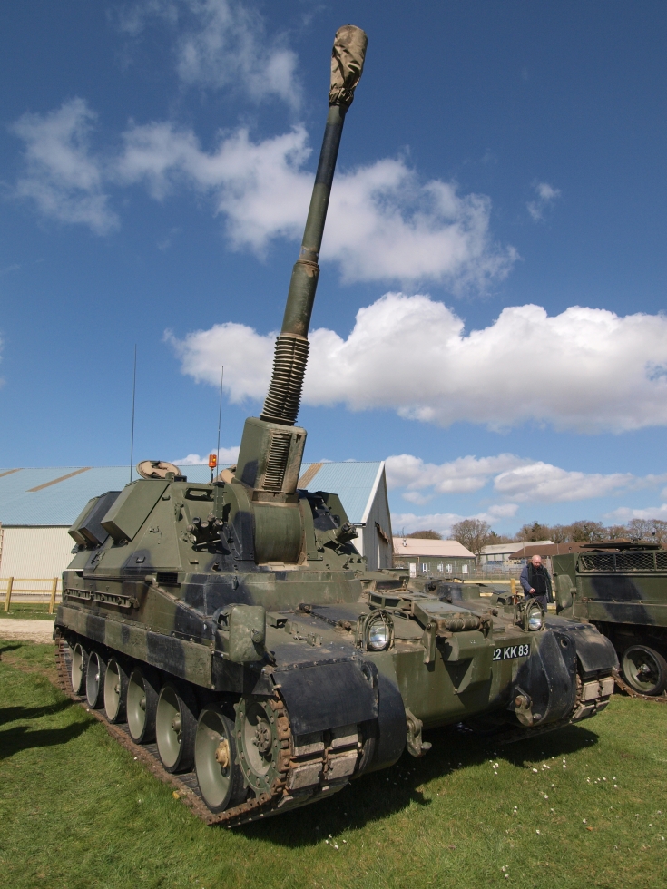

AS-90 Fact file - First Update!
This information was acquired from an outside source: Wikipedia. I do not claim this information as my own, or to be 100% accurate.
The AS-90 (acronym for: Artillery System for the 1990s, known officially as: Gun Equipment 155 mm L131) is a lightly armoured self-propelled artillery piece used by the British Army.
The AS-90 was first deployed by the British Army in 1993. 179 AS-90's were acquired to re-equip six of the eight self-propelled field artillery regiments (each 24 guns) in the 1 (BR) Corps, replacing the 105 mm FV433 Abbot SPG and older M109 155 mm Self Propelled Gun. It remains in UK service and will equip three field regiments supporting armoured infantry brigades for the foreseeable future.
AS-90 was designed and built by the Armaments division of Vickers Shipbuilding and Engineering (VSEL), whose parent company became BAE Systems in 1999. VSEL provided 179 vehicles between 1992 and 1995 at a cost of £300 million ($480 million USD).
The AS-90 underwent a capability enhancement program in 2008 and 2009, primarily relating to upgrades of the AS-90's electronic system.
In 1999, Marconi Electronic Systems was contracted to upgrade British Army AS-90s to include a 52 calibre gun in order to increase the range of the artillery. Critical to the program was a bi-modular charge system from Somchem of South Africa (selected after extensive trials of ammunition from many suppliers), which offered greatly reduced barrel wear. However, this ammunition failed to meet the requirement for insensitive munitions and the project was terminated.
Development
AS-90 started in the mid-1980s as a private venture on the 'gamble' that the tri-national SP70 would fail. When this duly occurred, the Ministry of Defence (MoD) issued a cardinal point specification on one page for a new 155 mm SPG. Four tenders were submitted, and AS-90 was the only offer that was not 'brochureware'. The MoD was also required to consider the US "Paladin", an upgraded M109 howitzer.
The MoD has undertaken studies in 2006-09 to "up gun" the Royal Navy's main shipboard gun armament, the 4.5 inch Mark 8 naval gun, to accept the 155 mm ordnance from the AS-90. This would introduce a common gun calibre for the British Army and Royal Navy, helping with ammunition logistics, and encouraging joint Army-Navy development of extended range and precision guided shells.
Design
In 1963 certain NATO nations, including the UK, agreed a Ballistics Memorandum of Understanding for a 155 mm 39 calibre ordnance and a baseline projectile with the shape used for the US M549 rocket-assisted shell. The AS-90 uses a conforming 39 calibre barrel which fires the L15 unassisted projectile out to a range of 24.7 km. However, this was a new design of ordnance and uses a split sliding block breech with Crossley obturation, instead of the more usual screw breech, to permit bagged charges (no metal cartridge cases). The breech mechanism has a primer magazine holding 18 primers.
It is fitted with an auxiliary power unit to eliminate the need to run the main engine to keep the batteries charged while stationary; electrical servos drive the automated elevation, traverse, magazine, shell transfer arm and loader as well as power for electronics and communications.
The vehicle is fitted with an autonomous navigation and gun laying dynamic reference unit (DRU) mounted on the trunnion. All main turret functions are controlled by a Turret Control Computer (TCC) with control and display units for the No 1 (Detachment Commander), No 2 (loader) and No 3 (layer). The combination of the DRU, TCC and powered laying controls provide autolaying. Every gun is fitted with a radar Muzzle Velocity Measuring Device. Reversionary mode laying uses deflection laying via the direct fire sight.
The gun can be brought into action fully closed down, the barrel can be clamped and unclamped from within the vehicle. Into and out of action times are less than 1 minute.
Characteristics
AS-90 on Salisbury Plain
Crew: 5, on board when moving (driver plus 4 gun detachment), full gun detachment 10 including driver, 4 detachment members in the turret.
Length: 9.07 m
Width: 3.3 m
Height: 3.0 m
Armour: 17 mm (maximum, steel)
Weight: 45 tons[vague]
Calibre: 155 mm
Range: 24.9 km (39 cal), 30 km (52 cal) standard charges
Rate of fire: 3 rounds in 10 seconds (burst), 6 rounds per minute for 3 minutes (intense), 2 rounds per minute for 60 minutes (sustained)
Secondary armament: 7.62 mm L7 GPMG
Ammunition carried: 48 projectiles and charges (31 turret and 17 hull), 1000 MG rounds
Main Engine: Cummins VTA903T 660 bhp 90 degree, v8, 4 stroke, liquid cooled, turbo diesel,
Max Speed: 55 km/h (Road)
Range: 370 km or 231 mi (Road)
Ground clearance: 0.41 m; Gradient: 60°; Vertical obstacle: 0.75 m; Trench crossing: 110 inches; Fording depth: 1.5 m
Variants
AS-90D - Modified for desert use. Thermal protection for crew and extra cooling for engine and machinery. Tracks adapted for reduced wear in sandy conditions.
AS-90 "Braveheart" - Basically the AS-90, but fitted with the 52 calibre length gun. This project was terminated due to non-compliant propellant charges.
Haubicoarmata "Krab" - (eng. Howitzer-cannon Crab) Licensed "Braveheart" turret on a Polish chassis UPG, with modern "Azalia" BMS. Designed and integrated in Poland, by Huta Stalowa Wola and WB Electronics. As of 2007, two Krab ("Crab") prototypes were built, and successfully completed all required evaluations and state acceptance trials. Initial serial production started in 2008, 24 units are planned before 2015 of 72 projected for Polish Land Forces with 8 in testing phase as of 2012.

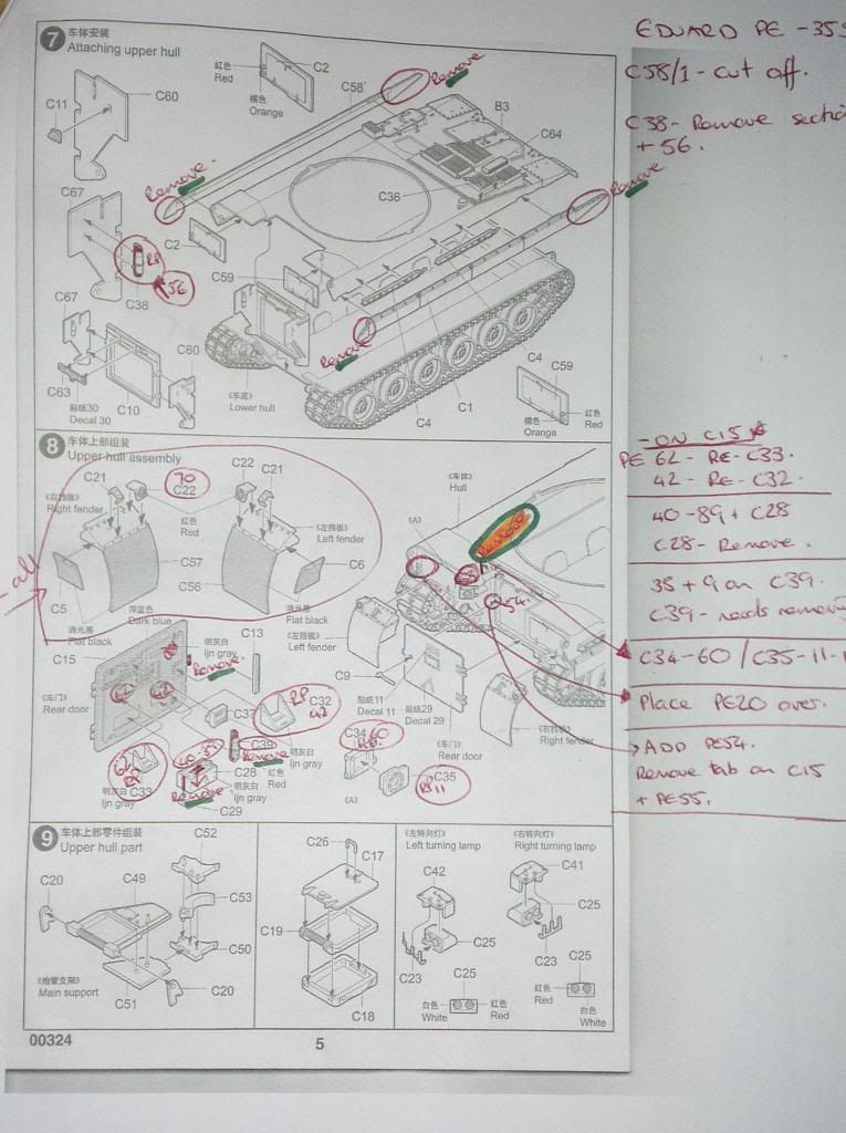

PE Struction Blueprint - Update Two
'Ow do!
At this moment in time I haven't started on the AS-90, mostly because I've been finishing another project and I wanted to make sure I'd caught up on my research. With this being my first attempt at PE, I'd decided that instead of my normal attitude to things of ignoring instructions and diving right in, it'd be wise to look over the PE and instructions. However, upon doing so I become quite confused as the instructions only goes as far as telling you what needs replacing or where it needs adding on a specific area, so it was difficult to me to work out on a whole where it all went.
[youtube]0Av-0rEwKZE[/youtube]
What I decided to do was scan the instructions onto my PC and then print them off, with this copy go about make a 'blueprint' or 'map' if you like of where the PE was going, and because I could see it on the modelled instructions it made a lot more sense to me. For some this might be how they do it and you're thinking 'well derp', but I hadn't come across anyone suggesting this as a method. In light of this, I then thought well if I'm new and I'm confused then there must be others in the modelling community that are also a bit intimidated by PE, so I'll put up some images below and I've also made video, which is linked above of what I mean in case others haven't thought about doing so.
On this photo on the left hand side there is what looks like a canister of some sorts, the red penned out section is to indicate that this part needs removing for another part (56) to be added. (56) is the PE number of the PE fret.
The whole mudflap section has been circled here, that's because from what I can make out, it's all replaced by PE, so would be a waste of time to indicate the replacements as it's all new.
On this photo you can see where I've used a blue marker to draw 4 dashes, that is to indicate where pieces of PE are to be added, and nothing is replaces or removed. It is a completely new feature of the model, in this case I believe they're brackets that will be used to hold a tool, or some wire. You'll also note on the grates have numbers on them, I haven't stipulated removing them so far as the instructions to say to, so I'm not sure if I should just put the mesh PE over the top, or cut out the grates and then place the PE over.
Similar idea here to indicate additional parts.
And the final photo showing the replacement PE mesh cage on the roof. Additionally I've read that the cage itself actually has a floor of its own that isn't the shown or displayed in PE. I haven't found any references images yet, but will keep looking to confirm.
As a side note after doing some reason and searching on 'the google' as my Dad would say, I've found that most AS-90's now have a radio box on the back of the vehicle on the left hand side, and was implemented after trumpeter creating this tooling. So, I'm going to attempt to scratch build on out of plasticard, no idea what thickness yet, and also use the spare PE as well, as I doubt I'll be doing all the PE for the model, but if I plan it before hand I can then see where I'm going.
Right, enough talking. Now it's apparent there is no modifications to the lower hull, suspension and wheels one should think about pulling a finger out of my rear and get building!

Looks like a proper blueprint! Cracking looking kit and add-ons. Looking forward to seeing this one come together :th:

Are you sure you're not actually building a 1:1?? LOL ... that's some very neat notes

Great looking Kit, your work on the instructions and notes is amazing!

That is some great preparation and forward planning - always worth doing! :th:
Personally, I always intend to do a bit of forward planning, but then get carried away and just dive in - and it always causes me problems; must learn! :wall:

Good work on those notes, I think for really comprehensive Etch sets you need to do something like that just to keep it all straight.

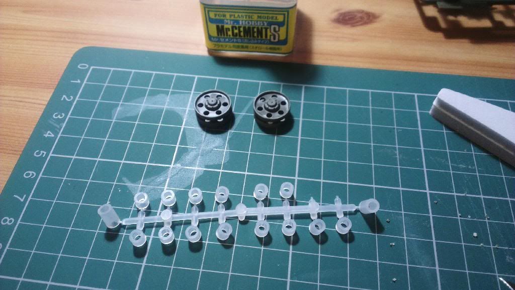

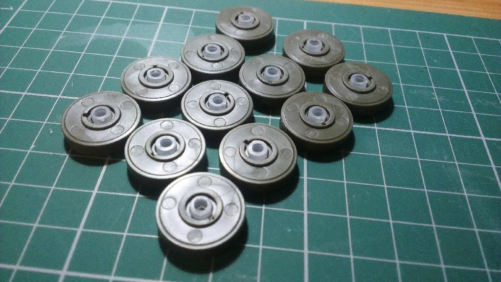

Lower Hull & Wheel – Update 3
'Ow do!
I finally started! I know, shocking isn't it. :-p
The main reason the construction of the AS-90 hadn't started was mostly due to my amazing ability to procrastinate to the ends of the universe, and partly due to my trepidation, fear and a healthy amount of respect for the kit. I've never tackled anything like this (my 2nd model after all) and the last thing I wanted to do was for the vehicle to end up in the bin. It's for that reason the blueprints for the PE have been draw out, which reminds me, they need to be completed before I move on.
As you can see from the update title, this post will be dedicated to the construction of the lower hull and wheels. If you're interested in seeing my progress as it stands now, please take a look at the video below.
[youtube]EcUPFymDKmQ[/youtube]
I'd like to say if you don't like lots of photo's, this isn't the post for you. I really should have made a post straight after doing the suspension on the lower hull, but it was late and then as soon as I got back from work the following day I commenced with the wheels. Ho-hum. :tongue:
For re-cap purposes the first image I have for you is sprue 'A' which is the lower hull and wheel sprue, and as every tank has two sets of tracks it's understandable for there to be left and right sprue.

That's the lower hull done for the most part, simple enough to be honest. Now onto the wheels. They are really easy to construct, the cleaning is the time consuming part, and I tell you what with the amount of filing and cleaning up I believe I sanded most of my fingers way and holding small parts for such a long time is a killer. Tank clean-up virgin syndrome obviously.
Here are the photo's of the wheel construction, so simple I don't believe an explanation is really required. I will say that poly-caps that came with the kit were used, and for no other reason than I could. :thumb1:

Nice idea with the PE, there is a lot of PE for this kit and it is easy to miss some.
