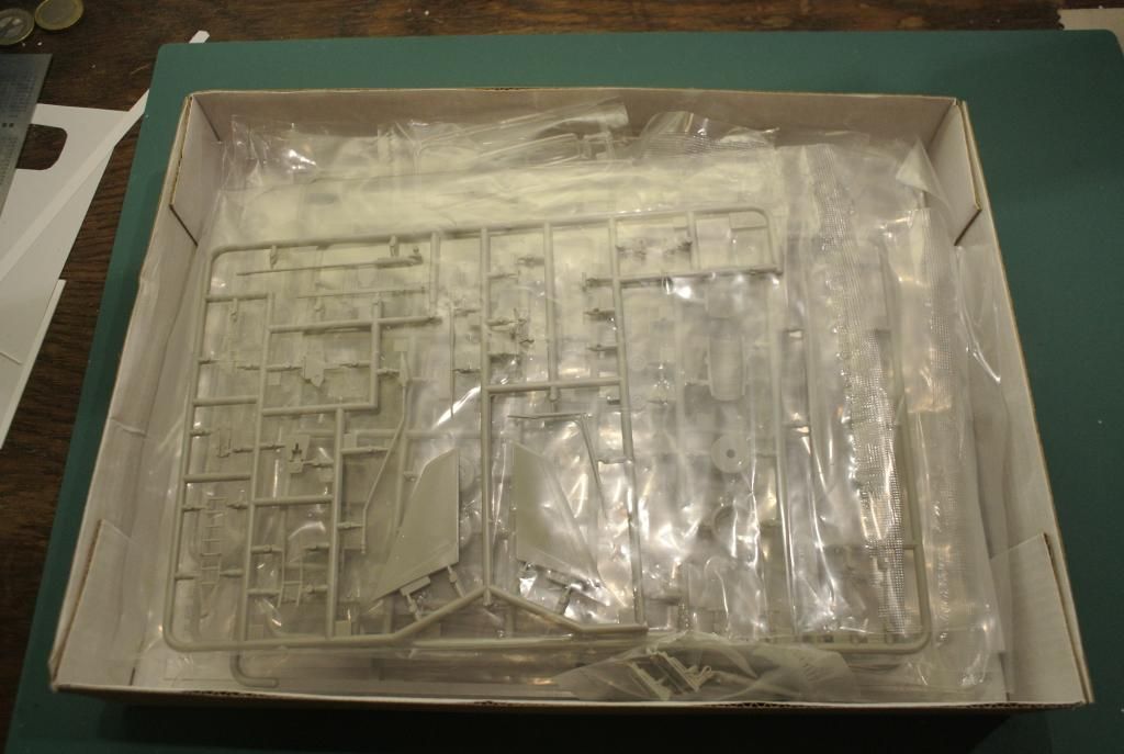

The tooling of this kit is from 2009 and this release is from 2010. The box comes absolutely packed with plastic. The majority of the sprues comes separatly packed. There is a total of 7 sprues with the ejection seats on their own sprues.
Bought this kit for: £10.56 / €13.27 / $17.13 + shipping charges from http://www.creativemodels.co.uk

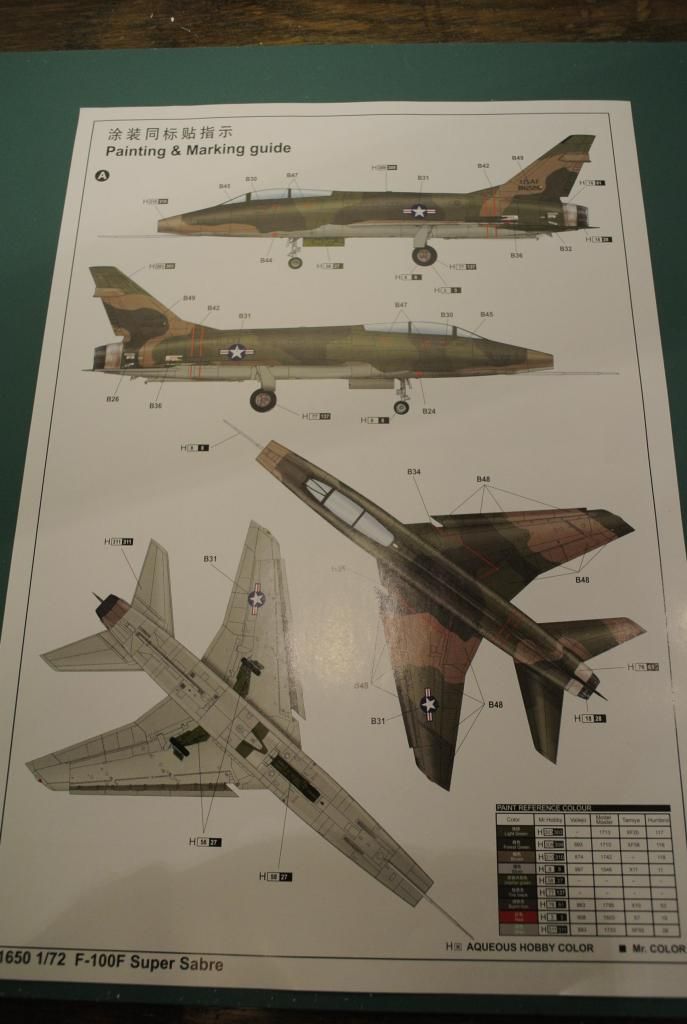

Instruction sheet
An example of the instructions

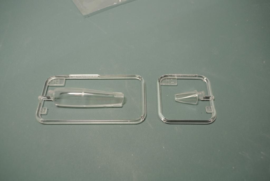

Clear parts. Look really good.
Very little magnifying effect.

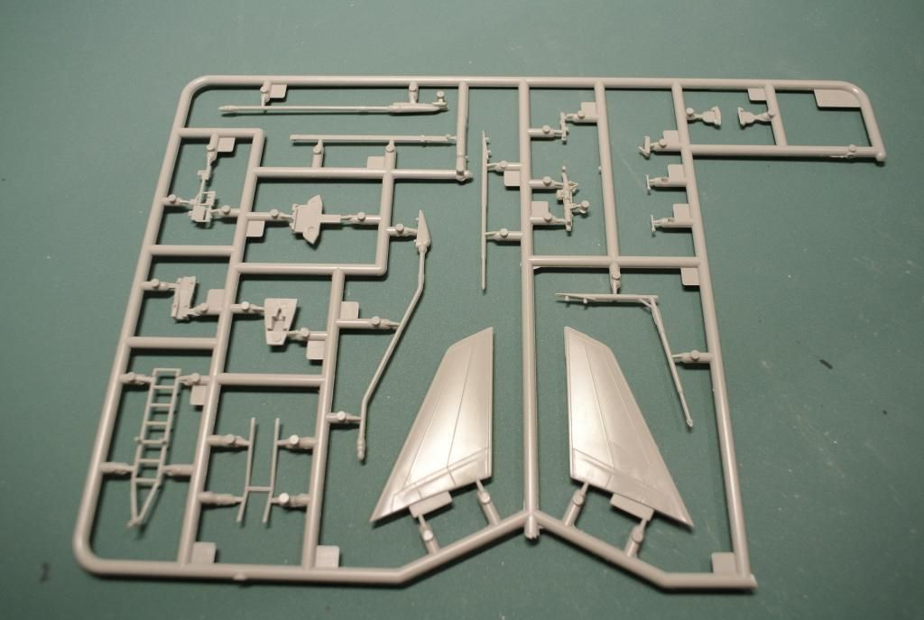

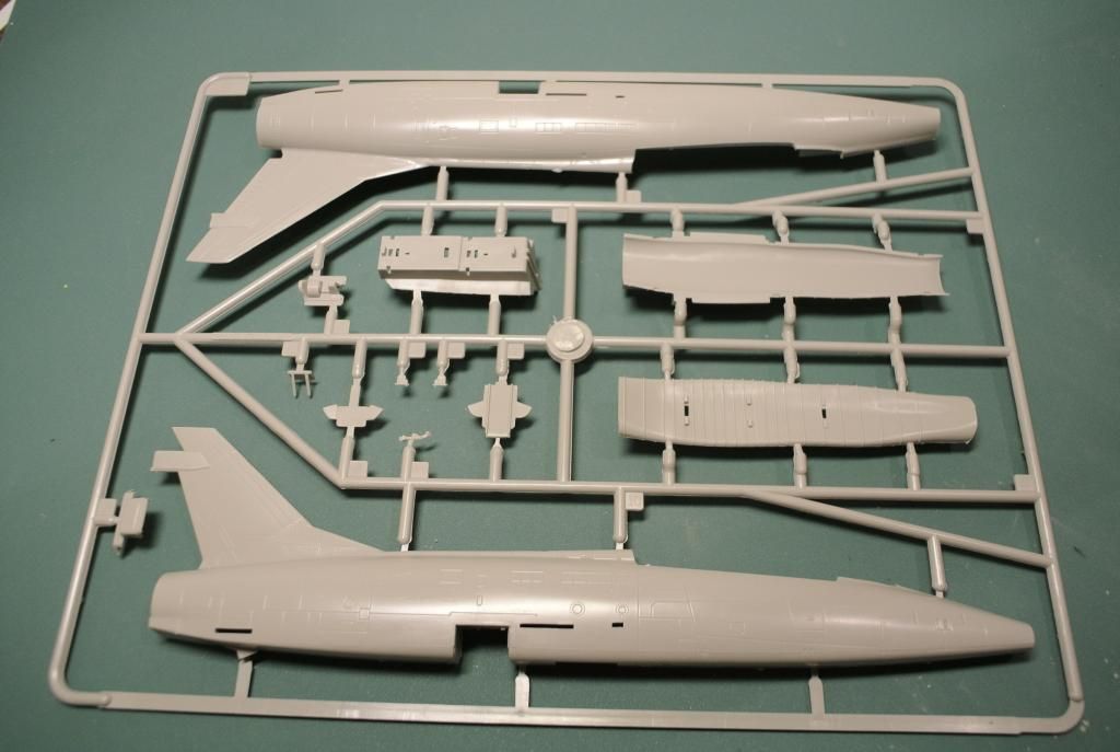

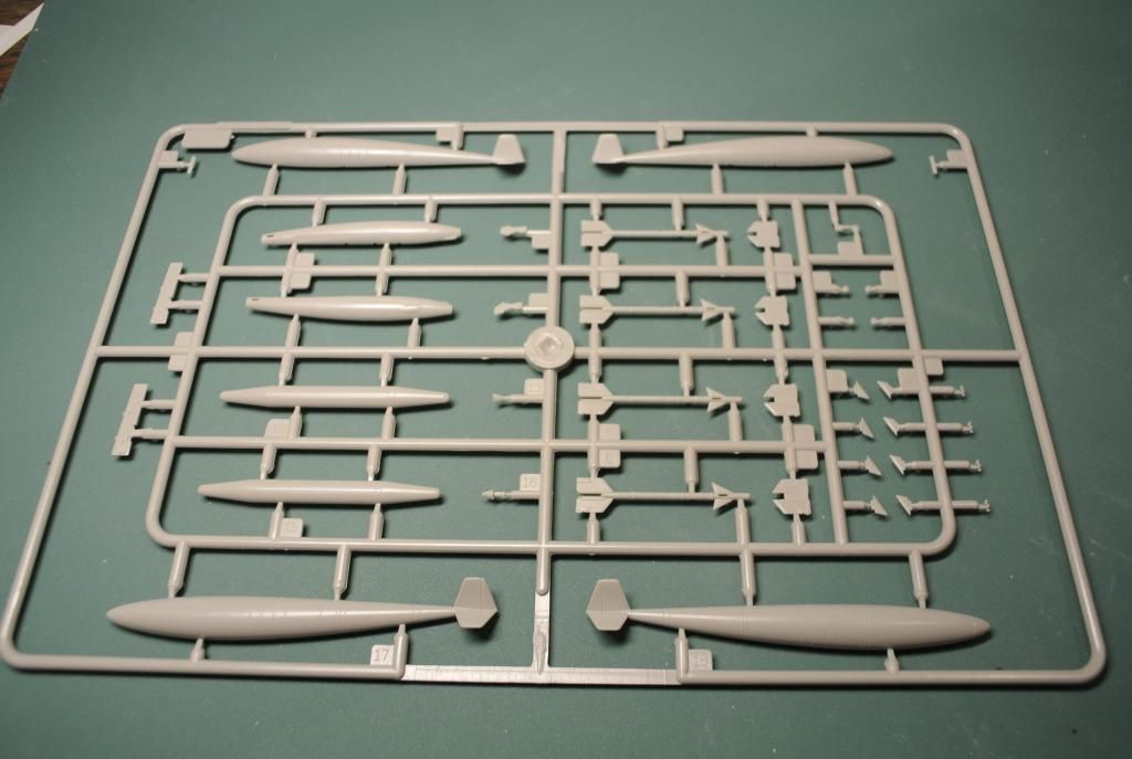

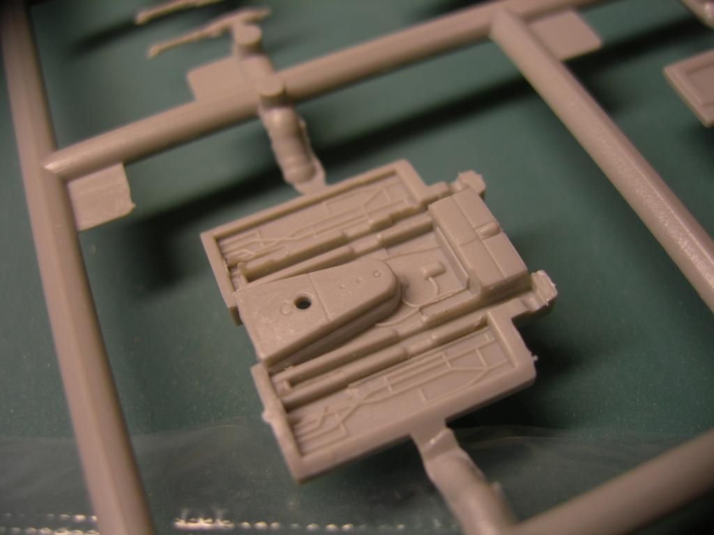

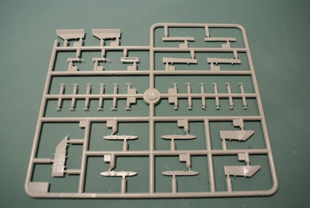

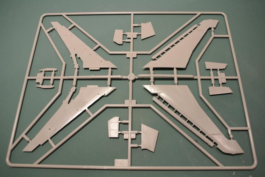

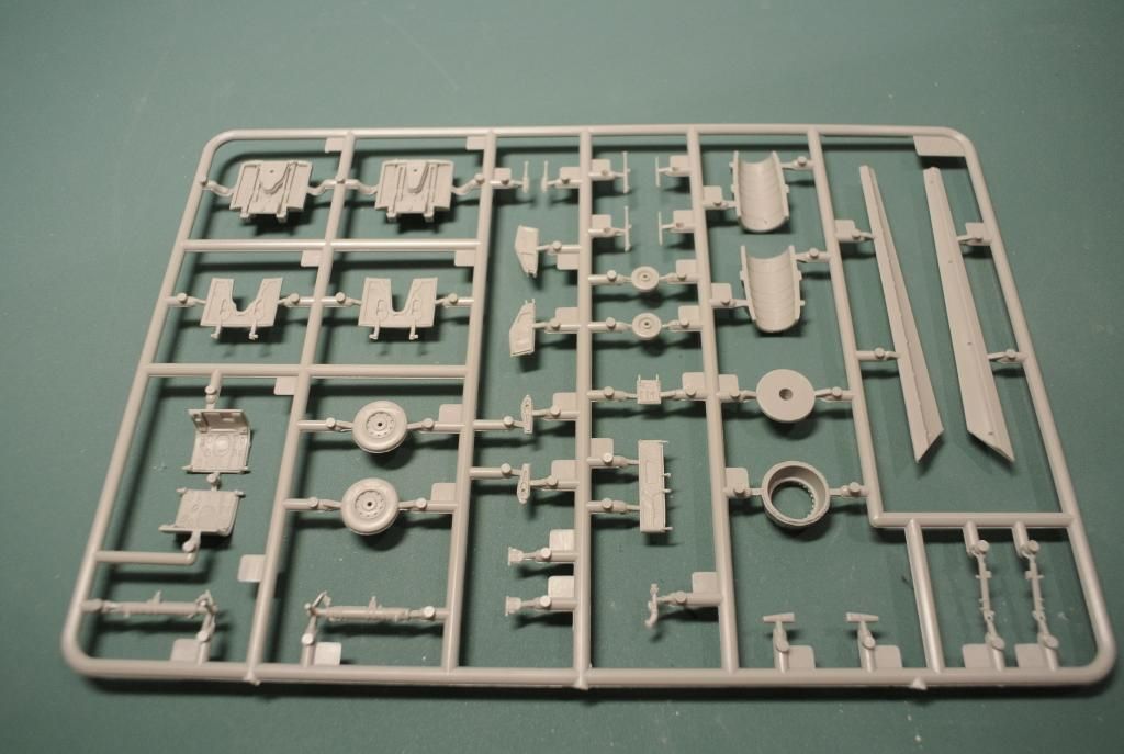

Sprue-shots:
Recessed details

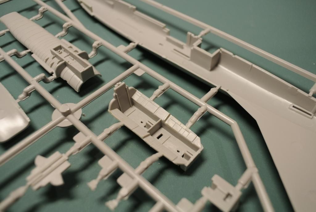

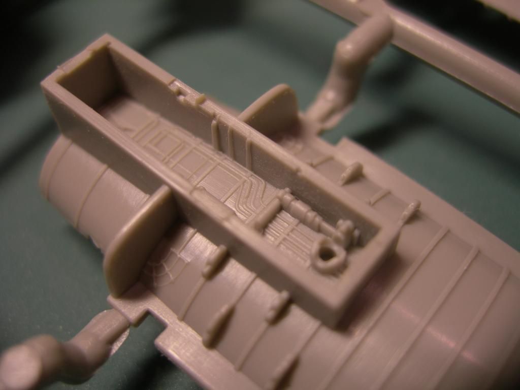

Small details for the insides.

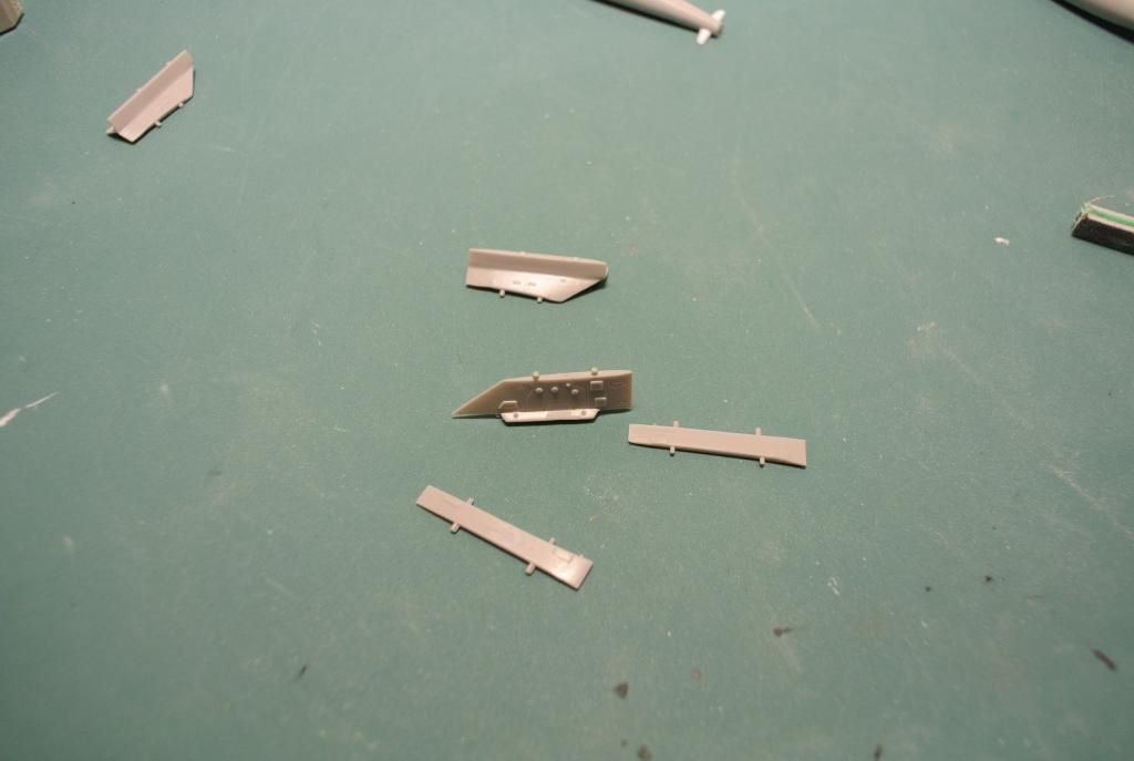

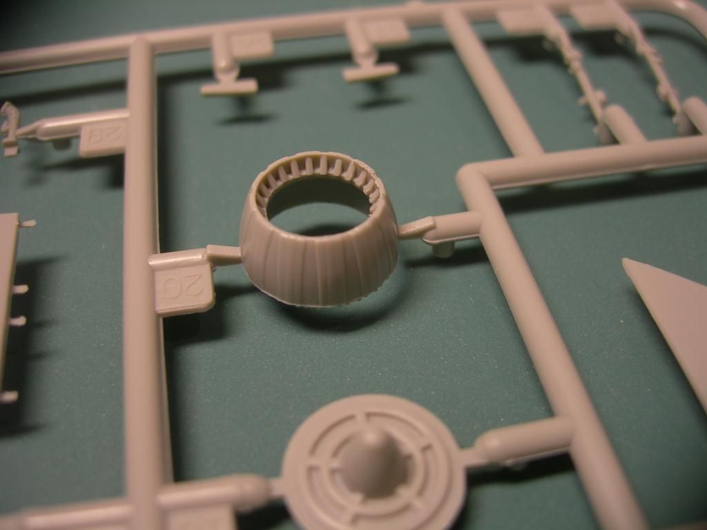

pylons
Probably wheel bays. Good looking details.
Really nice OOB ejection seats.

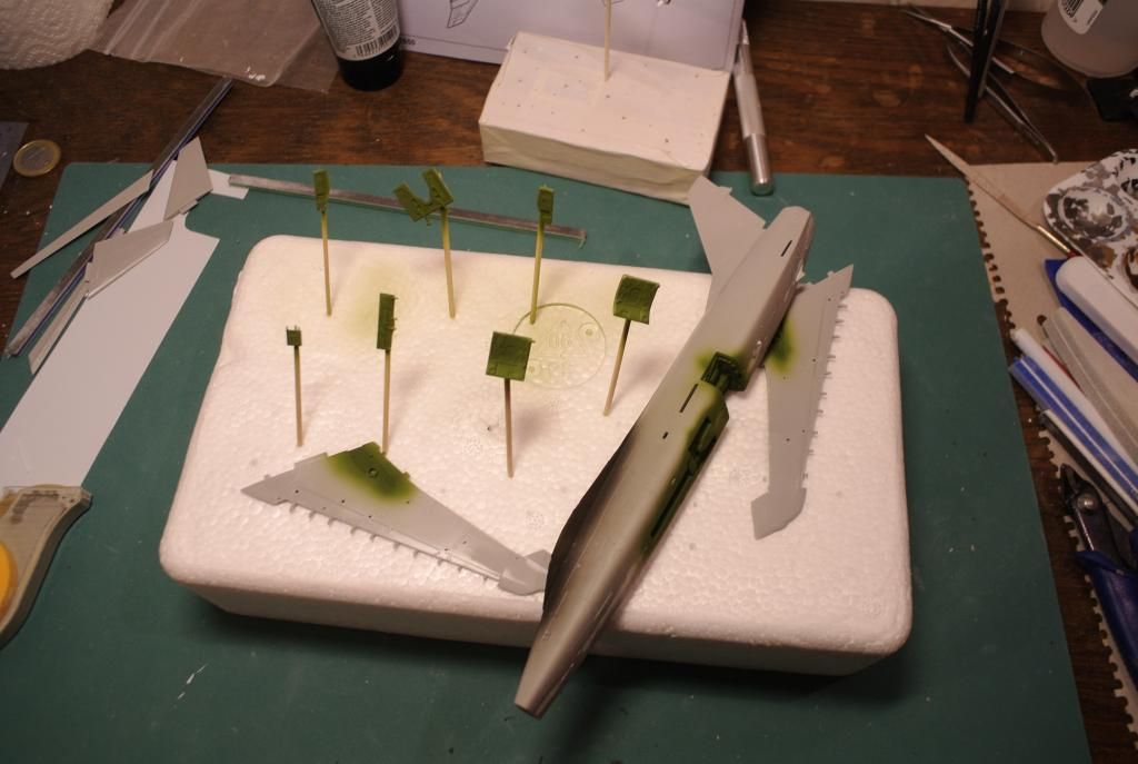

This will be my first kit thats airbrushed by me!!!!! :wtf: :wtf: :crazy: :cheers2: This will prove a challenge for sure. Dont know if I will use the Vallejo Primer or the Tamiya rattle can or just some grey Tamiya paint. The paint I plan to use for the SEA camo are Tamiya acrylics. I bought the ones I think will do the job. I have alot of Vallejo model color that would probably do the job, but my trials with the airbrush using model color have been very unsuccessful. The Tamiya ones sprays so nice in comparison.
I bought some Tamiya acrylics that I think suits the SEA camo. It will take some mixing, but I still prefer he Tamiya acrylics before the Vallejo when it comes to spraying.

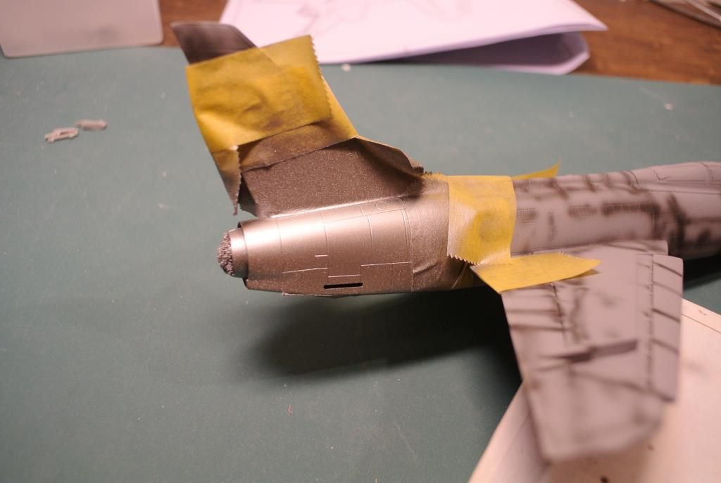

This will also be the first time im using Mr Metal Buffables for the exhaust. Have great expectations on these and Im excited how they will turn out.

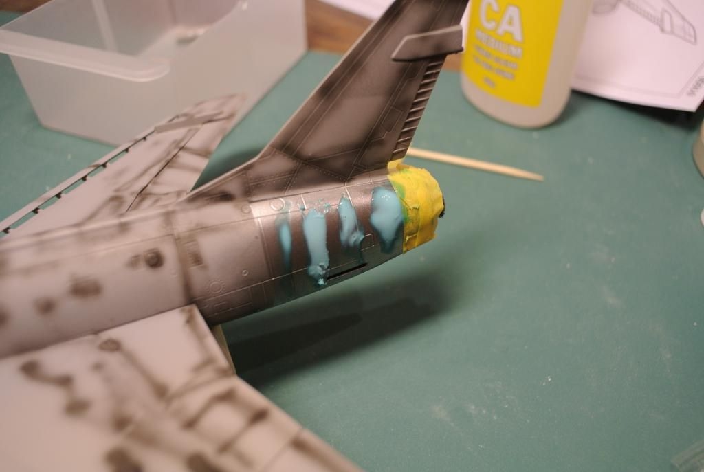

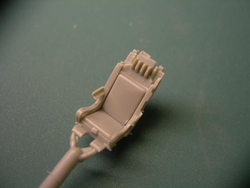

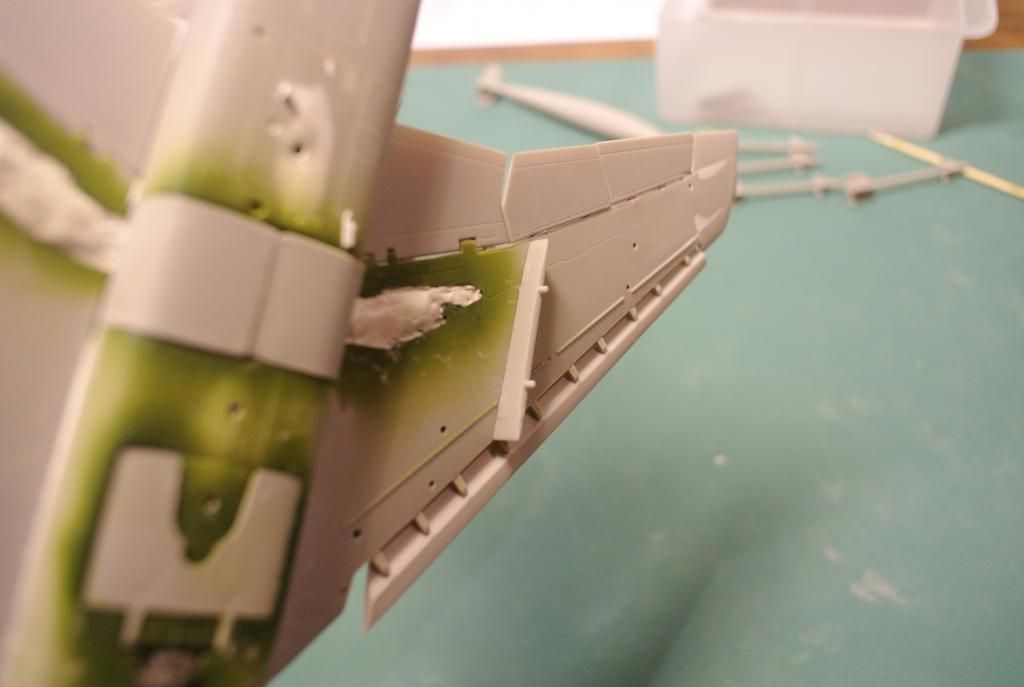

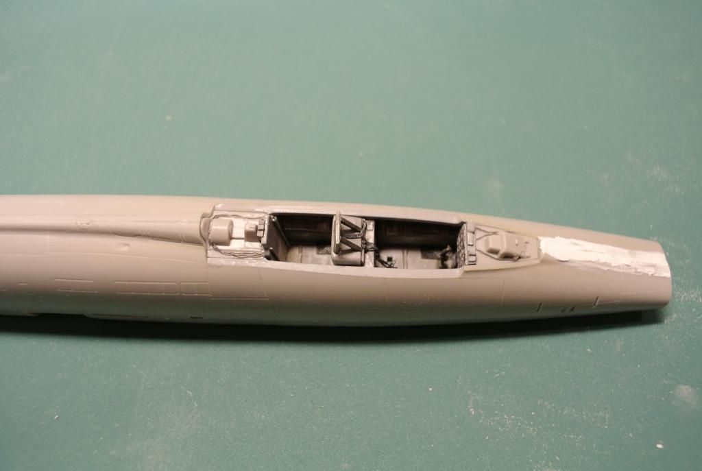

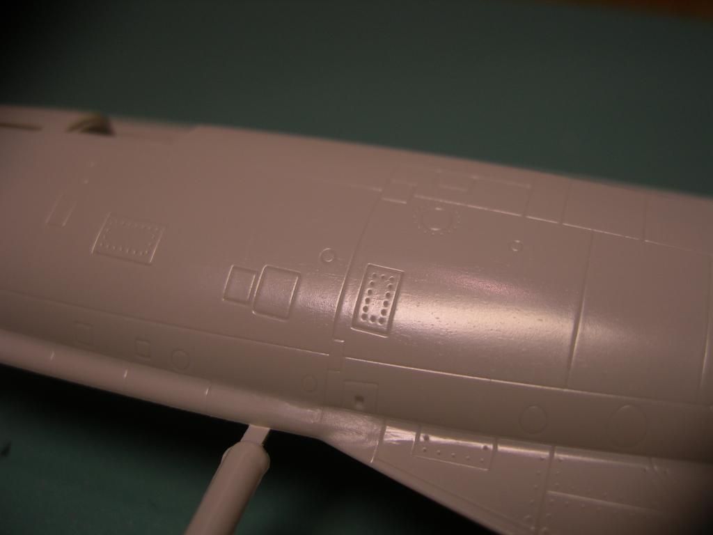

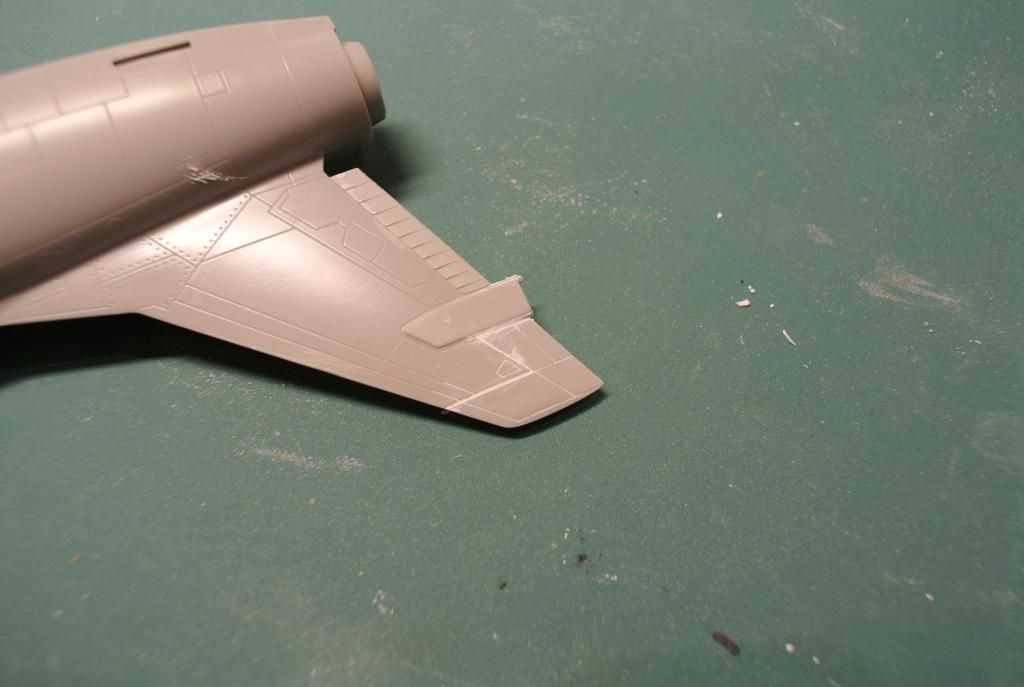

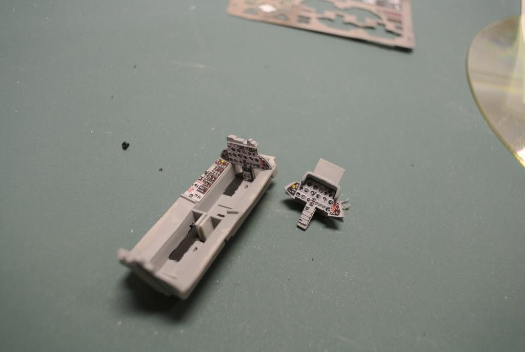

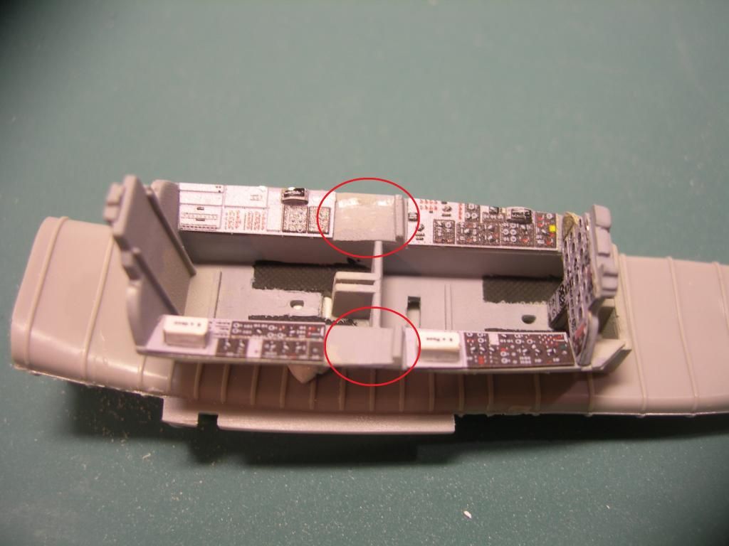

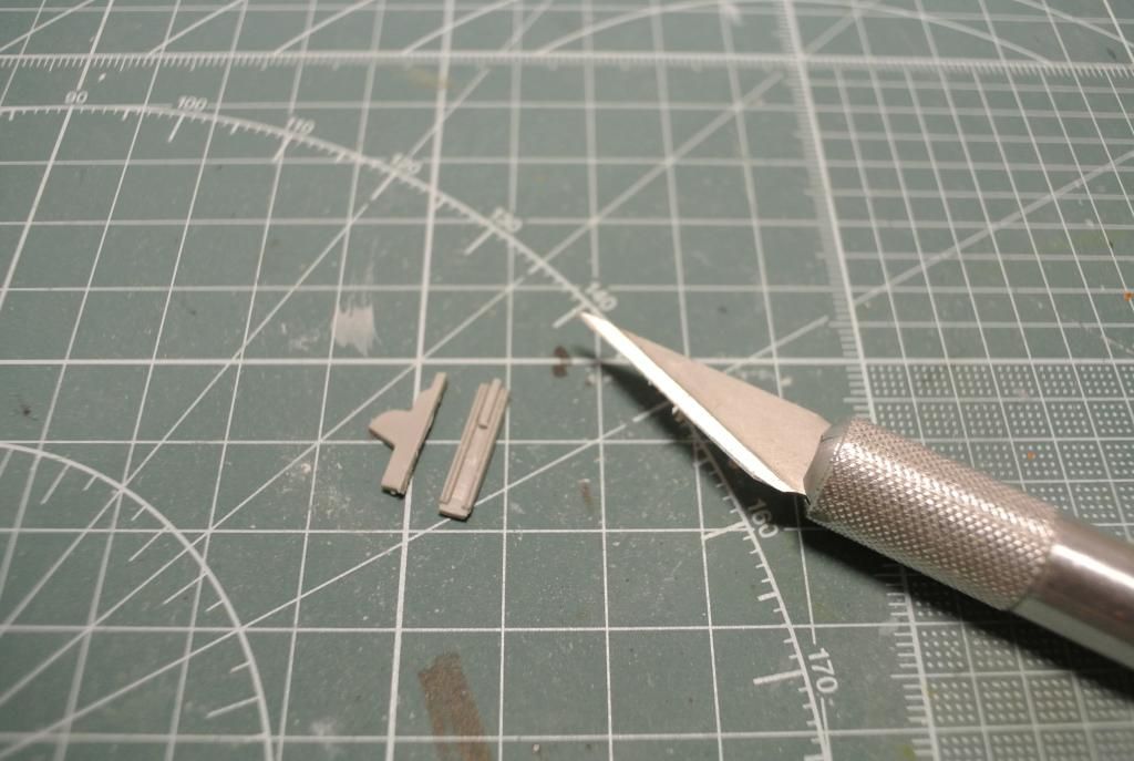

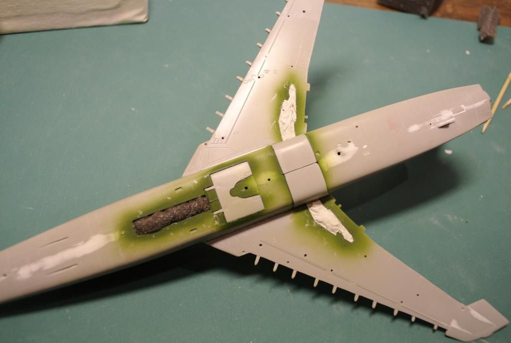

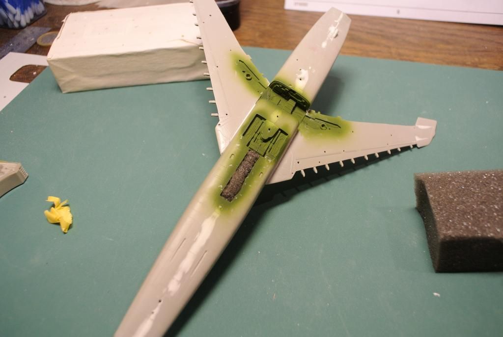

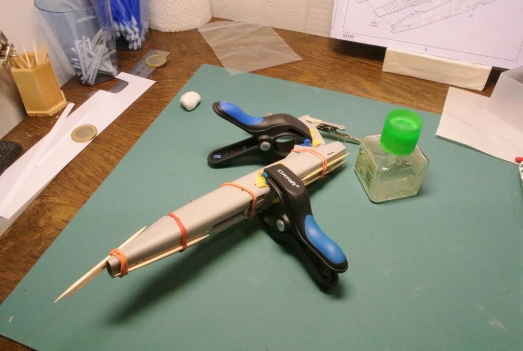

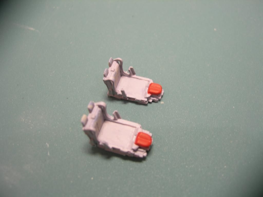

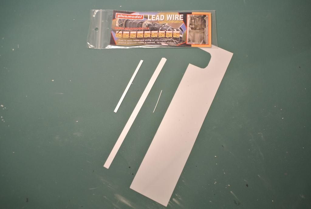

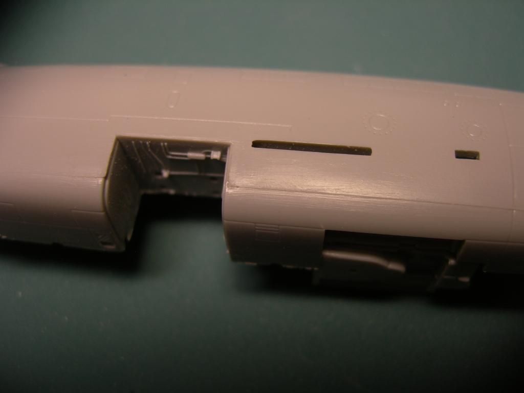

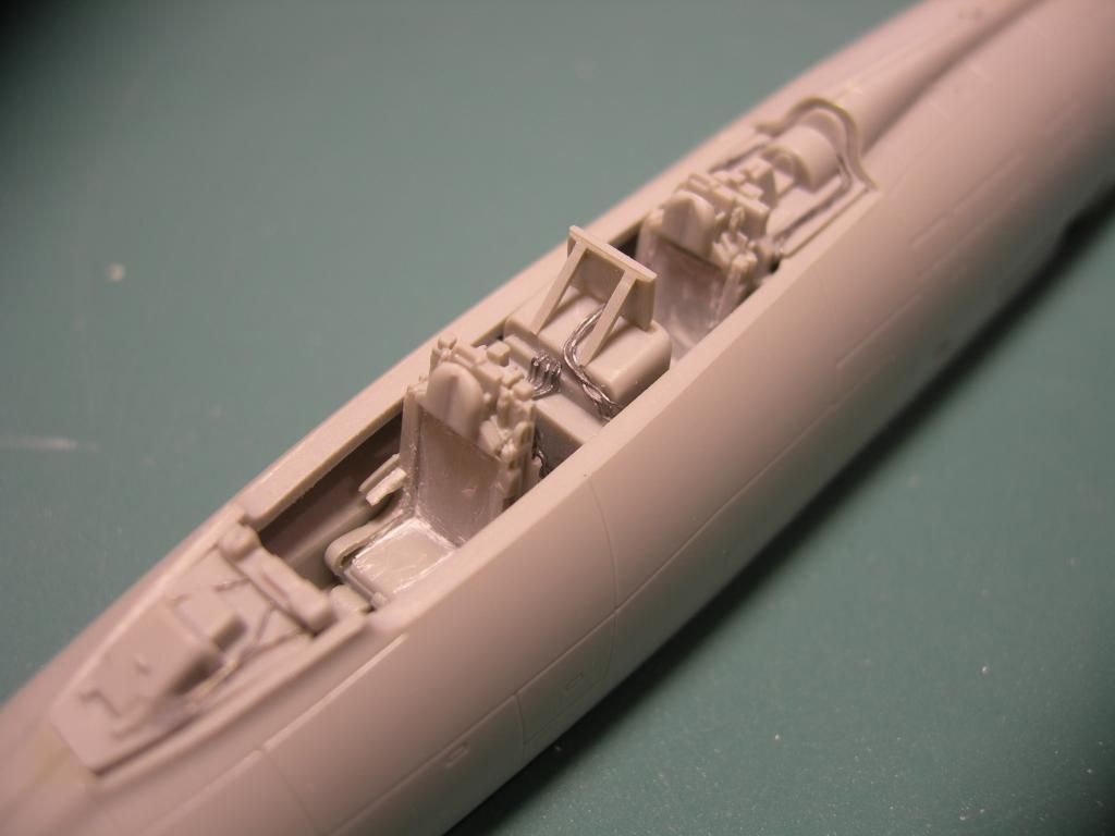

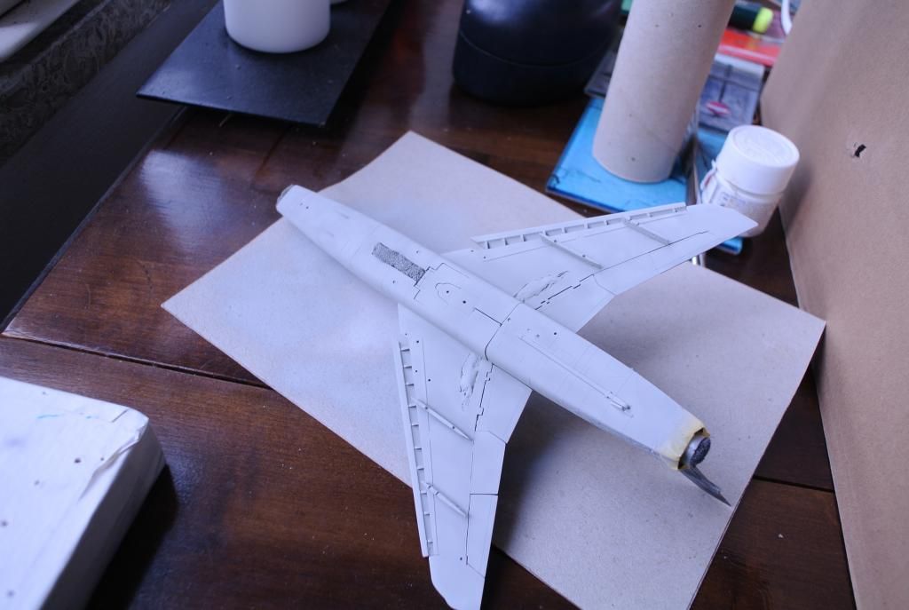

Have started doing some preparations to the kit and tried to correct some inaccuracies. Normally, I just cant be bothered with small inaccuracies but I really want this cockpit to shine as im having the canopy open. So....
The ejection seats does not have cushions at the back. Atleast not in the references ive checked :P So they had to be chiseled out.

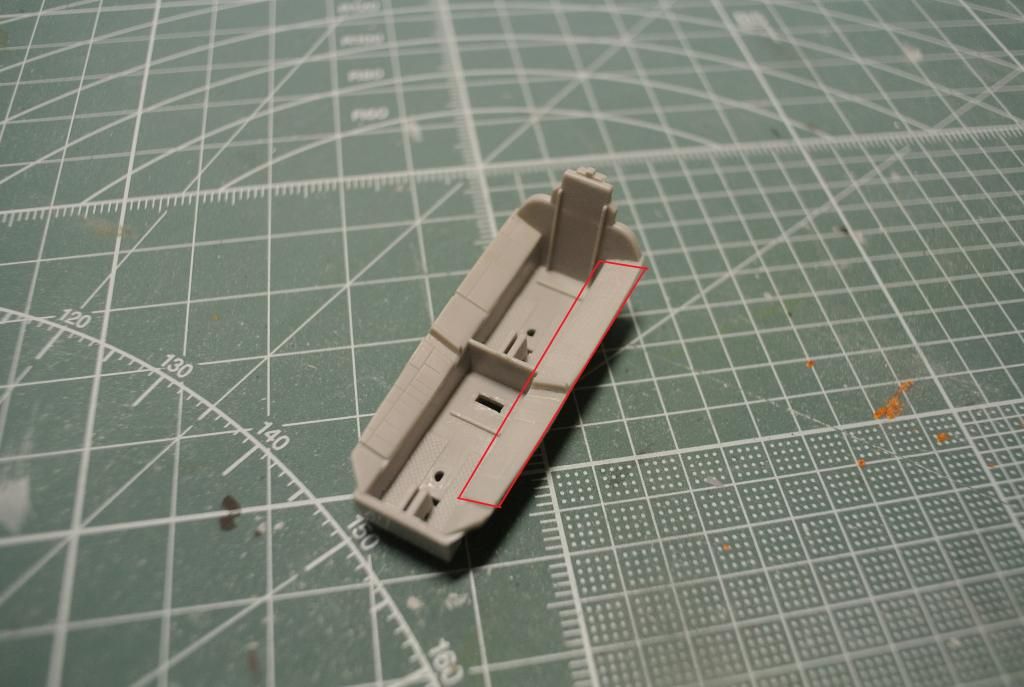

The cockpit seats are divided by a "wall" in the kit. Again, the references show that the seats are only separated by some kind of ribbing that supports the front seat, so a tiny bit of surgery goin on here.
Sanded down the instrument panels to make room for the photo etch.

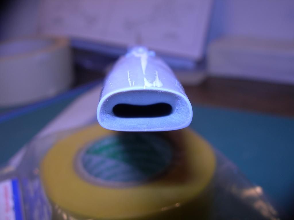

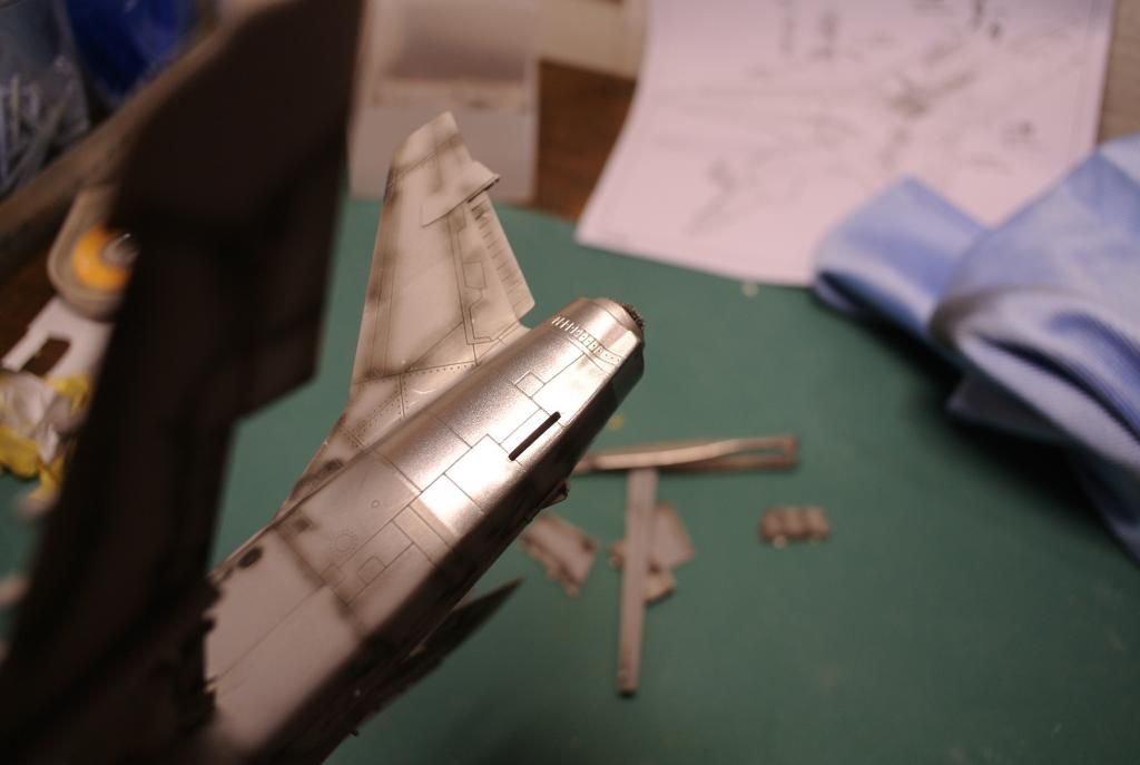

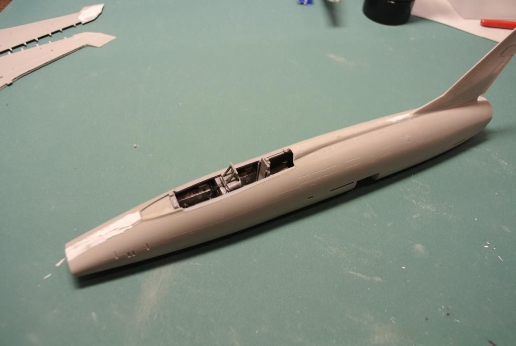

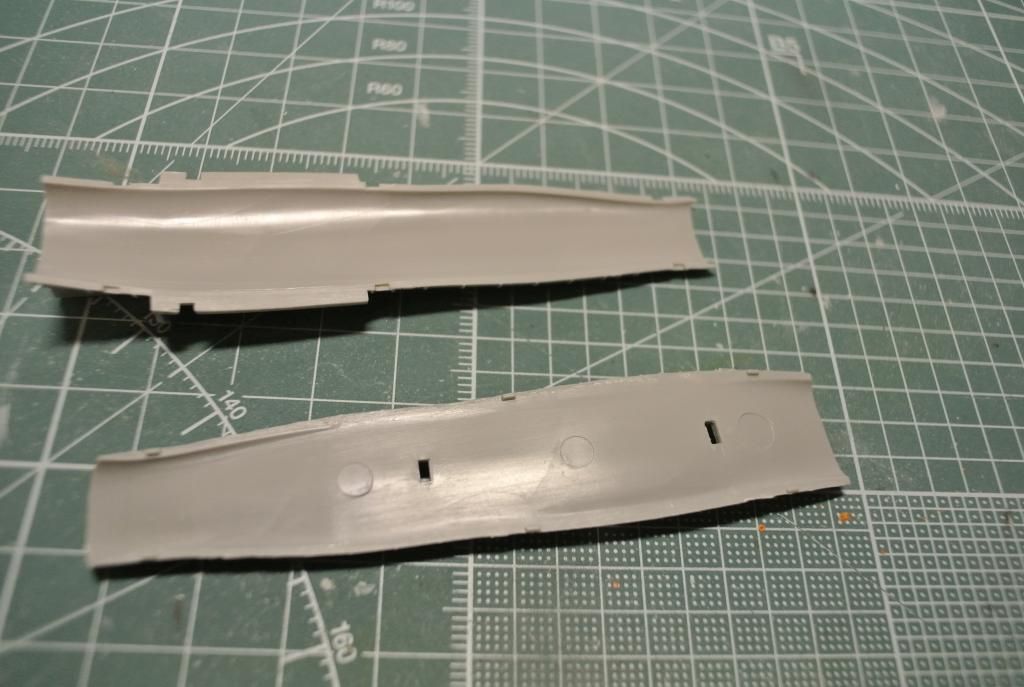

The top side of the intakes has ejector pin marks, but these will be fixed quite easily.

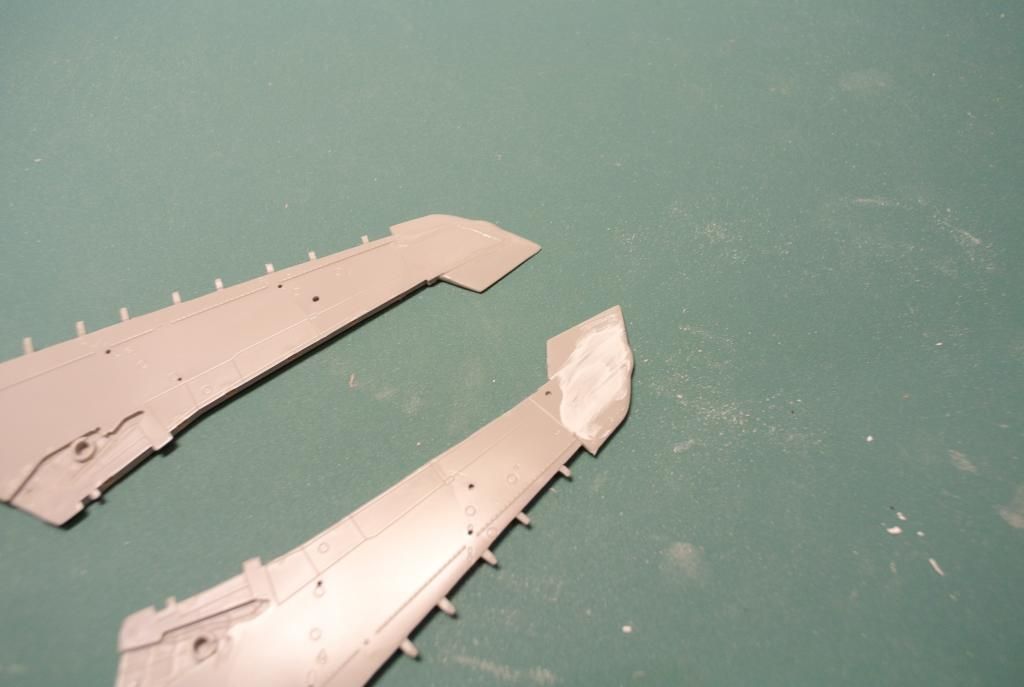

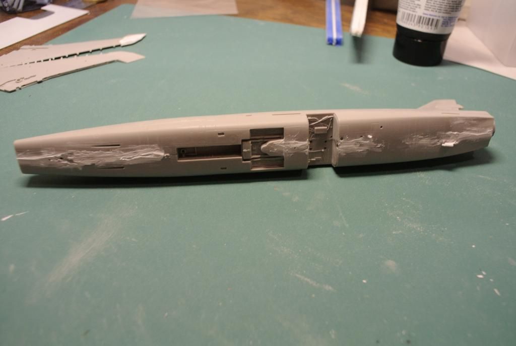

More filler work, the fit wasnt excellent on the fuel tanks.

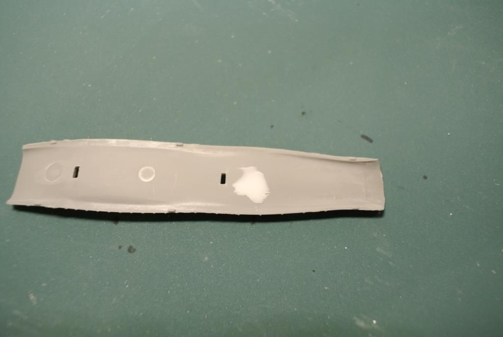

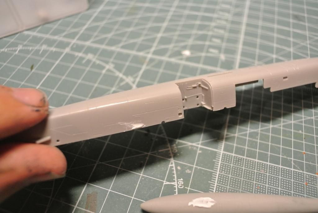

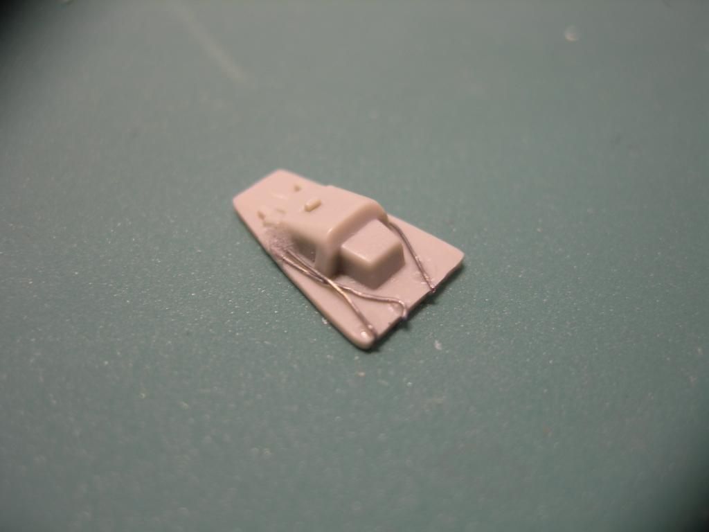

Some kind of mysterious hole on the bottom of the fusilage. No idea what it was, but it was not supposed to be there.

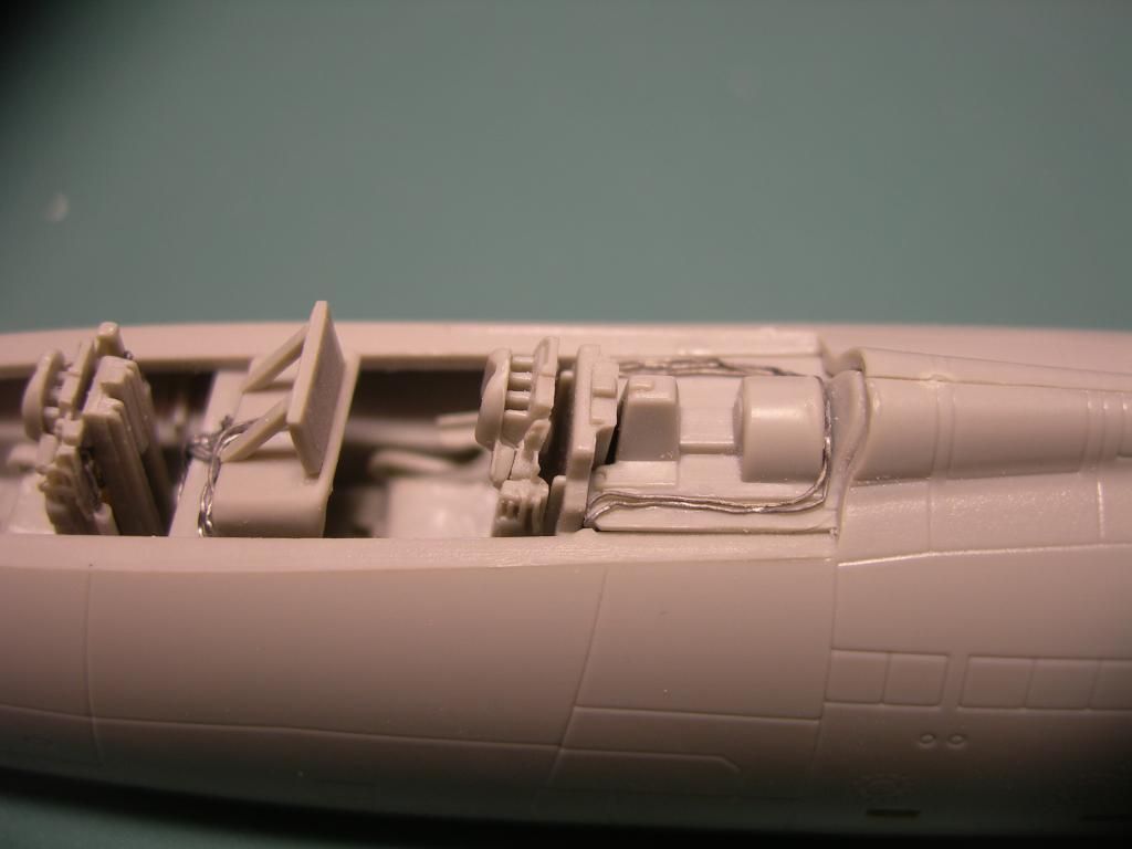

Added some detail to the area behind the cockpit. Just simple lead wiring.
As you can see, minor preparations. I will wait as long as I can with the assembly of the cockpit cause I really want my booklet to arrive before that :D

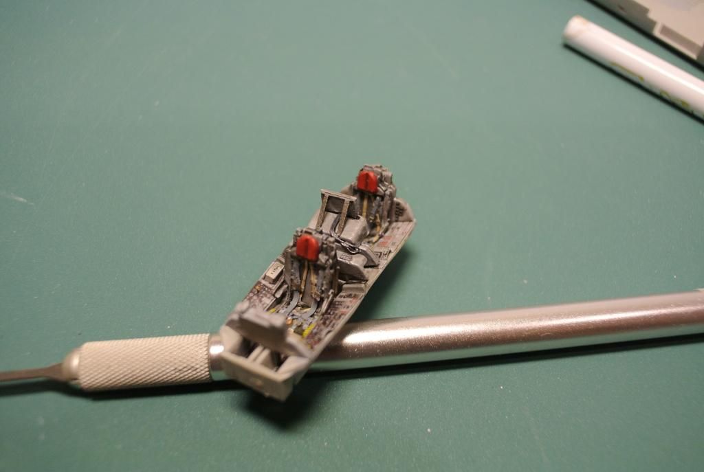

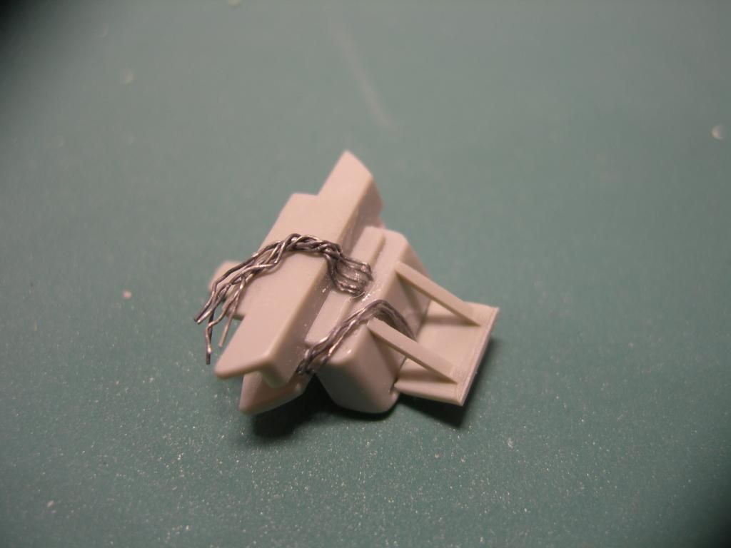

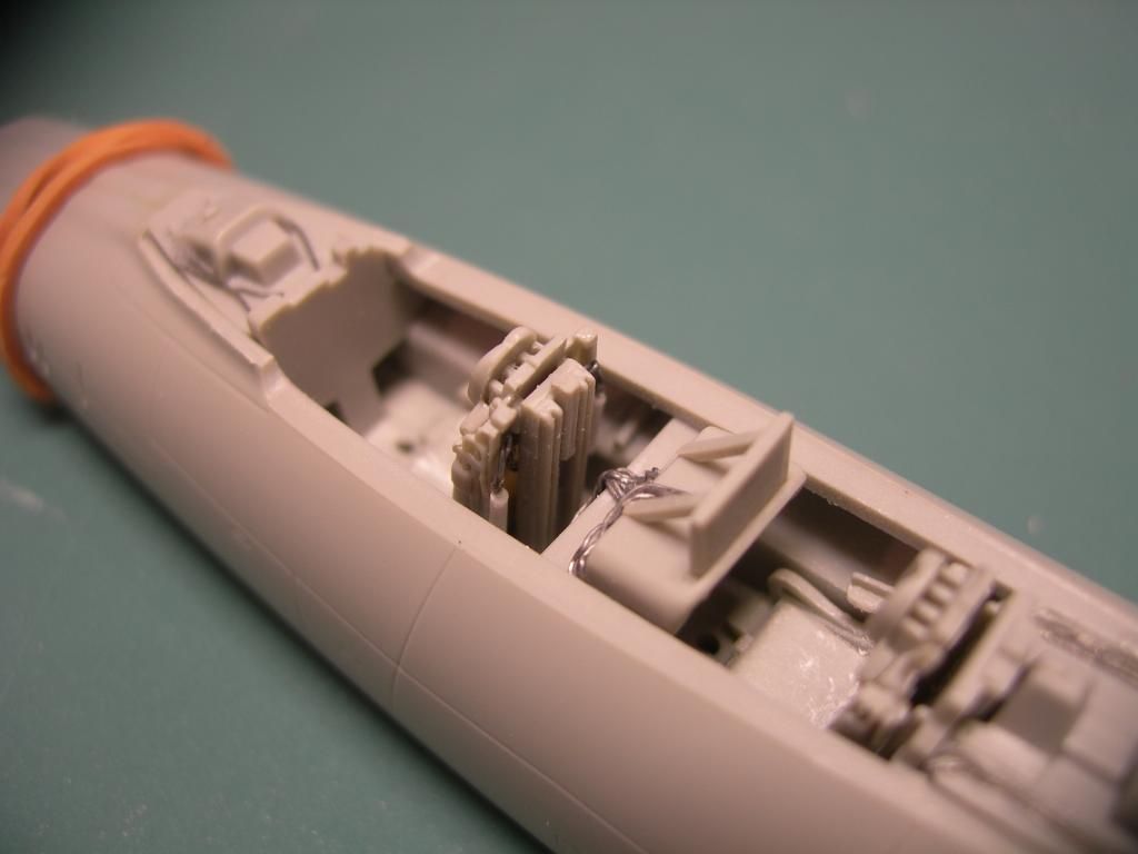

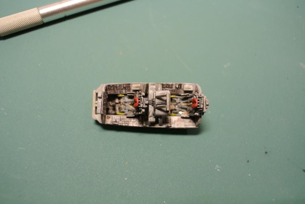

I apologize for the huge update but I did alot of work today and I want as much information as possible in this thread. I worked like hell with the photo etched parts and this was my first time using the Eduard Zoom set and it was both enjoyable and a pain in the ass. I should add that the first thing I did was to de-tack the self adhesive parts as the adhesive felt really weak. Here it goes:
I fixed the ejection pin marks in the intakes, however little of the intakes will be viewable once its assembled.

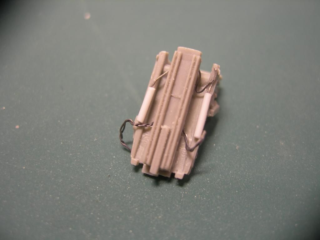

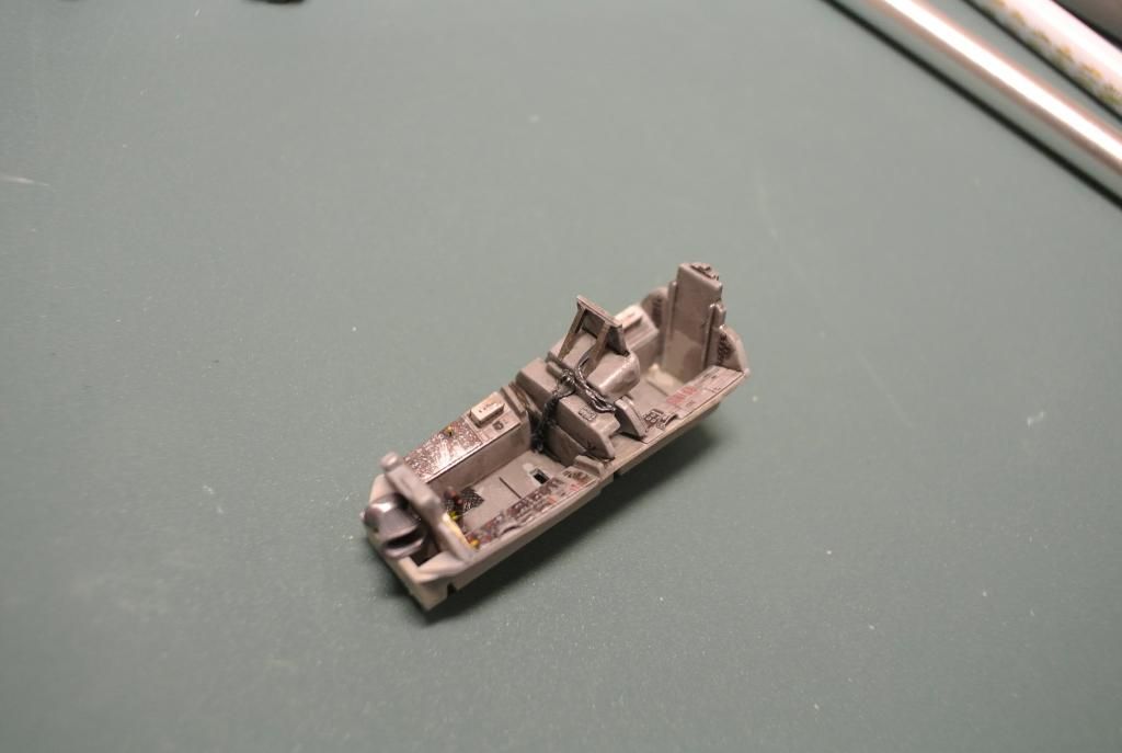

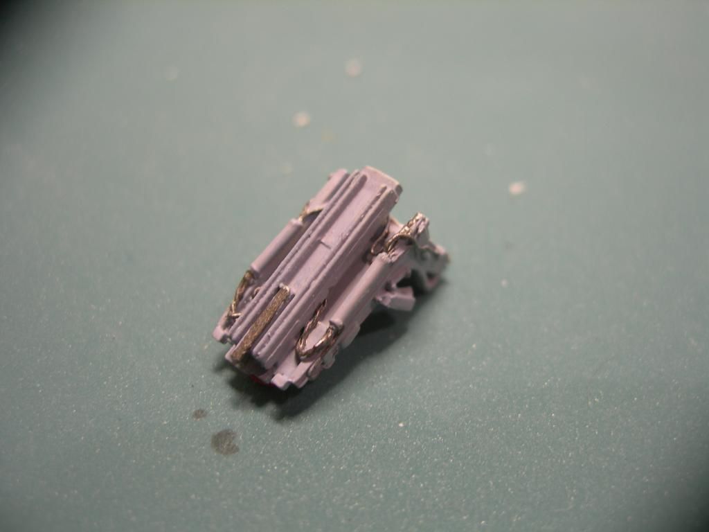

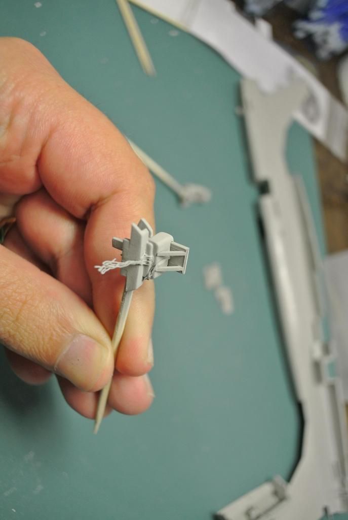

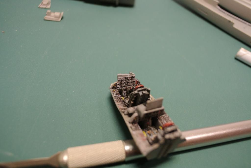

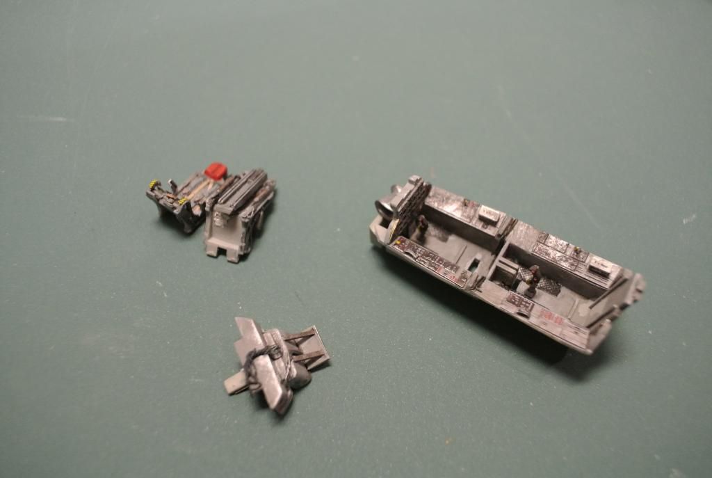

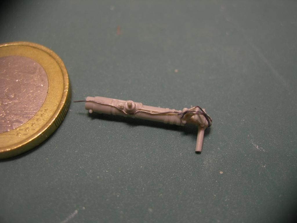

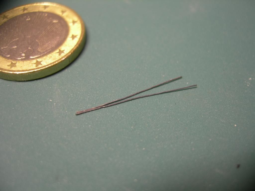

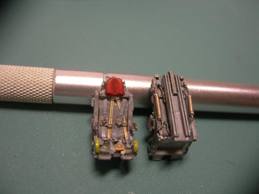

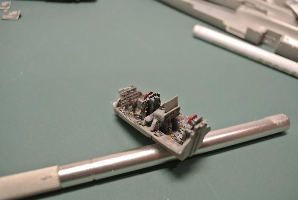

I wanted to wire up the front ejection seat and I did this with the help of lead wire, the thin variant 0.2mm.
Did some more wiring.
Dry fitting to see if i need more detailing.

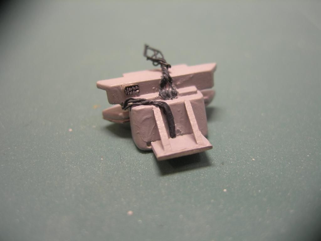

The details on the back of the seat will be visible

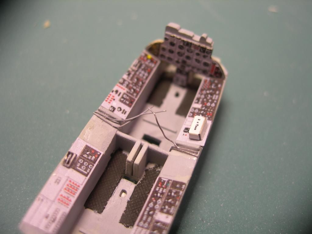

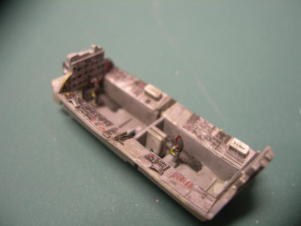

Basecoated the cockpit
Started painting the seats

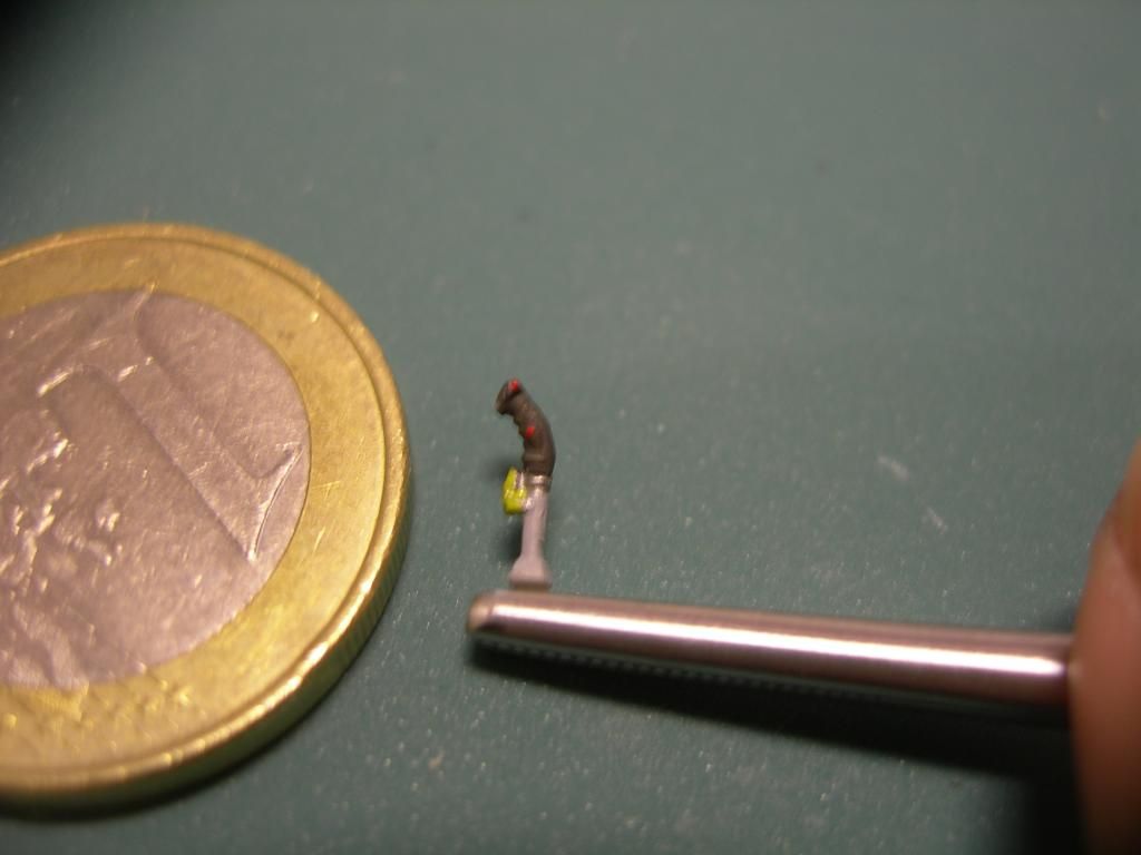

TINY joystick.
Started with the photo etch

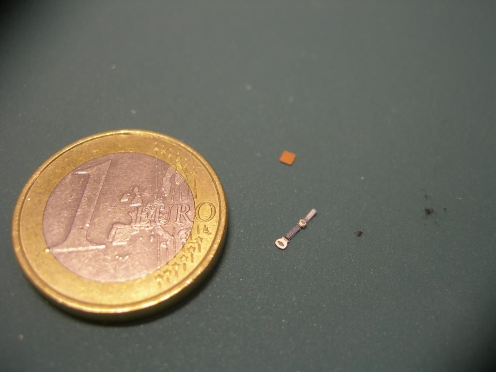

The harnesses are so tiny in 1/72 its ridiculous! :wall: :wall:
Im very pleased with the result though. The seat is packed with straps, latches and harnesses. I counted a total of 12 individual harnesses to attach plus 4 other details for the two seats. Here they are, weatherd and painted
After inspection, theres a small gap of void between the photo etch.
Filled in with some lead wiring.

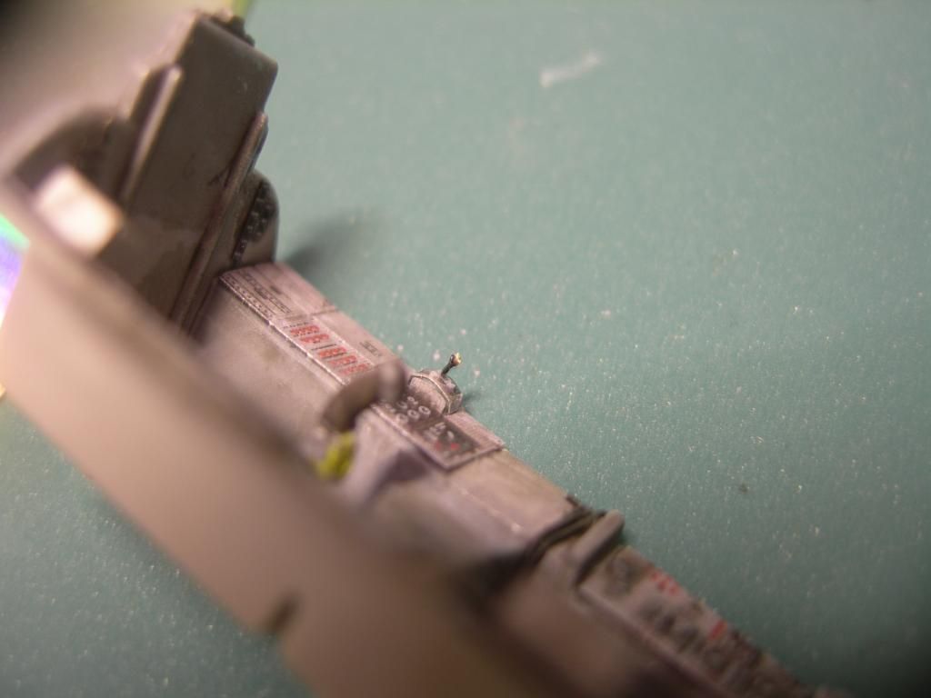

The cockpit weathered up. Gave the cockpit and the seats a bit of citadels "Nuln oil" wash.
These little levers were a pain to attach and get right. A total of 4 of them. To be honest, there was 4 more, but I skipped them :?
The cockpit in pieces.

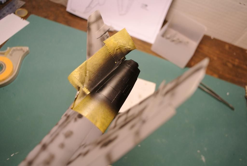

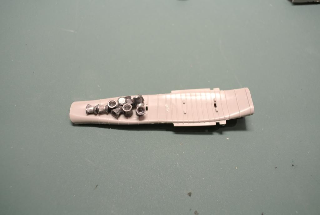

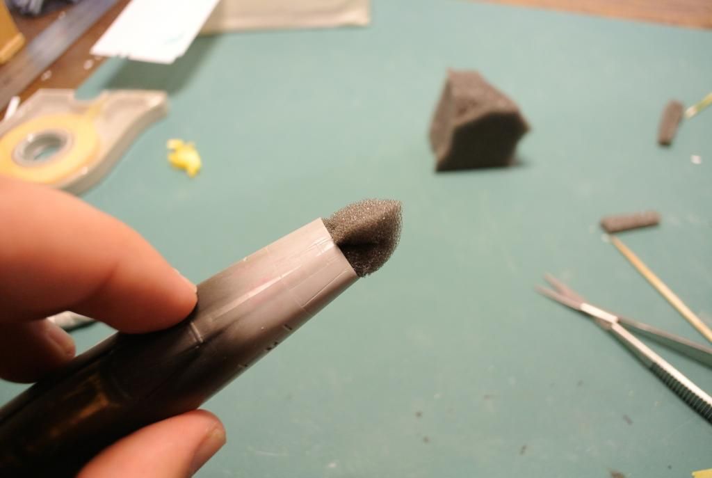

With an open-nose aircraft, nose weight is a bit tricky to place. Here, I have placed it upon the intake ahead of the cockpit wich mounts on the intake.

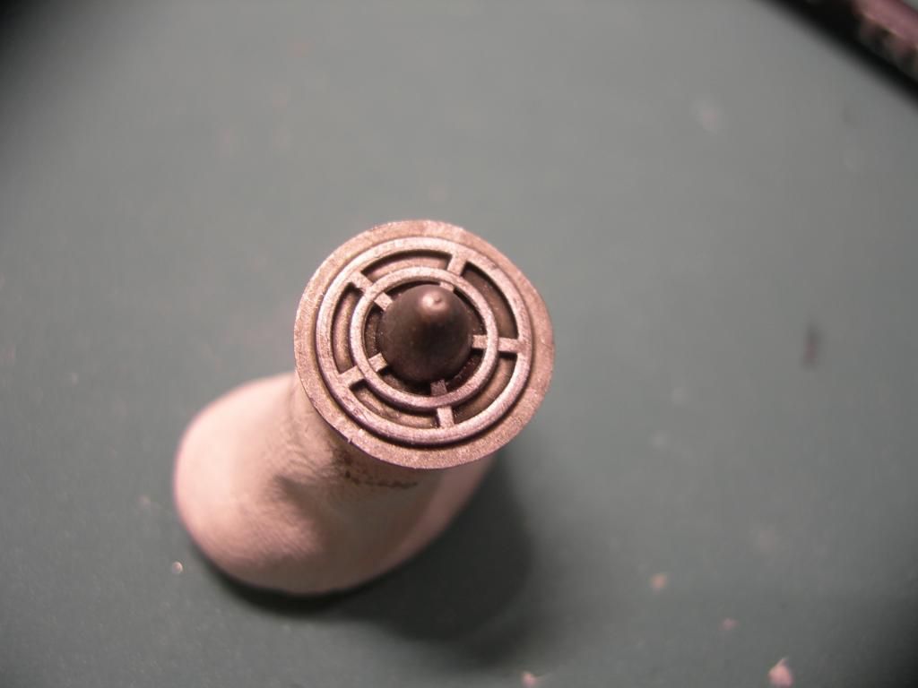

Finally, this is the type of paint i will use for the exhaust area of this aircraft. Its Mr Hobby Mr Metal buffable. It was the first time I used it and it sprays like a dream, even from a newbie like me. This is over a white surface, but it really needs a black surface to be really shiny. However you can see on this simple cup in the marked areas, how good it will look. Notice the white area at the top, thats how the cup looked from the beginning.

Started painting the engine
Glued the cockpit onto the intakes
Thats all for tonight. Also did some minor cleaning up on the air-brakes and fusilage. Until next time, :cheers2:
Ludvig :cheers2:

First some eye candy of the actual subject, feast my friends!
Tonights work was not very substantial either. Still, I figure the build is coming along nicely and the holiest of moments to an aircraft modeler has now been completed.

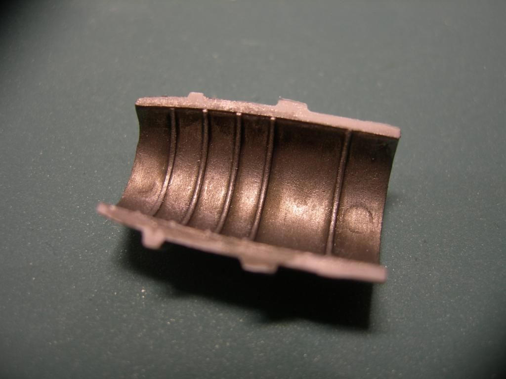

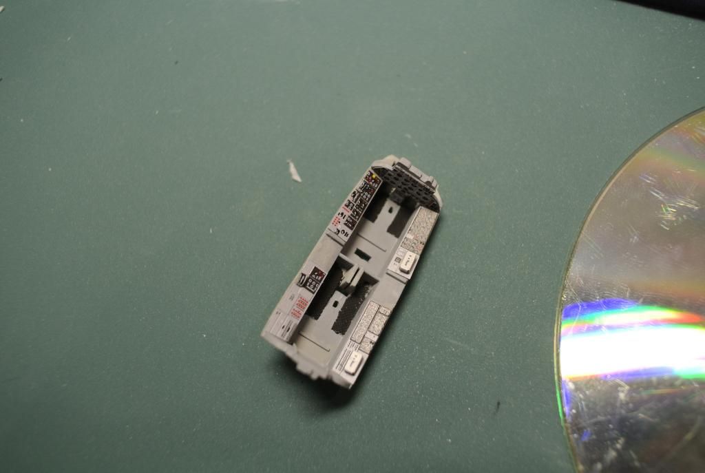

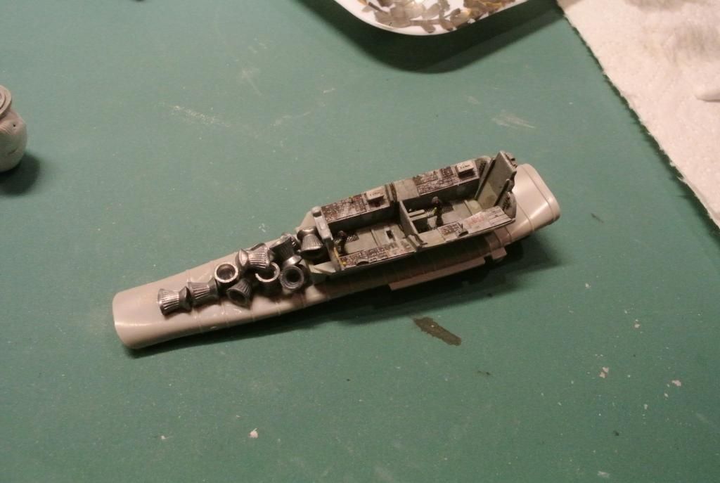

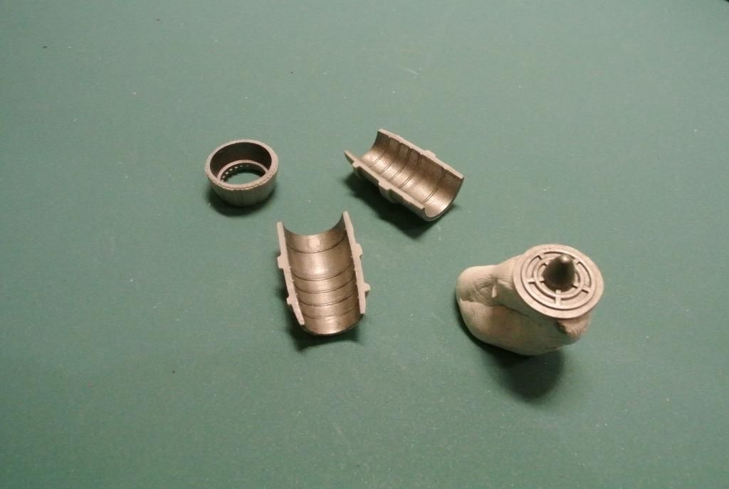

Before I joined the fuselage halves together, the engine had to be finished. Used citadels "Nuln oil" wash and drybrushed with citadels "Necron" dry compound.
The fit of the fuselage left me wishing more of Trumpeter. The fit is not appalling but there are still gaps and I will have to do some rescribing at some sensitive places. I will post more pics of this when the fuselage is dried up.
Weird "seam" on the side of the fuselage. Will be an easy sanding job.

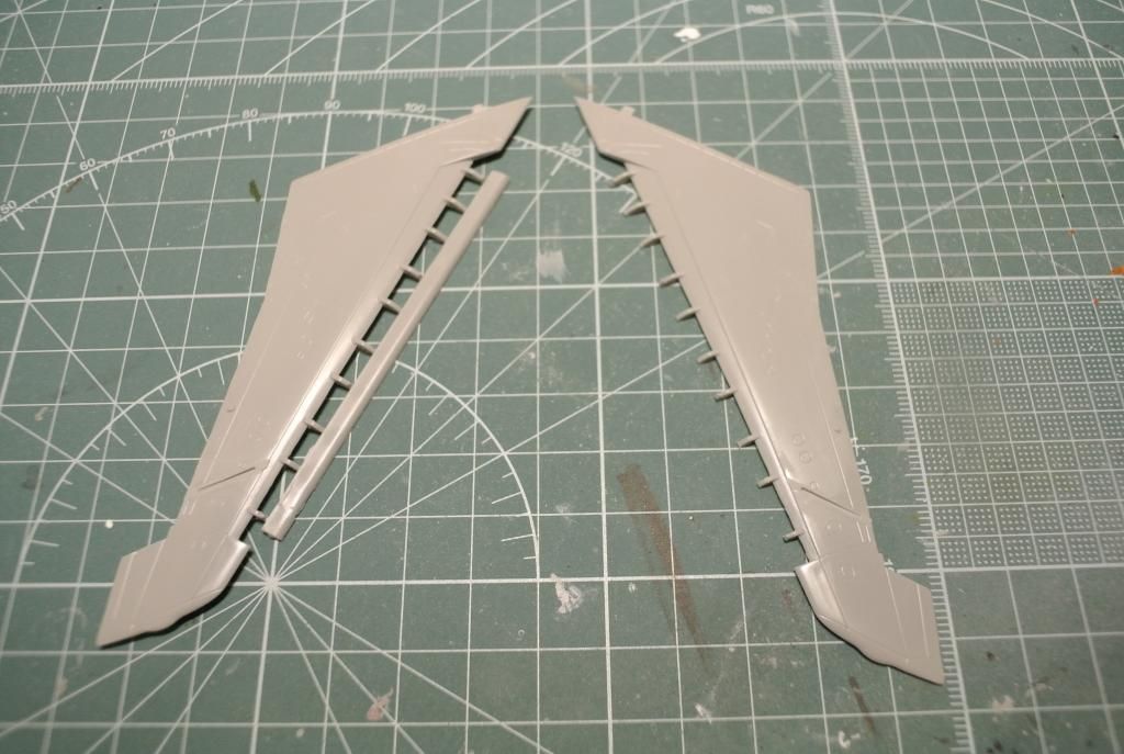

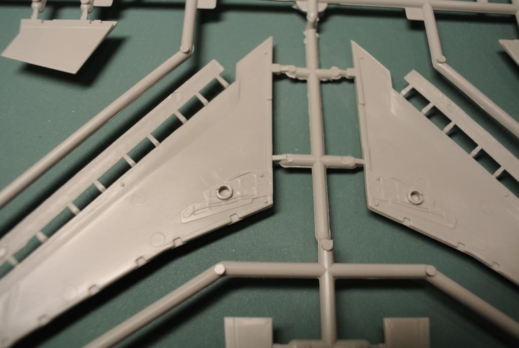

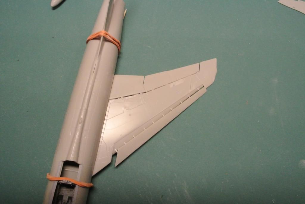

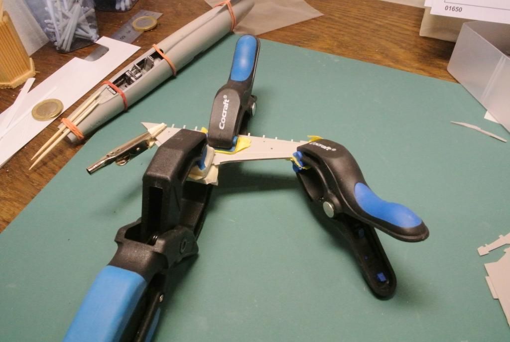

The wings consists of these three major parts. After the assembly, the 3-part flap system will be added and you can pretty much adjust them as you wish.
Dryfitting. This is how the wings will look when assembled. Looks pretty good for a 1/72 scale model!
Tricky clamping to get it right.

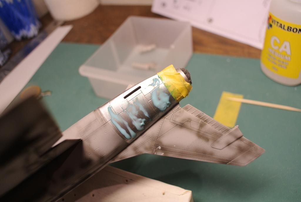

I need help with some painting ideas, and specifically painting the exhausts. Im watching several pictures, and the exhaust area looks a bit odd. It seems like the paint has been worn/burned off the engine area. Look for yourselves.
How would you go on and do this? My first thought is to do the metallizer first, seal it down. Then when Im doing the camo, I mask upp the end of the engine and free hand the rest of the engine area with very thin paint, only partially covering up the metal. What would you do? Im planning on using an airbrush. Thanks!

Twokidsnosleep wrote:She is coming along nicely, great pics too of the real deal.
I want to try out that Nuln oil technique. This is cool about the group build...... finding stuff others are using and doing
I haven't even got my kit yet for crying out loud :wall:
What are you building?
And yeah, the citadel wash is a great way if you just want a fast and easy way to darken something and give it some depth. Recommended! Its Gamesworkshop own wash-series and the black one is called "nuln oil". I have a "earth" shade and a blue shade aswell.
Ludvig :cheers2:
Airfix 1/72 A-4 Skyhawk
Last one finished:
Bandai 1/72 A-Wing Gallery
Posts: 18121
Re: Trumpeter 1/72 F-100F Super Sabre "Wild Weasel"
I did read somewhere that the paint was burning and peeling away on the back of the camo Sabres
You are on to a good idea to do a metal base, paint over and then strip some back to expose metal
See if they just let the cool bright aluminum ones fly, the painting would be easier.....they would have glinted in the sun and got blown away faster

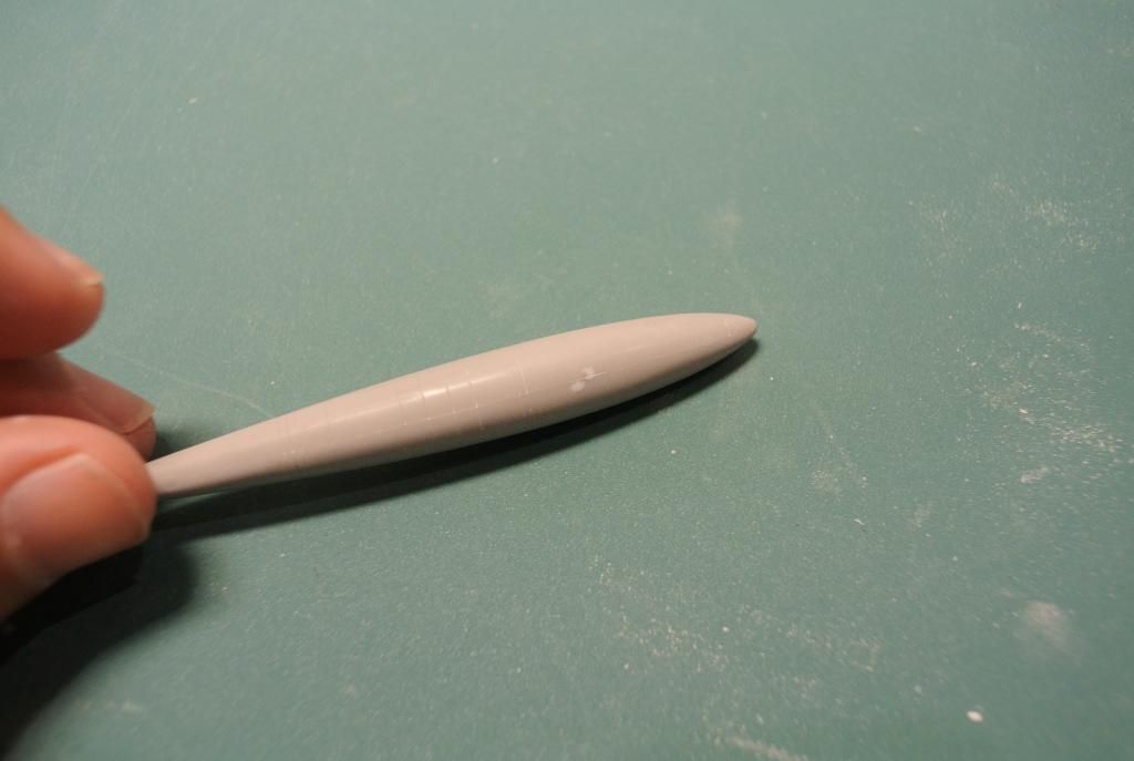

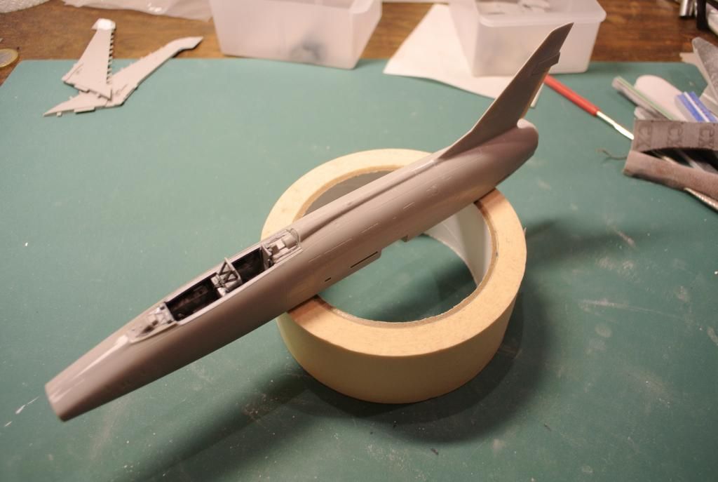

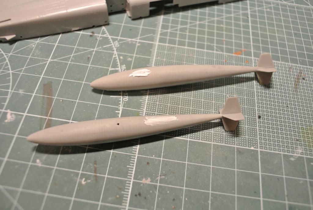

Its difficult to get these kind of intakes to be smooth and seamless since the joint will be difficult to get at with a sander at this scale. Im pleased with it, and you wont really see this much when its in normal lighting.
Attached the consoles behind and ahead of the cockpit.
The filler might look more dramatic than it actually is, but Perfect Plastic Putty often shrinks alot so I applied more than enough
Filled and sanded

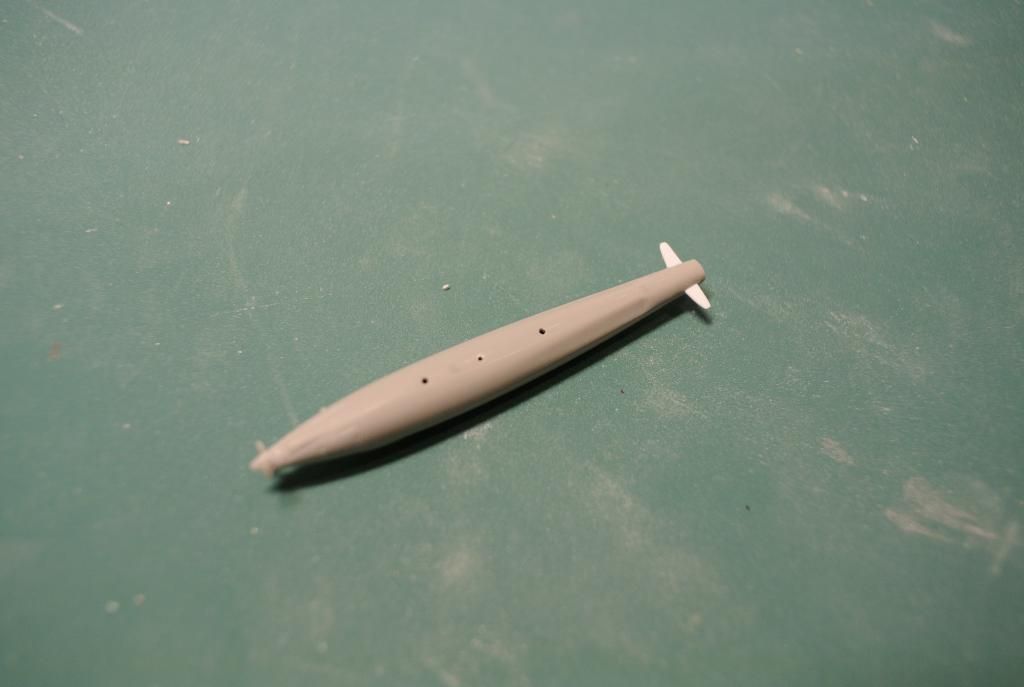

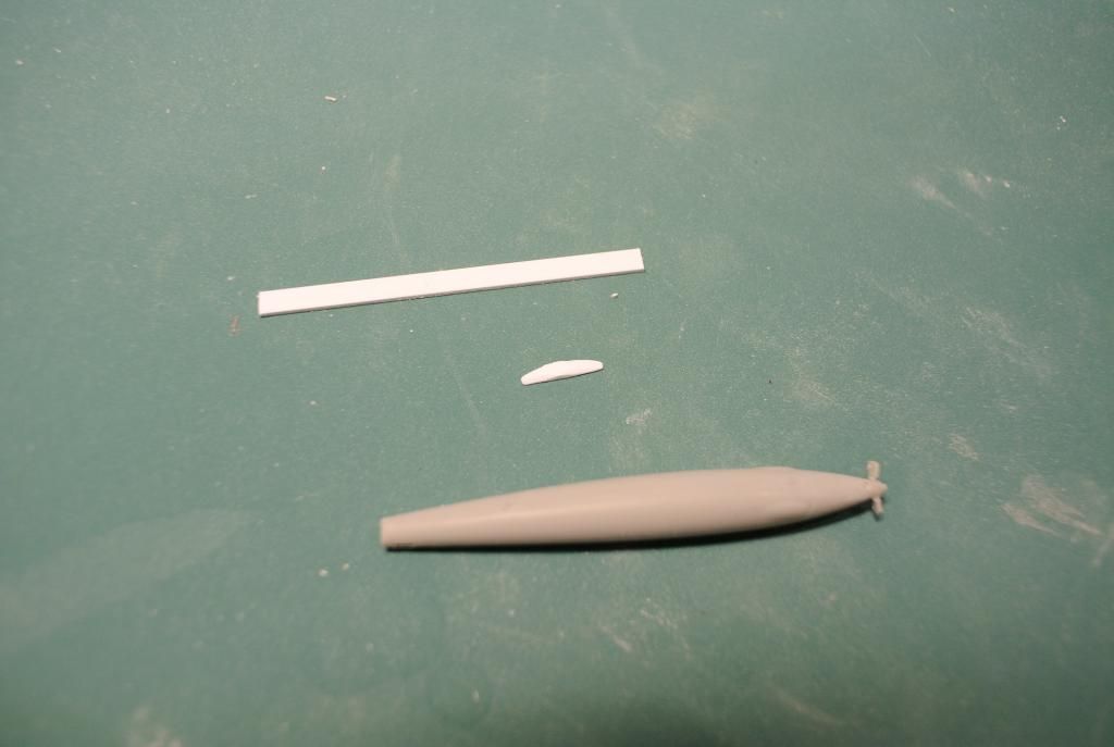

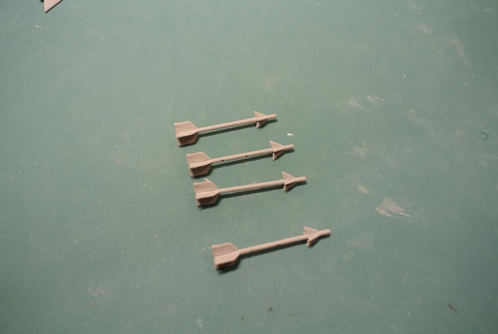

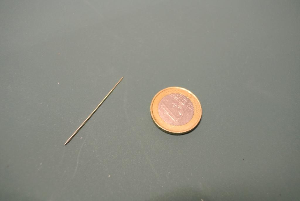

I lost the winglets of the ALQ-ordnance so I had to build new ones from scratch.
Also cleaned up the fuel tanks, got them reasonably seamless.

Have done some minor work since the last update. First, I attached the canopy, the front part with UV-glue and the major part with Krystal Klear glue. The reason for this was that Im planning on removing the canopy when the model is painted and display the canopy open.
I have cleaned all the parts that goes on the fuselage that has the "interior green" color like landing bay doors, air brages etc. For this I used Tamiyas "Flat green". This is also the first time I used an airbrush for actual painting. Im using a Harder&Steenbeck Ultra with the infinity tip and various other addons. I also managed to get a hold of an inline moisture trap that attaches to the quick-release. This has really been useful since I had alot of condensation in the hose, causing splattering in the paint work. This is now solved and the Tamiya sprays really nice. Here is the result of this first painting session.
Next up is the masking of these areas and attaching the wings. Then, its set for priming after I paint the intakes.

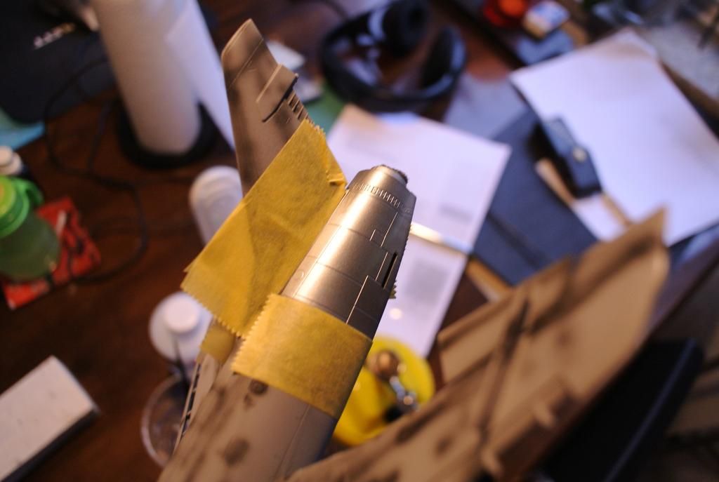

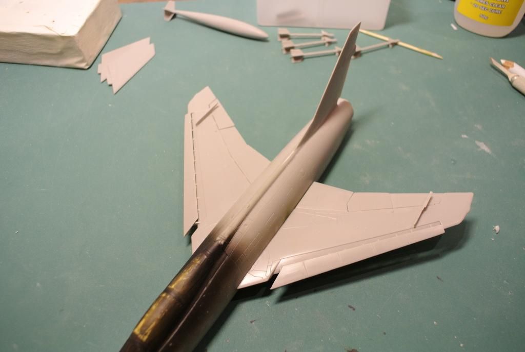

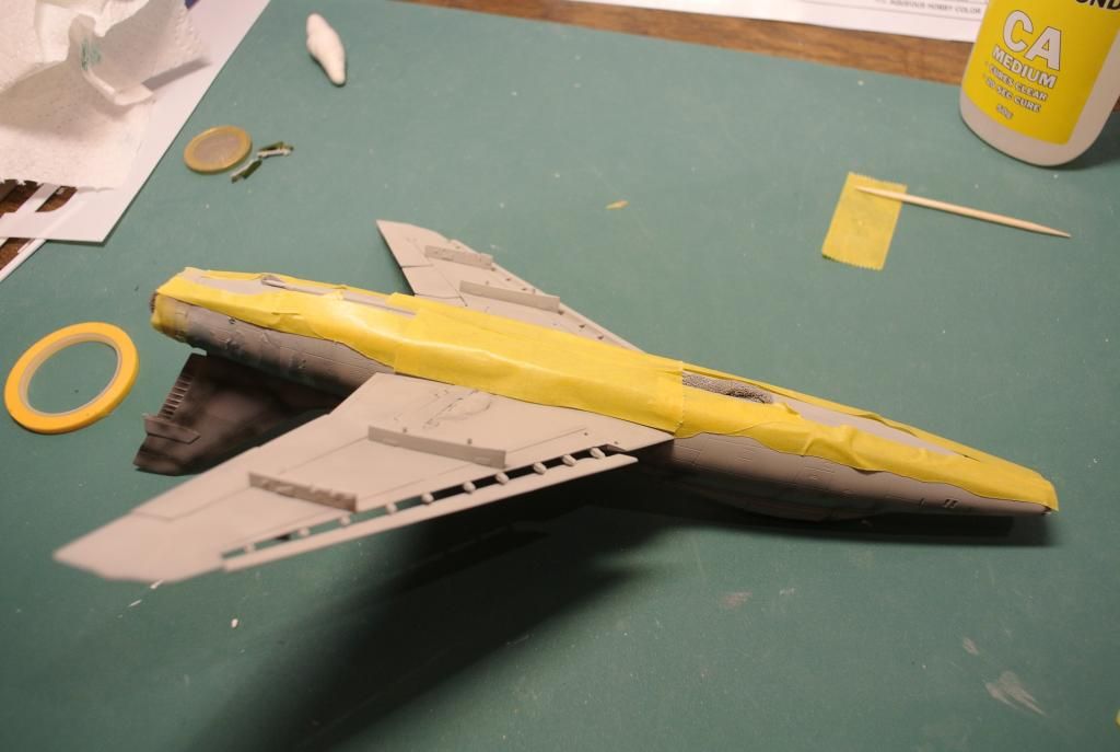

The working process has slowed down a bit due to studies. Anyway, I have attached the wings, and more!
The wings glued on
The fit of the wings was not the best I seen, but not the worst either. I used my favourite filler for the job. There wasnt any bigger gaps, but nevertheless they needed attention.
Cleaning up using a damp cotton bud makes the joint really clean.
Started to mask the inner parts of the aircraft using foam.
The fit of different hatches was ok. Used white tack for the whel bays in the wings.
Masking up the paintjob in the nose using foam.
Fit of the rear fins were snap-on, the front fins were really bad to fit. Think it turned out ok.
The wing construction is now complete. The flaps are not glued on, just dry fitted. Will prime and paint it, then glue it on afterwards since I havent figured out how to position them.

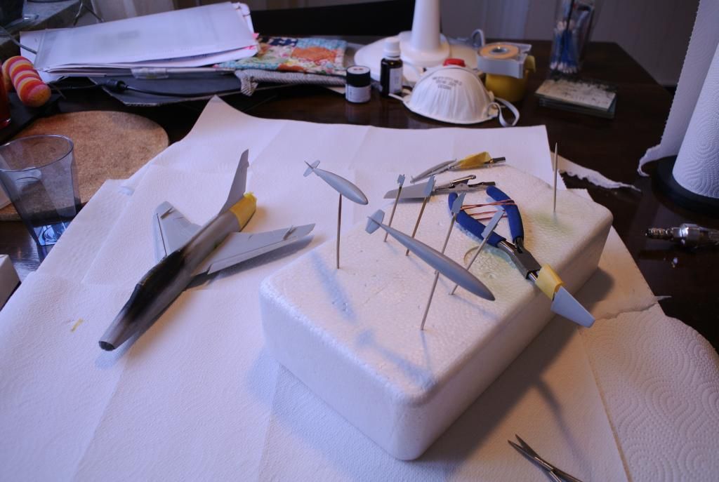

PYLONS
And when to attach them
I havent figured out how to do with these pylons. Do you paint them before you attach them, do you paint and attach them before you attach the ordnance? Please tell me how you do it! :)
I decided to attach the more shallow pylons for the main fuel tanks.
Think im gonna prime the model on thursday. Until next time, :cheers2:

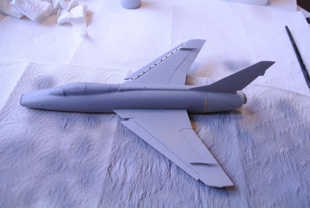

Got a bit of work done on thursday and here are the result of my endeavours. First, I prime the plane plus a load of other items, such as ordnances. Then I masked up the tail of the plane and sprayed it with Tamiya X-1 to make a glossy base for the metalizer im planning. Of course, lets not forget the preshading of panel lines. Oh my god, the result is pretty horrible, but its my first time so i think im excused. Precision work to preshade on a 1/72 :wall:

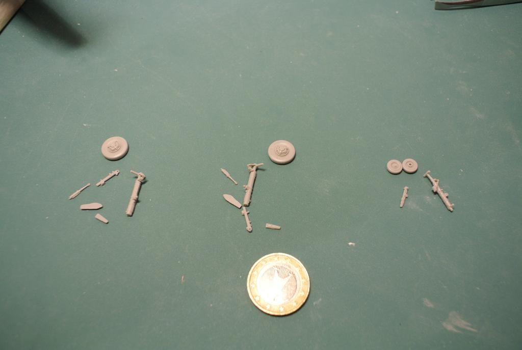

Then I started on the landing gears, which proved to be a bit more complicated than im used to with 1/72nd aircraft. The mould is actually quite crisp and good, but they all have giant seam lines, and on these small parts, its very annoying to clean up. The moulded parts come with good detail, including some moulded wiring. The real deal has more wires, so I added some simple lead wiring, love that stuff, just make sure you wash your hands after using them.
Lots of parts for the gear.
Simple way to make it look more interesting. Its not 100% accurate, but it looks more like the real deal than it would without the added detail.
Ready for priming.

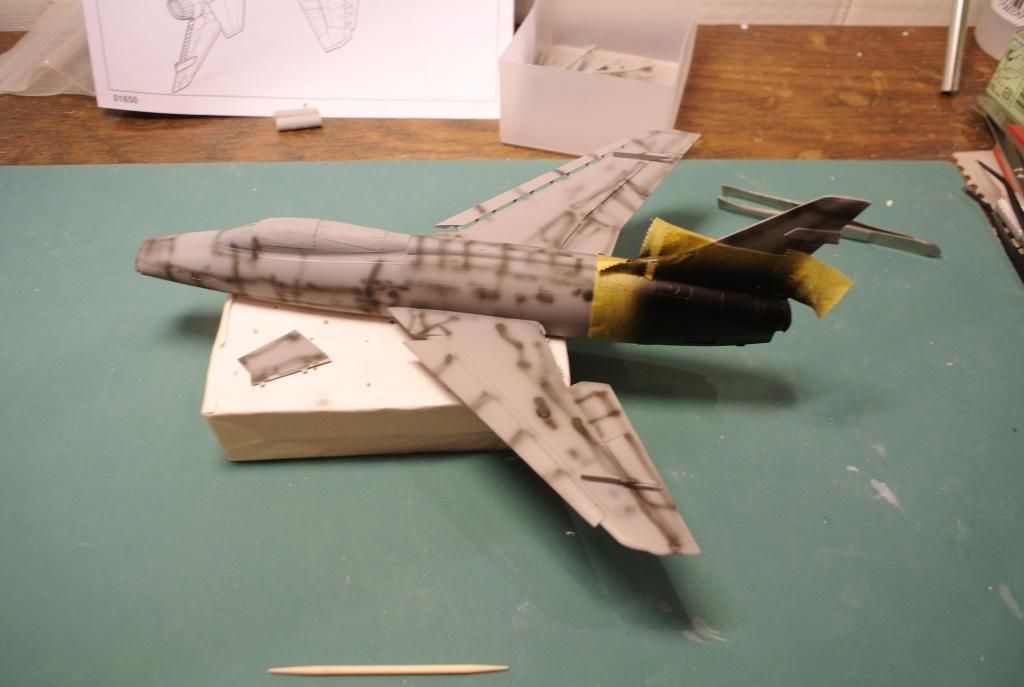

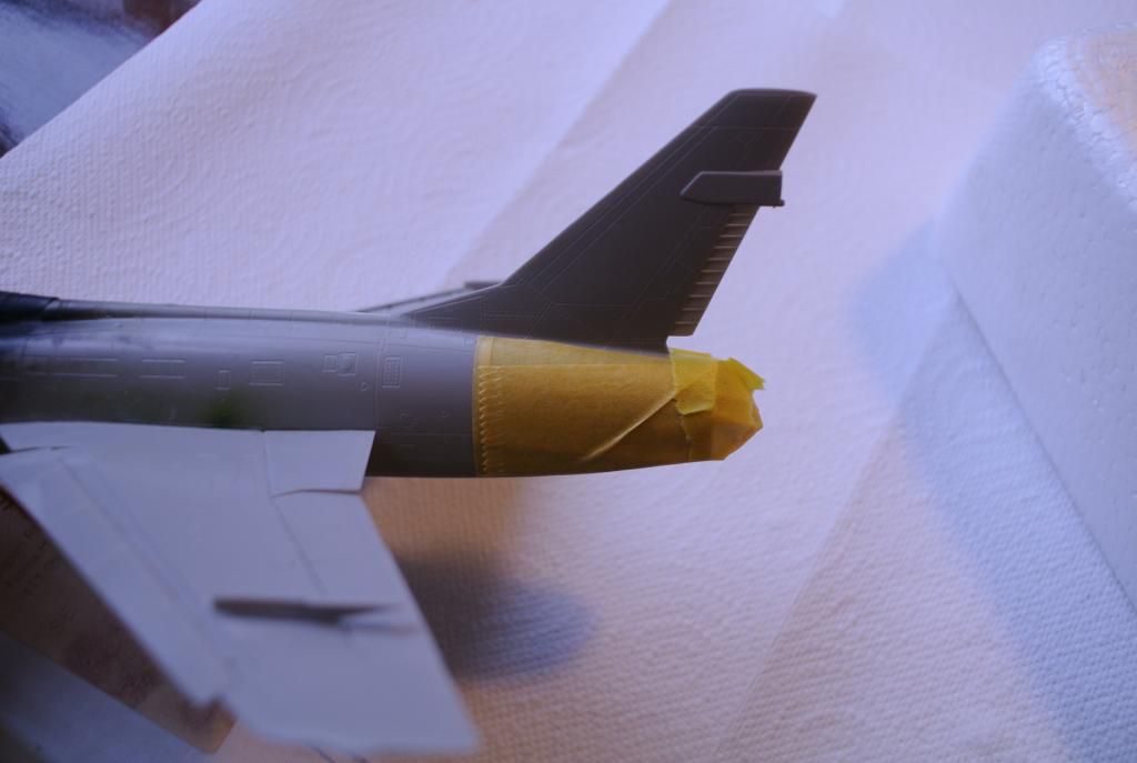

Masked up the tail area, based this area with glossy black instead of the grey one.
Used AK interactive grey primer. Great stuff!

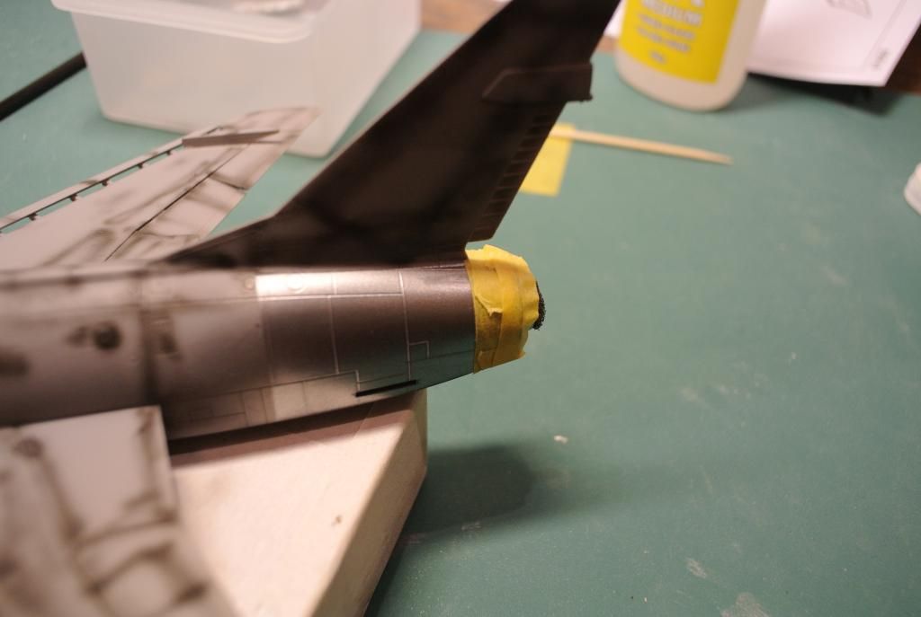

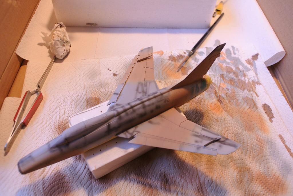

Masked up after preshading. Please ignore the horrible pre-shading, was really hard and I think I had too high air pressure.
The surface is not 100% smooth gloss, but it will do. Probably spray it with Mr Metal chrome. Again, ignore the preshading :wall:
Learned alot today. Especially not to have too high air pressure when doing precision work and glossy paint. Thanks for lookin, until next time :cheers2:

Coming along nicely. Don't worry too much about the pre shading, you don't want it to be exactly uniform all over.

At the moment Im waiting for an opportunity to paint the exhaust area with the Mr Metal chrome. I have to wait til I get a clear house as it smells alot and I dont want my baby to breathe the fumes. :hand: Meanwhile im doing the rest of the landing gears, loving the airbrush this far, its so easy to get a nice thin and clean coat of big areas, like the fusilage!

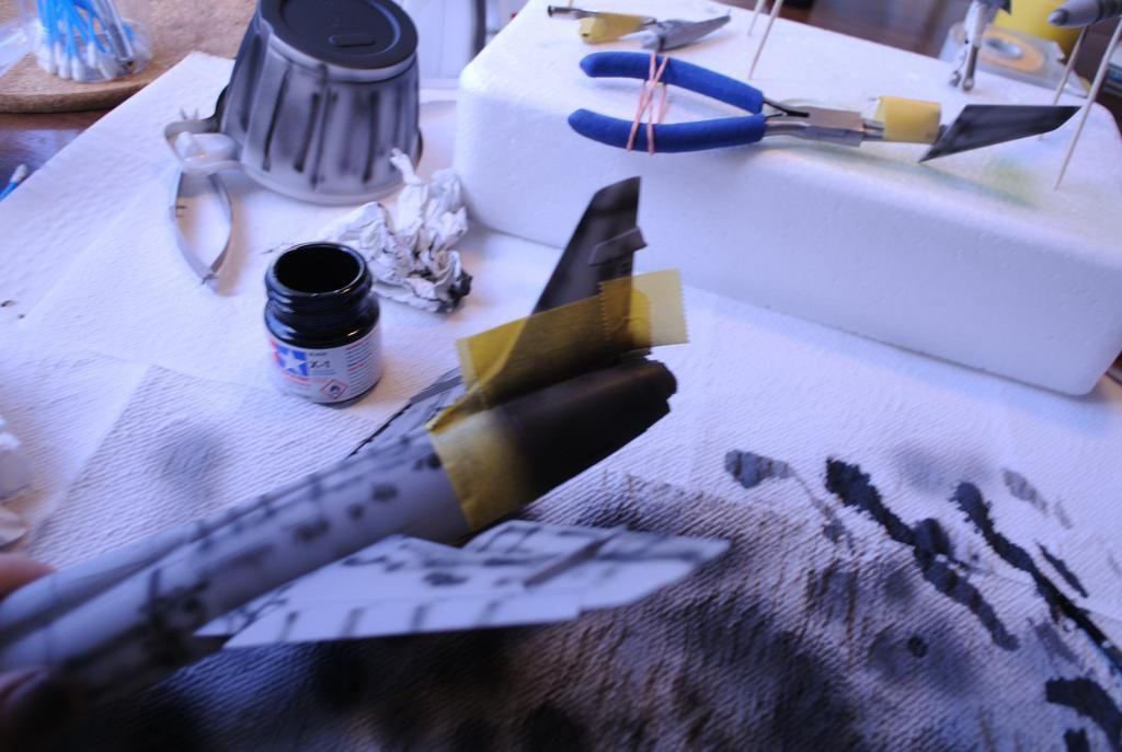

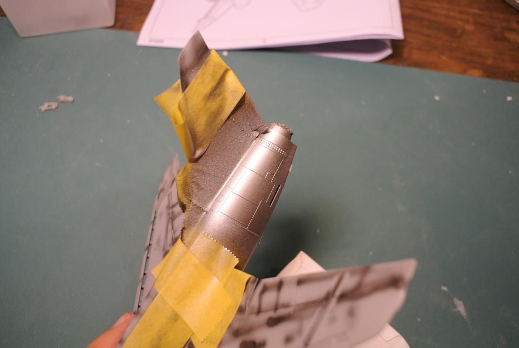

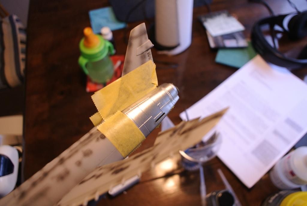

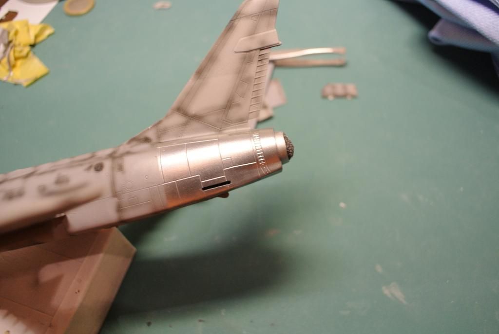

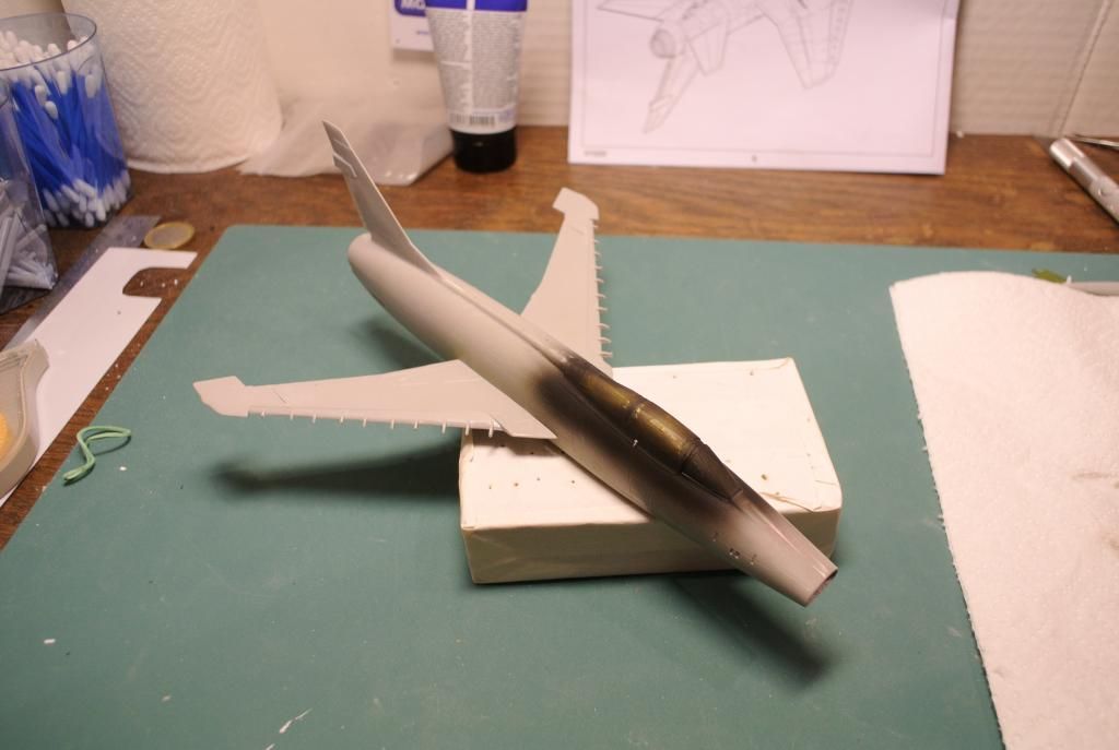

Got some work done on the Hun earlier this week, to be more specific, done the metal work on the exhaust. I used Mr Metal Buffable: Chrome Silver for the rear end of the fusilage, waiting with the exhaust til I get a handle on what color to use.
First, I had the end sprayed glossy black (Tamiya X-1).
Sprayed.
Here it is, buffed up
Then it was time to mask up again
Sprayed it with this sealer. Its supposed seal down the metal without dulling it, like you get with other varnishes. When you spray it, the metal goes dull, but the shine comes back after a couple of minutes.
Heres how it looks now, sealed and ready to be masked
Will be starting with the real paint work next week, til then Ill have to mask up the parts that I dont want sprayed using liquid mask to get a peel off effect. Stay tuned! Until next time,
cheers
Ludvig :cheers2:

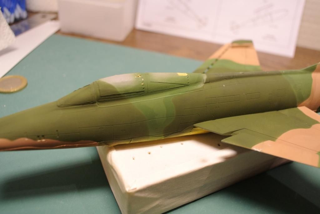

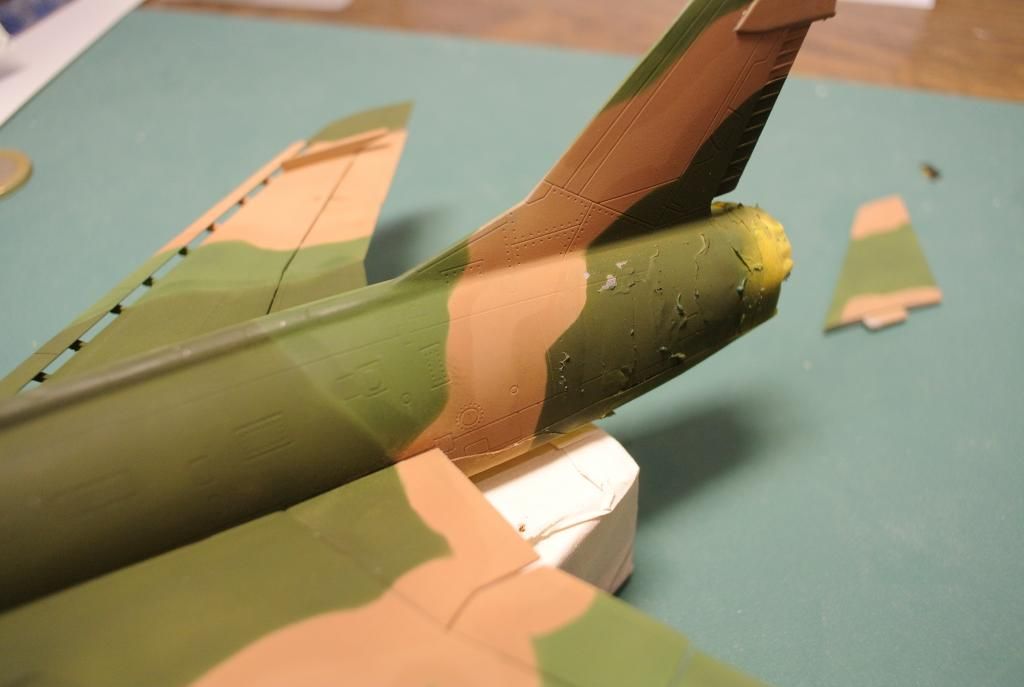

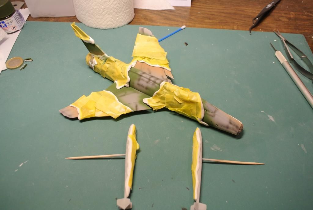

So ive spent alot of time today doing alot of spraying. This was my first real paint job done by airbrush, its also the first time doing a camo like this. On top of that, I also tried freehand camo for the first time with an airbrush, so alot of firsts today!
First I started with masking the engine
Ready for painting!
Started with the underside of the aircraft, here it is painted gray.

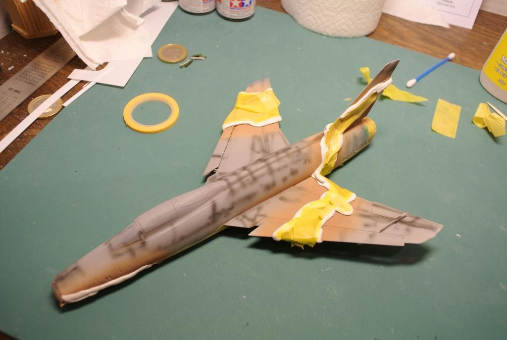

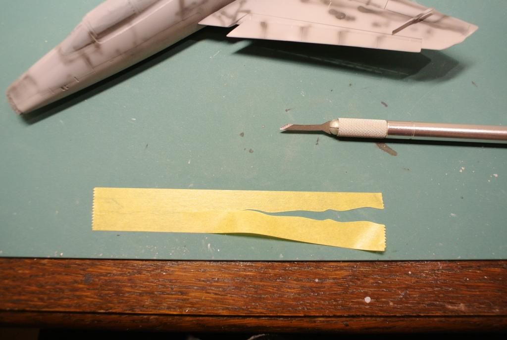

I waited an hour and left the model to dry. I then masked the gray areas up using simple tamiya masking tape.
Here is the first layer, the tan/earth color. Its my own mix with tamiya paints from different references that I could find. The brown color varies greatly from source to source, so i just went for one that I thought looked good.
I then waited 2 hours and masked up the brown areas using generic white tack and masking tape.
Second color down. Dont mind the Whale Shark in the background, hes my test subject for practicing airbrushing. :)
Waited another 2 hours and masked up the final time
Final layer painted
Even tried out some free hand camo since I forgot to mask it up and I was lazy ;)
I then waited another hour and was super excited to peel off all the masking and see the result of my painting...
Disaster!!!
The white tack has discolored the surface at some of the masked areas. Im really baffled by this set back. What did I do wrong? The first thing that I can think of is that I didnt wait enough before I masked it up. Then again, some areas did not become screwed up. Any tips why this happened?
Any tips why this happened? And I could really use some pointers on how to tackle this. Redo the entire process? Strip down all the paint or just paint over? Im not skilled enough to freehand the camo... Gah, a whole days work all for nothing!!!

Posts: 18121
I had to re-read what your disaster was a couple times. likely oils from the white tac. I think it looks kind of cool
Don't strip it all off. IMHO, I would test repair an inconspicuous area....gently wash a wing area of discoloration to remove the tac/ residue and freehand in some green to make it all uniform. If it works there then you are set to fix other more visible spots.
I hope other chime in with better solutions, just telling you what I would try
Good luck

Twokidsnosleep wrote:I had to re-read what your disaster was a couple times. likely oils from the white tac. I think it looks kind of cool
Good luck
Do you think its possible to remove the residue? What would one use exactly without ruining the paintwork?
