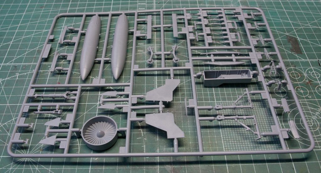

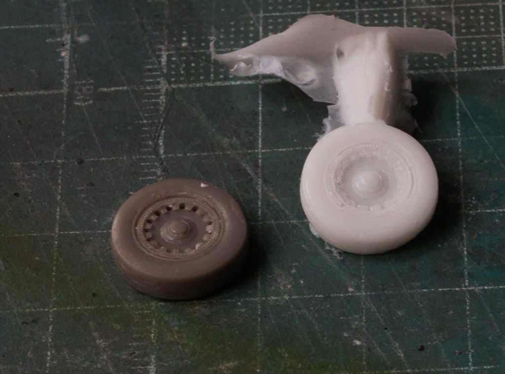

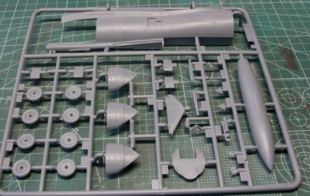

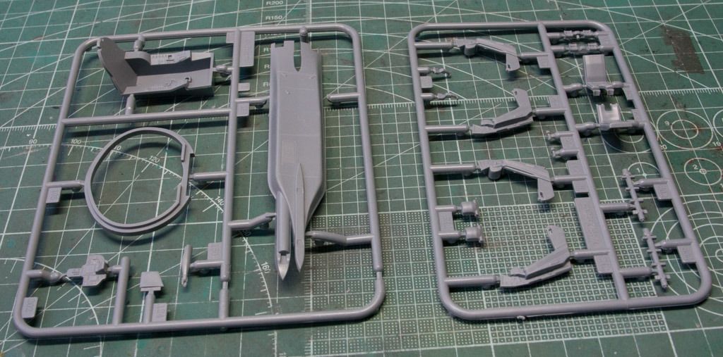

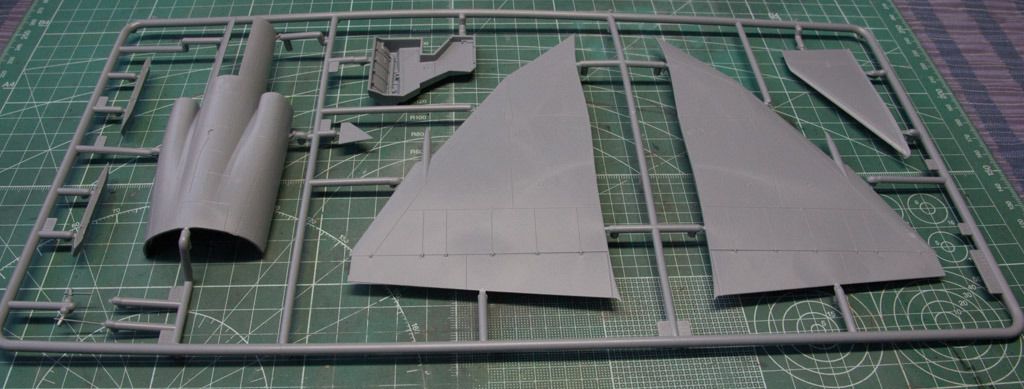

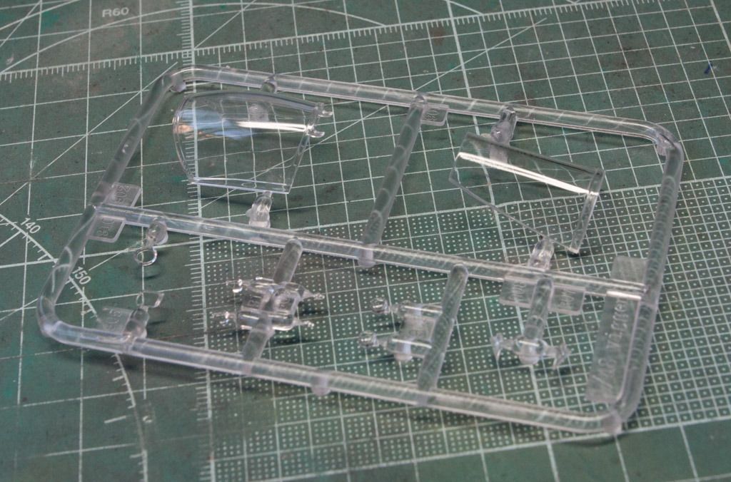

Finally time that I can get started on this! The plan is to do a pretty detailed version of the Viggen using a bit of aftermarket, painted in the splinter camo.
Sadly Tarangus idea of putting all sprues in one bag is not the best and one part was broken.

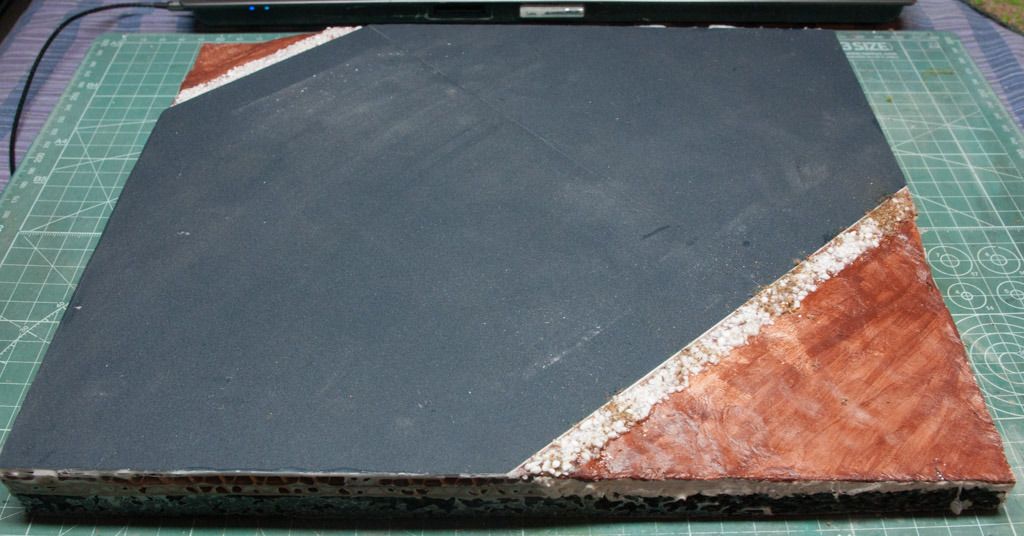

I'm planning to a small base for the plane, was thinking about something like a mix of these two.

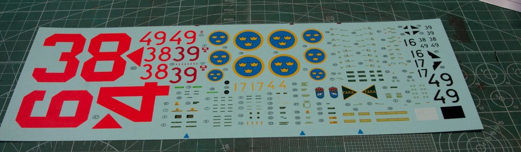

The kit decals for the splinter camo version is from the F4 unit in Frösön in northern Sweden, specifically F4-38 or serial number 37378. During the last years of its service it flew with a NMF tail, this is how I'm going to paint it.

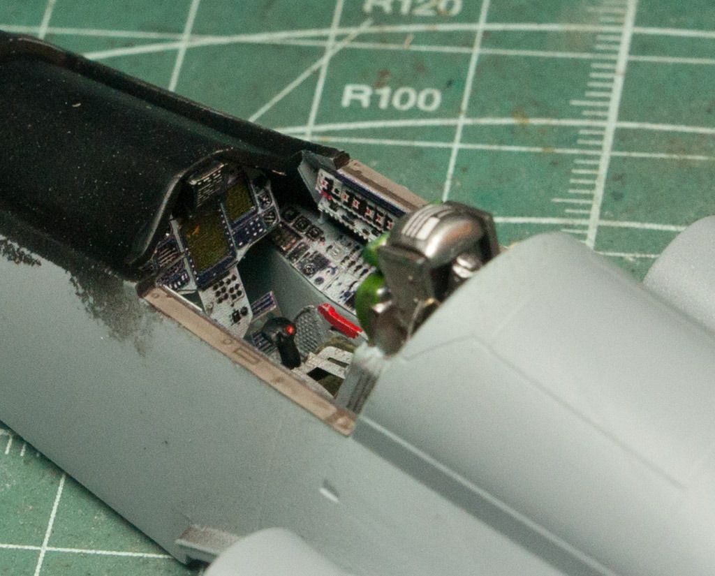

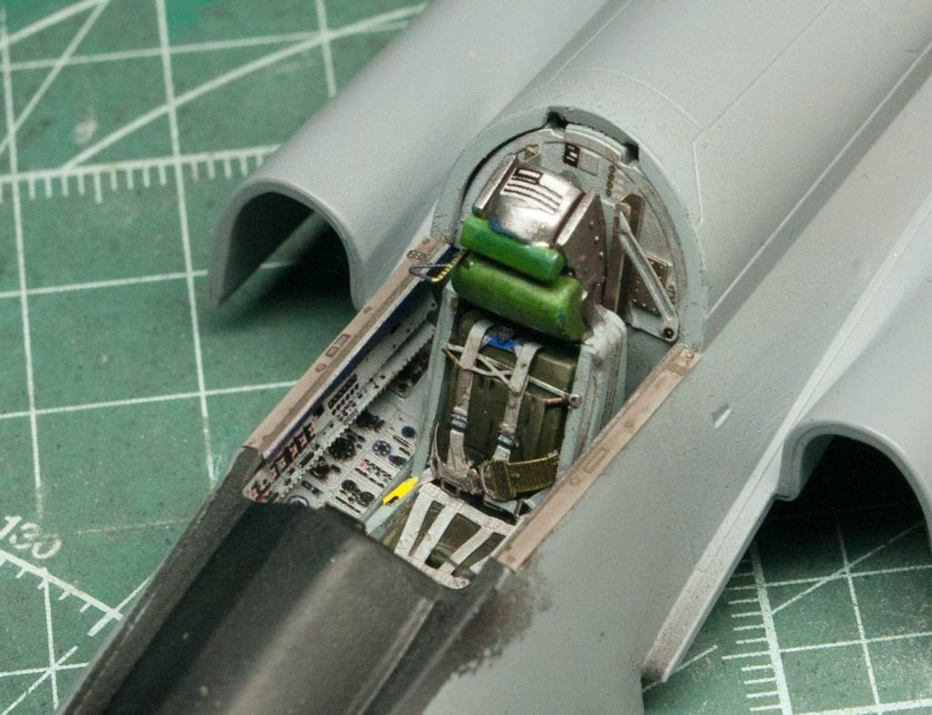

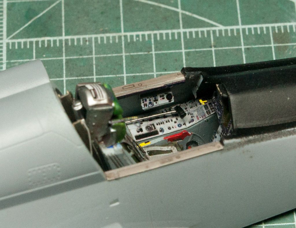

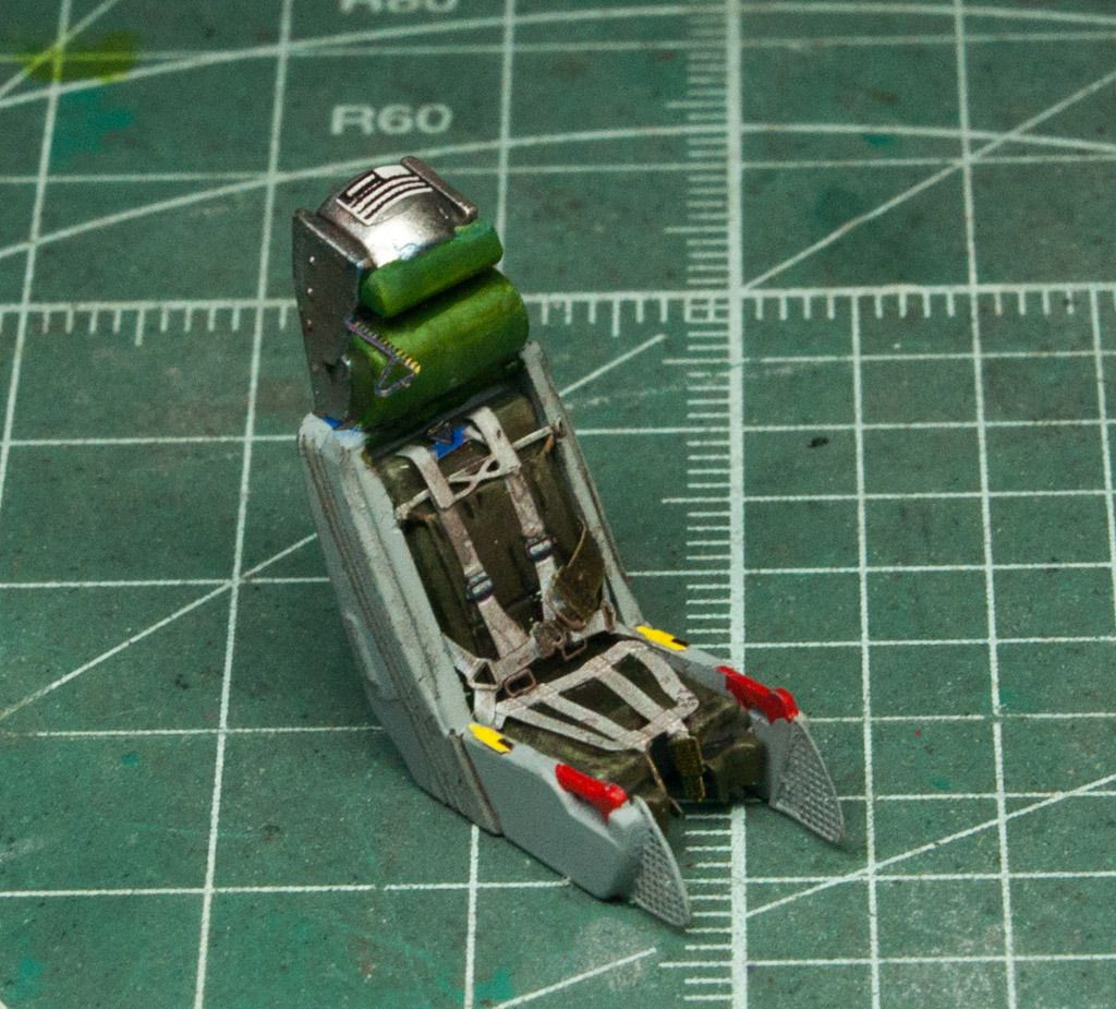

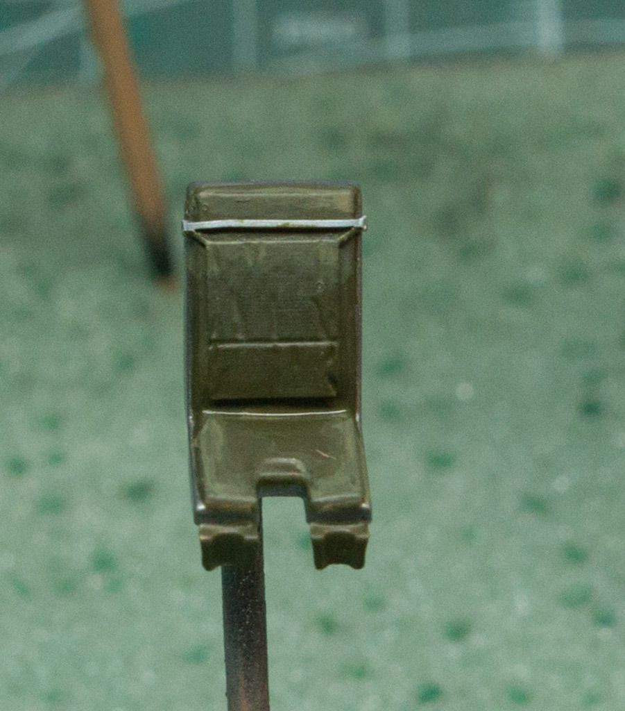

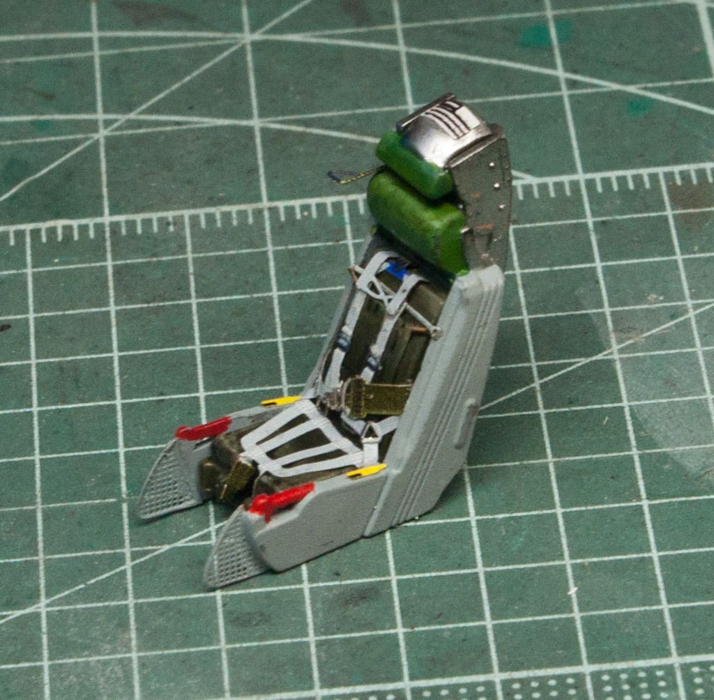

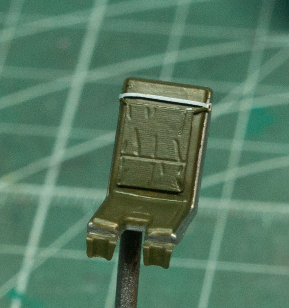

Started by removing the molded in details on the seat and the cockpit that will be replaced with PE with a chisel.
Got the seat assembled and painted, used AK Xtreme metal Aluminium and the cockpit color for the seat. The head rest was given the same modulation as the cushion but using a lighter green as the base. Then all the PE was applied.
To finish the seat I used some Ultimate Dark dirt wash and also used some 502 Faded navy blue oil paint as a filter on the head rest to add a blue hue to the green.

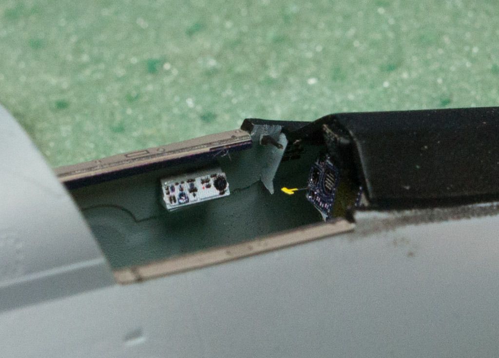

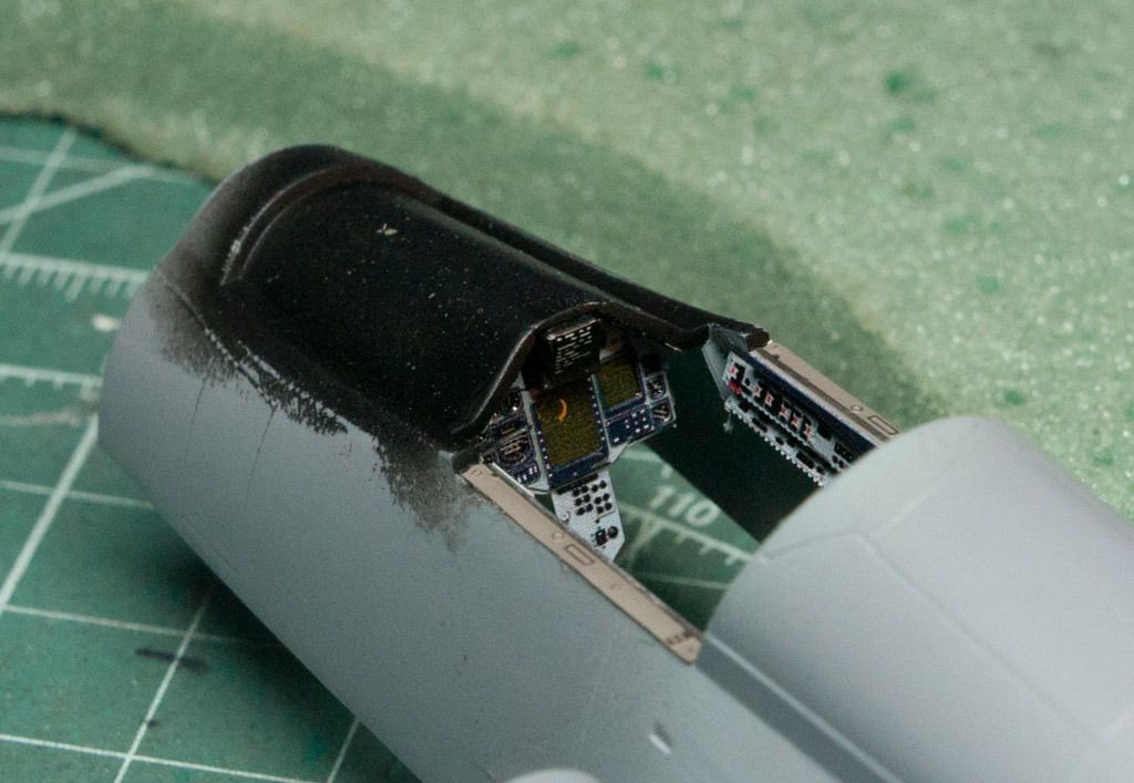

The cockpit done. In the instructions for the PE it looks like you'r not supposed to use kit part 208 (which in the kit instructions have the wrong orientation). But it should still be there if you look at this reference picture from the Tarangus web site http://www.tarangus.se/wp-content/uploa ... G_4135.jpg, and there is nothing in the picture looking like PE part #19. So I went with something more like the picture then the instructions. Also add the linkage using a acupuncture needle that is about 0.2-0.25 mm thick.
The PE instructions also tells you to glue PE part #23 directly to the side of the cockpit, however it is supposed to go on top of lit part #203 which can also be clearly seen in the reference picture.
And everything test fitted together.
After taking the picture I saw that the foot controls are way too close to the seat so I will need to move those a bit. There is also a control stick missing on the left side and the plastic part included is just way too big now that I re positioned part #208 so I'll need to make something smaller. I'm also thinking of adding a couple of wires to add a bit more detail.

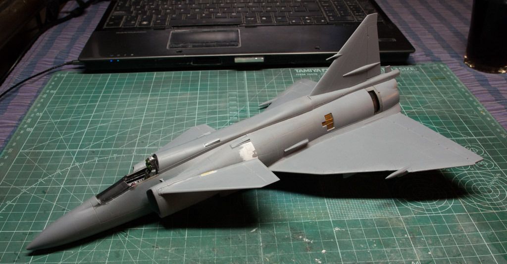

Have started joining the fuselage together and filling the seams with molten sprue.

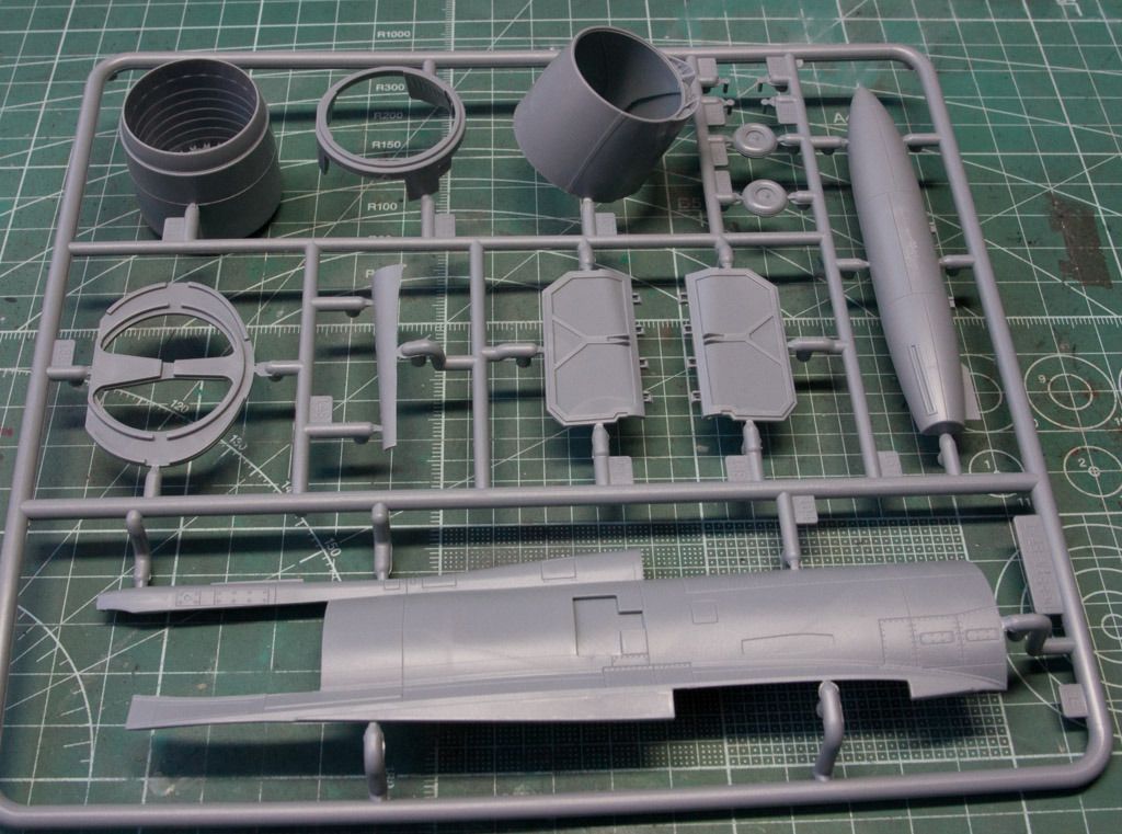

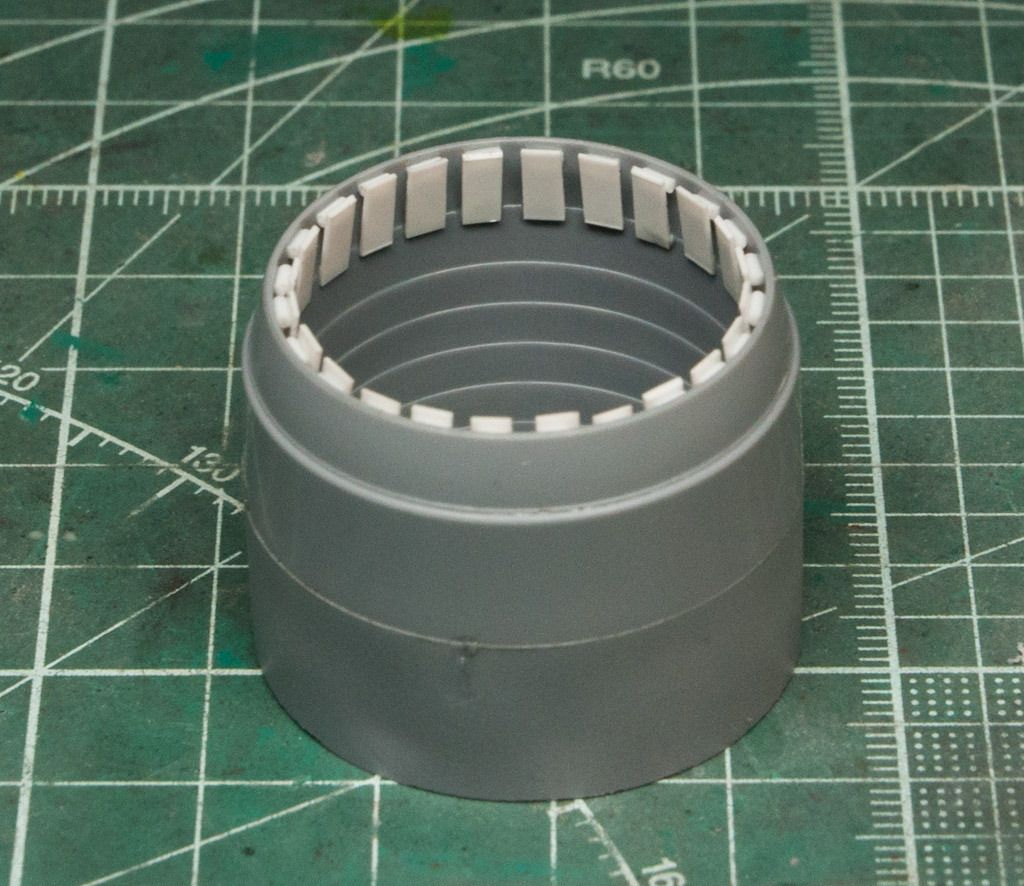

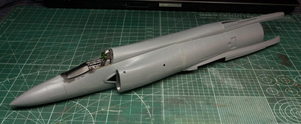

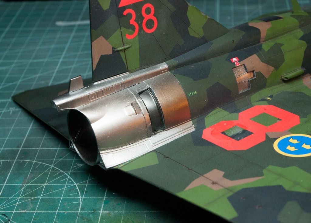

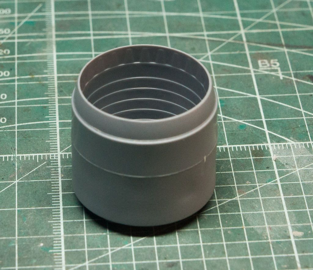

With the Navy SIG build done I can finally get back to this. The Fuselage has been sanded and is almost ready for rescribing, not sure but it feels like the fir of this was worse then the first one I build. Have also started work on the engine.
The kit part, nice detail in the bottom but a little bit soft at the edge.

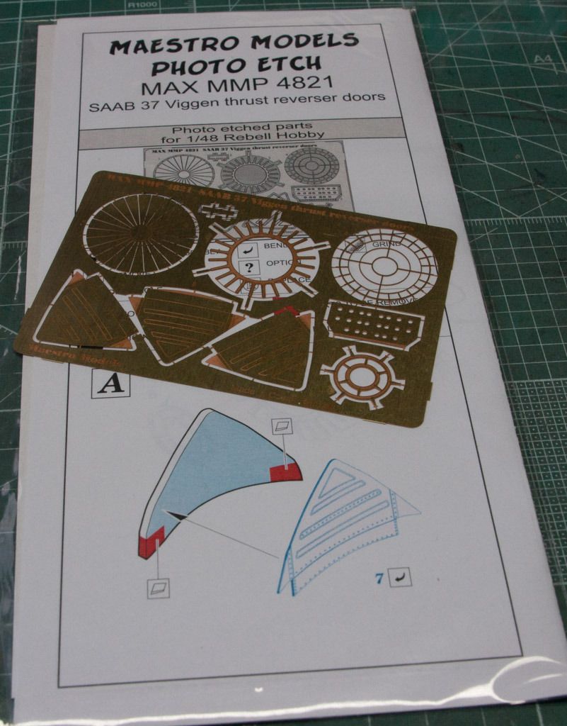

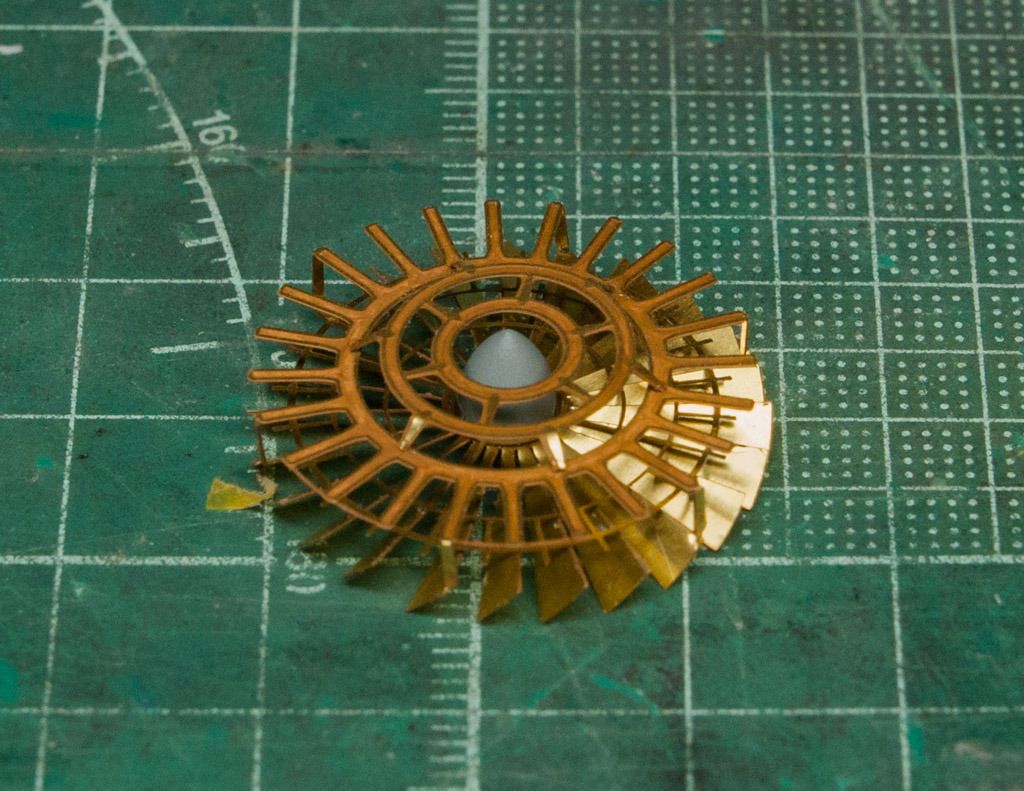

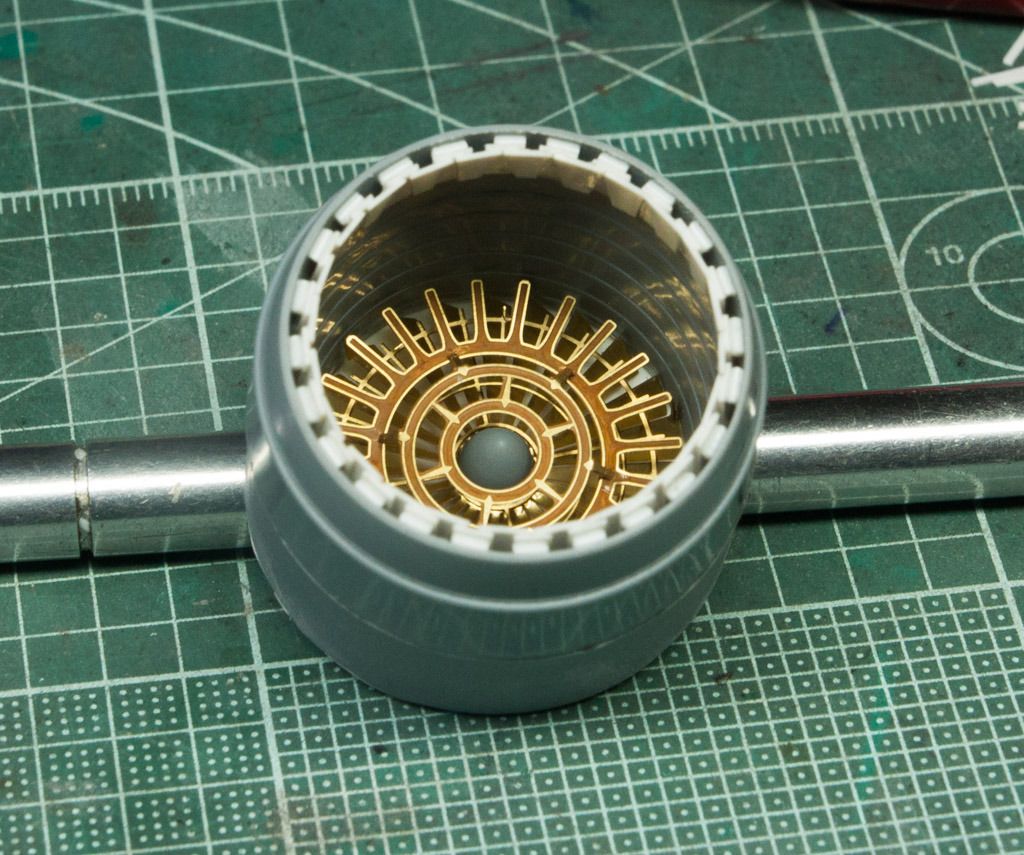

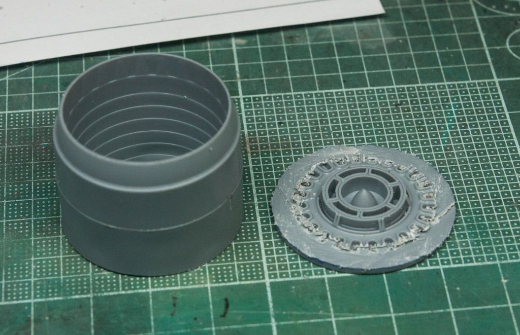

It's not completely clear in the instructions for the PE parts how they are supposed to go together. It looks like you'r supposed to just glue the PE parts on top on the plastic as it doesn't say to cut anywhere. But I decided to cut off the bottom of the engine.
Then cutting out the center cone.
Then bending and gluing together the four PE parts and using the plastic cone.

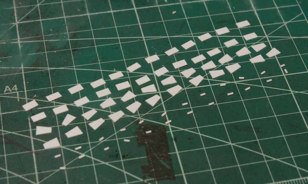

To add a bit more interest I started cutting a bunch of small parts of styreen sheet and rod.
And glued it to the engine. It might not be accurate but it adds more sharp edges that will hold a wash better then the kit part and will hopefully look more interesting.
Glued the PE parts and the shroud to a sheet of styreen to add a back so you can't see into the fuselage when it's all build.
All done, now it just needs some paint and weathering.

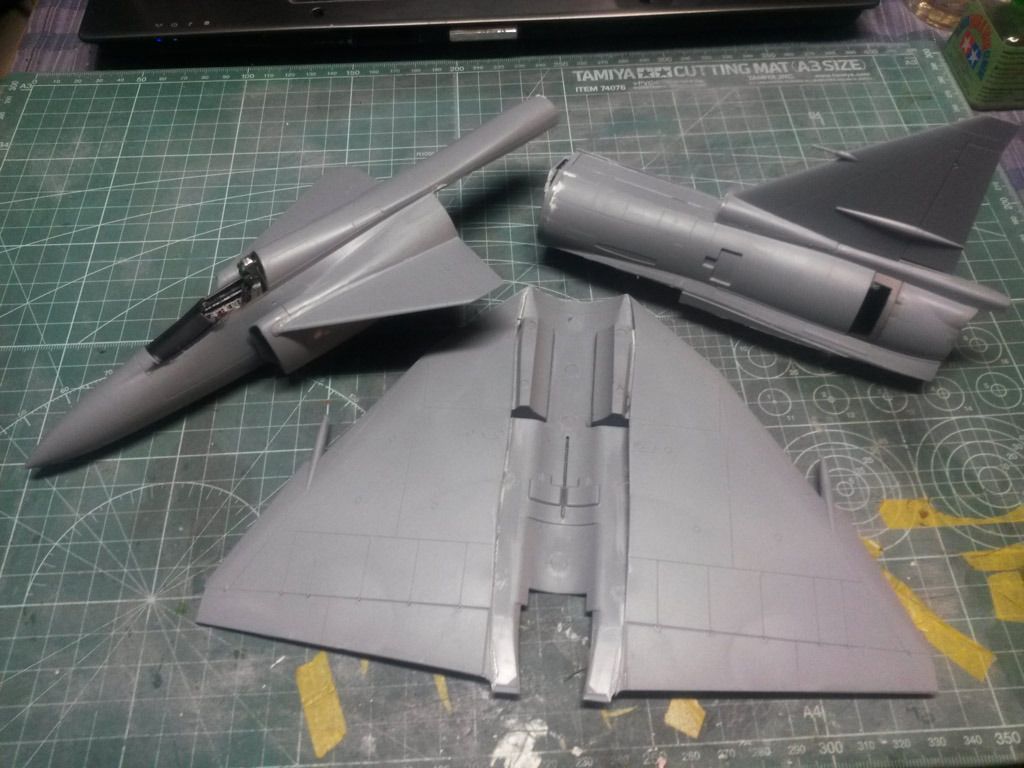

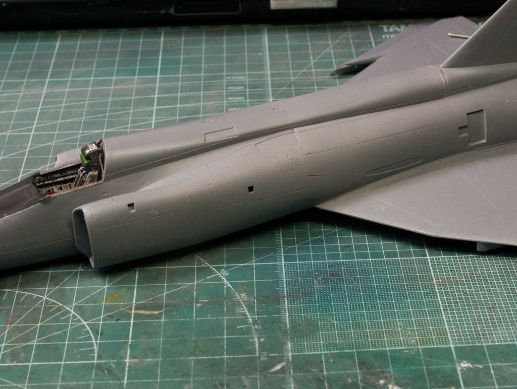

This thing is starting to fight me. I had the fuselage and wings glued, filled, sanded and rescribed, pretty much ready for primer. Looked at it from behind and saw that the main wings was right tip up. So I started to try to figure out where the problem was, and of course it was the fuselage that was twisted. So I had to tare it all apart again and will need to start over with a lot of sanding. Not sure why this happened as the first one I build didn't have this problem.

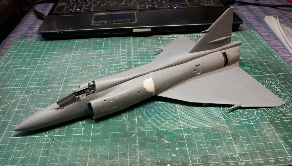

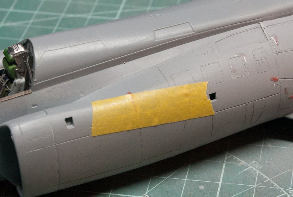

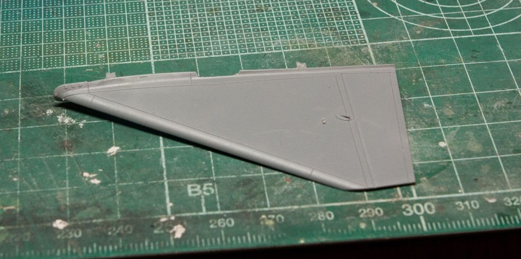

Things are finally back on track after the problem with the twisted fuselage. Got all the parts bend to shape reassembled, filled the seams and steps using Tamiya putty.

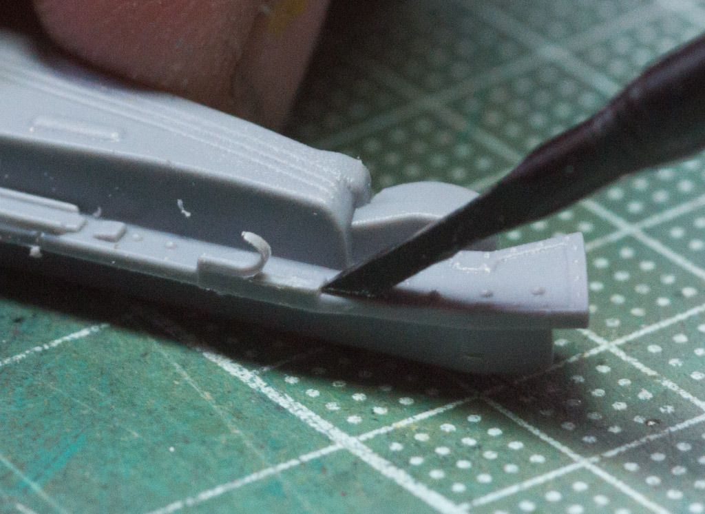

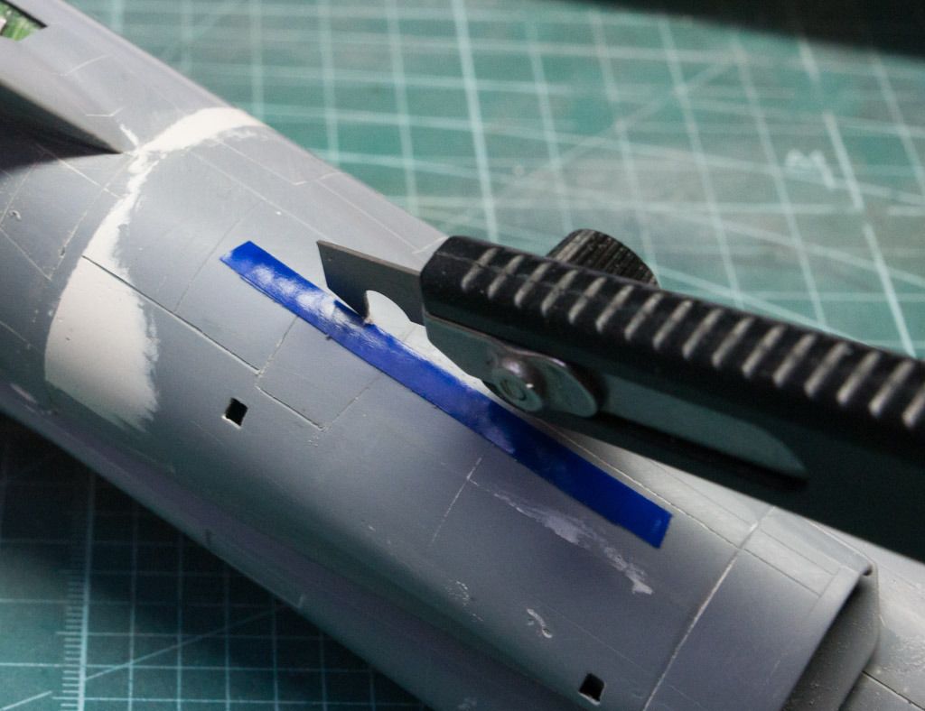

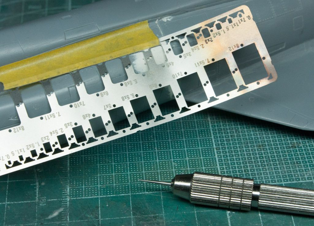

Next I started to rescribe all the panel lines that where lost, as some of them where completely gone I started by drawing them on with a pencil.
Then using 3M Fine line tape and a Tamiya scriber I started adding the bigger panel lines.
For the smaller panels I used a scribing template and an old 0.4 mm airbrush needle stuck in a pin wise. The needle is one that I dropped on the floor years ago, and if you drop an airbrush needle on the floor it will land point down and get stuck in the floor. And when you pick it up you will hit it and bend the tip, 100% guaranteed. So I sharpened it up again for this sort of use or making rivet marks and such.
Got a coat of primer over the areas that I have been working on, there is still some small spots that will need to be filled, this time probably using CA glue and some of the lines needs a bit of a touch up.But over all it's coming together.

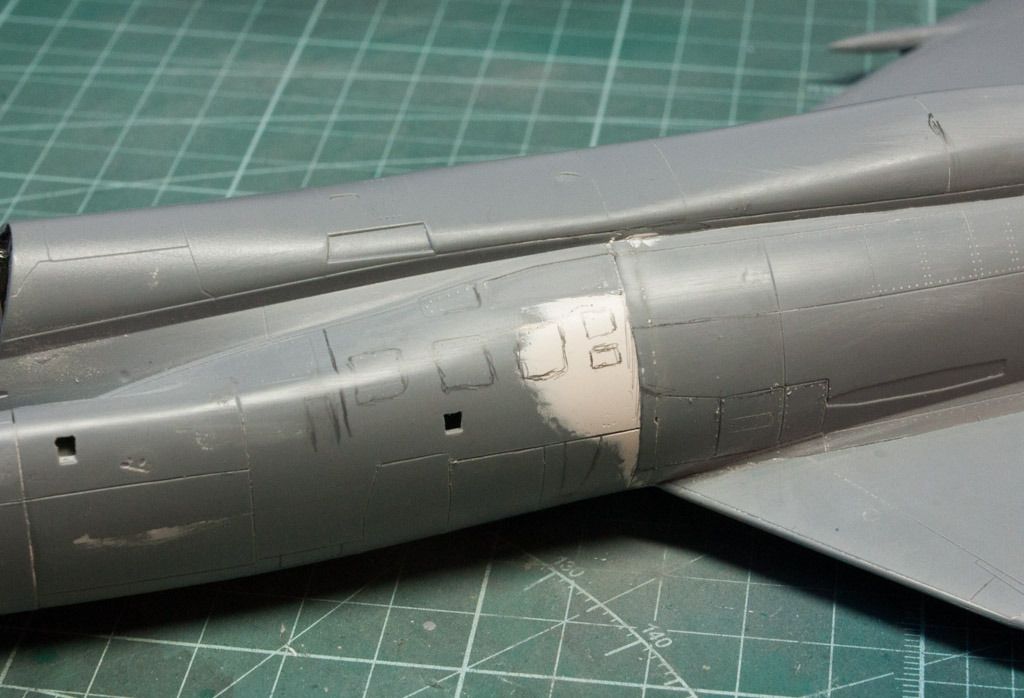

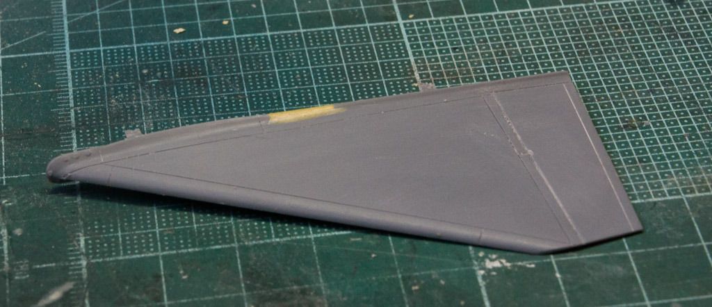

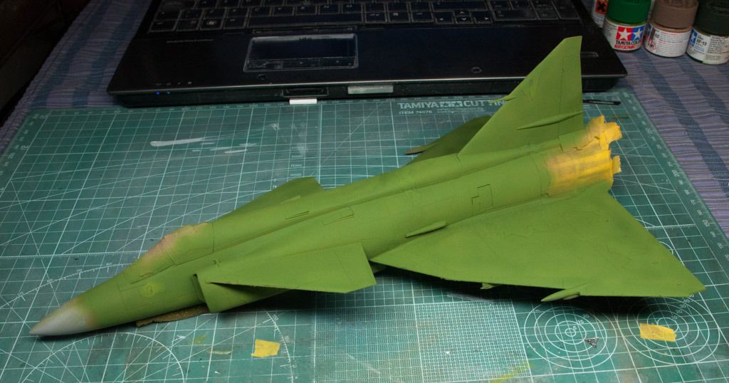

After I had to take the all the wings off earlier one of the canards got damaged. So to fix it I cut off a bit more to have more surface area to work with.
Next I put some Tamiya tape on the fuselage to protect it.
Mixed some Milliput and filled the hole.
Sanded it smooth,, applied some Tamiya putty thinned with cellulose thinner and sanded again.
Put the canards and most of the other parts on the fuselage.

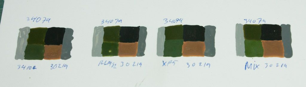

It's getting closer to paint, so it's time to start to think about what to use. The Viggen was painted in specific Swedish colors that don't have a direct conversion in say FS595 so it's a bit tricky to get the right colors. Combine that with changes due to weathering and it gets really tricky. Using the list at the bottom of this page http://peosflyg.fagelochflyg.se/gamla/v10/SCOLOR.HTM and IPMS Stockholms reference http://www.ipmsstockholm.org/colorchart ... sweden.htm and the colors Tarangus recommend I started to try to convert the colors to Vallejo Model Air or Tamiya as that is what I use. Doing this I got some really odd colors, like using the same green for both the dark and light and using a dark grey for both the light grey and the light green. So I did a bunch of test paints on a sheet of plastic to get a better look.
The dark green for all of these is Akan FS34079, which to me looks pretty good, XF13 is supposed to be really good so I'll probably get some and give it ago. The tan is Akan FS30219 that seems to be good and the tan color is the one that changes the most with weathering. Now the light green needed a bit more testing, the colors are from left Akan FS34102, Akan RLM82, XF5, six parts XF5 one part XF2 one part XF3. That mix was one that I found on a Swedish forum, I think that is the one that looks best but I might add a bit more white to get it slightly lighter. I got pretty much two different grays odd thing is that "The Ultimate Paint Conversion Chart" says that these are interchangeable, the dark one is XF53 and the light is Vallejo 71.046. The XF53 is probably the one that is closest to the real color.
Some pictures that shows ow much the colors change over time due to weathering, sure none of these are in service and are out in the weather all the time. The first three picture are of the same plane taken at different times.

Great research! Amazing how much those colors change. Do you have any ideas of the timeframe those pics are taken?

Thanks, no I have no idea when those pictures where taken.

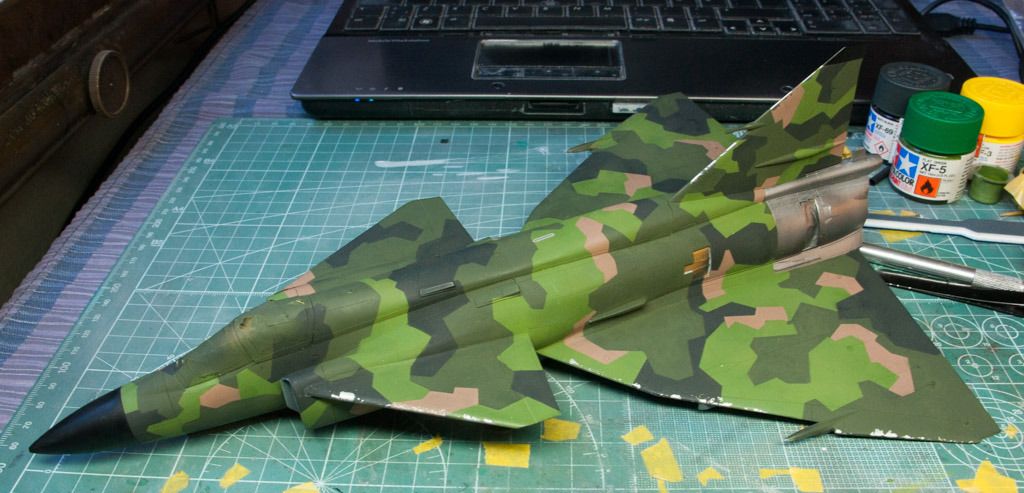

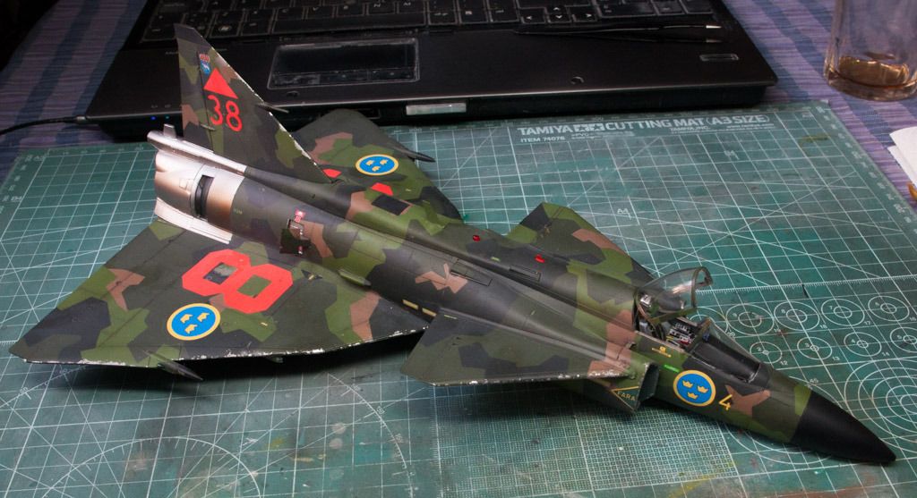

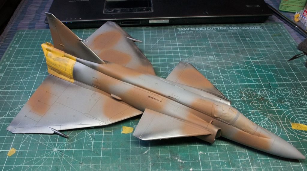

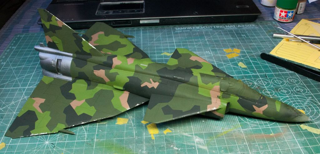

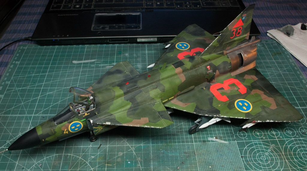

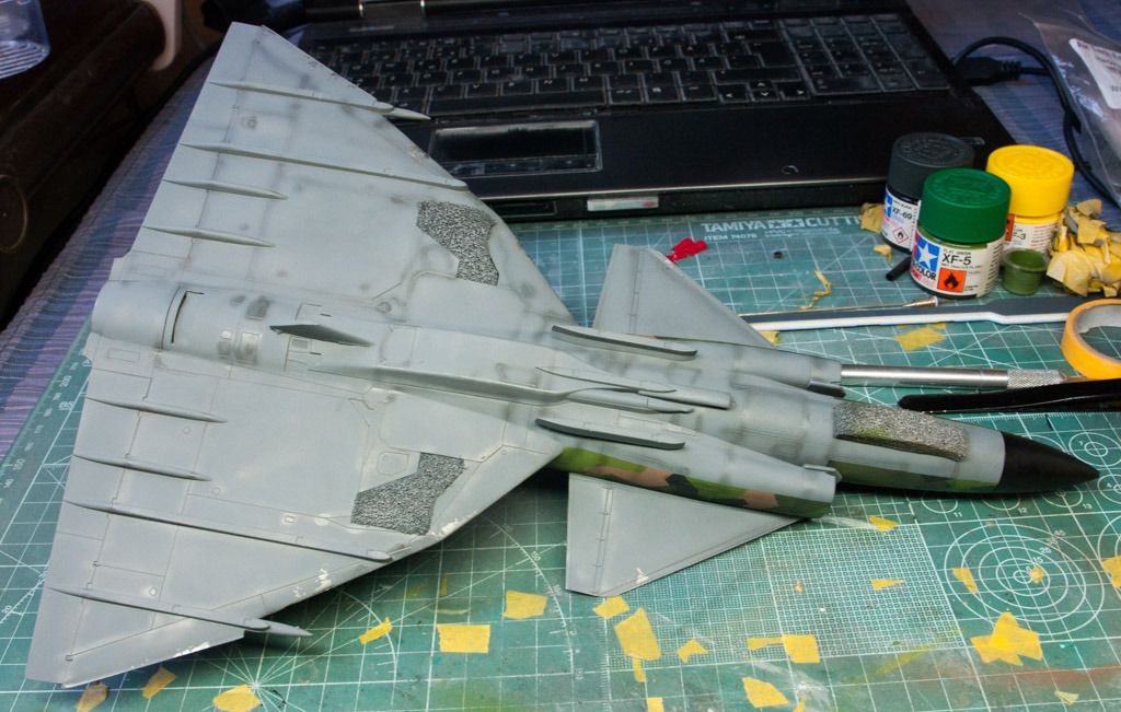

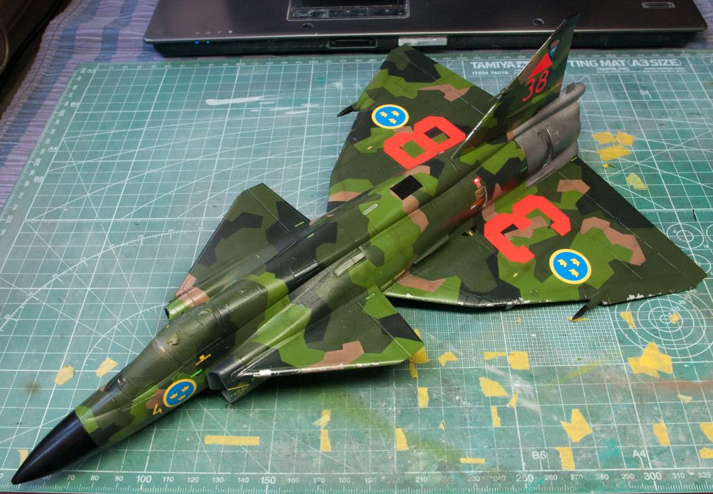

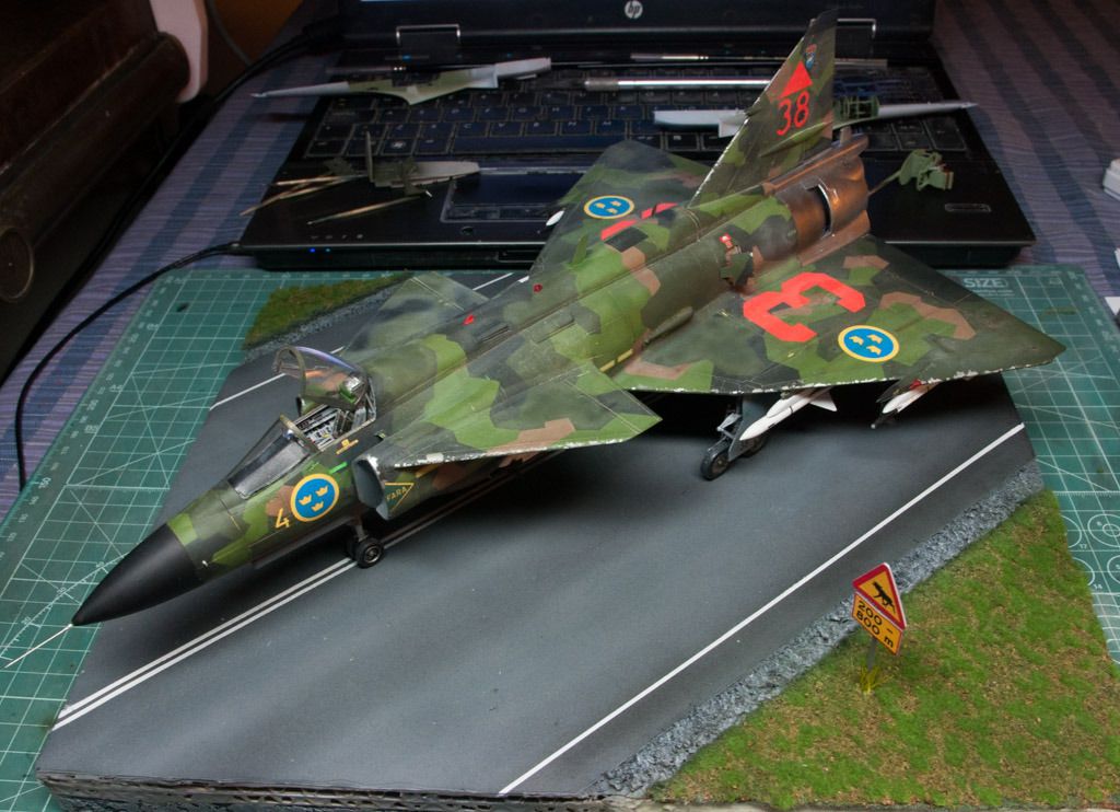

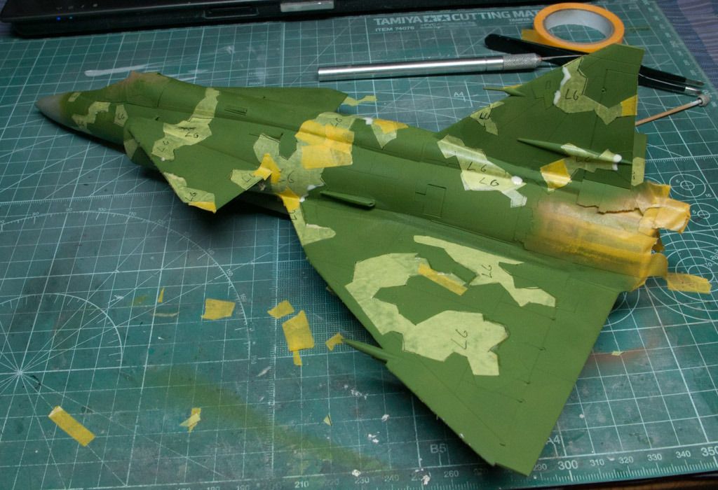

I have been doing a bit of painting and a lot of masking. Started with some AK primer followed by Alclad gloss black and dull aluminium on the leading edges of the wings and around the back of the engine. I then took a sponge and dabbed some liquid latex on the leading edges of the wings to get some chipping.
Since it's really hard to see the cut lines on the masking sheets I took some time and drew the lines and also noted what color each one should mask.
I started with the brown color.
Masked those areas painted the light green, masked those areas. I had to use some masking tape in some spots as I couldn't get the masks to line up. I also added some liquid latex where the masks for the different colors meet to make sure there wouldn't be a line between the colors.
The finally I could start removing all the masking. There are some spots that needs a bit of work. The paint pulled off in one or two spots and a couple of the edges is a bit soft but it's not too bad. When I put on the last layer of masking I started to feel a bit worried that the pattern would look wrong as some of the masks didn't meet up as they should and I had to use masking tape in some spots. But in the end I think it came out pretty good.

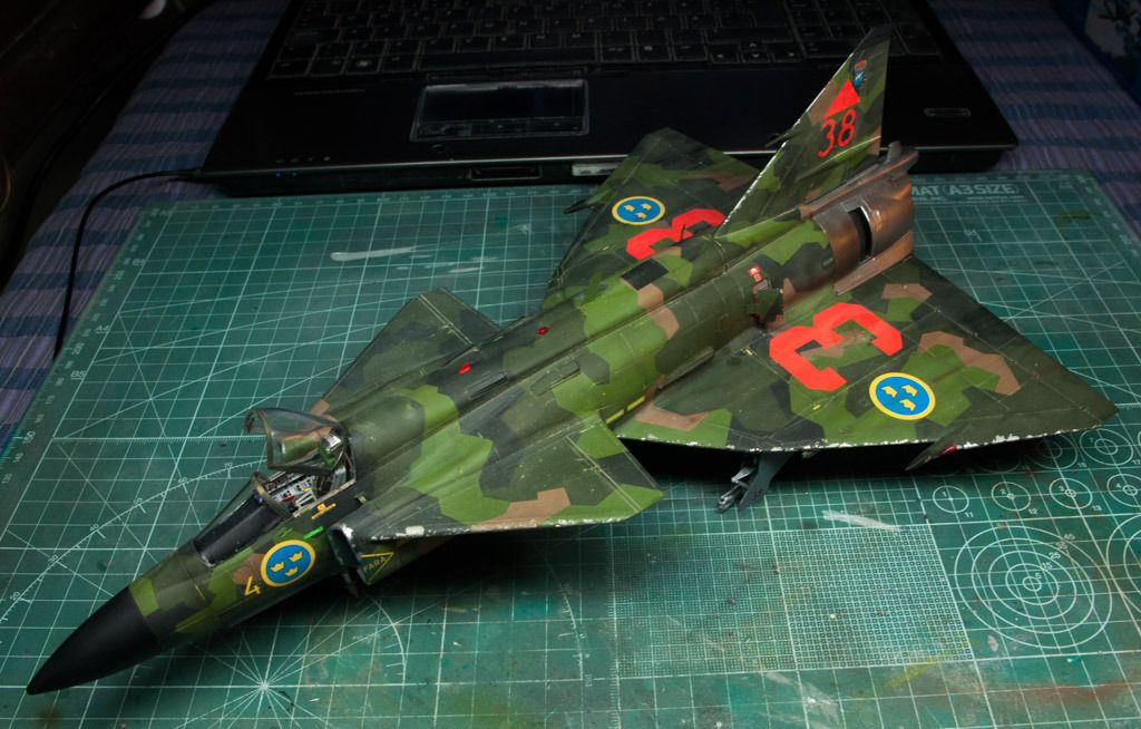

There is still two more colors to add, the black on the nose and grey on the underside. I did a couple of more tests with the paints and XF13 is really close to the Akan color I used for the dark green and same with XF52 for the tan. One thing I still need to do is post shading along all the panel lines as I didn't do any pre shading and I'll probably add some lighter versions of the all the colors to give the whole paint job a bit more faded look, since right now it looks too good and uniform.

Thats some splendid splinter camo , good work :cheers2:
Re: Viggen JA37
:jd: that is soooo cool! Great work buddy, she's beautiful :th:
Posts: 18029
Re: Viggen JA37
It is an awesome camo pattern, really like the effect! :th:
Re: Viggen JA37
Yeah! :clap: :clap: :thumb2:
That's how to do splinter-cammo - great job. It looks fantastic!
Re: Viggen JA37
Impressive work on the Viggen Jon! :th:
Great work with the recovery, re-assembly, fixing the problems and re-scribing etc.
As for the colours they look really nice, for those not familiar with especially Draken (J35), Viggen (J37) and JAS (J39) builds, Swedish camo colors are a djungle! :scratch::
As I have written before, no luxury of ready made colours from Tamiya, Vallejo etc. You have to mix Your own.
Great work on the research and mixing Jon :thumb1: , it looks the part for sure.
This will be one badass Viggen! :pistols:

Re: Viggen JA37
Sorry forgot...
So Your saying that the pre-cut camo masks does not really fit?

Thanks for the comments!
patrickroos wrote:Sorry forgot...
The thing is that I started with painting the tan and then adding those masks that are located in the middle of the wing only using the panel lines as reference. The problem then comes when adding the second layer of masking that has to line up with more the one of the tan masks that might not be perfectly placed. If one of them is off by only 1 mm or 1 degree you have problems, especially when you get to the third layer of masking that has to align to three (or more) misplaced masks. Also some of the masks overlap, the ones that are on the edge of the sheet and also the ones on the edges of the wing. All of this adds up to make it really hard to get it perfect. The masks probably fit just as they should, I blame everything on "skit bakom spakarna". If I where to do this again I might start in one corner and just paint that area, mask it, pain the adjacent area, mask that and keep going until the whole model is painted. This would take a lot longer, but that way all the masks will line up as they should.

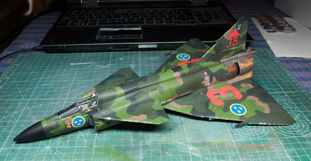

Post by JonMW »

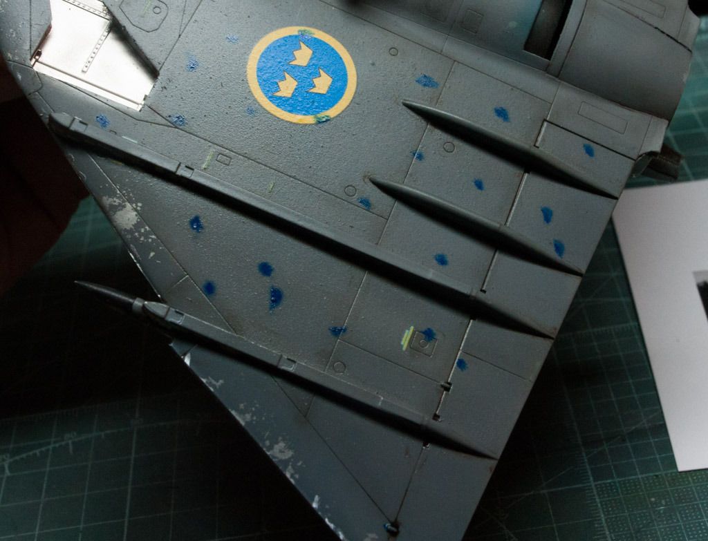

Continued with the painting, put some black on the nose cone and the top of the vertical stabilizer and painted the underside in XF53 grey. I think it came out a bit darker then I had hoped for and maybe should have a tone of blue to it, but it works. Also did some post shading using X19 Smoke along the panel lines and doing small figures of eights and mottling to get some color variations.
Then it was time for a coat of Alclad Aqua gloss and decals. I think it really comes alive when all the decals are added, especially when they have such a big contrast in color to the paint. I have to complain a little bit about the decals and the instructions. The decals are nice and thin, conform well and don't rip, but the numbering on the sheet is all over the place so it takes a lot of time to find the correct decal. But ok I can live with that, bigger problem are the decals that are missing numbers on the sheet and/or in the instructions. And then there are some extra one on the instructions that are not on the sheet and of course the ones that are numbered wrong in the instructions. But if you watch out for it it's fine, just irritating.
Next up is one more coat of clear then some Ultimate wash.
Re: Viggen JA37
Oh man she looks so SEXY. Brilliant work on the camo outstanding.

Nige201980 wrote:Oh man she looks so SEXY. Brilliant work on the camo outstanding.
I second that :bow::

Re: Viggen JA37
Post by wally »
Nice Viggen and the camo work looks terrific. The idea with the own paint masks is also very interesting. I like how it looks especially underside. :th:
Keep up good work.

Re: Viggen JA37
JonMW wrote:Thanks for the comments!
OK! :bash:
Good to know! Thanks! :th:
Re: Viggen JA37
Wow, now it really looks like a Viggen mate, beautiful!!! :th: :pistols: :cheers2:

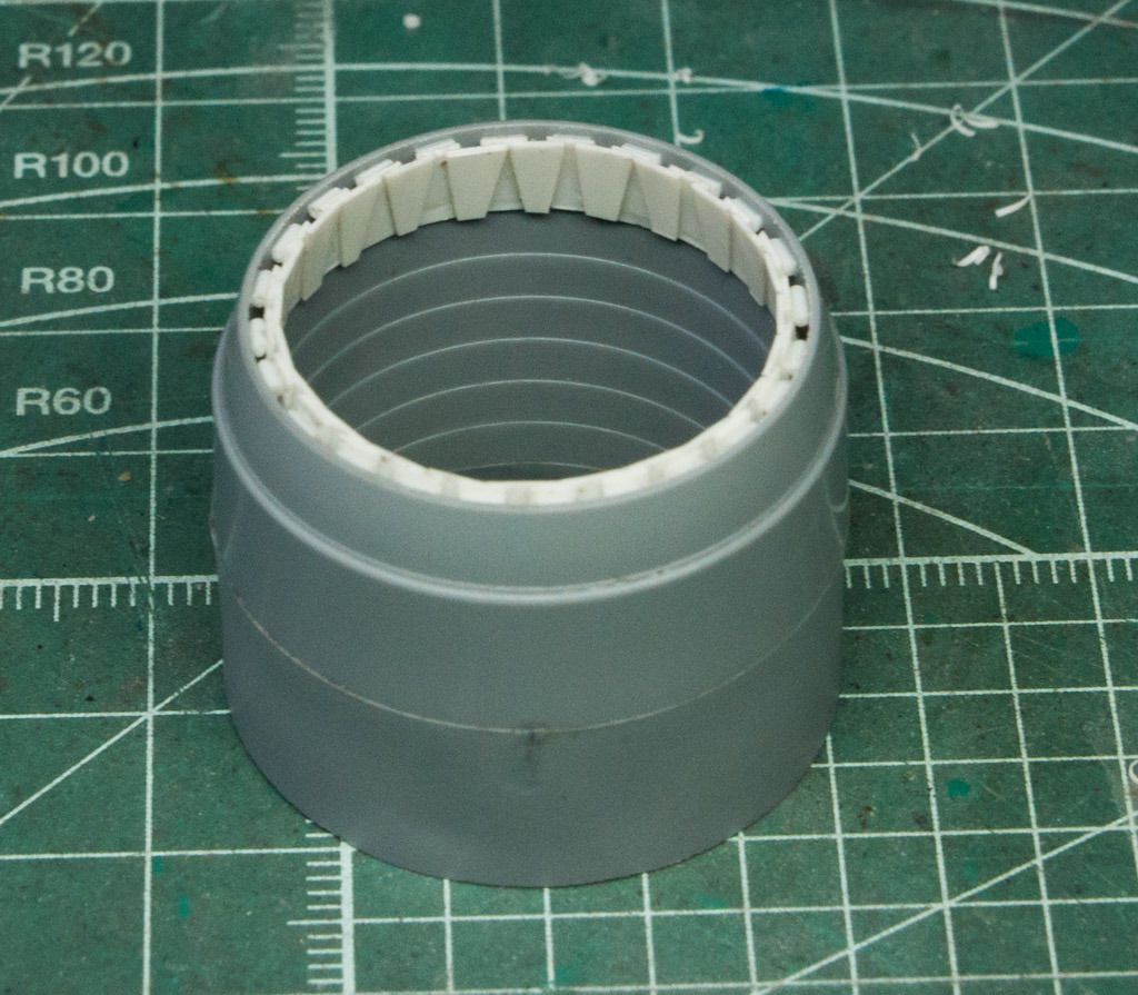

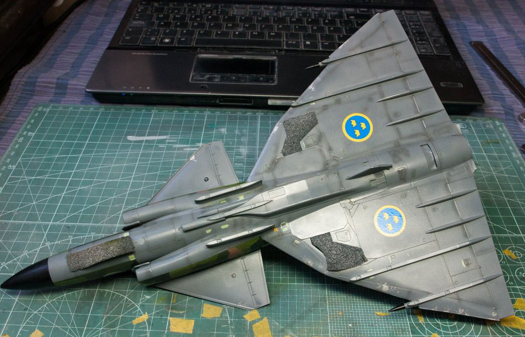

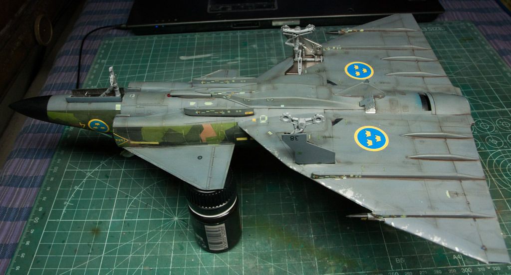

Been doing a bit more work, put a second coat of Aqua Gloss on followed by the new Ultimate Dark Dirt and then a coat of Model Master flat clear.
After all the clear coats the metal around the engine didn't look too good, so I repainted it this time also using AK burned metal to get some color variation.

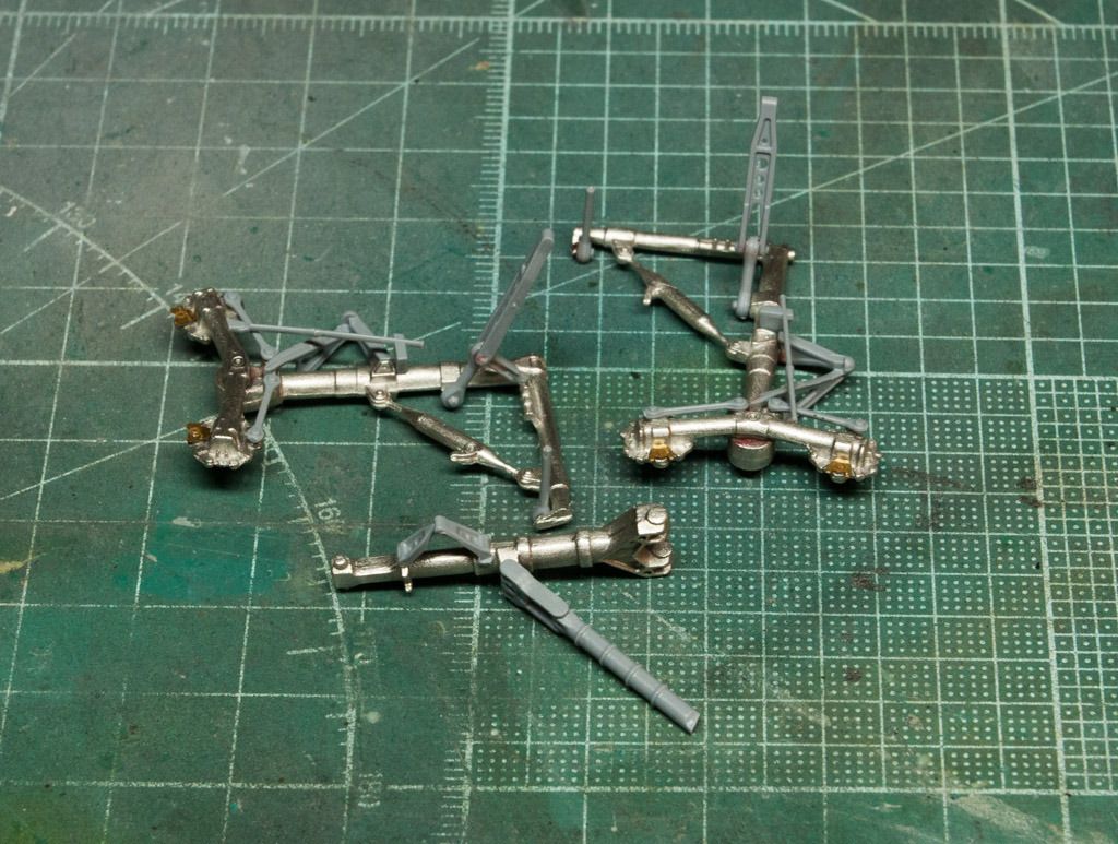

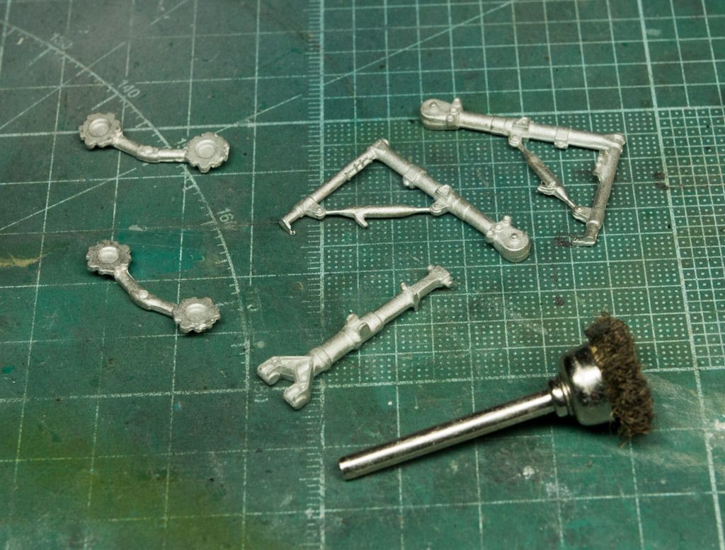

Next up was the landing gear. Since I'm using the white metal ones they need a bit of clean up. For this I used a small wire brush for a dremel, but used it by hand.
Gives a bit more of a shine on the part. One thing of note, I don't know what type of white metal Tarangus but some types can contain lead. So use gloves when cleaning the parts. Even if they most likely use a white metal without lead you can never be too sure.
The landing gear assembled and waiting for paint.

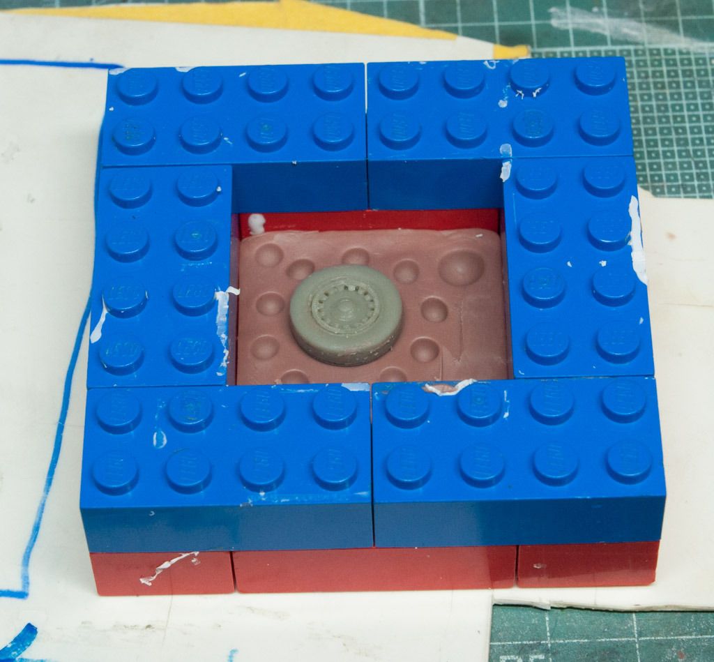

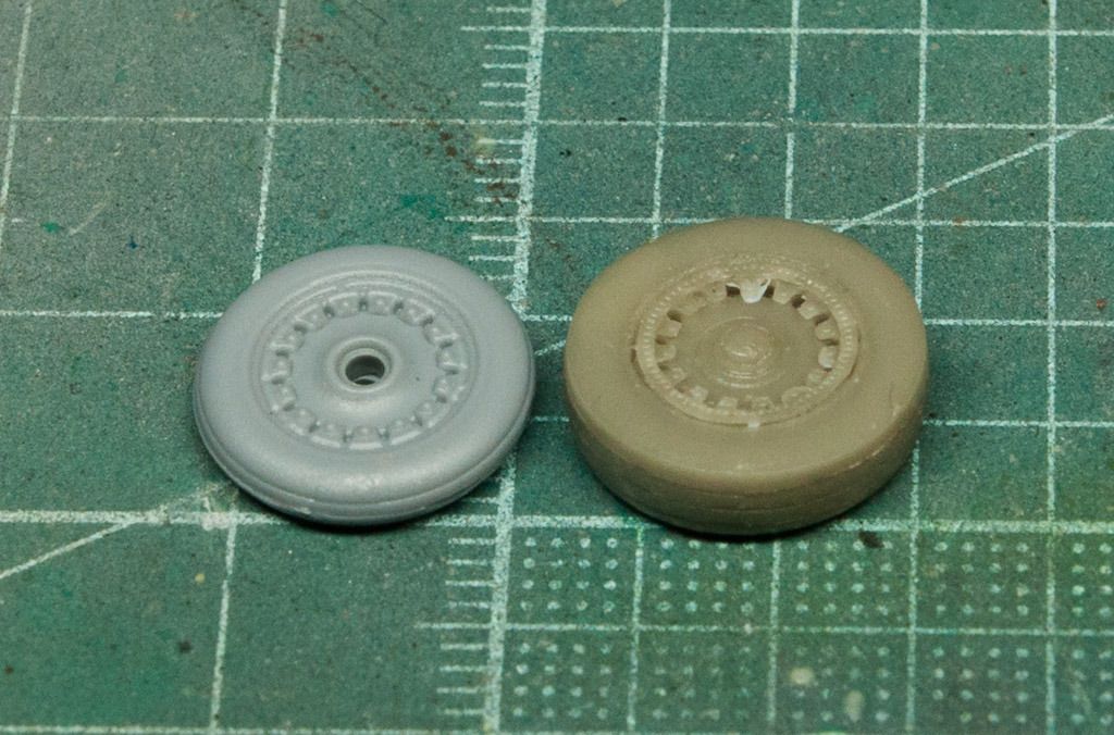

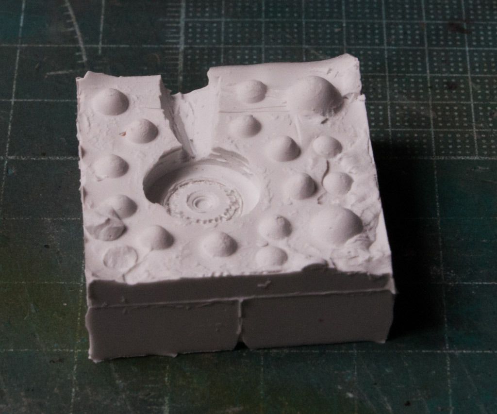

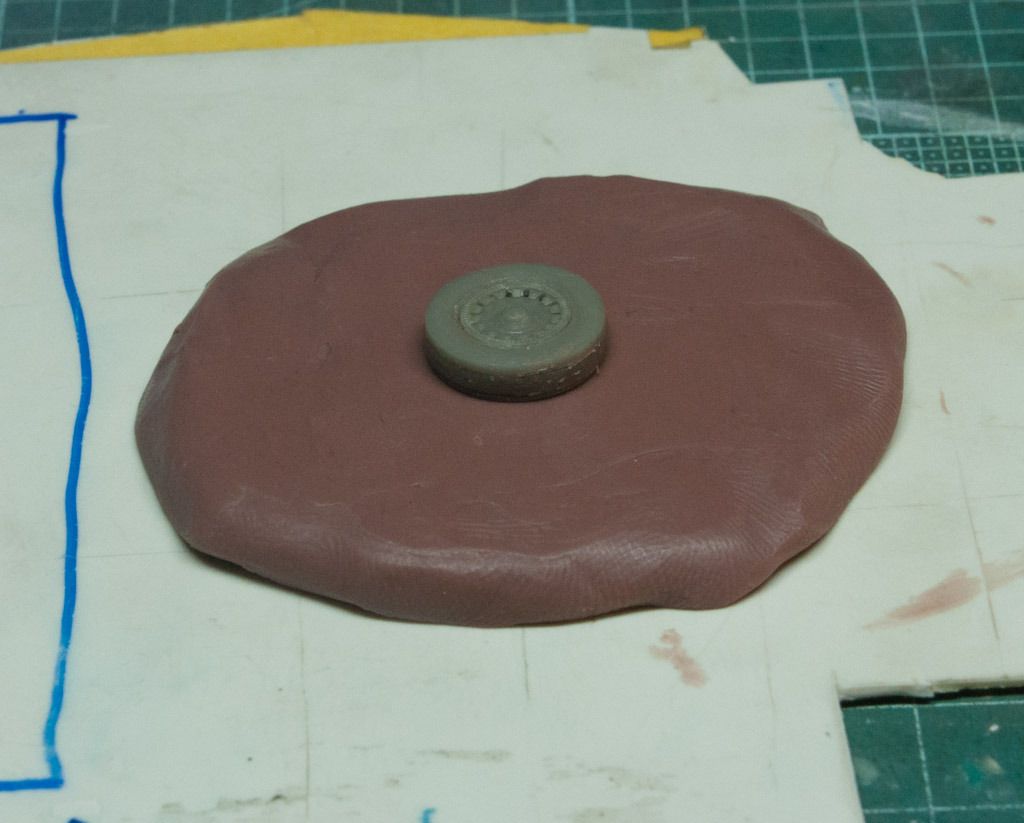

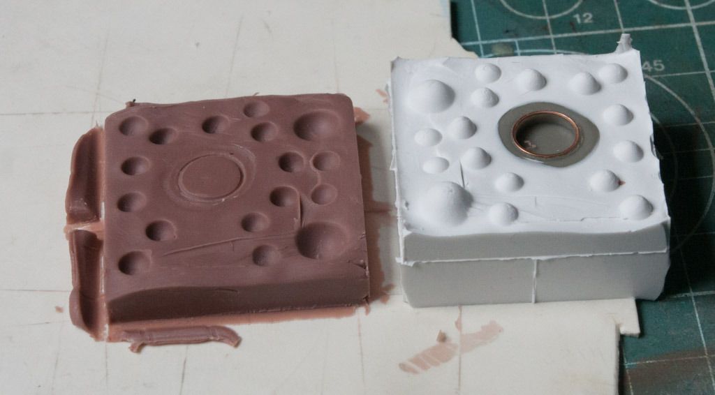

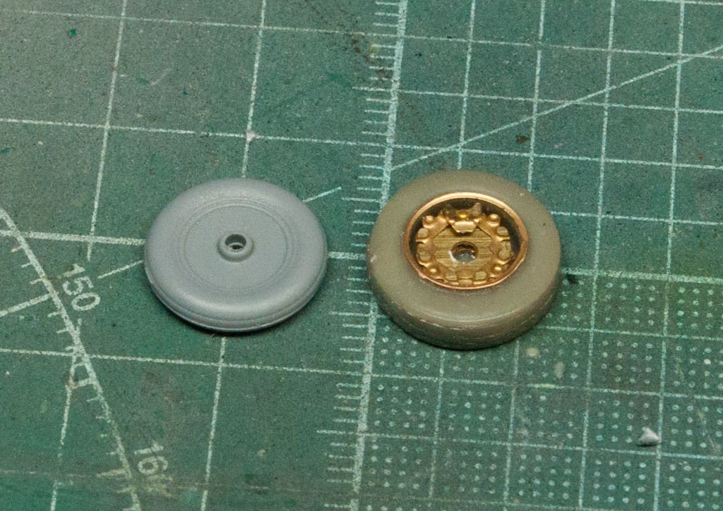

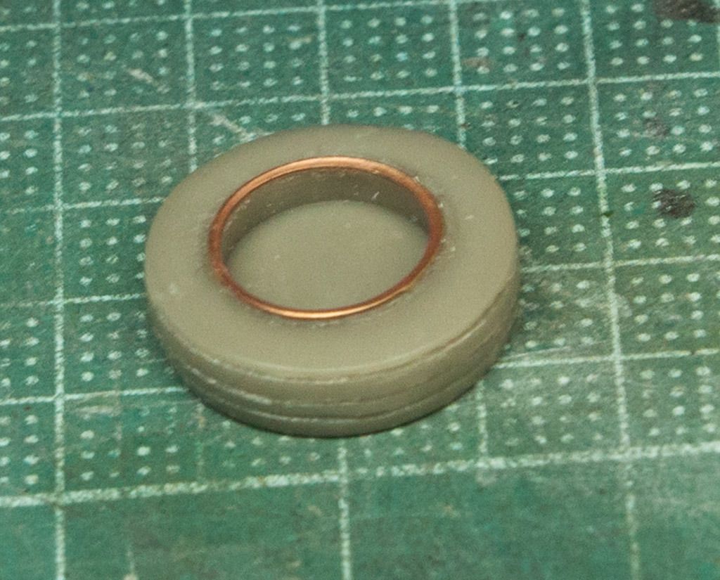

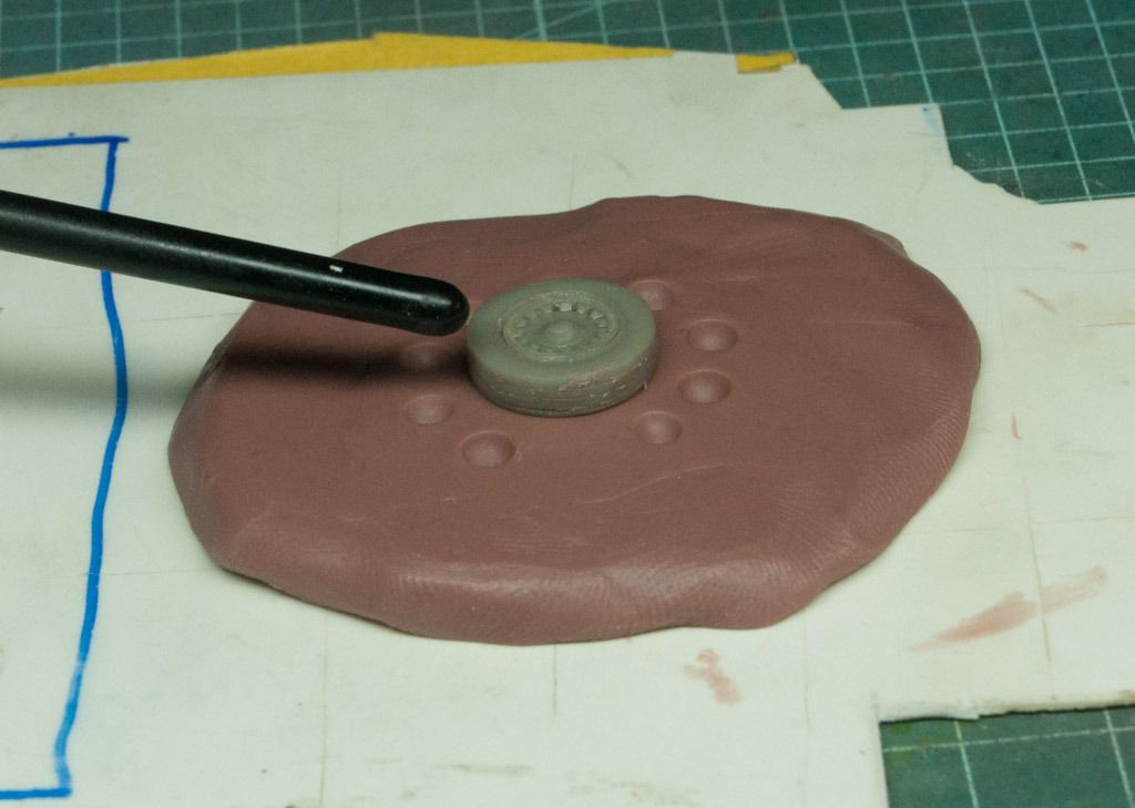

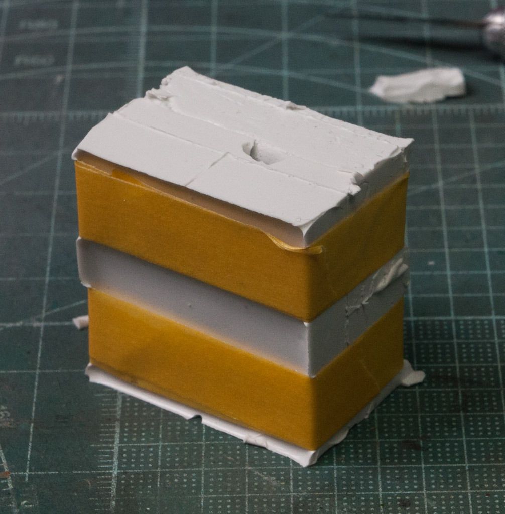

Have started working on the wheels, the resin ones has a lot more details then the kit ones.
But one of the main wheels in my package had a big air bubble in it and one of the rings on the PE has a gap in it. I could probably have contacted Maestro and gotten a new one, but I figured why bother them with that since I can fix it with maybe 15 minutes of work. First I glued on of the good PE rings on one of the good wheels.

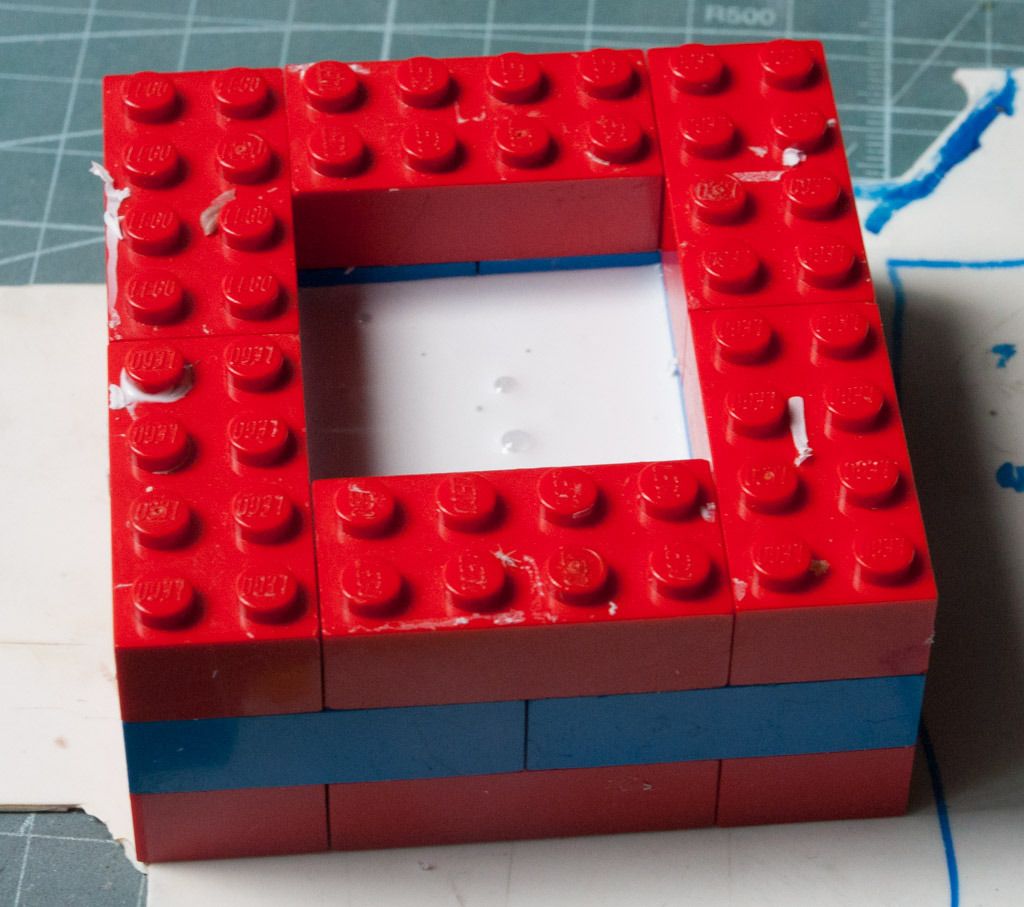

Next I put a thin layer of clay on a sheet of plastic pushed the wheel into the clay so that it only covers the side wall and a little bit of the tread. The clay I used is an oil based clay called Monster clay, it might not be the best clay for this, a softer clay would be a little bit easier to work with, like a water clay. The good thing with this is that you can cast silicon directly on it, if you use a water based clay it needs to be sealed with something like a clear coat.
I then made some dimples around the wheel using the back of a brush, I left a gap to be able to pour the resin in. Then build a small box of lego around the wheel.
Mixed about 20 grams of silicon, poured it in and let it cure for about 45 minutes.
The silicon came off the clay really easy and left a good cast.
I then put the silicon back in the lego box, coated it with normal washing up liquid otherwise the second part of the silicon mold is going to stick to the first one and you will have a solid block of silicon with an in cased wheel. After letting the second half of the mold cure for 45 minutes I could take it apart, remove the wheel and then cut a channel to get the resin into the mold.
Taped the two half together mixed about 2 ml of resin and using a pipette forced it into the mold, I found that doing it that way there is less risk of getting air bubbles in the part. Also tapped the mold on the table to help dislodge any air bubble that might still be in there. Waited about 30 minutes and took out the new wheel, it needs a little bit of clean up but should look as good as the other ones when done.
