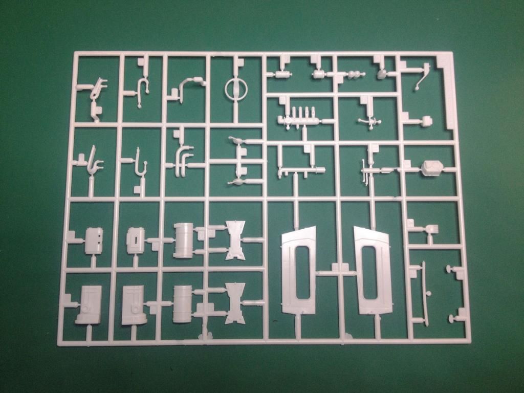

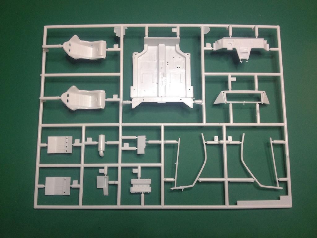

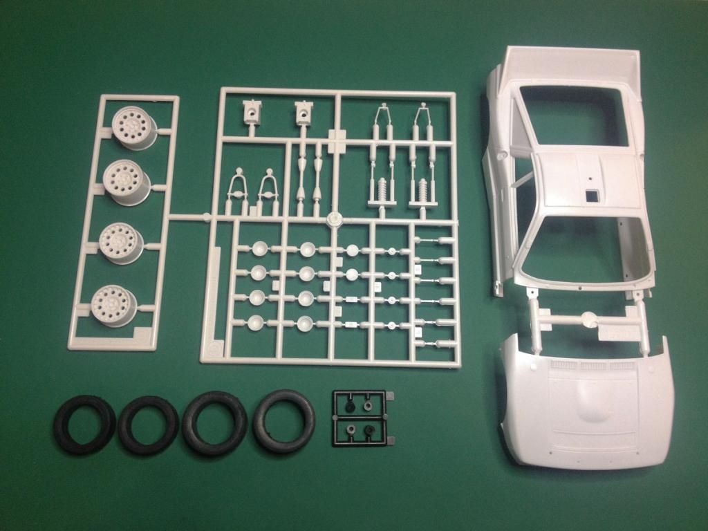

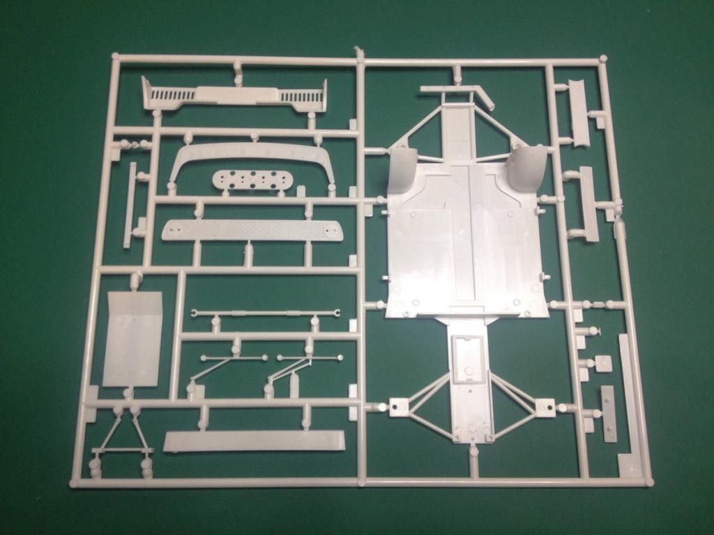

There are a few things I immediately noticed when opening the box though. First off is the amount of flash... This kit was released in 2000, yet I have some kits in my stash that are far older than that and that show almost no flash. So there will be a lot of cleanup to do. Secondly is the amount of parts. The box is listing 146 of them spead over 6 sprues. This is about double of what I'm used to of a Tamiya or Revell kit within the same price range (I paid about 30 Euro's for the Lancia):
Yes that's flash running down the middle of the sprue... The parts aren't as bad, but there is still a fair bit of flash on them.
With so much flash on the sprues, I'd had expected to find some nasty mould lines on the body work. The weird part is that there were only two little ones on the sides of the bonnet that took only about a minute to remove. The rest of the bodywork is flawless and needs almost no prep before priming.

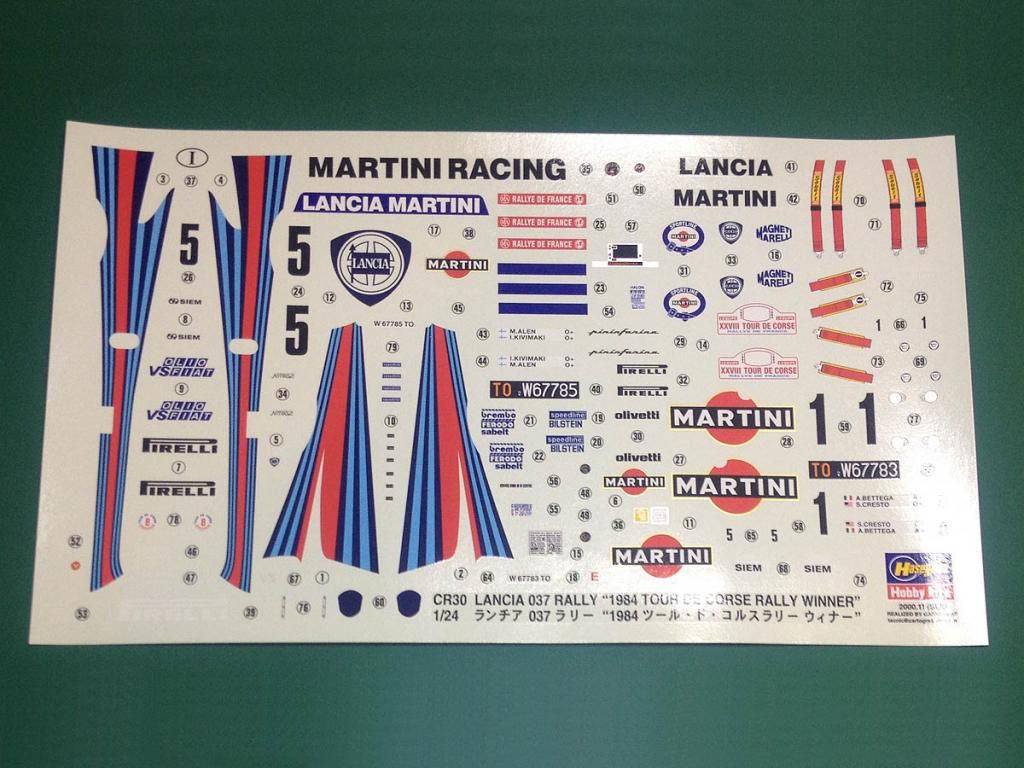

Quite a lot of decals which is good, cause I love decalling... :dance: It's always the part that brings a rally car to life.

the sprues look a bit flashy though but as long as the parts are clean i don't see a problem with that

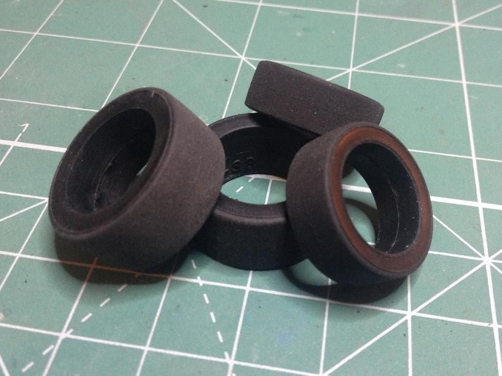

So, building has already started. Before opening the instruction booklet, I decided to do something about those awful tires. They were a terrible eyesore and needed some (understatement) cleanup:
Not exactly tires you want to put on your model, so out came the sanding sticks and buffer. All tires were pulled over their respective wheels to provide some more grip (pun intended), and after about 45 minutes of sanding, I managed to get rid of the ugly mold line running down the middle. They don't look so new anymore but at least they have that nice rough look as if they have been scraped over asphalt for a while:

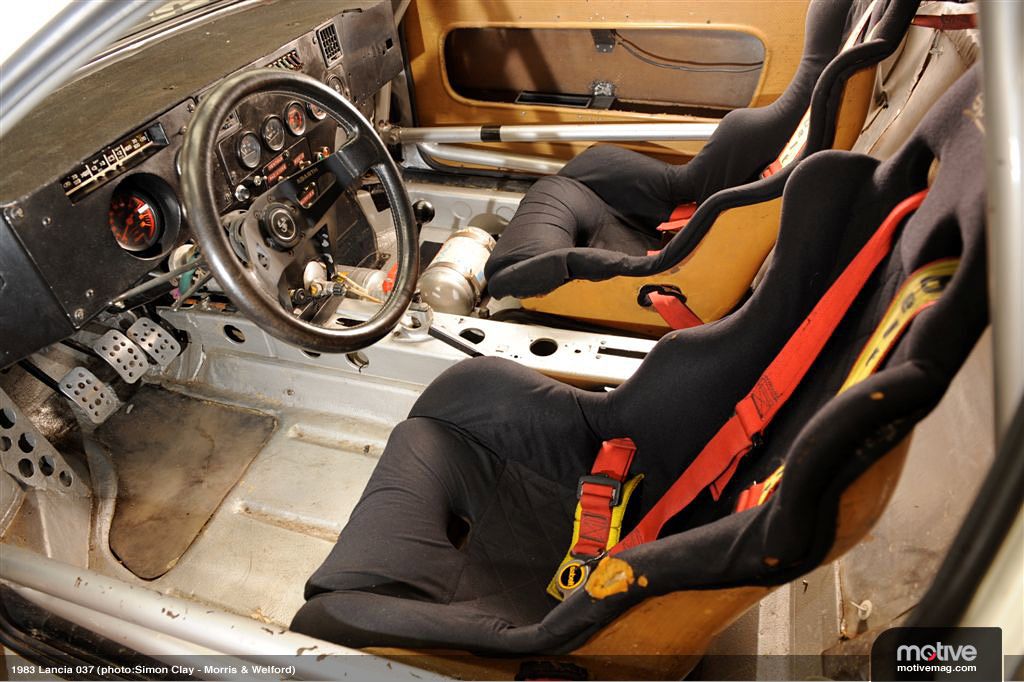

Next up I opened the instruction booklet and to my surprise, I found that although other kit manufacturers like to start the build with the engine, this one starts with the interior. I had a sneak-peek in some of the other boxes in my stash and it turns out Hasegawa generally likes to start the build of a model with the interior. So I scrounged the interweb for some pictures of the interior of the Lancia 037 Rally. I wasn't able to find very many, but I did manage to find one I like a lot. So I decided to use this pic as a guideline for building the interior:

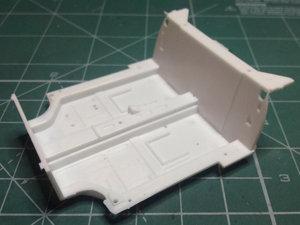

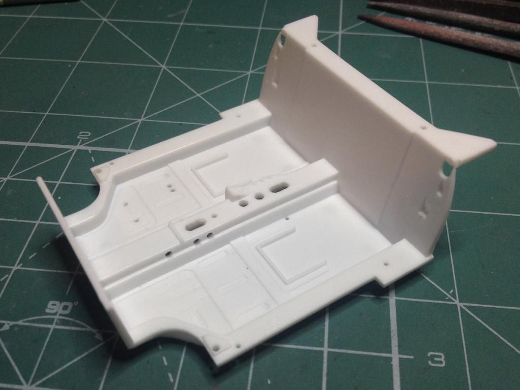

The first part to tackle was the interior tub. A lot of cleanup needed to be done. As per the above picture, I also decided to drill a few extra holes. So after a fair bit of work, I went from this... (apologies for the blurry pic):
to this:
Once the handbrake and gear stick were in place, I decided to add a few cables as per the above picture. I also liked the texture in the foot well, so out came the Mr. Surfacer 1000 and a old brush to add some more texture:

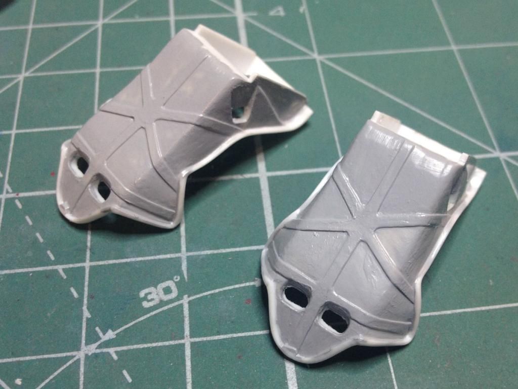

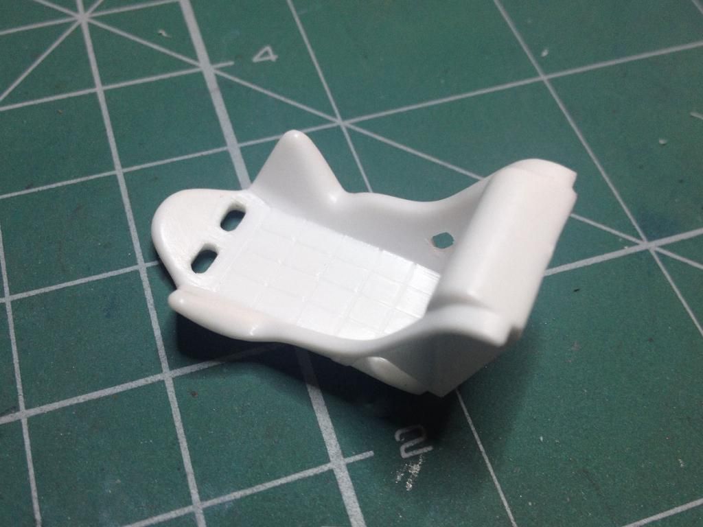

Next up were the seats. These also needed quite a fair bit of work.
Before:
After:
I also decided to add some Mr. Surfacer to the back of the seats to approximate the texture in the reference pic:

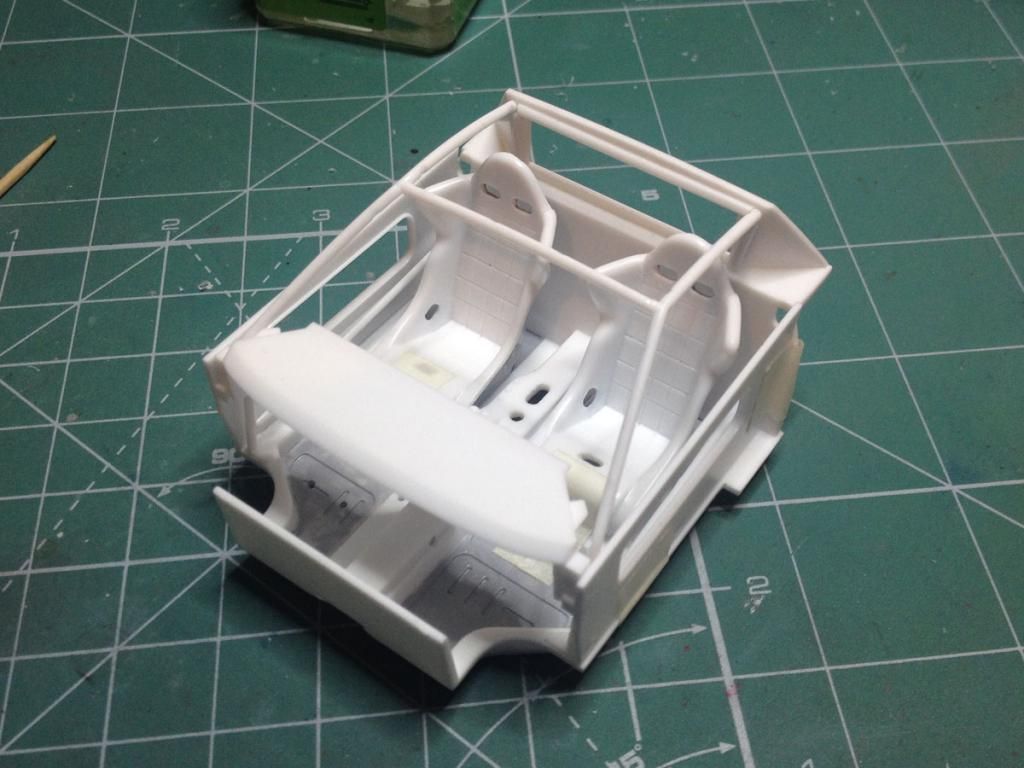

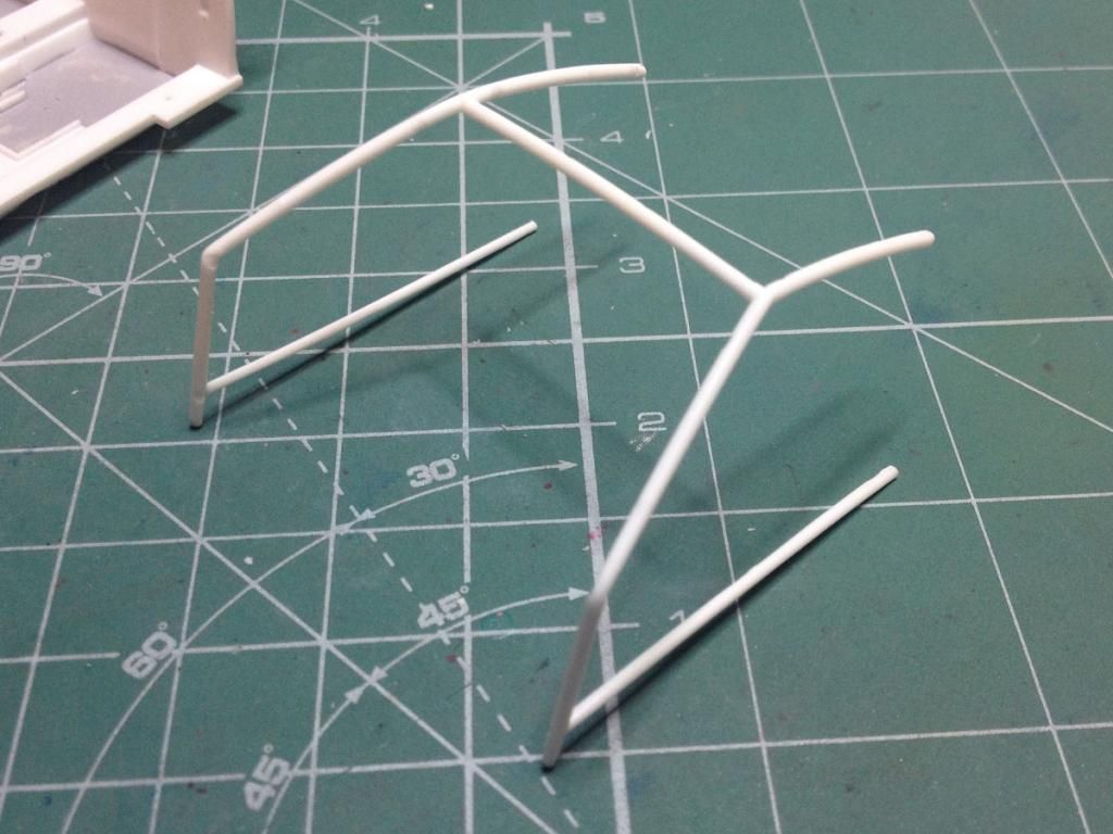

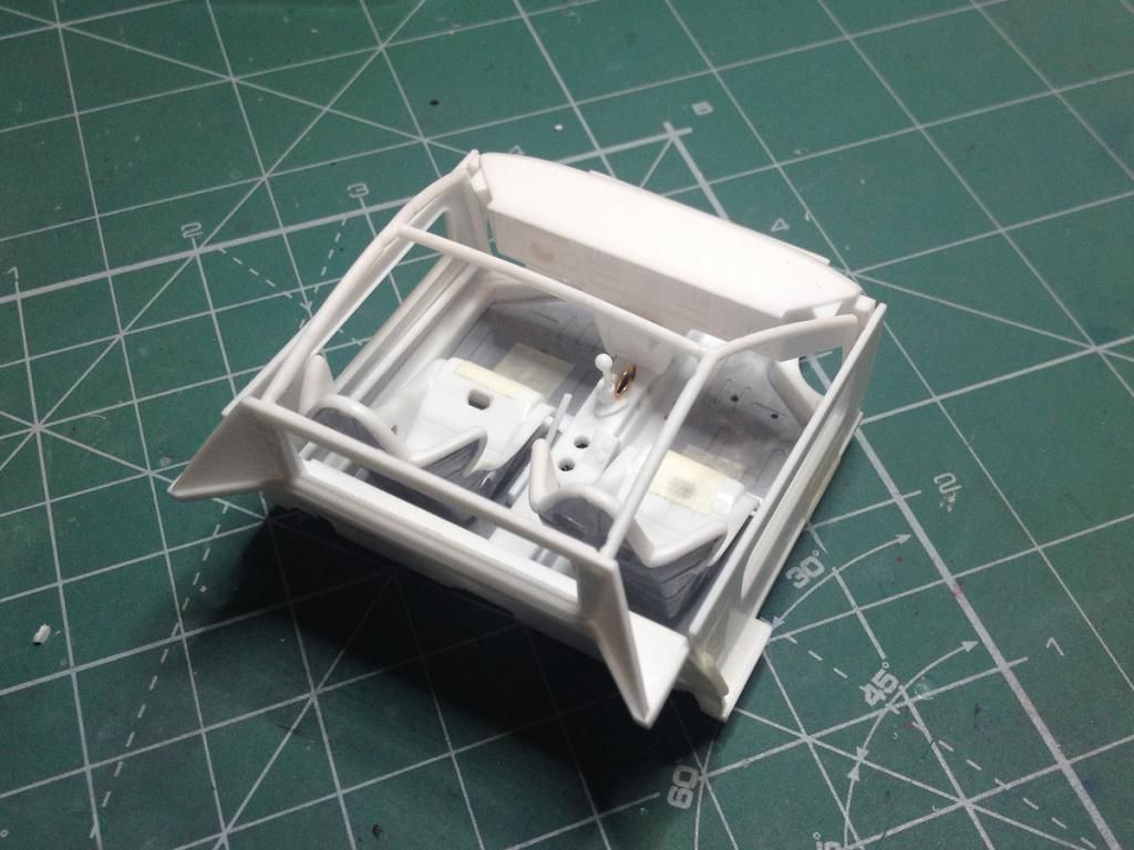

Nothing more can be done on the seats for now. The order I'm waiting for also contains the flocking powder I need to finish them off. Luckily there's a lot more to be done on this kit. The roll cage came next, and once I prepped the dashboard and the window separating the interior from the rear mounted engine, I decided to do a dry-fit of all the parts to see if there would be any fitting issues. Dry-fitting isn't something I did when building my previous models and I think I could have avoided a lot of issues with those builds if I'd taken the time to check if parts actually fit together properly before taking the glue out:
Roll-cage:
And some pics of the interior "mock-up":
Next is priming the whole shebang.
