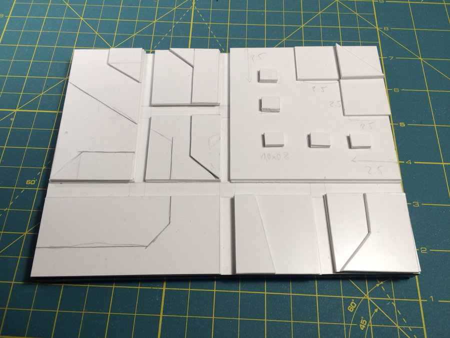

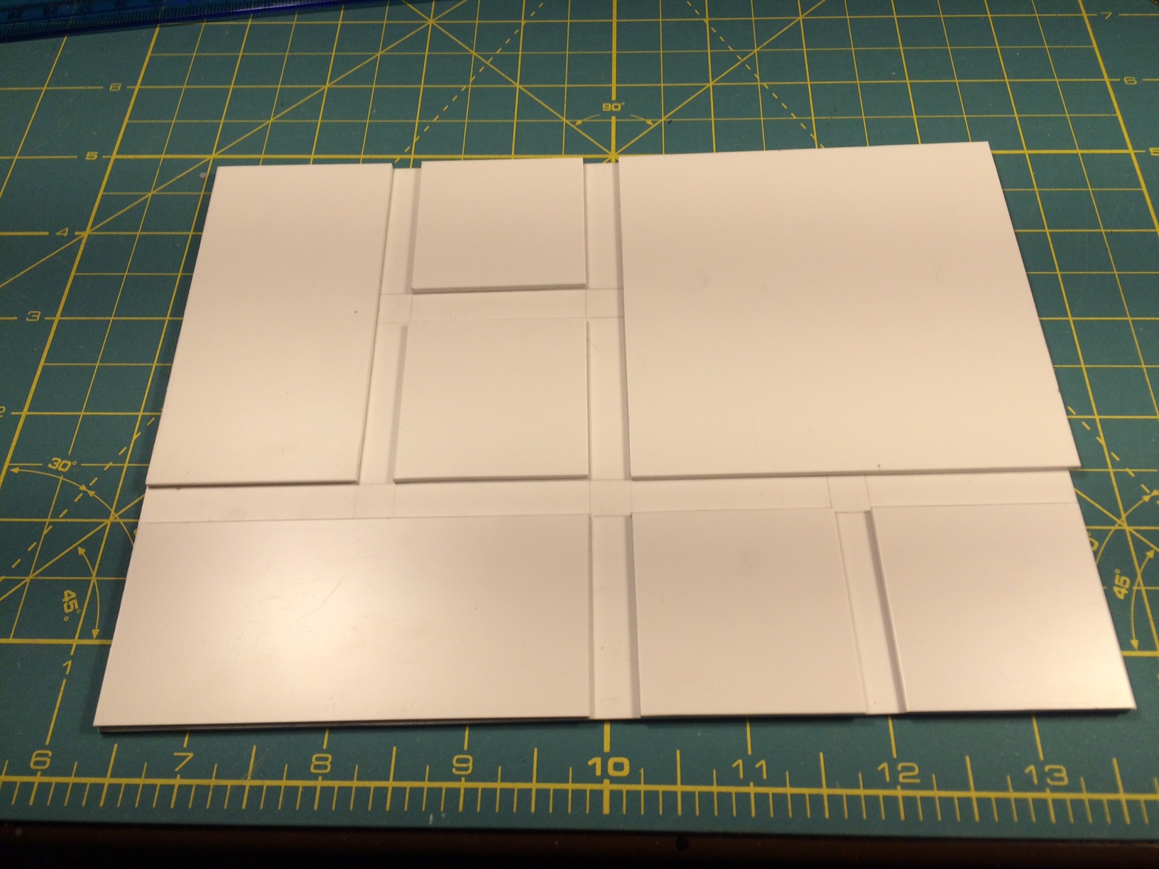

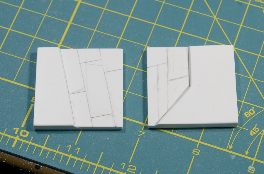

The plan is to mount it to a 10x15cm IKEA picture frame, so I started with a piece of styrene cut to the proper dimensions.
Here you can see the initial layout.
Some first layout pieces drawn and added.

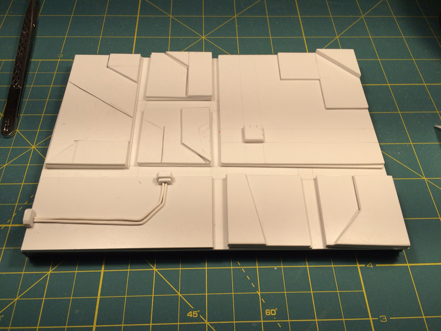

Trying some tubing ideas. Not sure if I can pull that off nicely.

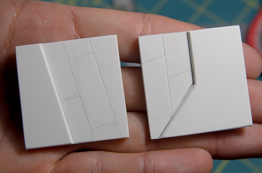

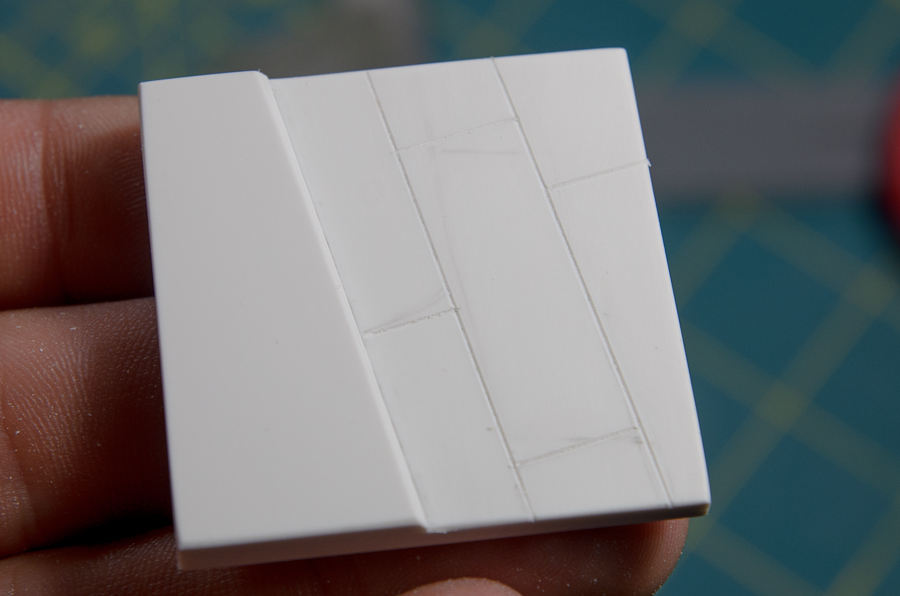

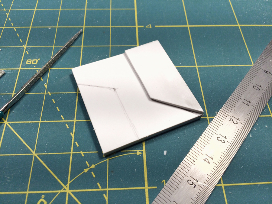

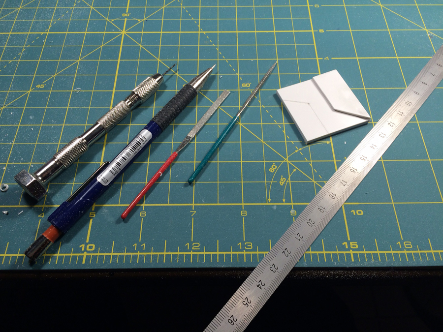

Started with some scribing. Unfortunately, I don't have a dedicated scribing tool, so I have to make
do with what I have:
DIY scriber from a pin and a mechanical pencil
some jewellers files
and a micro drill for making a "stopping hole" for the corner
Layout for some more scribing.
And the results so far.
That's all for now, took me about a week to get this far.

Thanks guys. There's still a lot of scribing to do and I'm thinking about getting a
dedicated scribing tool but I'm not sure if my panel lines aren't already clean enough.
Could I get a significantly better result with e.g. the Tamiya scriber?
Re: Stylized Death Star base for my Tie Interceptor
Maybe, but it's also worth mentioning that the model itself used in the film was little more than a giant kitbash. Foam and plastic in some random patterns.
I have a Trumpeter scriber that I've only used once (it worked well), otherwise the back edge of an 11 hobby blade works, too. It's looking great so far, just load it up with greebles until you feel happy. :th:
