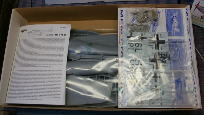

I've been wanting to join this SIG but haven't been sure with what. After looking around some shops I saw the Special Hobby Heinkel He 115 in Swedish markings and knew I wanted to build it. Problem was I couldn't find any shop here in Sweden that had it in stock, but one shop here in Stockholm had the German version. This shop is owned buy the same guy that owns Tarangus and Maestro Models, and Maestro have a set of decals to build the Swedish version. Last weekend we had a build meeting there and I was looking in the kit and talking about it and I said that I wanted to build the Swedish version. The guy working there said that if I buy the kit we could sort out the decals, now I didn't think that would mean giving me a set from his own stash for free, but it did, which I'm very thankful for. So I got the kit, plus PE zoom set and masks. One thing I have to say is that this thing is BIG! And I would like to do a small dio base for it, not sure where I could fit that but we'll see.
Kit comes with some resin bits like engines and radios.
The extra stuff

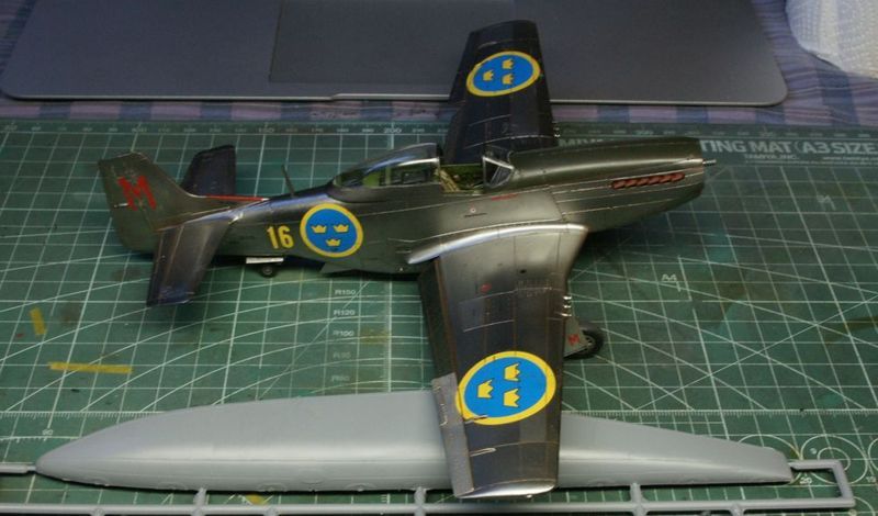

One of the floats next to a 1/48 P51D, so not small.

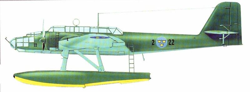

Heinkel He 115. T2 no.102 in m/37 markings
Torpedo drop 1939
A few of the images of the T2 show light colored walk ways on both wings. In most photos there are none, where these markings only applied to a couple of the aircraft for war games?

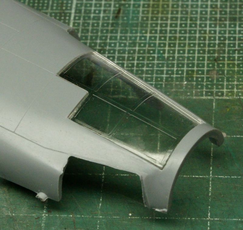

The fit is is really not the best, and this is the good side.
However all the glass seems to fit well, so at least that's good.

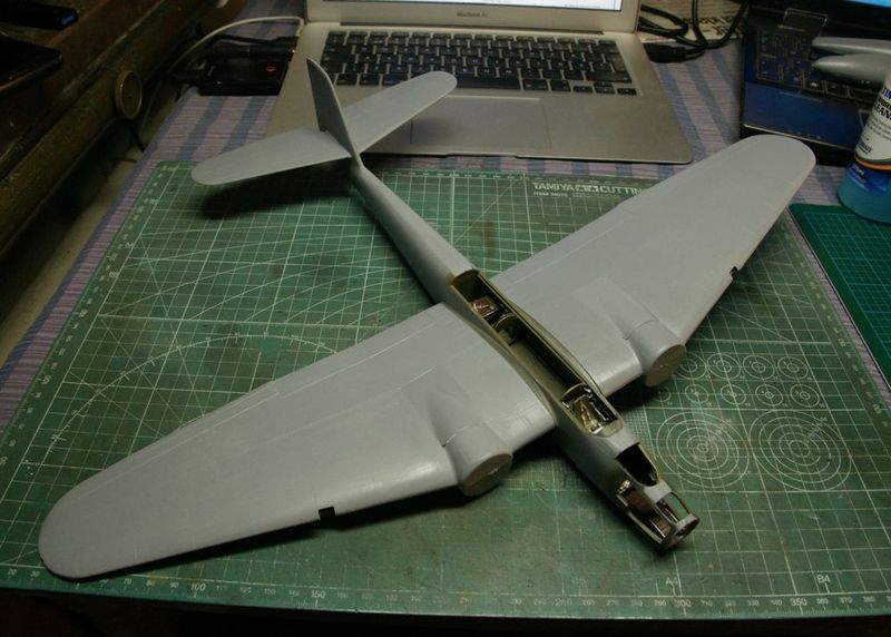

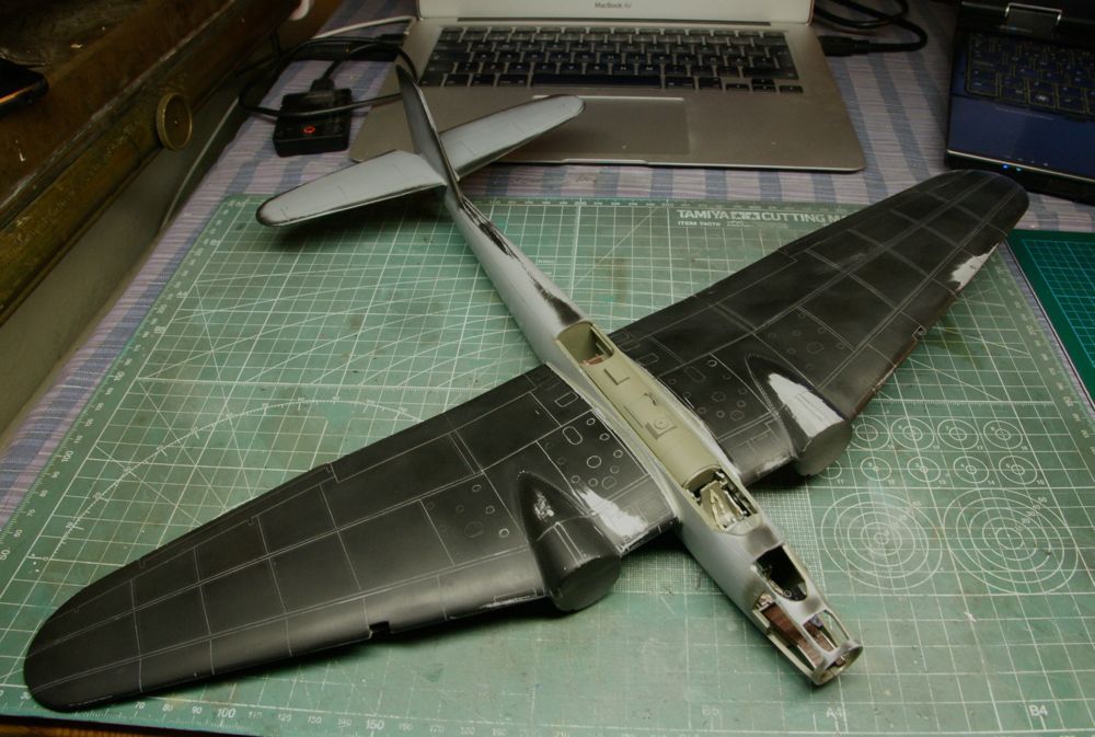

Progress has been a bit slow on this, but it has needed a lot of sanding, especially the top of the wings and the floats. So that removed almost all the panel line details from the wings that needed to be rescribed. For most of the scribing I used a Tamiya PE saw as I find it a lot easier to control then a normal scribing tool. However the top of the floats had a lot of raised details that will need to be replaced later. So after over a week of fillin, sanding and scribing I think it's close to good. Now I just need to fill and sand the wing roots and add the glass and floats before I can start painting.
Have also started to think about the base for it. As I want to make something that looks similar to the picture I posted earlier I will need some things. First off I need a 1/48 scale cow, Pegasus makes a set of farm animals that I will try to get a hold of but until then I wanted to see what I could do myself. So I found a pretty good 3D model that I scaled down and 3D printed, it's far from perfect but it's a start. Still need to fill the print lines and it would be nice if it had a better pose, I'll see what I can do about that. As the legs are a bit fragile I made a silicon mold of it so I can make a resin copy that will hopefully be a bit stronger. I also found a drawing for a small wooden row boat for use the archipelago, that has been used in Sweden since about 1450 and you can still by new ones today. So I made a 3D model of the frame parts that I printed, I plan on making the hull out of thin strips of plastic and build it up like the real thing.

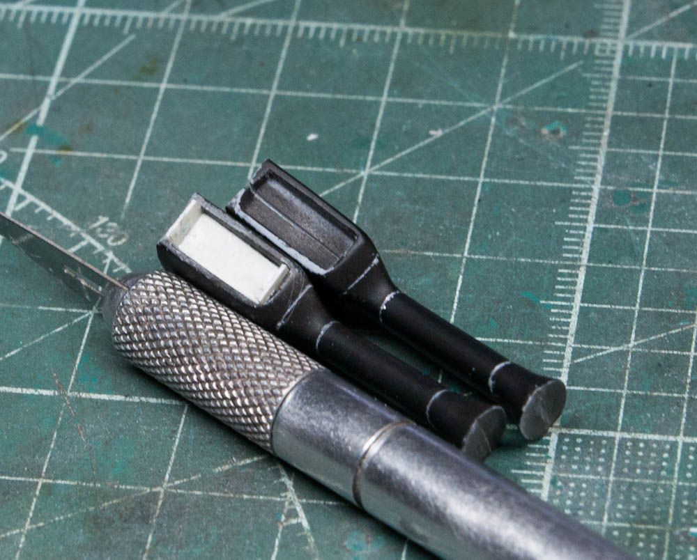

The resin engines where painted in Alclad dark aluminium, then all the pushrods where made from 0.5 mm rod that where then painted black.
The machine guns and mounts where painted back and then rubbed with dark steel pigments to add some shine.

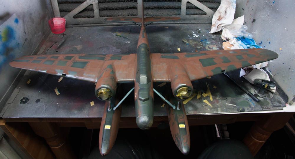

Have made some progress on the He 115, started with a coat of Ultimate black primer and then painted it in MR Paints Swedish colors, 058 blue grey for the under side and 328 dark olive drab for the top with the walkways in 325 olive drab. I then added a few drops of white to the 328 to lighten it and used it to bleach the panels on the top of the plane. I really like these MR Paints, they spray nice, the colors looks great, dries fast and can be masked over within minutes.
I have the Meastro Models decal sheet for the Swedish markings, but it's missing one decal. It's a warning sign that where put on the floats under the propellers that says "Varning för propeller" or Caution propeller in English. Luckily there is a good image of the sign in a book I have about the Swedish torpedo bombers. So I scanned the book, took the image into Adobe Illustrator to clean it up and convert it to a vector file. This way I can scale it without loosing any quality, it also makes it really easy to change the colors of the background and the text. When I had something I was happy with I printed it on white decal paper, cut it out and used it as a normal decal.
Also got the rest of the decals on, it's nice with a plane with only 14 decals as it goes pretty qiuck.

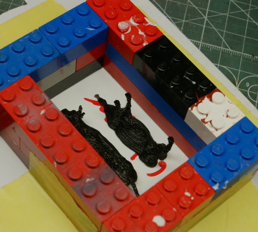

As I managed to find a really nice resin cow I'll be using it instead of the 3D printed one. The printed one would have worked, but it looked a little bit too static. Still have some detail painting left to do, now it's just sprayed in NATO black and one coat of white brush painted on.

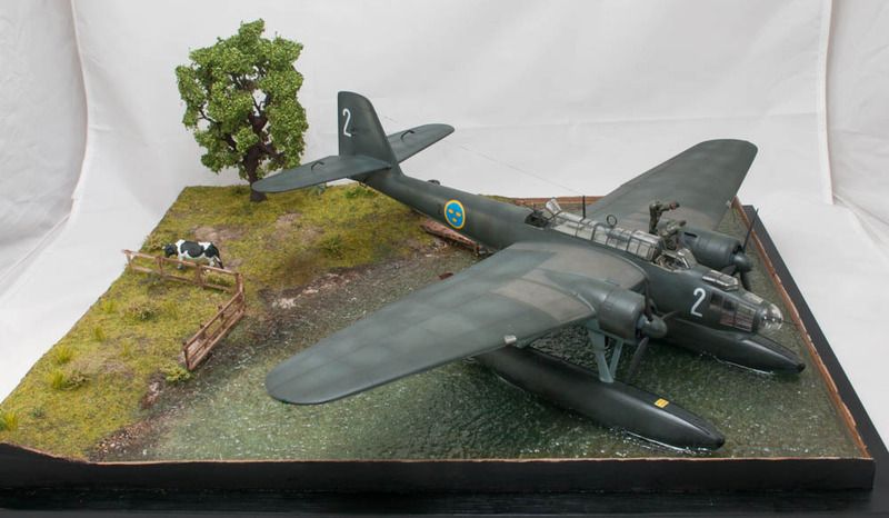

Time for a final update. Added the boat and the final layer of water, it's a bit too calm and needs some waves.
So I used an old brush to dab Deluxe Materials Making waves in a random pattern over the whole surface.
I also picked up a small oak tree from the rail road shop, it could be a little bit bigger but it works. The trunk was a bit boring so I dry brushed it with a few brown colors and added a Ultimate earth wash to it.
When that was done I placed all the things, figures and cow to the base, added the antenna wire and calling it done.
