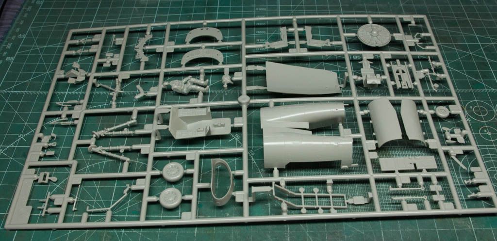

I wasn't planning on building this kit, but when I found it cheap at the hobby store and a resin cockpit set for 50% off I thought I would give it a shot. The kit decals are really old and yellow, so I need to get some new ones also I'm going to try to get a resin landing gear bay as the kit one is completely bare. The rest of the kit looks pretty good with some nice surface details considering the age of the kit.

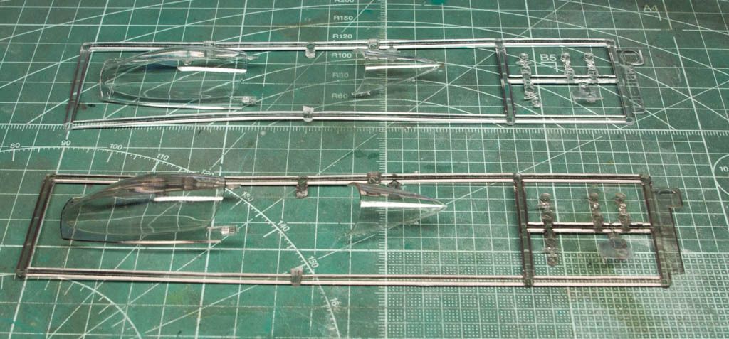

the pre colored canopy is a nice touch

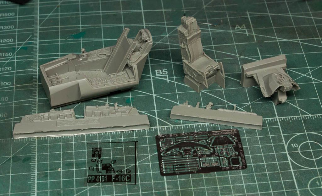

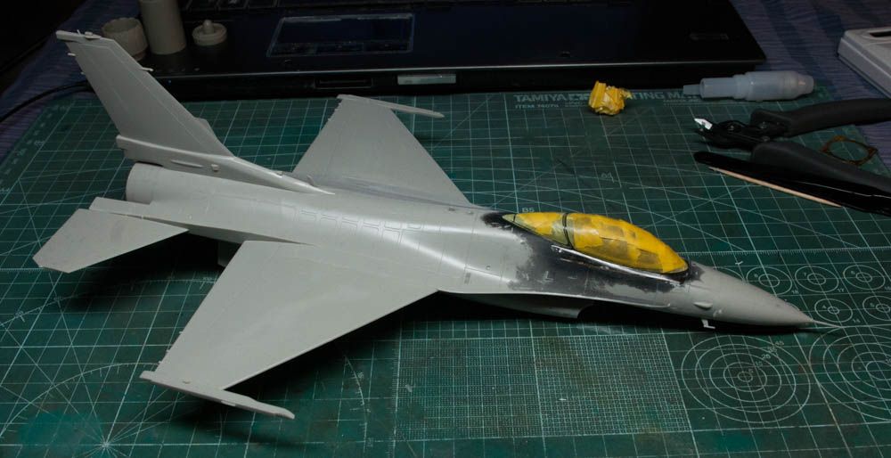

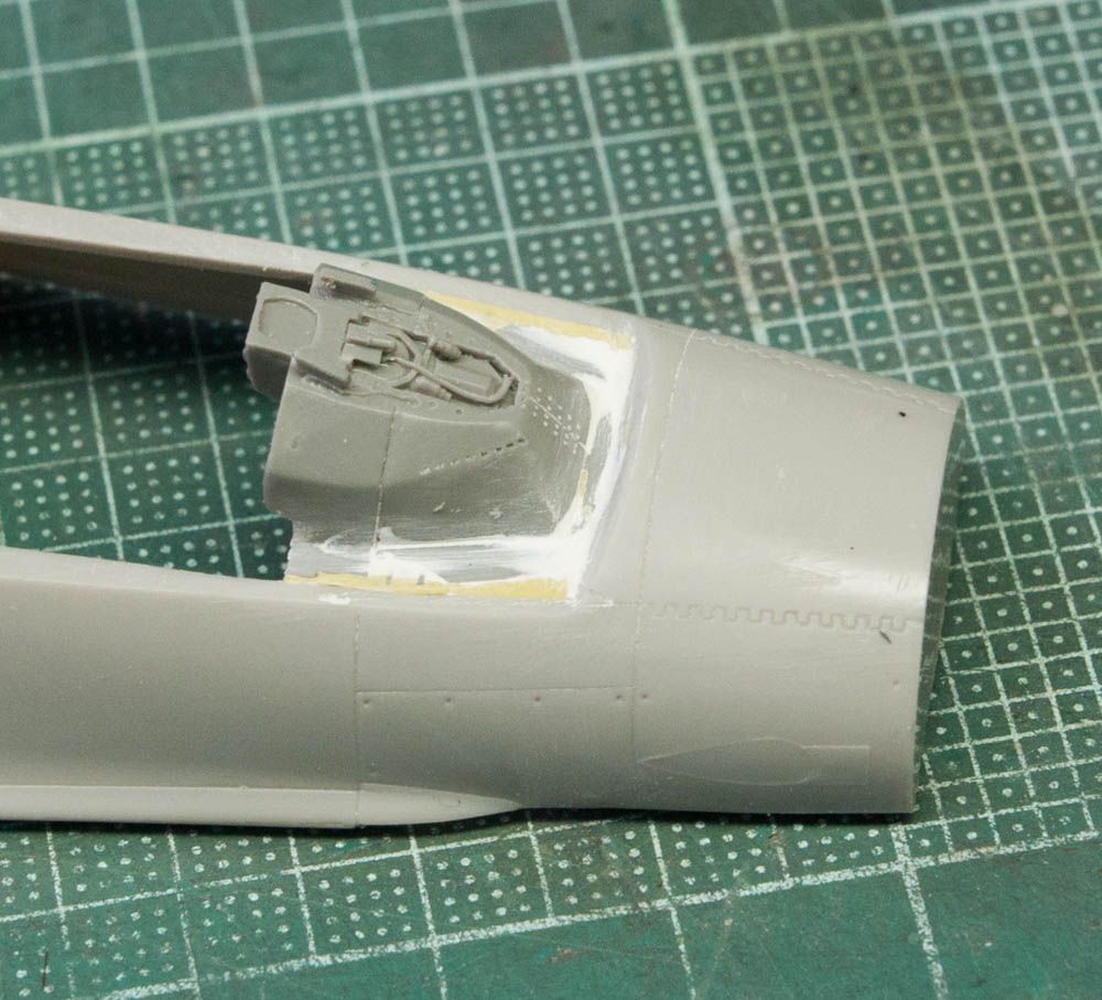

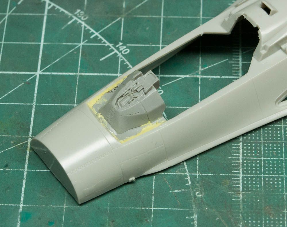

First thing to do was to cut out the cockpit to make room for the resin one, the instructions where a bit vague where to cut so I removed a bit to much around the instrument panel.
I used some Milliput to fill the gaps and then used thinned Tamiya putty to smooth the result.

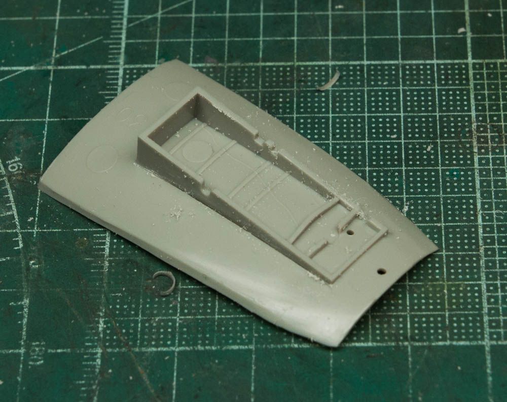

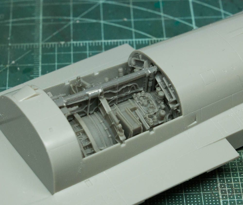

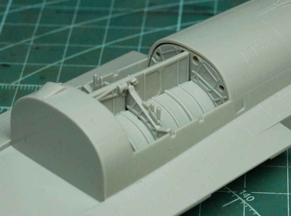

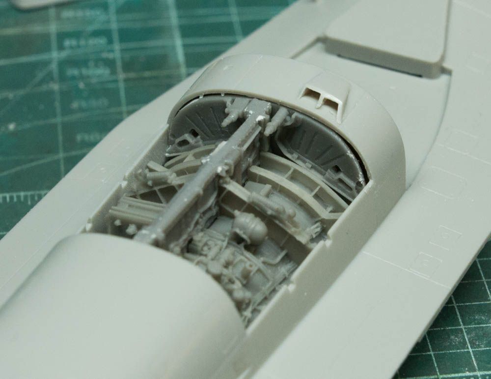

The kit landing gear bay are sparse to say the least, and the front one has a big, nice EPM in the middle. So I'm replacing that with resin as well.

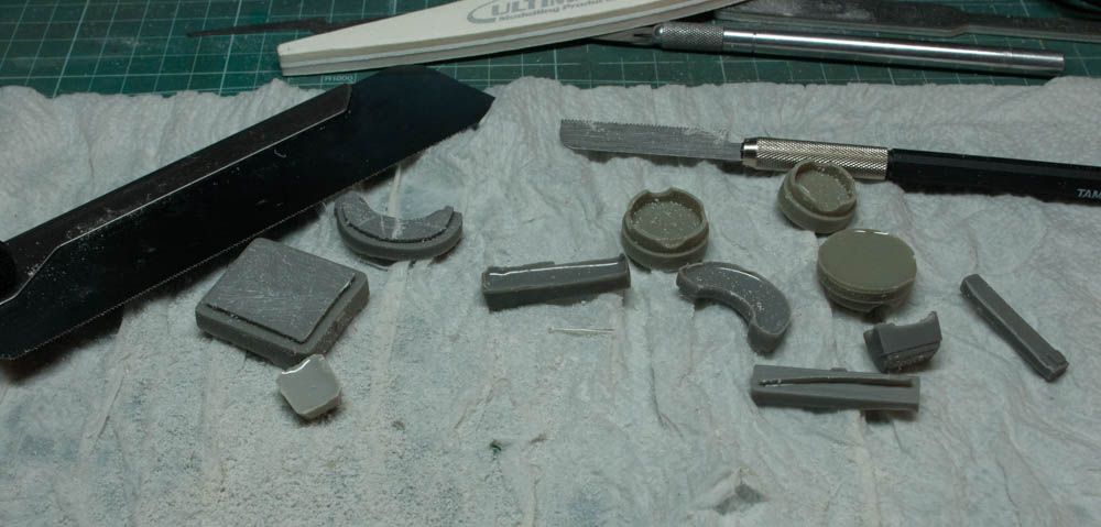

So after a bit of cutting to get rid of pour plugs on the resin parts as well as cutting out the kit ones.
And fitting the resin ones. The fit of the front one was good however the front wall of the main was a bit small so that will need to be filled with some Milliput.

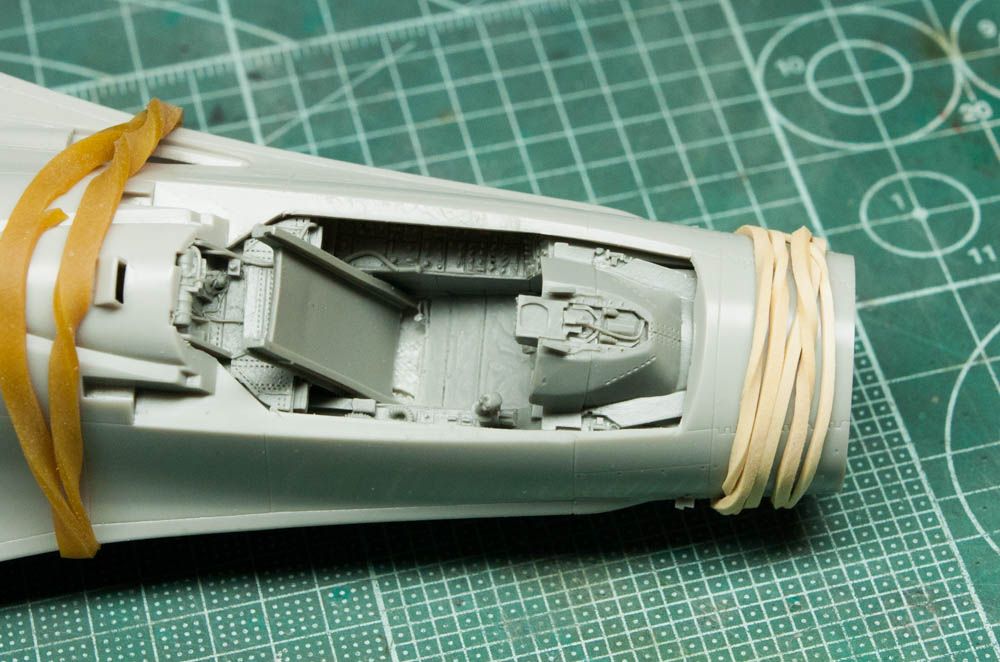

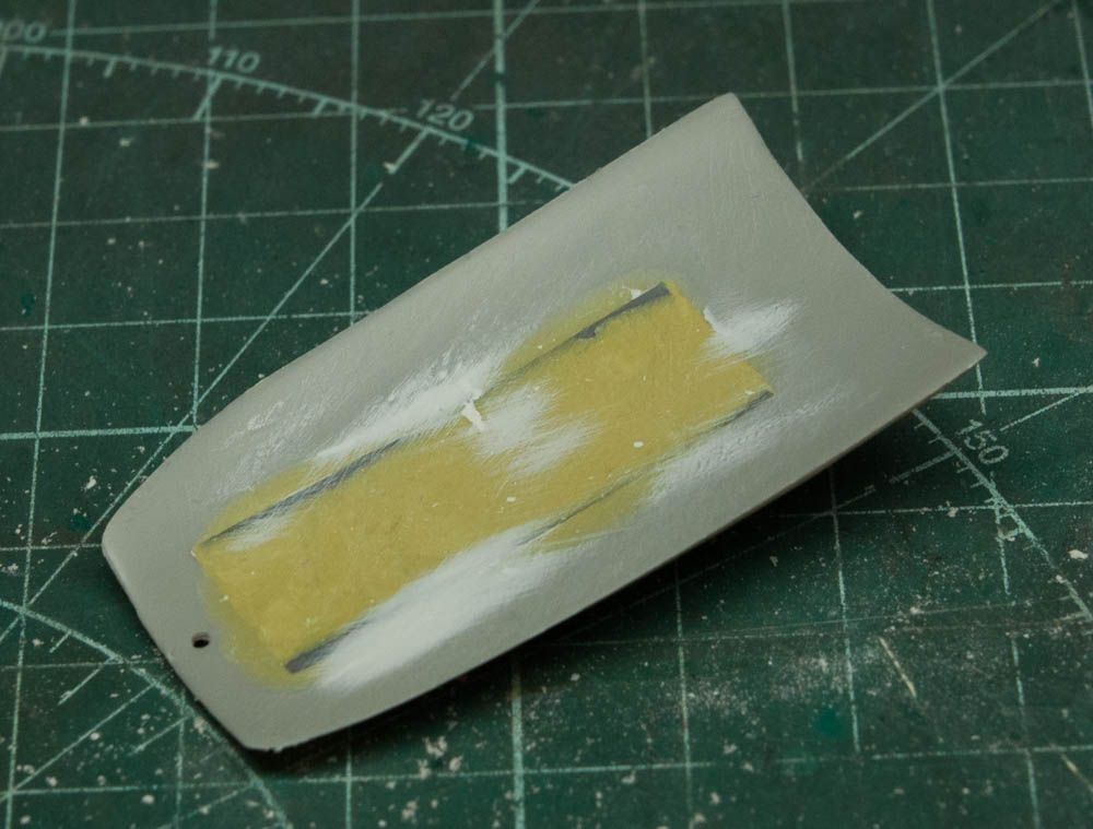

Have done a bit more work, first was to fit the front landing gear bay. Since you need to cut out the plastic one, the resin also has part of the inside of the intake. The fit is not the best and needed a couple of mm of filler. I used Milliput as it's a two component filler and shouldn't shrink like a normal one component, like regular Tamiya putty.
This was then sanded and given a really thin layer of Tamiya putty just to smooth the edges.

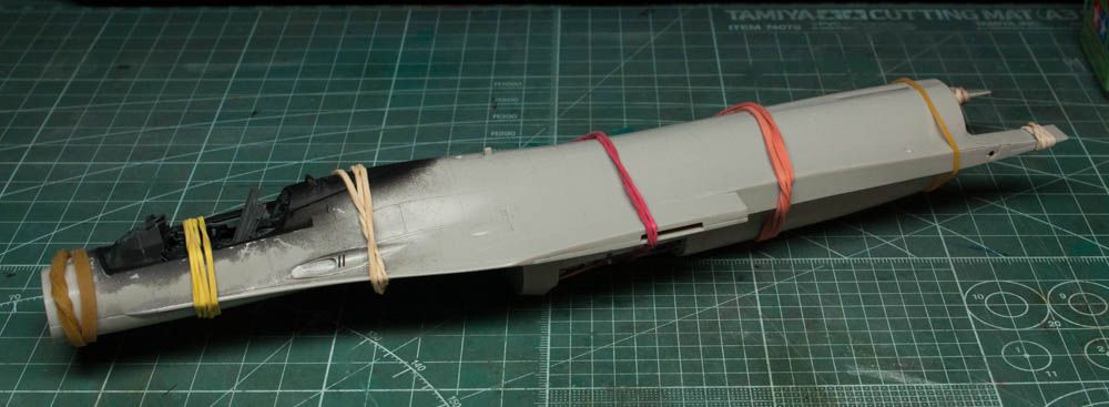

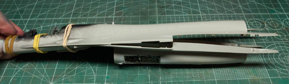

The fuselage was a bit warped and needed a few rubber bands to close.
It only needed a little bit of filler in the front, I think this could have been avoided if I had spent a bit more time fitting the cockpit because when I test fitted it with the kit cockpit it looked like it wouldn't need any filler.

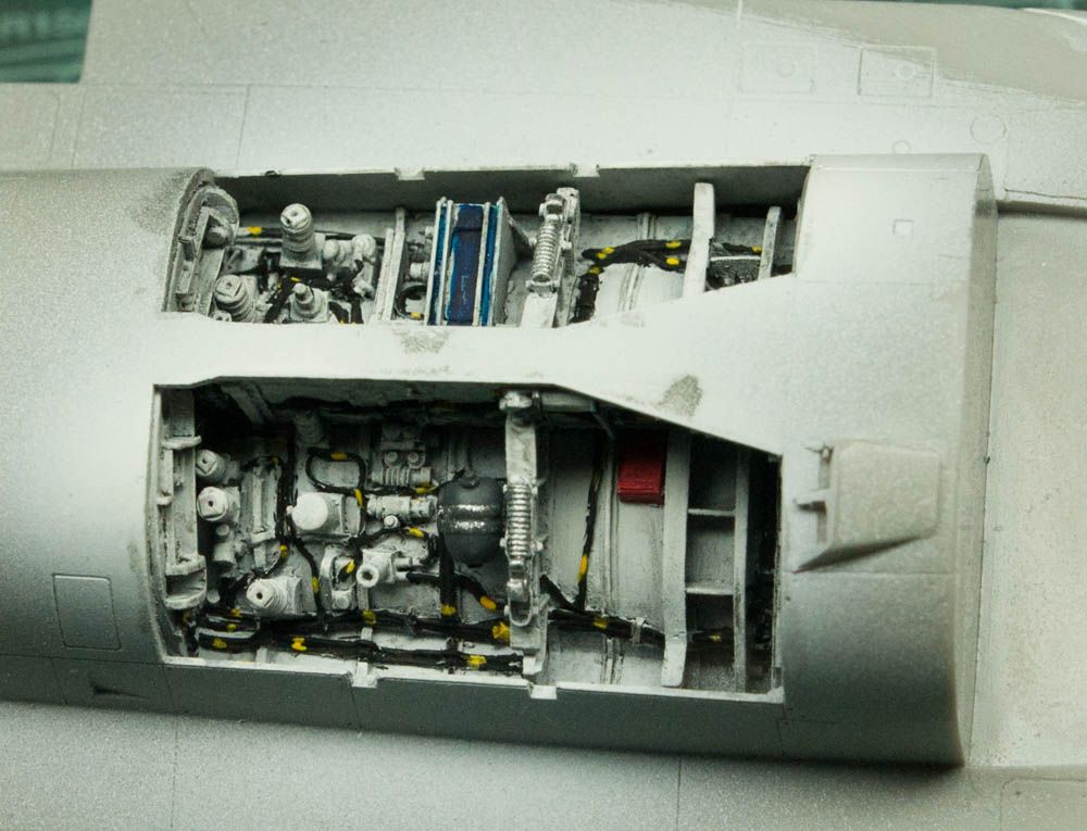

Also got the landing gear bays painted, just sprayed white and detail painted. Finished it off with some AK landing gear wash.

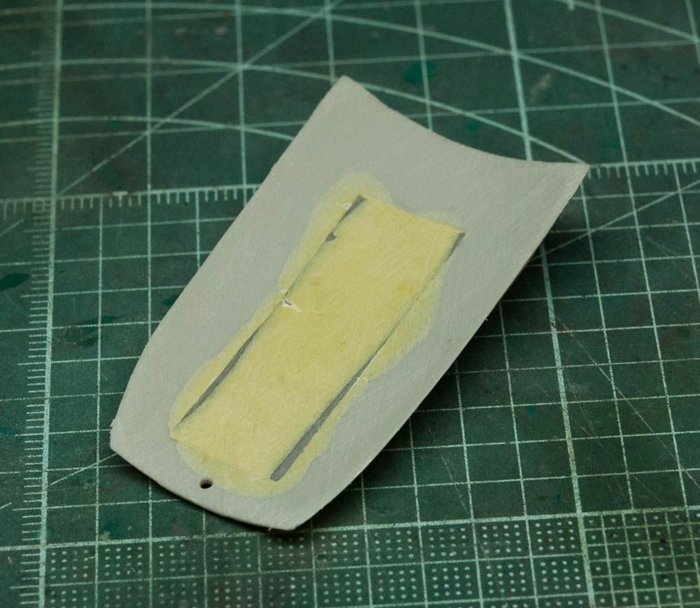

The progress on this has been really slow lately since I needed a mask set that I finally got the other day so now I can start painting.
All build and masked waiting for primer.
Used the Badger primer for the first time for this. I have been thinking of getting some for some time but it cost quite a bit here in Sweden. But I went and got a bottle today, wow, now I understand why everybody is praising it so much. Sprayed perfectly and gave a really nice and smooth finish.

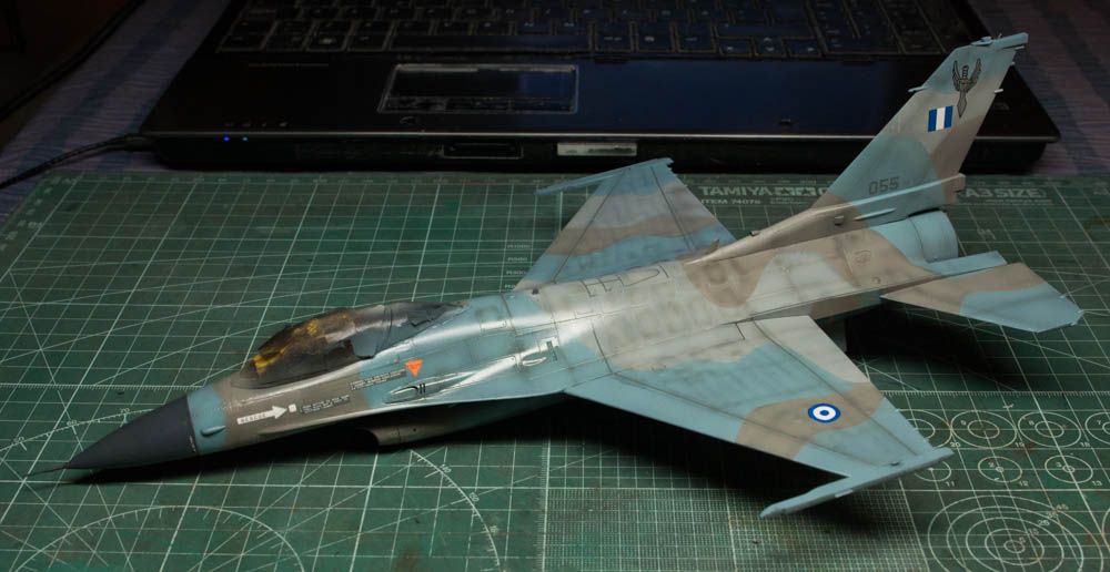

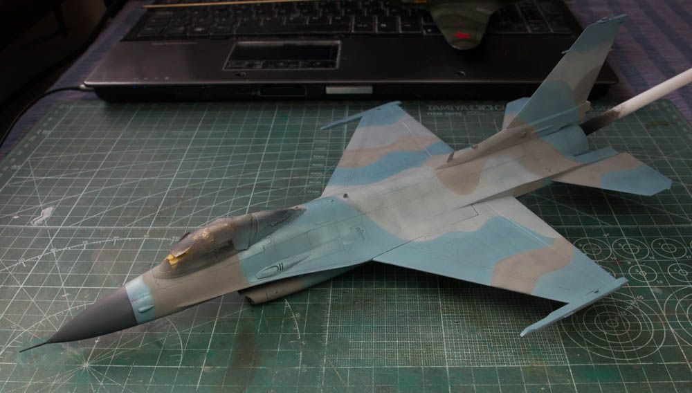

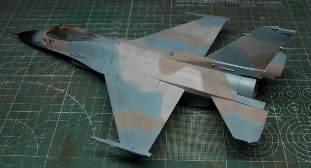

Managed to get some paint on it, was a bit unsure about the colors to use. The decals says that the light grey blue should be FS35237, but I think both the Vallejo and Gunze versions of this is way to grey so I mixed something that I was happy with using Gunze H337 and H323. The other colors are MIG Ammo FS36270 and Tamiya XF-20. I did have some paint peel off when I removed the masking, this was around the cockpit where I had some over spray so I will need to touch up those areas.

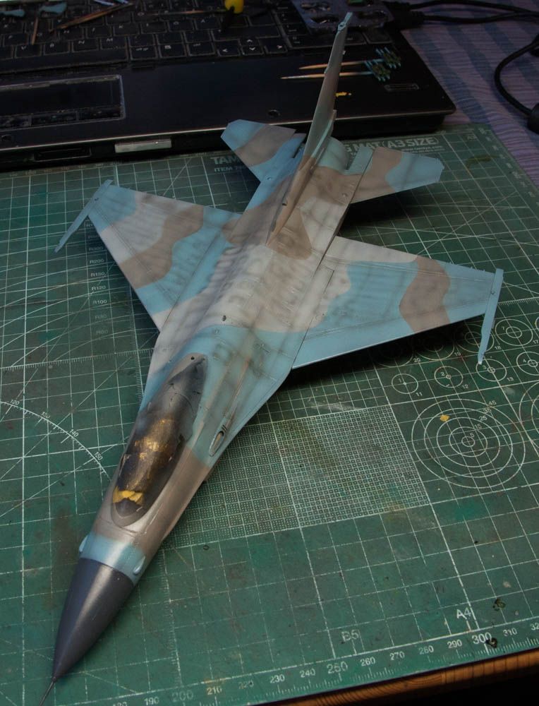

I have touched up the spots where the paint pulled off, then added some post shading using Tamiya Smoke and also added some light streaks using the smoke. Now it's time for decals, luckily it's not too many.

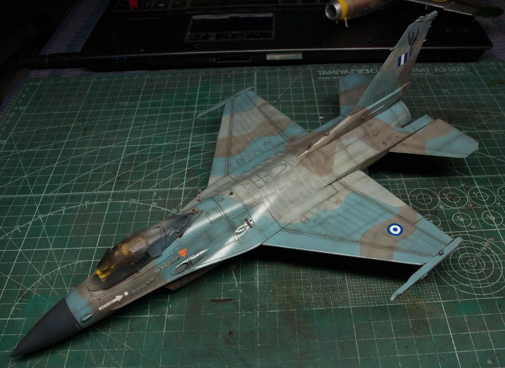

Re: 1/48 Hasegawa F-16C
Post by JonMW »

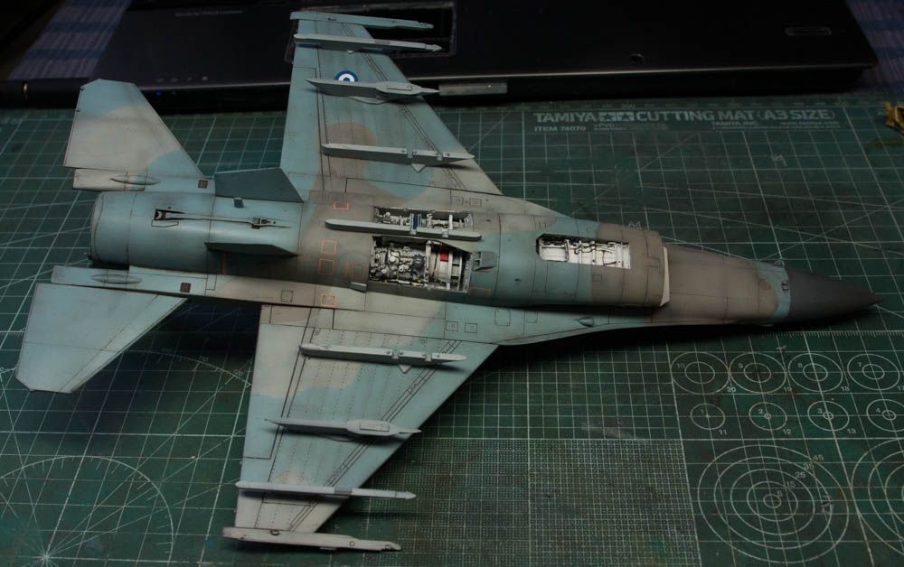

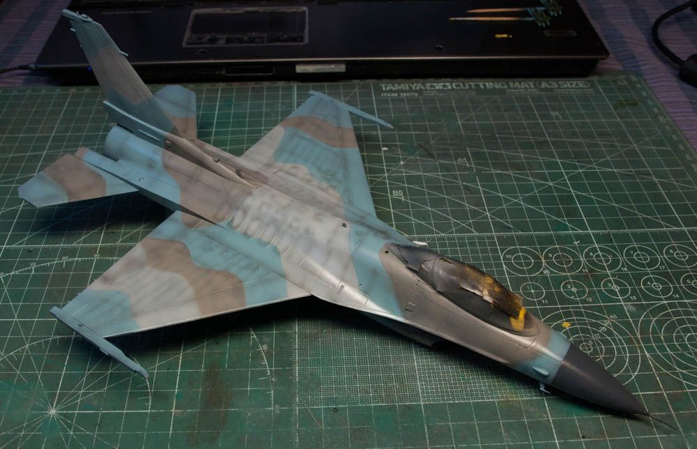

Have managed to get quite a bit of work done on this. First got all the decals on, most of them went well, however two where missing all the carrier film so I couldn't use them. And the decal instruction could have been a bit better, like the lines on the top that has no numbers and nothing to tell which goes where.
Then added a second coat of aqua gloss followed by a dirk dirt wash.
And finally a flat coat.
Painted the engine in a few different metal colors, will need to add a bit of weathering.
Very, very nice work, especially that paint job! :th:
That looks very nice
but just to make sure i understand it
Did you used the tamiya smoke on the panel lines after you painted the camo colors
and is that in a similar way you would do pre shading but on top of the camo instead of under the camocolors
JonMW
Posts: 987
Location: Stockholm Sweden
Post by JonMW »
Thanks for the comments!
MarkVerploeg wrote:That looks very nice
The idea was to get something similar to the effect of pre shading, but also adding some streaks and dirt at the same time.
