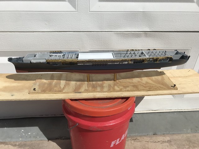

tommym
Posts: 126
Joined: Mon Feb 16, 2015 1:40 am
Location: So Cal
Re: !:350 Merit USS Enterprise CV-6 with Ifini Photo Etch
Post by tommym »
I had to stop with the photo etch for now and protect the hull. The PE was getting too delicate to handle and I needed to start gluing some down to the hull.

Time to provide a temporary cover for the hull and future work.
Ripped some scrap pine down to 3/4 “x 3/4”
ImageIMG_3264 by Tommy Mejia
Cut to Size
ImageIMG_3265 by Tommy Mejia
Glue and pin nail
ImageIMG_3267 by Tommy Mejia
ImageIMG_3269 by Tommy Mejia
Fitting on larger base
ImageIMG_3271 by Tommy Mejia
Wrap in plastic
ImageIMG_3274 by Tommy Mejia, on Flickr
Hull is protected from dust.
ImageIMG_3272 by Tommy Mejia
Sure is fun and easy to make with power tools ;)
Tommy 8-)

Productive weekend for me.
Began adding the Ifini photo etch to the front Port side.
ImageIMG_3273 by Tommy Mejia
Continued adding detail
ImageIMG_3282 by Tommy Mejia
Size comparison
ImageIMG_3278 by Tommy Mejia
Bracing under 20mm tubs
ImageIMG_3284 by Tommy Mejia
Onto the Port mid section
ImageIMG_3287 by Tommy Mejia
Front and mid section laying next to each other.
Dragon is another project I am currently painting.
ImageIMG_3286 by Tommy Mejia
Parts Bent and folded into shape waiting to be attached.
ImageIMG_3288 by Tommy Mejia
Currently where I am at on the Port mid section.
ImageIMG_3290 by Tommy Mejia
Tommy 8-)
