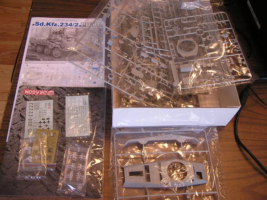

Box color reference.
Sprues, instructions, photo etch etc.

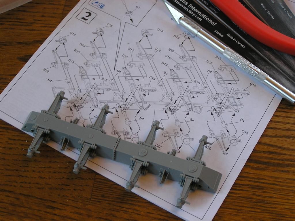

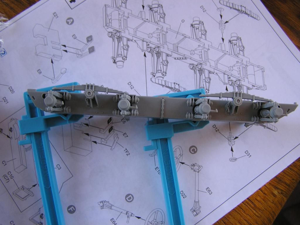

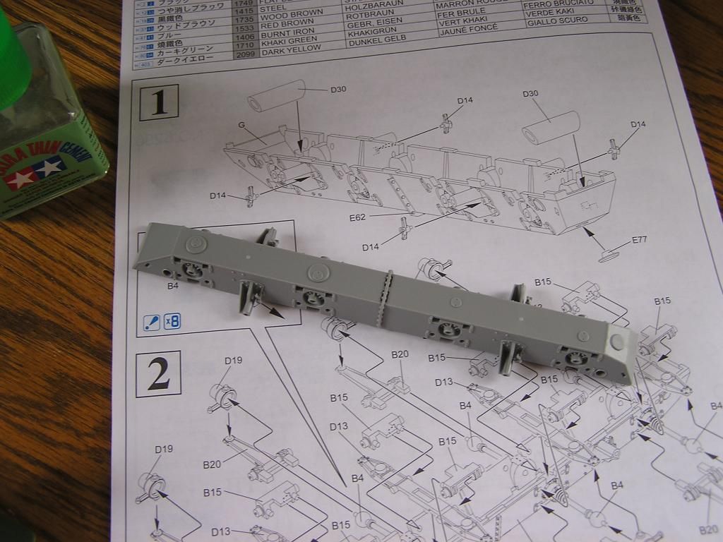

Step 2 completed.
Typical Dragon vague and convoluted Instructions are as always hard to follow.
So I cut all the parts off of the sprue and did a test fit before gluing to make sure everything lined up.
Step 3 completed

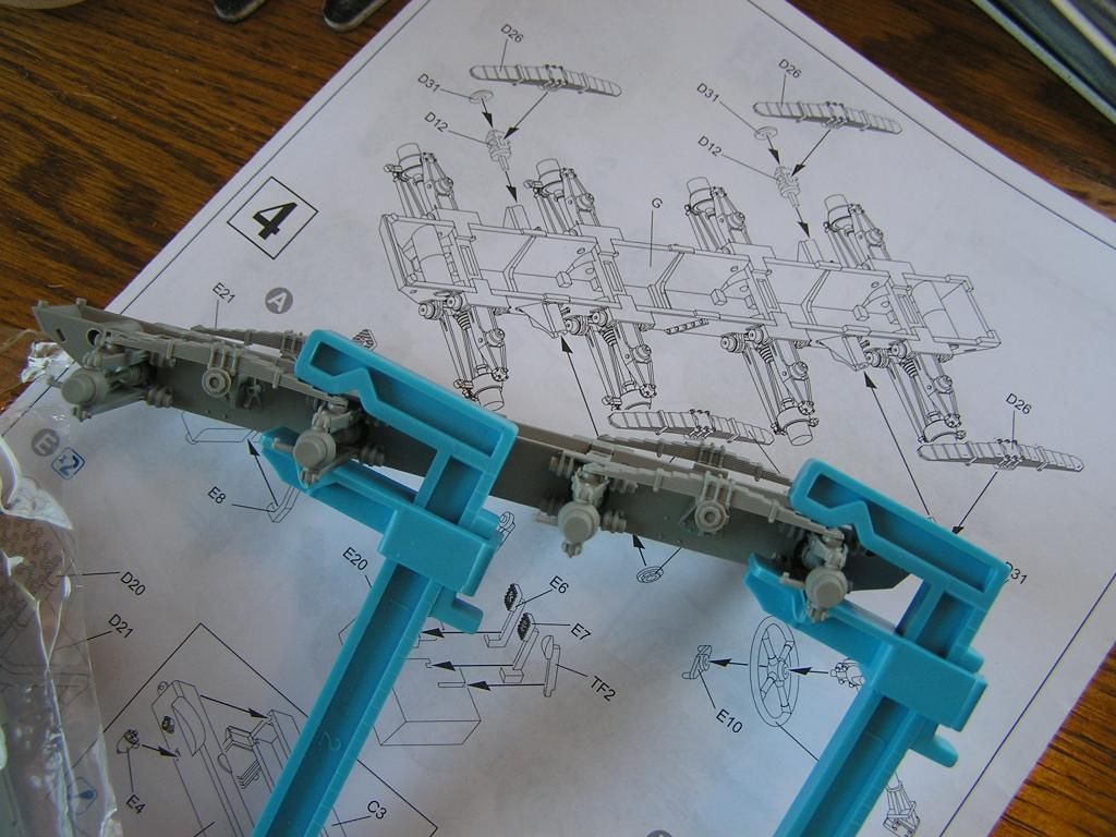

Had a good size gap on both sides of the 4 leaf springs.
I solved this by using Tamiya extra thin on one side 1st and then when that dried I glued and clamped down the other side.
No problem but again the instructions clearly show a spacer under the springs that doesn't exist in the kit.

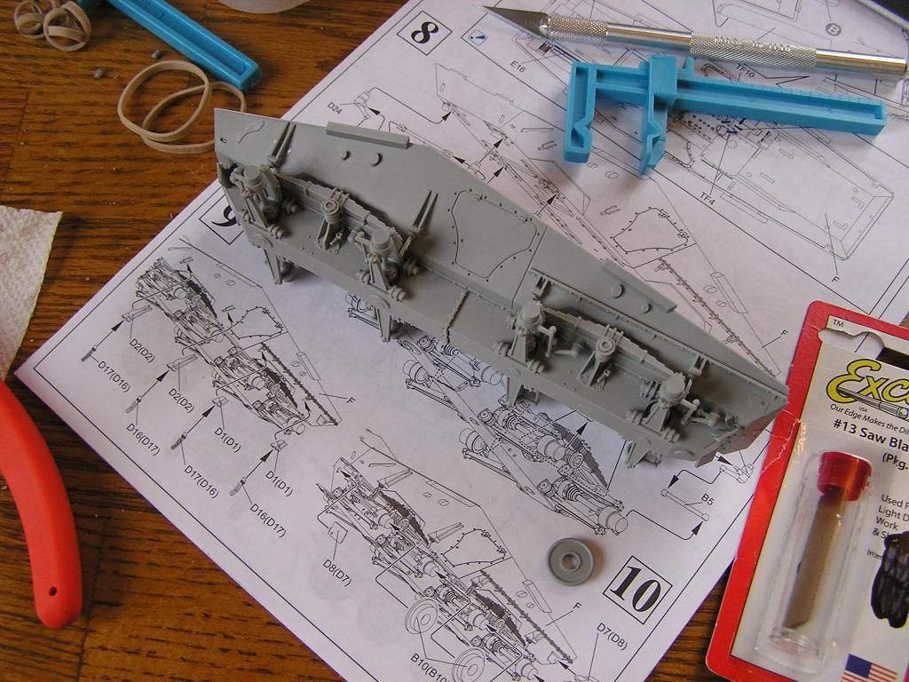

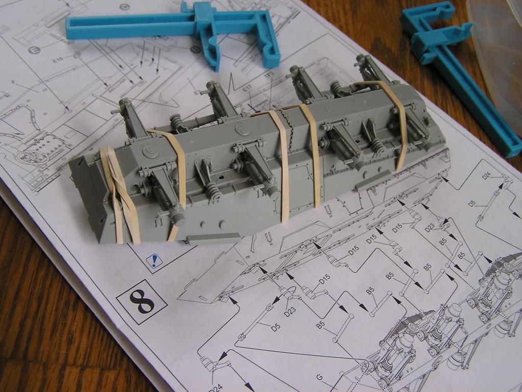

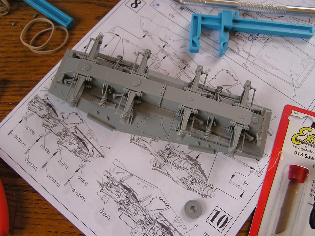

Suspension Cont.
For some unknown reason at part 4 the instructions have you leave the suspension and move onto the interior build.
I decided to jump to part 8 thru 10 to finish the suspension.

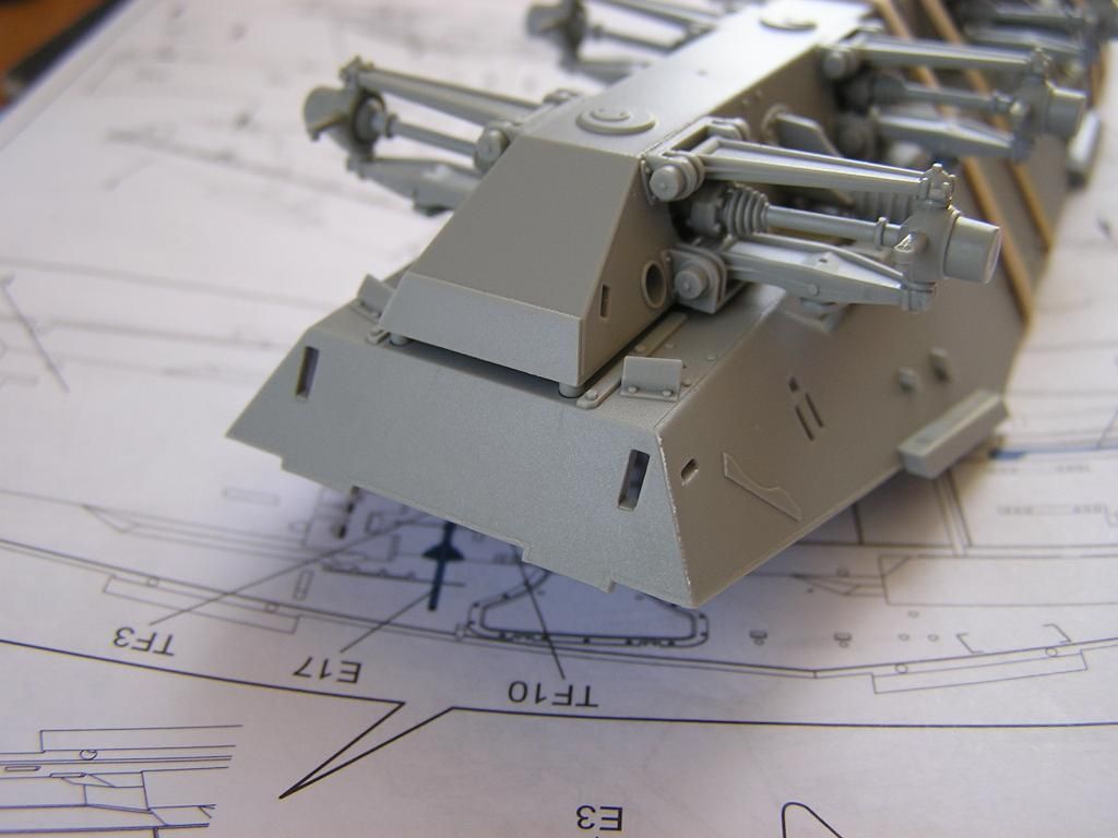

Attaching the lower hull to the suspension.
I little bit if a gap that was removed by gluing one side 1st then working across.
The completed suspension.
I decided to leave the wheel hubs off so I could prime the lower hull/running gear easier.
I will attach them directly to the wheels later.
PS I screwed up during the build and was able to fix the problem with a Excel #13 saw blade.
Can any of you spot the mistake I corrected?

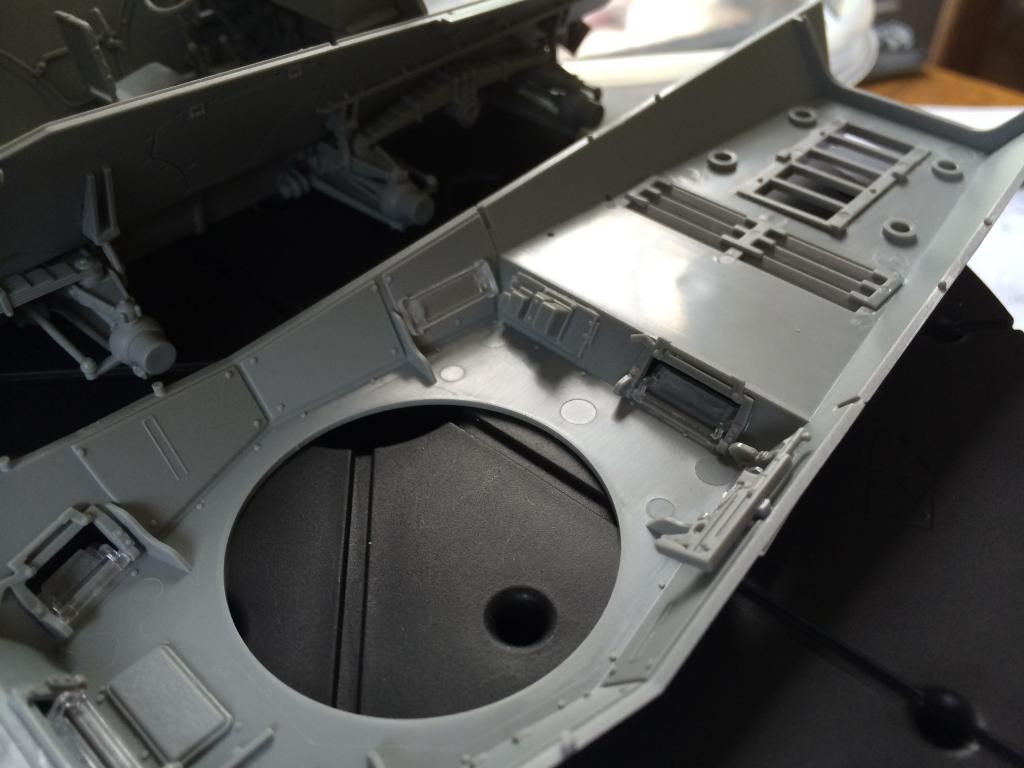

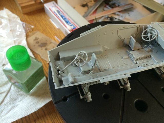

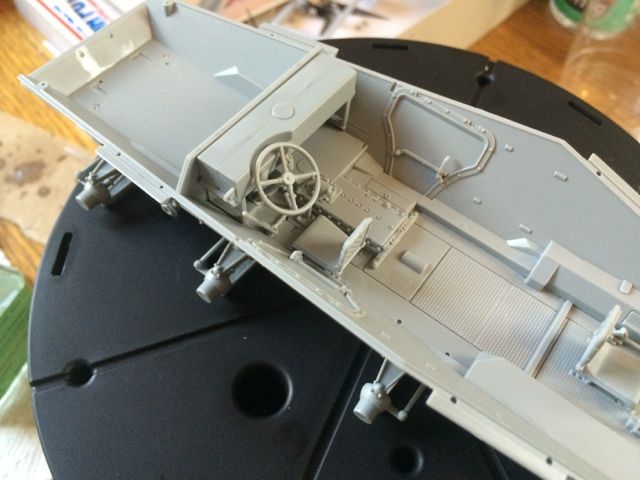

Lower hull interior build steps 4 thru 7 complete.
Front drivers seat.
Rear drivers seat.

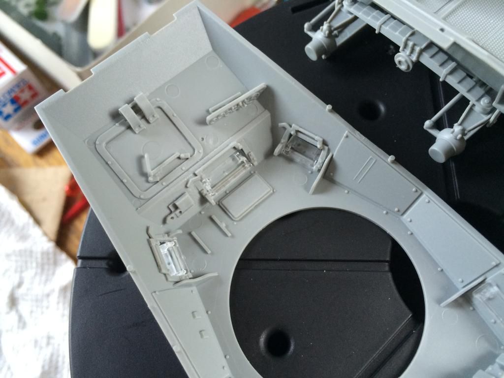

Upper hull interior build steps 11 thru 14 complete.
Front drivers position, drivers upper hull escape hatch can be displayed open or closed.
The 2 lower hull escape hatches can only be displayed closed.
Rear drivers position, all visors are movable.
I have 5 small parts that mount onto the visors but I have yet to figure out how they go on.

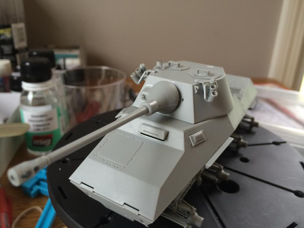

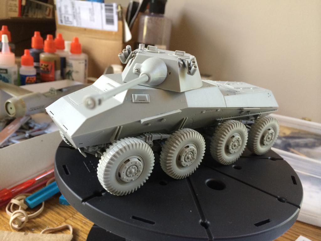

Step 21 thru 24
The turret was a pretty straight forward build with no issues.
In the background you can see some of my unfinished misfit toys.
PS. I got a new Iphone 5S and this thing takes very nice photos!

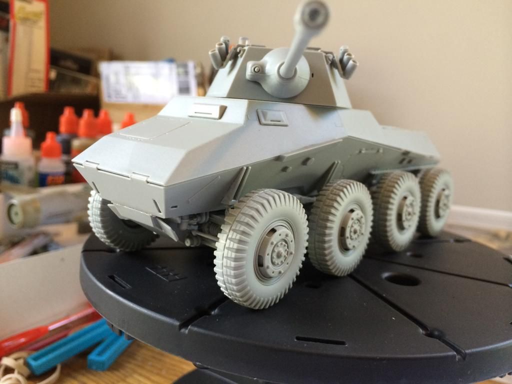

I continued on to step 24 to finish the tires.
To seal the small open gap in the center tire tread I used Tamiya super thin glue to melt the pieces together.
The hull half's still haven't been glued yet because I'm debating what to do with the interior.

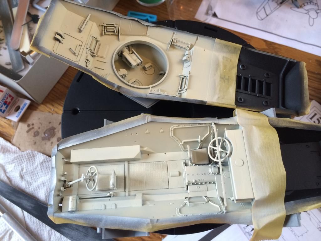

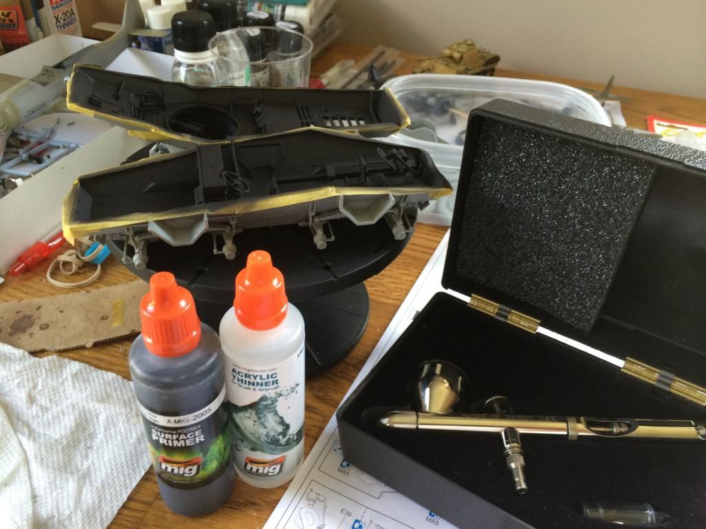

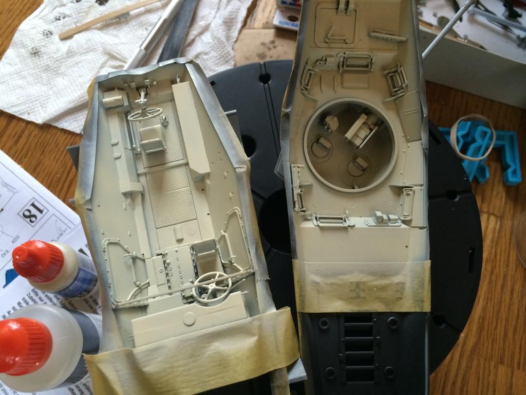

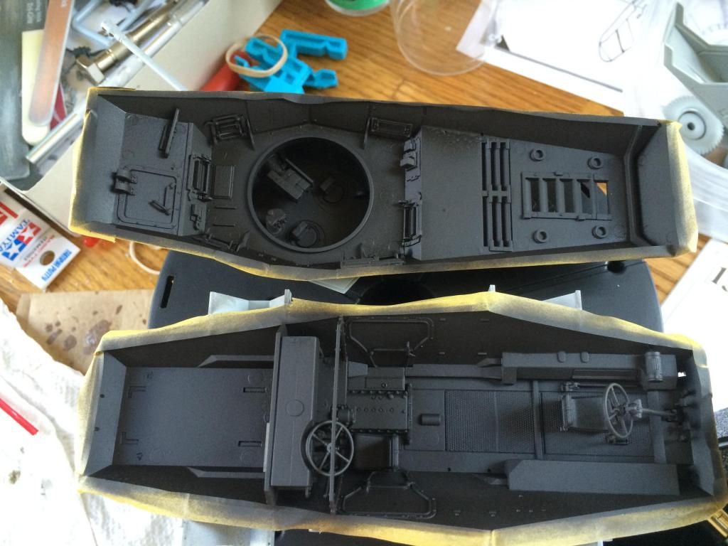

I decided to prime the interior and paint it before continuing with the build.
I used my Badger Patriot 105 to apply Ammo of Mig Black primer with 25% thinner at 15 psi air pressure.
I allowed the primer to dry for 4 days.

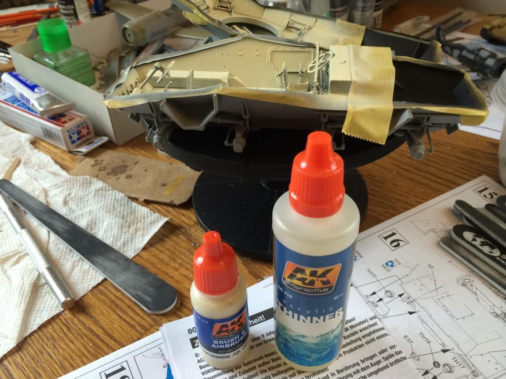

I then painted it with AK Interactive RAL9001 Cremeweiss AK092 with 33% thinner at 13 psi air pressure.
I like the way the black primer gives the interior some subtle preshading.
I left the engine section black to hide it when looking in the open air intake grills.

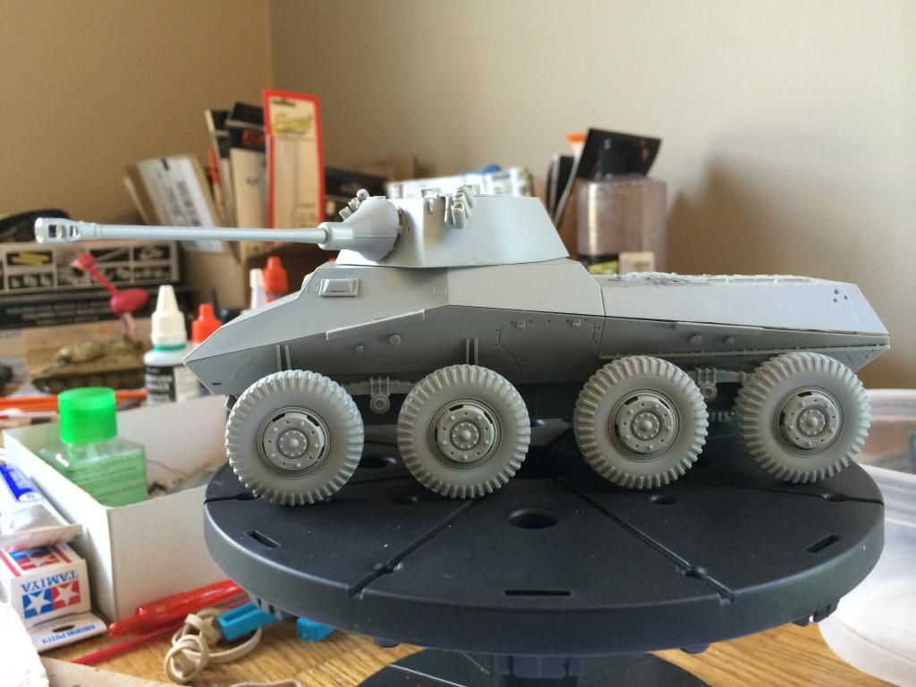

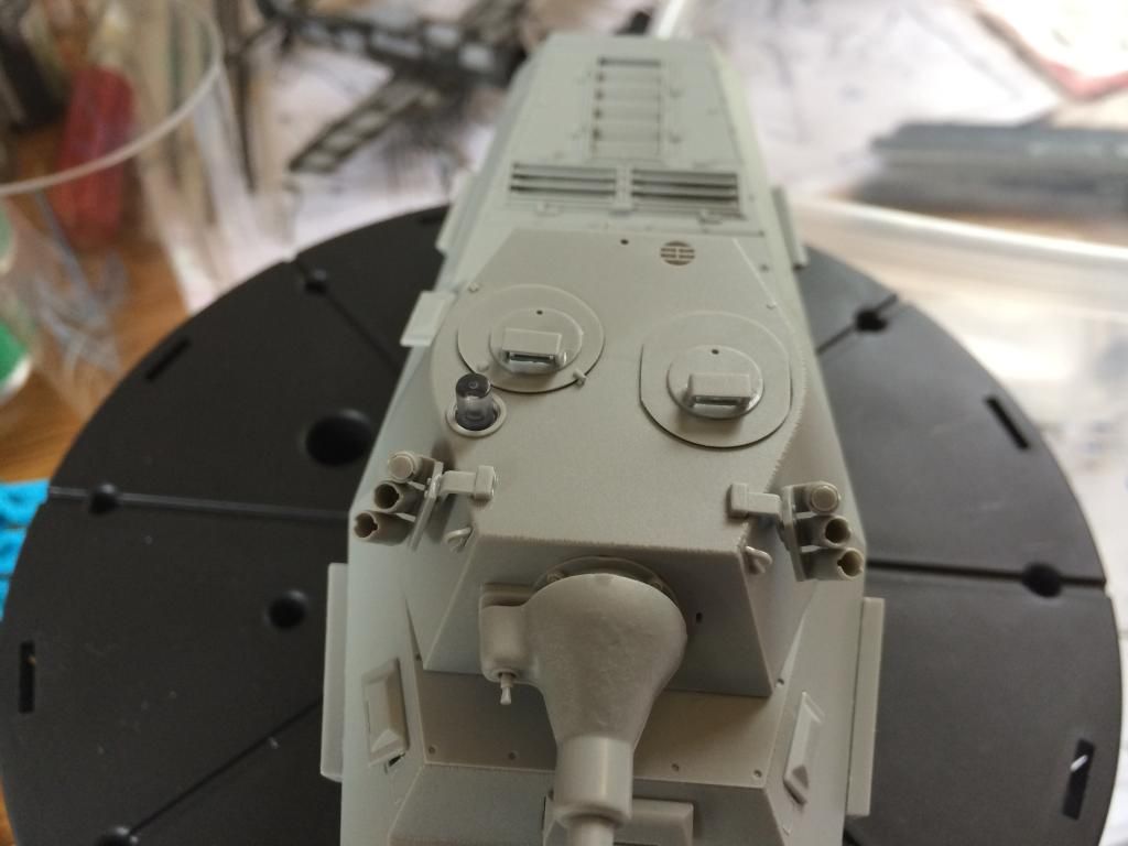

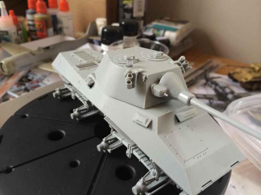

I finally finished the assembly part of the kit.
Now begins the painting.
I primed with Ammo of Mig Black Primer A.MIG-2005 for a pre-shade on the undercarriage, turret, pioneer tools and wheels.
I then over sprayed with AK Interactive Dark Yellow Primer AK176.
Update:
I installed and primed the antenna mount that I missed during the build.
I also primed the 9 wheel hubs AK Dark Yellow and painted the wheels with AK 720 Rubber/Tires to give them a worn look.
I used AK 712 Thinner and had no problems spraying the paint thru my Badger 105 Patriot.
