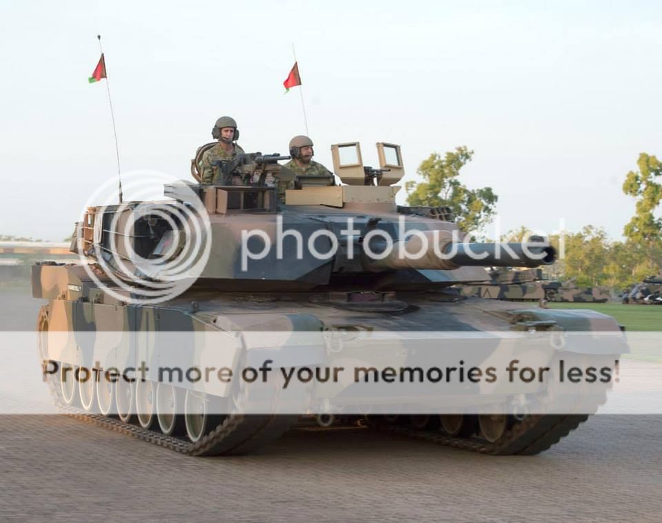

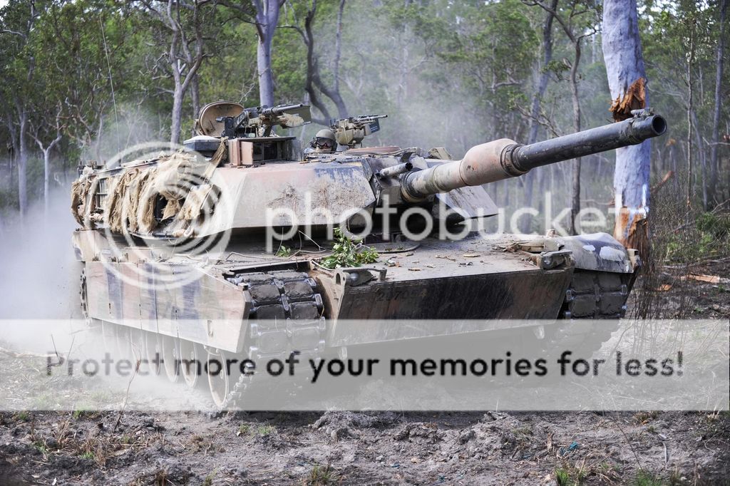

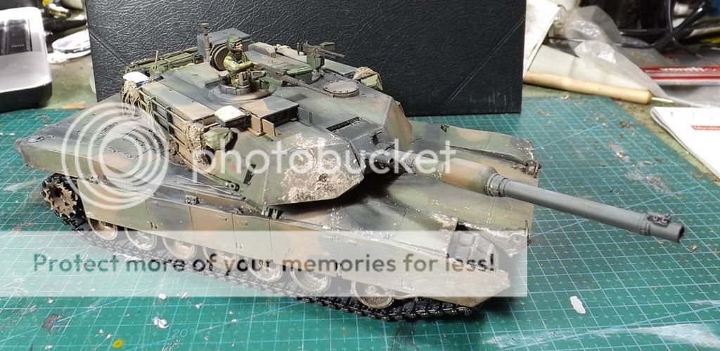

After 30 plus years of service for the Leopard 1 (AS1), Australia started looking for a new MBT. With due diligence the Defence Material Organisation hit the catalogues to find a replacement. They decided on the M1A1 Abrams.
General characteristics
Weight: 62,000 kilograms
Length: 9.83 metres
Width: 3.65 metres
Height: 2.89 metres
Crew: Four - Commander, Gunner, Loader and Driver
Overall performance
Power plant: Gas Turbine Engine 1119 kilowatts
Speed: More than 60 kilometres per hour; Cross-Country more than 40 kilometres per hour
Operational range: More than 400 kilometres
Smoke Grenade System: 66 millimetre Launcher Grenade M250
Aramment: 120 millimetre M256 Smooth Bore Cannon, 12.7 millimetre M2HB QCB Machine Gun, 2 x 7.62 millimetre MAG58 Machine Gun

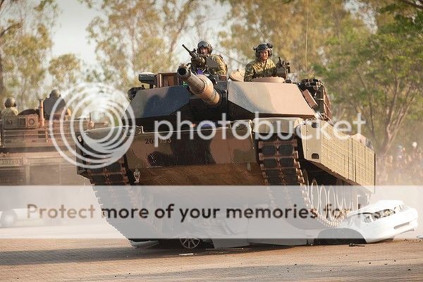

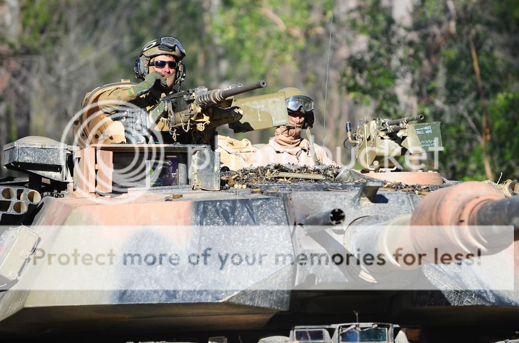

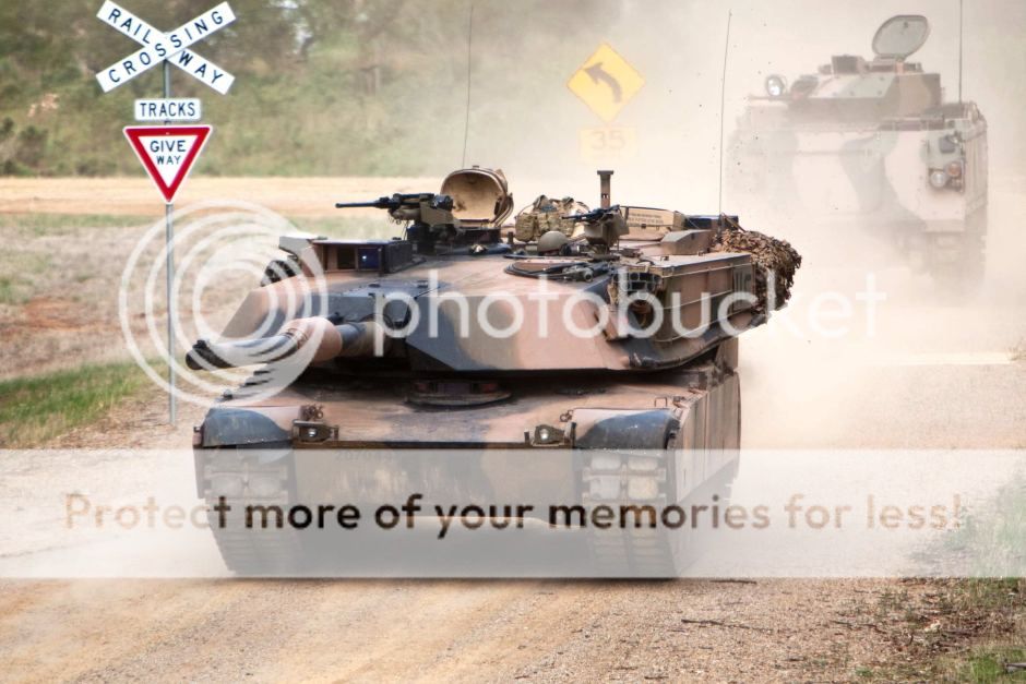

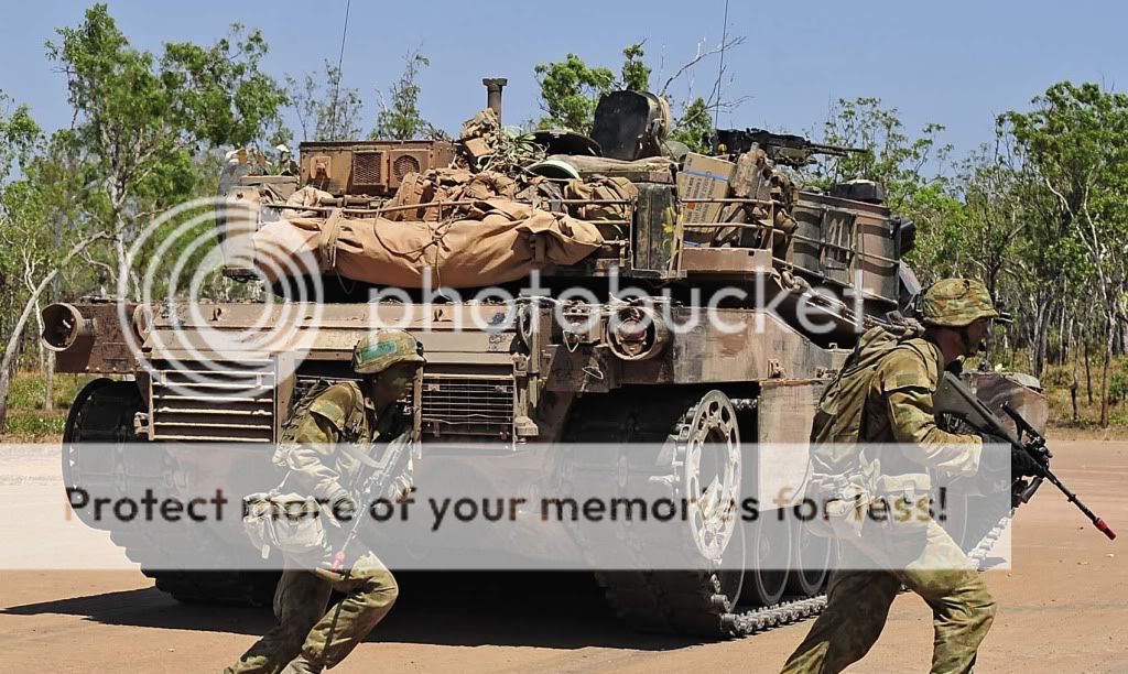

The Abrams is the most powerful vehicle in the Australian inventory. While retaining the gas turbine engines, the Australian Abrams tanks use diesel fuel instead of the kerosene based JP-8 that powers American Abrams tanks.
A total of 59 M1A1's were ordered, the first arriving in mid 2007.

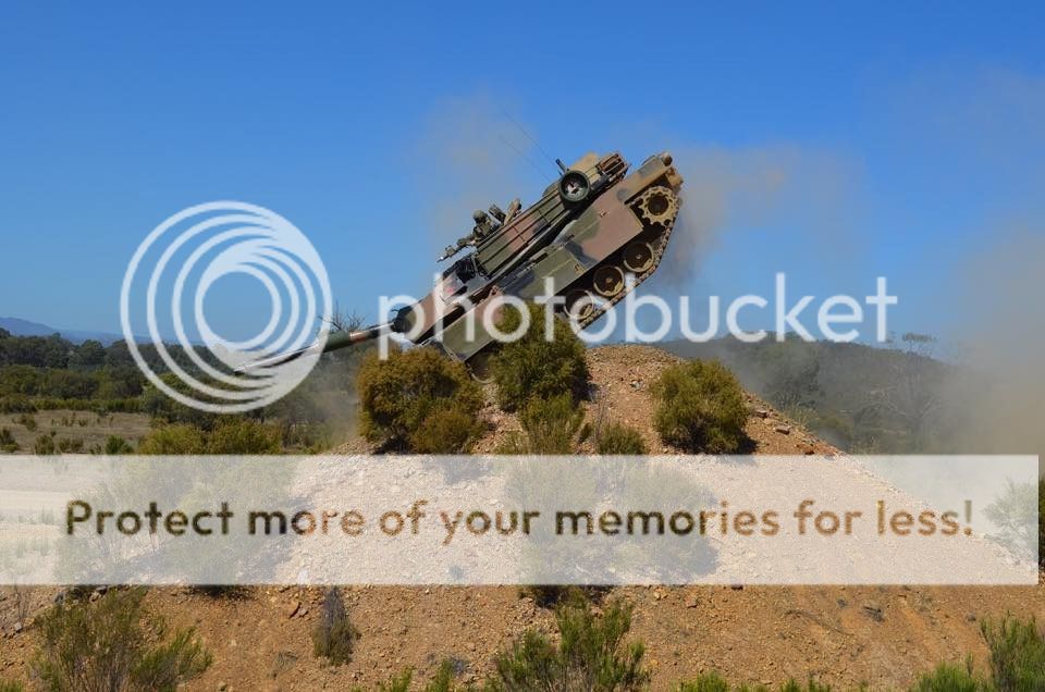

Training began, and the Abrams were tested out.
Satisfied, they were given there war paint and handed over to trained professionals.

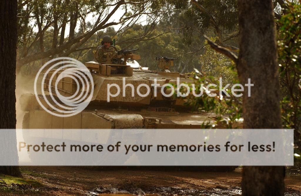

Once out of the car park they were packed up for a weekend away and sent bush.

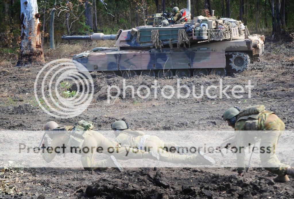

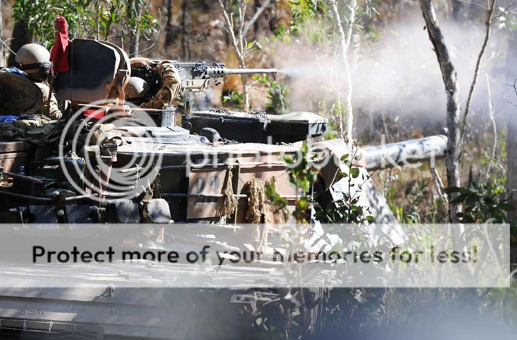

Notional enemies beware, Exercises under way. Contact.
Satisfied with a job well done. And, barely a scratch on the hardware.

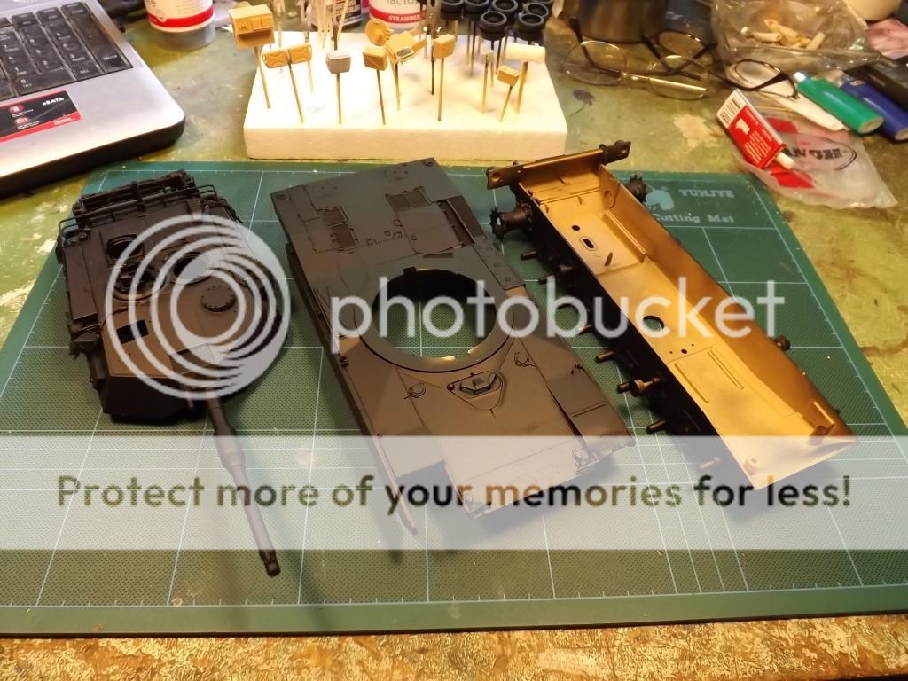

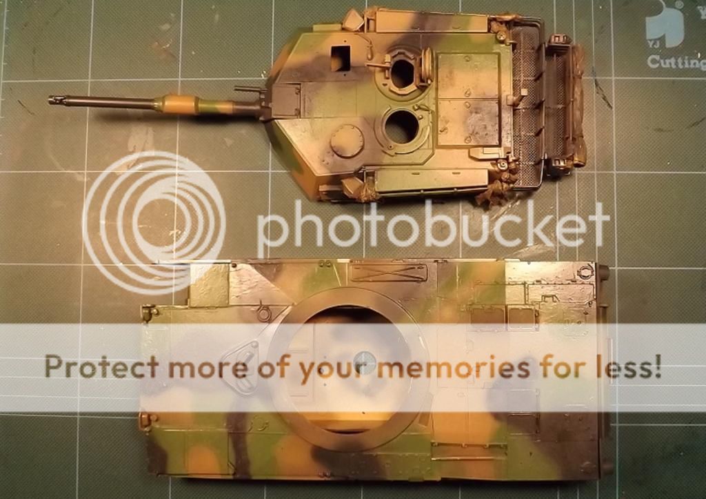

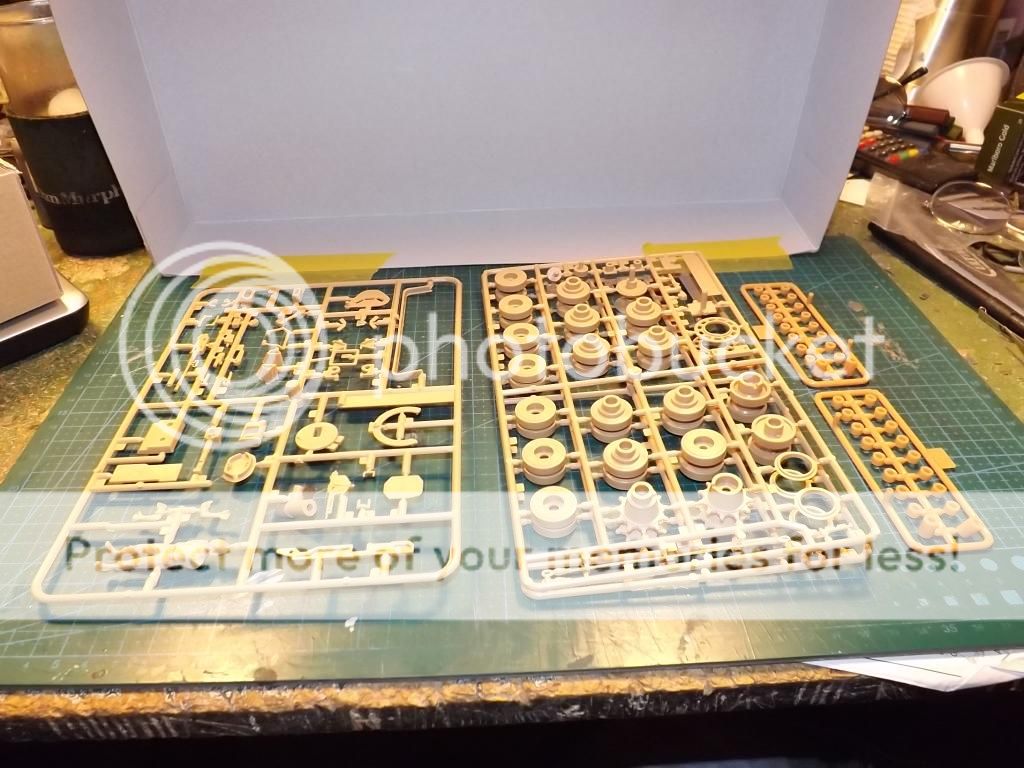

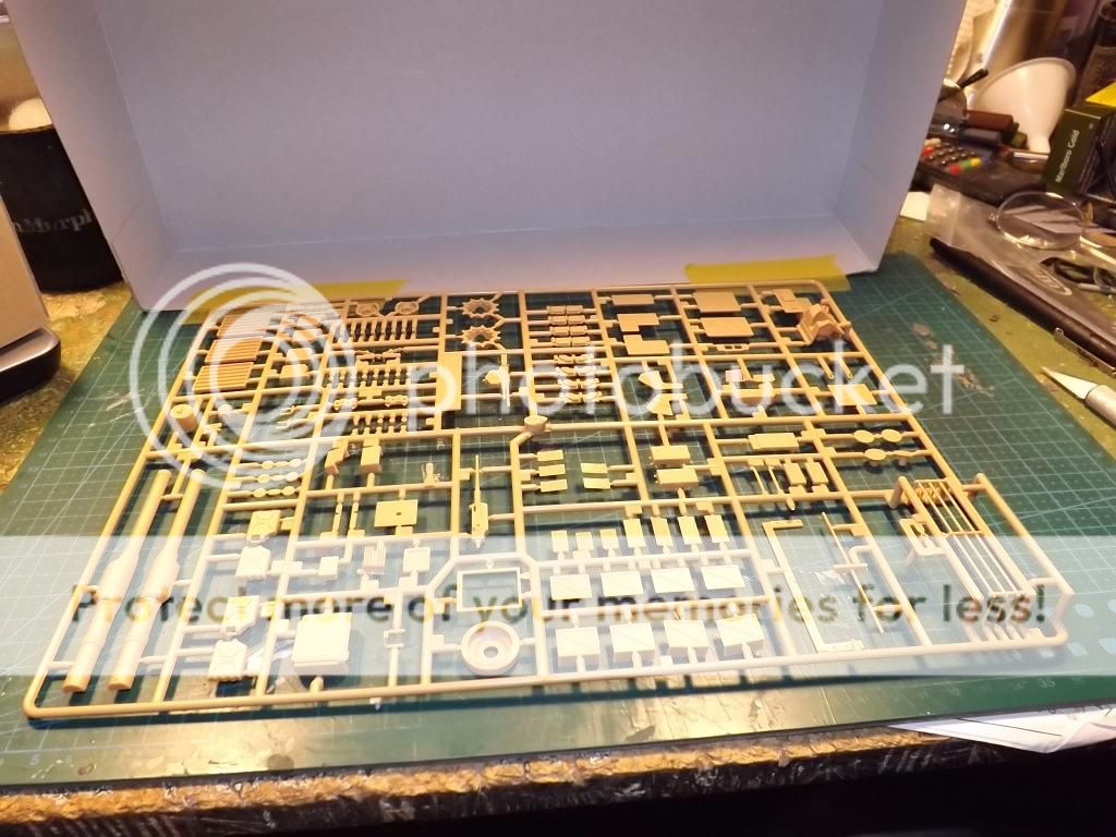

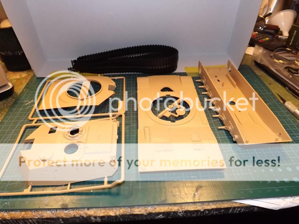

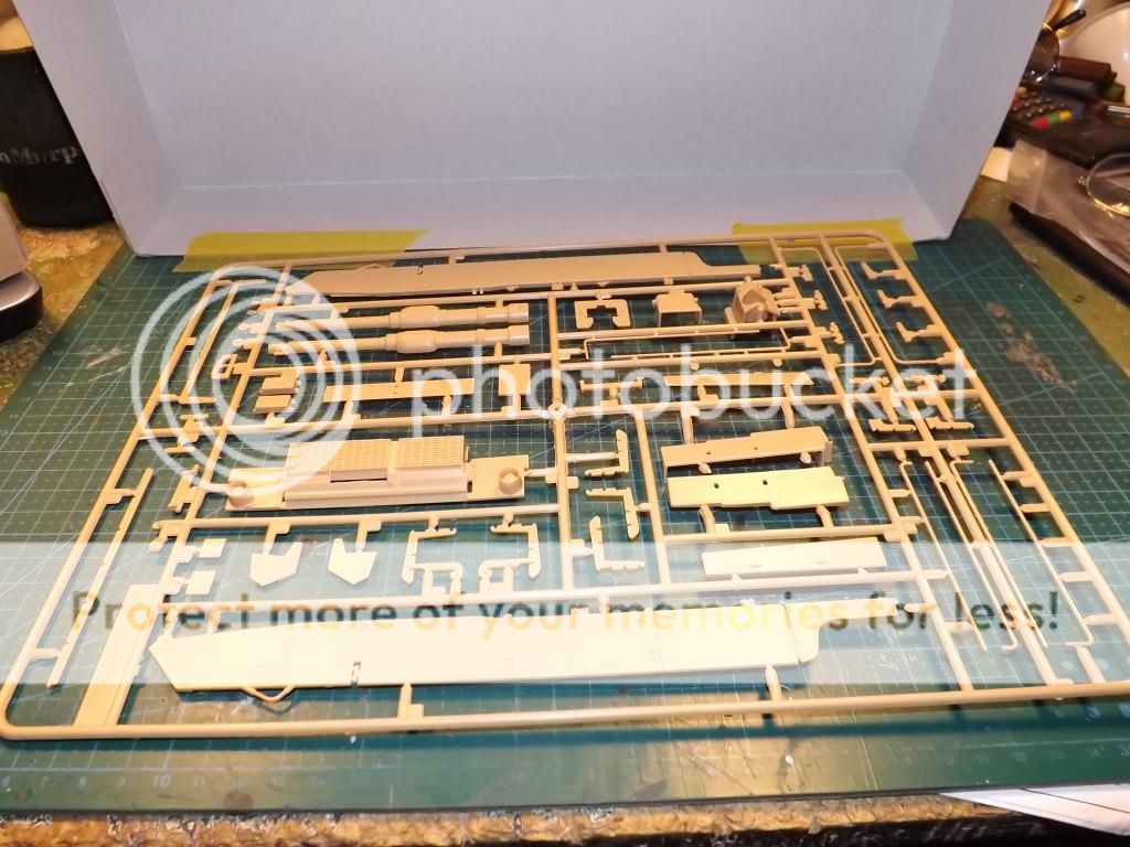

The Kit
Going to use the Academy M1A1 kit to hopefully represent the last photo in the previous sequence a fine walk around that i'll also be using is http://www.aussiemodeller.com.au/pages/ ... 2Aust.html.

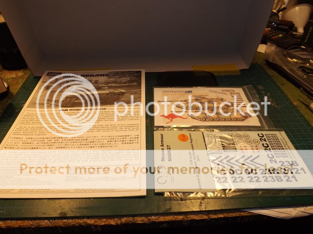

Box and Sprue shots.
The tracks in the kit aren't right for my purposes, so I'm using some link and length from a Trumpeter Abrams. Decal wise I have a few options, since I purchased some aftermarkets, forget about them, and luckily enough bought another, different set. I intend to use the markings for "Bundaberg" after my hometown.
Cheers, Russ.

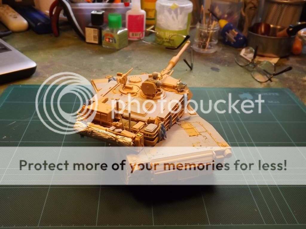

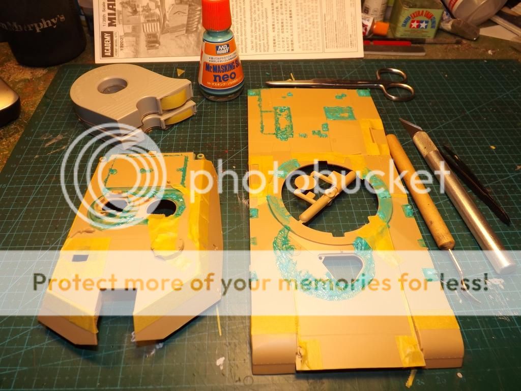

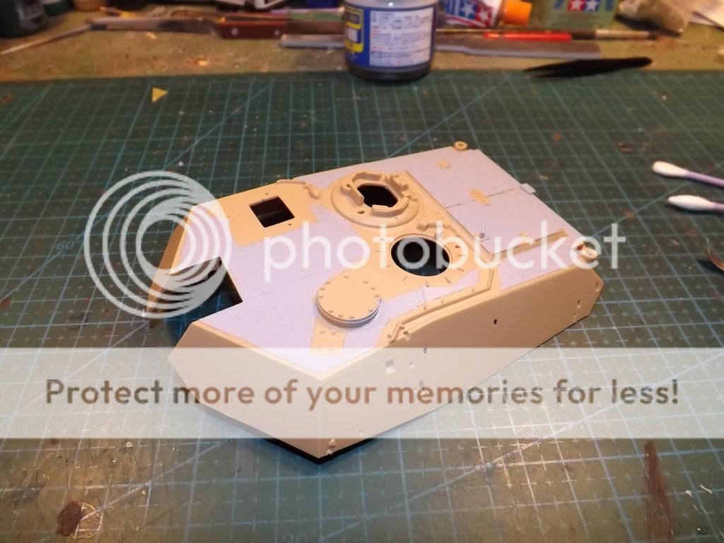

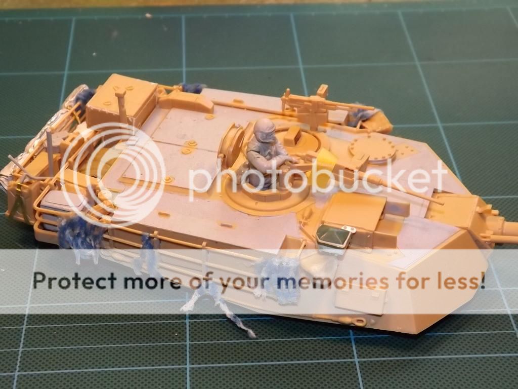

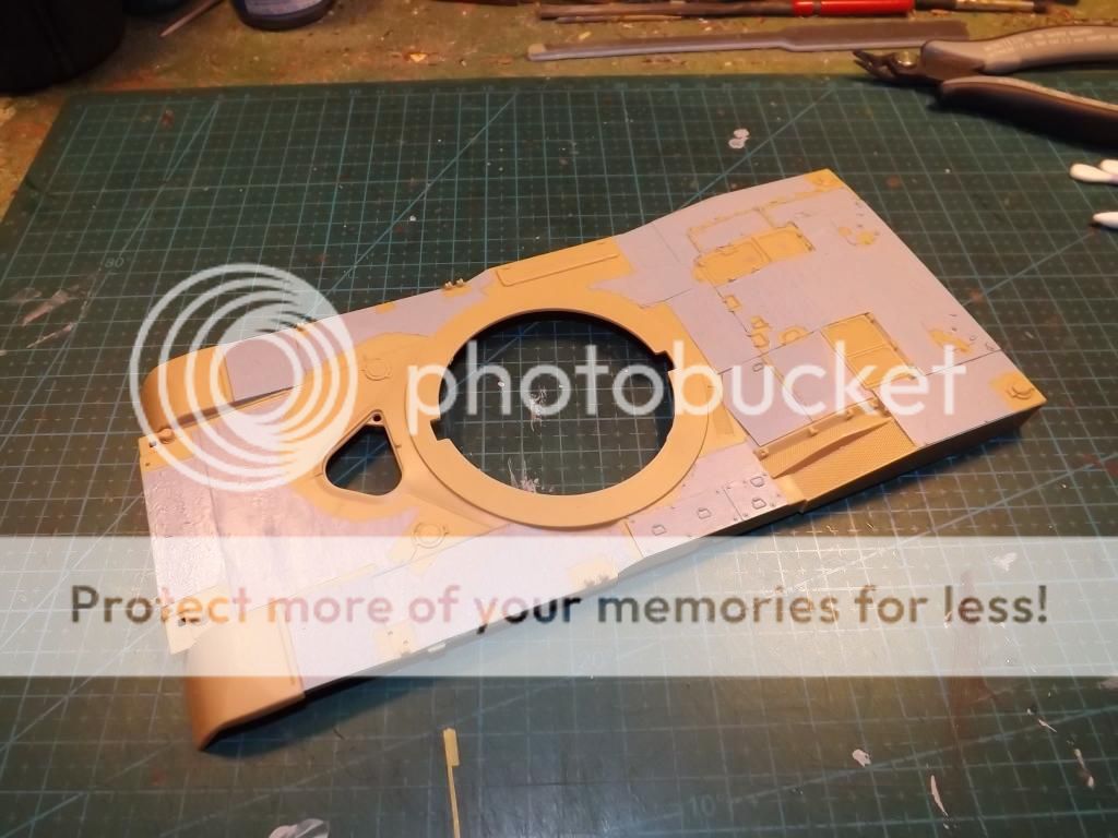

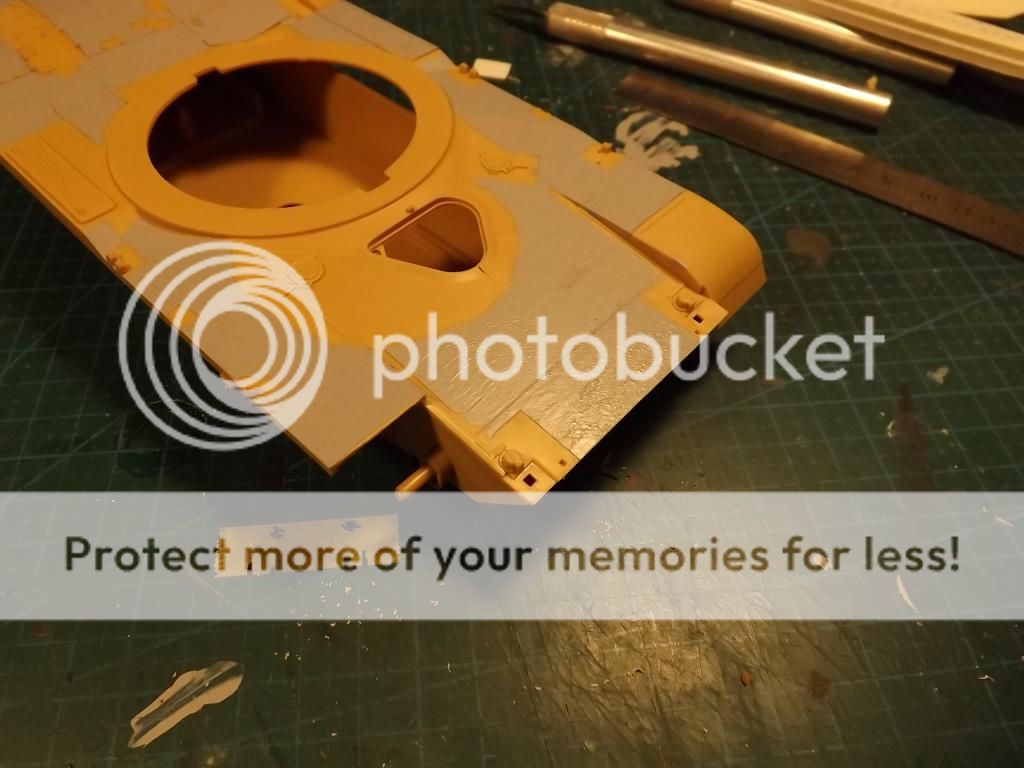

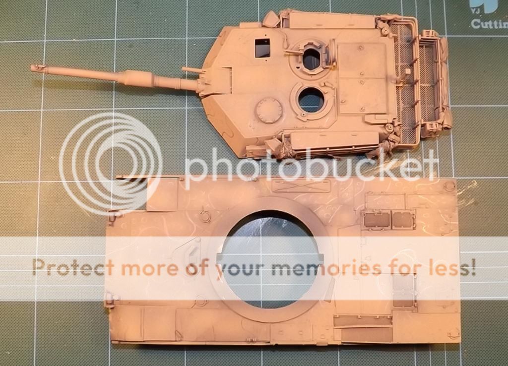

Update 1

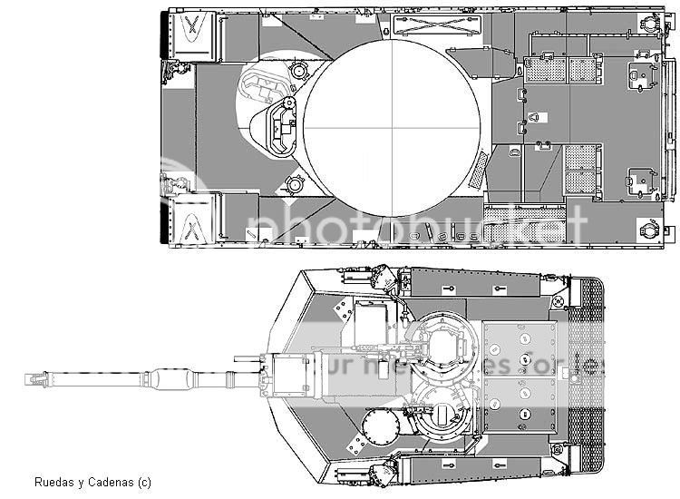

Wanted to try Anti Skid on this kit, as it was a bit of a fail on the Six Wheels or More SIG. I didn't have the opportunity to pick up some Gesso as Norm ( schweinhund227 ) suggested, but I did have some Mr Surfacer 1000. Gav ( Gav0909 ) suggested he might try it for some anti skid. I found an appropriate layout, and started masking off.
I applied the Mr Surfacer with a cotton bud. Dip the cotton bud into the Mr Surfacer and rolled it over the surface until it started to tack. There are some areas that could possibly do with a little more, I'll see what it looks like after undercoating.
Cheers, Russ.

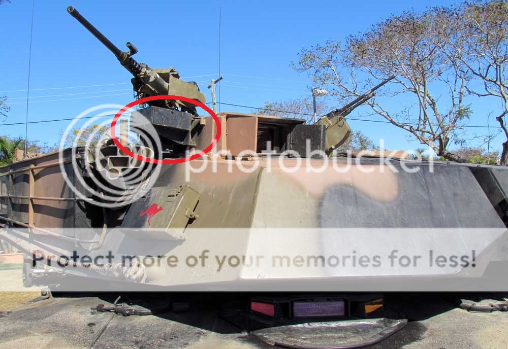

Sorry Norm, I meant this one hear.
Thanks for the help by the way.
Russ. :cheers2:

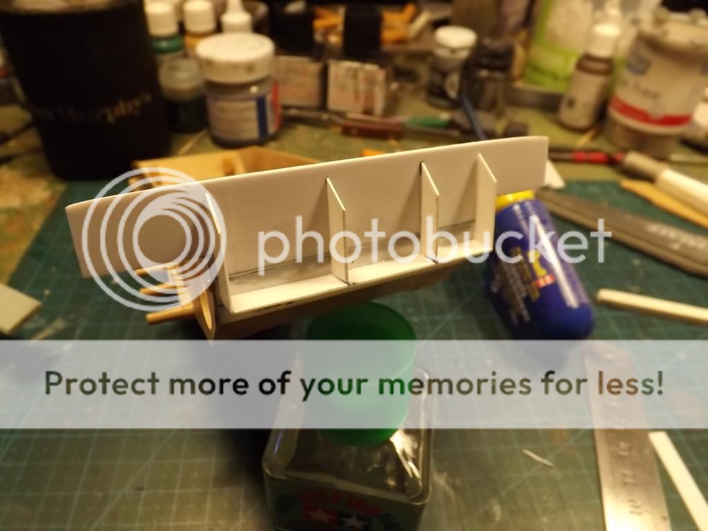

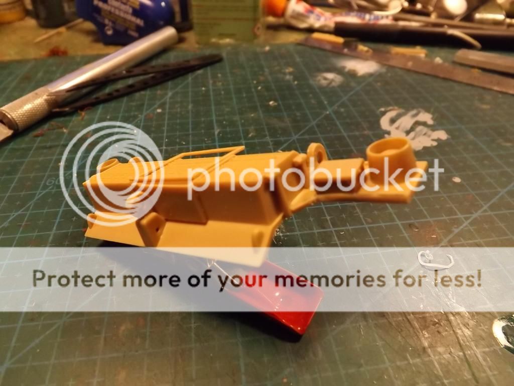

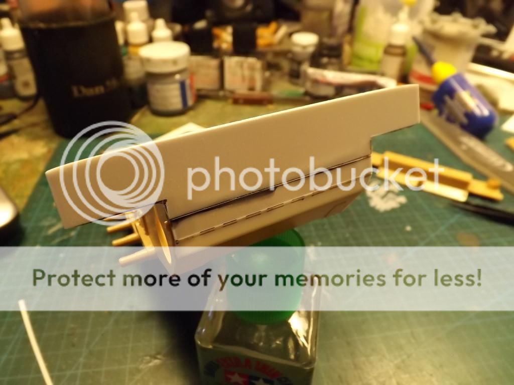

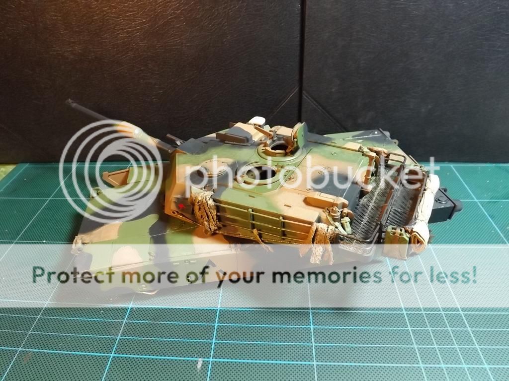

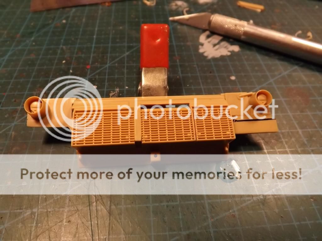

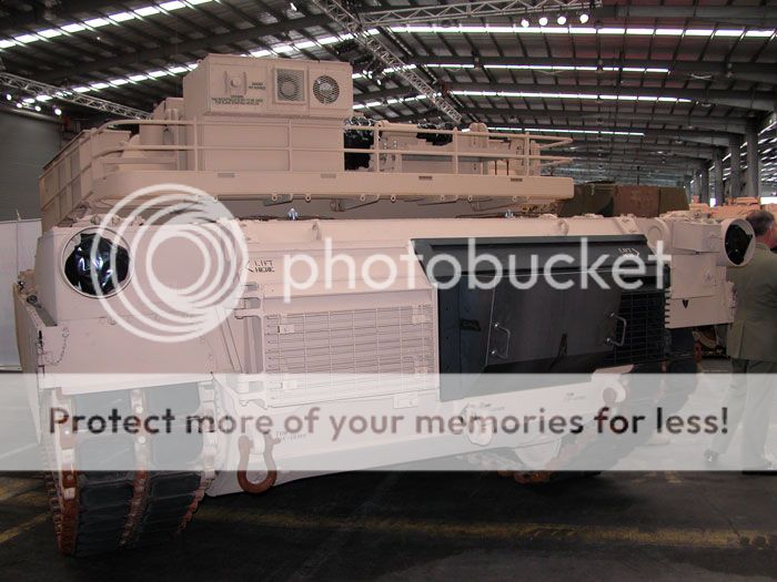

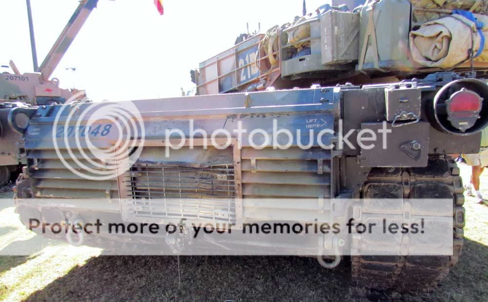

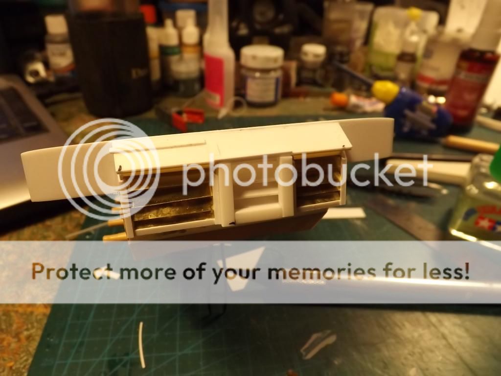

Update 2
Started by looking at the rear of the tank, wanted it to look more like this.
The idea was to expose the slats/louvers, make them out of brass, and bend and bash them. Things didn't work out. But here is some picks anyway.
That's as far as it got. It was going wrong and I kept going, so mojo got a kick in the ......... , more practice and patience is required. I went back to the kit part. If anyone can recommend a kit that might be more suitable I'd be grateful. Things still needed to be done to the kit part to make it more suitable.
Rear mudflaps were removed.
Filled a sink hole in the towing point and drilled out the tie down lugs.
I also removed the front right mudguard, the left has to be bashed up a little.
Cheers, Russ. :cheers2:

Good work on the antislip. your masking is excellent Russ. keen to see this kit unfold.

timtamtung wrote:Good work on the antislip. your masking is excellent Russ. keen to see this kit unfold.
I just checked out yours mate. I looked at using all Tamiya tape but I had an attack of the Lazys and used the maskol.

I used Mr neo masking too on the bolts and hinges. I got a bit lazy with tamiya tape

ok... this is a reinforced enclosure for the Blue Force Tracker antenna and GPS puck
Here is another view from above...
through the Translucent cover... you can see the Antenna box.
http://www.hmmwvinscale.com/photos/M115 ... S%2082.jpg

Thanks Norm, I was torn between something satellite related and air quality monitoring/detection. I'll get the styrene out and see how I go.
Cheers, Russ :cheers2:

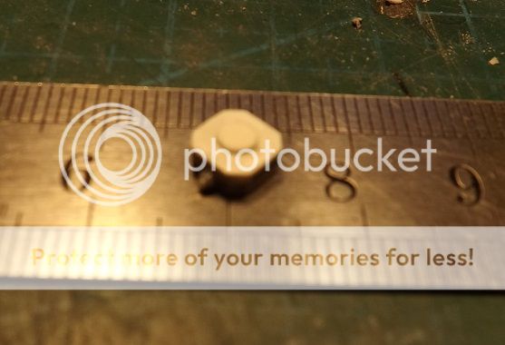

in 1/35 scale
the Blue Force Tracker Antenna... is 6mm x 6mm and 3mm thick
you can buy pre-made Antenna blocks from Live Resin
I get mine from Lucky Model Hong Kong....
cheap cost and free shipping on that Brand....
That square piece is what you can see peer through the cover of previous picture...
Good luck with the project...
take your time.....

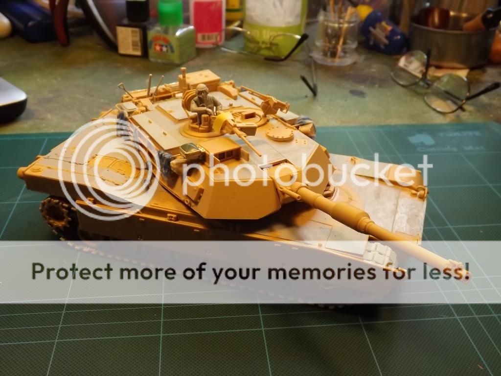

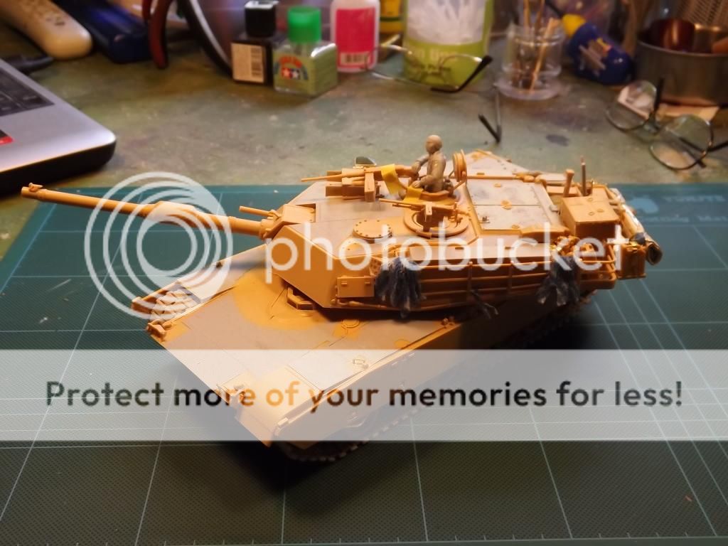

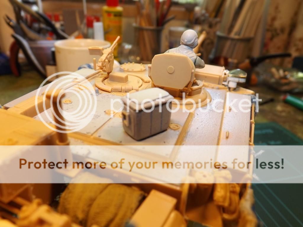

That's the stuff dimensions. I will be doing it cover on but have knocked this up to use for scale.
I have done a couple of boxes but still not quite happy enough. This one is a little too big so I will try again.
Thanks again mate. :cheers2:

Oh! wow!
Most excellent work! :cheers2:

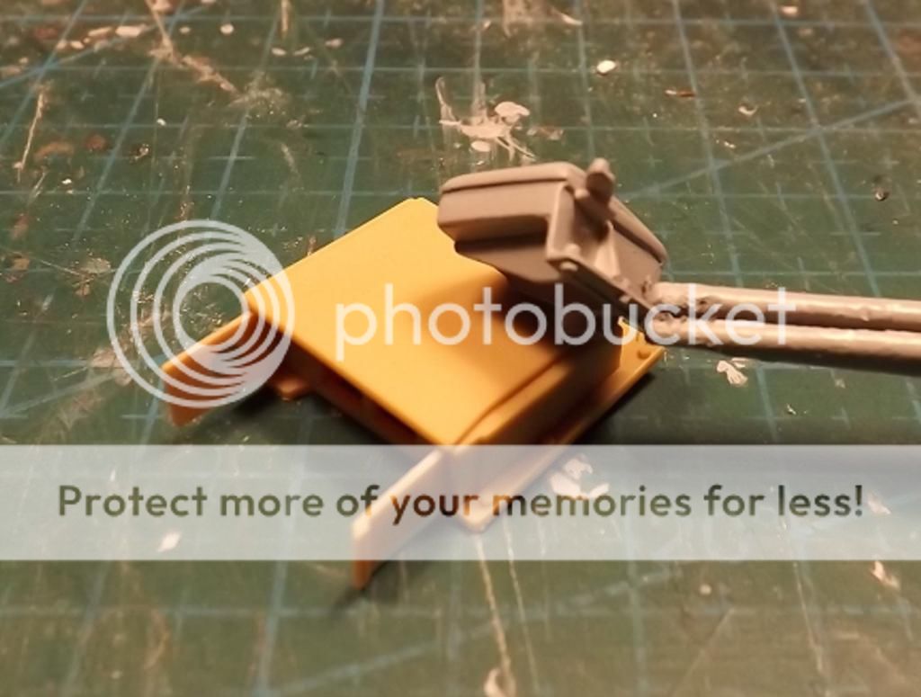

Moving along with the main build as well as some mucking around.

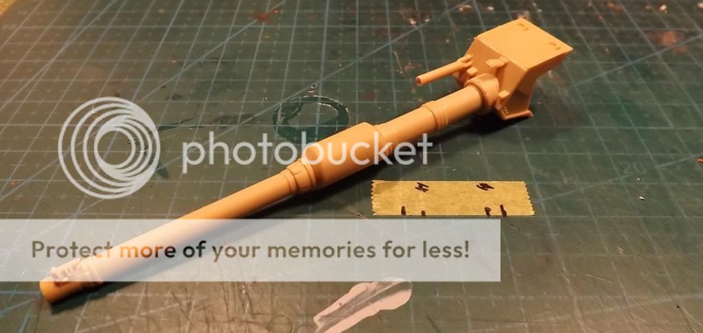

Barrel together.
Bits going onto the turret, a little bit of damage to the nearest smoke discharger but that will be covered up.
Turret baskets made. The kit provides nylon mesh, I had some brass mesh from Secret Weapon so I gave it a try just to get used to working with medium. The nylon mesh would have worked fine though.
Made an esky/cooler/chilly bin for the stowage.
Took a figure from the Trumpeter Abrams kit. Uniform's not right, but when it's painted it'll look the part. The pictures I have been working off show hession strips all over the place, look to be used as a cheap visual disruption device. Tried a couple of different things to replicate this, ended up using small strips of dish cloth, lightly distresses and attached with PVA. Not totally convinced by this, I will reassess after painting begins.
Everything temporarily together. The Trumpeter link-and-length tracks still a bit of work, take out one or two links and distress the track pads.
Waiting on a new airbrush to come in the mail and then painting will begin.

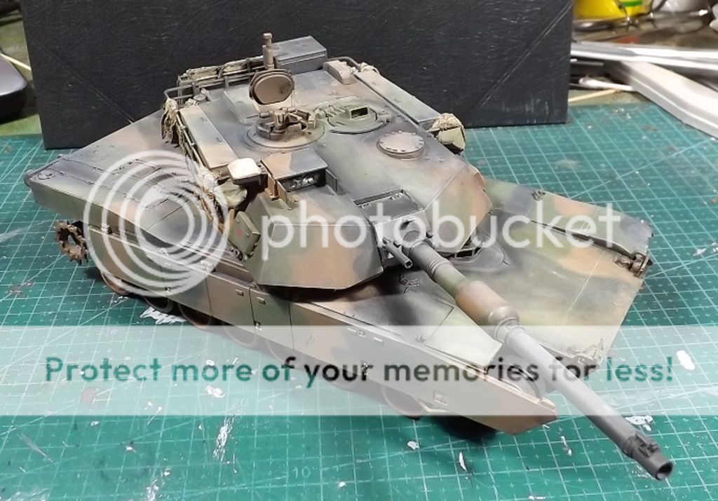

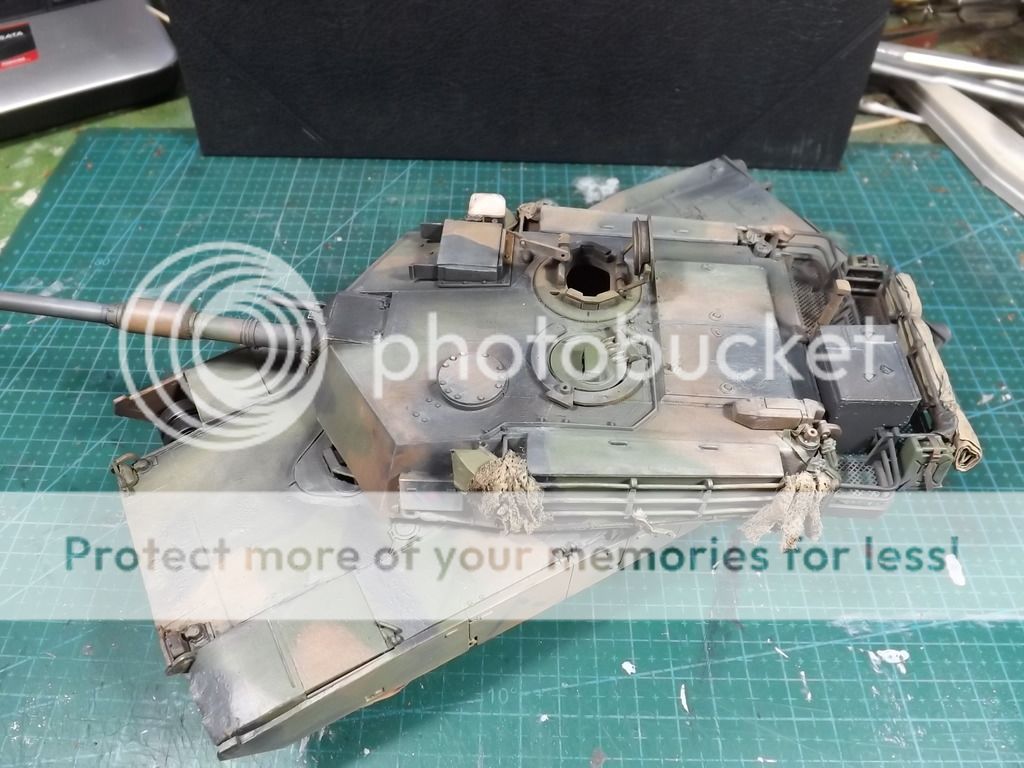

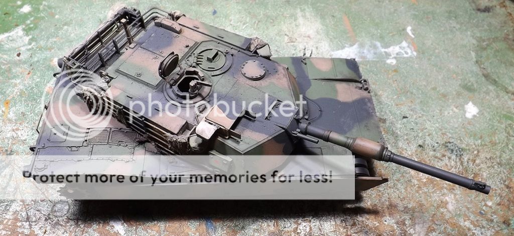

UPDATE TIME

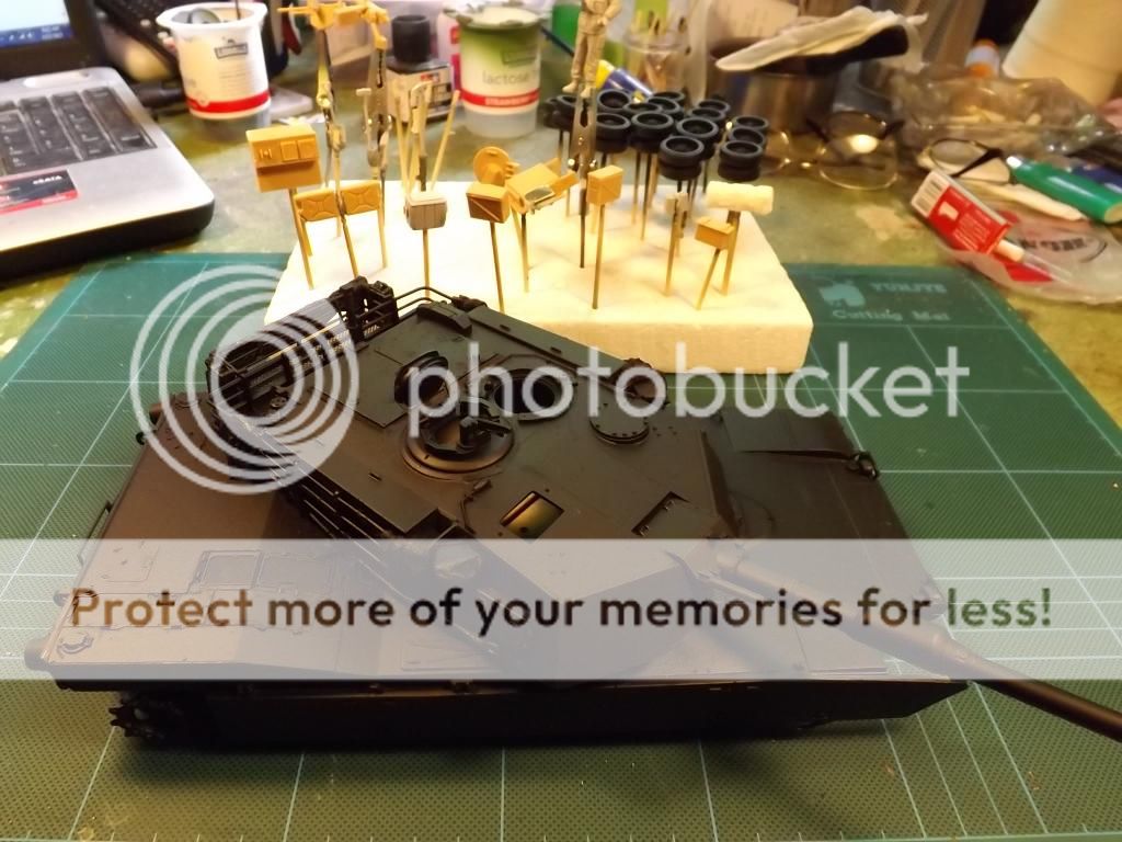

Hey alll. Its been a long time between drinks but some progress has been made on this build. Probably be done by the end of the SIG. I'll jump straight in.
Undercoated with Vallejo Black primer.
Base coat of Panzer Aces 339. The camo pattern was drawn in pencil with the black areas marked with "x" and green areas marked with "o".
Camo colours down. Panzer Aces 348 (Splinter Strips) and Vallejo Model Colour 168 (Black Grey). Then gloss coated.
After gloss coating I looked closer and realised I didn't do a very good job at hitting my pencil marks for the camo. I went back in and brush painted some areas and did a spot of highlighting while I was at it. Decal's have also been added, and some detail painting done.
So that's where its at. I would also like to acknowledge the Abrams Squad mag "Modelling the Abrams - Vol 1.". In particular the article by modeller Pere Pla, entitled "Aussie Abrams". I had no idea this article existed before I started this thread, if you ended up here hoping to find more information about Pere's build.....sorry you found mine.
Cheers. :cheers2:

Really nice aussie colors! I have the Modeeling the Abrams mag/book too. Really good for Abrams lovers

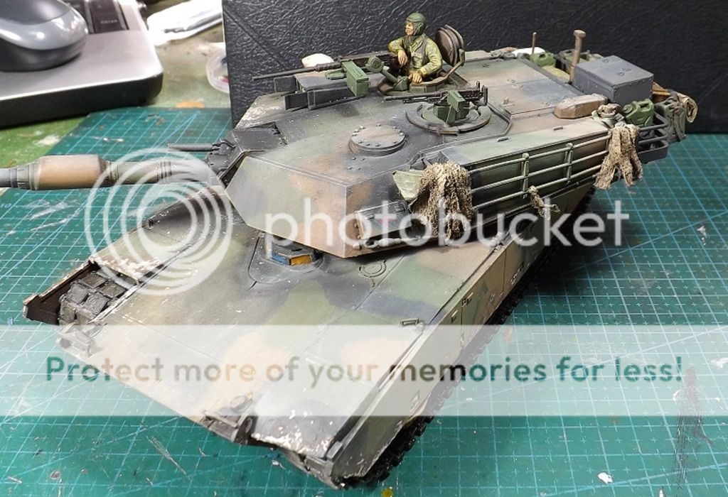

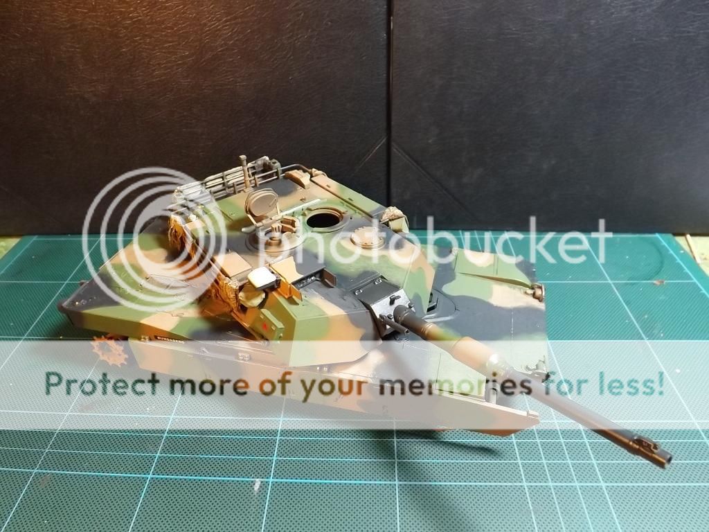

Last Update

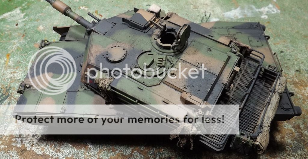

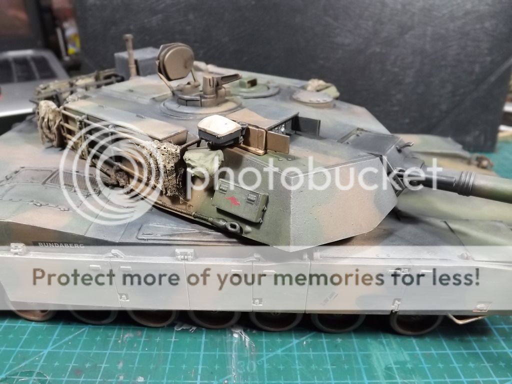

So from last update gloss coat was on, time for washes. Dark brown all over wash followed by black pin wash.
Matt Coated. Had a bit of a Hiccup here. I tried Matt coating with a Liquitex Matt. When I went to apply the first filter the matt coat bubbled and peeled like a red head in the sun. Everything underneath was fine just the matt lifted so I used white spirit and removed as much of the Liquitex that I could and proceeded to use a Tamiya Matt Coat instead.

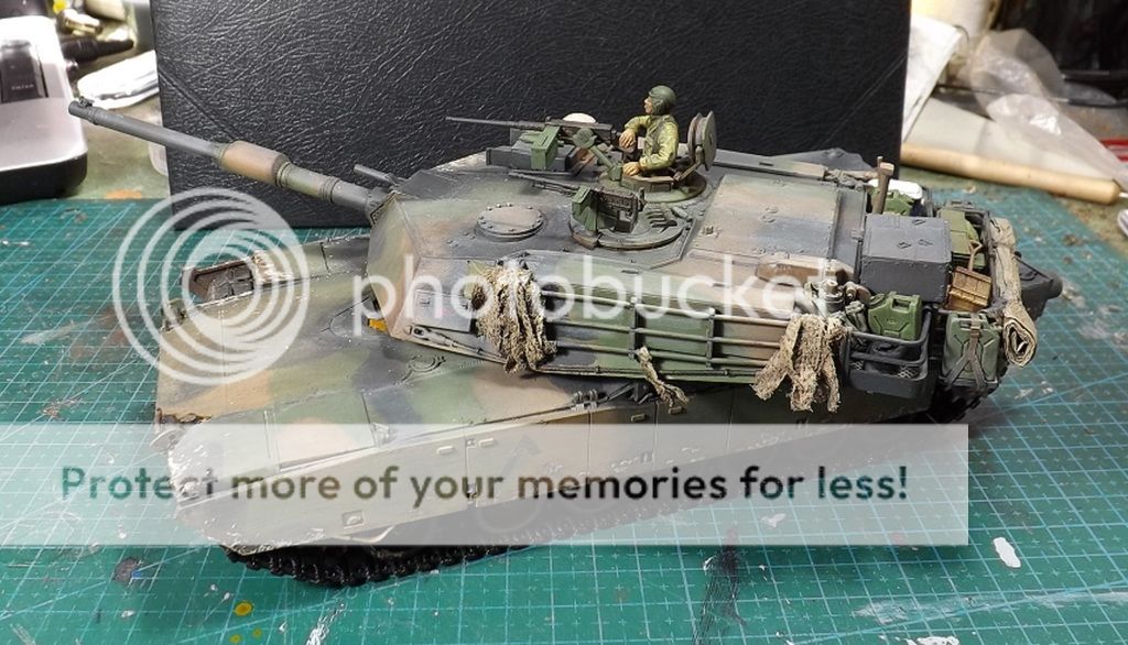

Stowage, tracks, and figure added, some mud splatter (plaster, pigment and water stippled and flicked).
Still a few things to fix up and finish, and then some pigments.
Came across this photo the other day, its a bit late for this build, but looks like a good future project.
Cheers Blokes. :cheers2:

For better or worse I'm calling this build done. Should be in the reveal section soon. Big thanks to commenters and contributers, your input and support was much appreciated.
Re: Academy 1:35 Aussie Abrams
Russ, she's an absolute beauty!! :th: :th: :th: :bow:: :bow:: :bow:: :clap: :clap: :clap:
Love the camo scheme and you've weathered it perfectly. The figure and all the stowage just finish it off - top job! :cheers2:
