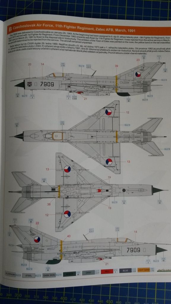

I'm going to build this marking:

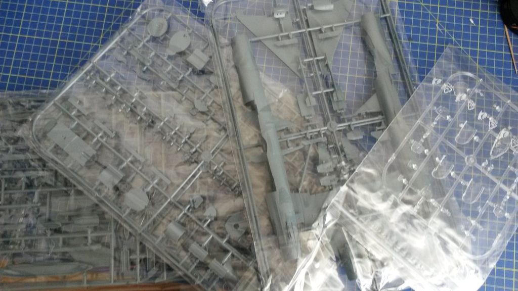

Quite a lot of sprues and parts:

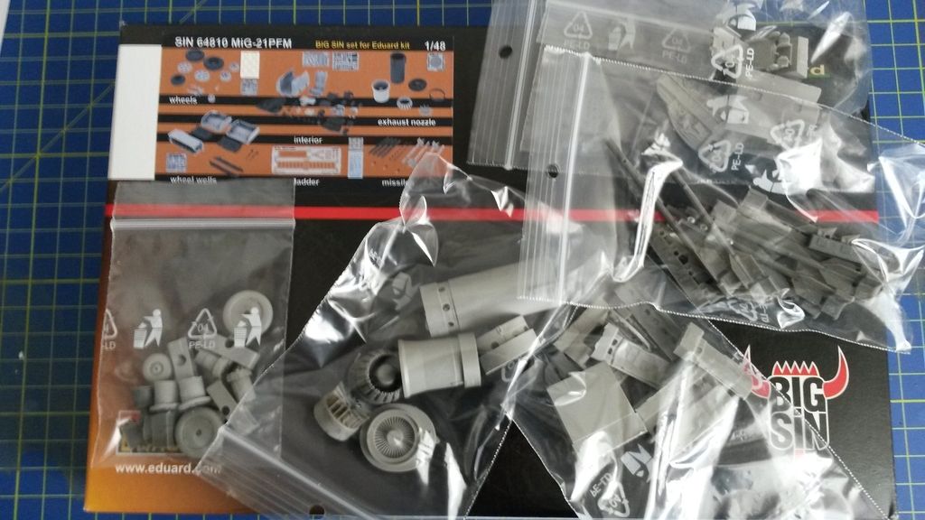

And finally BigSin for this kit:

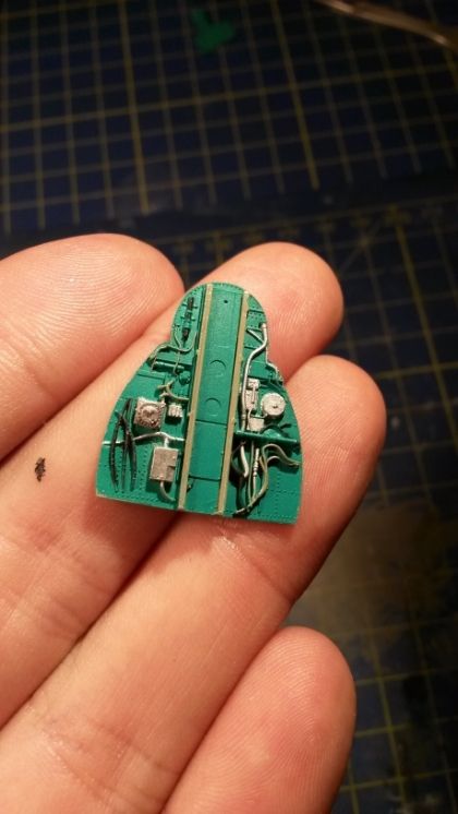

Re: Eduard 1/48 MiG-21PFM Czechoslovakia
Post by michald »

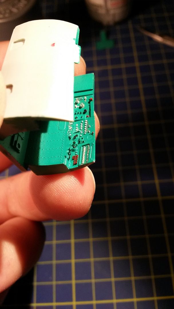

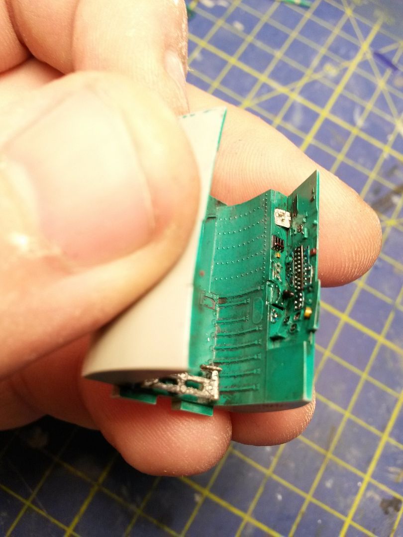

First new experience: working with resins is much easier on the pictures than in reality.... Anyway after some hours some painting in cockpit is done, now PE time....
Post by Jack »
Looks like a great kit, good luck mate.
Tamiya 1/35 Tiger 1 mid production
Bandai AT-ST
Dragon 1/35 M4 DV
Great start, that cockpit looks fantastic!
The kit with all that extra stuff will we awesome when it's ready, good luck !
martin57
Posts: 897
Post by martin57 »
Well done, very impressive so far :th:

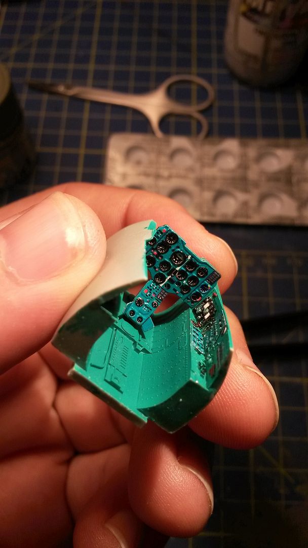

Post by michald »

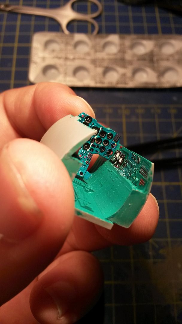

Well... Dry attach of instrument panel uncovers disaster... Slightly different color tones on PE and my interior color on photos... Yesterday I was sure they are the same, but... :( Any idea how to fix it without destroying everything? Or it's better to keep it as it is and just live with it?
greenhorn
No leave it as it is! There's a lot of excellent work there, don't go chopping it just because it's the wrong colour. It's not that far off anyway and once it's buttoned up no one will notice. Just tell everyone it was a factory one off... :thumb1:
Very nice work so far
I have this kit in my stash .....somewhere
It looks like a very nice kit to build
I would just keep it like that and wouldn't bother to repaint everything
The canopy of the Mig is not so big so you will have a hard time looking for the difference in color

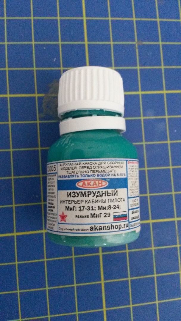

But may i ask wich paints did you use because to me the overall cockpit color looks like mr hobby aqueous ,emerald sorry i don't know the number but i have seen a mix of mr hobby colors
They suggest to mix H25 and H46 i believe they are but the names are sky and emerald and in a 50/50 mix they are almost identical to the color of the Eduard pe set
Good luck with the rest of the build
Post by michald »
Thanks for advises! I really appreciate it.
So I'll leave it as it is. Difference is almost invisible on daylight and maybe I'll fix it little bit with some oils....
I have also versions R, MF, PF and another PFM, all as overtrees with PE so next time I'll try mix as MarkVerploeg suggests. Thanks a lot for this ;)
For this build I used Akan color on dark base. Test looks fine, but I think I over-sprayed base color with Akan so it's lighter than it should be.
Thanks again for you help!
greenhorn
Avgas wrote:No leave it as it is! There's a lot of excellent work there, don't go chopping it just because it's the wrong colour. It's not that far off anyway and once it's buttoned up no one will notice. Just tell everyone it was a factory one off... :thumb1:
I agree completely. It looks worse than it is under the workbench light, but it will hardly be noticable inside the fuselage.
You might consider to put some light weathering on to reduce the contrast a bit, but don't overdo it. Start with the seams between the two parts where the colour difference is most obvious.
Just an advice...
/Tommy
Post by planemaker »
Nice work on the cockpit, mate. :th: :th:
michald wrote:Well... Dry attach of instrument panel uncovers disaster... Slightly different color tones on PE and my interior color on photos... Yesterday I was sure they are the same, but... :( Any idea how to fix it without destroying everything? Or it's better to keep it as it is and just live with it?
Does not the the resin aftermarket set provide a resin instrument panel too? If so you could use that instead of fixing the colour of the PE.
Would look more realistic too. :thumb2:
Myself have dealt with the same issues too. That's why I don't really like pre-painted photoetch.
In my FAF Saab Draken build I just used a brush to paint over the pre-painted PE to get the right
colour. IMO it was easier then I thought.
Post by michald »
planemaker wrote: Does not the the resin aftermarket set provide a resin instrument panel too? If so you could use that instead of fixing the colour of the PE.
yes, you're right. I totally forgot it immediately when I saw PE ;) I painted instrument panel cover with correct color and all the stuff, but now I have problem how to remove top PE part from instrument panel without destroying underlying PE witch all the controls backgrounds... Tried to use scalpel, but no success... Please, do you have any idea?
Post by michald »

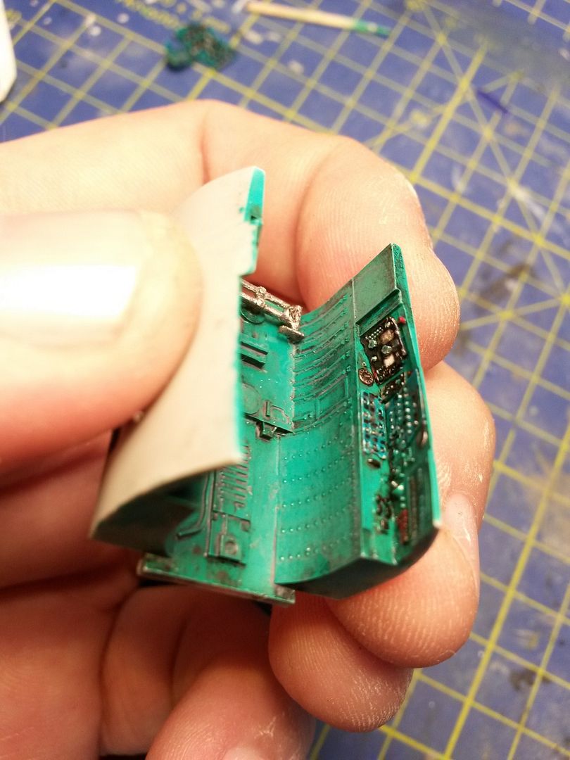

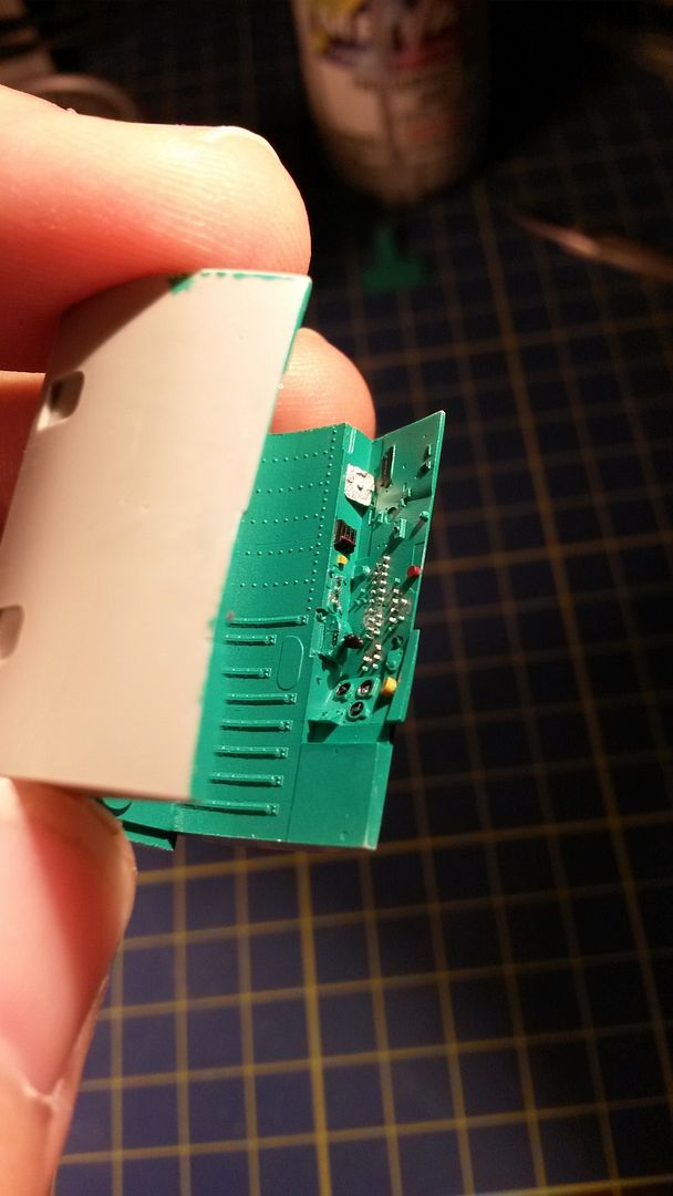

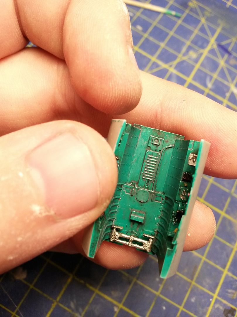

So I tried some cocpit weathering, but I have a feeling that it's too much :( What's your opinion?
greenhorn
Filmman586
Posts: 532
Location: Stratford, CT US
Post by Filmman586 »
Looks great in my opinion! :thumb2:
michald wrote: yes, you're right. I totally forgot it immediately when I saw PE ;) I painted instrument panel cover with correct color and all the stuff, but now I have problem how to remove top PE part from instrument panel without destroying underlying PE witch all the controls backgrounds... Tried to use scalpel, but no success... Please, do you have any idea?
I don't think you can save the pre-painted photoetch istruments, but it would look even better if you would use the decal instruments behind the resin panel to replace the PE. Just forget the PE instruments, and just cut out the underlying PE instrument part and slide the decals on top of it
and then after you painted the resin panel you just glue the PE part with the decal instruments behind the resin part. If the resin part has not got
any holes for the instruments, then just drill them out.
Just as a tip you could use Microscale Kristal Klear or just regular PVA glue for the instruments to get a 'glass effect' and make them look more realistic.
Hope it helps. :cheers2:

Post by michald »
I mean remove paint from resin instrument panel :) It really looks terrible. I will keep trying to paint instrument panel until I will be happy with it, or I until I lost patient :D

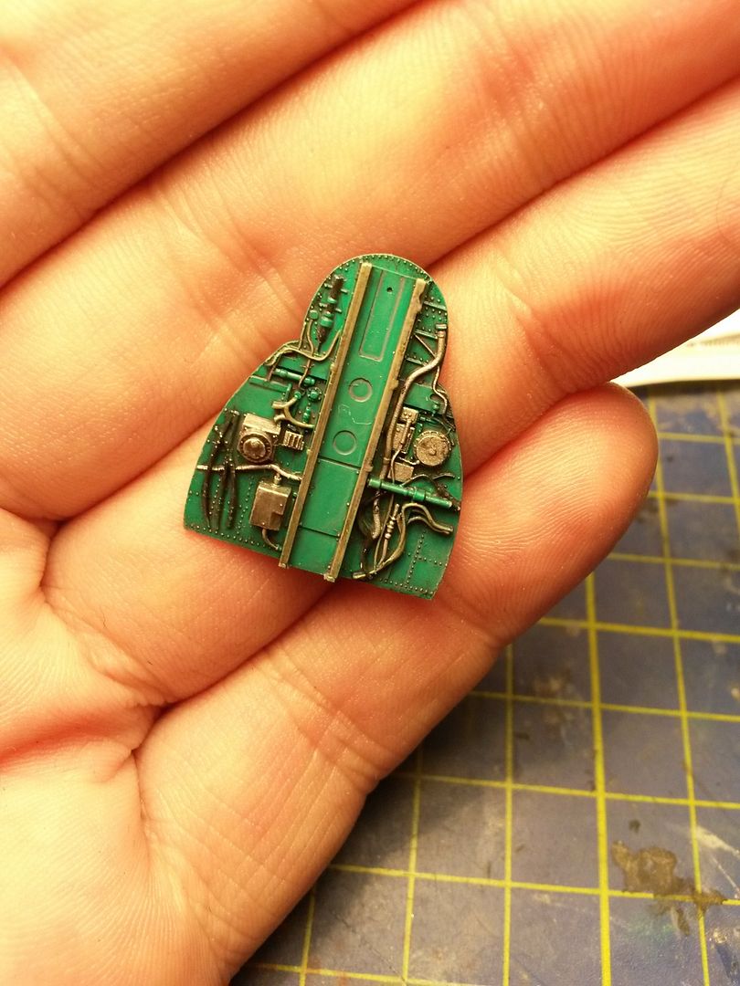

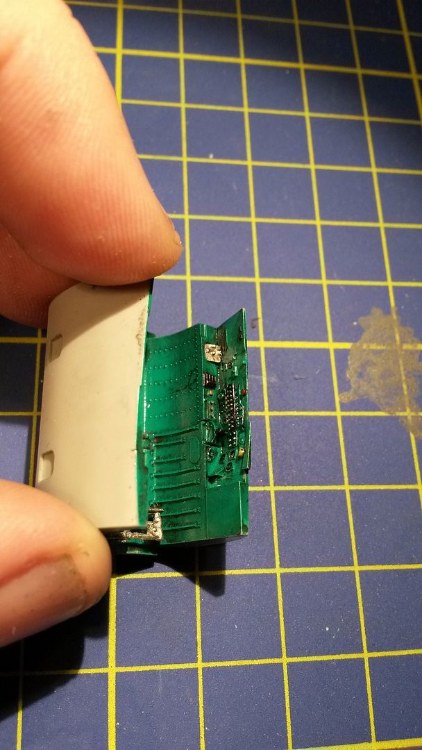

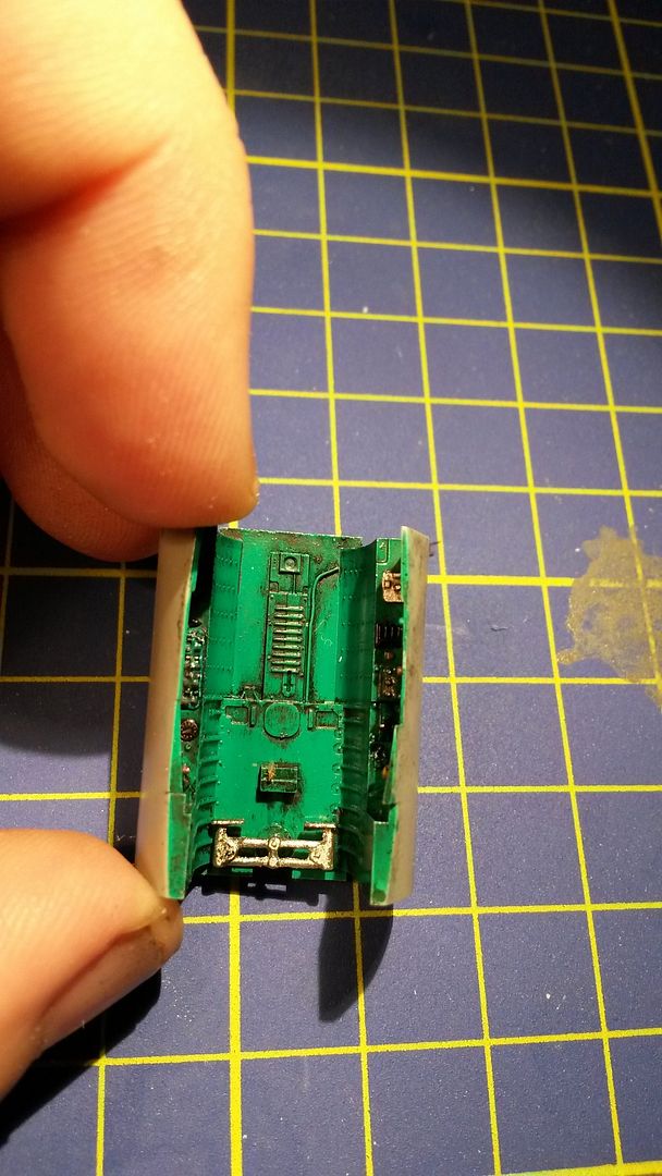

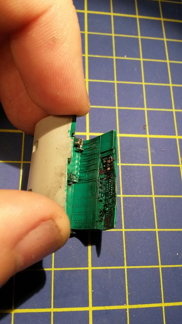

I also slightly adjust cockpit weathering, I was not happy with it. Hope it's now better. If not, it's easy to go back with it :)
greenhorn
The cockpit tub and back panel looks perfect, great job! :thumb2:

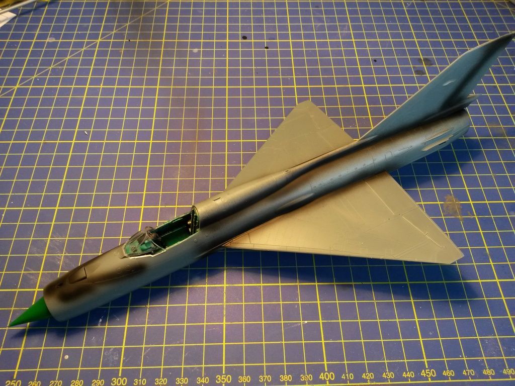

Post by michald »

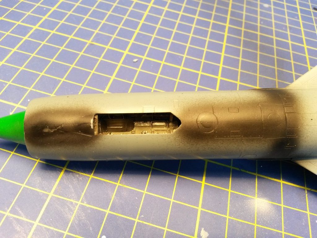

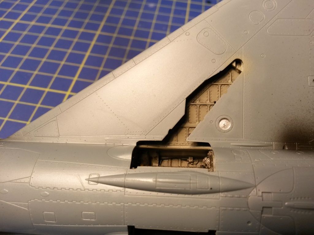

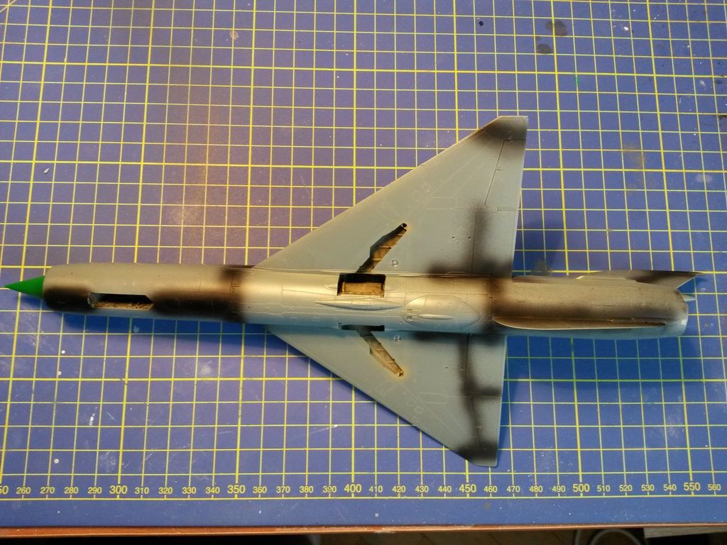

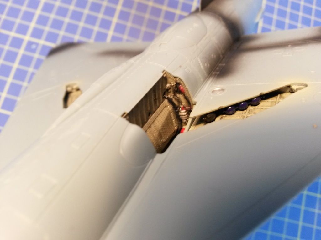

Business trip is over and some work is done on Mig as well. Model is going together nicely. So far no putty. I just sprayed black surfacer to see what I screw up.
greenhorn
vdbo76
Posts: 45
Joined: Fri Apr 24, 2015 8:59 pm
Location: Amsterdam NL
Post by vdbo76 »
Great detail work and amazing painting skills :th:
Fabian
An absolutely beautiful build so far. Keep it coming.
