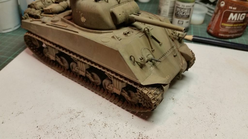

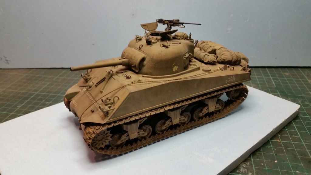

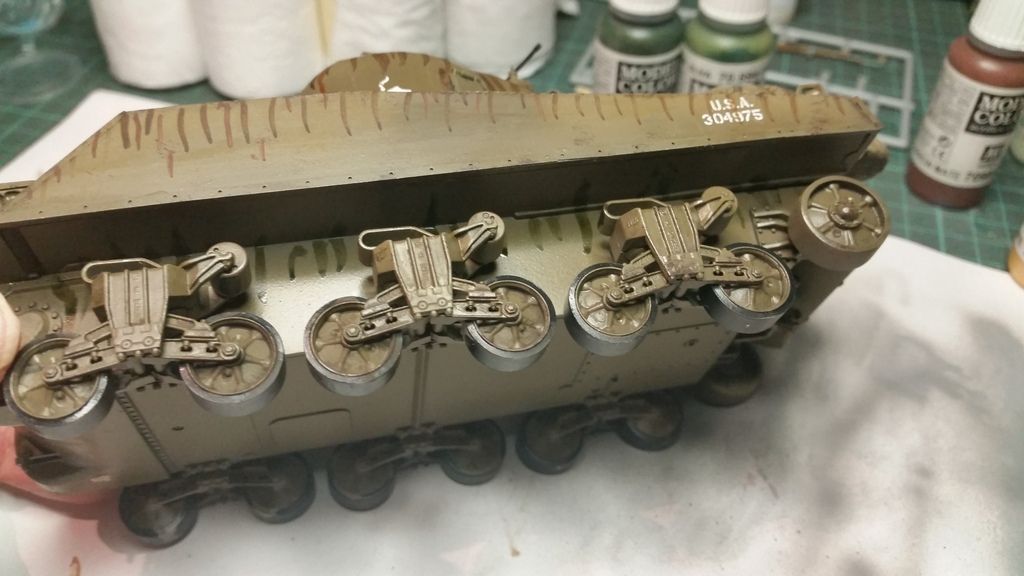

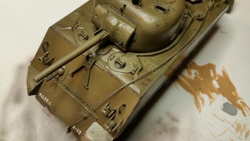

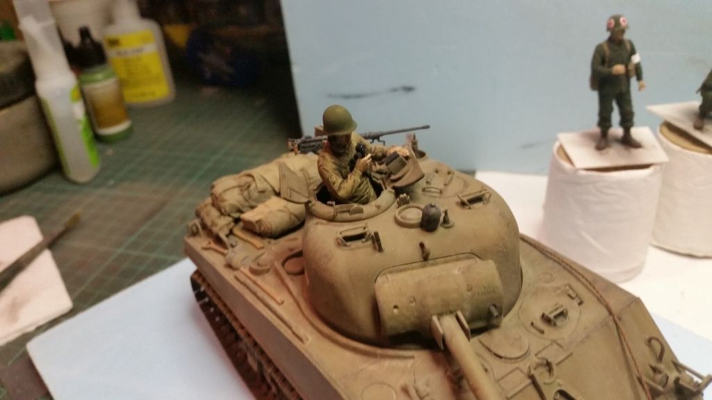

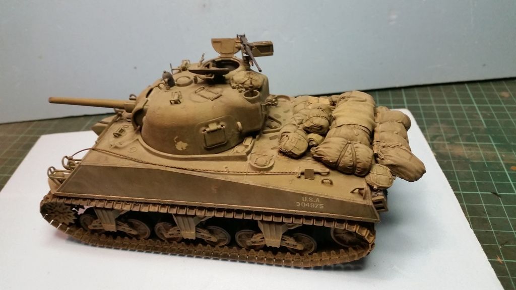

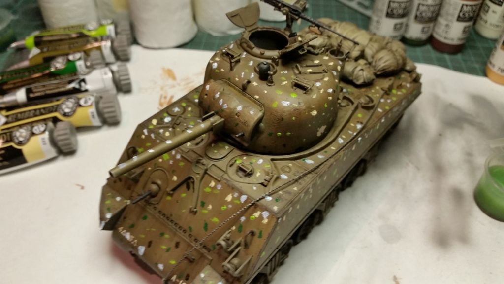

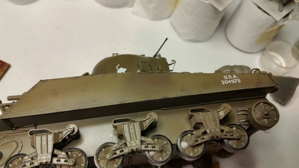

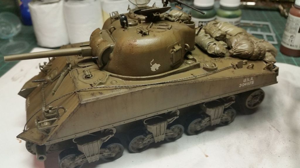

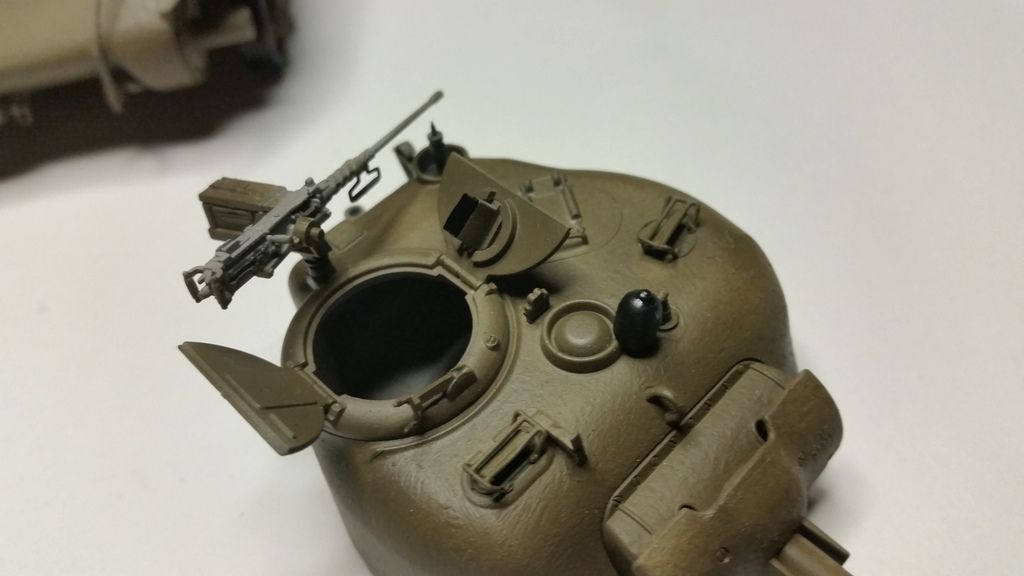

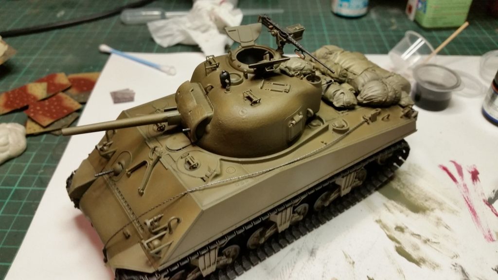

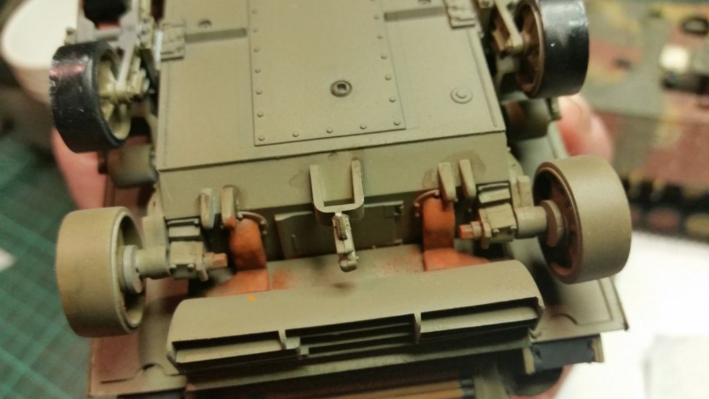

so here is the painting of the Sherman
the base color i used is mr hobby aqueous H304 olive drab
wich was applied in 4 thin coats all over the kit
this version of the olive drab is brighter then the shades you have from Tamiya and Vallejo
i think that this is a discussion point in general as every one has their own opinion as to wich paint is the best for painting olive drab
but i picked this shade because it would work better with the black and white base and i personally don't like the look of the very dark shade wich could result in a very dark and hard to weather tank

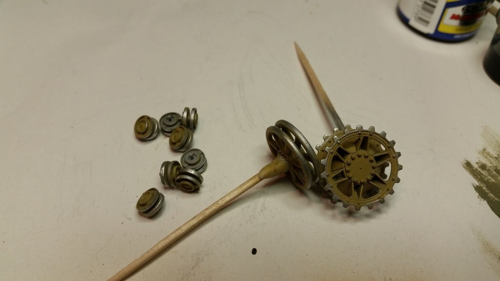

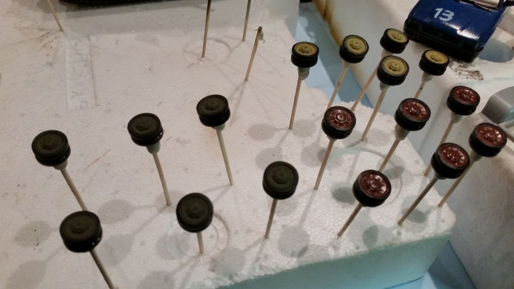

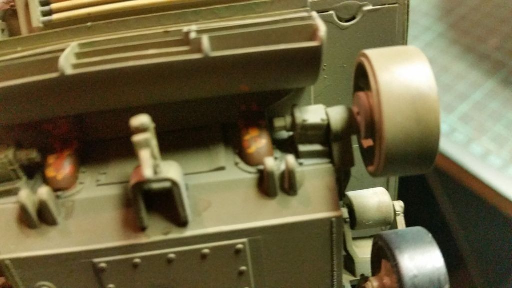

i used mr hobby aqueous tyre black to brush paint the tyres
this paint worked well enough for me but it needed some thinning to make it easier to use

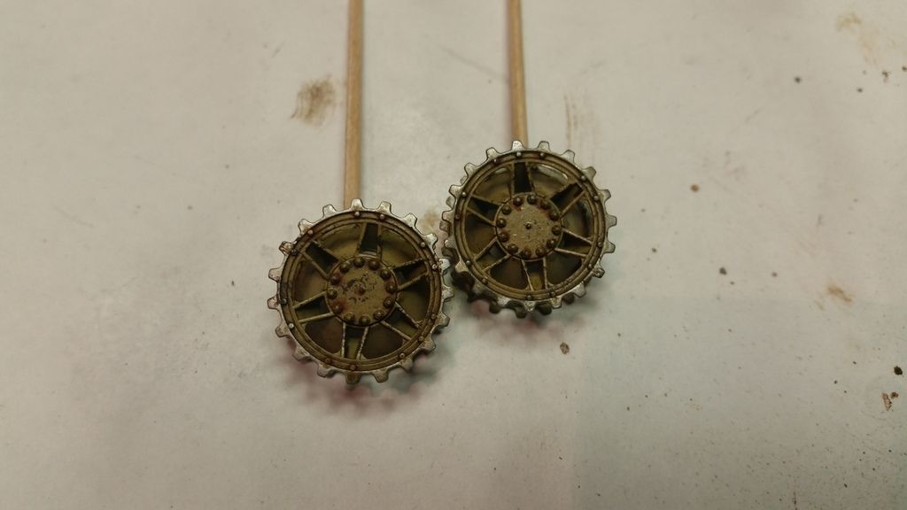

then i used Vallejo modelcolor oily steel on the edges of the sprockets where they are most likely to chip paint and get a polished look as that is the part where the sprocket hits the metal part of the track

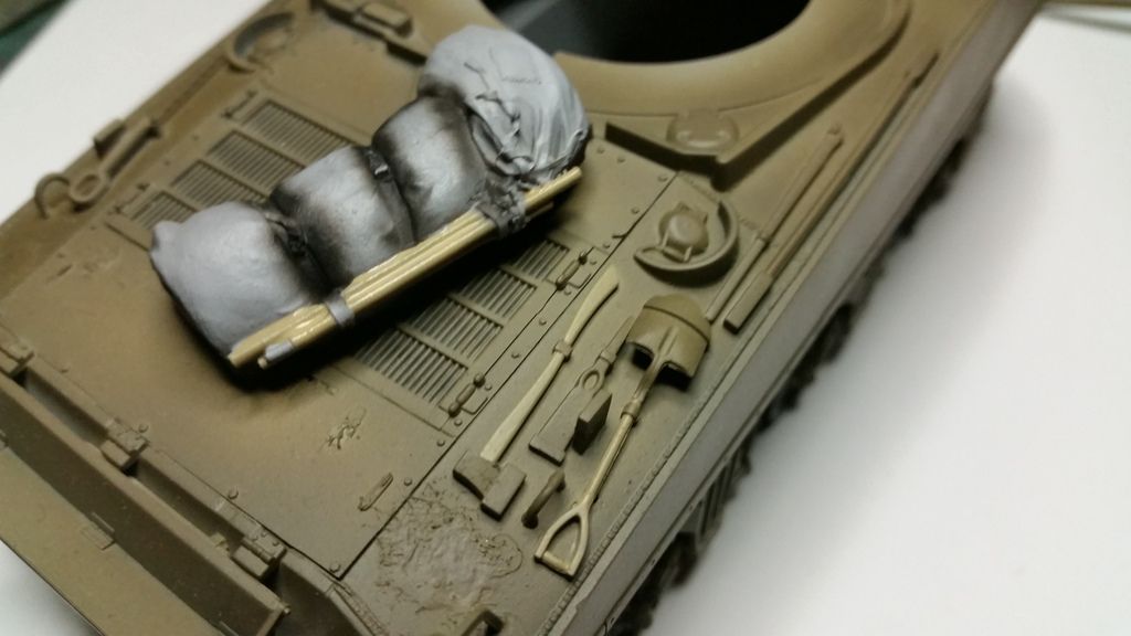

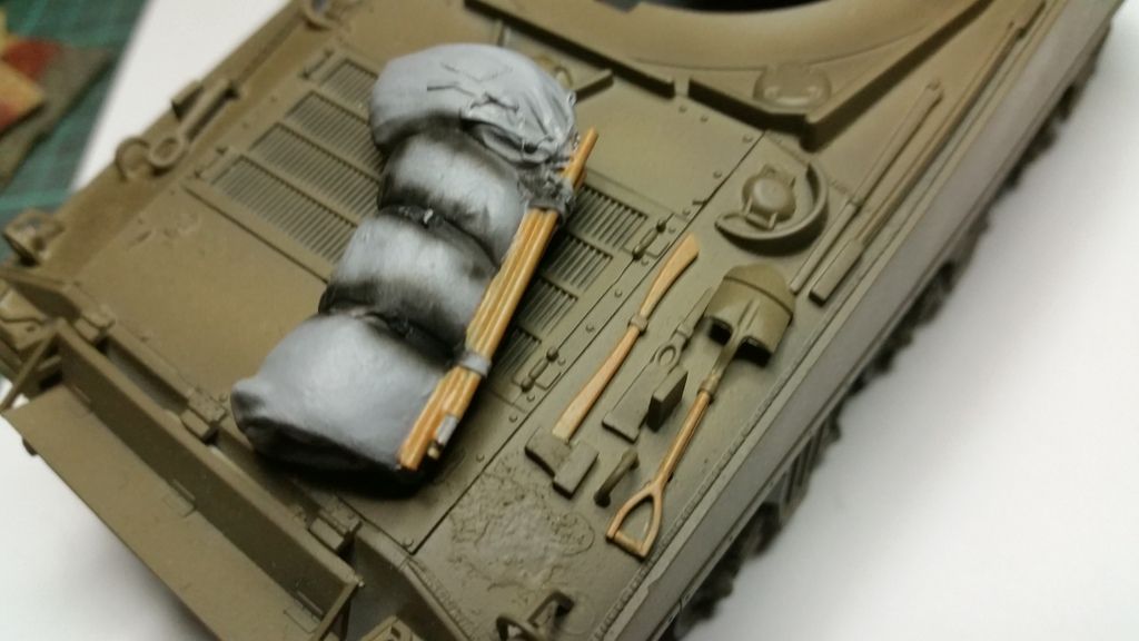

the next thing on the list where the tools

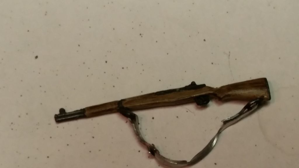

so i started out with the wooden tool handles
there is a extra set of cleaning rods on 1 of the stowage parts so that was done at the same time
as a basecolor for the wood i used a mix of Vallejo model color English uniform and white
these where mixed in a 4:1 ratio
after looking at some reference shots i noticed that the tools on US vehicles had a reddish brown look to them or even a bit orange
so i used model color orange brown wich i dry brushed on the tools in lng motions
this way you still get a slight wood grain effect on them

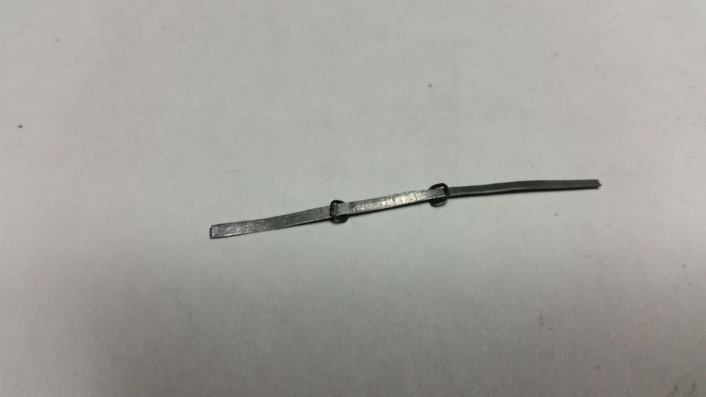

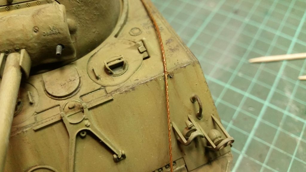

the towcable was painted in oily steel
i think that i will use some rust washes later to make it look old and unused
the spare tracklinks where painted with the same tyre black i used before on the wheels

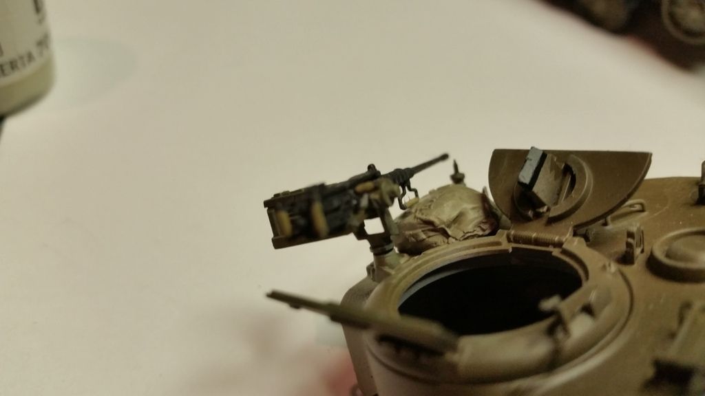

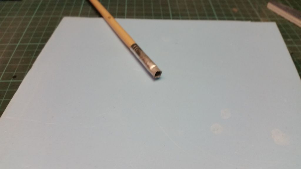

the head of the cleaning rod was painted with mr metal color aluminium and modelcolor black
the handles are painted in the same way as the toolhandles
the search light and lowest part of the periscope where painted in black

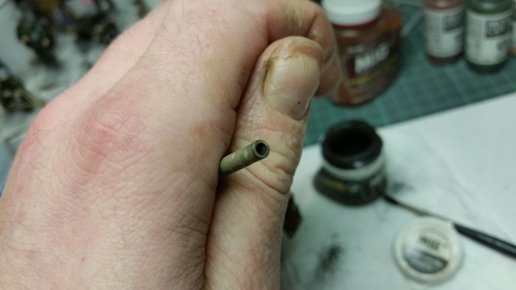

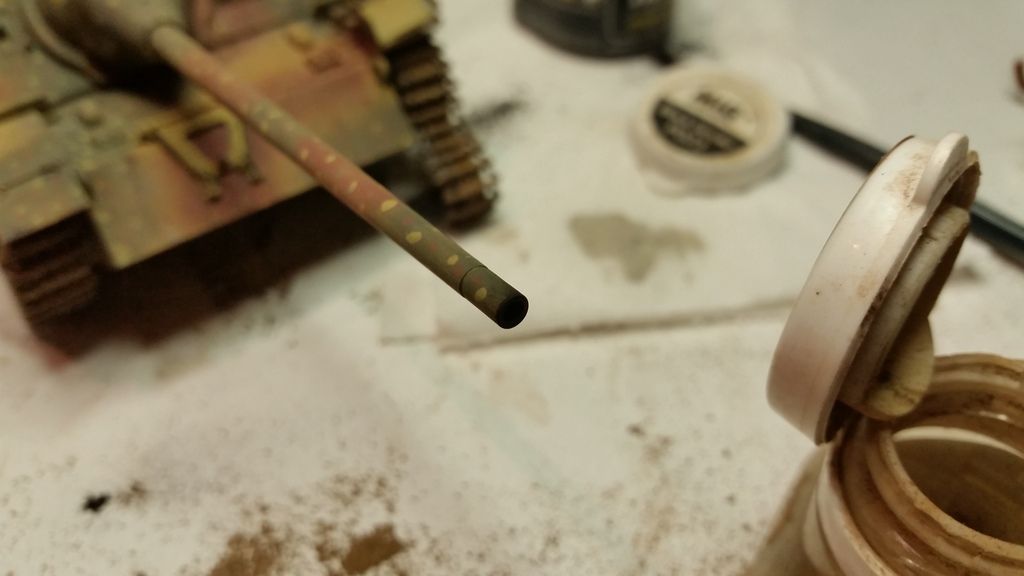

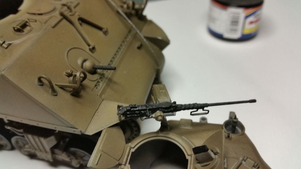

the gunbarrels where brush painted with mr metl color dark iron
it looks a bit chunky in places but with a little polish with a piece of paper towel they look better
after a quick polish with a paper towel and old brush
i use the brush to get to the small places where the towel can't go without damaging parts

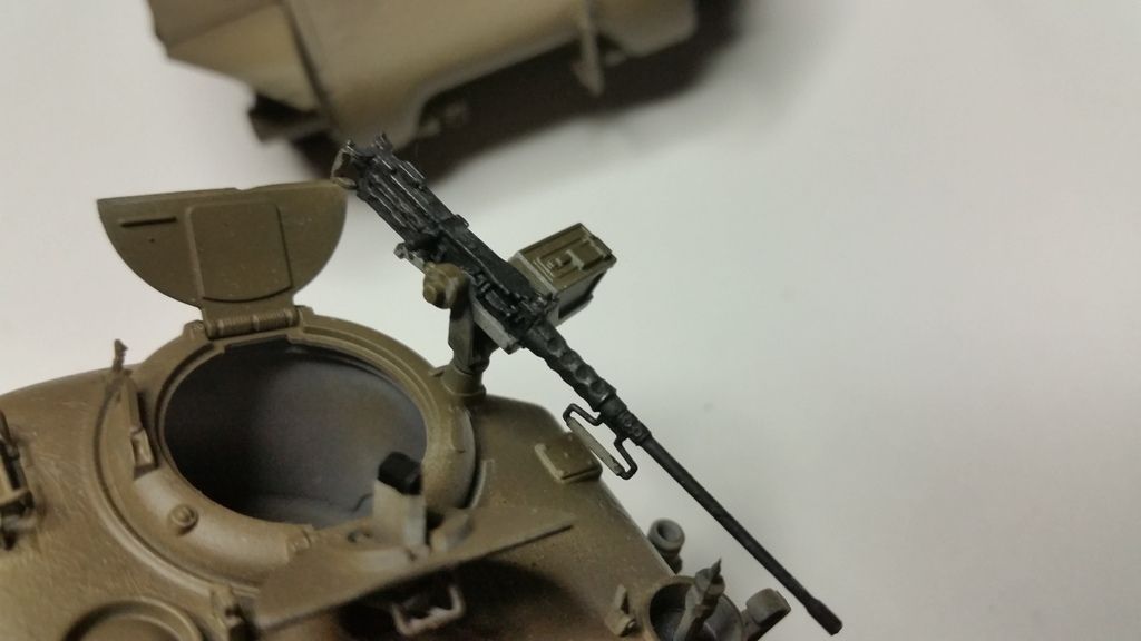

i then painted the ammobox on the gun with model color olive drab wich is darker then the basecolor i used
i also did a general dry brushing using model color uniform green wich is a bright green but in thin layers it will look a bit darker and it worked well to highlight the raised details

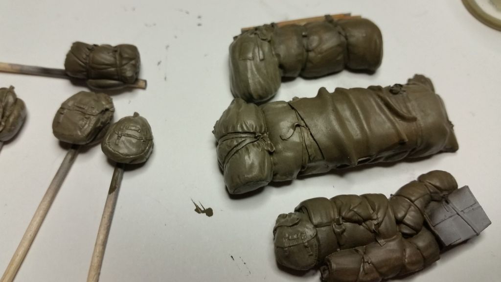

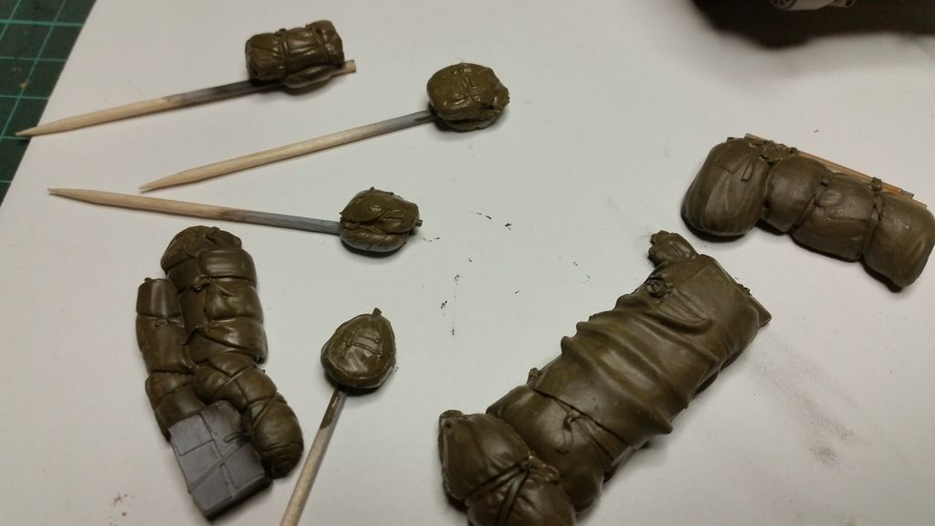

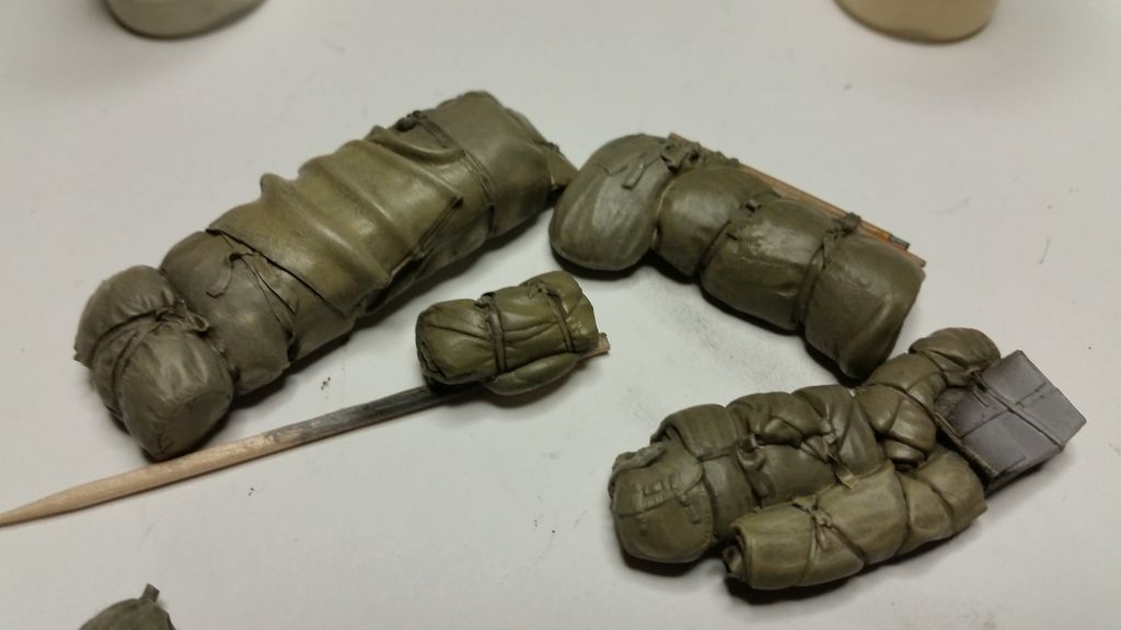

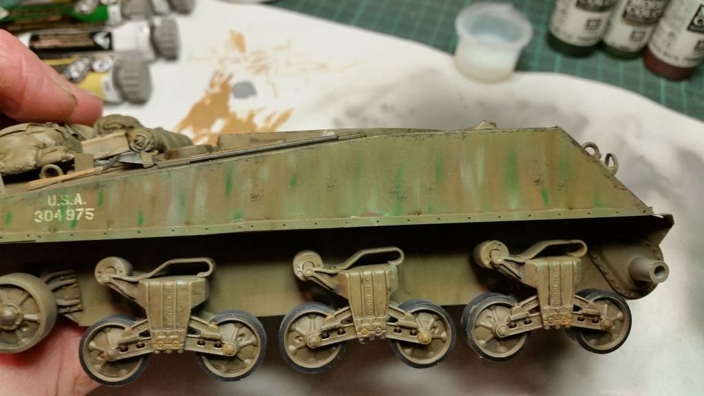

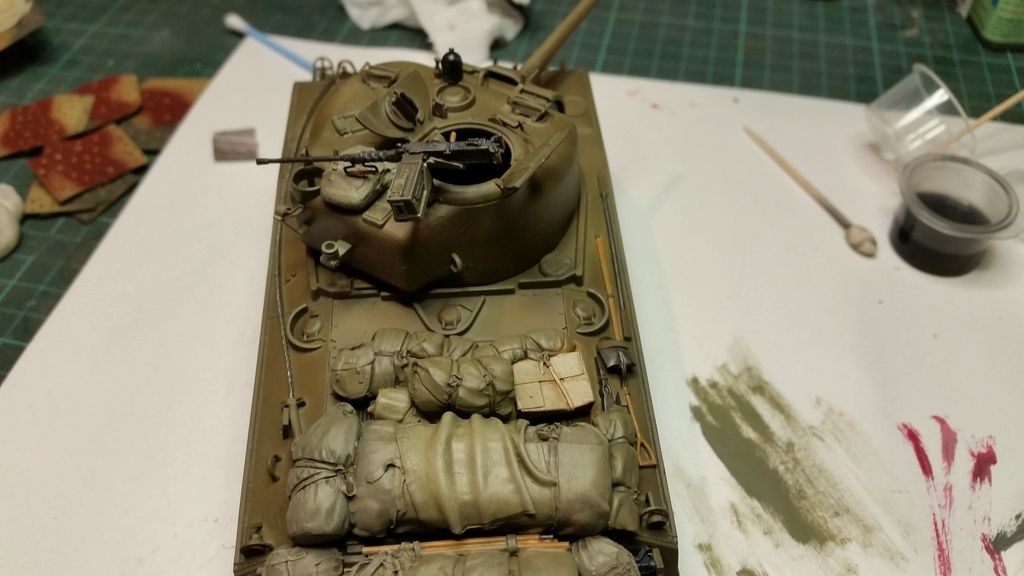

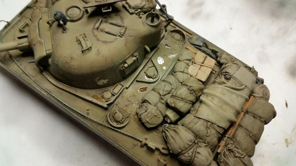

i then sarted to work on the stowage
the sets i picked only consist of either personal back packs and rolled up tarps
so i decided to use 2 Vallejo panzer aces colors
i used dark mud on the tarps and canvas on the back packs

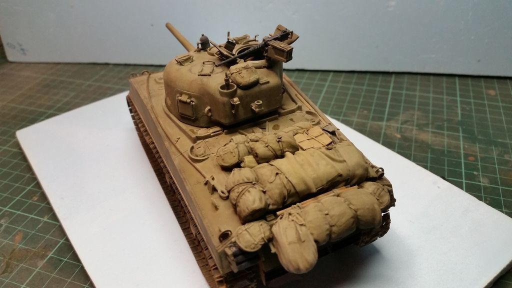

i then started to use several eath/dust tones to dry brush the stowage
colors i used are , pale sand , dark sand , german camo beige all by Vallejo modelcolor
i used them to highlight the raised detail
a second dry brushing
this time i used the german camo beige mixed with a drop of white to further highlight everything
the drawback is that it leaves a very sharp contrast
so that is something to deal with
to soften the effect of the dry brushing i used colors i used before
the tarps where painted with the beige again and the backpacks with the canvas
but this time to make sure they have some transparency i thinned them with a lot of water
about 50/50 or even 60/40 water to paint
because the drybrushed paints where only dry not cured the effect will become softer as you blend them a little with the thinned paint
the cardboard box was first painted with modelcolor orange brown
and before this had time to fully dry i used heavily thinned pale sand over it
again this blends the colors together a bit but still leaves different tones in the end (when you don't cover everything and keep using a brush on it)
the wooden handles of the M2 where painted in the same way as the toolhandles
this is one of those thing i tend to forget when i am painting :bash:

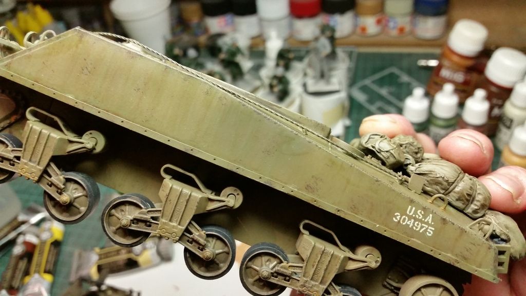

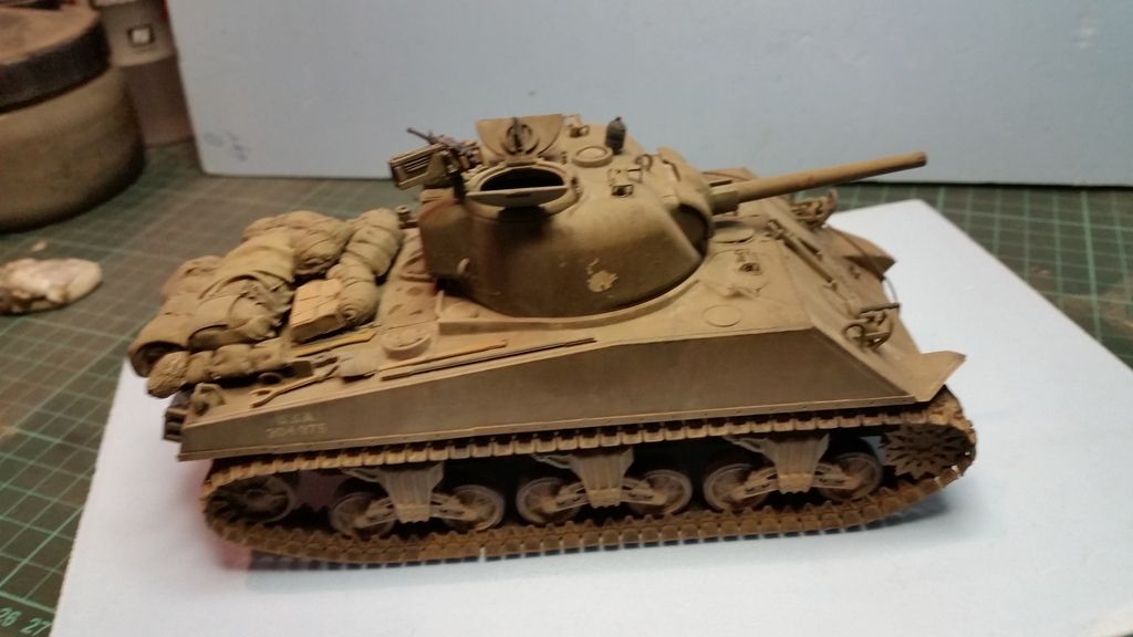

ll the stowage was glued on the tank
for the weathering i don't feel like it makes much difference if the stowage is on there or not
and a complete tank is easier to hold then a small stowagepack

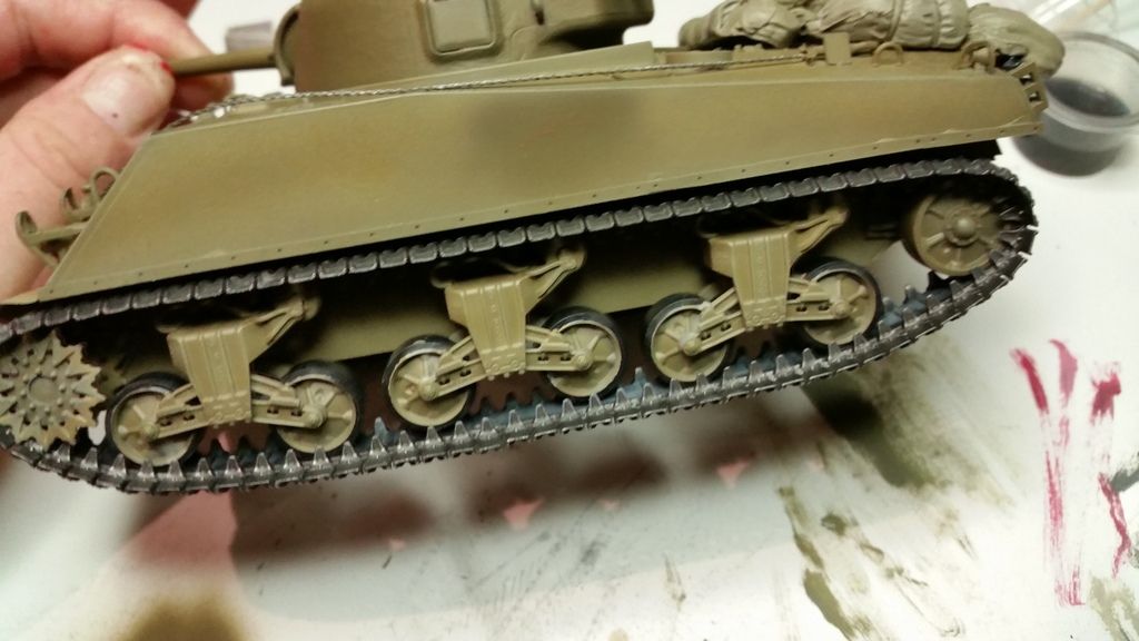

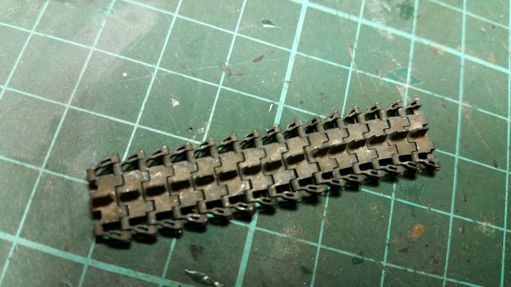

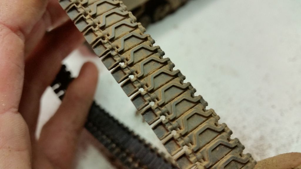

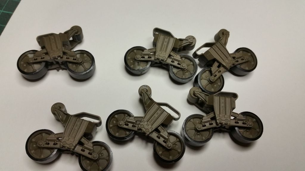

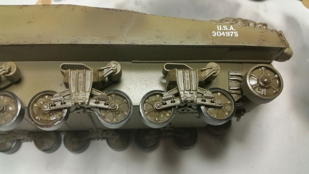

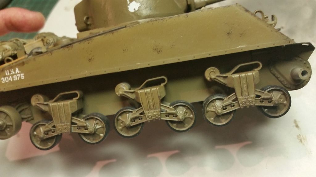

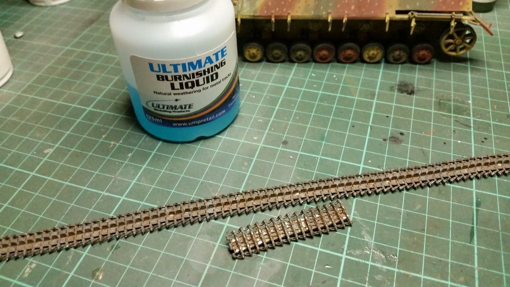

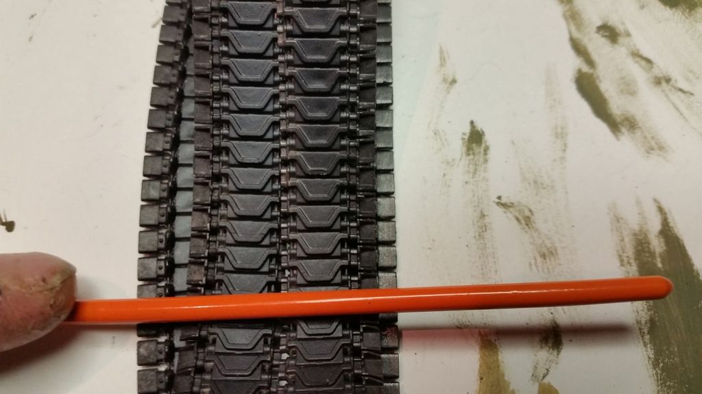

i then worked on the tracks
the tracks where first sprayed with the tyre black i used on the wheels
the metal parts are painted with mr metal color dark iron (brushed on) and then buffed to make it look more like metal
the left is before buffing the metal and the right after
to give the tracks a used look i decided to dry brush the chevrons and the insides with modelcolr neutral grey
left is finished , the right one is from the prevoius photo
a mini reveal of the paintwork
i didn't do the chipping at this point because i want to do some chipping over the decals to make it look like the markings are scratched in some places and i found out that it is easier to remove mistakes with the chipping after the model has a coat of varnish because i use some mr hobby aqueous thinner to gently remove mistakes i make with modelcolor or similar paints but you run the risk of damaging the paint underneath if it is not protected
so that is alli have for now

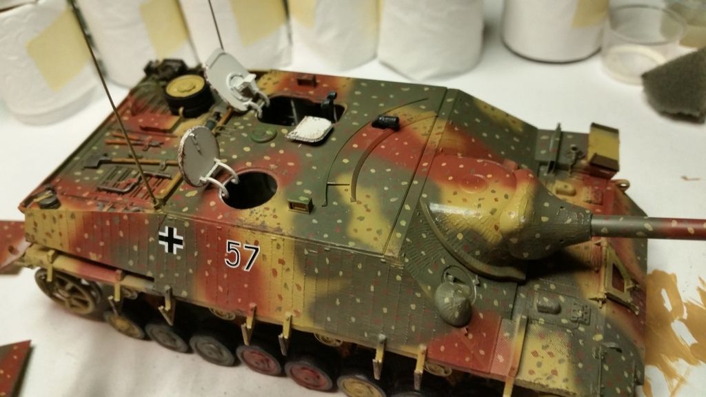

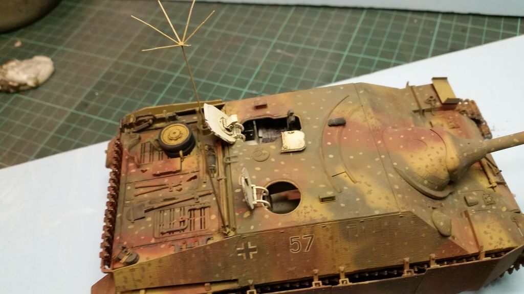

hi guys
so i am back with another update

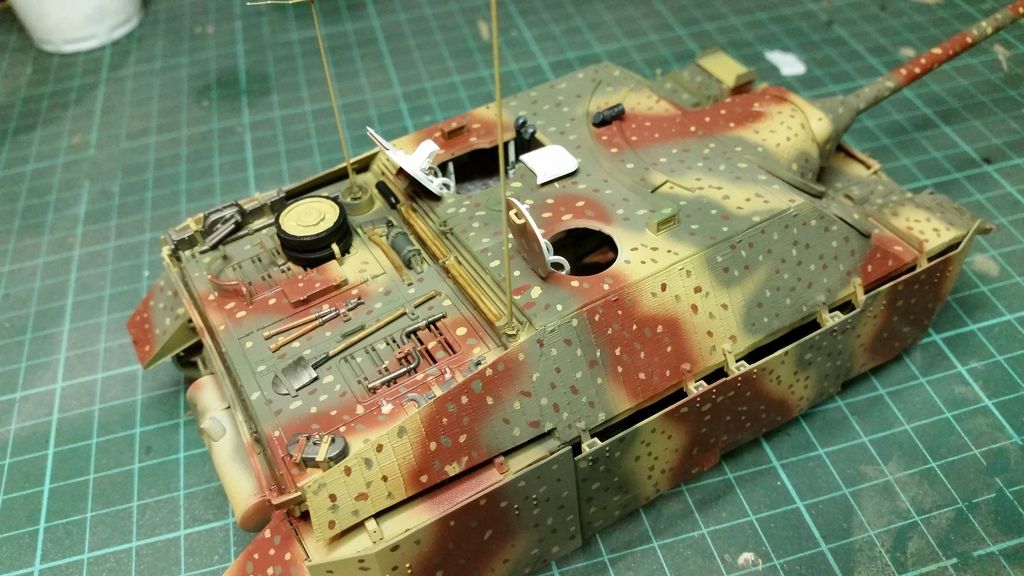

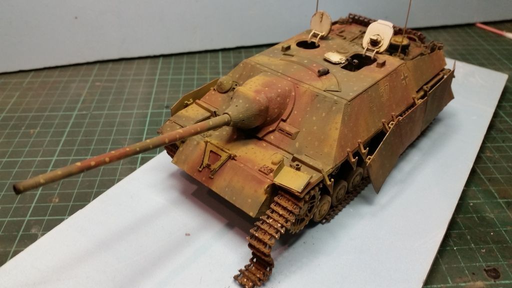

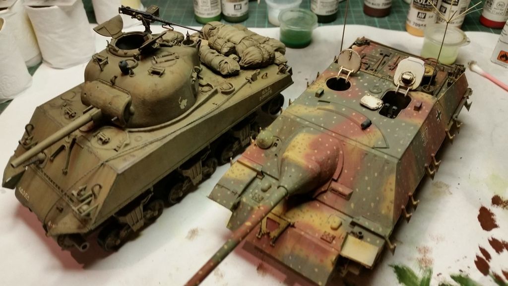

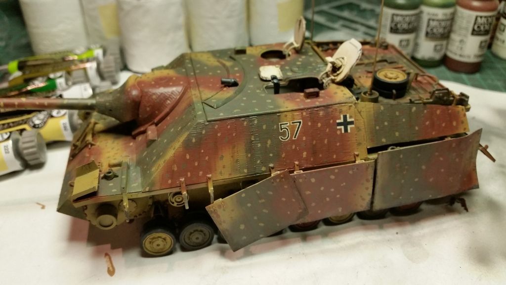

this time i will go over the painting stages of the jagdpanzer IV
i also had a small change of my plan

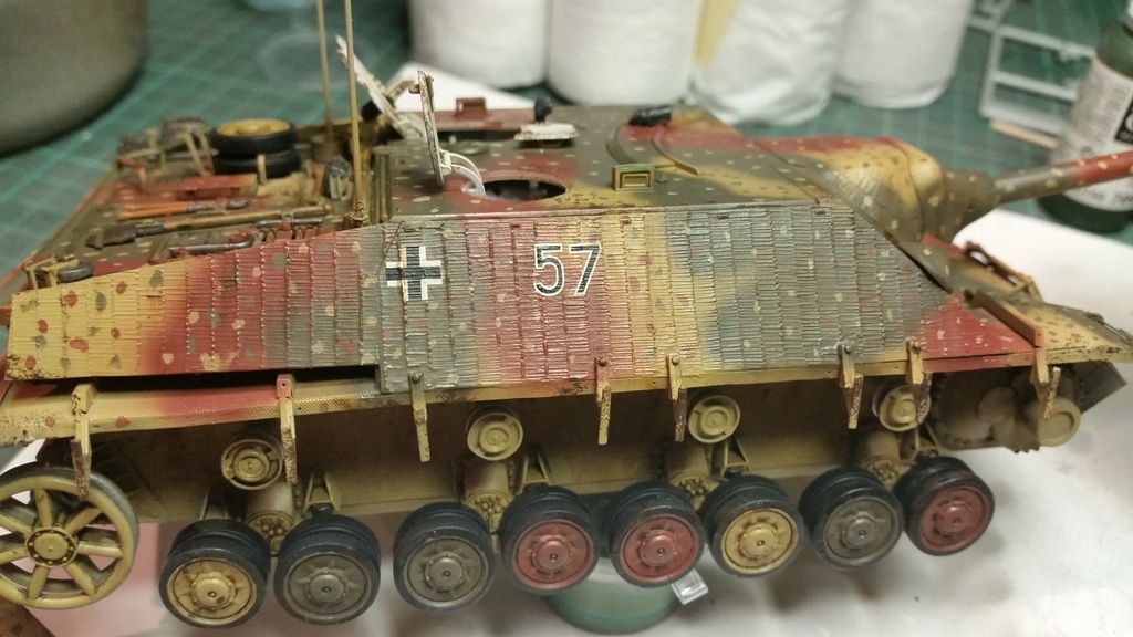

i wanted a vehicle with a ambush camo scheme but as i already have a Jagdpanzer IV i thought it would be nice to have this one without the side skirts
but the problem was that most ambush camouflaged vehicles had colored road wheels
so after i had a look i decided that i will add the side skirts because i didn't like the look of the colored upper hull and wheels with the large dark yellow space in between them
so i will start there and then go back to the painting

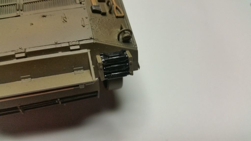

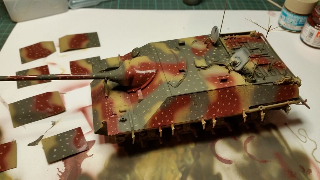

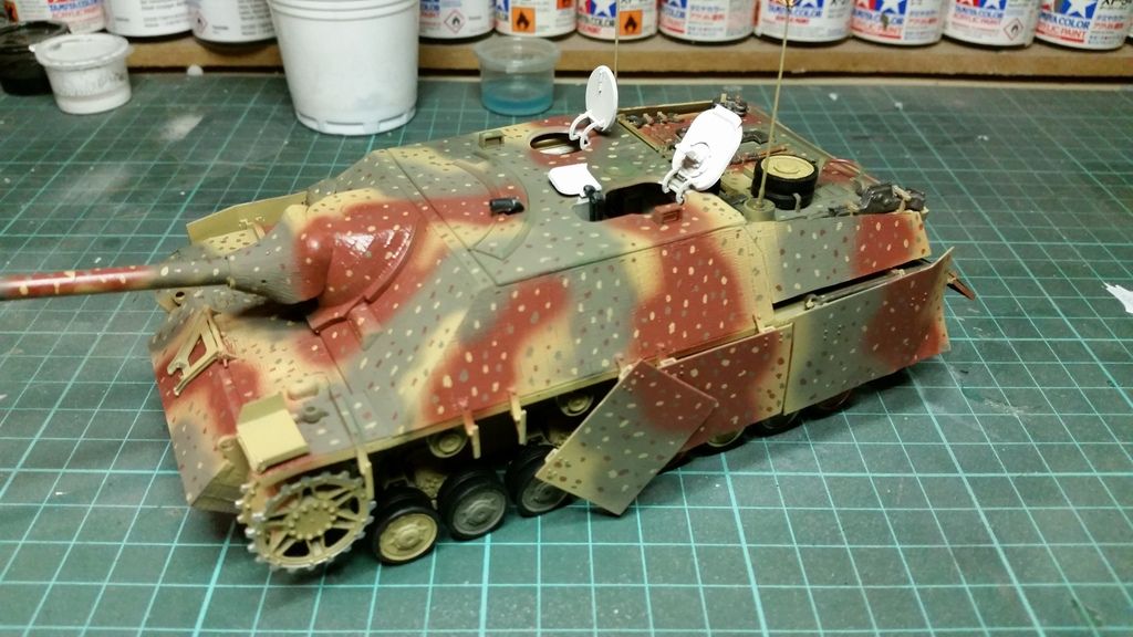

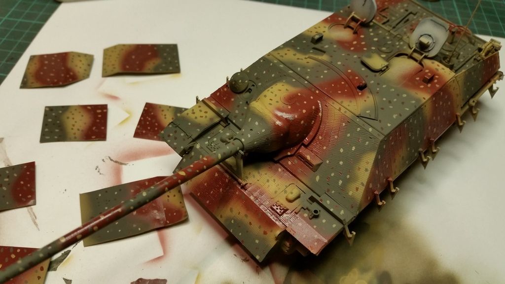

as you can see the vehicle is already in the basecoat

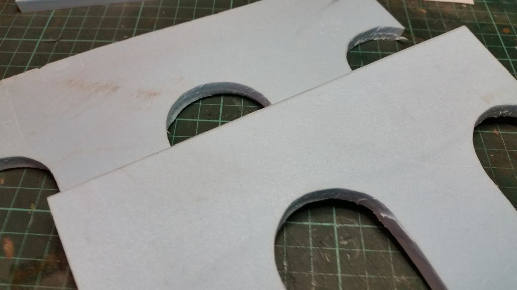

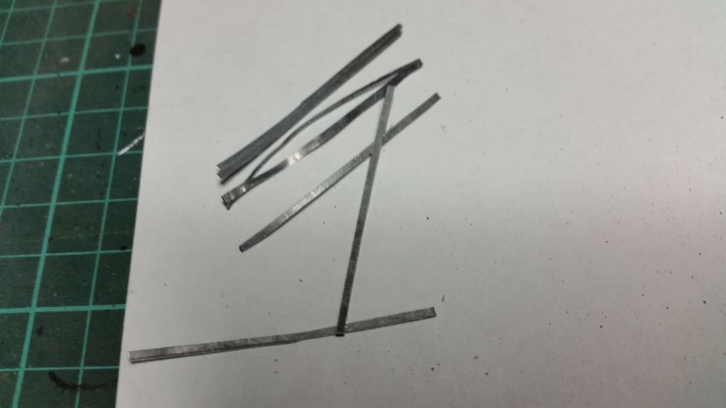

the side skirts are from the kit
they where in full lenghts so i used a knife to seperate each panel
next i used a pair of pliers to bend and dent the panels
i could have been a bi more carefull as i accidently cracked 2 on the panels in the proces so i had to use some TET to make sure i wouldn't damage them any further
so back to painting

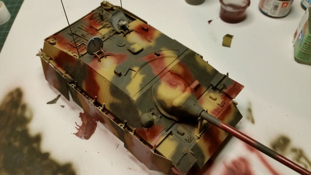

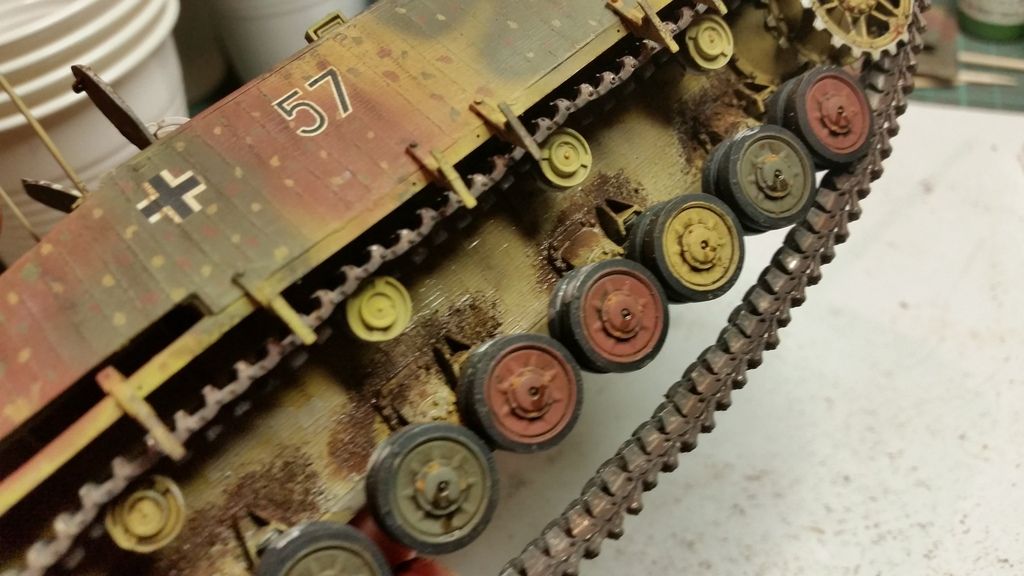

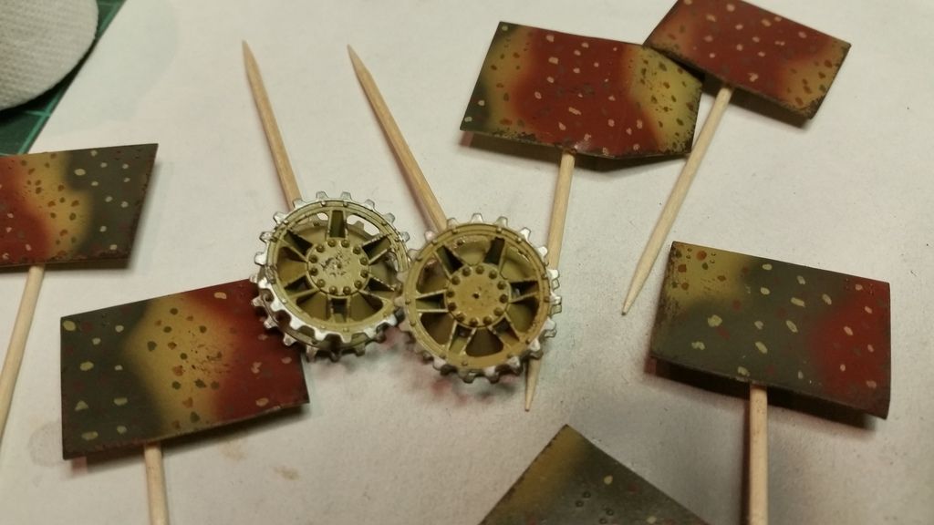

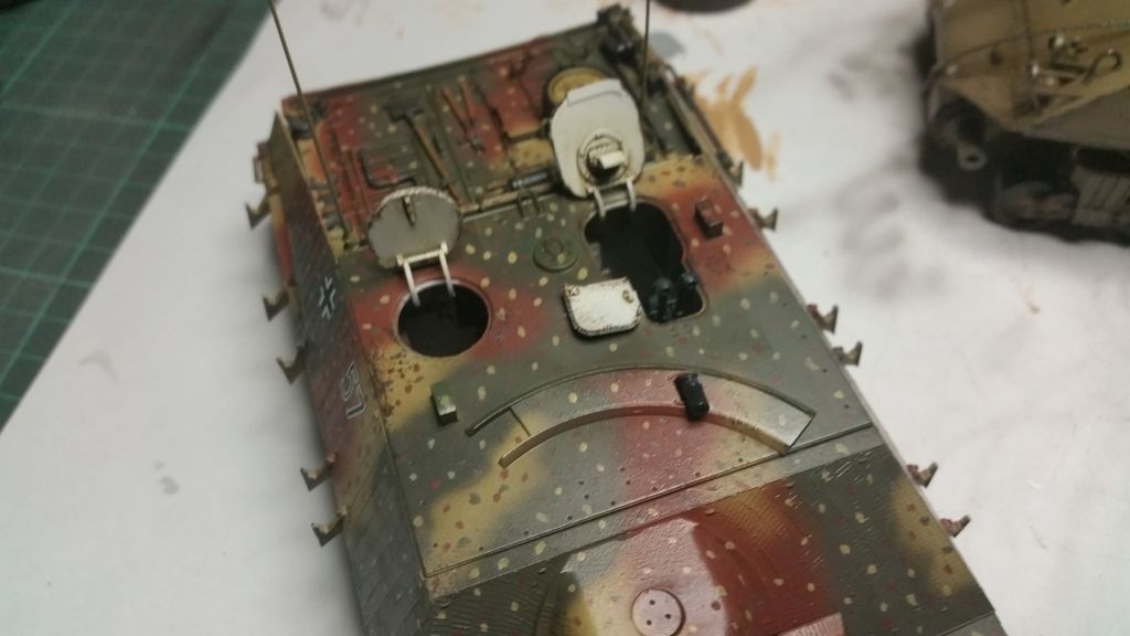

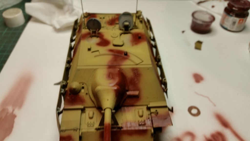

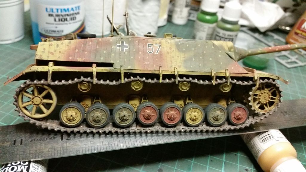

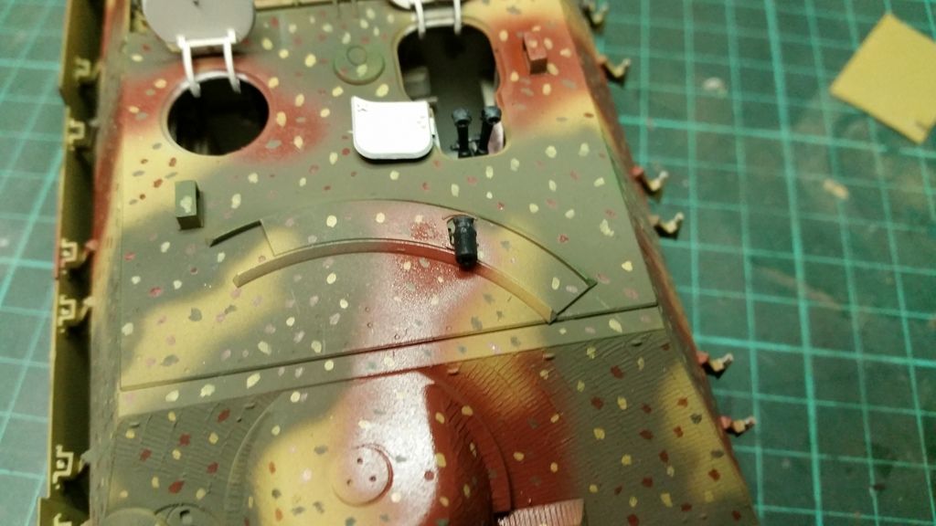

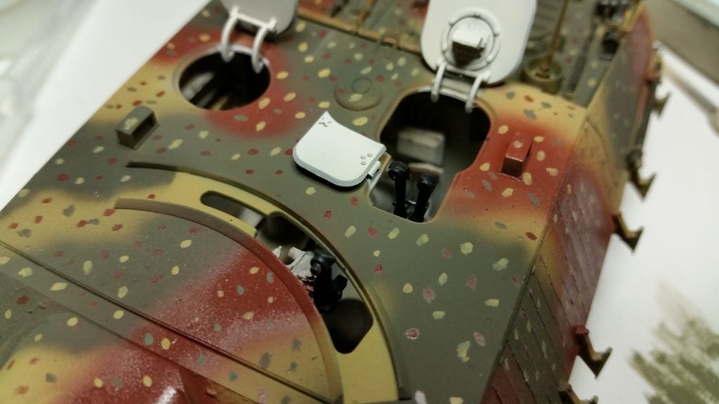

the basecolor is Mr hobby aqueous H403 dark yellow
this is made a bit lighter by adding sail color from the same range
it is similar to tamiya's Buff but a little bit darker
the first camo color i add is always the red brown (if i have a tri tone subject)
as i didn't have enough of the tamiya color i used the Aqueous red brown wich has more red in it but the coats of varnishes and weathering later will make it look less red then it is now
then the dark green was added
i used Tamiya xf-61 for this wich was also slightly brightened with a lighter color
in this case i used the buff color to do this

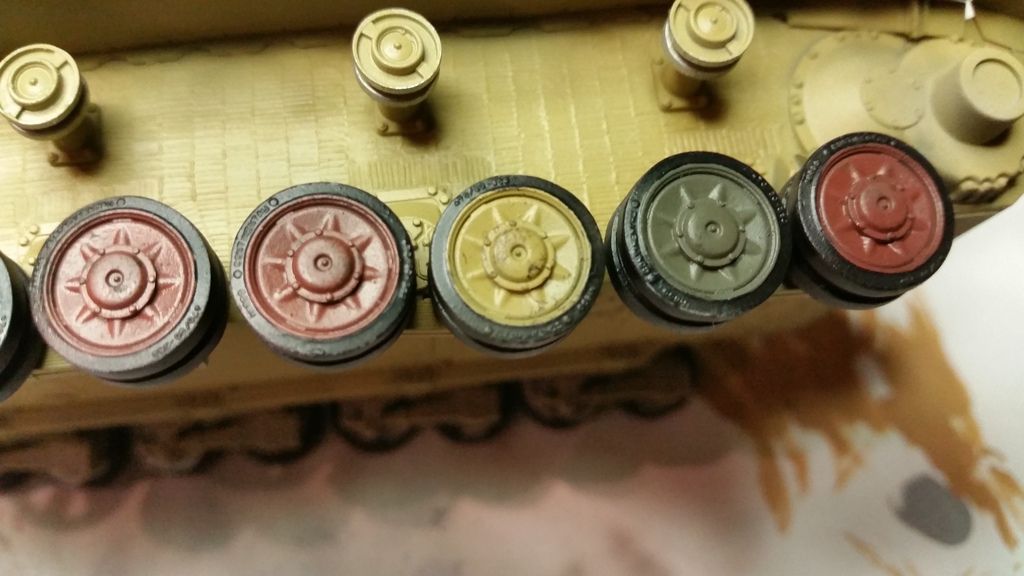

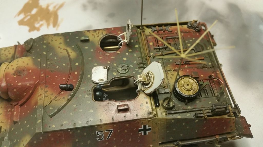

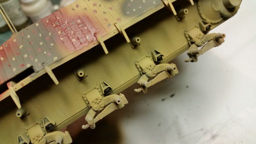

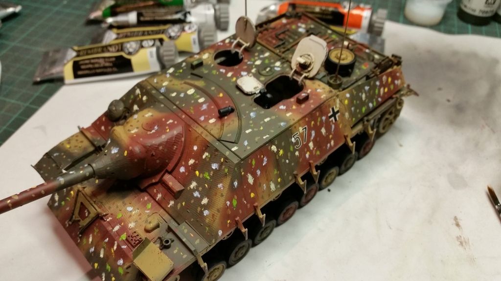

then i started with the dots
i started with the base color
i have heared some other modellers (not on here but at a show) say that you can't do this with the tamiya and aqueous paints as they dry too fast
i don't agree , this is the same paint as the base color but i added a bit more thinner
this makes it possible to paint them without any trouble
brush painting large areas with these paints is a tougher job though as they do dry fast
the red brown dots
and finally the dark green ones

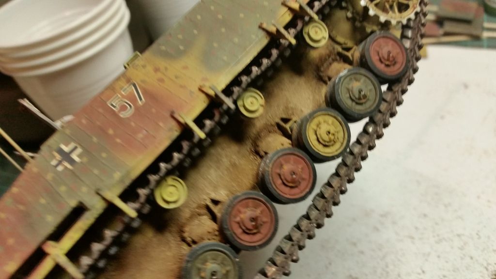

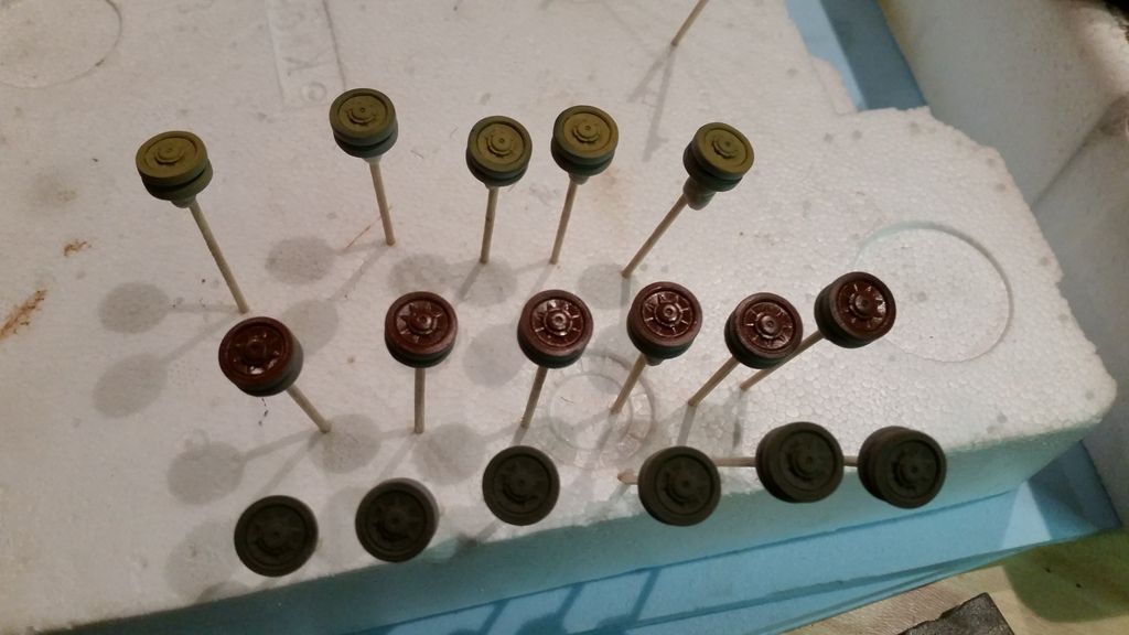

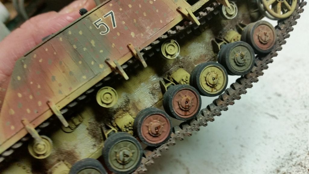

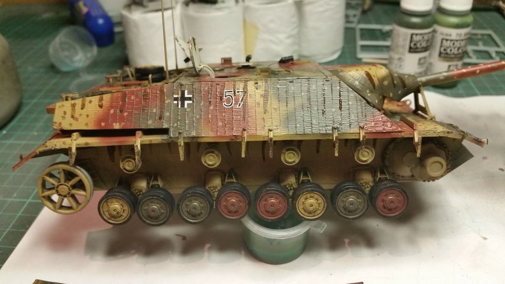

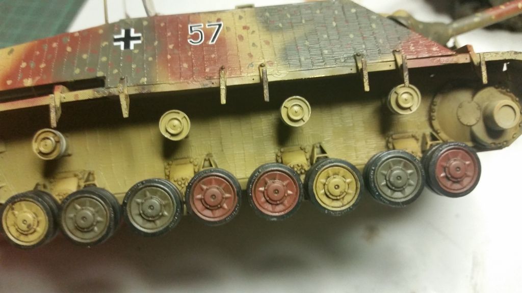

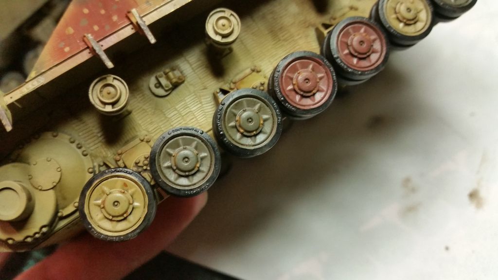

once i had a idea on how the camo looks i can see wich color is above a road wheel
i then counted the wheels that should have a certain color and sprayed them

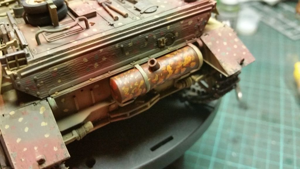

i then painted the tyres
i used aqueous tyre black for this and again with some thinner in it ,it was brush painted on the wheels

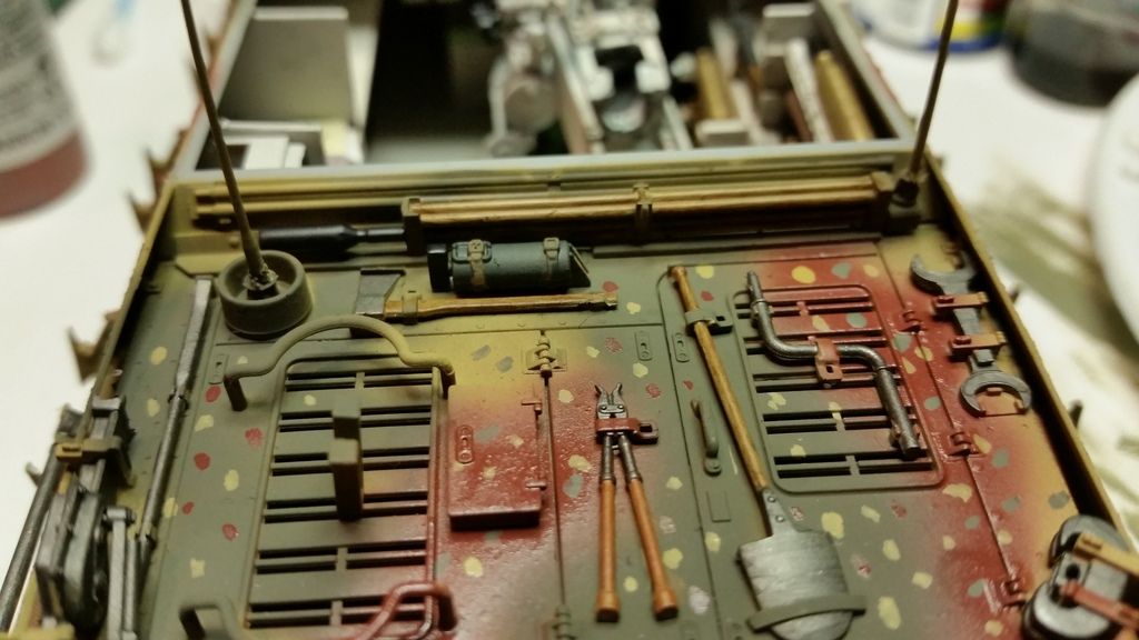

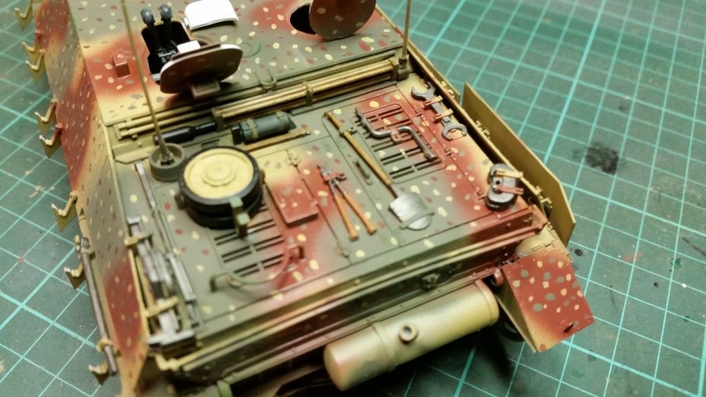

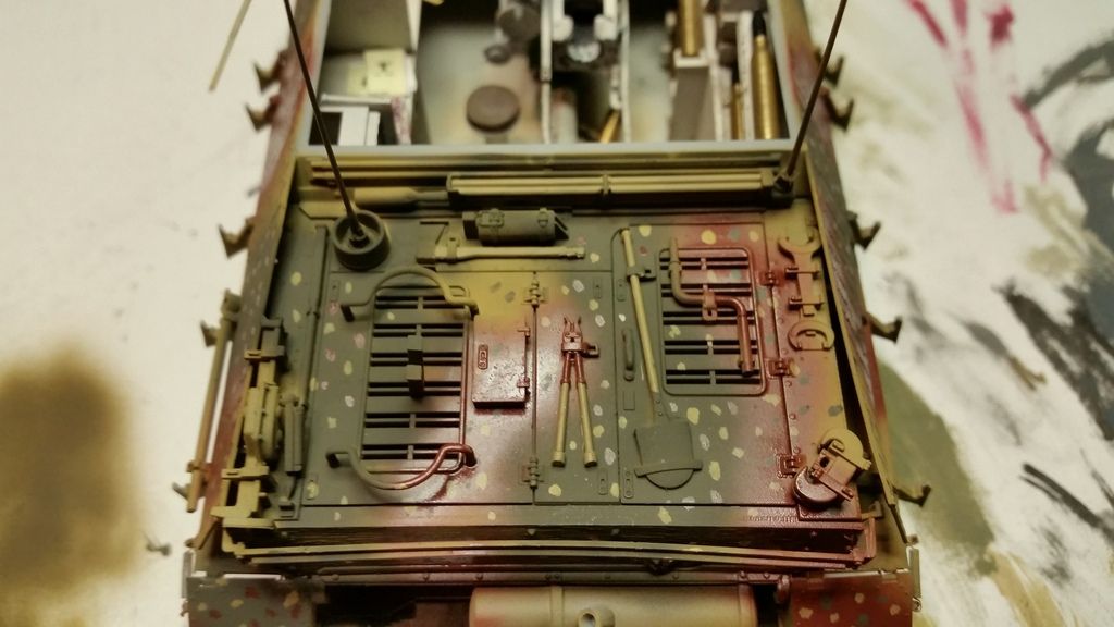

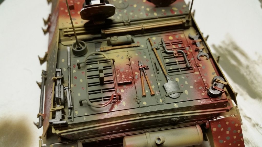

then it was time to paint the tools
i start with the handles wich are painted in a 4:1 mix of modelcolor English uniform and white as a basecolor
i did this with the cutters aswell but thos will get another finish as they are made from bakelite instead of wood
the next step for the tools
the wooden parts where dry brushed with modelcolor smoke
i do this with long strokes so i get a long woodgrain effect on the handles
the cutters where dry brushed with a mix of flat brown nd orange brown
i didn't really liked it at this point :scratch::
so to fix the look on the cutter handles i used the modelcolor orange brown again but i thinned it with water roughly 2 parts paint to 1 part water
this allws you to add very thin layers untill you get the color you want

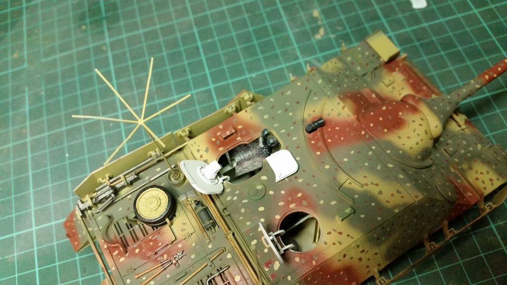

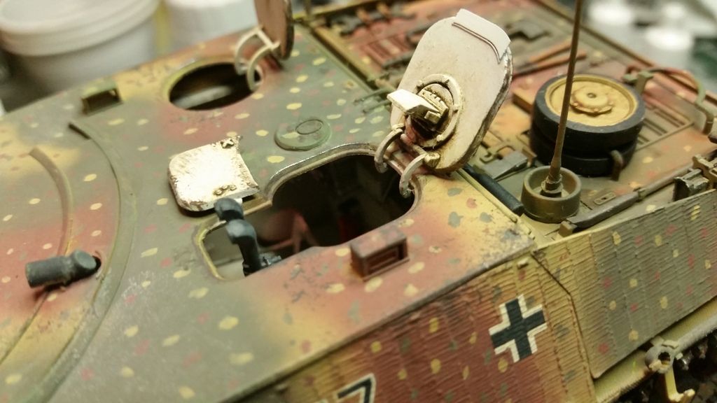

i then painted the metal parts of the tools
i used mr metal color stainless steel for this
it is one of the range of buffable paints but if it is brush painted the buffing effect is very minimal with this color

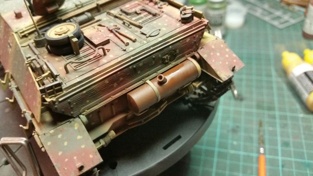

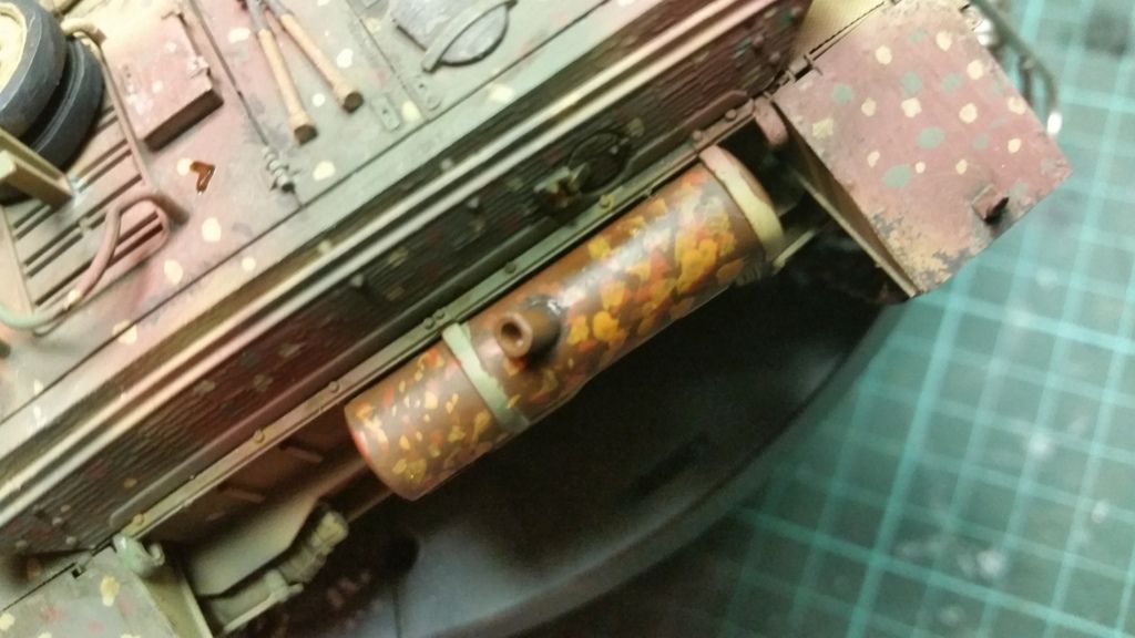

the periscopes where painted black and the interior side of the hatches was painted in the same color as the rest of the interior
i then painted the fire extinguisher (almost forgot the thing)

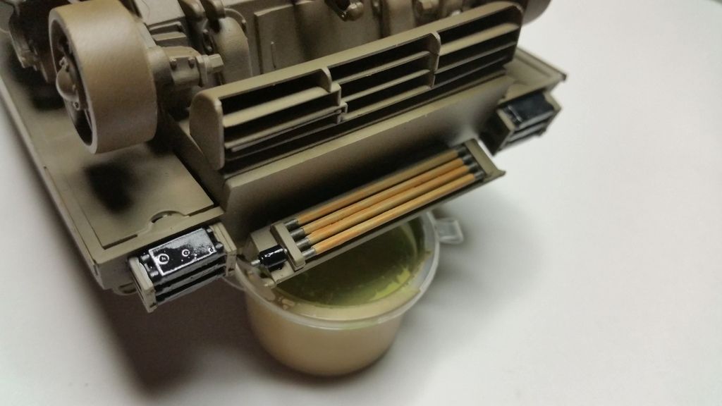

i used black for the top part and modelcolor extra dark green for the rest
the bump stops where also painted with tyre black as they are supossed to be made out of rubber
the return rollers , idlers and drive sprockets where first painted with mr metal color aluminium
i sprayed this on there , then i buffed the paint to get the shiny result like you see here
once the paint was fully dry i added a coat of varnish (satin i think)
a day later i sprayed 2 coats of AK worn effects chipping solution on them
this needs to dry for 15 to 30 minutes don't wait much longer as you need to get painting once it is dry because this product looses the chipping effect over time

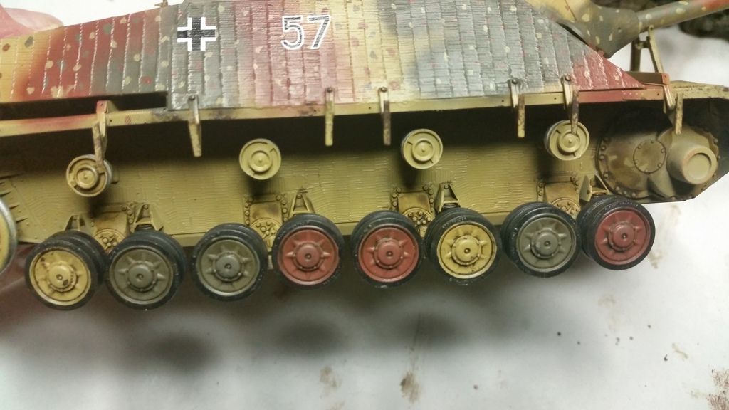

then the wheels where painted with the vehicles base color
waiting for another 30 minutes i added some water on the parts where i think the paint would completely wear off
and this is the result
the wheels where put in place
the drive sprockets are friction fitted all the others are glued in place
the spare wheel was put in it's place
i decided to only add 1 so i don't get the look like this thing just drove out of a service depot
so once the roof was finally glued in place i added the small extension for the gunners sight
and now i have a mini reveal like i did with the Sherman
and you can still see the inside
it still needs the tracks but i have to be honest i didn't have a single day that i was feeling like it to make them
but i have a 3 day weekend starting sunday so maybe i can get them drilled out and burnished then
the vehicles are already half way through the weathering stages and i can start the oil fading tomorrow as the varnish base is still drying
so if all goes according to my plan i can have a little trip to the hobby store next week for diorama supplies and still finish both vehicles and the figures
but it depends on the oil paints if i can finish the vehicles that fast , i never used the oil dot fading before and i have no idea how long it takes for them to dry (only that it can be a slow proces)
so that is all i hve for now
i hope you like it
thanks for stopping by and untill next time
cheers ,Mark

Hi guys
So for now i have a little teaser on the vehicles
I finished them half an hour ago so not all the pics for the updates are uploaded yet
The sort of reveal photo's are ready to go so i thought i would post a few and try to do the updates on them tomorrow as updates uasually take me a hour or more to make (slow at typing)
So here is the Sherman
And ofcourse the main subject of this build
The Jagdpanzer L/70
So that is all i am showing for now
I hope you like them so far
Thanks for stopping by and untill next time
Cheers Mark

hi guys
so as promised here is the first of the 2 updates about the weathering stages of the vehicles
i will start with the jagdpanzer IV
once the painting was done i covered the entire model with a coat of Vallejo satin varnish
i think that the satin varnish is good enough as a base for decals
if you use some decal solution to make the decals set better they will go down on the surface without any problem
once the varnish was dry i added the decals and the chipping

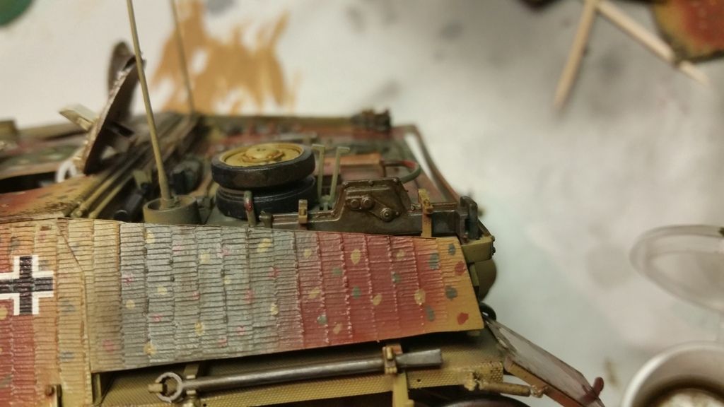

i added the chipping using a sponge and Vallejo modelcolor german camo black brown wich is a very nice color for this
i applied the chipping around hatches and on the plates where the crew would be walkingwhen they get on or off the vehicle
i didn't do this on the parts where there is zimmerit as zimmerit is a mix of sawdust and concrete so it can't rust but only show small amounts of rust where metal parts stick through the zimmerit coating but that would be more like streaks then actual rust
i aslo made some chipping on the wheels and the side skirts
i actuall added more chipping to the side skirts as they would shake around while the vehicle is on the move so they would bump in to eachother all the time causing a lot of paint chipping and damage on the edges of these plates
after the chipping was done the vehicle was covered in a coat of Alclad aqua gloss
once that had time to dry i applied the wash
i used AK DAK wash for this ,wich i use for most of my german armor
the wash is a dark brown wash wich looks pretty similar to raw umber for those who use oil paints for their washes
i then started to remove all the unwanted wash that was on the model
i only want the wash to be around the raised details and in the recessed places
i then started the streaking effects
for this i used the AK streaking effects for dark yellow vehicles but there is some ruststreaking on there aswell but only on the dark yellow and red brown because this color is very similar to the other streakingcolor it would be nearly invisble on the dark green
the streaking effects are basicly a thicker wash wich allows you to make the streaks by pulling the paint down with a moist flat brush
to complete the streaking effects i used a flat number 2 brush wich i moistened with thinner
be sure that the brush is only moist and not soaked as you will only need a small amount of the thinner as too much thinner will remove the streaking all together
the streaking is very hard to see on the sides of the upper hull part because of the zimmerit but the same would happen in real life as the dirt will go down 1 layer and then fills up that recess before it goes down to the next
the effect is more visible on the side skirts wich are flat
to have some more rust and especially on the dark green i used some mig prod. light rust wash
this is easy to see on the dark green and provides you with a bit of contrast with the light orange rust on the dark back ground
i also used this around some of the rivets
and again using a flat brush i "refined" the streaks a bit
i also added some of the rust wash on the wheels and various tools like the jack and the shovel (not in the photo)
once all that had time to dry the vehicle was covered in a coat of satin vanish from Vallejo
then it was time to bring out the oil paints
i used the following colors
sap green
transparent white
napples yellow (light yellow)
cadmium yellow (bright yellow)
permanent red light
the oils where applied in dots all over the vehicle
i used the lighter colors on the upper parts and the dark ones on the lower parts
the red was only used on the engine deck
that was tip i had from a book wich suggested that it gives a warmer look to the part of the vehicle wich actually becomes warm in real life
i however just followed that suggestion to see how it would turn out
to work with the oil paints i used a number 4 and a number 8 round brush and the same AK thinner i used with the washes
i removed almost all the paint leaving a thin layer on the model to fade the entire vehicle
after about a night of drying time i applied the final clear coat wich is AK's ultra matte varnish
i only thin this a little but so it still won't spray very well but i raise the pressure to about 30 to 35 psi wich helps to make it spray very smooth and gives a very nice and even finish
i then started to work on the friul tracks
i start by drilling out the holes
then they had a bath to remove the mold grease
and after a quick drying using a old towel they where put in the Ultimate burnishing liquid
and as you can see the result is very nice
i still had some airbubbles or grease residue on them but all on the outside of the tracks wich can be covered with pigments later
then the tracks where fitted
the drivers side track is damaged but that is par of my plan as the Jagdpanzer will look like the track is hit by a HE shell wich caused it to break and the crew then abandoned it as they where under fire so they didn't have time to fix the track
something i should have done earlier in the build but i wasn't sure how i wanted to make the rust effects on it
so i started out with the old rust from the Ammo for Mig rust set
then using the dark and medium rust from this set i made spots all over the exhaust
i did this to get some color variotion later on when i add the pigment
i also added a ring of shadow rust around the welding seam of the exhaustpipe
i then added mig prod. railroad rust pigment on the exhaust
the same pigment was added to the spare tracks
just before the pigments i added some bare metal to the model
i used a regular HB pencil for this wich i moved up and down several edges all over the model but all are places where you would expect regular use of a hatch or part
i also repeated this on the edges of the side skirts as those would hit eachother all the time when the vehicle would be on the move
i also added some oilstains on the engine deck and the roadwheels wich would often leak some oil

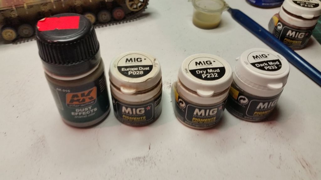

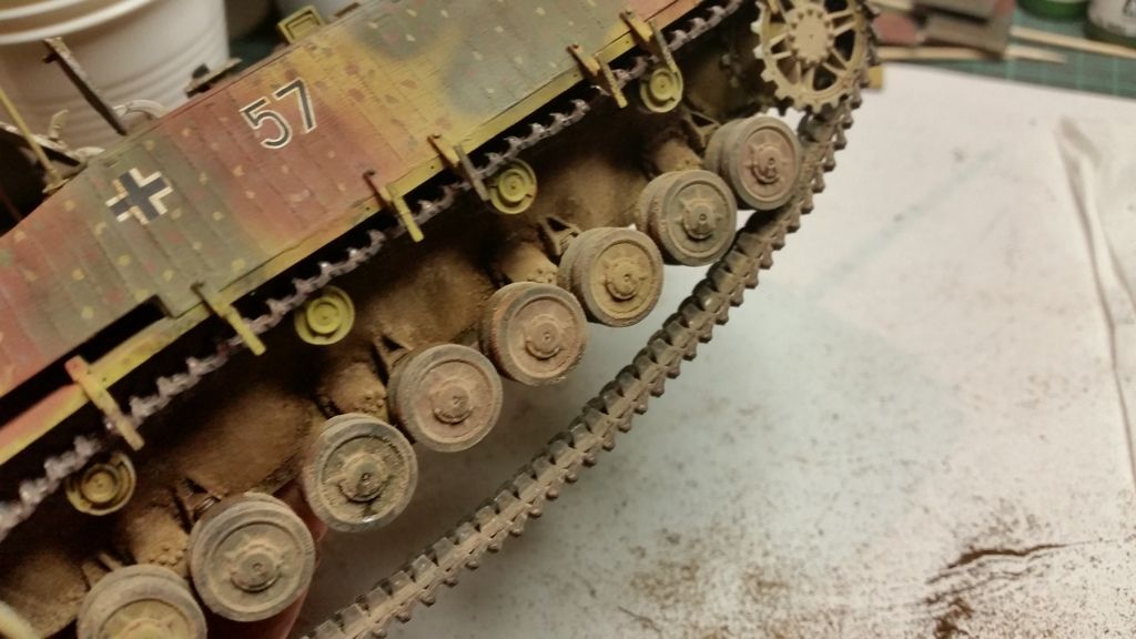

then it was about time for the pigments
i use the Ak dust effects as a fixer instead of the regular fixing agents
i started out by brushing on the dust effects on the lower part of the vehicle
then the dark mud pigment was added
this will simulate the darker wet mud
the the europe dust was added
this should look like the slightly moist/drying mud
then the dry mud was added
i used this only in the middle between the wheels and places where there would be more sunlight to make the mud dry
the wheels where also covered with the dry mud pigment
then using a cotton bud/q-tip to remove the pigments from the running surfaces of the wheels
the insides of the mudflaps also received some pigments
and the tracks where covered with the european dust pigment

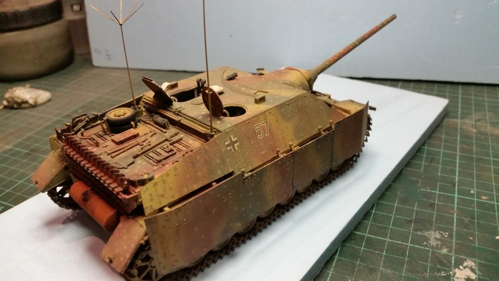

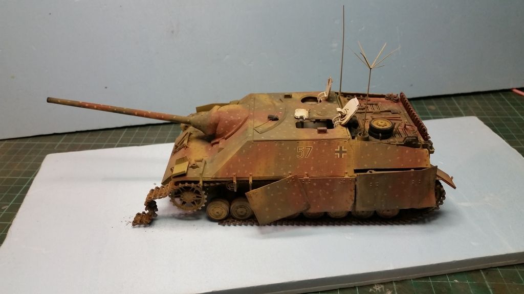

i then started to add the dust layer on the vehicle
i make small spots of pigment and use a large (#8) brush to cover the entire panel
and then it looked like this

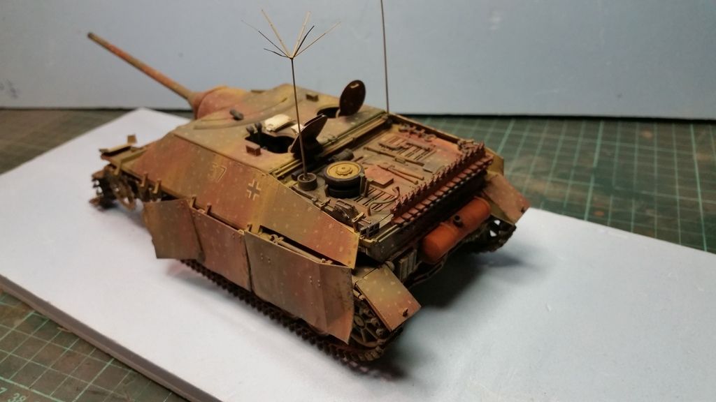

i added some black smoke pigment to simulate soot around the exhaust pipe
the same was done on the tip of the barrel
to make it look a bit more intresting i used the pencil again to make the edges look like they are in bare metal
i covered both the inside and outside
i then added the side skirts for the last time and called the jagdpanzer IV finished
and now i have a sort of mini reveal for this vehicle

i started with the chipping
i used Vallejo modelcolor german camo black brown and a small piece of sponge for this
once the chipping was dry i sprayed the model in a new coat of alclad aqua gloss to seal it in
the bottle instructions call for a drying time of about 6 hours but i usually do the sealing at the end of the day and it can dry during the night
i then applied the wash ,this time i used the AK OIF/OEF wash wich is meant for modern dessertised vehicles
but you can use it on dark green vehicles aswell as it has a very dark brown color
i then started to remove the excess wash using AK thinner and a flat number 2 brush
the next step where the streaking effects
i used AK OIF/OEF streaking for this wich is the same color as the wash but it is thicker
as a experiment i used Dark green streaks on the lower hull to get a effect of wet streaking but it didn't work out all that well so they where removed completely
then with the use of the same brush and thinner as i used in the previous step i started to make the streaks thinner and thinner untill i got to this result
after this had enough time to dry (3 hours) i sprayed the Sherman in another clear coat but this time i used Vallejo satin varnish wich will serve as a base for the oil dot fading
i then went on to the oil paints to do the fading
at this time this was my first attempt at this technique
i used the colors you see above wich are
sap green
olive green
permanent green medium
transaprent white
napples yellow
pale yellow
i then applied the dots
the darker colors where used on the lower parts of the hull and turret
then i started to use lighter colors as i worked my way up and the lightest colors went on the flat surfaces of the hull and turret
i used AK thinner and a large (#6 or 8) round brush to pull the oils from the top to the bottom
once the most of the oils was removed i had this result
i think i removed a little bit to much but for a first try i am happy with it
the overall look after the oils
i applied the last coat of varnish after the oils had a day to dry
i prefer the AK ultra matte varnish for this as it dries very fast and gives a nice finish
it dries very fast when you use your airbrush as a blowdryer :mrgreen: :thumb2:

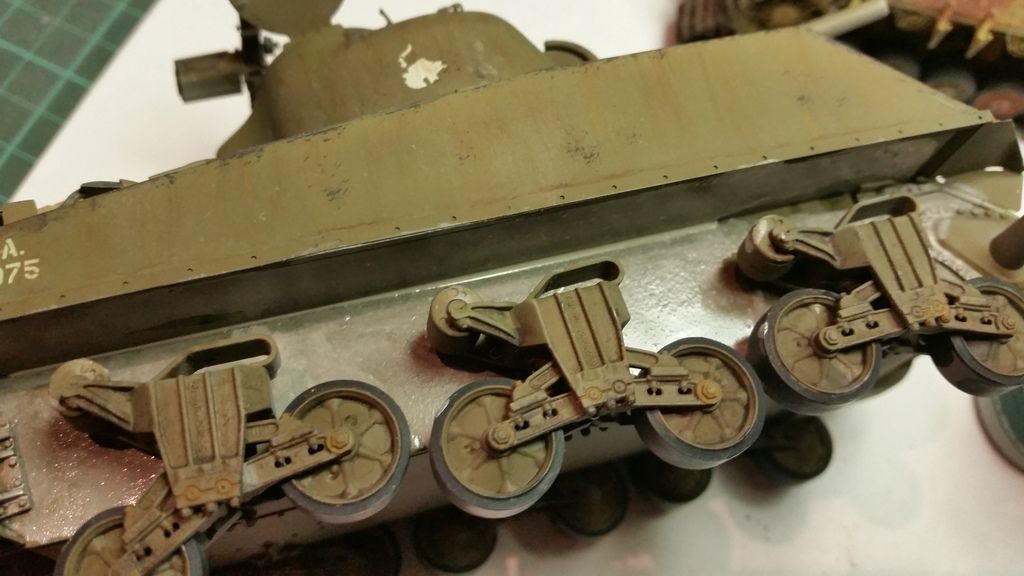

i then applied some fuel and oil spills
they are both done with AK products that where made for these effects
the barely visible exhausts where painted with the Ammo rust set
i used old rust as a base and made dots with dark and medium rust
and here the Mig prod. railroad rust pigment is applied
you can still see the spots through the pigments
i applied the Mig prod. rust effects wash on the towcable
it will build up more in the recessed areas so it only looks partially rusty
i also added some of the rust wash on the boogies

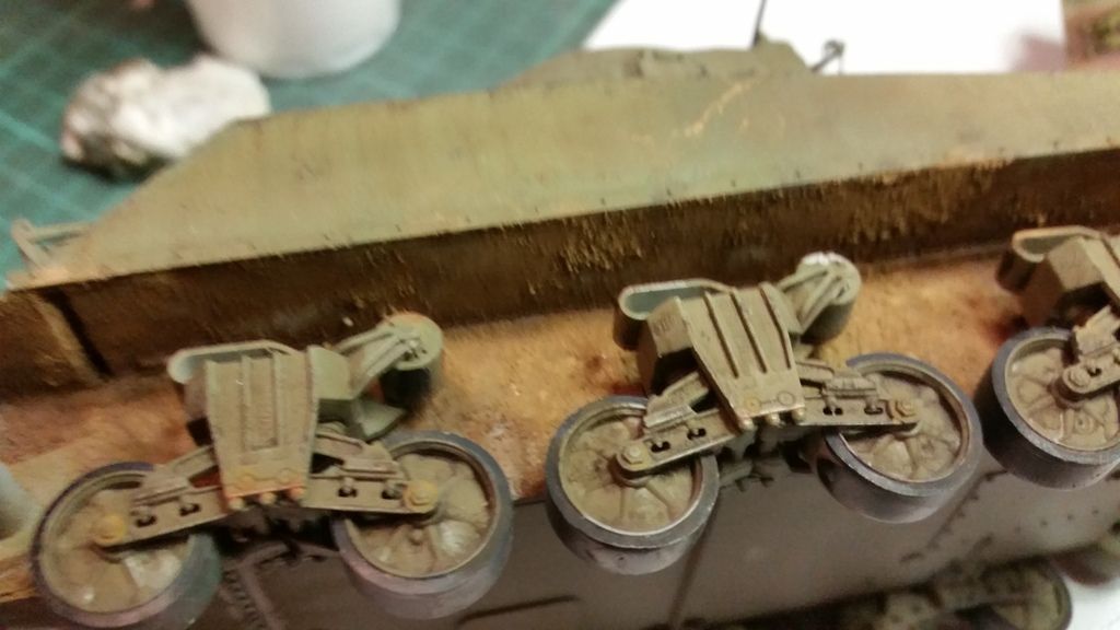

and i did the first step of the mud
i don't use a pigment fixer but i use Ak dust effects wich is a very thin and flat drying dust colored wash
this is brushed on all the parts where i think mud would be able to get to and where it could be for a long while
i added the first pigment wich is dark mud
i use this color to get the look of wet mud
the second color is european dust wich looks like moist mud but still gives the look like it is already drying
and in the most expossed places i added dry mud pigment
i then added the dry mud pigment on the tank by making small spots like you see here
and with a big flat brush they where moved over the surface of the tank
the tracks also received pigments
i used the european dust and dry mud for them
i started to put them on the tracks like this
i then blanded them together with a big brush
this also helps to cover the entire track surface
as a last step i rub my thumb over the chevrons to clean them a bit
pigments will stick to your fingers as those have a little bit of natural grease and oils on them so it helps to remove the unwanted pigment
do make sure you wash your hands after this as you don't want to get our pigments all over the place
the tracks where then placed on the tank
i used some black smoke pigment on the muzzle of the gun
to finish the barrel i used a HB pencil and rubbed that on the inside and outside of the barrel to make a worn effect
and some black smoke pigment on the exhaust
this was the last step of this vehicle build
it will get a commanders figure later on but that is not finished yet
so like i did with the Jagdpanzer ,here is a mini reveal for the Sherman
and that is all i have for now
i hope you like it so far
cheers,Mark

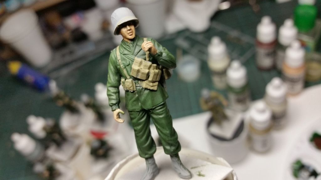

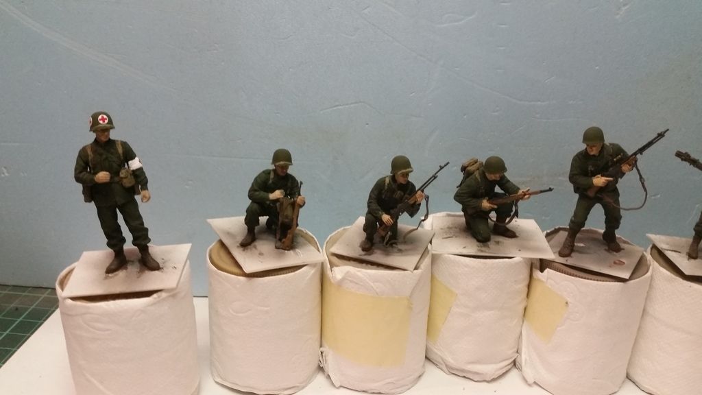

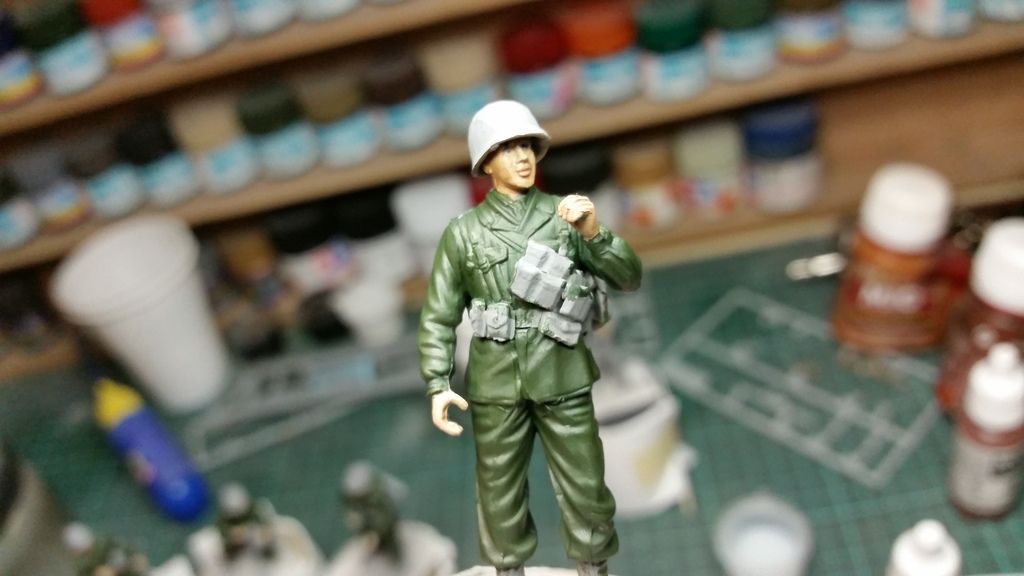

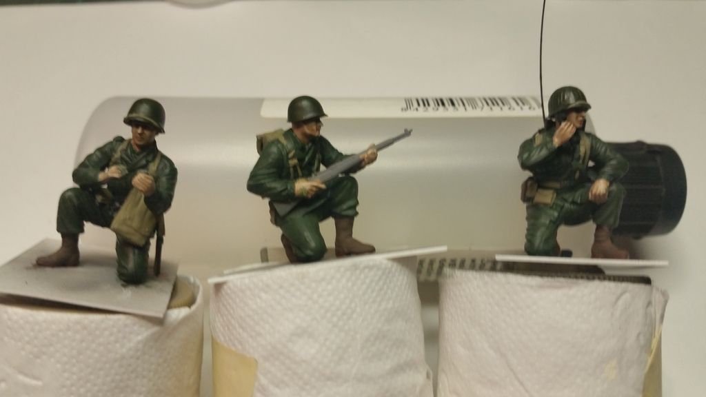

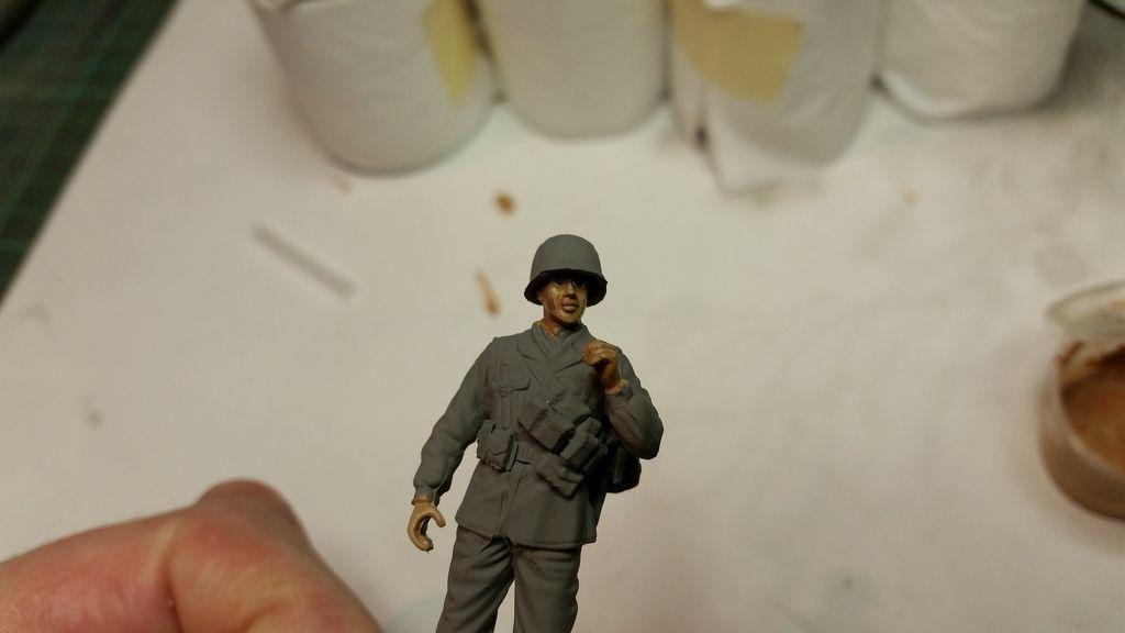

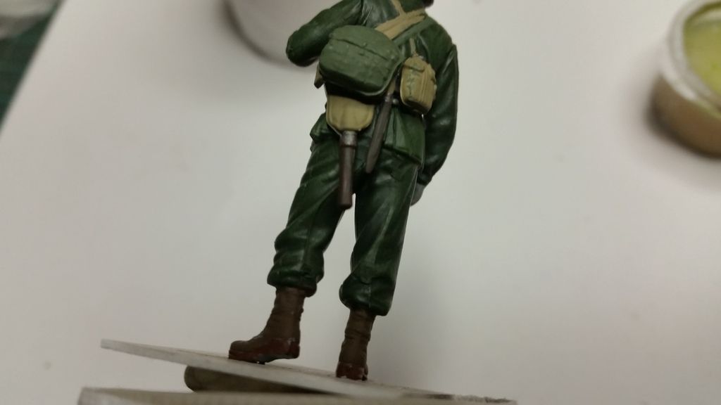

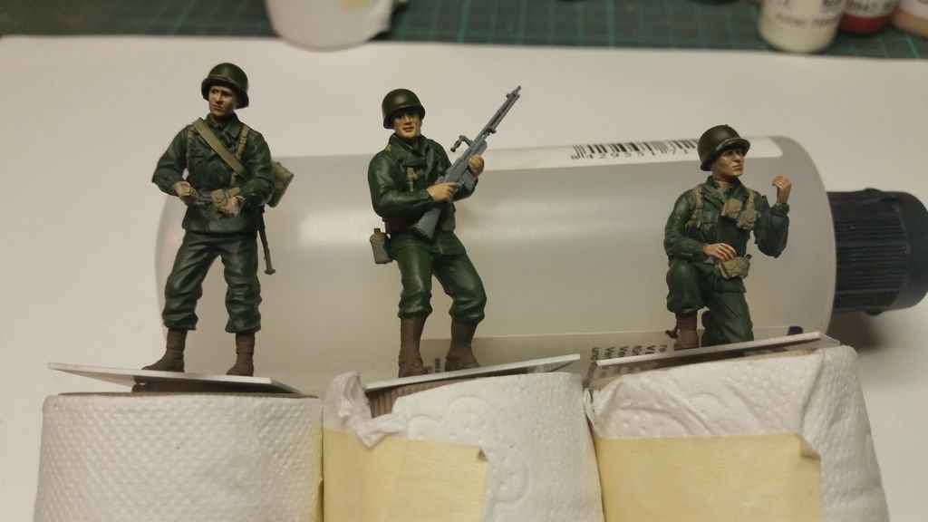

so i tried a new method (for me anyway) to paint figures
i Always find the skin tones the hardest of figure painting so i was looking for a new method to make it look better and make it a bit easier
but here is what i did with the figures for this build

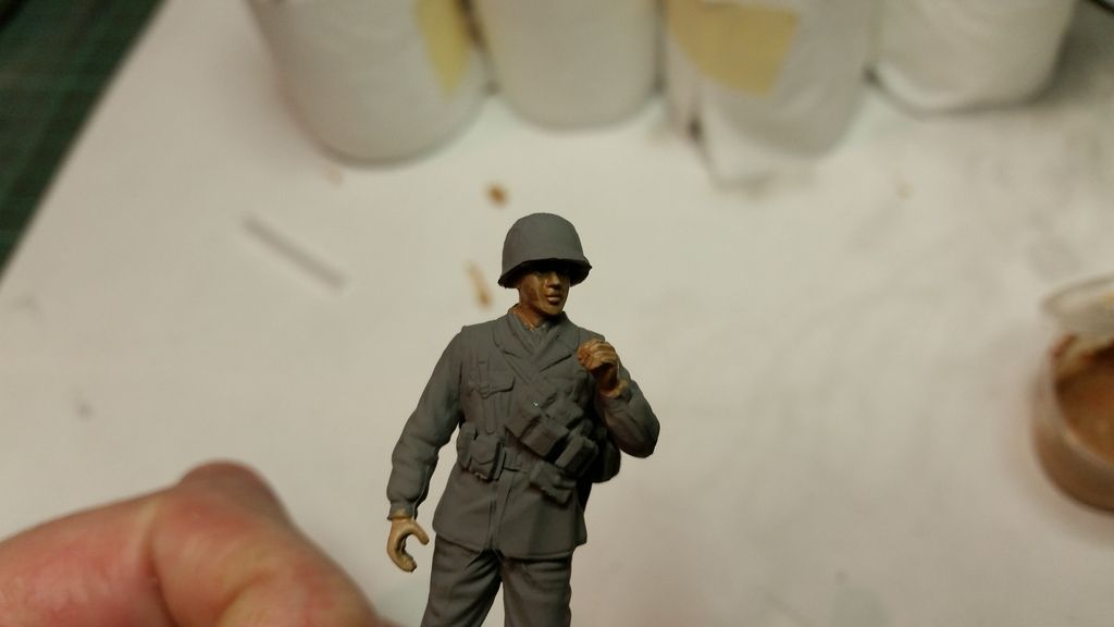

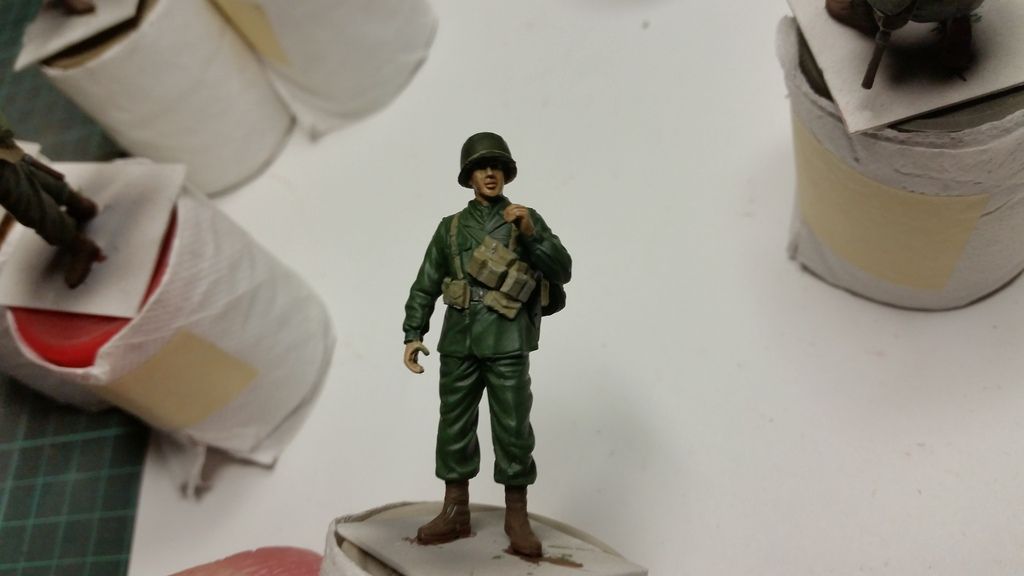

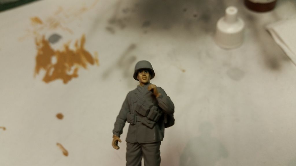

i didn't actually primed them as i am not happy with my primers lately so i used a dark grey from tamiya to use as a "primer"

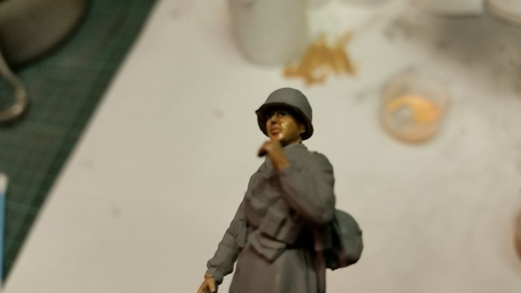

i started out with painting the eyes
i used Vallejo modelcolor paints for all the paintwork so i will just call out the color names from now on (saves me a lot of typing :th: )
the white is actually Ivory as white would look too bright , the iris is painted with dark prussian blue
the darkest and first color i used is dark skin tone but i mixed in some english uniform wich is a light brown to make it darker
this will be my basic shadow color aswell
i then used basic skin tone wich was applied all over except the parts that would need the shadow color
then i found the shadows to be too light so i mixed some basic skin tone and flat brown and re apllied the shadows
then more basic skin tone to tone down the shadow
after about 5 highly diluted layers it was looking okay to me
i then mixed the Ivory and basic skin tone to make the highlights
allthough they are a bit hard to see here ,you can see where it is as it is still glossy

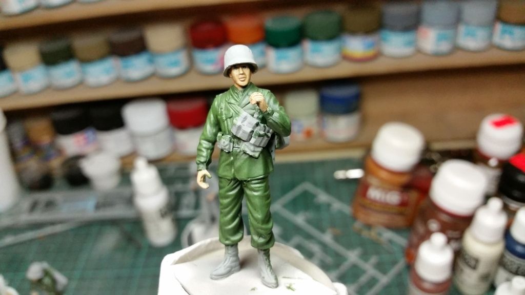

after the highlights i was happy with the skin tones and continued with the uniform

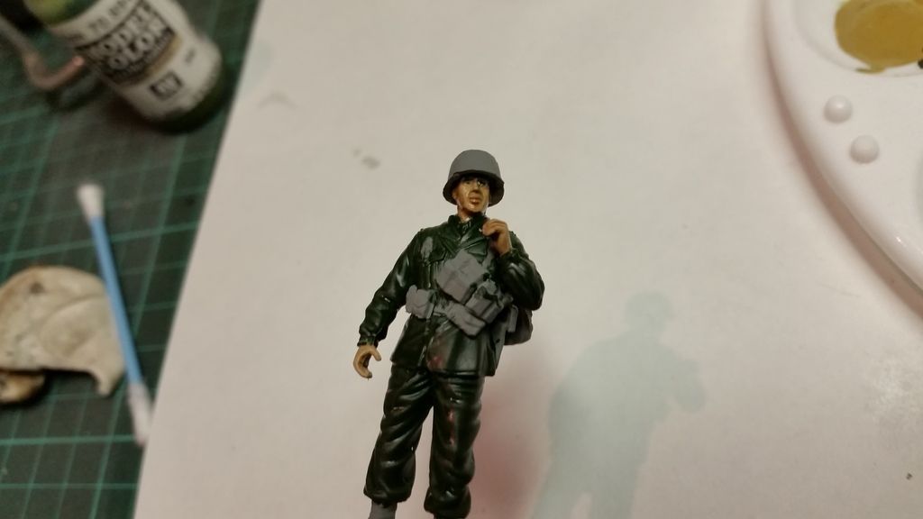

again i worked from dark to light
so the shadow color for the olive green uniforms is military green
i used german camo olive green as a basecolor for the uniforms
being carefull to not paint over the deeper folds in the uniform
to make the highlight color i mixed a tiny amount of pale sand into the olive gren and dry brushed it on the highest parts of the folds
for the ammo pouches and parts of the overall gear i used khaki
most of the figures have this big bag on them wich i painted with a light green color wich was mixed with pale sand and a drop of olive green
the handle of the shovel and the case of the bayonet are painted with olive drab
the metal parts where painted with mr metal color stainless steel
the boots where painted in leather brown while the soles where painted in flat brown
the helmets where painted with mr hobby aqueous khaki green wich was the recommened color form dragon
i used some field grey to drybrush the helmets with the camo netting on them
the belt buckless where painted with gun metal grey
and then the basic figures where painted

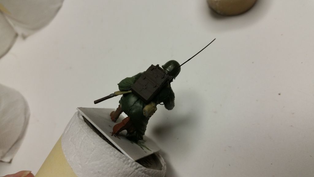

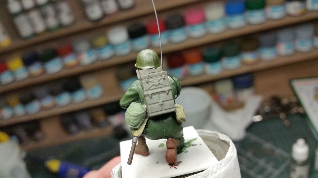

but some of them where different as 1 has a radio and there is a medic aswell
the basecolor for the radio is olive drab
wich was then dry brushed with field grey to get a more faded look

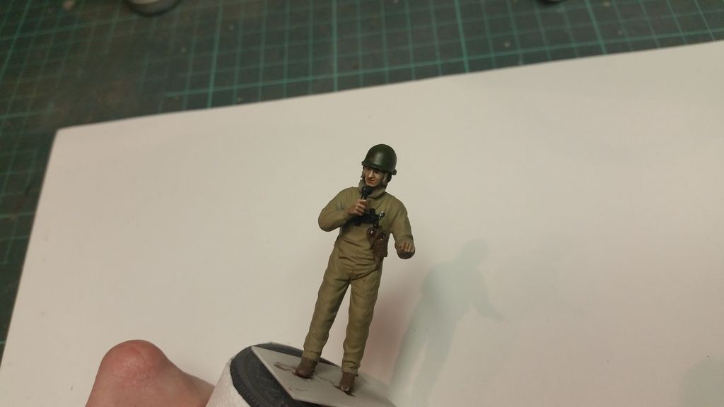

the tank commander is painted with the khaki for his entire uniform
small details where painted with gunmetal grey and leather brown
then they where all painted up
with the exception of the guns but those will be added later on
i then coated them with alclad aqua gloss
once the aqua gloss was dry i applied some mig productions dark wash
and then i removed most of the wash again
i only left it in recessed places and the bigger shadow areas
once the wash was dry again (i left it over night) i sprayed the figures with AK ultra matte varnish

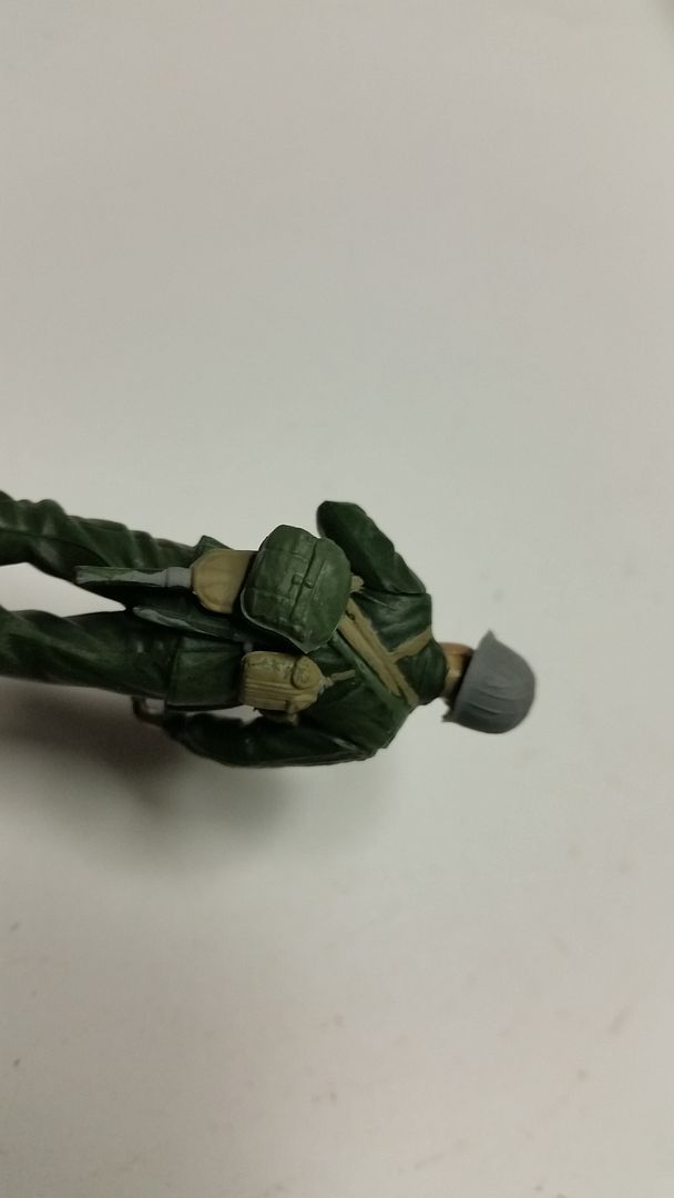

so now on to the guns

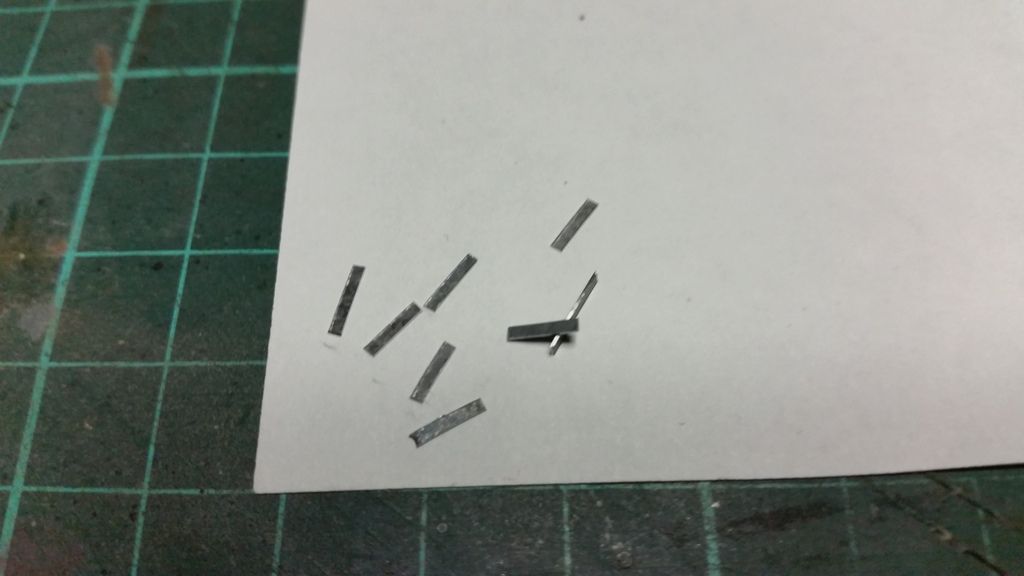

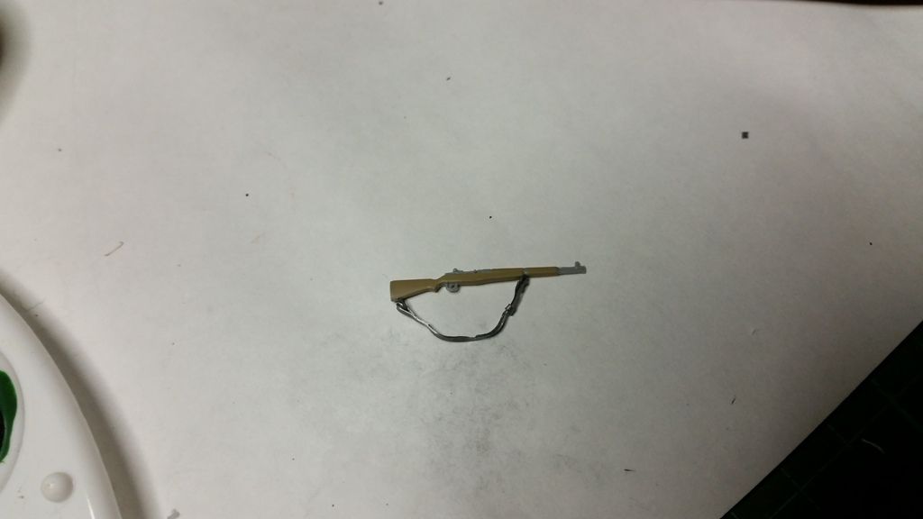

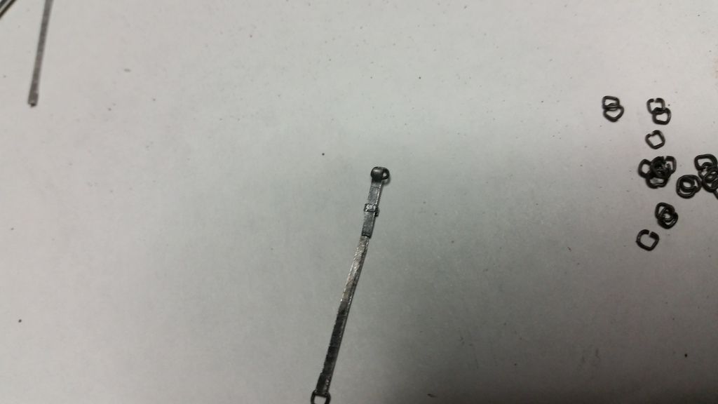

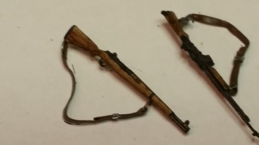

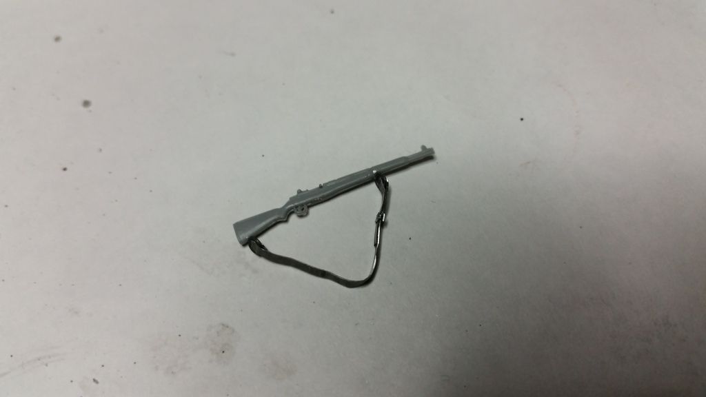

these leadfoil strips will be used for the slings

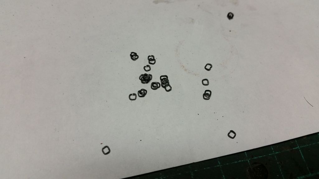

i made these rings with lead wire
i did that by coiling it around a styrene strip and make a cut on 1 side to get them into single rings
2 of these rings where added to each sling
and the ends where folded over them and glued together (with ca glue)
i then needed some small strips
the small strip where used to make the small buckles on the slings

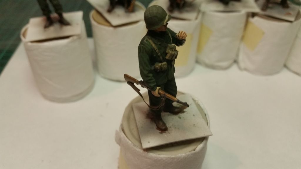

and then i glued the slings to the weapons
as a basecolor for the wood i used a mix of english uniform and white
to make the woodgrain and the laquered effect in 1 go i use the color smoke wich is a semi transparent color that i applie with a brush with very short bristles
i then drag the paint over the gun to get this effect
i also did this with the M1A1 carbines allthough that was wrong (incorrect color) as they where finished in a more orange brown laquer then a brown one like on the BAR and M1 Garand but i don't haave such a color and wasn't going to get bottle for just 2 guns
the metal parts where painted with mr metal color dark iron and then slightly buffed on the edges
finally i painted the slings with leather brown
then the guns where added to the figures

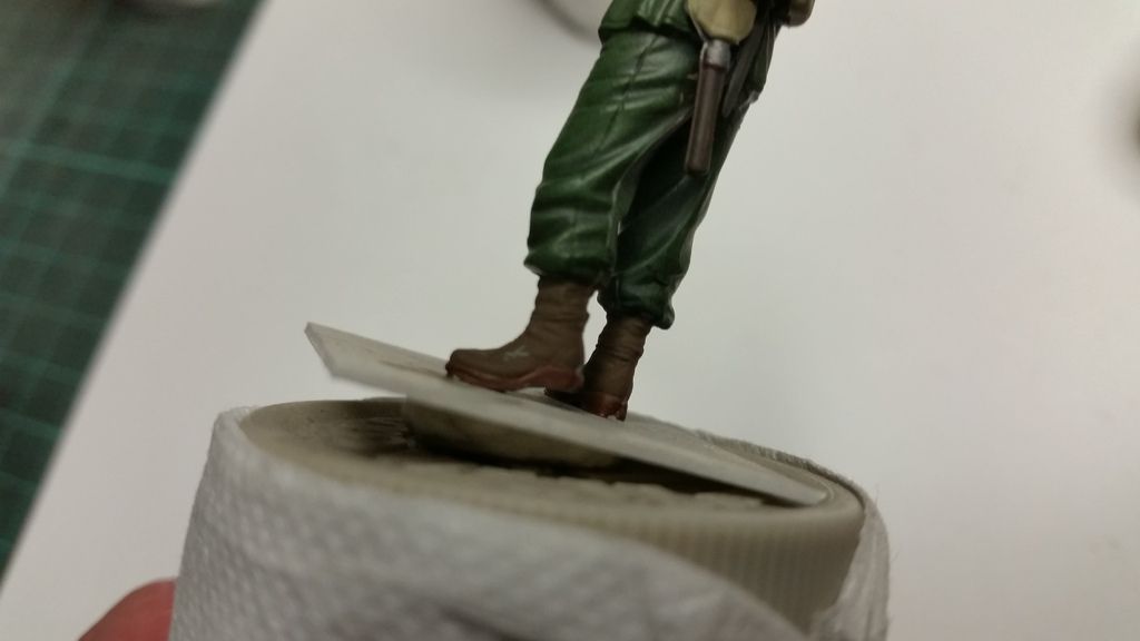

i used a little drop of ca glue in the hands of the figure and then push the gun into the hands
and with that step done they where finished

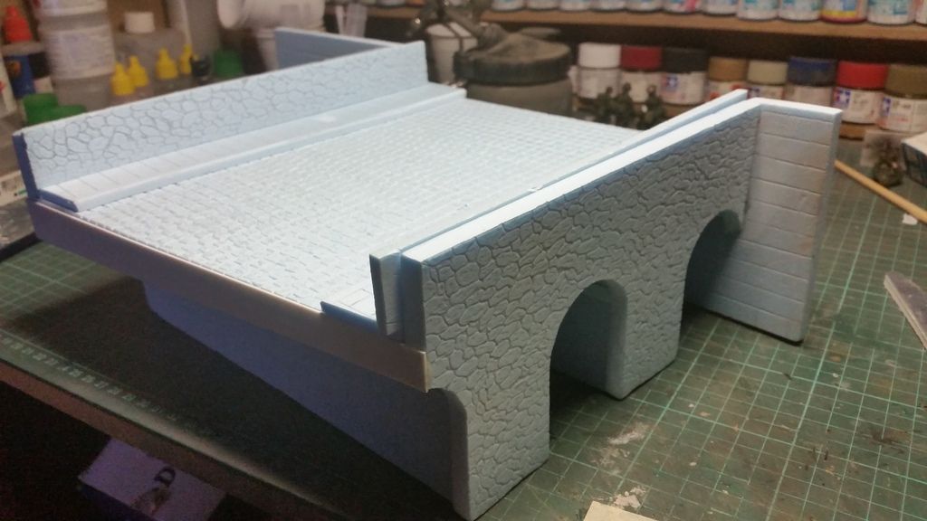

but i will start with the things that i have done first
as my original idea was proving itself as a bit too much i had to come up with a new idea
so i settled with a small road with a bridge on one end and a storage shed in the background
and since i started with the bridge that is where i will start now
my main material for the entire build will be blue isolation foam sheets in various sizes
i started out by marking the opening on the bridge and the bank of the river where the bridge will be attached
i then cut the panels to get the basic shape of the bridge
i later used some sanding sticks to get a smooth finish on the parts where i made the cuts
once i sanded the cut out parts i used them as a mold for the curved sections
the larger square parts will serve as the "legs" of the bridge

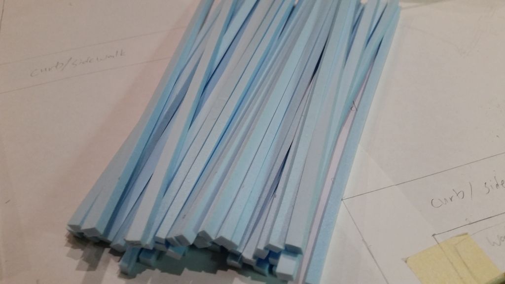

i then made a big pile of strips with the foam sheets wich i will use to make the interior part of the bridge
i simply glued all the strips together and folded them over the 2 supports i placed in each opening
one tip though this method was not working that well so using larger sheets wich you can put on top of eachother to make the curved part would probably work a whole lot better and would be stronger way of building aswell
so while the glue on the bridge was drying i started to work on the road surface that will go on top of the previous part

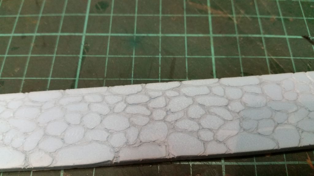

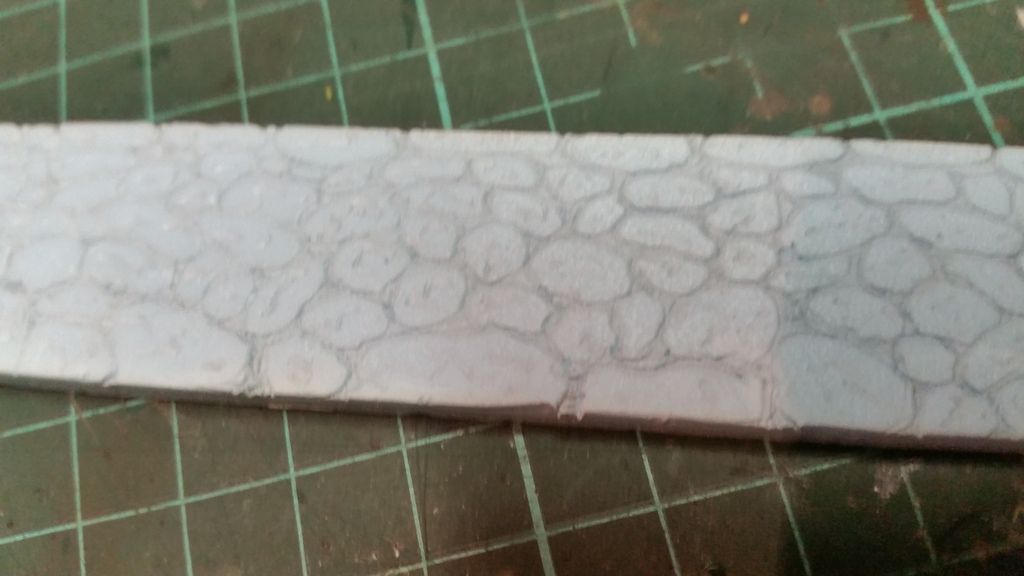

i started out with the sidewalks ,to make a curbstone i used the dark grey Ultimate sanding stick to sand down the edge to make it a bit round after that was done i carved in the tiles to finish it (not in the photo but you will see it later)
i used a ordinary pencil as my scribing tool for the entire build wich for me works just fine

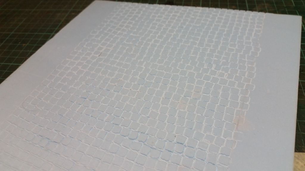

to make the road itself i used a large slab of the foam sheet wich was cut to size
to make the shape of the cobblestones i used the paint brush you see in the photo
i pulled out the hairs and used pliers to make it square
this can now be used as a stamp to get the basic shapes in the foam sheet
here is the result after i used the stamp
cobblestone roads never look that straight as a brick road so i was happy that it looks a bit random and not too nice and neat
then i used my peencil to make small dents in each stone
i did this to get a look like the stones where cut and worked over with a hammer and chisel as was normal in the old days
the stones get smoother as the road gets used more but that can take years and years
then the road and the sidewalks where glued into place
i used the pensil again to draw stones in the foamsheet
this was done on both the inside (over the sidewalks) and the outside of the bridge
and again i applied the same effect with the little dents on these stones aswell
and then the bridge looked like this
i still need to do a lot of sanding and trimming at this point but you can see where this is going

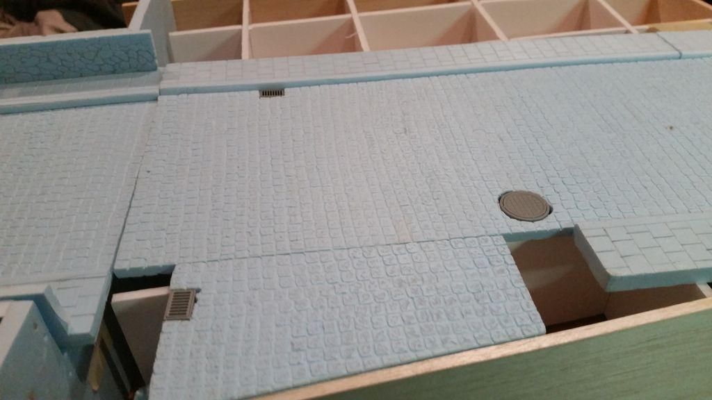

i used foam core plates to make this grid on the inside of the diorama
it will serve as filling for the rest of the build
if i was to use other material i would have needed to buy more and i decided to use the stuff that i already have first
then the road sections and sidewalks for this part where cut to size
i used the same methods on these parts as i did before on the bridge
all the detail wa carved in and they are now ready to get glued together
but before i did that i added some details like a sewer cover and some drains
these are from miniart , i think it was the street accessory set
to give the parts a little bit more surface to be glued on to i put a sheet of paper on the grid first
the sections i made where then glued on the paper and then the paper was glued on to the grid
i still needs a bit of filler in places but nothing too serious i think

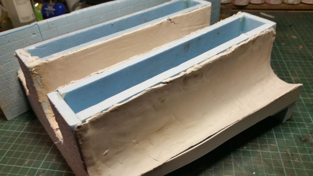

many old bridges in Europe have a sort of concrete layer on them
i heared it was applied to make it stronger but i am no engineer so i don't know
but as the reference photo's i used all showed this i made a similar thing
i used DAS clay wich i rolled out into thin layers and i then applied that over a glue covered surface of the bridge
the big benefit of the clay is that you can sand it
so it it is uneven (like in this photo) you can simply sand it untill it is smooth

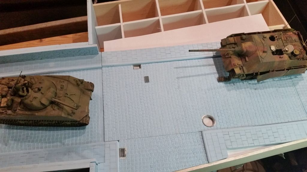

then just for the fun of it i placed the 2 vehicles of this build on the base to see how much room they need and how it looks so far
and that is about all i have for now
at this point the bridge and the road parts of the build are done (minus some touch ups)

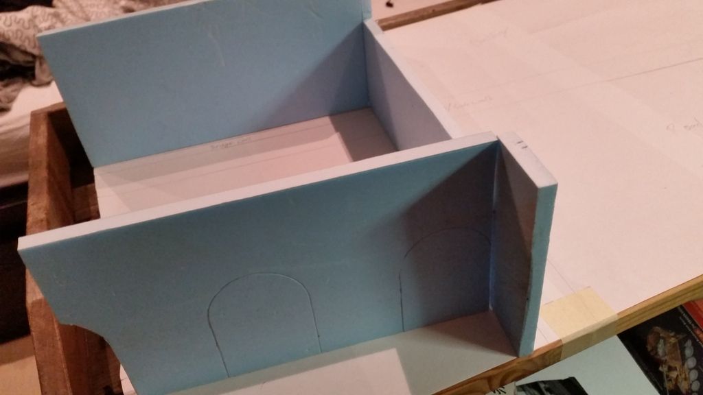

so i started out by cutting the major parts from the foam sheets
because i will be using miniart parts again i used them as templates to cut out spaces for the windows and the doors
i think they are barn doors actually but those where the only big doors i had and i didn't have balsawood thin enough to make some of my own
and they don't look too bad so why not use them
a mock up setting to see if it will actually fit on the base
i then glued everything together using 2 part epoxy glue and a bunch of needles

i started with the lower parts of the bridge
they often have a concrete like layer to protect the bridge from the water and the erossion it causes
so to replicate that i started with a coat of Tamiya german grey wich i applied in a random pattern but not covering the surface completely
with a sponge i applied thw second color wich is vallejo modelcolor neutral grey
to finish the concrete look i sprayed a transparent layer of vallejo modelair pale blue grey
then i turned my attention to the sides and the top of the bridge
i painted everythin from the sides of the bridge to the road in vallejo modelcolor neutral grey wich i applied with the airbrush as it is a pretty big surface to paint with a brush
the embankment wall is painted in light grey

oncd the paint was dry i applied mig prod. rubble dust pigments over the pile of rubble
allthough very hard to see i also applied brick dust pigment to give more color variation to the rubble
i then applied some of the panzer grey pigment on the concrete floor in the background
i later added some European dust to make it look dirty

the other one was dusted with European dust pigment
the fuel supplies however where varnished with a satin varnish to protect the previous layers
once that was dry i applied darka wash from Mig prod. wich is basicly just a black wash
i then removed all the unwanted wash from the cans and drums
i then flat coated them using AK Ultra matte varnish
and to finish them of some dust was apllied with European dust pigments
