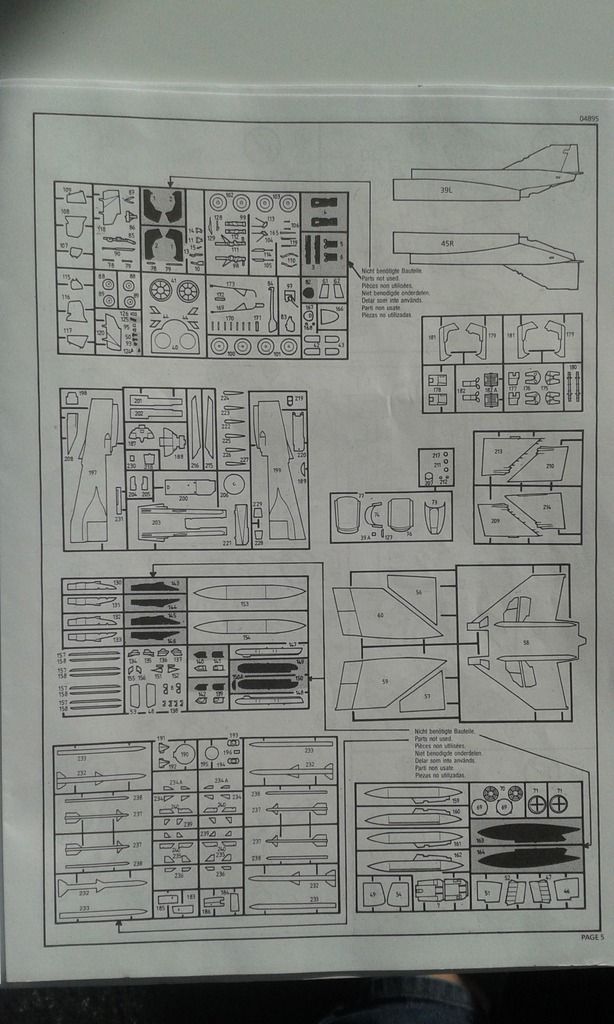

A snapshot of the sprue map in the instructions.

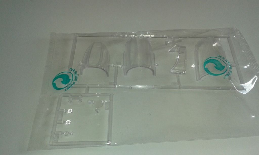

The clear parts.

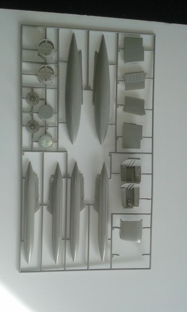

Intakes, exhaust and external fuel tank.
Landing gear, internal engine and other assorted parts.

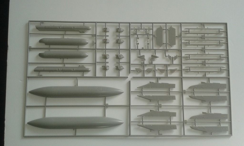

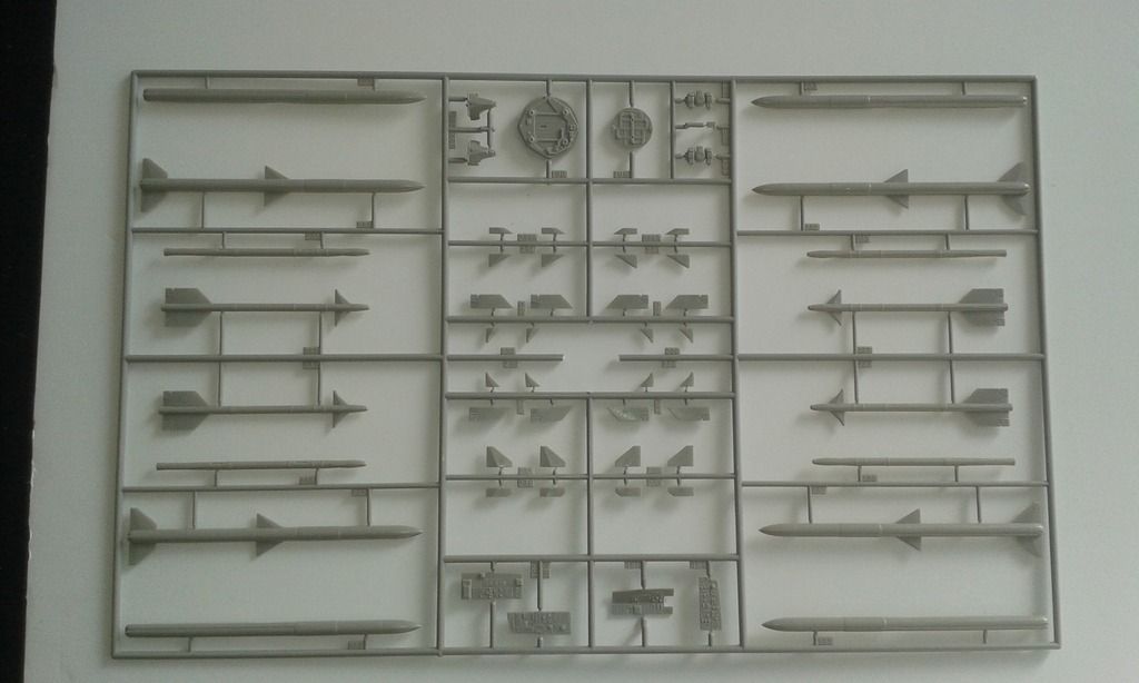

Armament.
External stores.

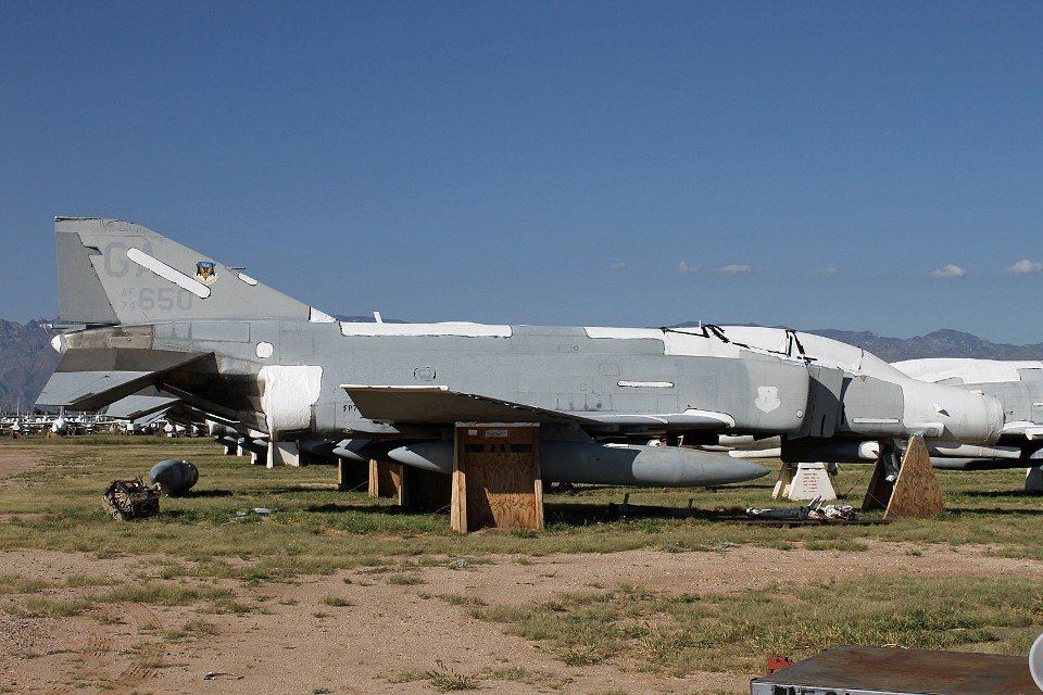

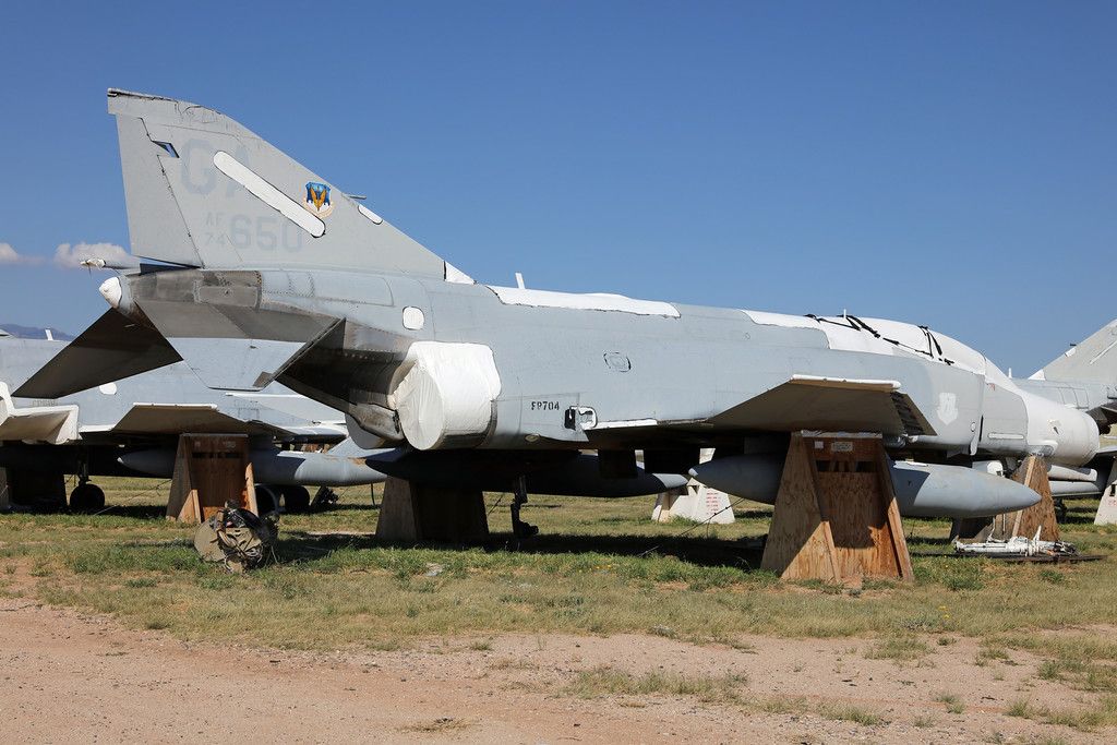

On June 20th 1991 the aircraft took it's final flight. The aircraft was phased out and transferred to the 309th Aerospace Maintenance and Regeneration Centre AMARC at Davis-Monthan AFB in Tucson Arizona. This unit runs the "bone yard" and long term storage facility. The aircraft remains there to this date. It has gone thru the stages of long term storage and now sits on the East Side - RIT (Reclamation Insurance Type) Area.
74-0650 in it's final resting place in area 24 of the RIT
Another shot of 74-0650 still in the colors of it's colors of it's last job, with a new addition a stencil aft of its right wing FP704. That is its new inventory tracking number.

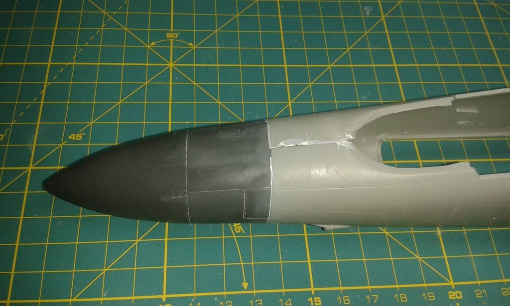

Inbetween aswering to posts of others contestants in this SIG. Posting some more background info and attending the SMC (Scale Model Chalange) in Veldhoven managed to get some bench time in aswell.

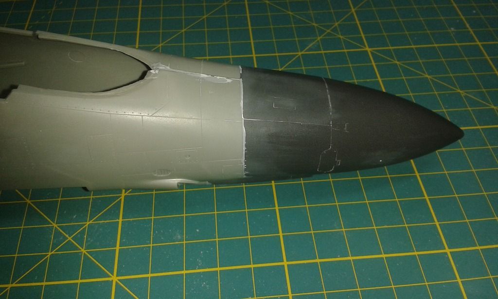

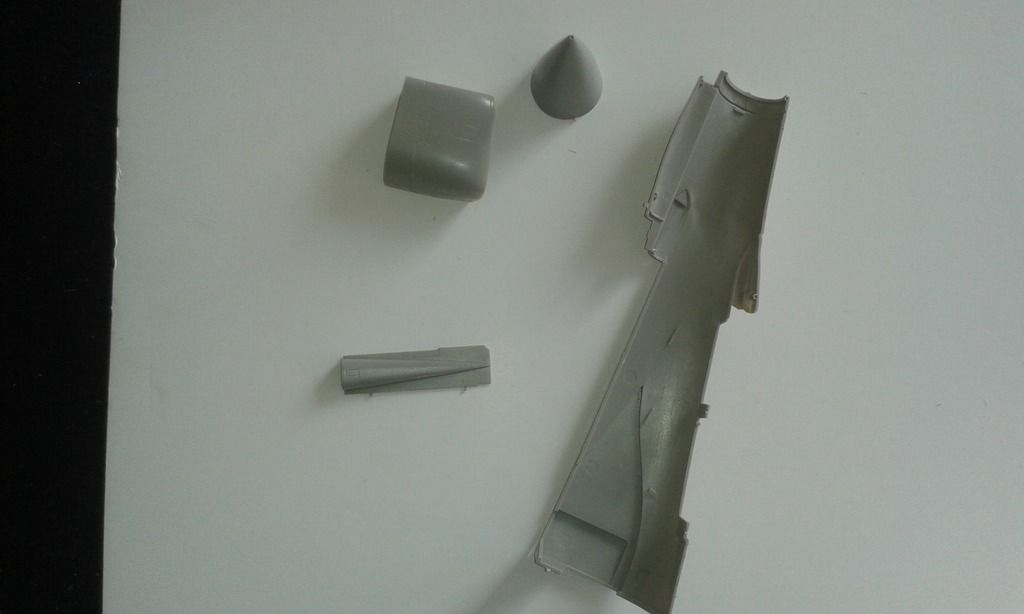

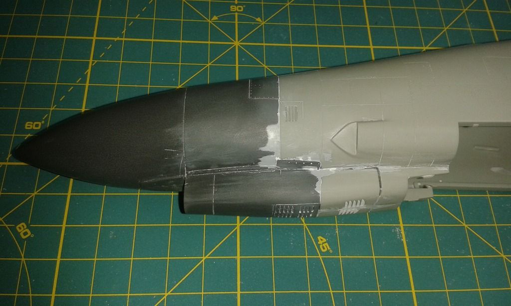

Because I will be fitting a Resin cast cockpit and corrected nose from GT Resin my build will deviate from the kit instuctions right from the start. I removed the parts that make up the forward fuselage from the sprue and marked the areas where cuts where going to be made. I cut these of using both my CMK and RB Productions razorsaws. The CMK for the large straight cuts and the RB Productions one where access or the shape of the cut was more challenging. Here are the parts before and after the kist have been made.

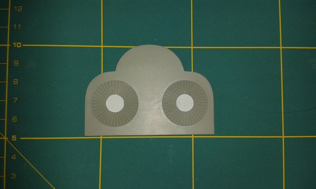

The kit parts and the resin cockpit, nose and seamless intakes from GT Resin

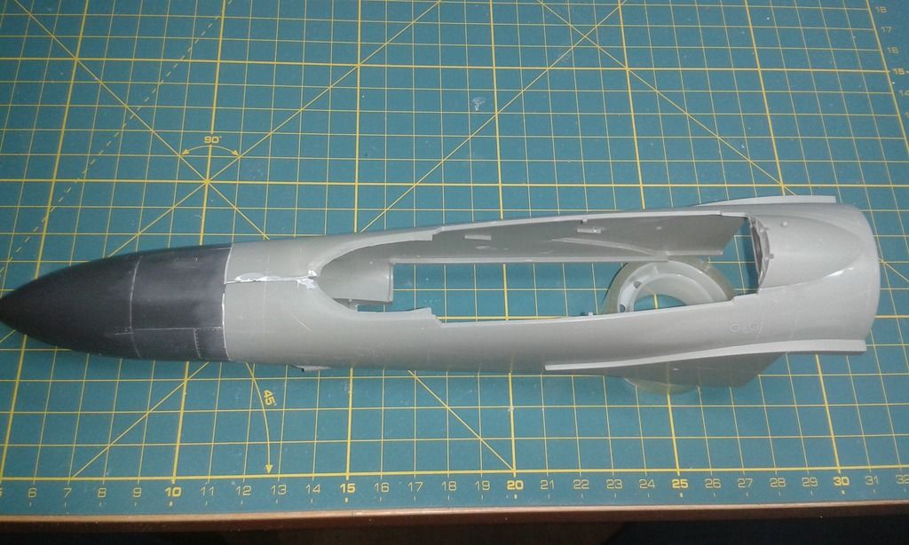

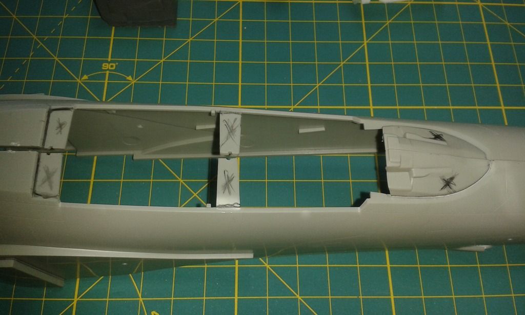

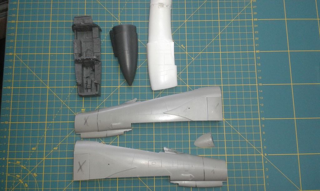

Tope view of the forward fuselage halves. The X's indicate the areas that had to be cut out
The forward fuselage halves after the cuts where made.

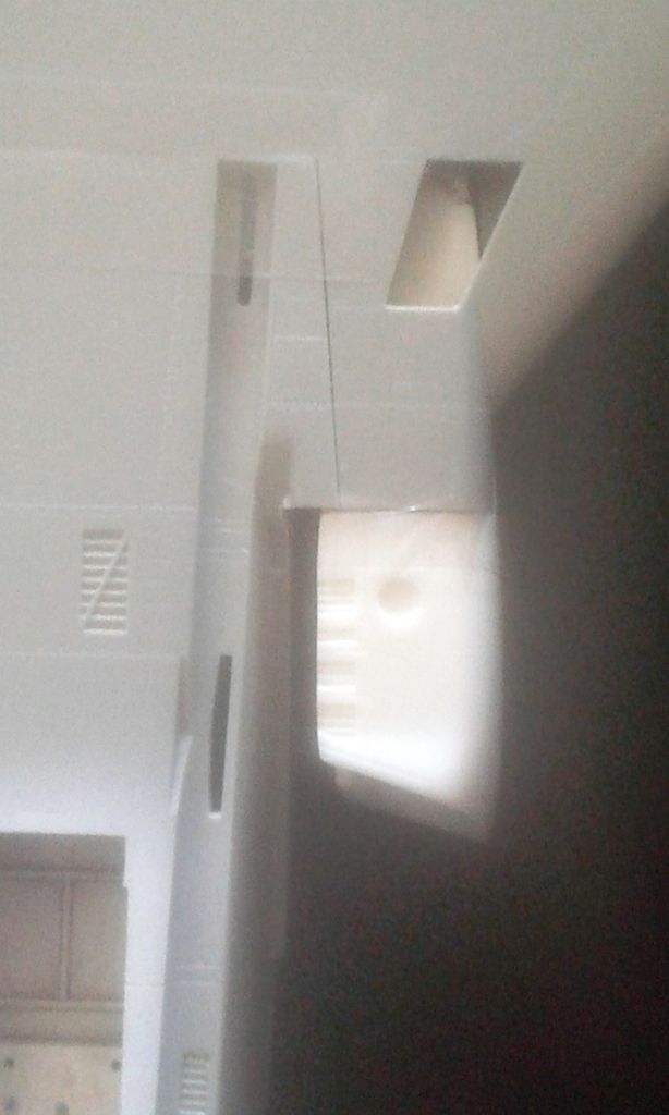

The instructions that came with the resing upgrade kit made a mention that the kit chin pod (The part that "houses" the gun) on the kit was to wide and that a small strip had to be removed from that section. The locateion where it had to be removed at the bottom of the fuselage join and forward of the nose landing gear door. From experiance I knew that doing it this way would put a large amount of stress in that section making to more prone to breaking open over time. I therefore made two extra cuts in the chin pod to allow for a more easy manipulation of the stryrene in that area.
The nose slid in like an old pair of gloves.

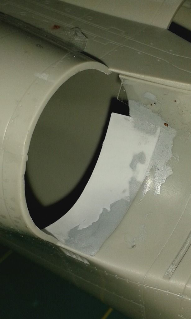

Bottom view of the nose. You can just make out the correction that would have to be made 0,75 mm from both fuselage halves.
During the manipulation of the kit styrene it turned out that the stress was still to much and the parts broke free. This was a blessing as it would now be easier to make a smoothe transition between the resin and the styrene and therefore lead to a cleaner end result.
Detail of the right side of the nose after it was glued
There where still some gaps that needed to filled. So out with the arsenal of putties and other fillers. I also picked up some new Mr. Surfacer 1500 (grey) that came in handy. I never worked with it but watching, reading and positive feedback from others made me try it. My first impression is good, it sure smells less toxic than Mr. Desolved Putty that I previously used to fill the very small gaps.
To fill the gaps here I used: Tamiya Putty White, Mr. Desolved Putty and Mr. Surfacer 1500. The end result is a smooth and clean Nose Job.

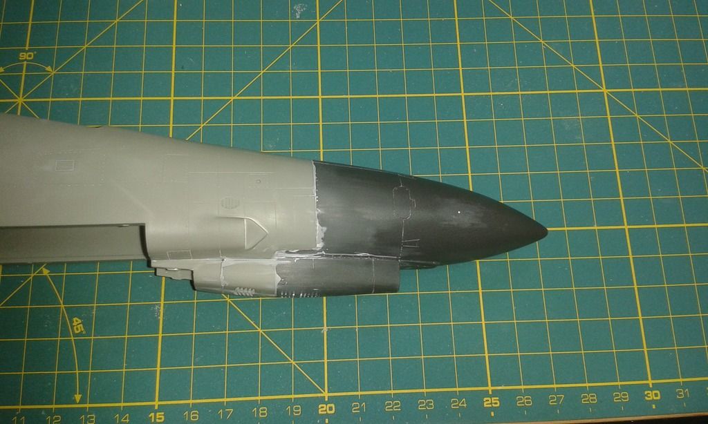

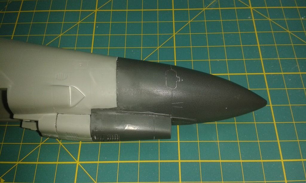

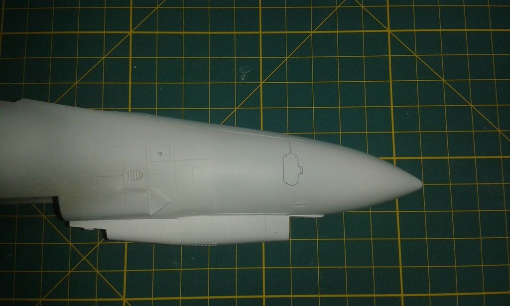

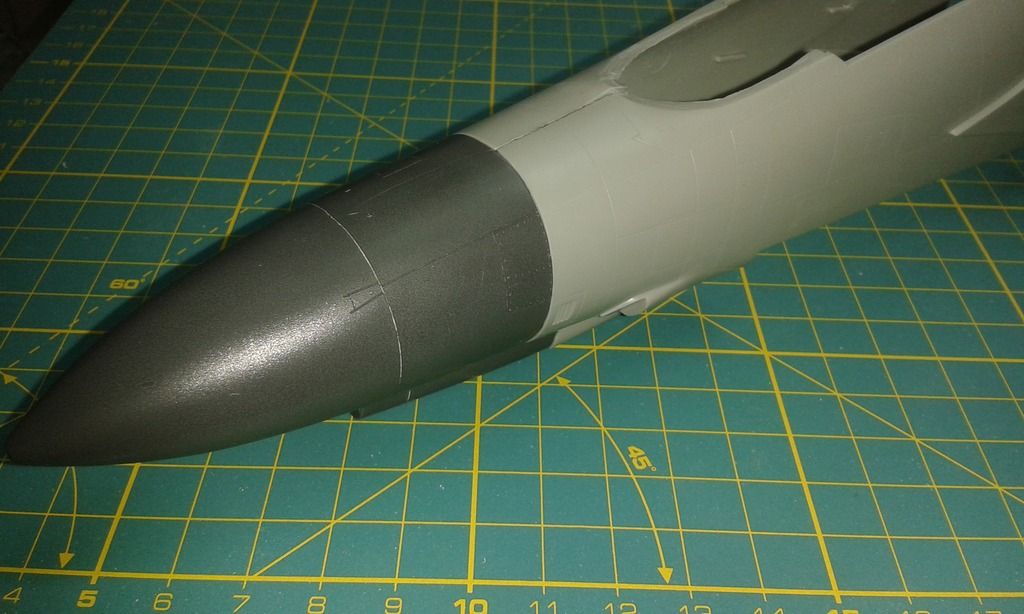

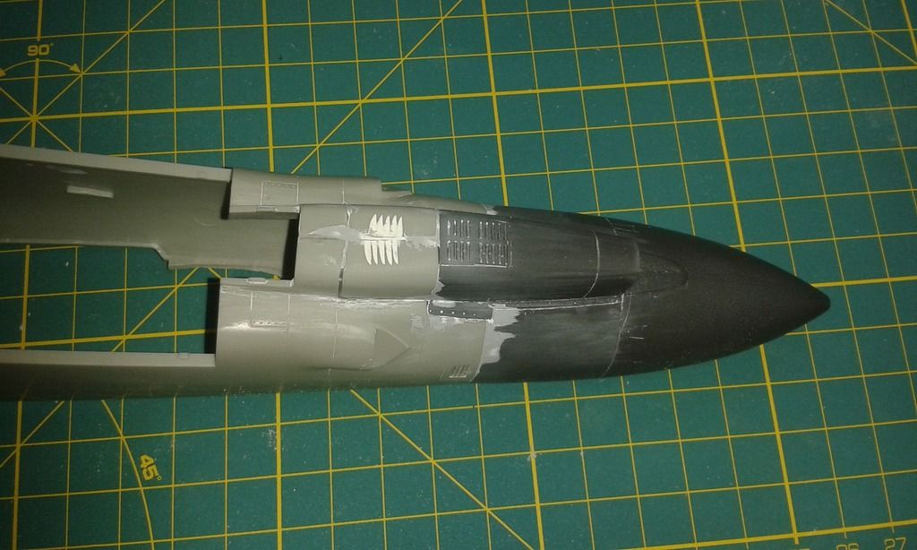

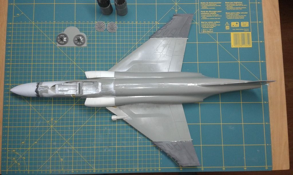

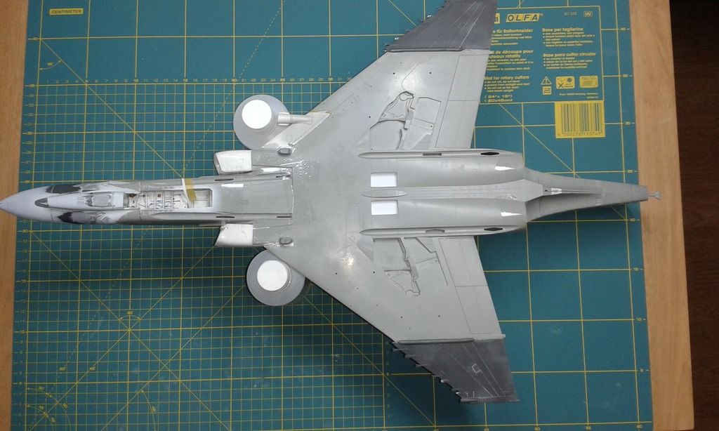

Here are the end result photo's of the Nose Graft ;) :lol:
The Left bottom side view
Left top side view
Right top side view.
Right bottom side view
Bottom view

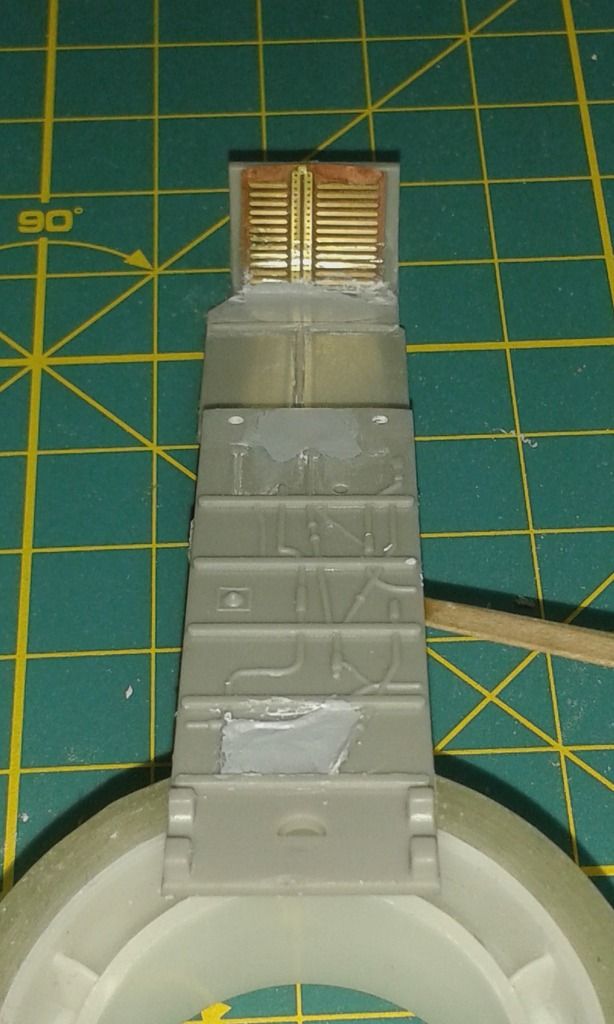

The aft. chip pod gun venting louvers where so misaligned that those where filled with putty. In the Eduard External PE set I have a PE part to enable me to reinstate the later on.
The top view
This last photo also gives a nice size reference as each number indicates 1 cm. She is going to be HUGE.

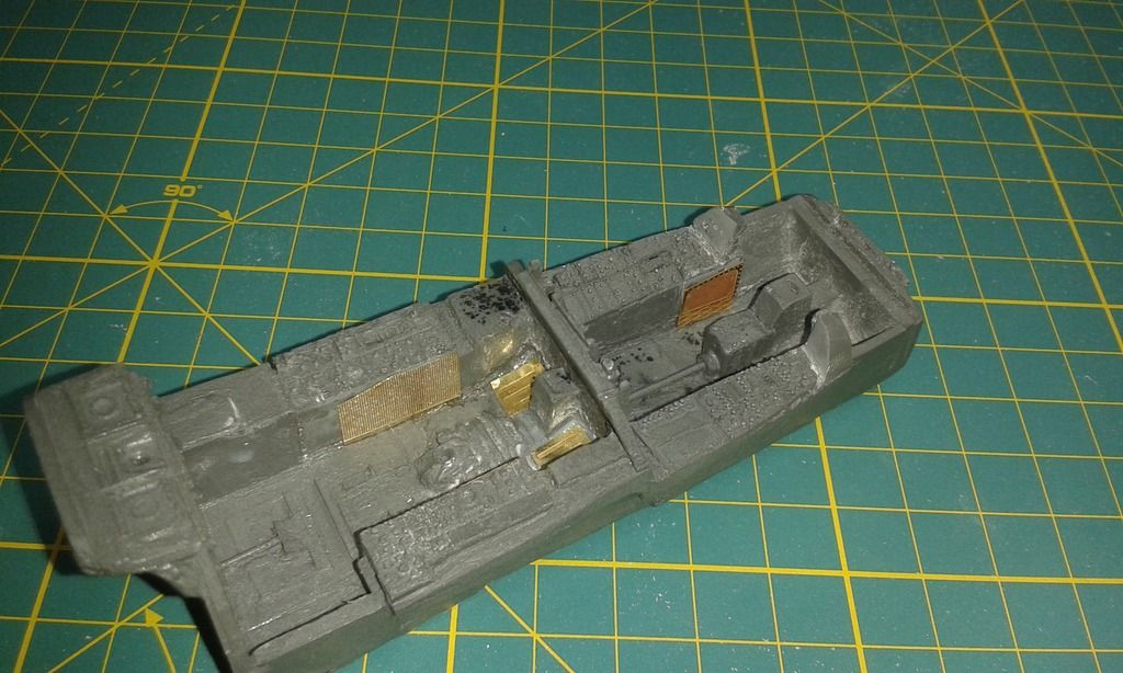

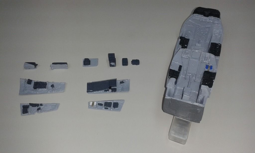

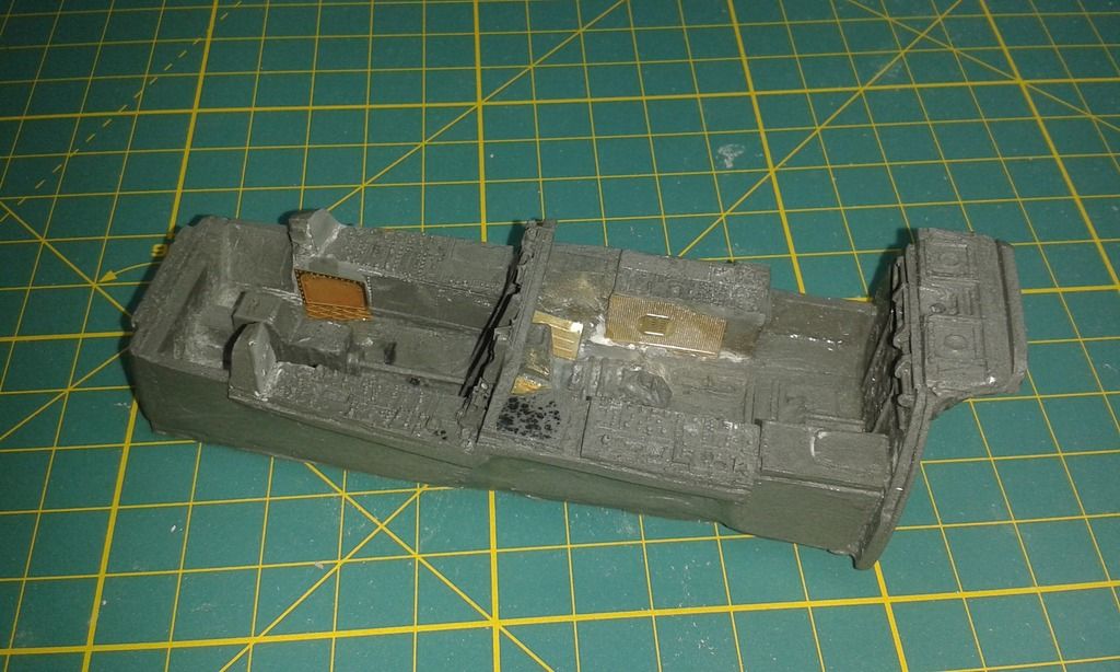

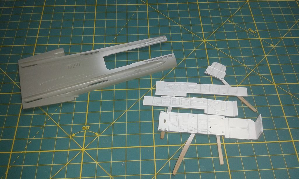

In the time I was waiting for the putty to cure I also started on the construction of the Nose Landing Gear Bay. In the roof of the bay where 3 massive ejector pin marks that had to be filled.
The roof of the NLG Bay with filled elector pin marks and PE fitted.
As I also had to wait for the putty and Mr. Surfacer to cure I got a chance to start doing some work on the cockpit tub. I was not to impressed with the quality of the casting in the bottom of the top as some bits weren't as crisp and clean as I would have liked them to be. luckily for me I had PE replacements that came compliment of the Eduard Interior set I had purchased for this build.
They fit right in without any hassle at all. Also filled the at the bottom of the casting and sanded down the Instrument Side Panels in the forward cockpit as the raised detail would interfere with the photo etch that I will be using.
Cockpit tub seen from the left
Cockpit tub seen from the right
Detail shot showing the upright portions of the side panels that had the raised detail removed

Found this while I was flicking through my pictures don't know if you've already got it,
It was taken at raf alconbury july 1979
simon
In the stash
Lots and lots of phantoms
Vleugelmoer
Posts: 1011
Re: 1:32 Revell F-4E Late 32nd TFS Soesterberg AB The Netherlands
Post by Vleugelmoer »
Spook wrote:Image
:cheers2: Simon, I didn't have this picture yet. Alconbury was some sweet field, got to visit it in my teens with the air scout troop I was in. They where operating A-10's and phasing out the F-5's.

So inbetween my first steel tip darts match in 18 odd years and a bunch of appointments today managed to squeeze in some bench time. In that time I made so more progress on my build.
First of all I primed the nose section, internals of the nose landing gear bay and cockpit tub in white Ultimate primer. The primer highlighted a couple of area's on the forward fuselage that will require some more work ei filling and sanding and rescribing before the final paint is applied.
The parts that will make up the nose landing gear bay and close the bottom of the forward fuselage

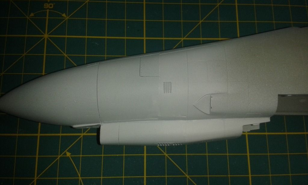

Left side of the nose
Right side of the nose
You can see that some of the pannel lines have some issues that will need to be addressed. Also some of the kit pannel lines don't represent the actual aircraft so those will be addressed when I'm rescribing the forward fuselage section. At the same time I will add some riveting detail to really make it pop.
The cockpit tub primed and ready for the base coats of color

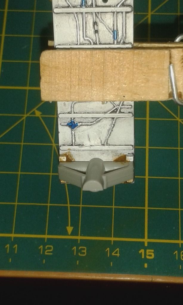

The sections of the nose landing gear bay detail painted and sludge washed
For the detail painting and sludge wash I used the folowing products.
Vallejo Metal Color (77.701) Aluminium. I used it for the hard line hydraulic lines, wiring conduits and juction box, the plunger of the uplock switch and as a base for the erea work lights.
Vallejo Model Color (70.995) German Grey. I used it for the flexible hydraulic lines and the uplock switch body.
Vallojo Model Color (70.869) Basalt Grey. I used it for the crew ground call horn.
Vallejo Model Color (70.947) Red. I used it for the warning square around the uplock switch.
Vallejo Model Color (70.951) White. I used it for cleaning up small paint overspills.
Tamiya (X-23) Clear Blue. I used it for the AN fittings on the hydralic lines.
Tamiya (X-26) Clear Orange. I used it for the light lensses of the area work lights.
The sludge wash was done with Vallejo wash (76.516) Grey.
As an Aircraft engineer by trade I know that there is always a grease build up around the pintle pins (the fulcrum point around wich the gear rotates) of a landing gear. The simulate this I mixed Vallejo Still Water (26.235) and Vallejo Pigment (73.105) Natural Sienna. I chose this pigment becase of the age of the aircraft Aero Shell Grease 7 or 33 (Mil. Spec. MIL-PRF-23827C) was most likily used. These greases are clay based and brownish in color. That paste was applied around the pintle pins with a fine pointed brush. I used the kits upper nose landing gear part as a plug so that the paste didn't seep into areas where I didn't whant it to.
here are some detail photo's of the paste after it was applied.
The fwd side of the nose landing gear
The aft side of the nose landing gear
The fwd side of the nose landing gear is more heavily weathered as the gear itself would have obstructed cleaning of that side.
It has been a while since my last post in this build thread. That was due to varying reasons, lack of modeling MOJO being one of the main ones. Luckily for me that has returned so I can continue on this build again. Even during my MOJO slump I have not been sitting totally idle. I have been doing research for some scratch built items that I’m going to include. I have also been in contact with Isra Decal Studio’s to find out what the main differences where between stencil decal set IAF-40 (RF-4 set which I have got) and IAF-39 (the F-4 counterpart set that has been out of production and out of stock for some time now). The owner of Isra Decal Studio’s was very helpful and was able to send me a spare sheet of the needed stencils mainly for the nose, slat wings and TISEO pod. One of the things that was supposed to be included in both sets was the stencil data for the outboard / external wing tank pylons. Here is a photo of the spare sheet that I have received free of charge.
One of the things that were still missing from the stencil data are the decals for the outboard wing pylons and the ECM Pod. As the aircraft I’m portraying almost always flew with the ALQ-119 (long) ECM when it flew with the 32nd TFS. I had a look on scalemates and there I found out that previous releases of the kit I’m using had all the decals included I’m currently in contact with Abtailung X at Revell to see if I can still obtain them.
When I left you last I had just painted the Nose Landing Gear Bay. That was done because the forward fuselage had to be assembled before the test fitting of the GT Resin Cockpit could commence. The forward fuselage came together easy enough, there were some issues though, large panel gaps, missing and incorrect panel line details and some uneven kit part joints. After I installed the Corrected Nose also from GT Resin I had already found that not all the kit panel lines where meeting up as I would have liked, where missing or just incorrect after checking the reference material that I have gathered for this build. To address this issue I have compiled a re-scribing list of all the panel lines that will have to be “fixed”.

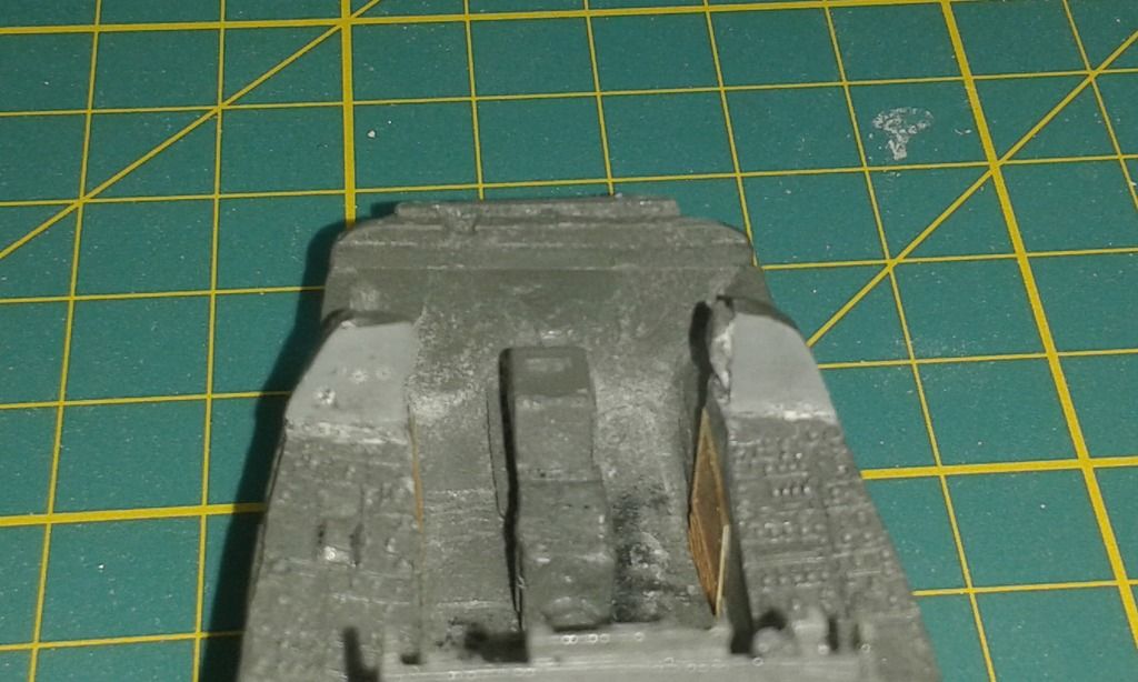

The cockpit itself was an easy slide in replacement with lots of fine detail that was void in the kit office. Even so it is still getting the Eduard Interior PE treatment to enhance the detail even further. Here are some photo’s of the cockpit during the test fit preassembly stage.

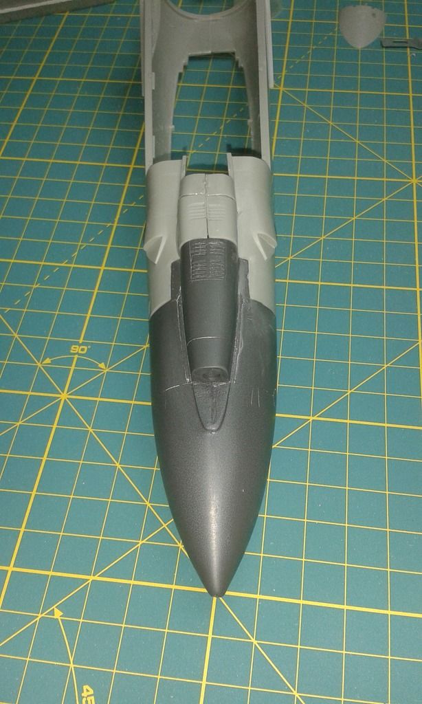

After the forward fuselage mod’s where done and test fitted it was time to start on the rear fuselage modifications. These included Seamless intakes, corrected vertical stabilizer Fin Cap and Exhaust conversion. These where all included in the GT Resin Shipment that I had received prior to the build.
The seamless intakes required some major plastic surgery of the kit parts to make room for these as the design people at Revell had a day off when it came to doing the internals for the kit intakes. The kit intakes where therefore null and void when it came to this build. The effort put in will definitely pay off in upgrading this kit. The cuts were made in both the forward and Aft. fuselage sections, wing bottom and the forward fuselage bottom. Now that access was provided the intakes itself could be test fitted.
As you can see in the photo’s above something went “wrong” during this stage. The photo’s in the instructions where grainy small black and white ones so picking out the fine detail was very hard to put it mildly. As the aftermarket manufacturer GT Resin Is one of the contributors to another forum it was time to take a look over there to see if I could find any info and photo’s there, man o man that was easier said than done. So after being unable to find the info I needed there I contacted the seller directly. He came back with an initial reply within the hour, not bad considering I’m in Western Europe and he is located in sunny Florida in the USA. Taking the time difference into account I can only imagine that he must have been working late as it was around 1am in the morning. Got to love the cottage industry manufacturers that are still out there in the world of aftermarket.

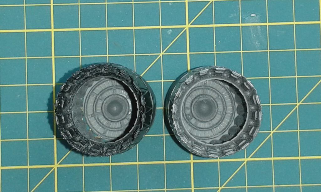

After a short back and forth over the email, Garry (owner of GT Resin) provided a better walk thru of the fitting instructions and also provided some very high resolution color photos that showed all the aftermarket he makes fitted to the latest 1:32 Revell Release Phantom the F-4G. As I had previously built this model out of the box in my younger days I never noticed that the kit intakes where t wide. But this totally explained why I was having difficulties in fitting the correct size and shape intakes. The photos that I had received also clearly showed that a quick sanding and filling job could remedy the mismatch. However as I was also going to fit resin combat strike camera’s to just under the intakes the easy fix was not going to cut it, as this would only highlight the problem area even further. After checking my reference material to find the correct location of the combat strike camera’s I noticed that I would have to perform some real world to modeling world magic to get them to look right. The curvature in the access panel was also very nicely portrayed in its kit counterpart and was even a glue in item. No problem one would assume, but the resin camera’s available are made for the Tamiya F-4’s and I’m building the Revell F-4…. Needless to say now the same mismatched panel on the intake side now also needed work in the back to get the flat resin camera to fit the curved panel. As the transition has to be smooth and straight I decided that a removal of the outer curve with a razorsaw, reworking the part and fitting it in the corrected shape would leave me with a nicer fix.

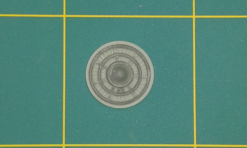

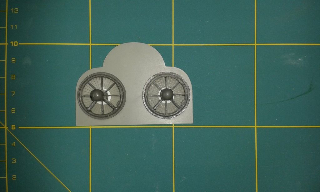

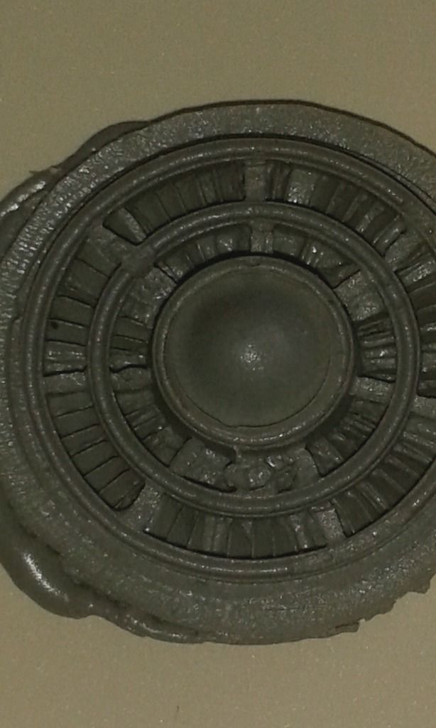

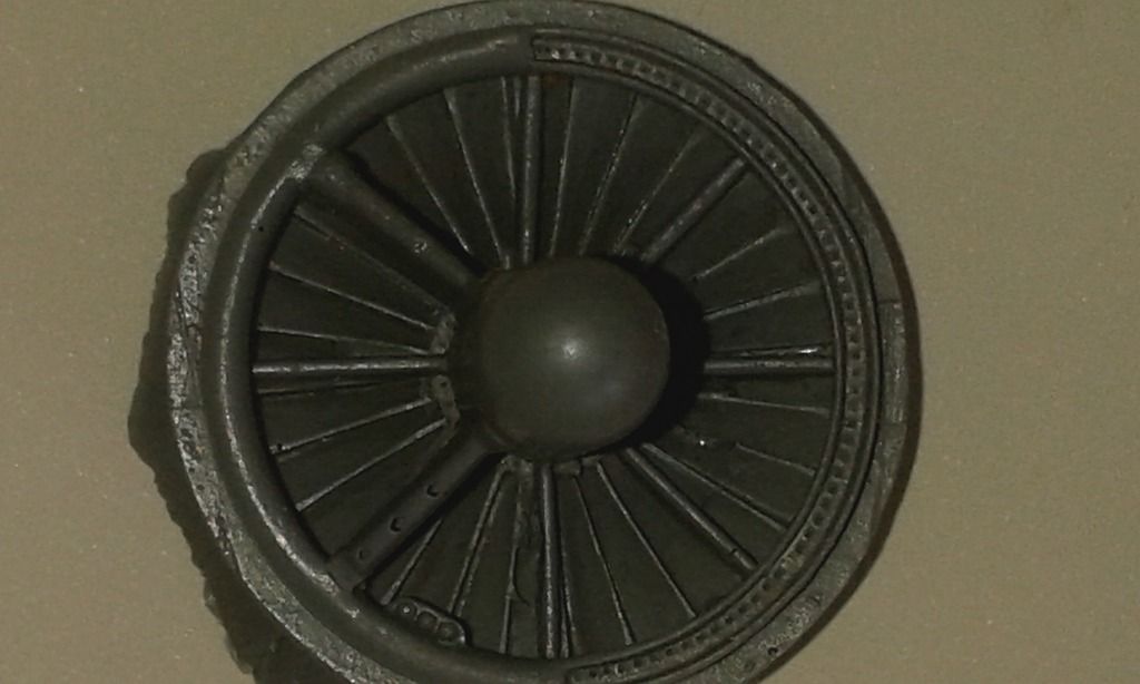

The seamless intake set also included General Electric J-79-17 fan faces. The intricately cast parts had some casting issues and transportation damage on them. Some broken fan blades and hard to clean excess resin overflow.
As the aircraft I’m portraying in this build was delivered new to the squadron from the factory a fix would be in order. The kit does contain plastic fan faces and engine intakes which would come in handy for the fix I came up with. As the resin parts also contained varying sized casing blocks that would interfere with the kit reinforcing bracket with the fan blades on them sanding them down to beyond the norm would leave me with just the engine intake.
Here’s a photo to show the intermediate that I now had.
Time for a test fit. This revealed that the injection molded fan-blades from the kit would also need some tinkering to get an accurate end result. Some 0,15mm sheet styrene and a 10mm hole punch came in handy. Here’s a photo of the created plastic discs fitted to the bulkhead with Tamiya Extra Thin.
As the kit bulkhead will be sacrificed in this repair an new one was made up out of sheet ABS of the same thickness as the kit part. Some carving of the fine detail is still to do to get the fan blades to meet up accurately. I will do my best to get something looking like this.

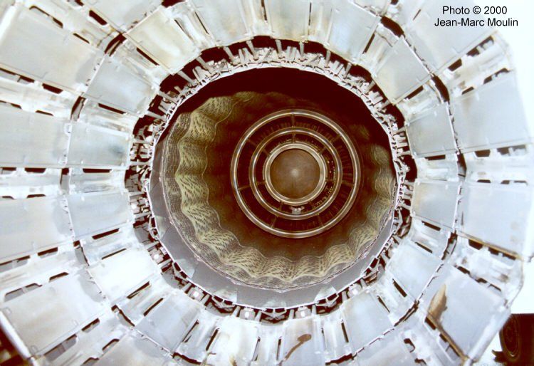

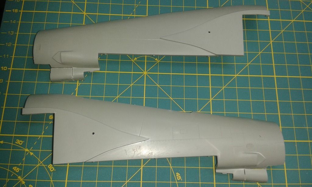

The resin jet tailpipe was much longer than the kit part. The kit aft. fuselages halves needed a relief cut so that it would not interfere with a correct fit. The removed parts where set aside as the where nice flat and thick styrene, they would come in handy later on in this build. The resin nozzle and tailpipe both had reasonably sized casting blocks and required only little works to get them off. A nice touch ware the scribed in cut line to aid in removal and something not found in some aftermarket. The parts also fit together snugly so only a small amount of medium or thin CA glue will be needed during final assembly. This is a point that I’m reasonably impressed with as GT Resin is only a Mom & Pap after market manufacturer.
ImageHere’s a photo of the real thing that might come in handy in other builds
A test fit of the pre-assembly to the aft. fuselage pointed out one of the faults with the kit. The exhaust heat shield aft. of the jet tailpipe fell short. This left light coming thru where the nozzle meets the fuselage. Some 0,1mm sheet styrene was used to make a almost perfect circular repair. Now it represents a more accurate depiction of the real aircraft. This point was also evident when I built a previous version of this kit in my younger days. I also did a similar repair back then.
Here’s a detail shot of the repair. White is the sheet styrene, Gray is standard Tamiya filler to get a supper smooth transition. The later is not absolutely necessary as the will be hidden behind the nozzle but hey I’m a stickler for detail.

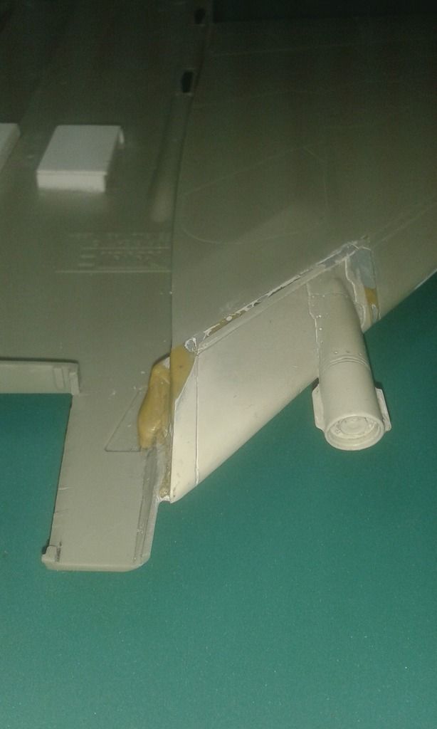

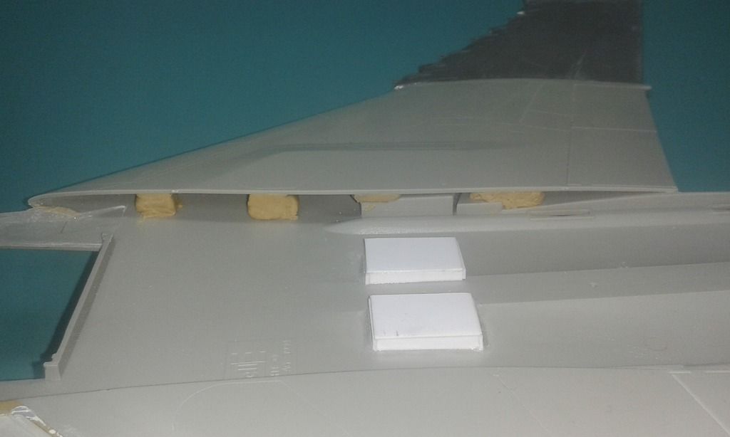

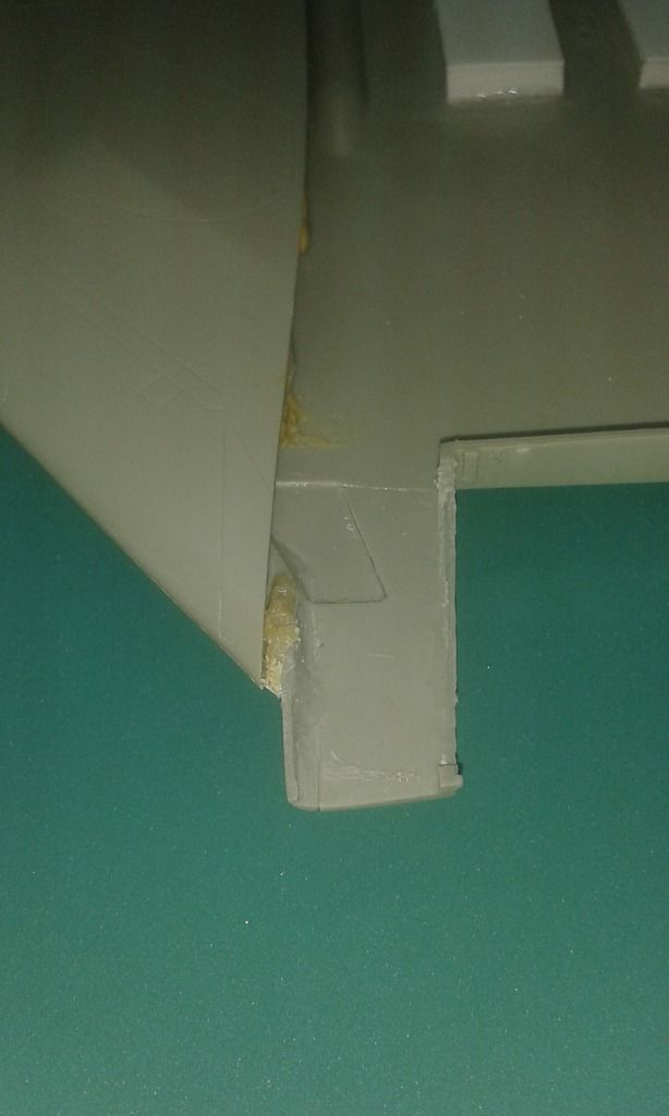

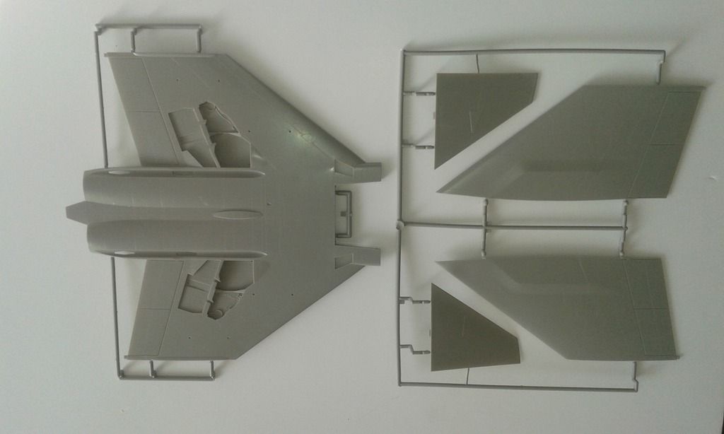

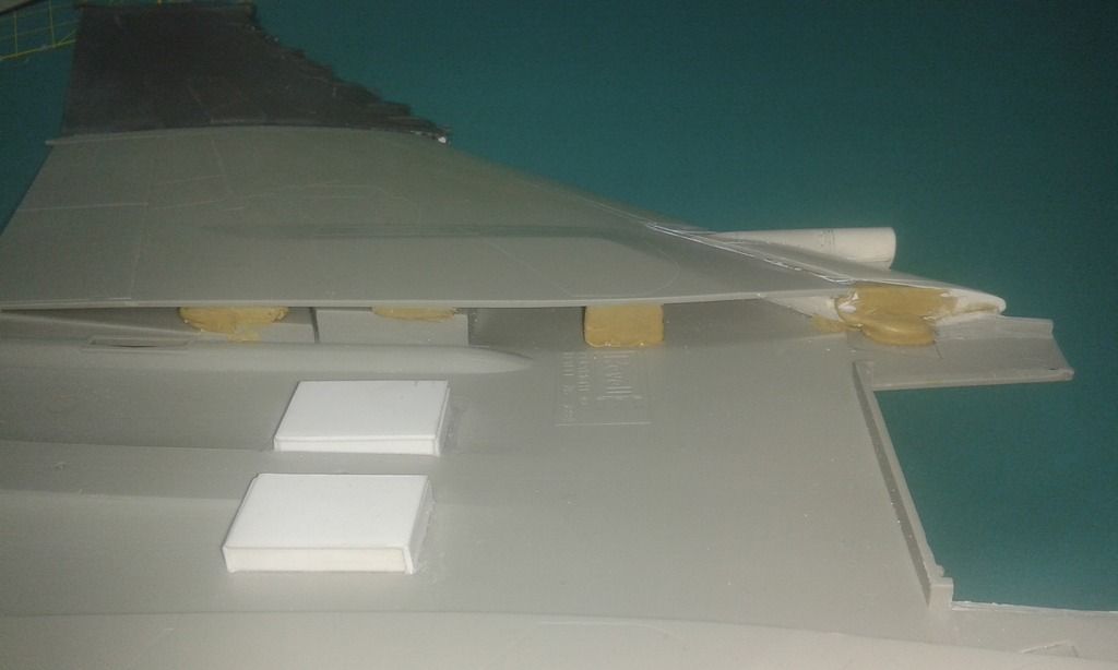

Now that the aft. fuselage was also done it was time to start converting the wings. The modifications being done include: Resin Slat Wing outer wings, TISEO in the leading edge of the left wing, Placement of resin combat strike cameras and opened up auxiliary air doors as those where almost always open on the ground including scratch built interior.
The outer wing modification was undertaken first as this mod required the removal of the end plate of the inner wing. As this would be almost impossible after the inner wing would be glued this was first on the list. The kit preparation work was well described in the instruction that came with the resin parts from GT Resin. The resin outer wings are full of detail and are a well worth investment over the very basic kit alternatives. There only a couple of small issues, the surface texture of the resin part still includes the milling marks of the master mold. The other one is the inclusion of an access panel on the underside of the right outer wing which should only be on the left side. The last one is that the scribed detail on the underside on the wingfold hinge is a bit soft and could de with a re-scribe. These are all minor issues in my opinion as the modification itself will require sanding, filling and re-scribing to get the optimal end result.

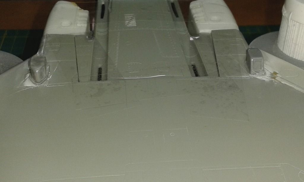

After the outer wings where on it was time to tackle the TISEO. The kit panel lines where almost correct but left me with a cut out that way too big for a straight in replacement. As the wing root also needed tweaking to fit the resin intake this was undertaken at the same time this had a positive effect on the fitting of the resin TISEO pod that was a one piece casting with the leading edge section. Because there was no positive guide to the placing of the replacement leading edge section after removal of the wing root section the access panel that would hold the combat strike camera was glued in place. The resin leading edge section had a notch to accommodate that panel so the inner positive stop was ones again there. The leading edge section was glued in place with thick CA Glue that would also act a preliminary filler for the mismatched gaps. The inner and outer gaps that where left where then filled with Tamiya Epoxy Putty. As the wings are of a hollow monococque construction on this kit without any reinforcement the inner wing joint would be not as strong as one would like where it will meets the aft. fuselage. Reinforcement blocks of Tamiya Epoxy Putty where made up to solve this issue. This also fixed the wing shape issue that is on the kit discrepancy list.
The cut outs for the auxiliary air door where made using nano PE saws from RB Productions. I used scribing tape to outline the panel that had to be cut to get nice clean cuts. 0,25mm Sheet styrene was used to create a box that would hold the interior detail which will all be scratch built just prior to final assembly to minimize the risk of it getting damaged.
The combat cameras where the easiest of the modifications as they where a glue on and fill addition to the wing. The access panel and the wing root panel required minor filling to get a smooth transition from the bottom wing to the resin intakes.
With the wing now also pre-assembled it was time to start on the final assembly. But before I started that I was a nice opportunity to test fit the semi completed build. I used clear cellophane tape as this would leave me with a good indication of any gaps that would occurre during final assembly. This also was a nice photo opp. To show of all the modifications and alterations that have been made. The light gray is the kit plastic. All other colors are resin, filler and sheet styrene.
Now that the major modifications where done it was time to start with the final assemble. I opted to start with the forward fuselage that contains the cockpit that has been whispering build me, build me for some time. The resin cockpit tub had already been primed in white after the PE details had been added to it. The resin side walls and ancillaries where taken off the casting blocks and cleaned up prior to test fitting them. After I was satisfied all the part would fit and look alright it was time to spray them in Ultimate White primer ones that had time to cure the base color went down. I used Mr. Hobby Aqueous H306 (FS36270) as this was a close match to the color on the pre-painted PE from the Eduard set. At this point a two small gaps became clear. One was on the right inner wall of the aft. cockpit, where there was a step visible from the intake spike in the outside of the fuselage. The other was a gap where the aft. cockpit deck meets the aft canopy hoop. The flat styrene pieces from the exhaust relief cuts where the correct thickness to solve both issues. Those were trimmed to fit their new home on the model and glued in place with regular Revell professional modeling glue. On the intake side of things a small step was still visible and that was filled using Tamiya putty. The inside of the forward fuselage was then primed in Ultimate White primer followed by the base color. After that it was time to start with the detail painting of the cockpit. Here are some progress photo’s of that as well.

Now that the main conversions are done it's time to start on the final assembly of this big girl.

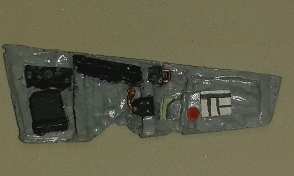

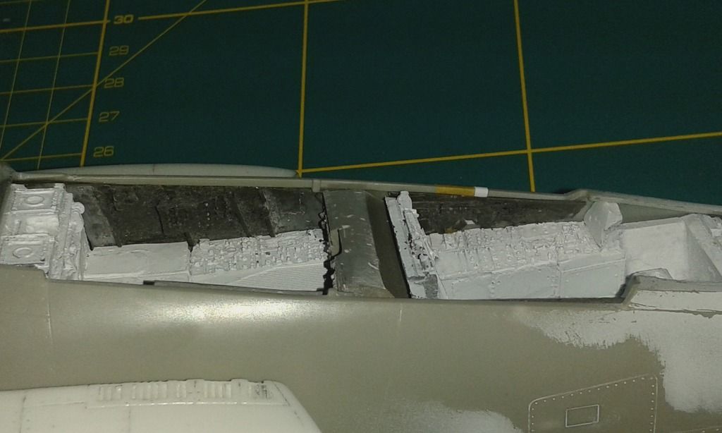

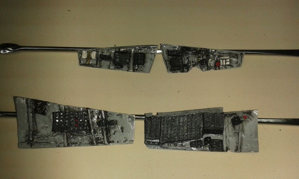

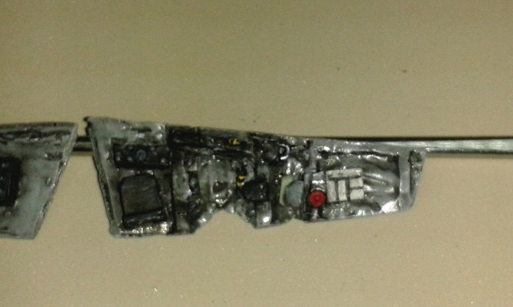

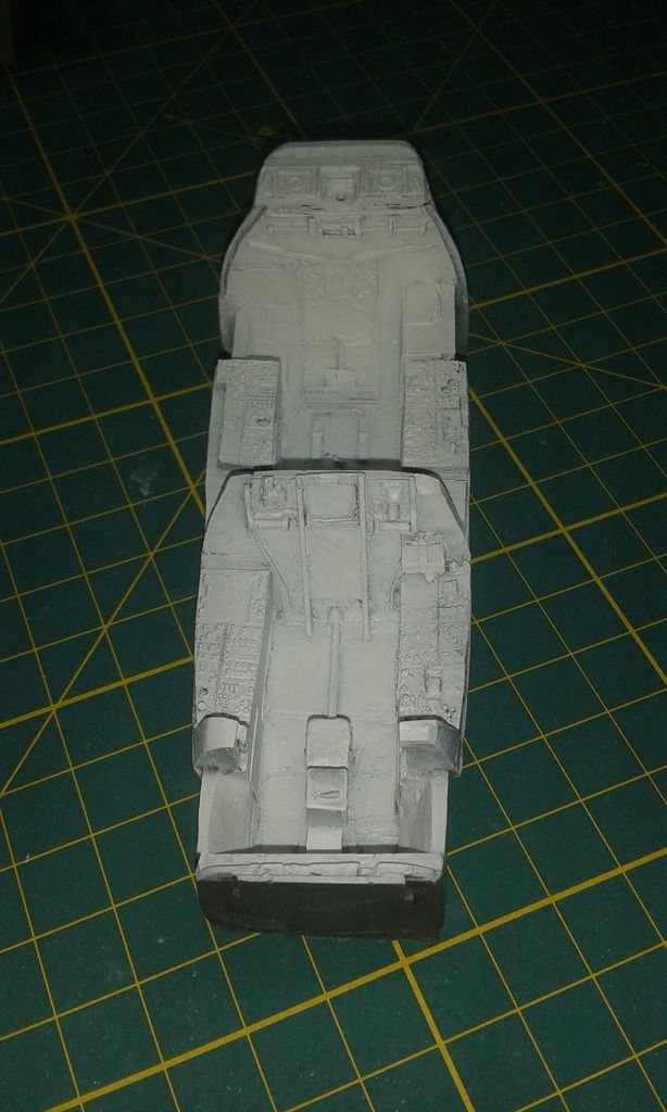

Started on detail painting of the cockpit over the weekend and here are some update pics.
The side panels all painted and weathered up.
I hid have to add some of the fine detail with copper wire.
Also added the strike camera and gun camera switches and armerment safety switch. I used 0,15 mm styrene sheet for the switch panels and white glue to build up the switch details.

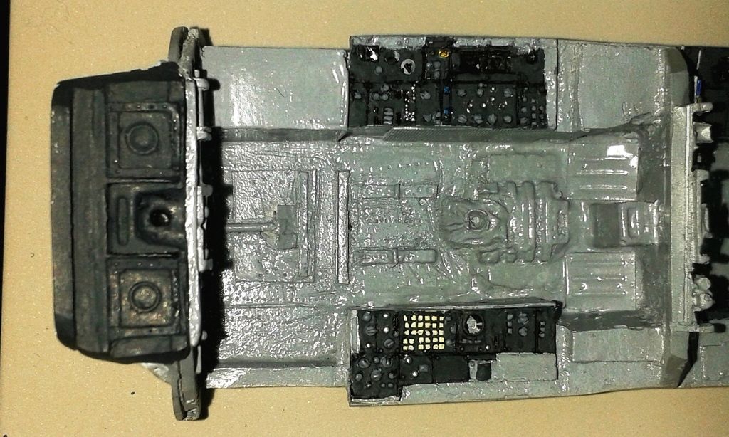

Also made some strides on the tub of the aft cockpit
The white squares will get a smoke filter with Tamiya Clear X-19 to give the TISEO control panel switches a nice lustre.
That's all for now more to come so stay tuned folks.
