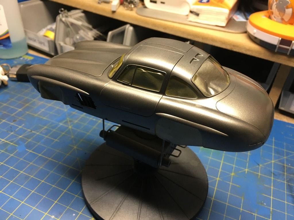

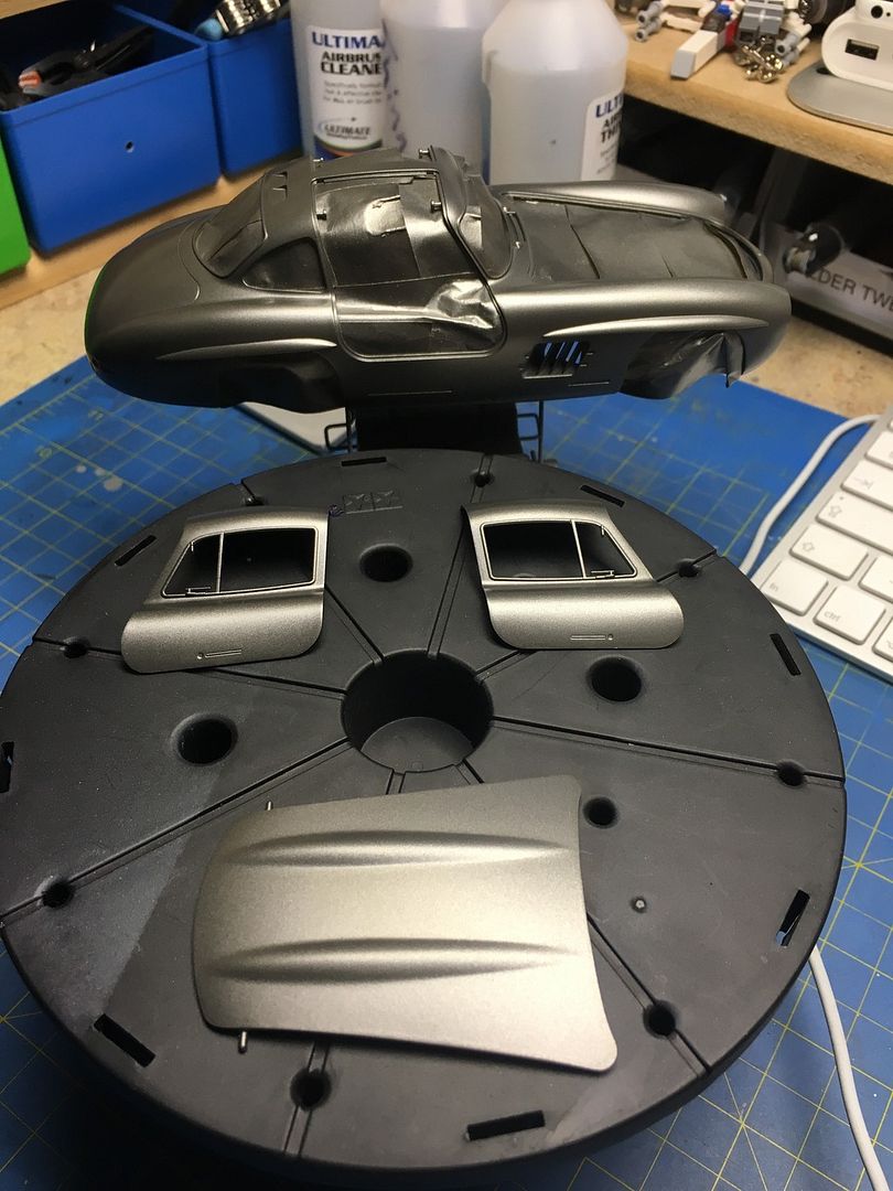

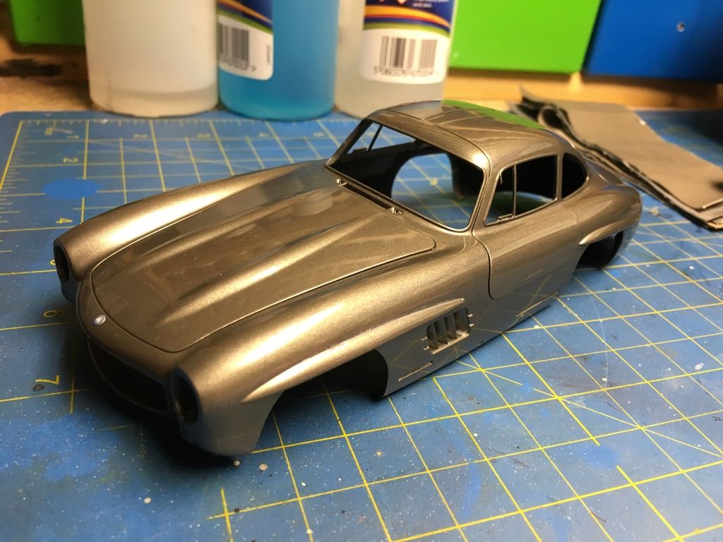

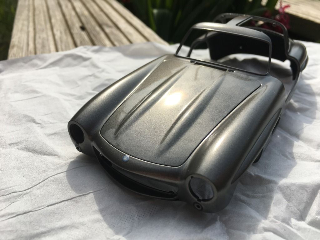

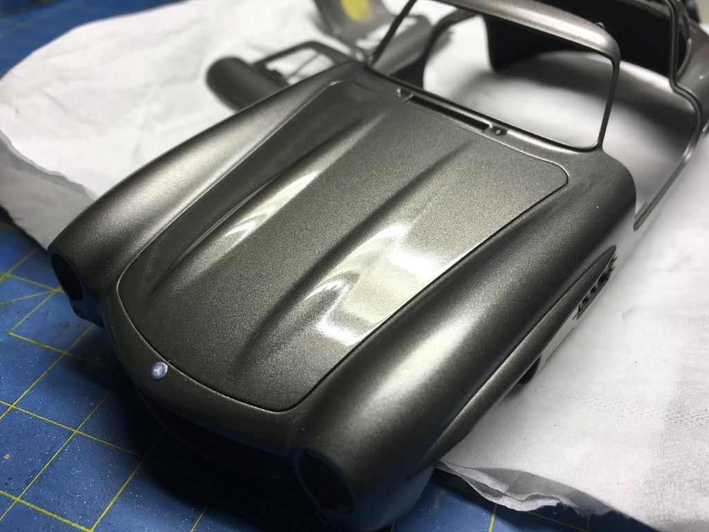

With the gloss totally dry the delicate work of polishing it starts. I had not given it the best gloss coat, this is still very much a learning curve.
Lucky enough I had put enough 1k down to flat and polish it. Also the 1k being strong really helps.
To start I used 3600 to get rid of any rough patches then slowly went lighter and lighter with the grades.
When I had done that I used 6000 with the coarse compound. Both used at once with a little water really works well. Thanks to Paul Bretland for giving me that tip. When I was happy with it all polished and shiny I sealed it with Tamiya modelling wax.
So far only done the bonnet, I will slowly be doing the rest of the body this weekend.

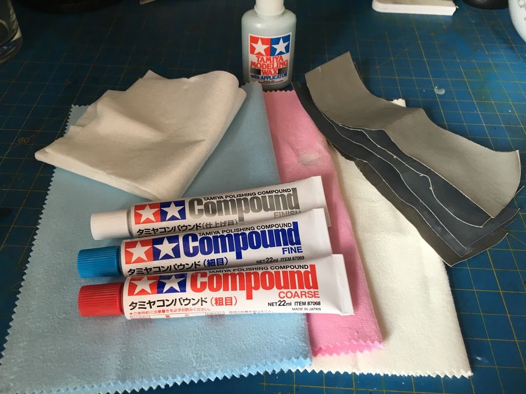

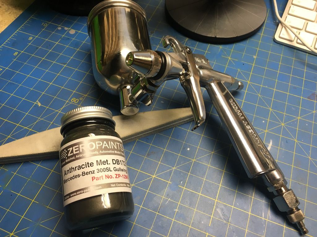

This is all the products used
Micro-mesh wet and dry polish set
Tamiya compounds coarse,fine and finish. The matching Tamiya clothes

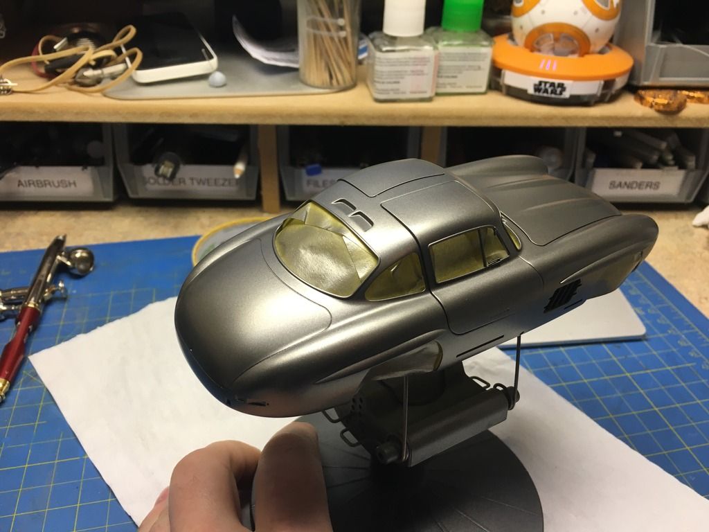

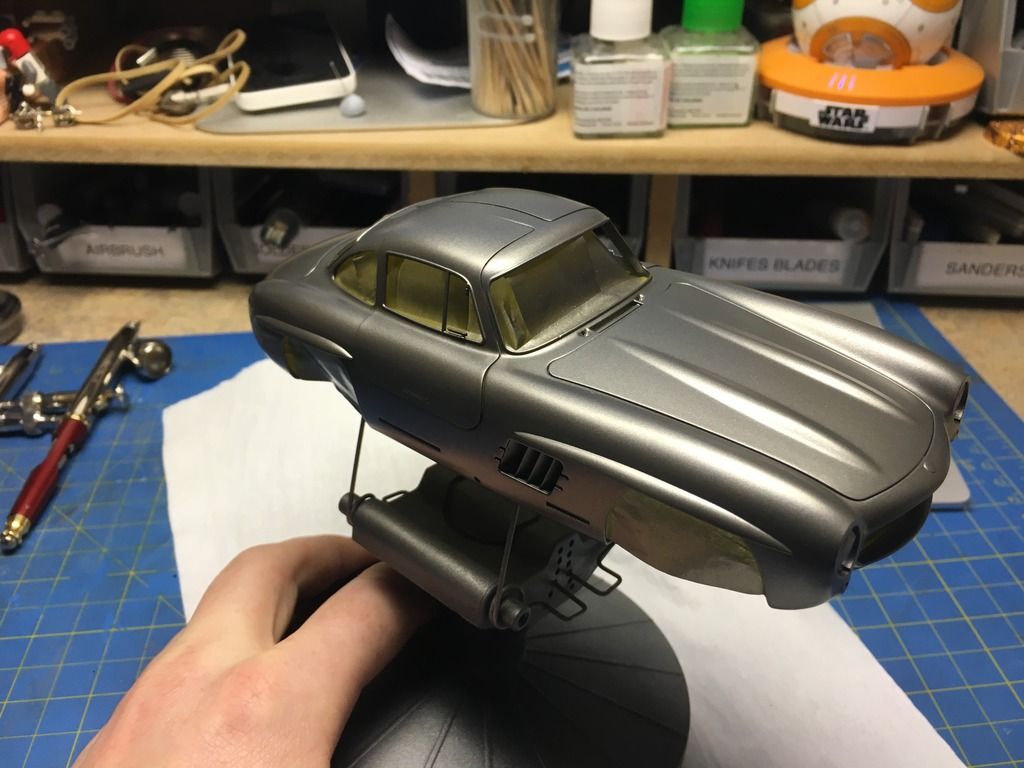

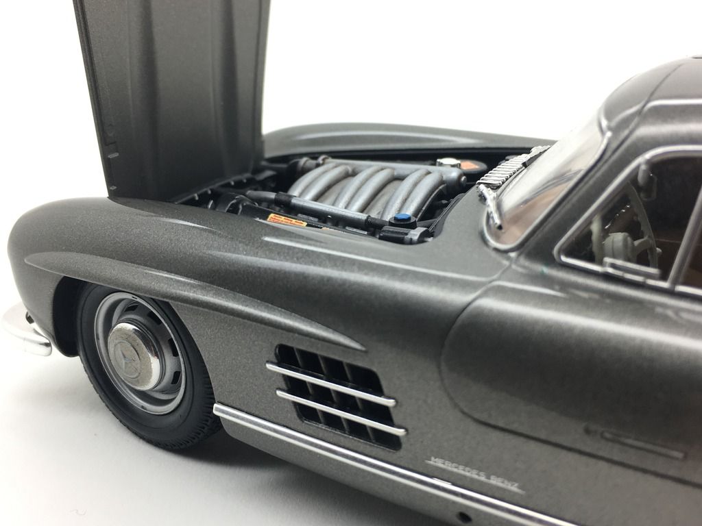

The bonnet looking good really looking forward to the rest of the body being finished
If your thinking the is some strange markings on the bonnet it's actually the reflection of the clouds
