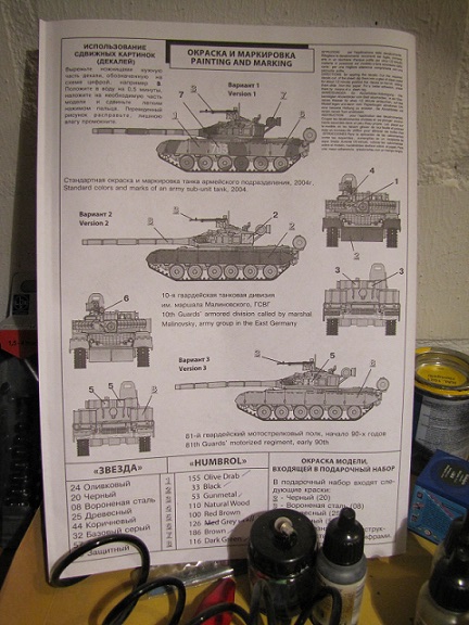

Let's get to painting-guide.Not great either...
There are 3 versions to choose.
Three-tone camo of an sub-unit tank 2004 :thumb1:
A green one of the 10th Guards' armored Div. in East Germany. :thumb1:
And an other green one of the 81st Guards' motorized Reg. early 90's :thumb1:
Of all, there is only a side front and rear view. No top view and no idea about the other side... :bash:
Humbrol paints are recommended.The other recommended color are written in Cyrillic :scratch::

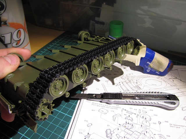

Let's start with the kit!!!!
The tank is equipped with a small dozer blade. Between the teeth of these are struts provided with bolts. Don't know what are these for... :scratch:: Two rubber-aprons are later infront of the dozer. You have to shorten the struts before you apply the rubber-skirts...
I noticed too late... :wall:
At the rear plate I stupidly installed the exhaust incorrectly. :oops: Thus, the part was open at the top. Quick cover with a small plastic piece and fill in later. Hopefully you can't see it later.

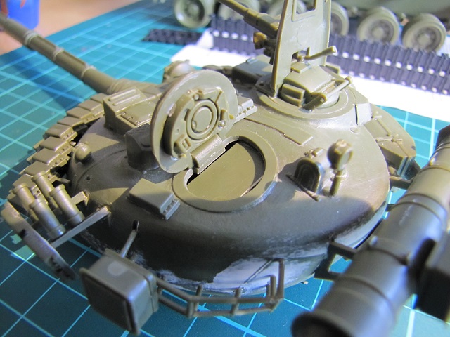

The turret consists of two halves that need to be sanded after glue together. Do not worry if you lose the surface texture. There are so many parts mounted that you can't see the texture later.

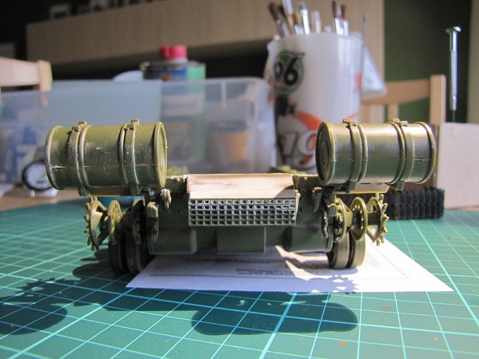

Post by Dunhill2005 »

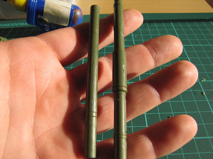

Why?!?
At back of the tank, a round wooden beams is later attached.This has about the same scope as the cannon...
My question: Why is this part moulded in one piece, while the guns coming as good as ever in two parts??? :x
If the gun is mounted on the turret, it looks like a big lollipop...

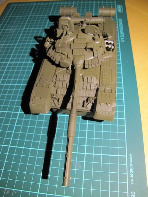

Continued the turret...
The ERA-blocks on the turret have been molded connected. I had to remove one block (red marked) because the plate otherwise will not fit. Pushed against the commander cupola. :scratch::
The ERA blocks at the front of the turret were molded connected too. This I cut apart completely because nothing fit if they are not cut... :scratch::

is it truly a one piece or the back side is Hollow ?
I can't see a FULL one piece that large !
a 3/4 surface with hollowed out.... centre is more like it !!!
but there are new development in scale model moulds technology.... all the time...
I want that kit..
Nice save on the Turret ERA blocks...

Reactive armor is also mounted at the fog launchers. But first they must puttied on the backside
because they are hollow.
The basket on the site does not fit too. It's warped. With a bit of heat you get it the back to the original form.

schweinhund227 wrote:Image
I want that kit..
The beam ist completly round and massive and only one piece...
Thank you for the compliment :bow::
You're gonna need some aftermarket products if you want to buy one, then the tank fit to your skills... :thumb1:

The turret is fully assembled :banana: At the hatch of the loader I inserted a disk for a guy of the crew.

Yesterday I started to assemble the upper hull.
Normally, I put together the upper and the lower part of the hull and mount the tracks before I add the sideskirts.
But here you can the glue them already before on the upper hull. Because the parts fit together so great that you do not need putty :th: .
This simplifies the painting also immensely. Thus I must not mask the Lover hull!!!
Two skirts are also located at the front of the tank.T hese are contiguous in the box. I cut them apart because the are apart at the original.
From the front they look great, but from behind ... :doh:

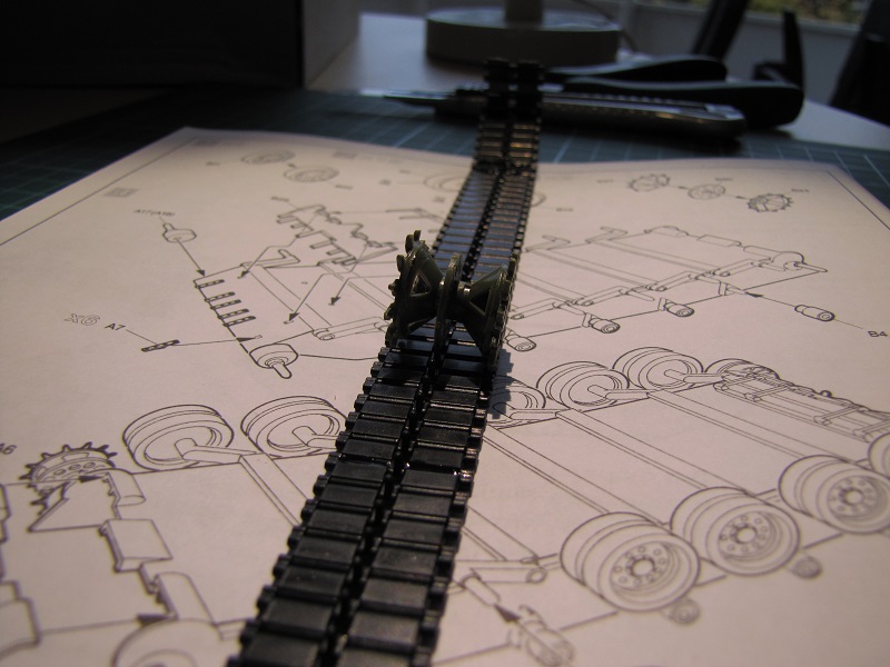

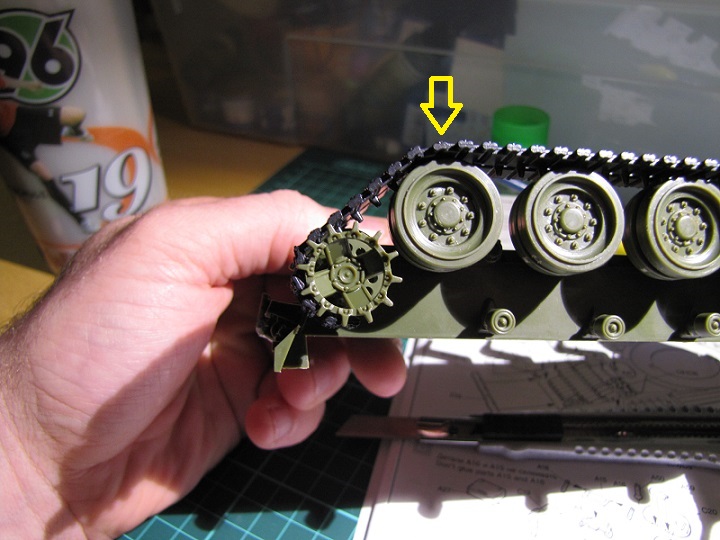

if possible, I'm keeping the running gear to the end. This is the part that cost me the most nerves. :crazy:
The wheels look good and do not require a lot of work. Sorry, no Poly-caps :cry: . The roller must be adhered.
The track consists not entirely of single-track-links.The upper and lower parts of the track are already finished molded. Unfortunately, the drive sprocket is too narrow. Hard to see in the picture. That's why I cut the back teeth of the sprocket. Due to the skirts you can hardly see it later.
schweinhund227
Posts: 2627
Location: Ontario,Canada
Re: Zvezda T-80BV with ERA 1/35
Post by schweinhund227 »
That is weird the sproket doesn't fit !
too bad ! but your fix is ingenious !
not body will be able to spot it with the skirts.... Nice move.

During assembly the tracks, I glued only the two outer rollers. This allows me to airbrush the inner side better. And then this !!! The lower part of the track is too long :wall: . No, not my fault. This part is already complete in the box. I have cut a track-link and glued to the outer connector back again(yellow arrow).

And I thought my track problems were bad! Your tracks come pre-assembled and don't fit, that's bad! It's good that you can think out a way to work with what you've got. Keep at it! :thumb2:

The front-skirts are attached to the under-hull, which is good. This makes the front seam covered where the upper and lower part of the hull gets together. So, no filling and sanding! :th:
At the rear I have glued the extra tanks. And I see that I must rework the exhaust. :scratch::
Then I can start with the airbrushing...

The more I look at my tank, the less I like the paintjob :think:
As I previously sat on my couch and looked into my stash, I saw my T-72 and reminded me of the paint-guide from AK witch is inside ;)
This I am going to use for a new painting tomorrow...
