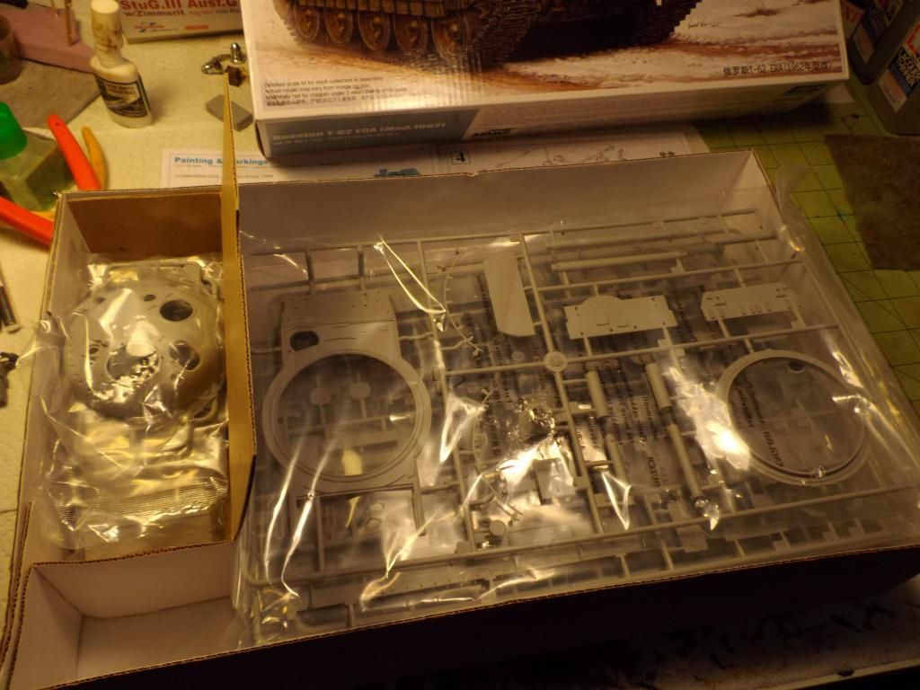

And now a look at what's in the box:
Nice boxart - the norm from Trumpeter :thumb2:
The box is packed!

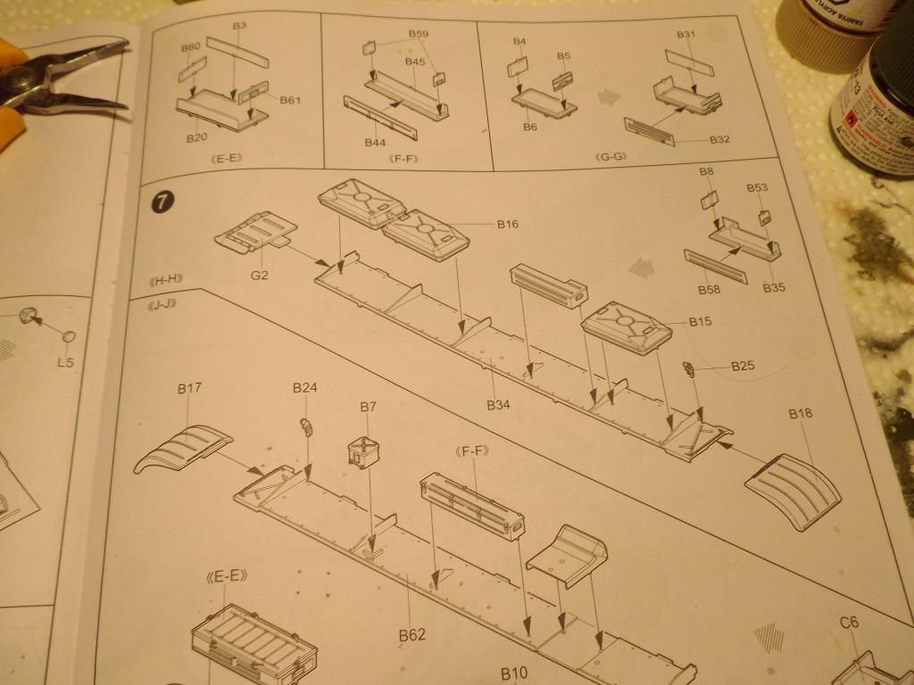

Nice painting guide, though no information about the vehicle shown; there's only one paint scheme, too.

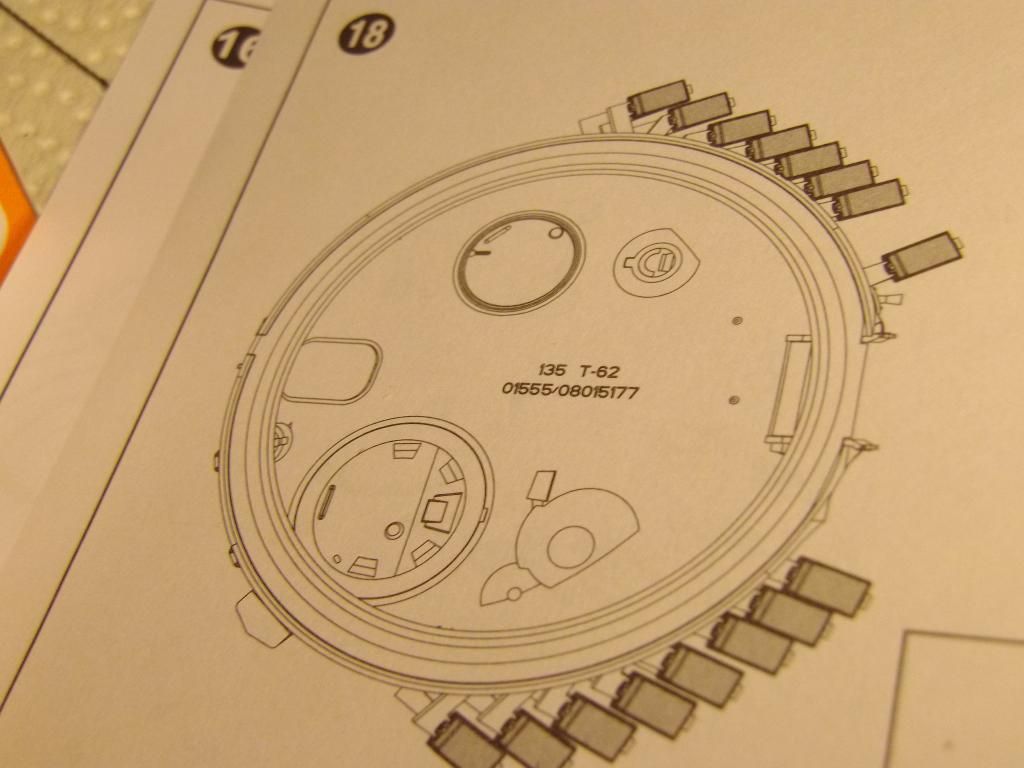

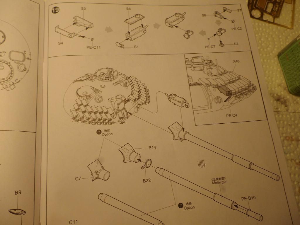

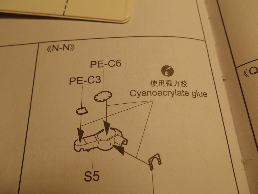

Instructions are clear and clutter-free! :D
Though this looks a bit tedious :crazy:

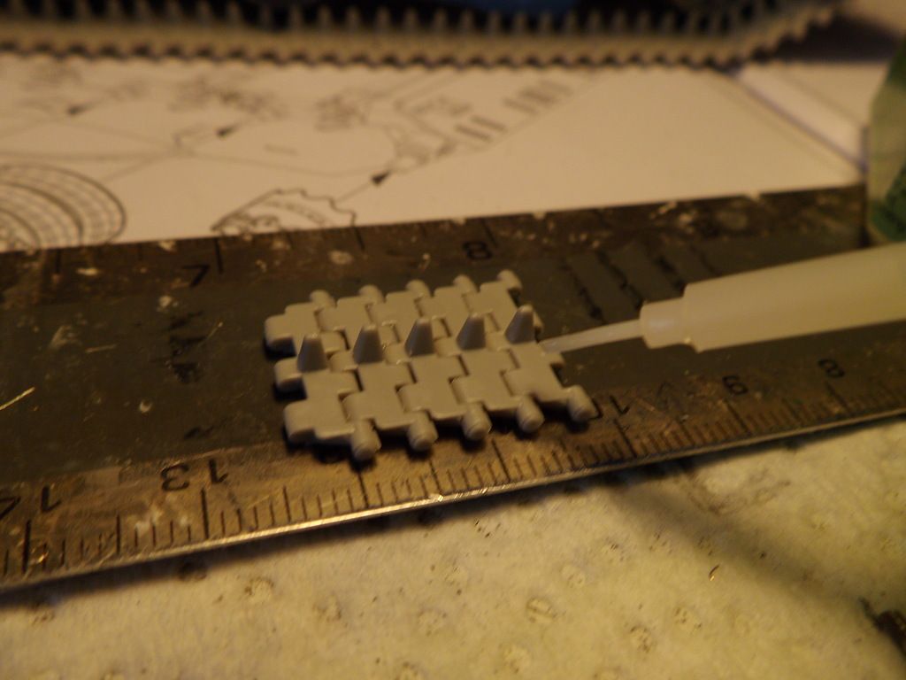

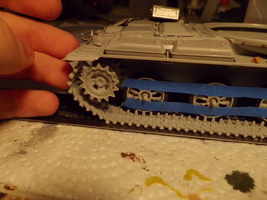

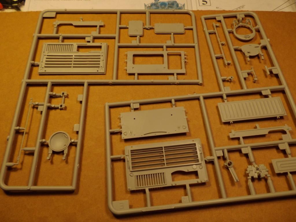

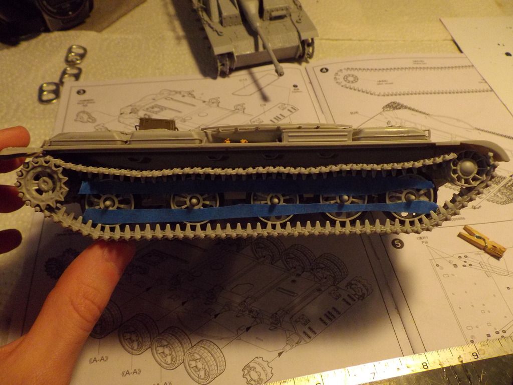

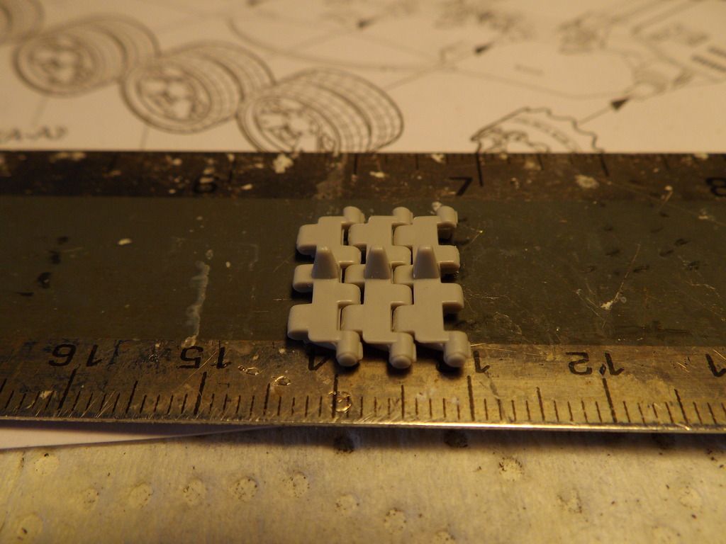

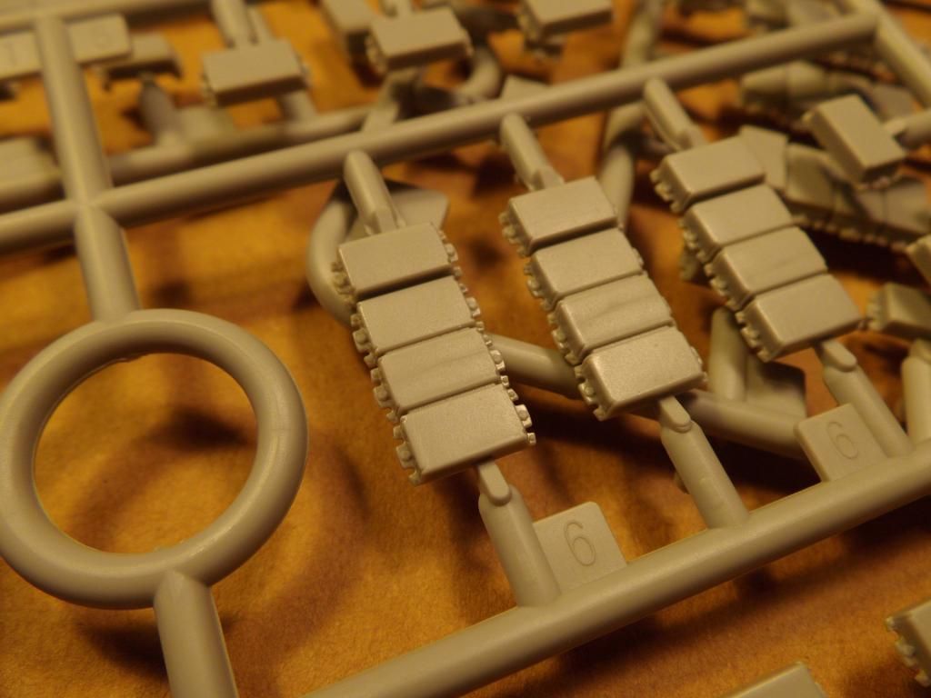

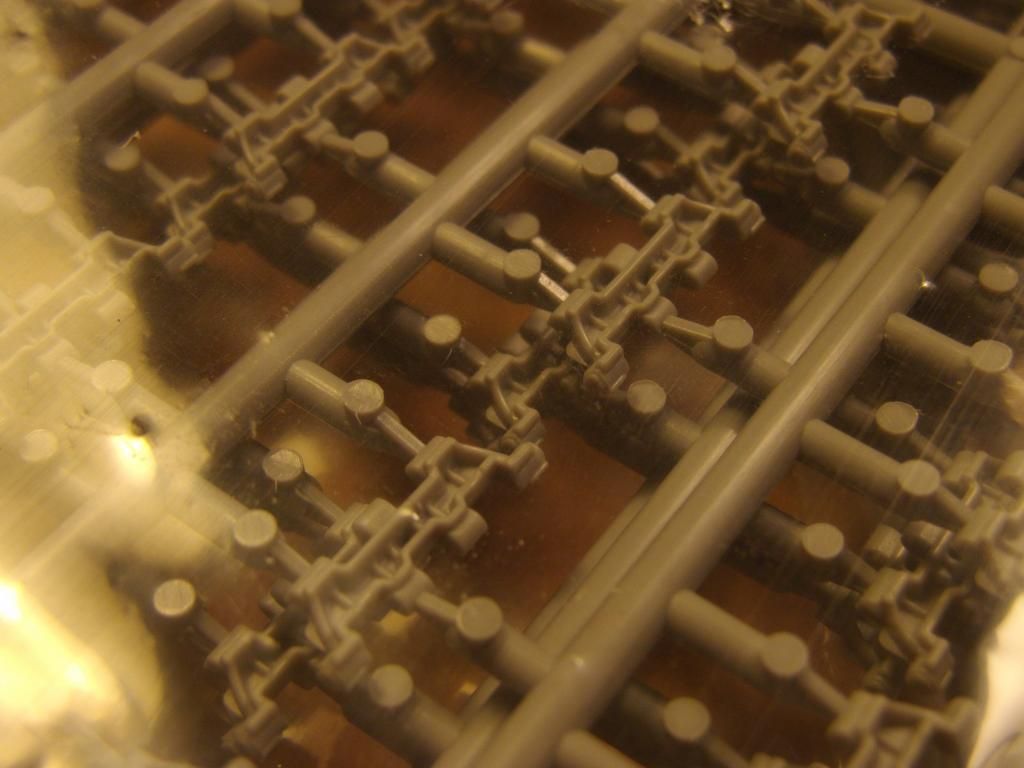

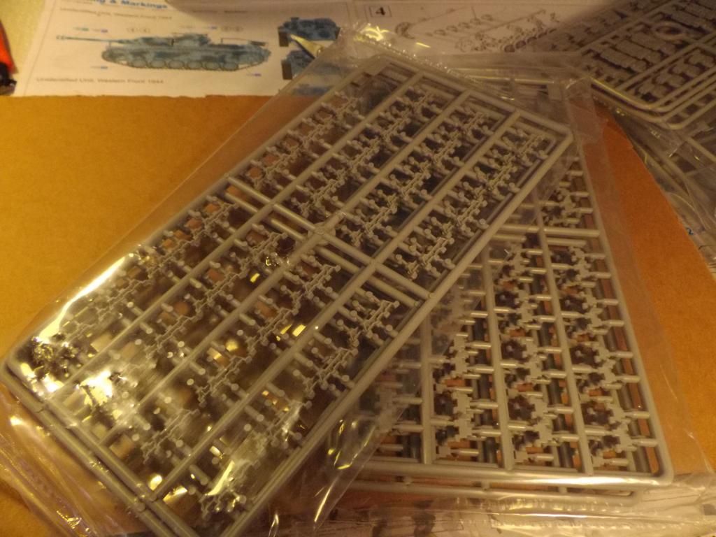

Tracks are on sprues but have minimal moulding points and are nicely detailed... :think:

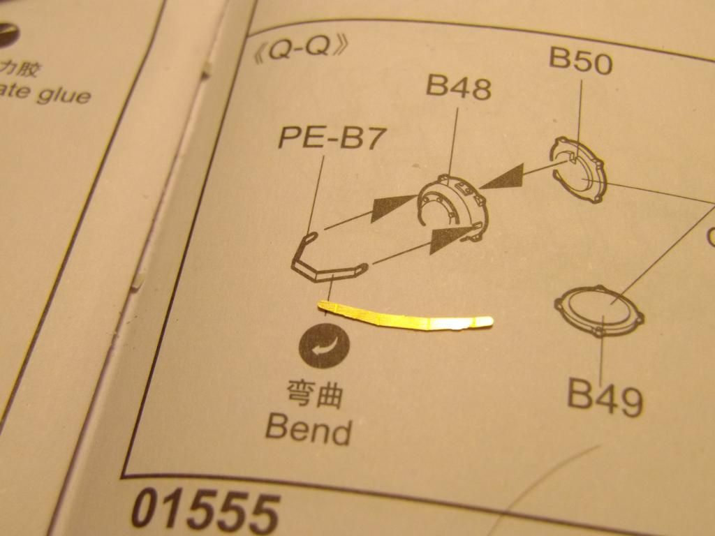

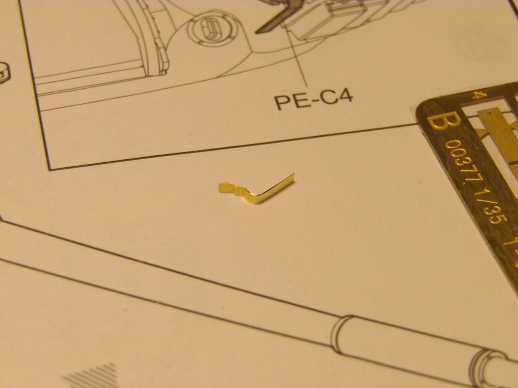

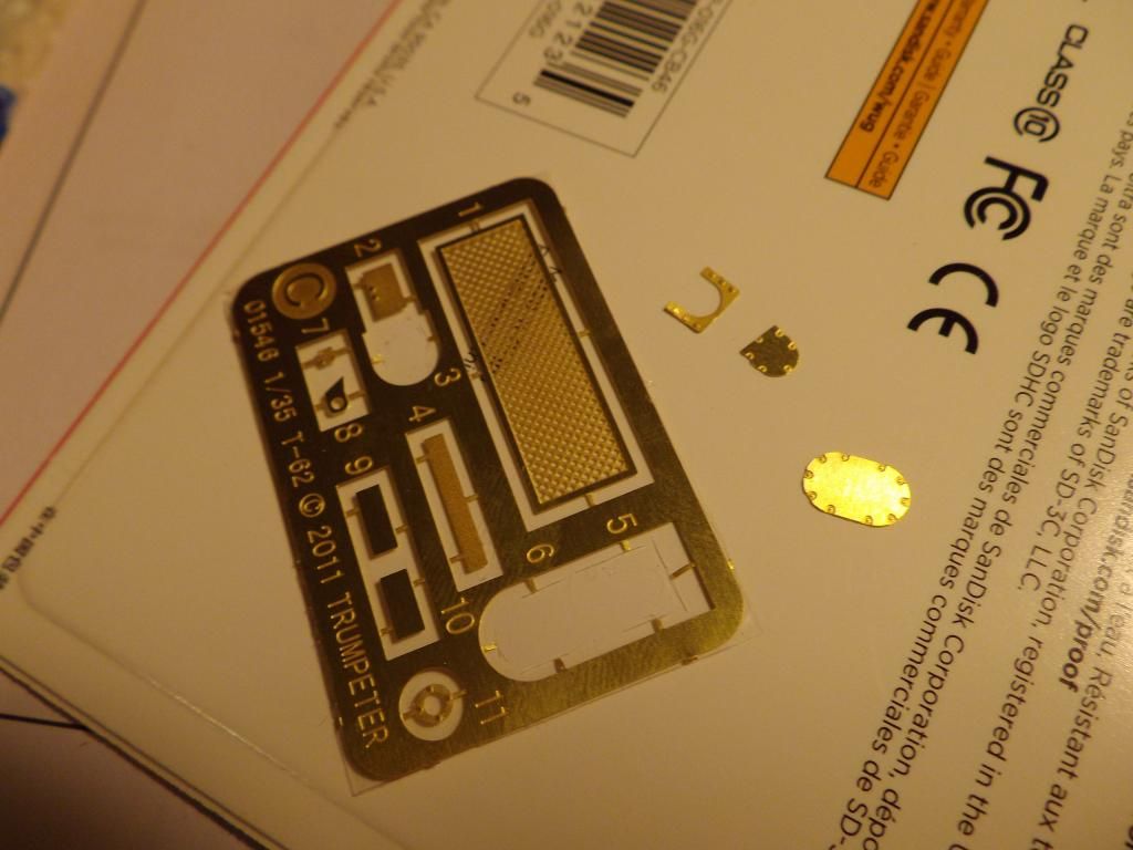

One of the PE frets and the decals - a nice touch, given that you're not supposed to use them... :?

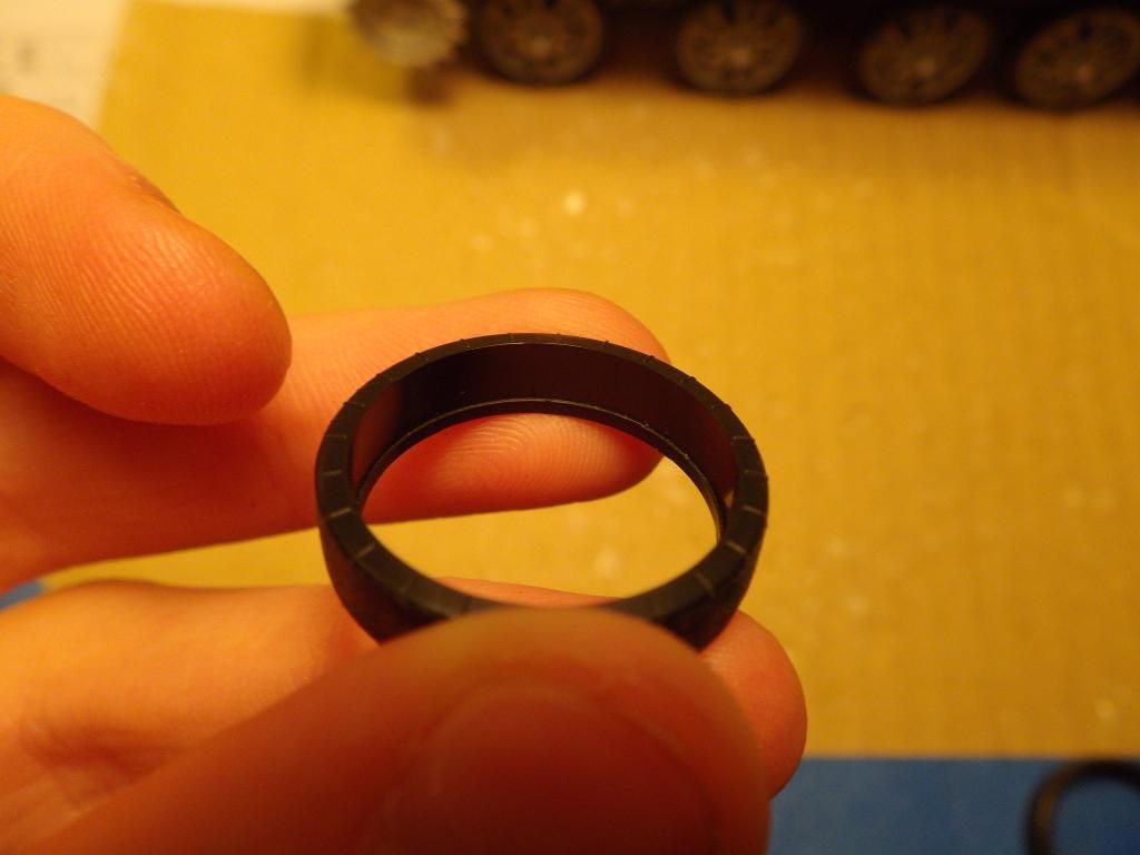

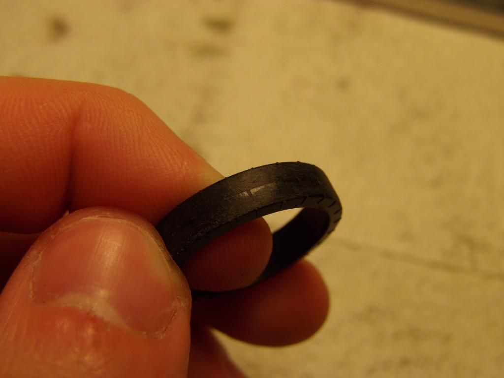

The rest of the PE as well as the clear bits and the tires - moulded in black, but not in rubber. :clap: Nice for painting!

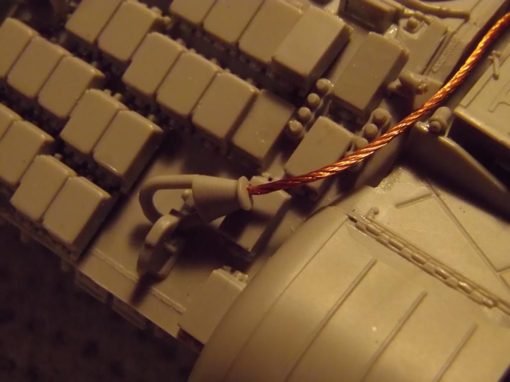

Hull, turret, metal gun barrel, and a nice tow cable!
Nicely detailed; looks cast to me! :thumb2:
Various bits, again moulded well!

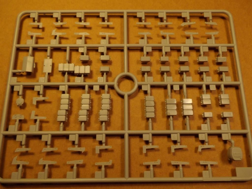

ERA everywhere! :wtf: On the plus side, though, there's minimal sprue gates and Trumpeter has put them in groups when they can. :thumb2:

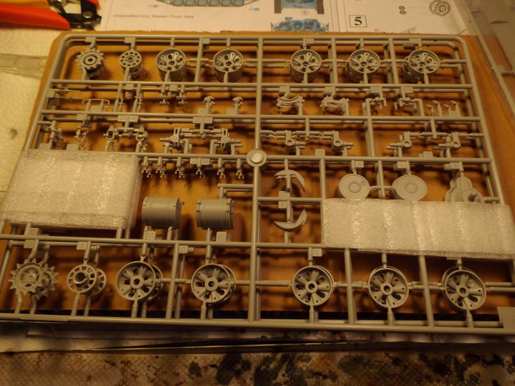

Wheels n' stuffs. Once, again, Trumpeter does well in wrapping delicate handles to protect them.

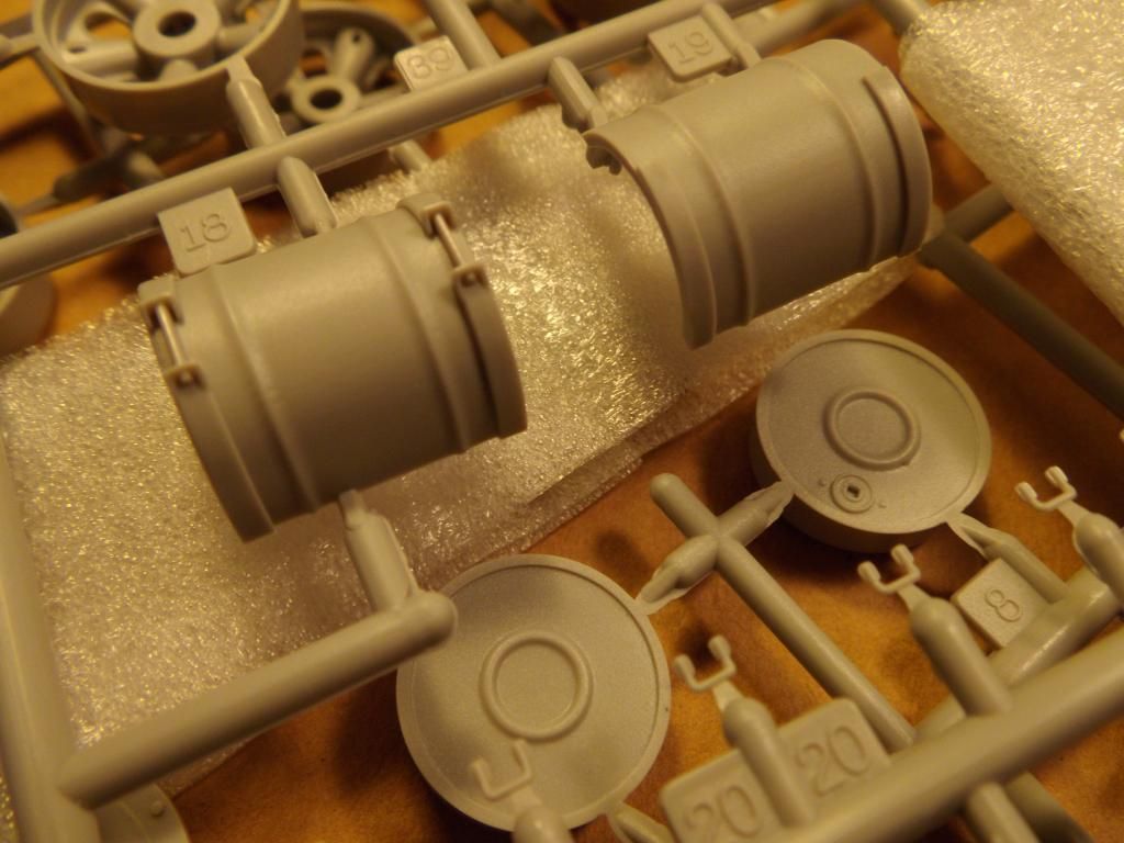

Interesting way of doing the fuel drums. Usually the whole thing is two halves with flat circular end plates, but this way, with the both ends of the drum as one piece, there's less seam to clean up! :mrgreen:
As you can see here, there was some grease on some of the parts; nothing major, though :(
That's "it" (a lot is a better term), so now onto the building! My YouTube review can be found below:

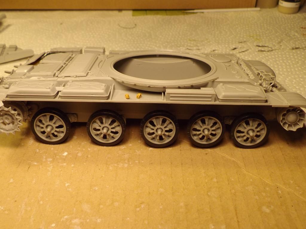

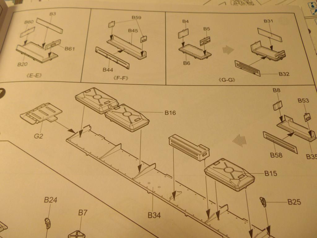

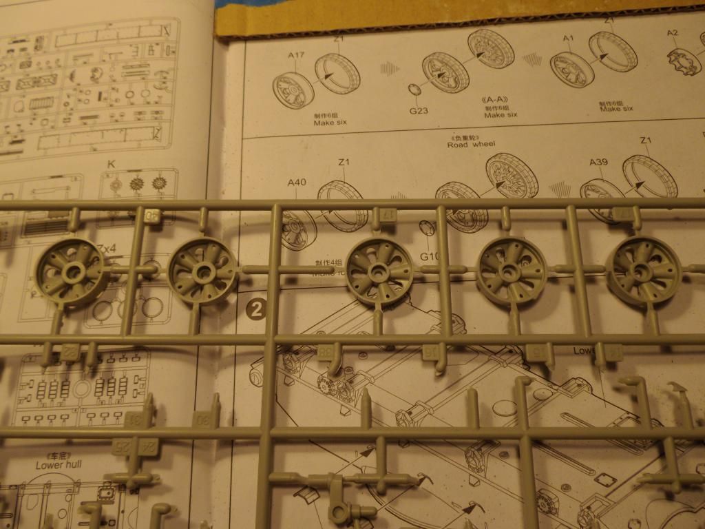

STEP TWO
I skipped step one because I hate putting together road wheels :D

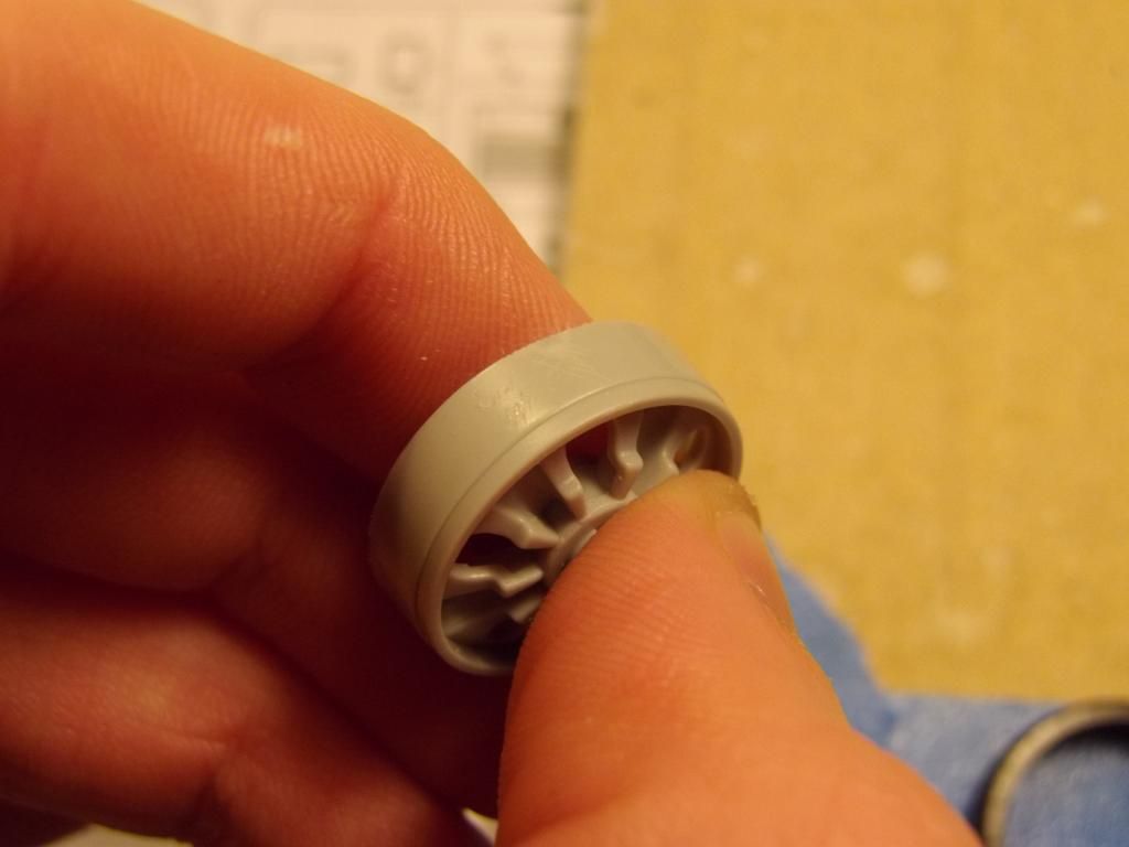

Trumpeter moulds holes you need to drill out on the inside of the part :thumb2: Awesome! I could 'drill' them out with my no.11 blade no problem!
STEP THREE
Not sure about this C13 option, so I just went with C9 because that's the right piece for this model.
C9 didn't want to go on - he kept begging me to take C13 instead - so I had to clamp him down :tongue:
Suspension arms done.
STEP FIVE
Again, I skipped a step (number four) because that was the tracks and I'll do those later.
Fill these holes....
...Only to cover them up later? Hell no - that requires effort! :mrgreen:

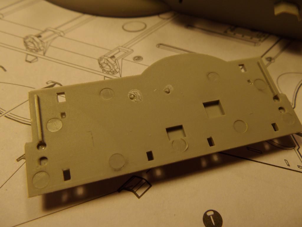

STEP SIX
Putting the details on the front of the hull.

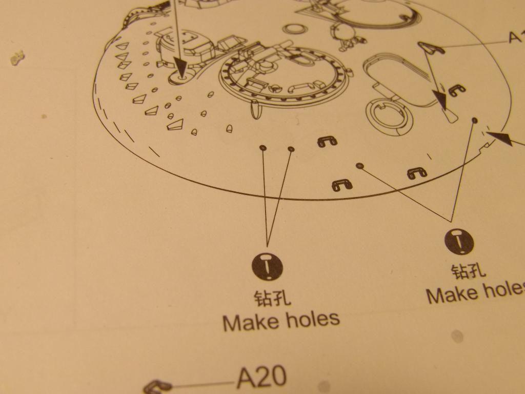

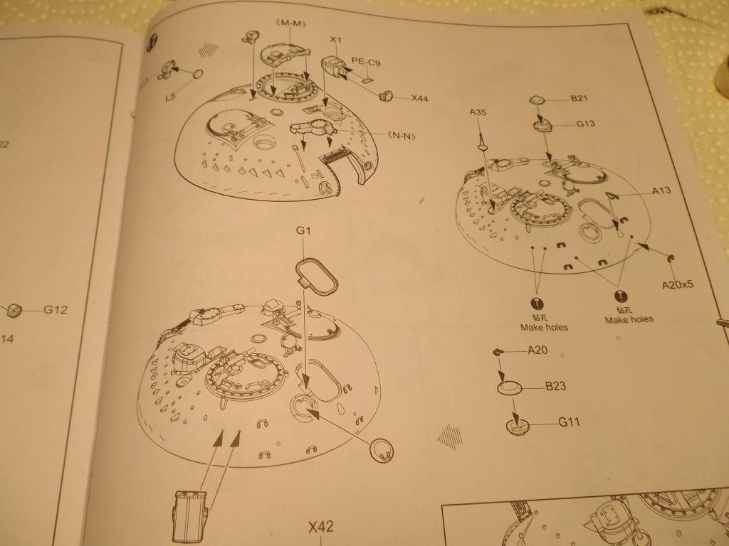

Again, the holes here already drilled 50% of the way through from the back, so I could just poke them through (right set) with a knife and open them up (left).
All done! I left the clear parts out of the headlights because I'll put those on after painting.
Last edited by Panzermeister36 on Mon Feb 02, 2015 10:07 pm, edited 3 times in total.

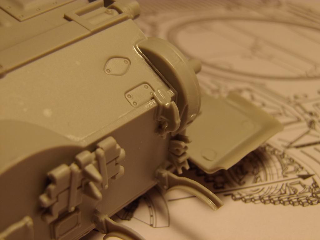

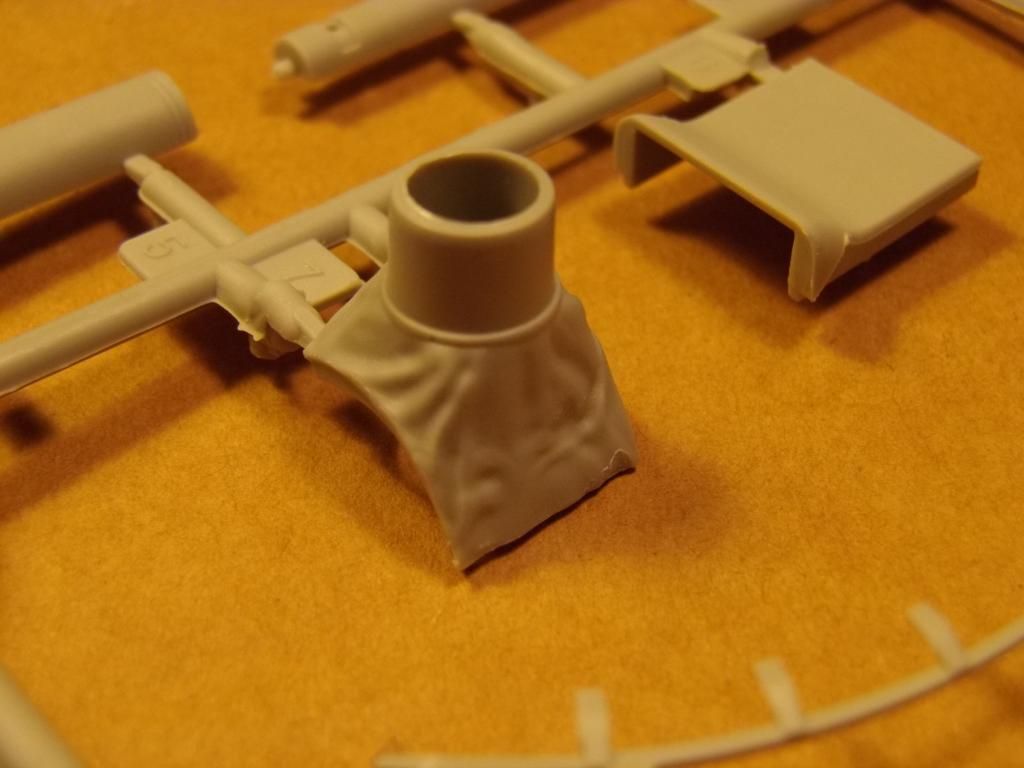

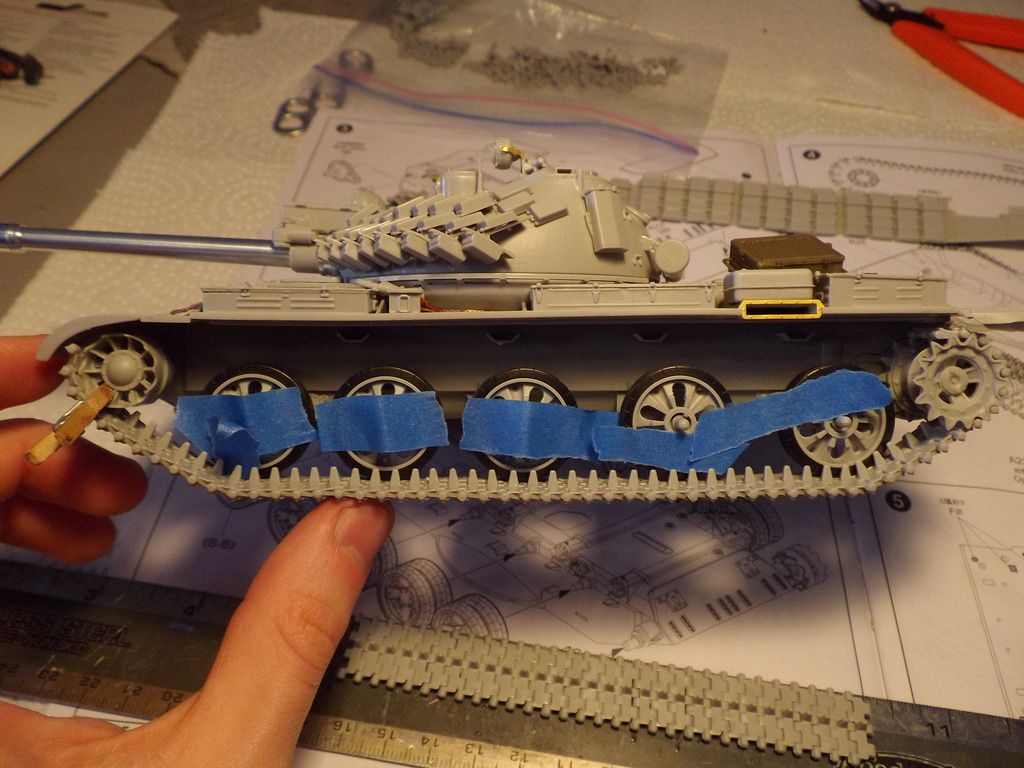

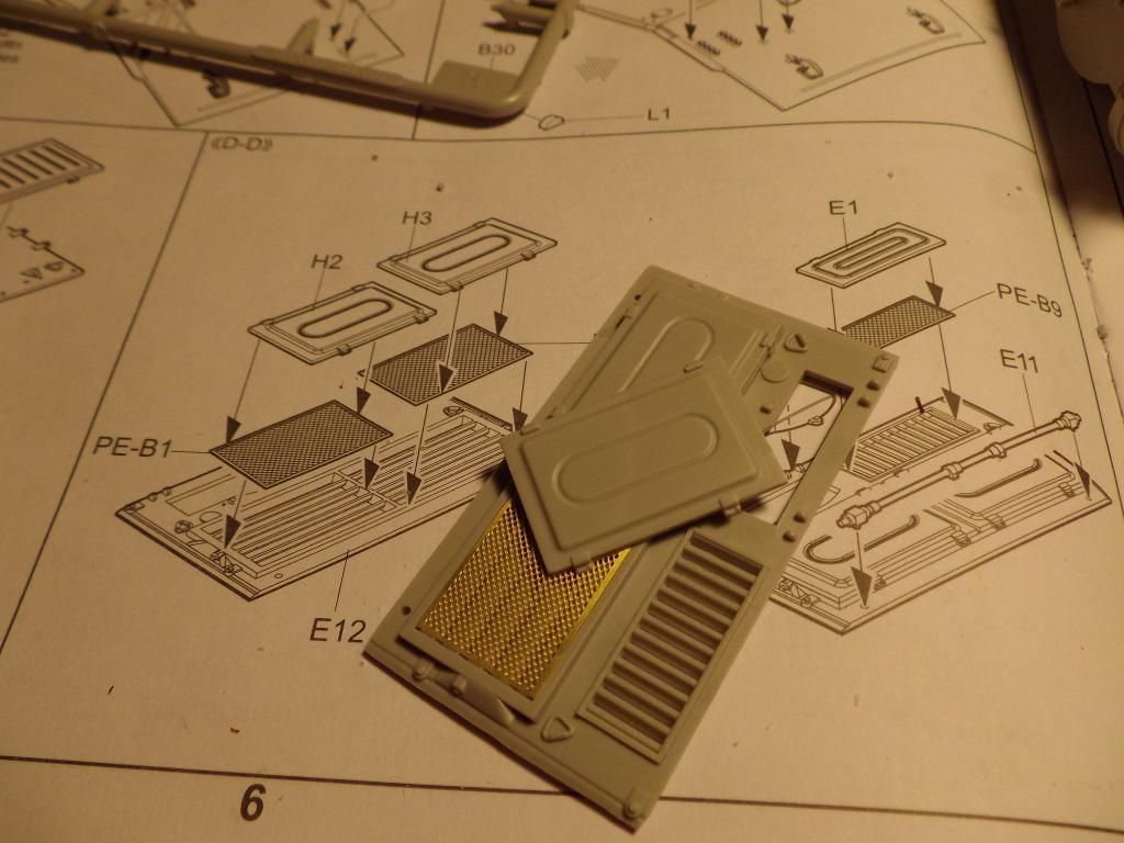

STEPS SIX, SEVEN, EIGHT AND NINE

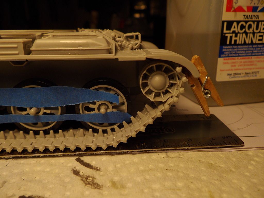

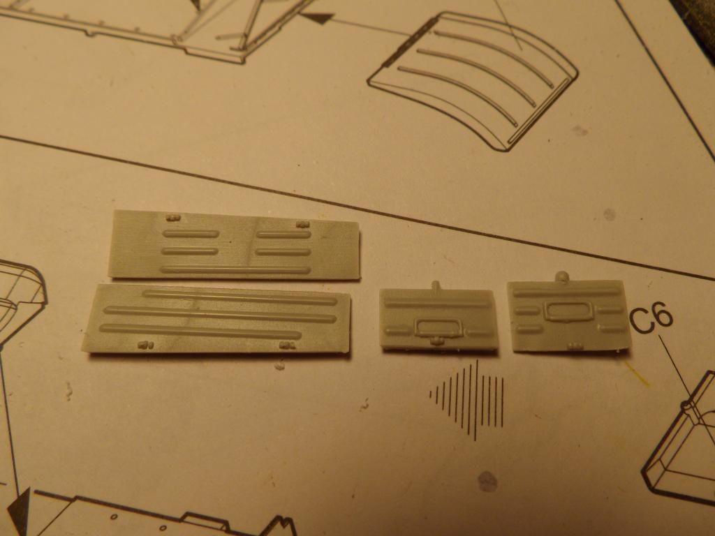

I did these steps kinda as one; sometimes, instead of building all the subassemblies and then putting them on together later on, I just glued the subs onto the tank when I finished them. That's just how I roll!
Nice PE screens, but they all get covered up!

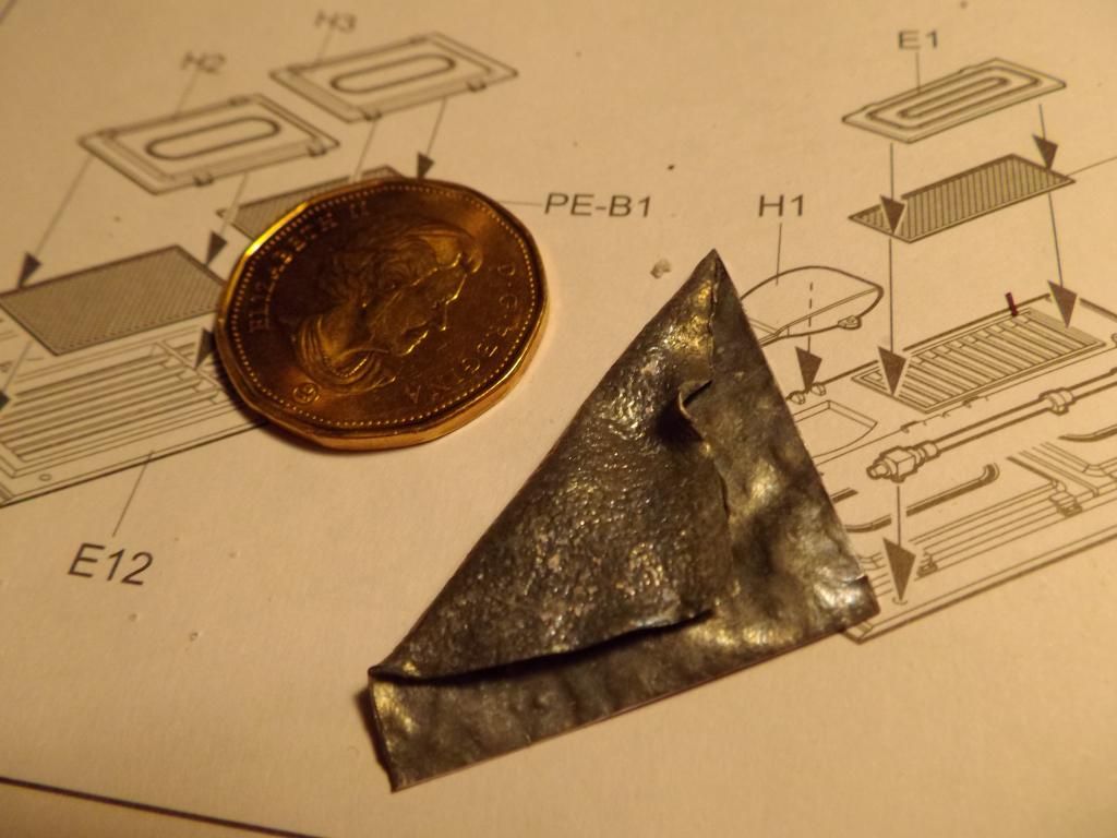

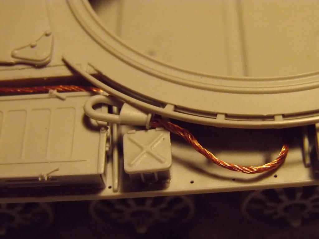

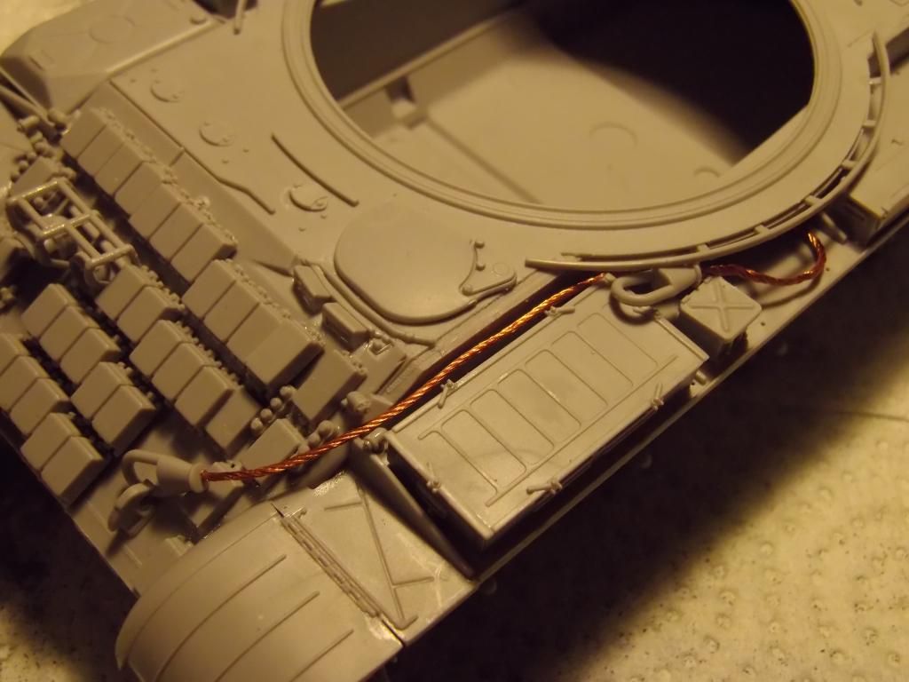

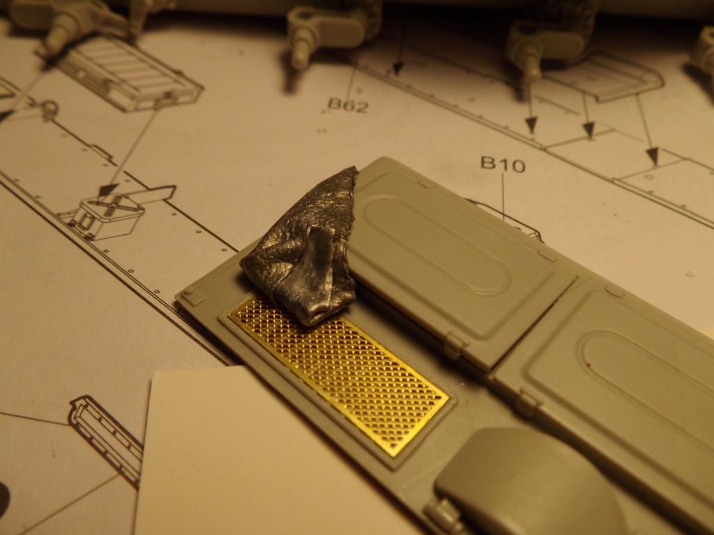

So I made this tarp out of lead foil. I cut it out of a larger sheet as you can see above and then simply folded it randomly to fit the engine deck hatches but still prop them open a bit. Now some of the vents are visible! It adds some interest, too.
And this is where it stands with then engine deck built.

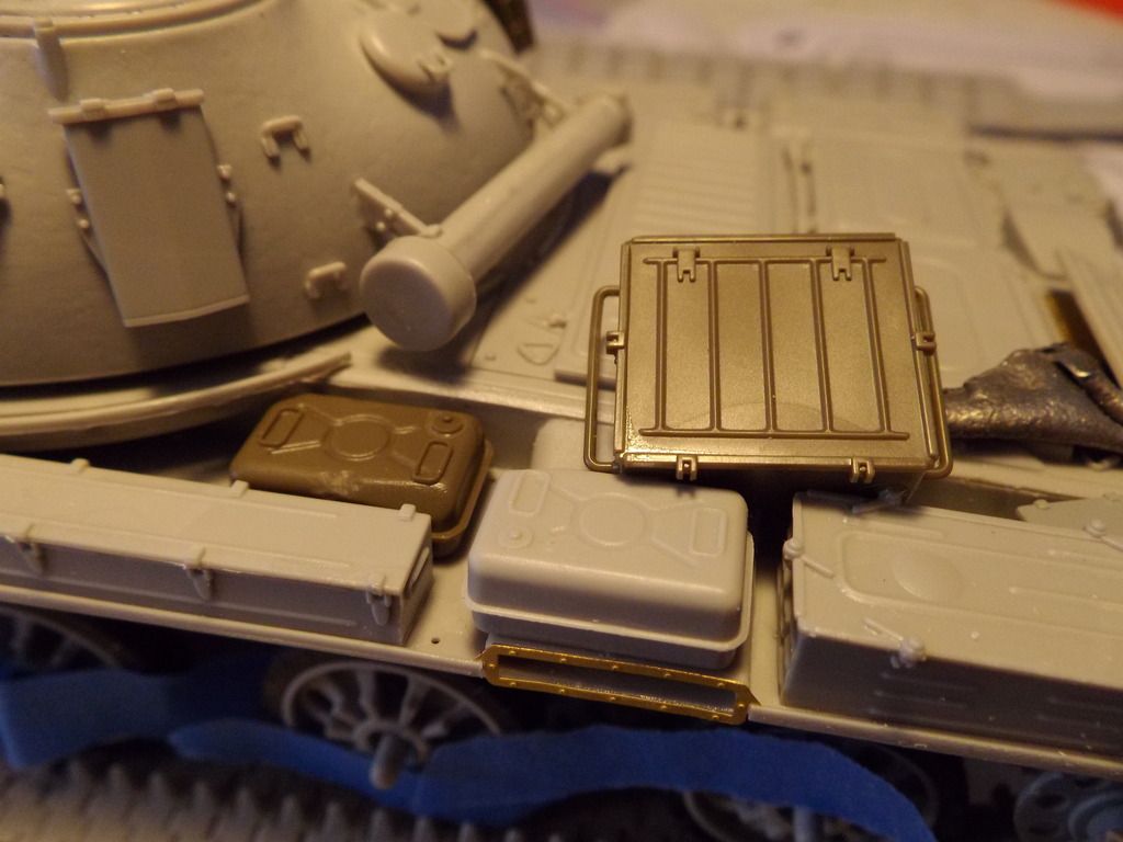

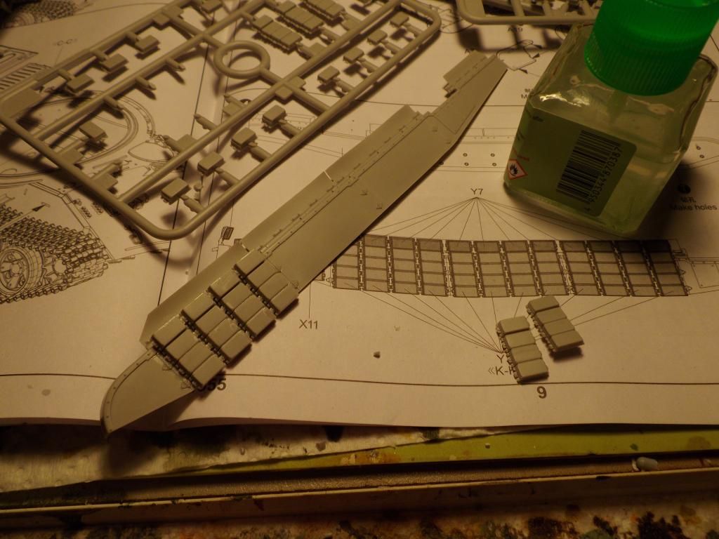

These steps cover the fenders.

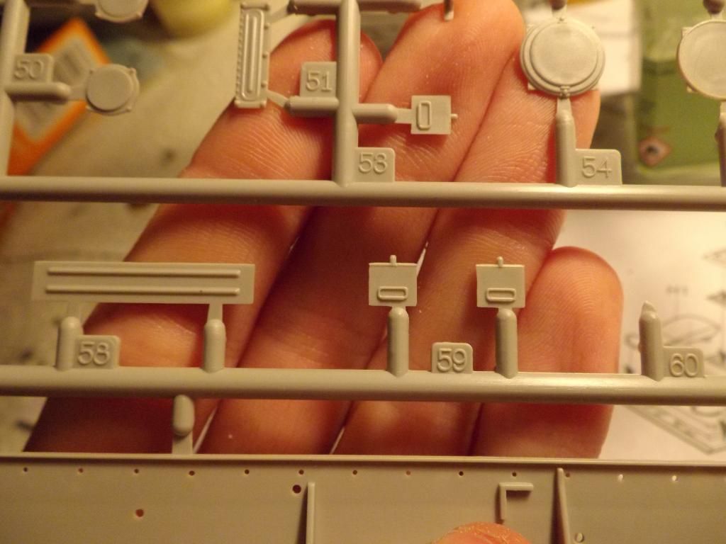

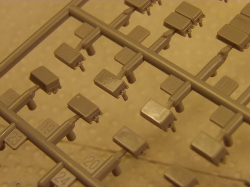

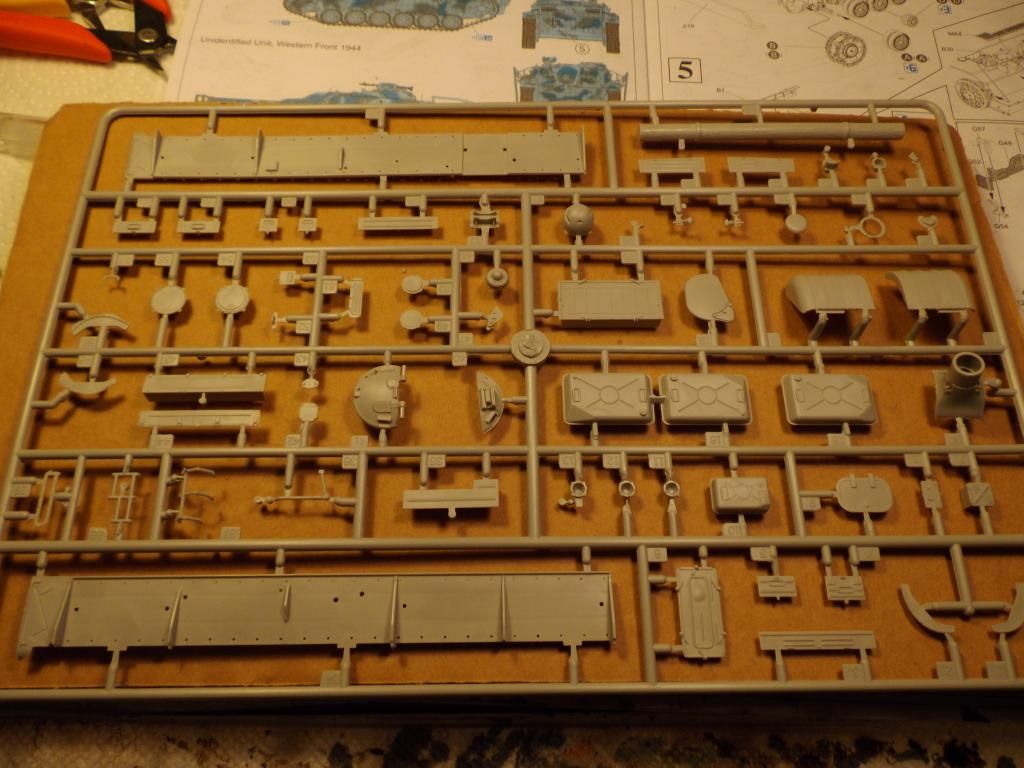

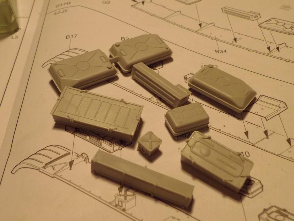

This is how I keep track of the parts' numbers since I like to clip them all off the sprue at once, and then sand them all at once, so that I can put all the parts together at once! :mrgreen:
I thought that it was interesting that this box is slightly angled. :wtf:

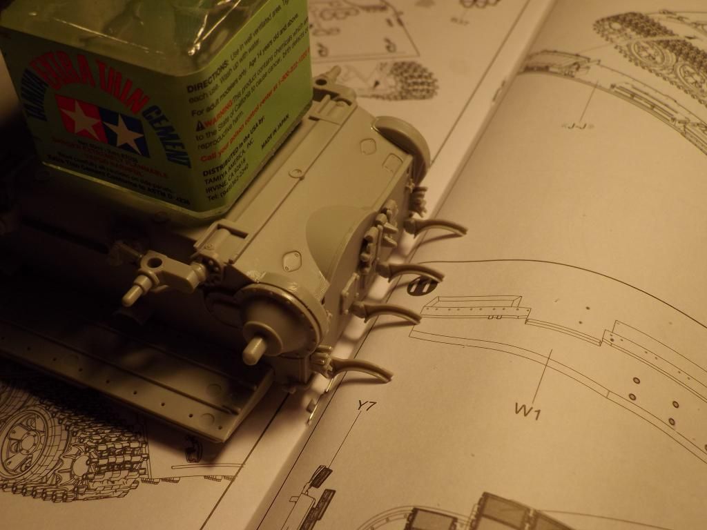

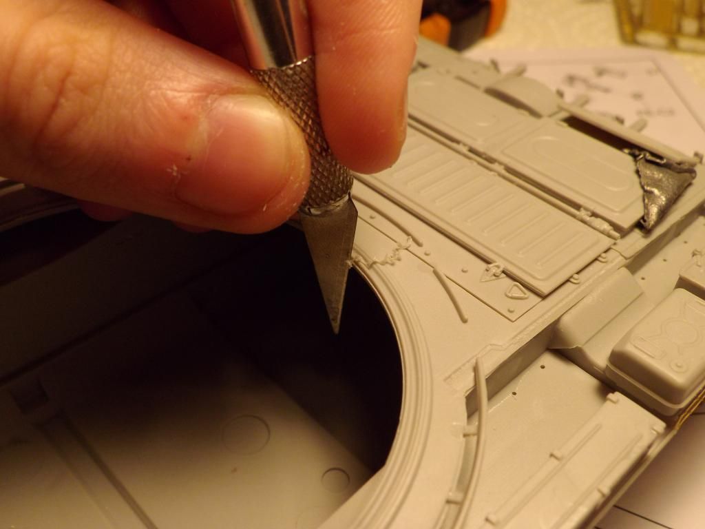

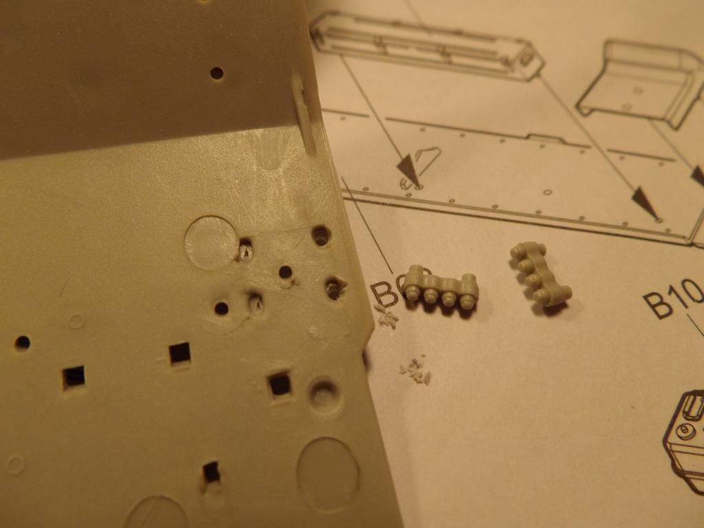

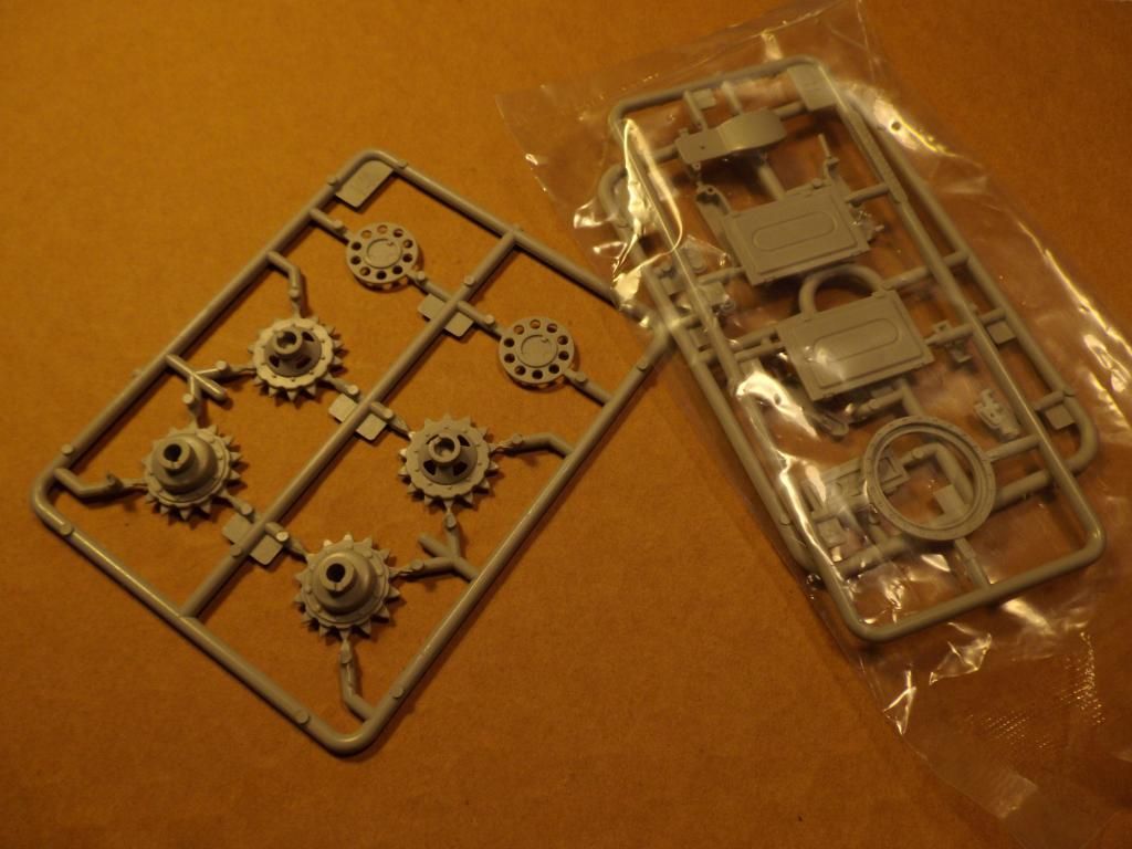

Way too close to the sprue, Trumpeter! :cry: How do I cut them off without damaging them????
Well, this is how: You cut the sprue gate from the main sprue rails, and then it's easier to cut off :D
Lots of boxes - reminds me of Ikea.

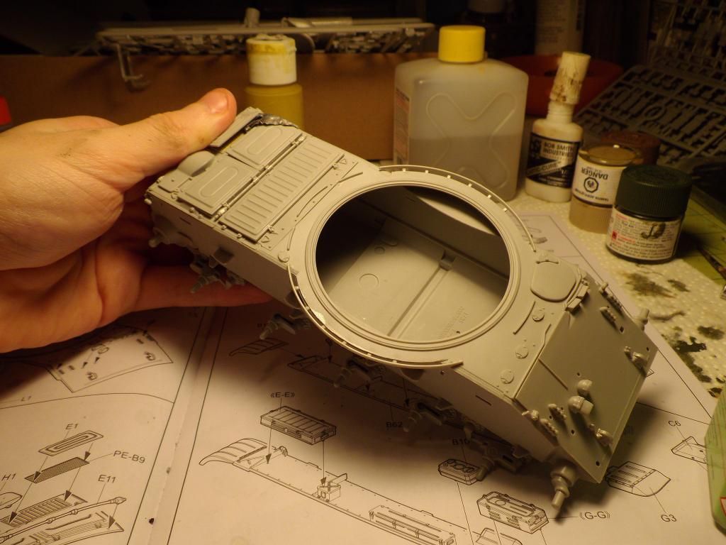

And now here we are! Done the basics of the hull, and it's been a fun build so far :thumb2: I love Trumpeter now!

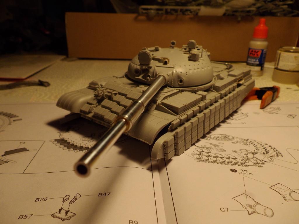

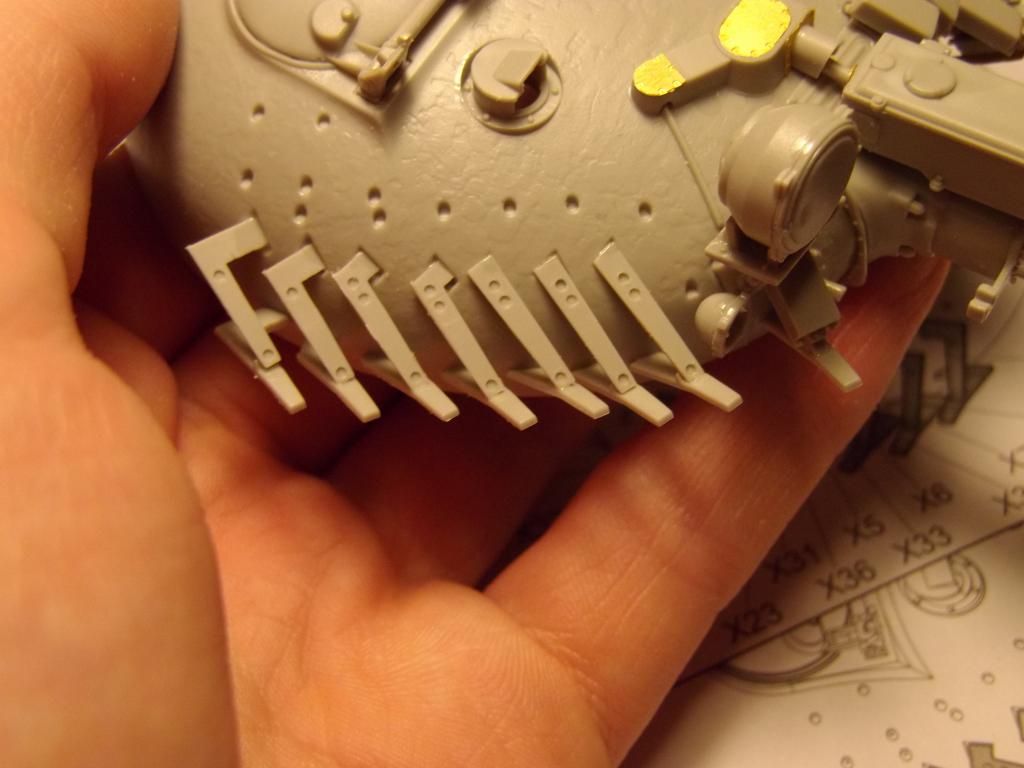

~PART THREE~
All text refers to the photo(s) directly above it

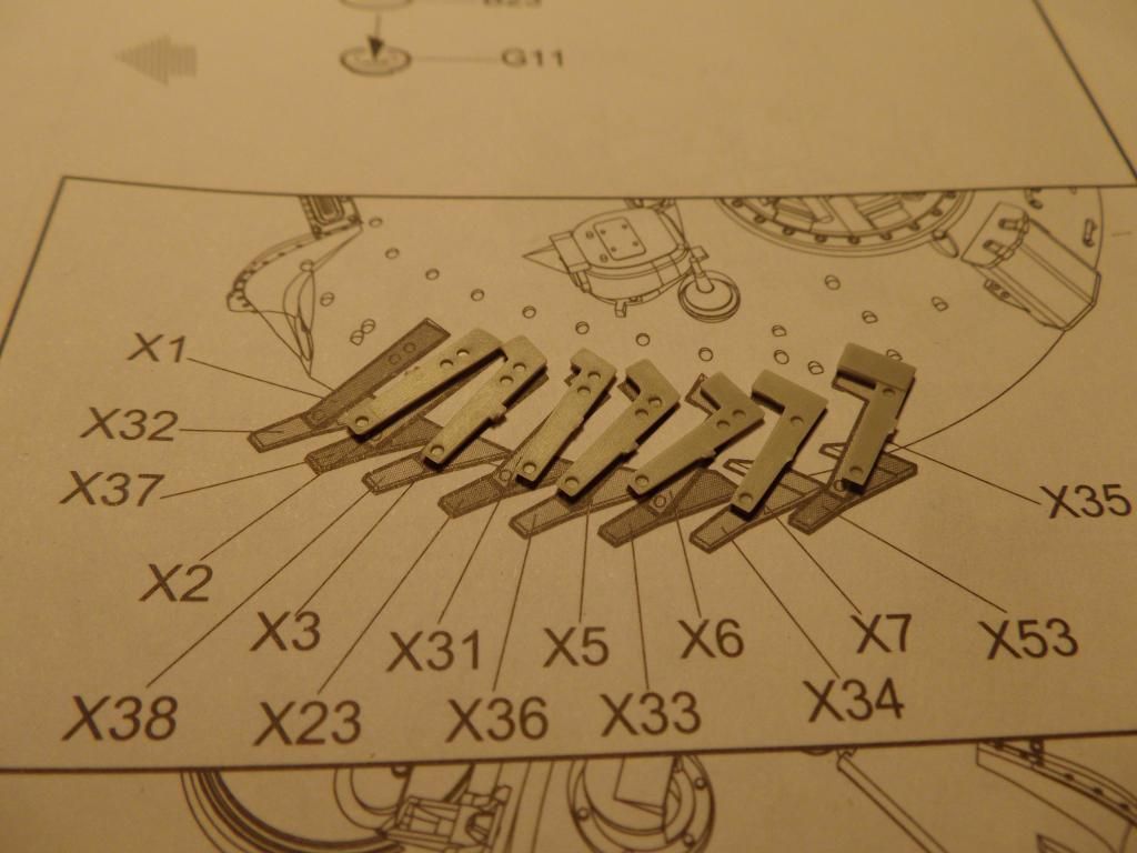

STEPS 10 (con't.) to 14

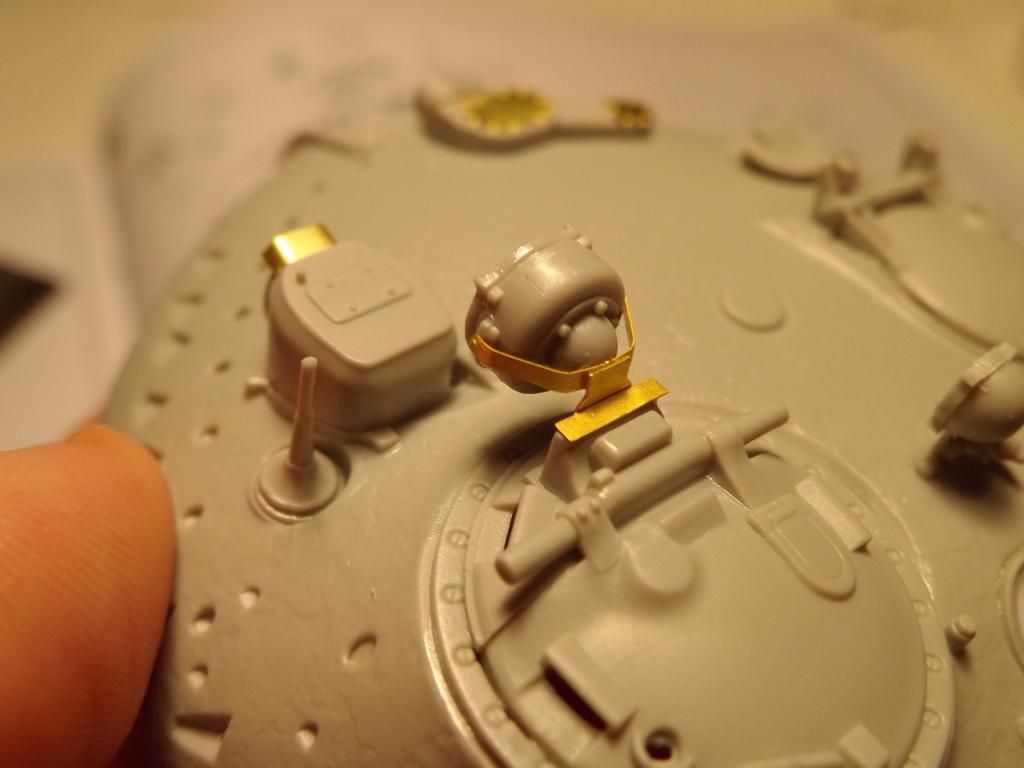

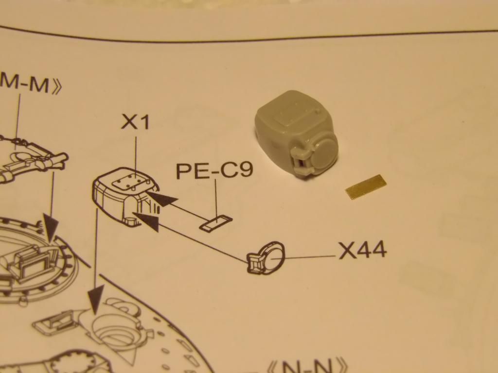

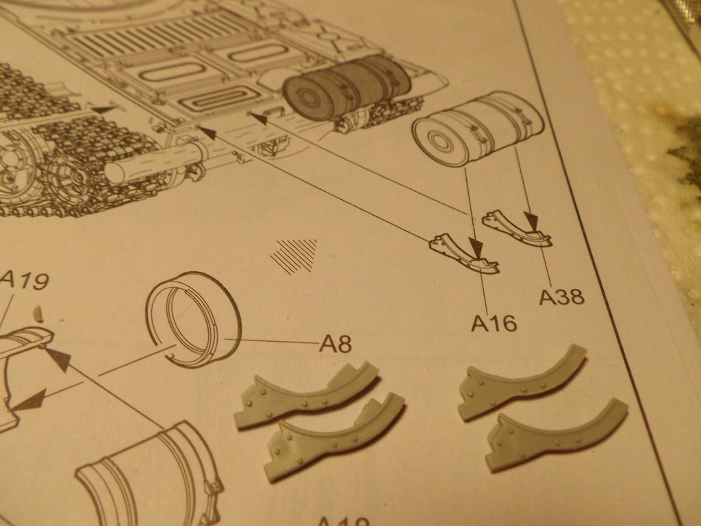

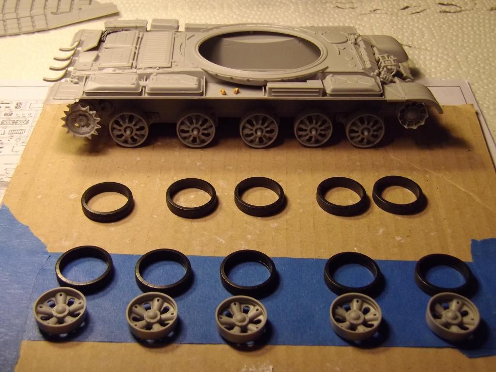

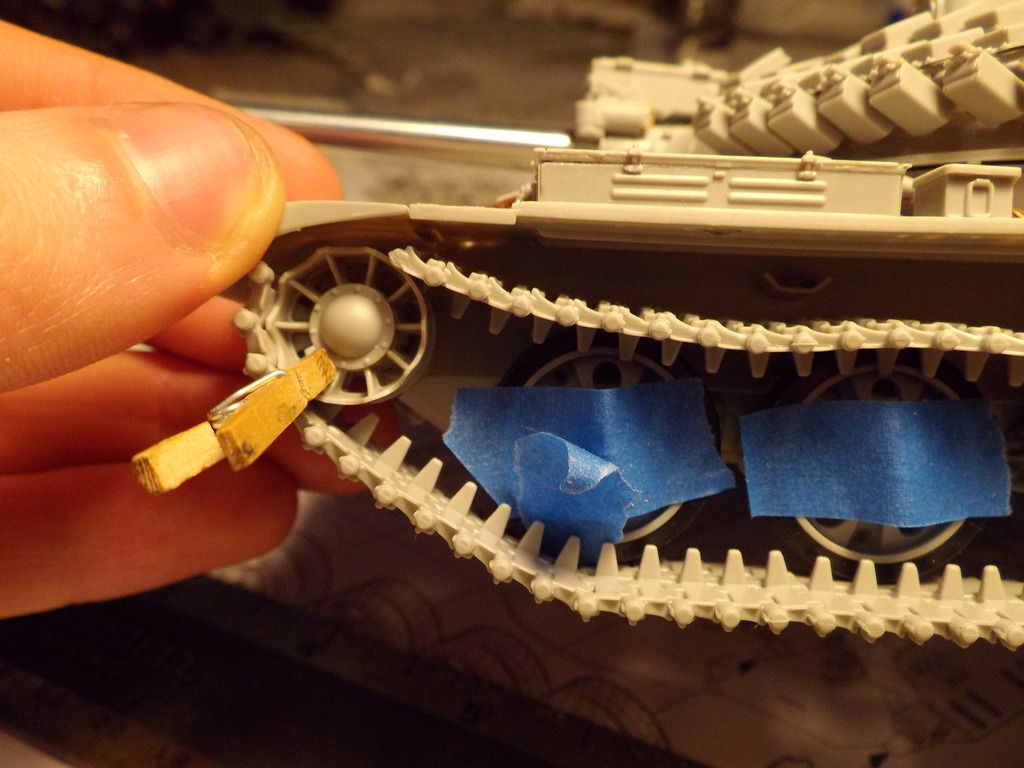

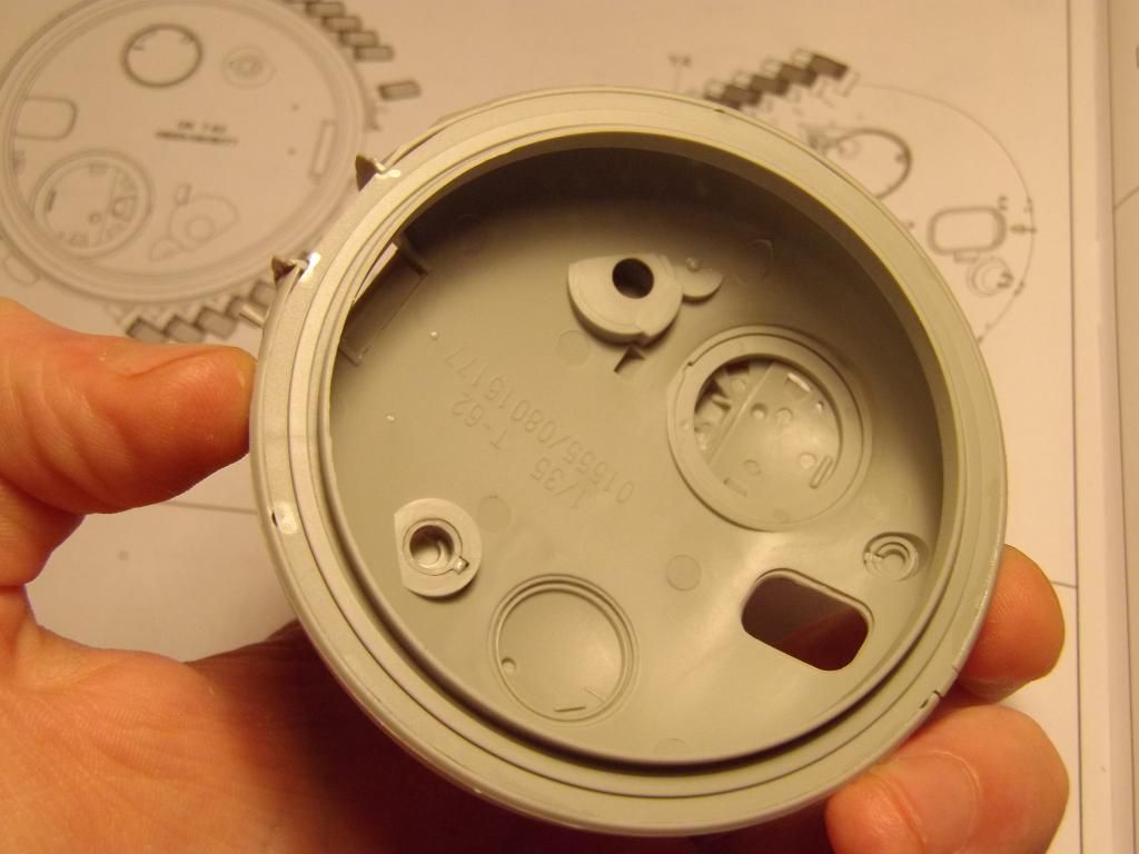

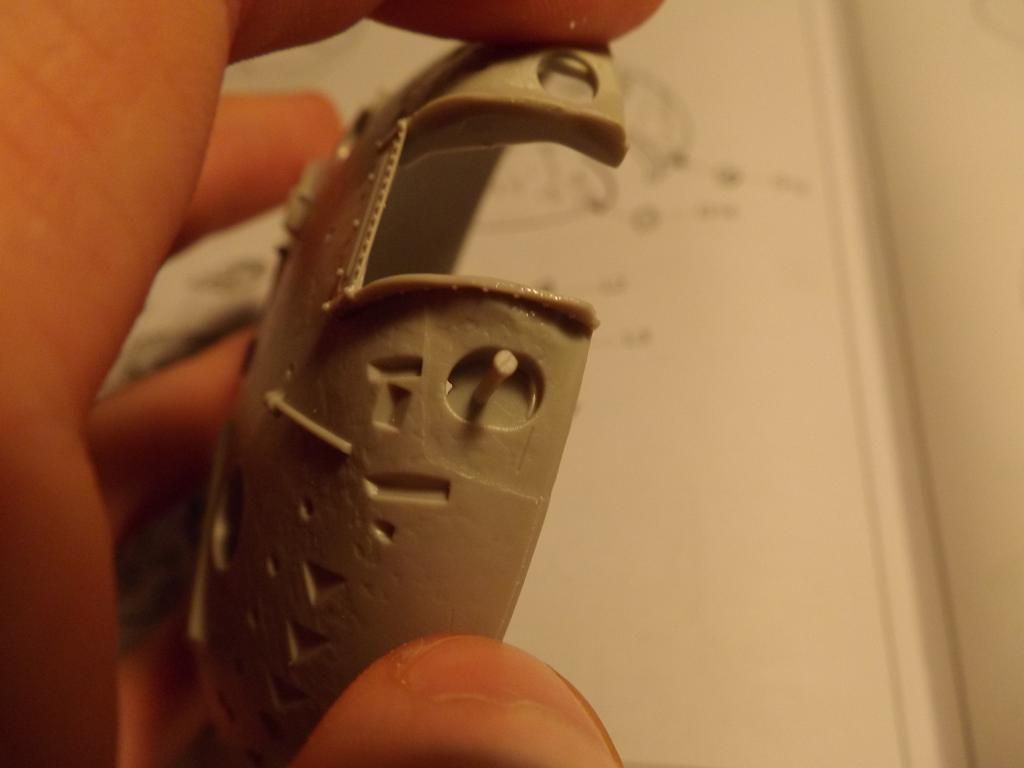

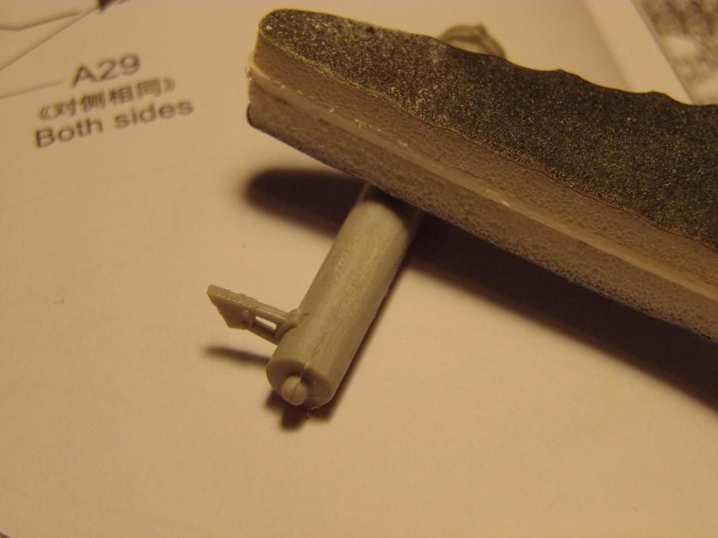

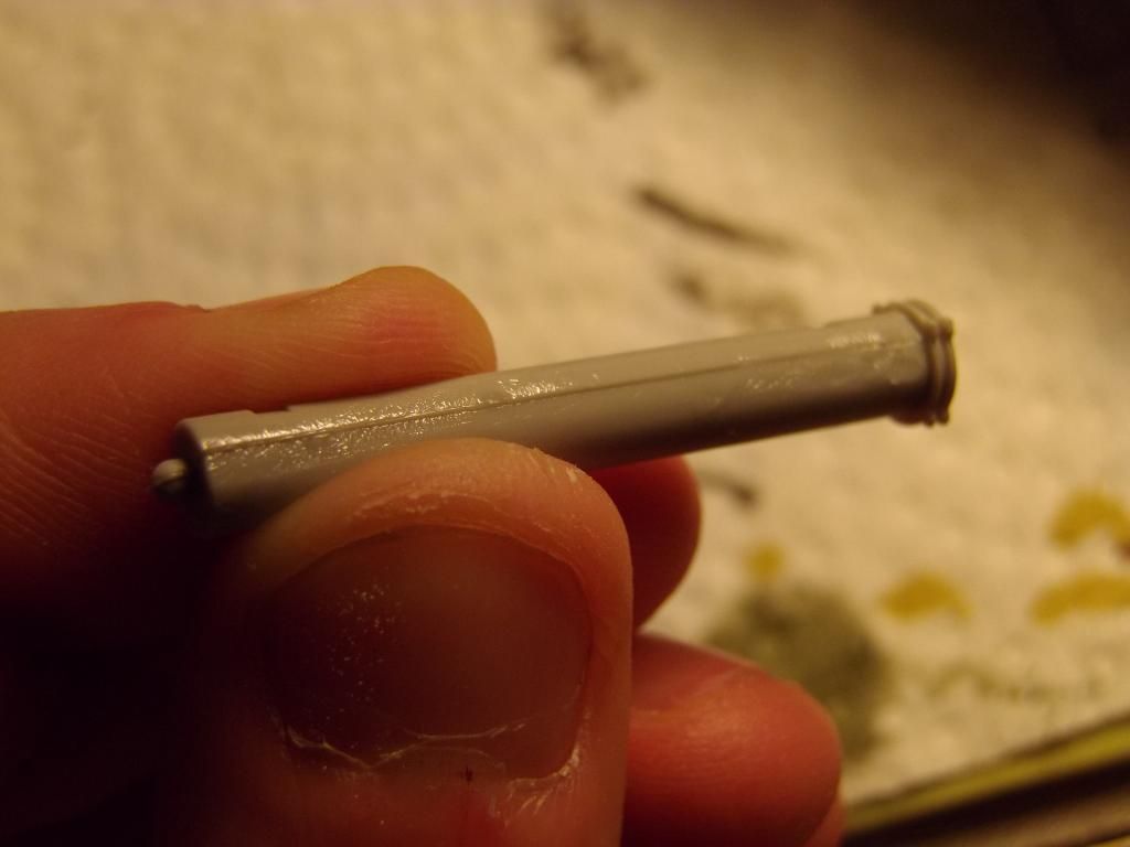

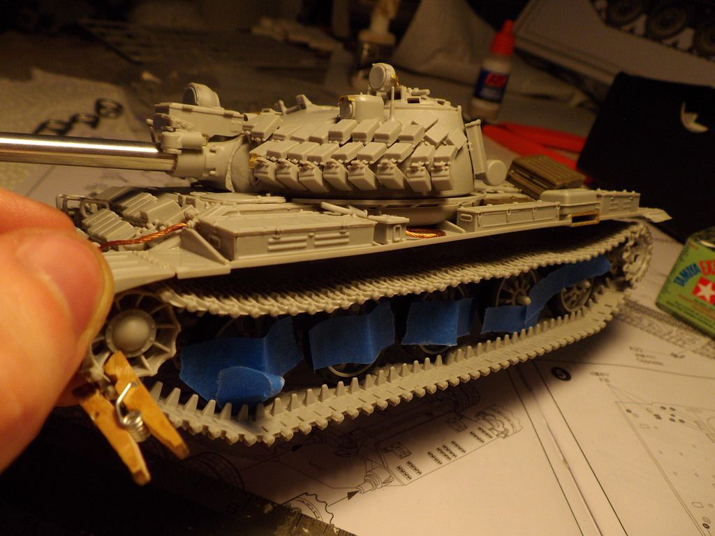

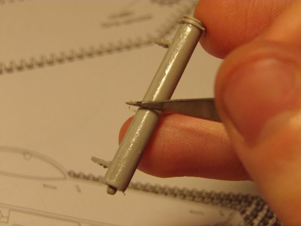

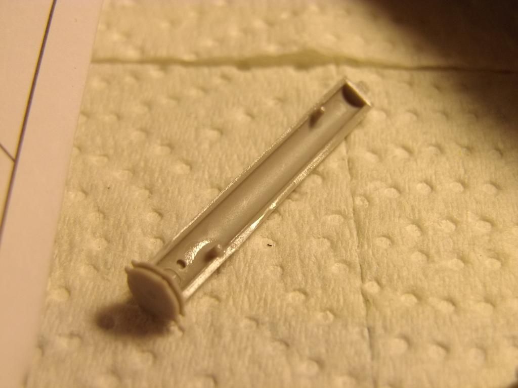

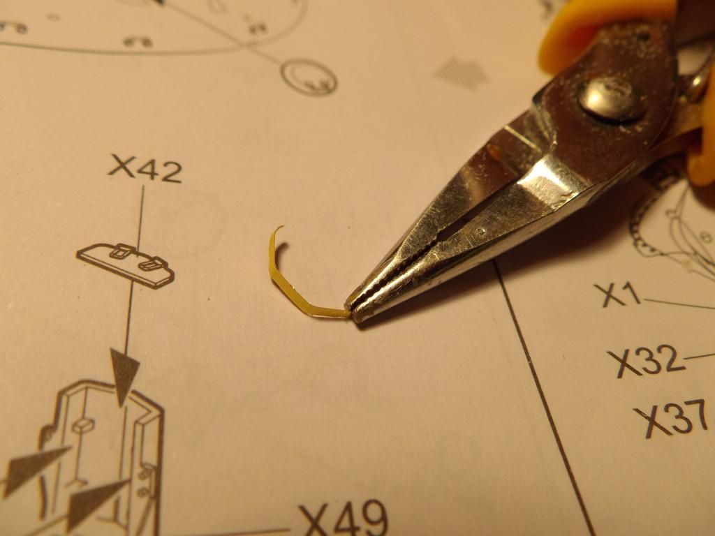

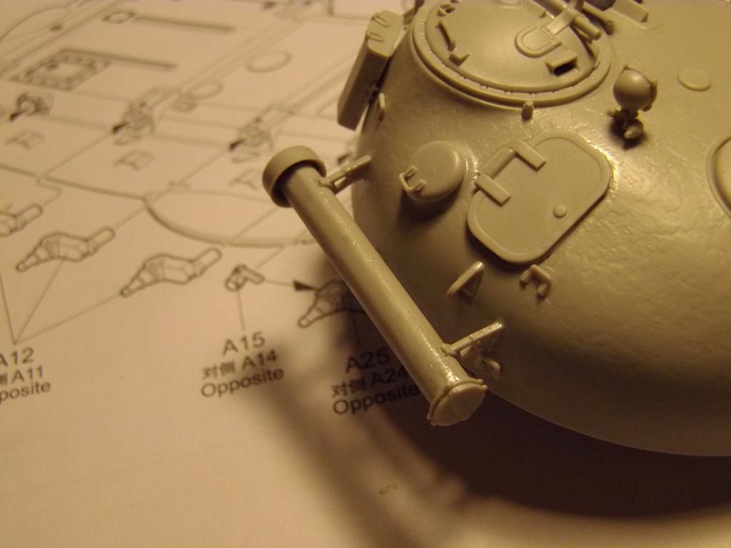

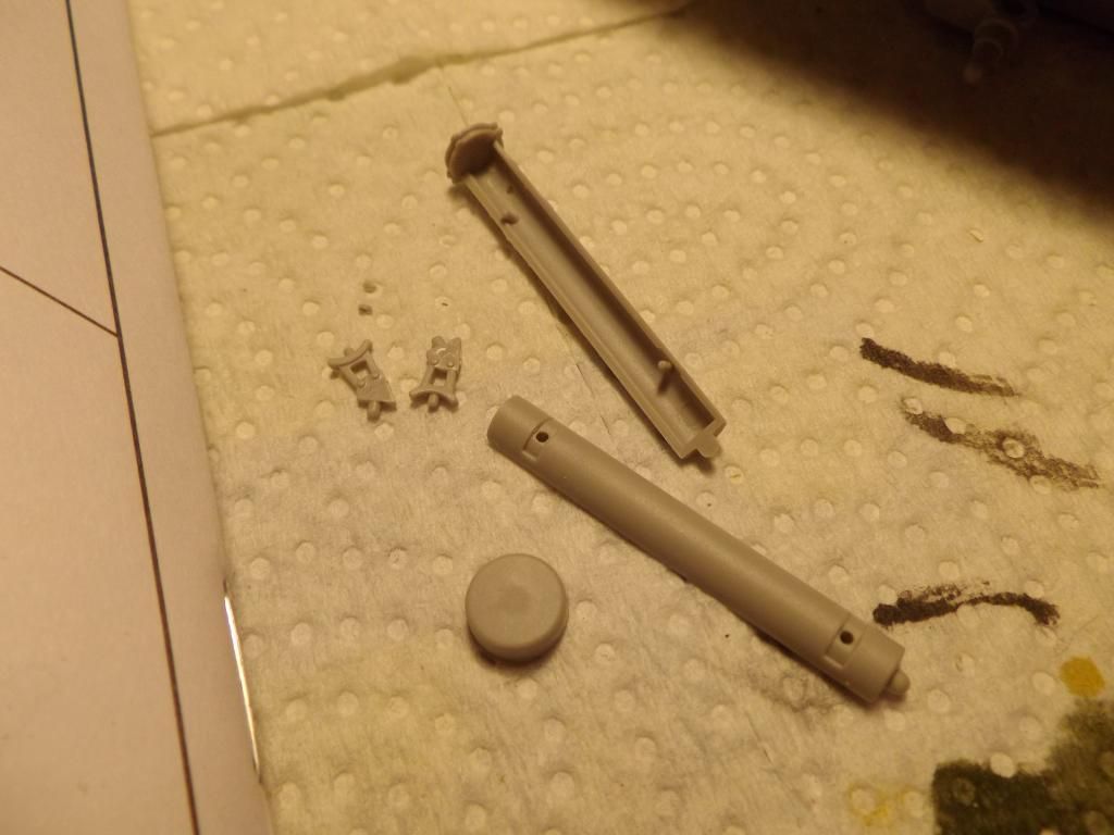

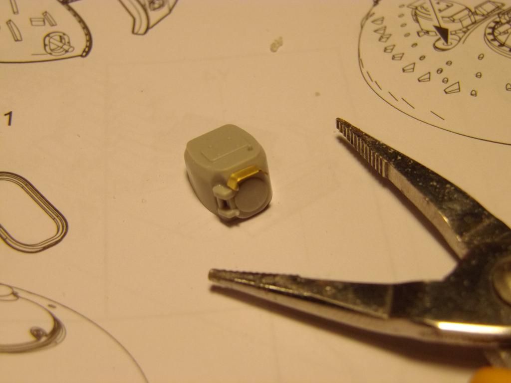

I wanted to leave the fuel drums off so I cut off the locating tabs on these arms. Before (left) and after (right). I used the sprue cutters to hack most of it off and then cleaned it up with the hobby knife and ISM sanders. [product placement alert!]
I came up with this to ensure the arms were all lined up.

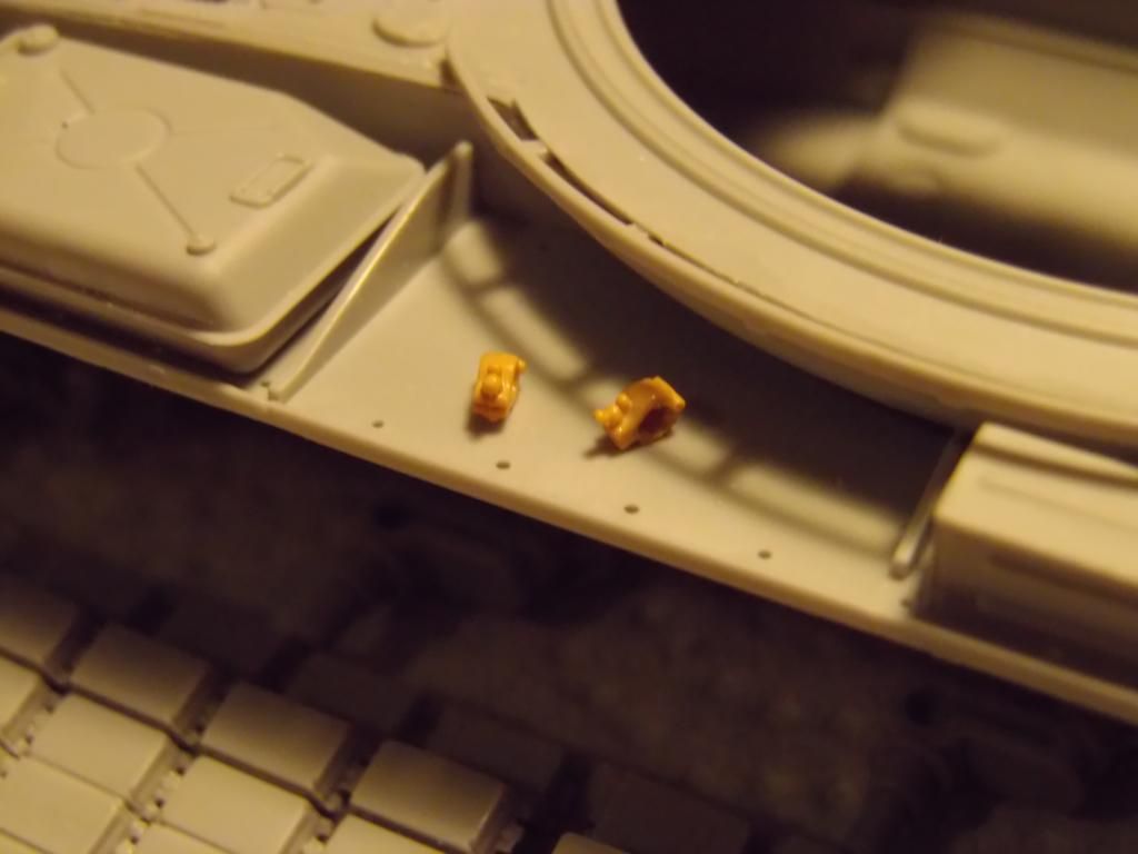

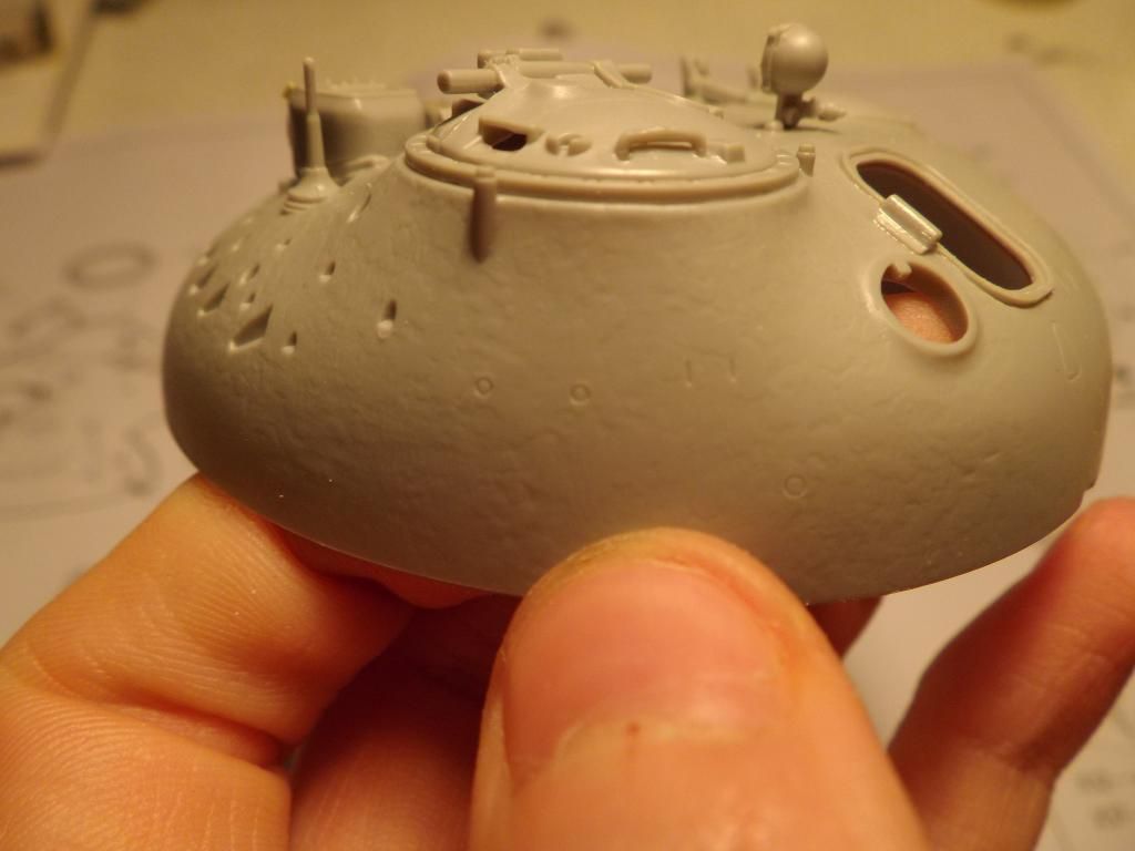

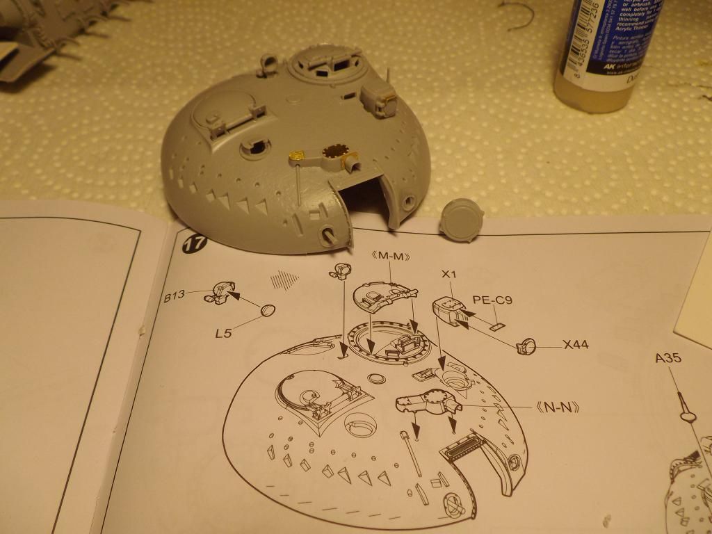

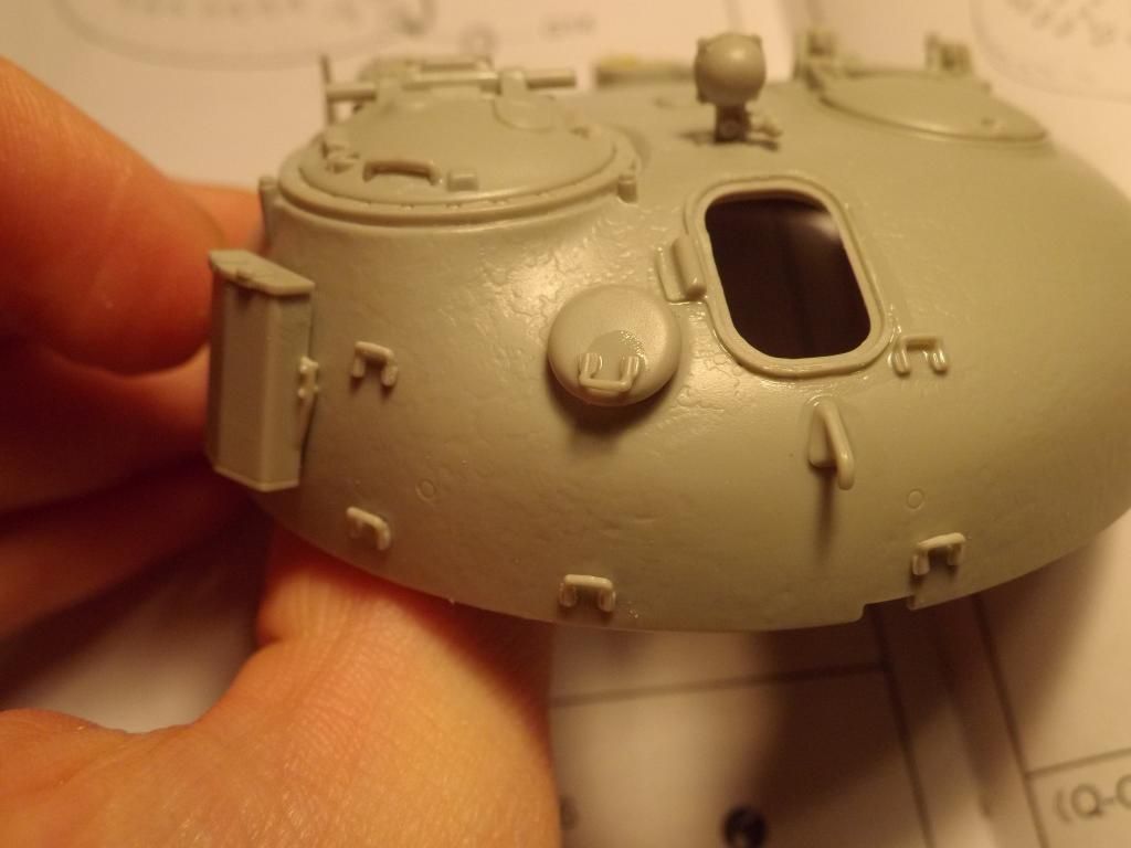

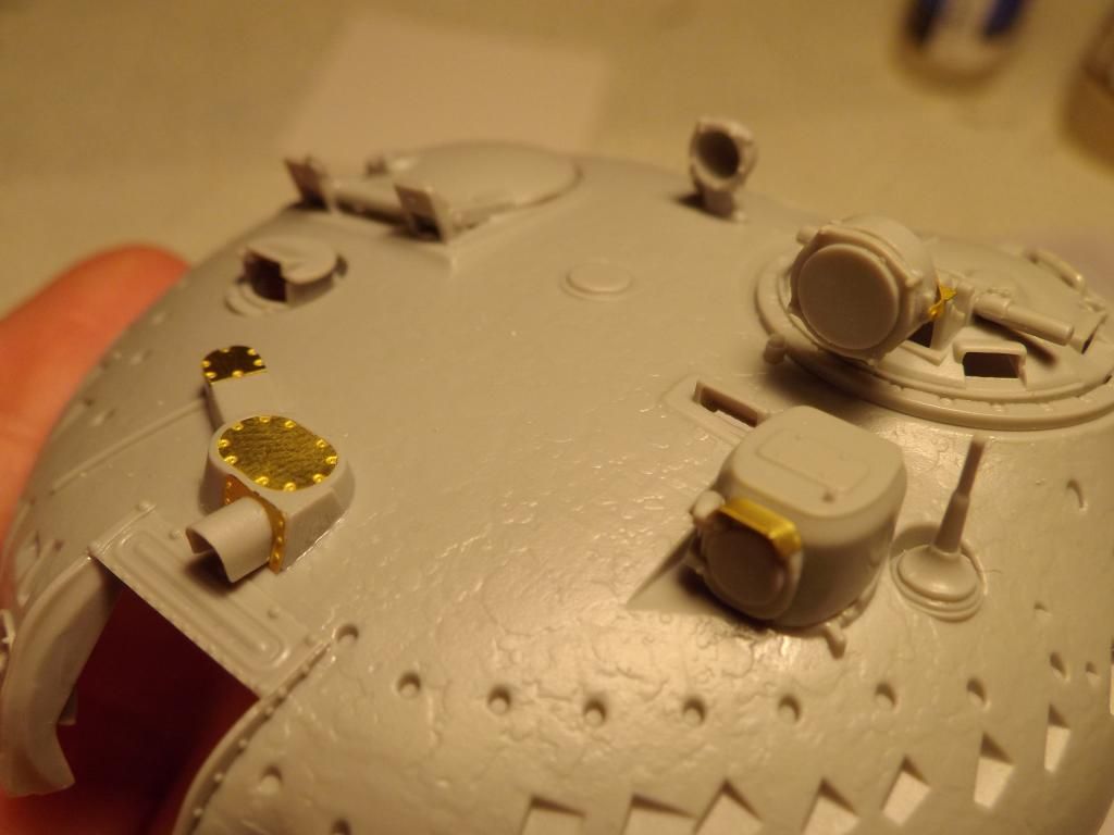

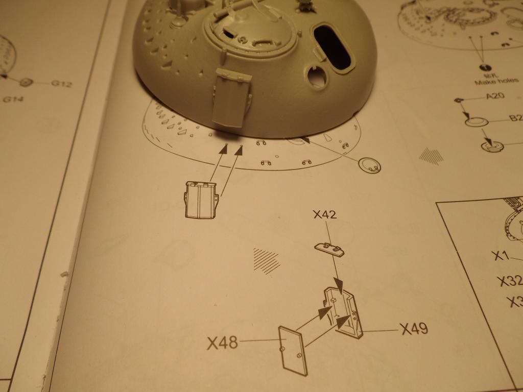

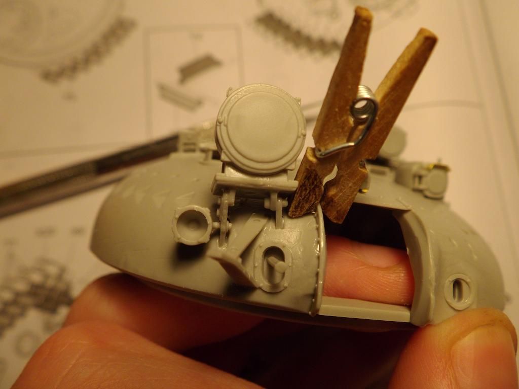

OUPS! Shouldn't there be something in there????
Luckily I have curved tweezers, so I could put the periscopes in like this through the turret hole.
All better!

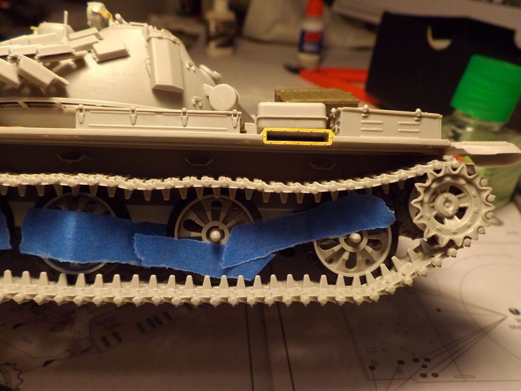

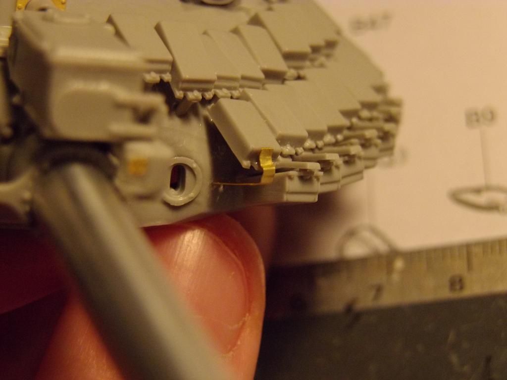

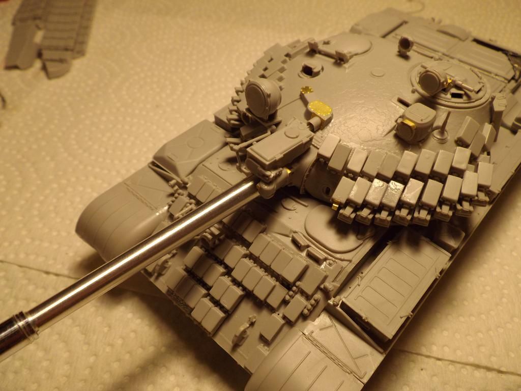

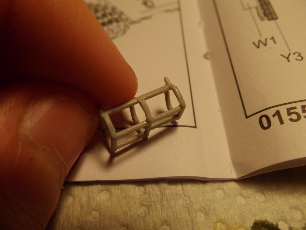

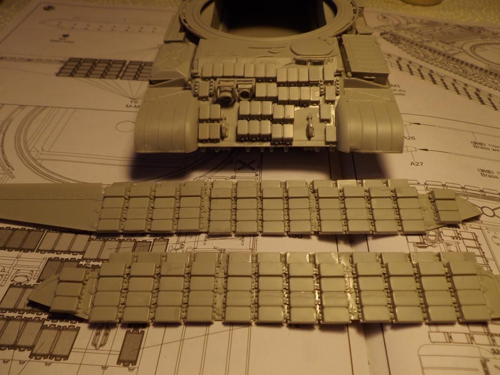

This headlight guard was very warped, but I eventually glued it together after two hours. :crazy:

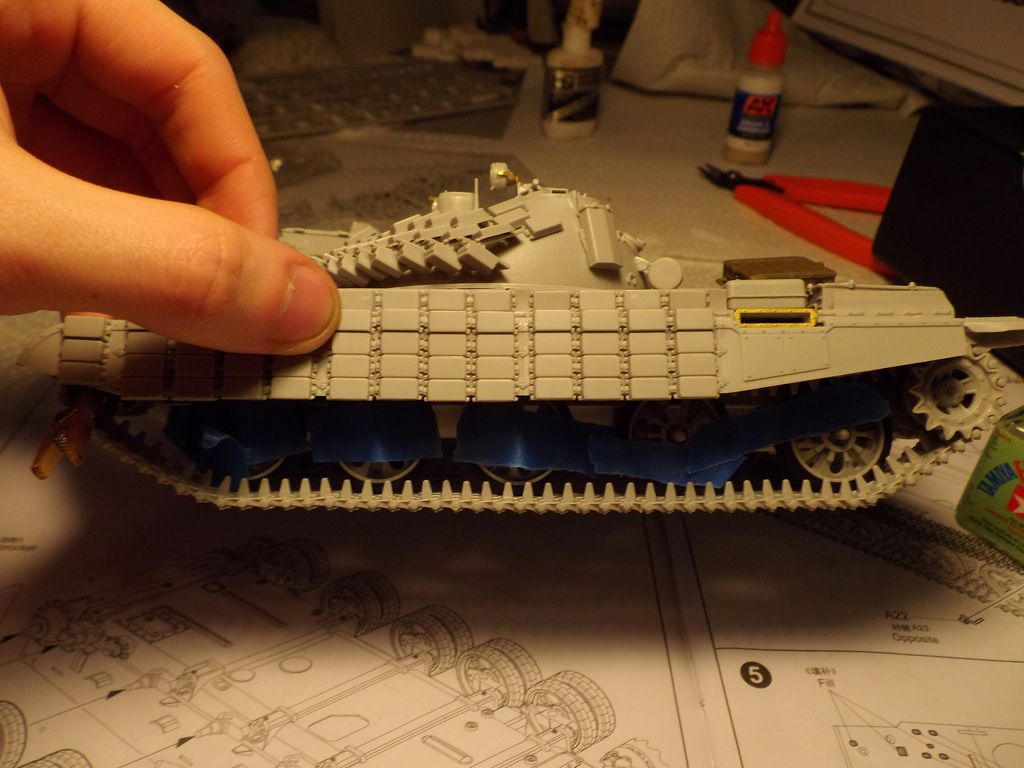

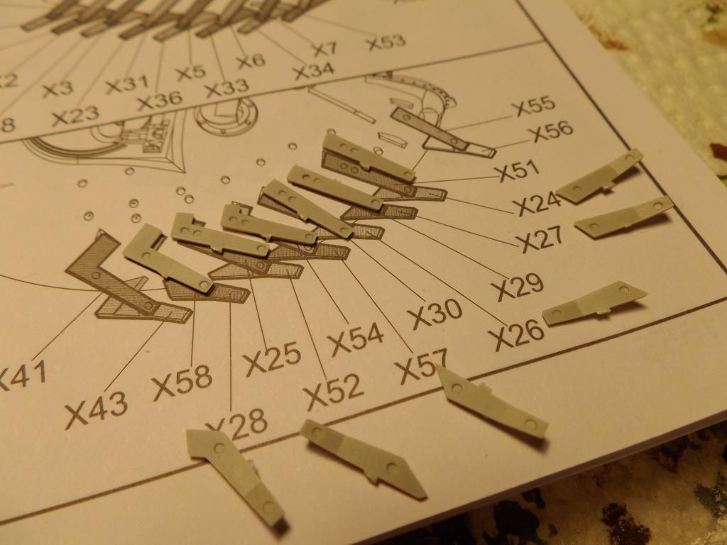

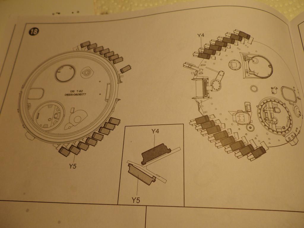

The ERA was actually very easy; most of the blocks were moulded as groups when they could be, with minimal sprue gates given the detail on them!
No time at all! Very well done, Trumpeter :thumb2:

http://s1381.photobucket.com/user/Panze ... 9.jpg.html
Where did you get the LEAD foil from ???
I am looking for various thickness and length ....
thinking of going to a LURE store and search through their Fly fishing accessories...
Panzermeister36
Posts: 692
Re: Trumpeter T-62 ERA mod.1962 - Free Syrian Army
Post by Panzermeister36 »
PaulAyrey wrote:Nice kit, some lovely details such as the cast effect on the turret. Great job so far!
Thanks Paul! It's a superb kit so far :thumb2:
gustavlekstal wrote:Fast and furious! You must have a lot of ikea at home :tongue: :th: looks great!
The build is flyin' since it's so nice and enjoyable to build. I live in Ottawa where there's the largest Ikea in North America I believe - that thing is bigger than an adjacent shopping mall!
schweinhund227 wrote:http://s1381.photobucket.com/user/Panze ... 9.jpg.html
I got this from a buddy...I'll ask him where he got it for ya :cheers2:

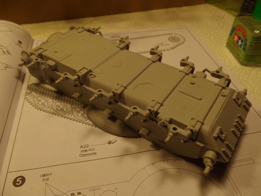

STEP FIFTEEN
This step covered the final additions to complete the hull.

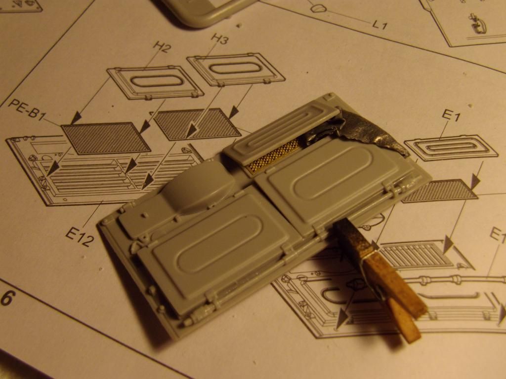

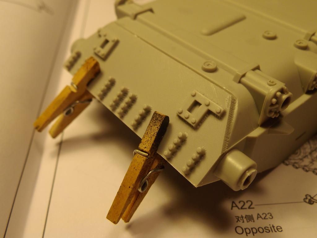

I put on these hooks that the tow cable attaches to at the rear
These are some AM tow cable clamps that were given to me for a T-55 but I'm pretty sure they're accurate. If not, I like it better this way anyways - they're far better detailed :mrgreen:
I didn't want to put on the tow cables because I don't like tow cables; I can never get them to look good. I think I may still drape one over one of the fenders here, though, just because that's more realistic than not having one on. I can only use one because you are given two 'normal' ends for the cables and two ends that are supposed to go here that already have these clamps moulded on, so I'll only be able to use the free ends.

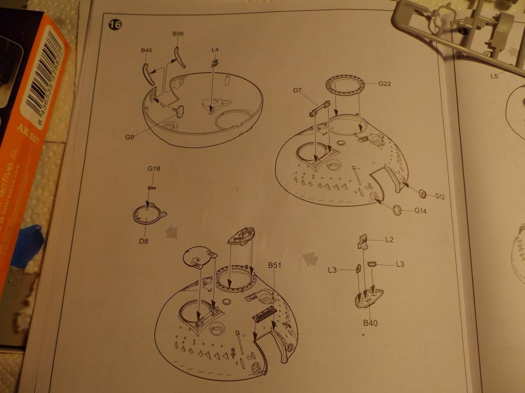

STEP SIXTEEN

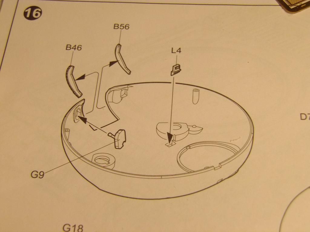

This step covered the basic assembly of the turret.

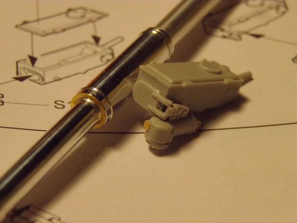

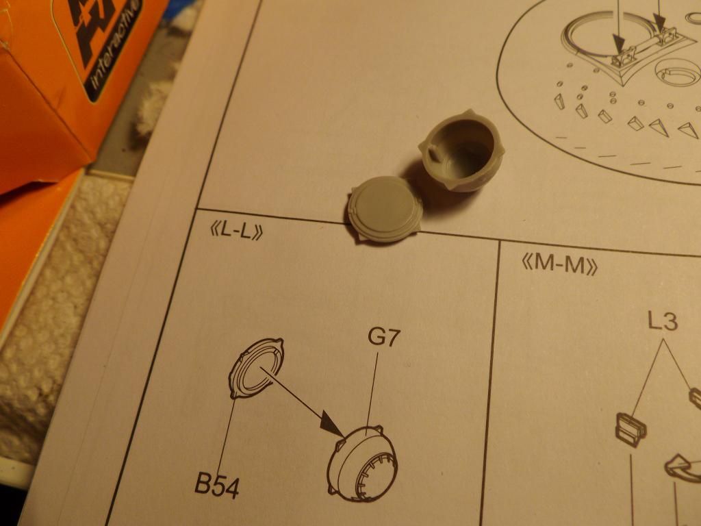

Here's the co-ax MG...or what Trumpeter tries to pass as one. Is it really all that hard to mould it with a hole for the bullets to come out of? ;)
Mildly disappointingly, there was also no option for a clear cover for the infra-red night sight (this bit spotlighty-looking thing beside the gun); you have to use this solid piece that nicely replicates it when covered.
Well-labeled diagram for a well-detailed assembly. Mentioning to use CA glue with words rather than just a symbol is nice :thumb2:

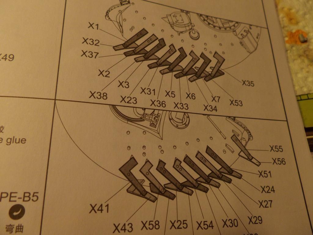

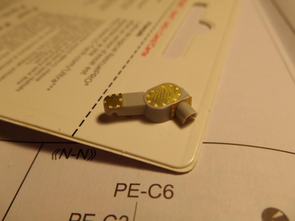

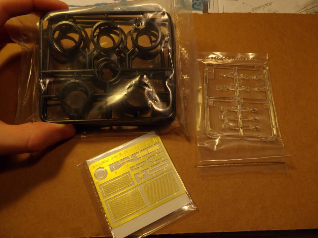

Here's the PE:
Looks nice! I'm going to have to clean off my fingerprints though :whistle:

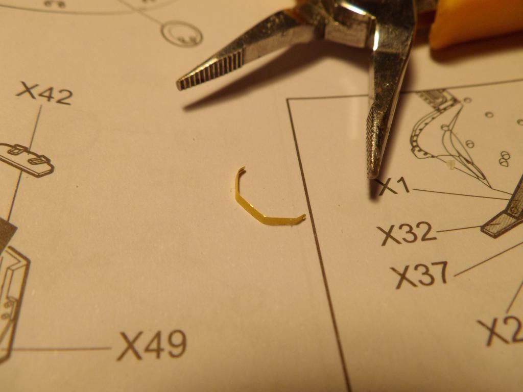

Once again, nice PE...BUT...there's no indication on the PE part as to where to fold it!
So I just kinda guessed (the scientific term would be "B.S.ed") and bent it with these small pliers - gently, as to not mark the soft metal with the texture of the pliers.
Mission 16 accomplished.

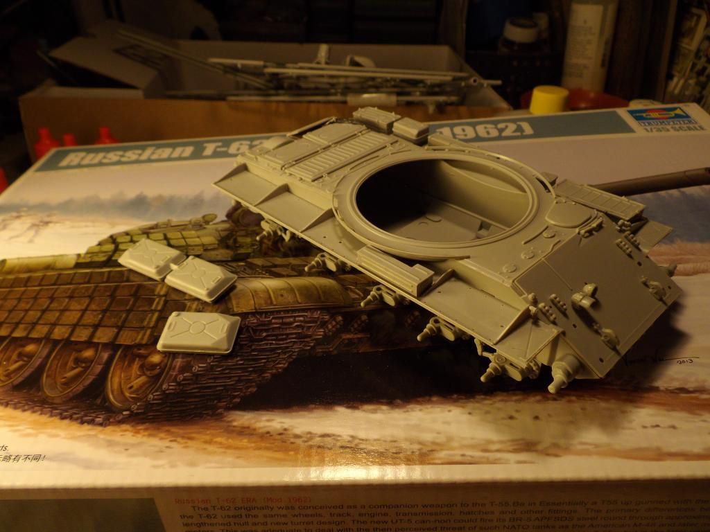

First I put on all the subassemblies that were built in step 16.

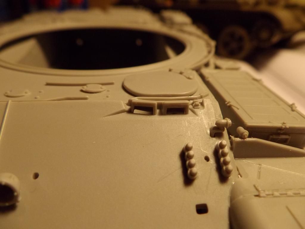

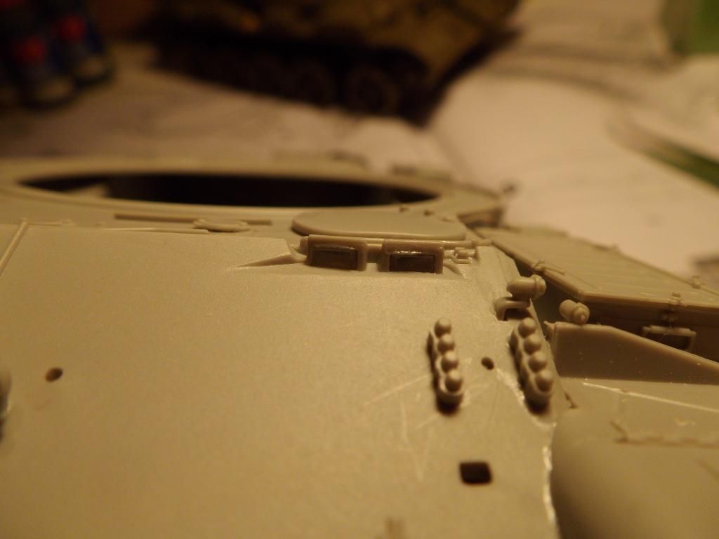

Here holes to be drilled were actually lightly marked into the outside surface. :scratch:: Why the change? No idea.
Even more Ikea for this tank.
These bits were actually nicely done; only one, small moulding point and no flash! :thumb2:
Here they are glued on:
Once again, no marks as to where to fold the PE bit engraved on it.
Once again, just guessed and tweaked till it looked good.
The PE really adds a nice, realistic touch, though. :D
STEP EIGHTEEN
As you can see, between steps 16 and 18, this plate for the bottom turret edge and turret ring magically appears.
So I glued it on here.

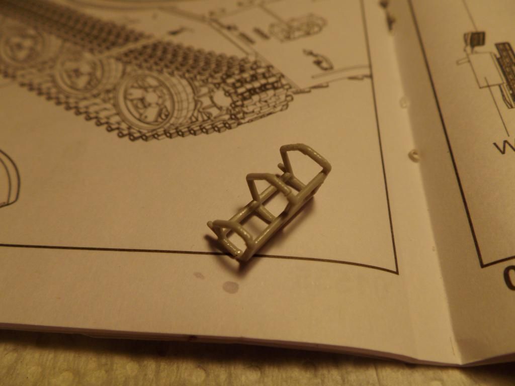

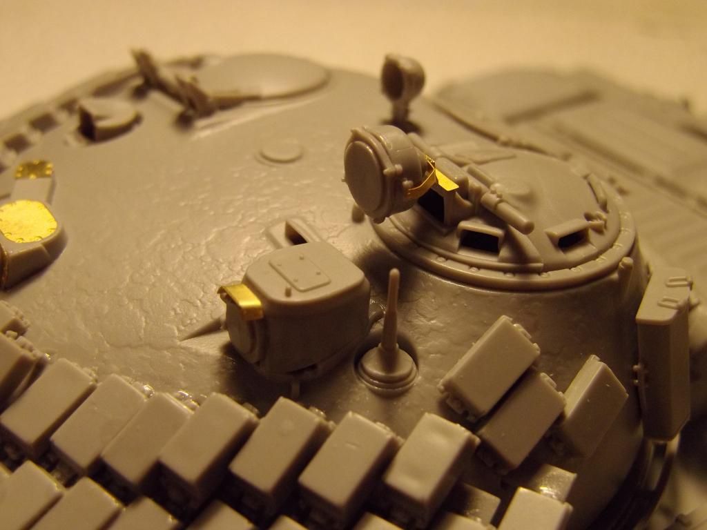

The framework for the IR sight was a bit sketchy and unstraight, to I had to clamp, balance, and wedge it as it dried to get it looking decent.
More PE for the beautiful metal gun and for this box which I believe to be a laser rangefinder or something along those lines.

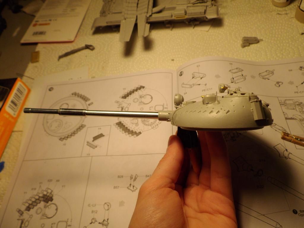

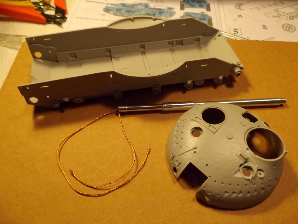

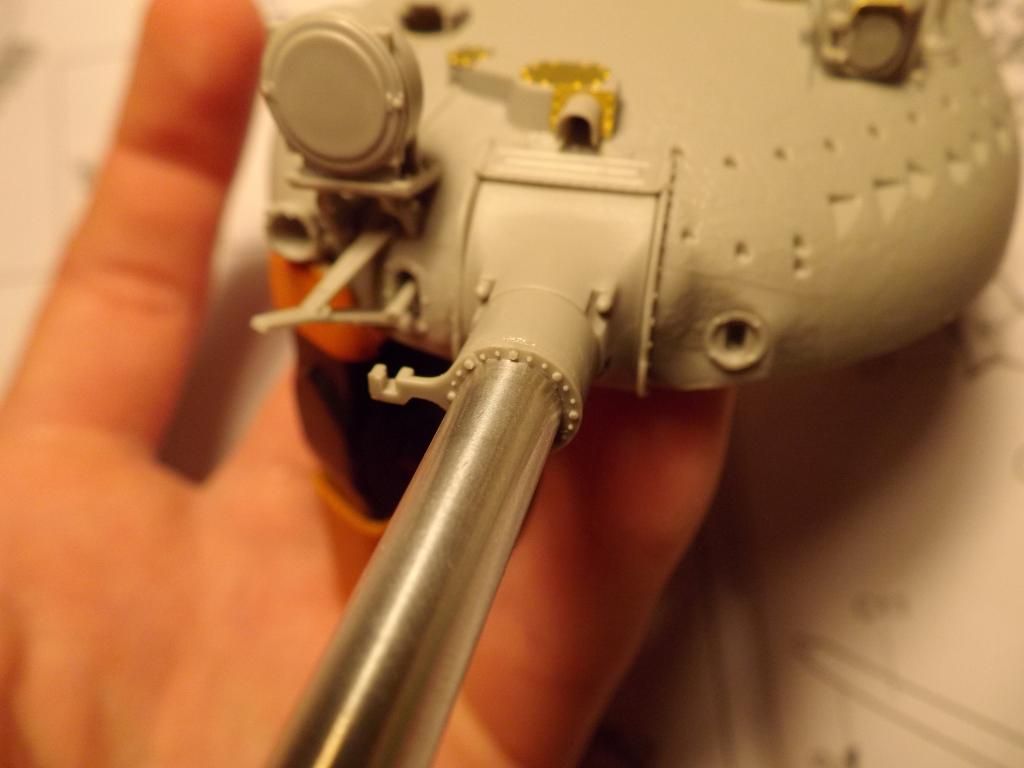

I skipped ahead to a bit of step 19 here to put the gun and stuff on.

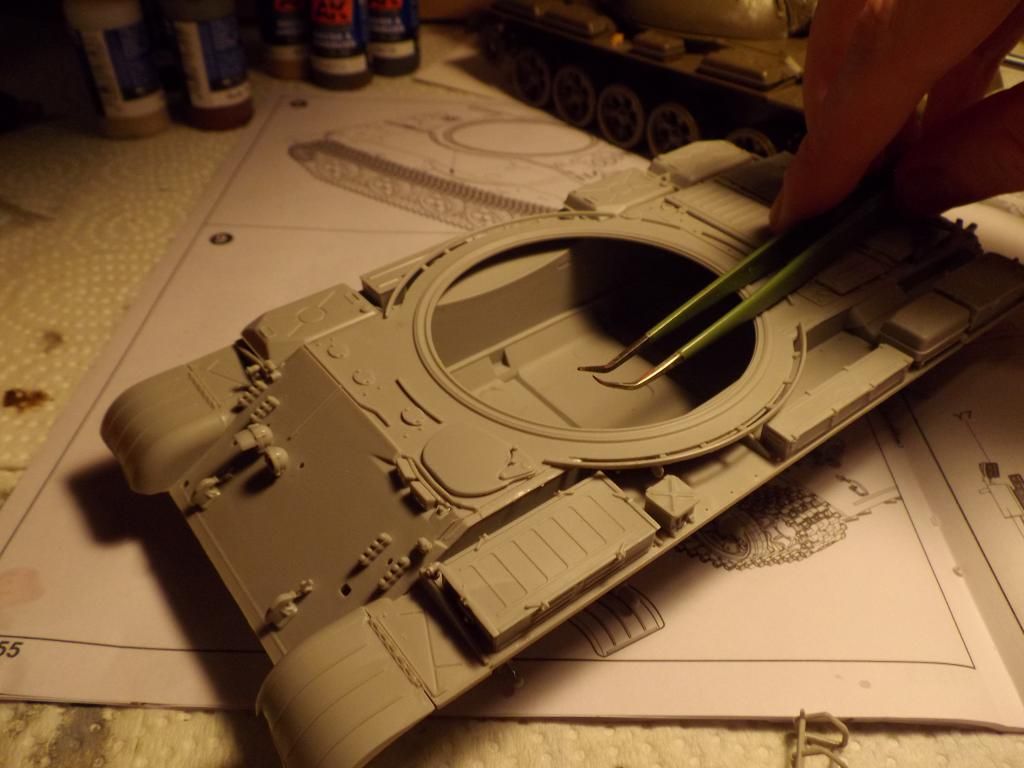

Tight fit for the barrel, I had to scrape it down a tad with a no.11 to get it to slot in.
I also had to scrape down the hull bit of the turret ring to get it to accept the turret. Only two passes of the whole thing with the no.11 and then a quick rub with the 1200 grit Ultimate sander and it was fitting in nicely!
Big gun, low turret, nice!
Right about now was when all hell broke loose.
I do this as to not lose track of the parts and mix them up.
Very fiddly and hard to get these arms lined up, so I did one side at a time.

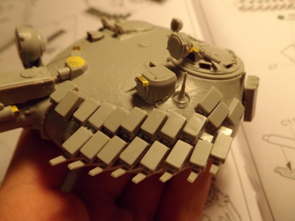

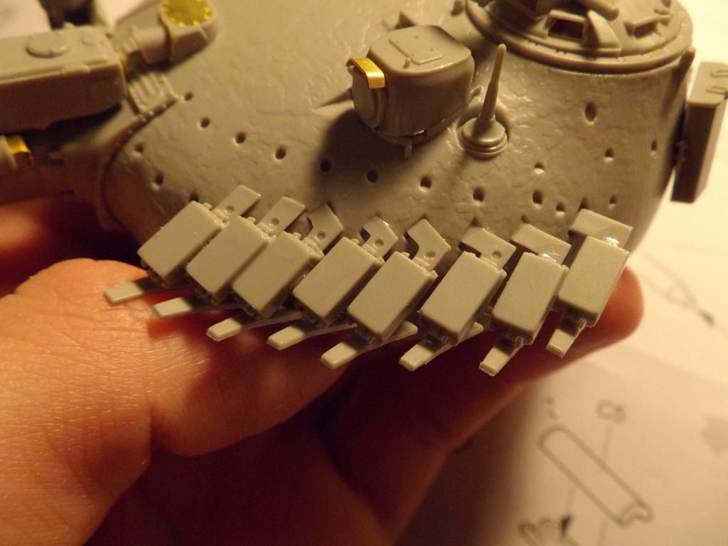

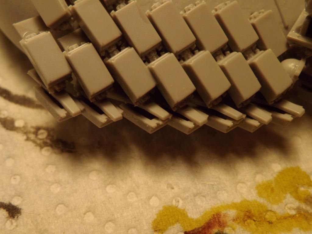

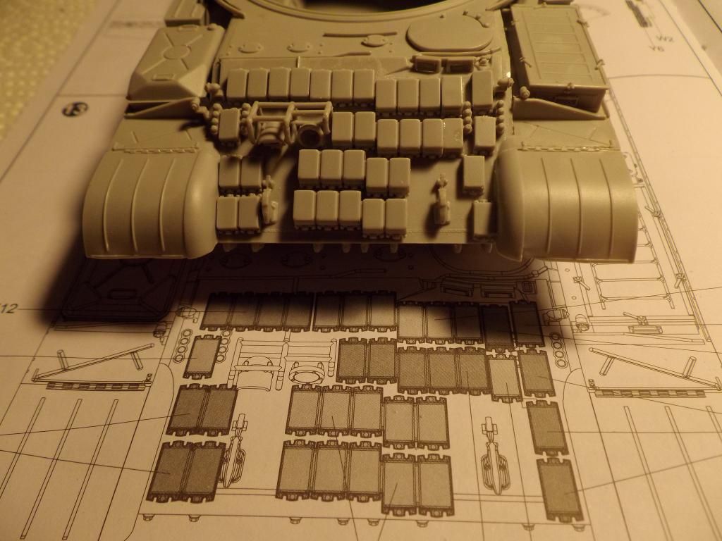

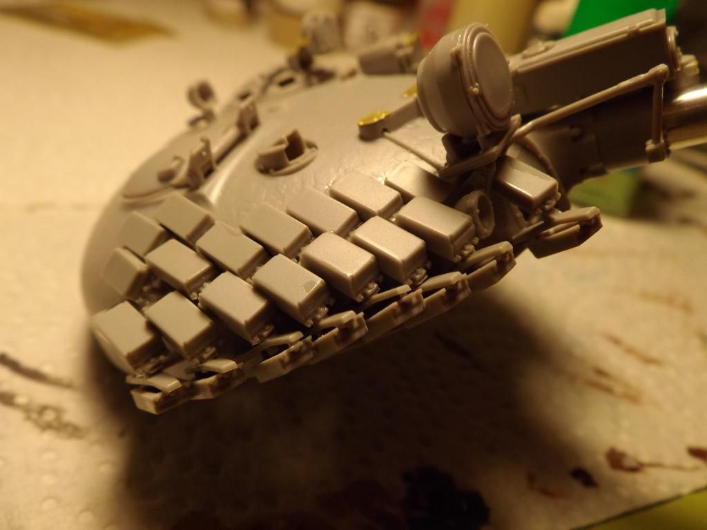

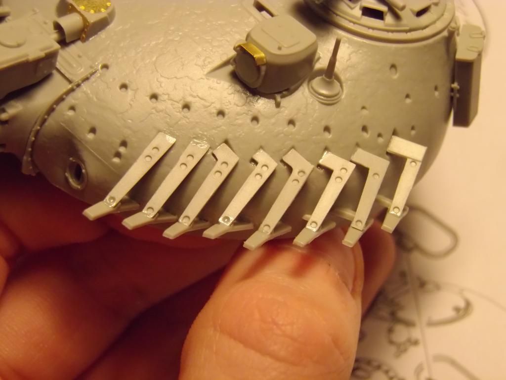

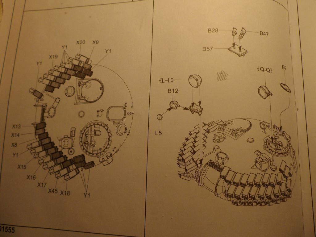

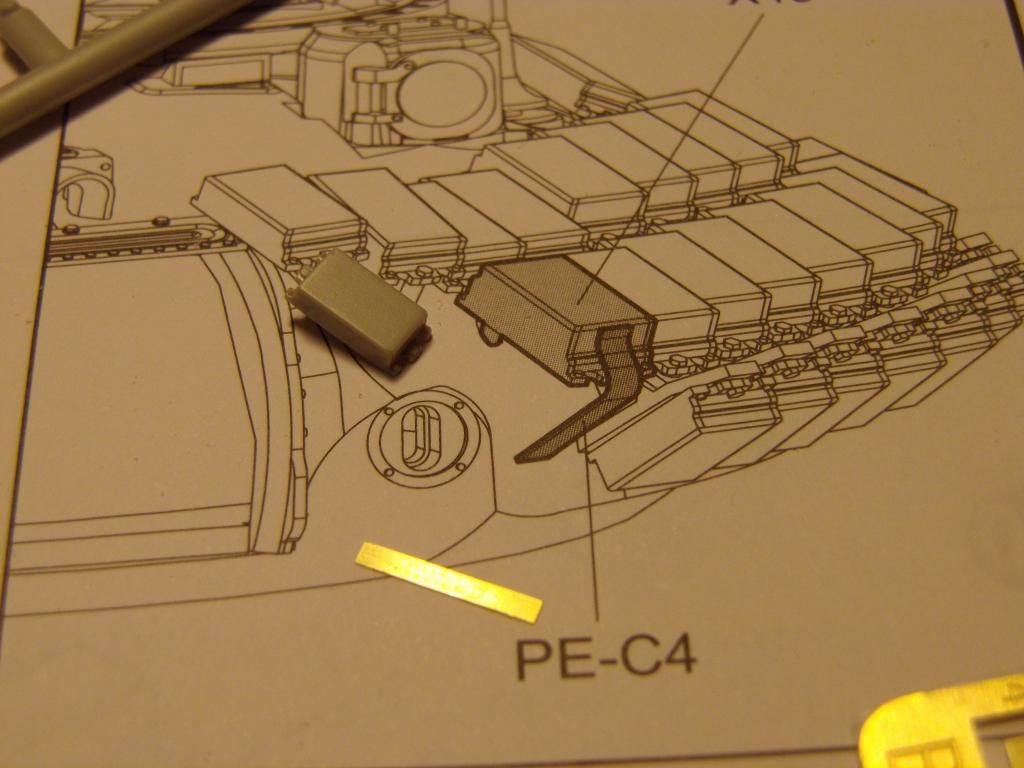

I had all the ERA already cleaned up so that I could put it on before the glue for the arms completely set. This way I could fiddle with their positioning to correct the alignment of the ERA. I focused on getting the best alignment for the ERA blocks on the top of these arms because they are more visible than the blocks on the bottom.
The rest of the top ERA blocks for this side on. I then put the row on the bottom.

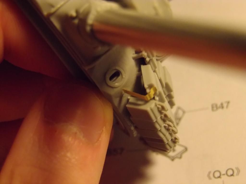

No PE folding marks again. :cry: This is actually part of step 19, but I decided to get it over with now along with the rest of the ERA.
Still, it's not that hard to do it right with the nice instructions provided. Like the rest of the PE bits, I used CA glue to attach it.
You can also see the bottom ERA on this side here as well.
The other side went much faster because I knew what I was doing. I did it the same way as the driver's side which I already explained above.
However, you can see that the ERA blocks are hollow........ :doh:
STEP NINETEEN

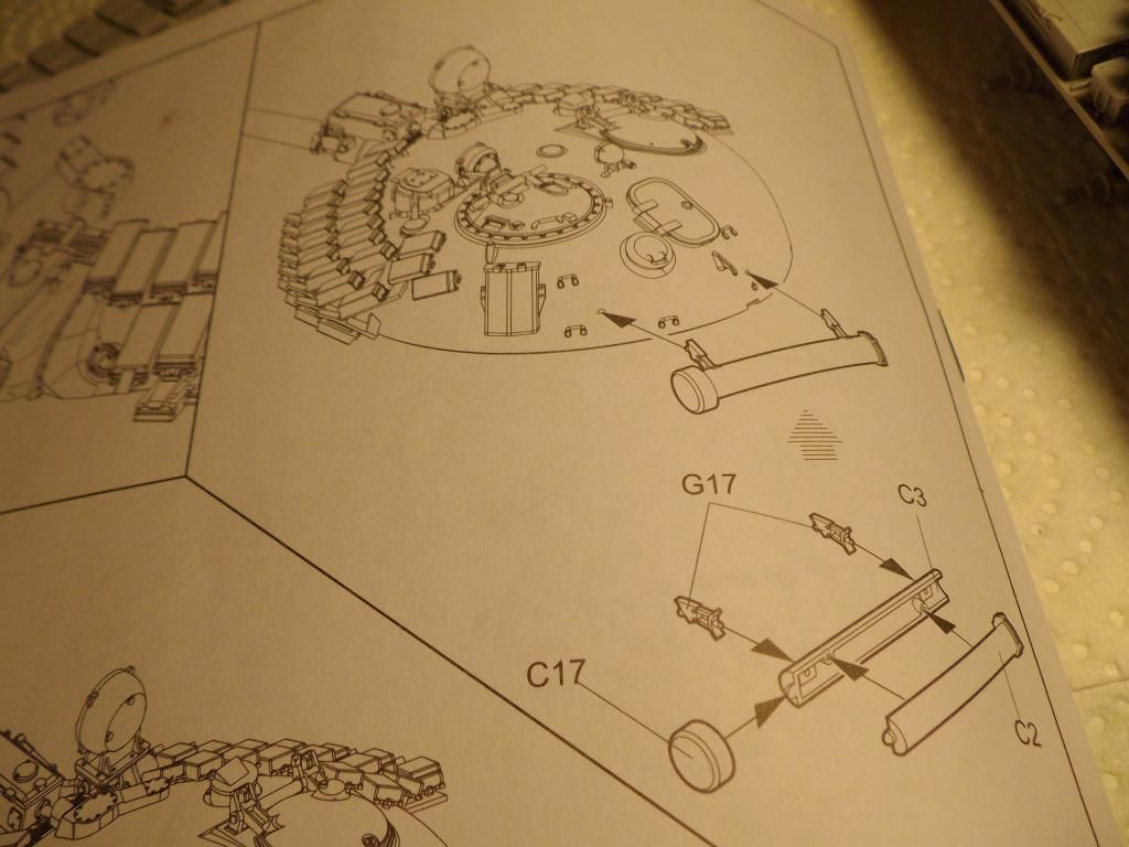

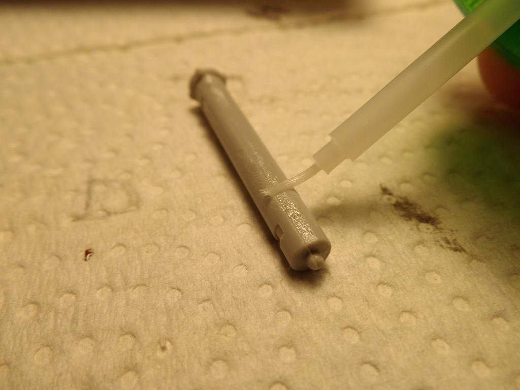

Seems pretty simple, the assembly of the snorkel. I'll go into detail about how I did this because this is similar to a two-piece plastic barrel which is always hard to make look good.
Cleaned up the parts.
Put Tamiya Extra-Thin along the sides here.
Stuck the sides together and put on more Extra-Thin to soften it up.
Now because I put all that glue on, the plastic is pretty flexible, and therefore when I press it together it makes this thin bulge along the seam. No filler required!
Now I run some more glue over the little budge to help smooth it down.
After it had dried I did the same with a no.11 to further flatten the seam.
And final smoothing with the 1200 grit Ultimate sander - very useful in this situation and for gun barrels and wheels! :thumb2:
And here it is on the turret. I hope this helps anyone out who has trouble with two-piece plastic barrels! :D

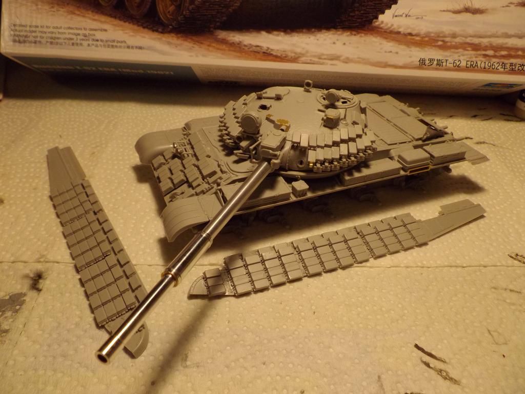

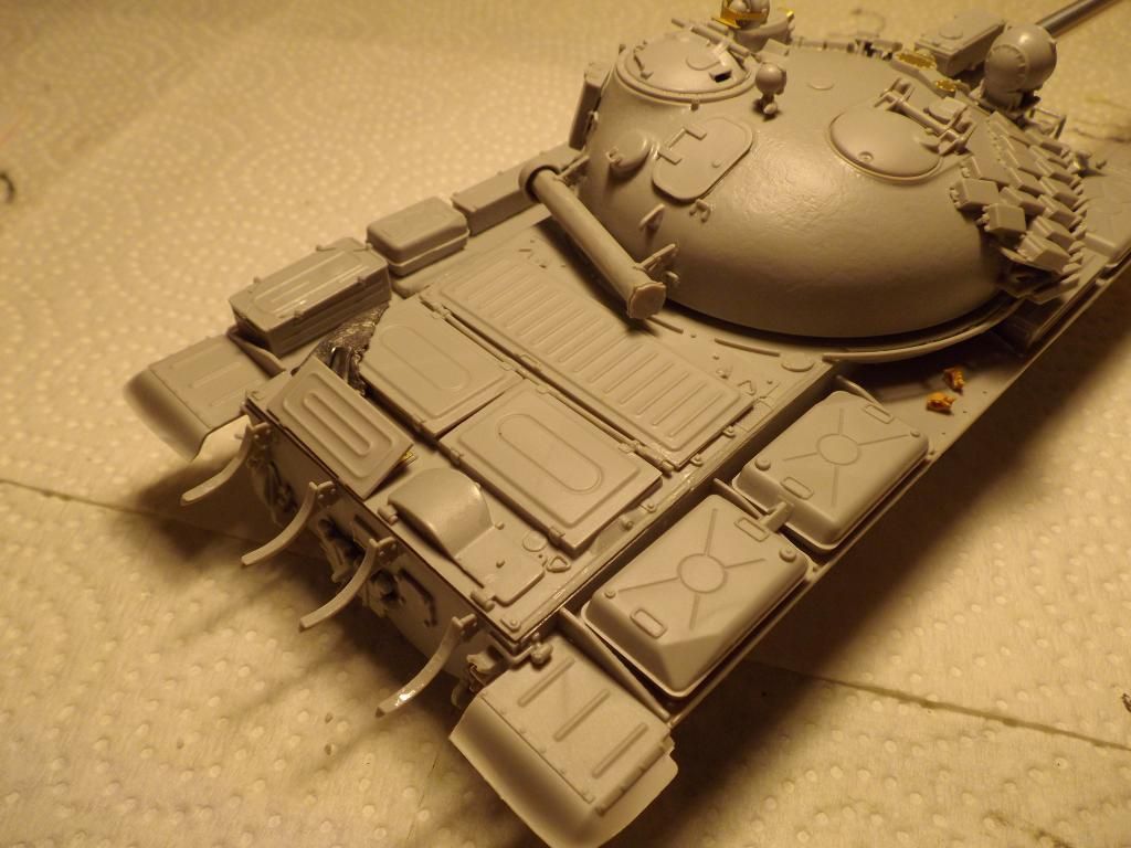

And the turret is done! Here are some photos of how it is looking so far, below. All that's left are the wheels and tracks. :mrgreen:
All the progress in this entire update #4 corresponds to less than 4 hours. That seems quite quick, but I was in a buildy mood and Trumpeter has done a great job with the instructions, with the moulding of the parts (no flash etc.), and with the engineering of the kit. :bow::
The turret ERA was the most irritating bit to get done so far (I have yet to do the tracks - keep that in mind), but it wasn't really frustrating or hard, just a bit fiddly. I decided to get it all over with so I did all the turret ERA in about 1 hour and 45 mins :crazy: :thumb2: The hull ERA was no problem at all - very easy.
And just in case you can't tell, I'm loving the build so much!

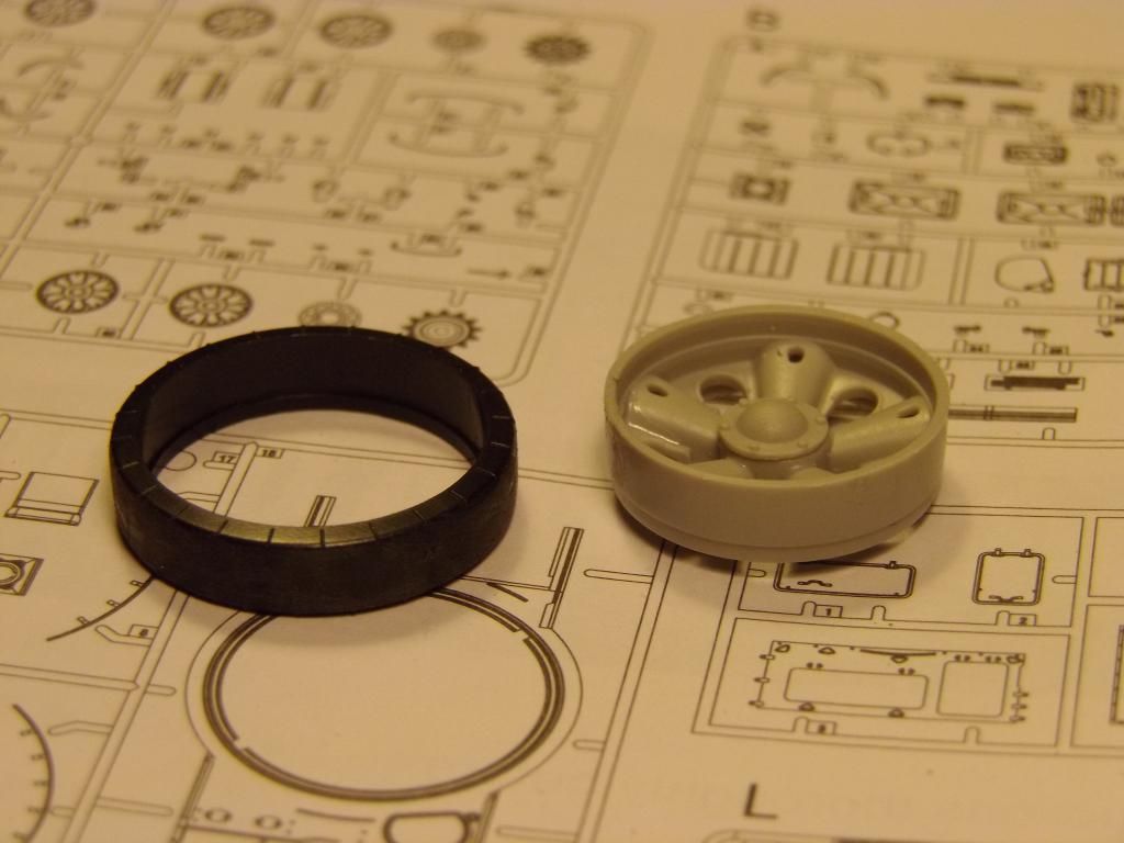

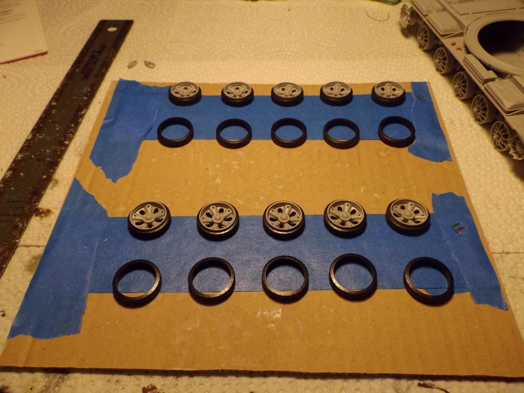

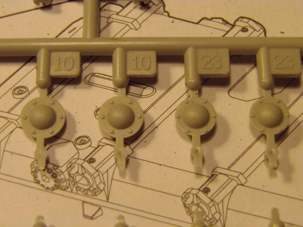

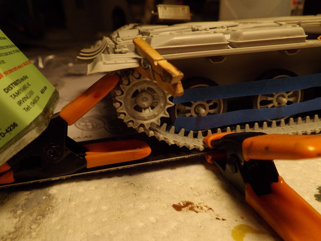

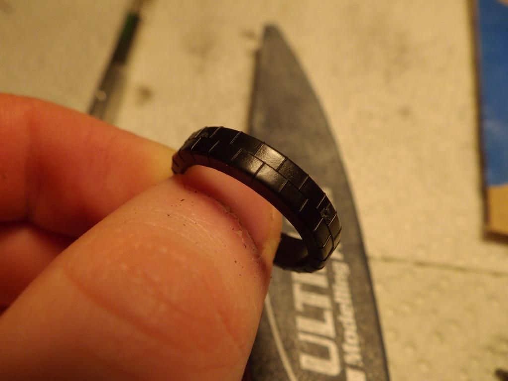

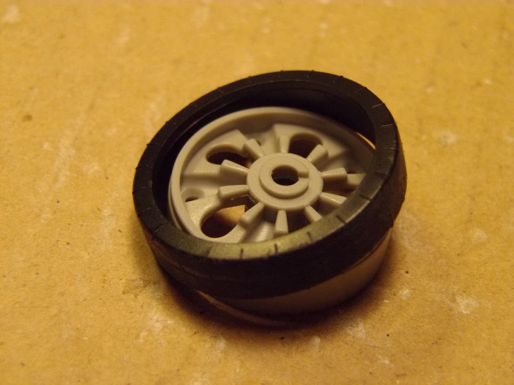

So I finally went back and did the wheels. I hate wheels. :tongue: Still, Trumpeter's way of designing them is very good!
The two on the left are the 1st and 5th wheels on the sides; they are apparently different.
The difference is that this bit here that goes on the end of the wheels is slightly wider on the 1st and 5th wheels (10 is bigger than 23). I never knew this before, but it was well shown in the instructions so I didn't miss it!
Awesome ribbing on the wheels!
So I sanded most of it off to simulate wear. I'll explain how I did this later :thumb2:
You can also see here how there's a lip on the inside of the tire...
And a corresponding slot around the wheel.
This way, the tire has to be installed from behind the wheel.
This is great, because I can glue on the innermost set of wheels to do the tracks, but I can remove their tires for painting!
Here's one side done. The outermost layer of wheels will be left off for easier painting and easier track removal when painting the hull. I can still get to the innermost wheels with the airbrush no problem, and I'll leave the side skirts off until after I paint them. :D

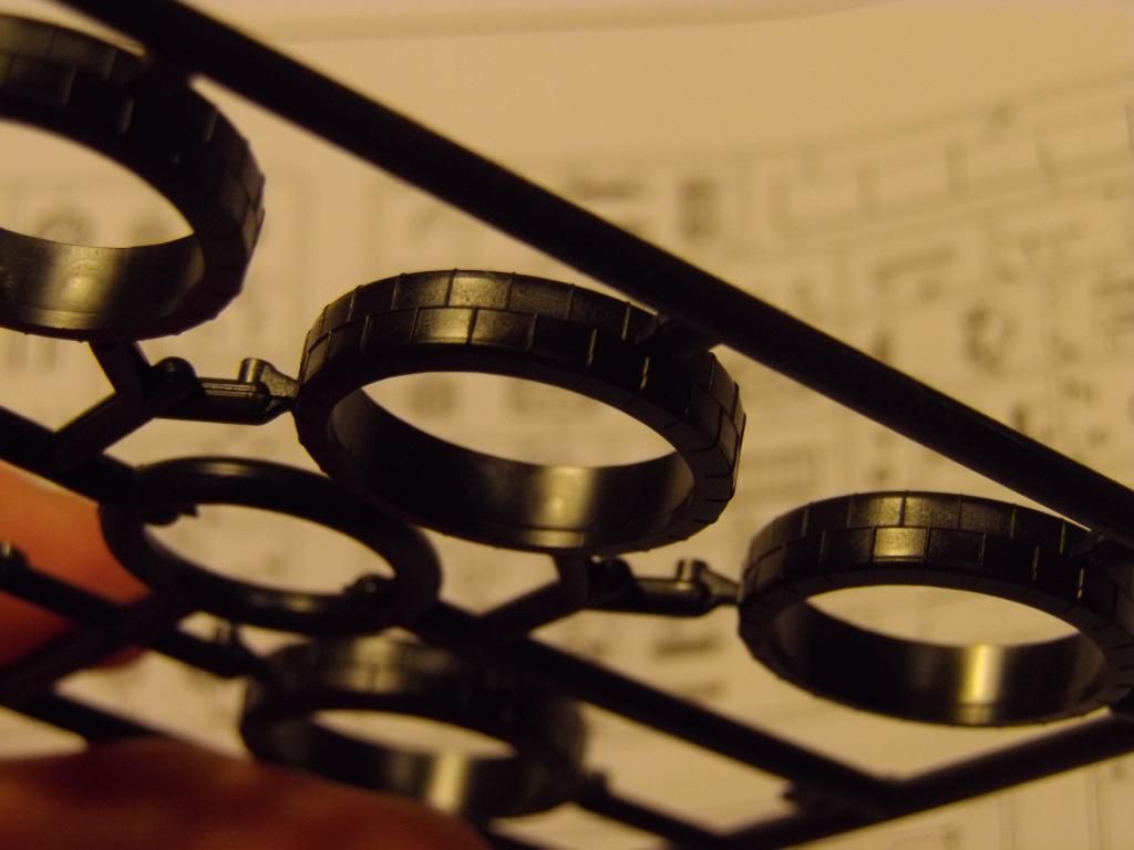

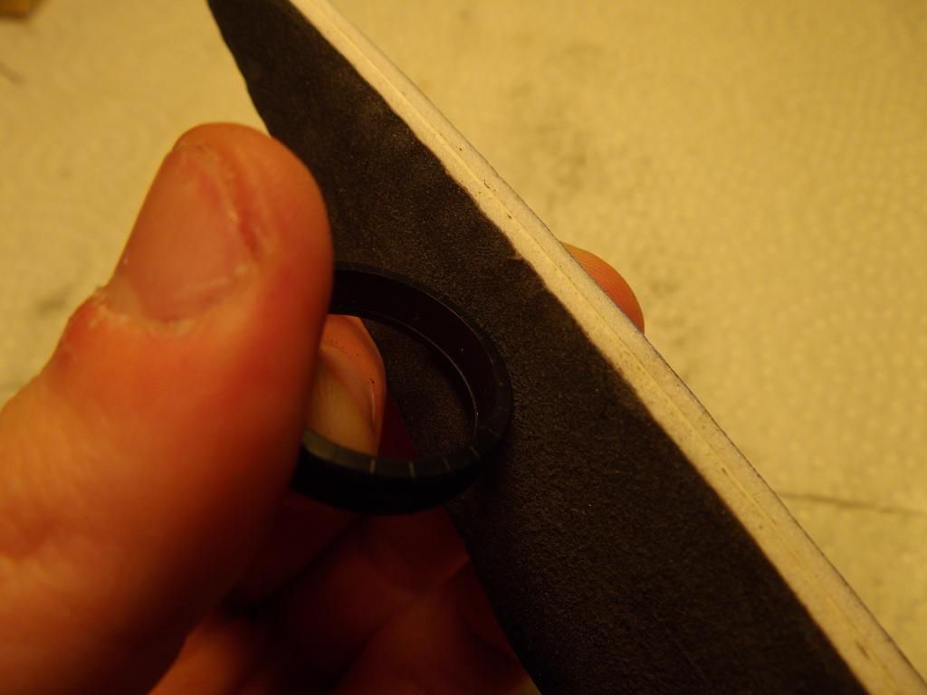

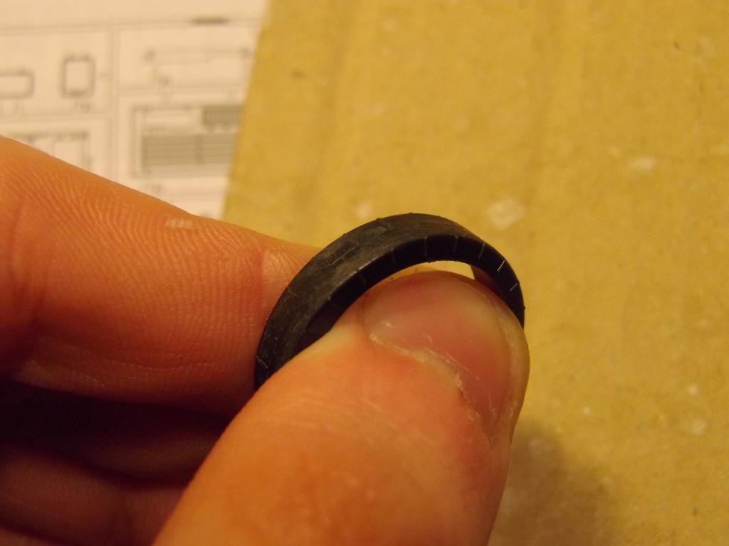

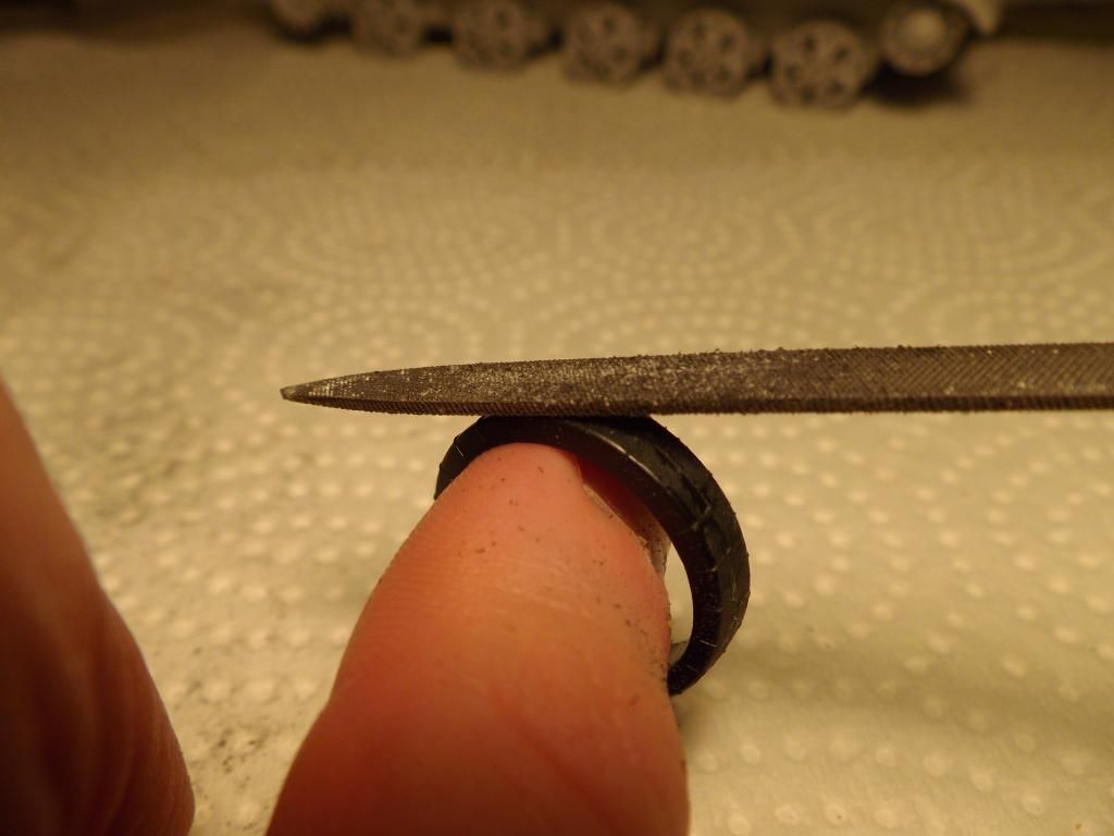

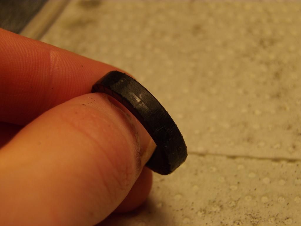

Let's do some tires! I'll explain how I roughed them up here to simulate wear because that ribbing would come off the 'in contact' parts of the wheel very fast.
Fresh from the sprue - very strong ribbing texture marred with sprue attachment points. If you're planning on doing a new vehicle with the ribbing intact, the sprue gates will make that pretty hard.
First I used a file to sand off the attachment points and most of the ribbing.
But as you can see, some ribbing still remains.
So I went over it again, this time with the 240 or 220 grit side on this Ultimate sander.
This roughs it up somewhat and also smooths out the remaining ribbing texture. There's still a bit of the ribbing showing through, but that's okay and I like it; it adds some interesting texture.
All done; you can see the inner wheels glue onto the hull in the right.

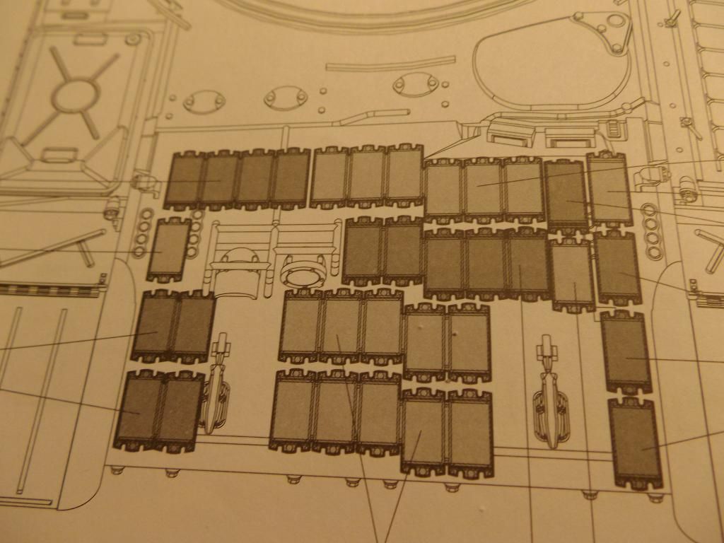

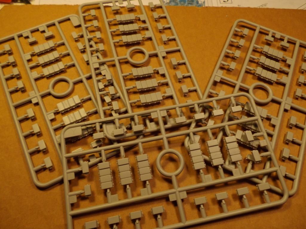

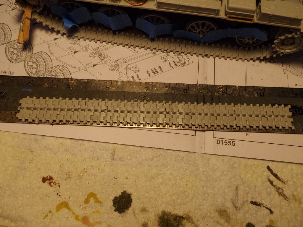

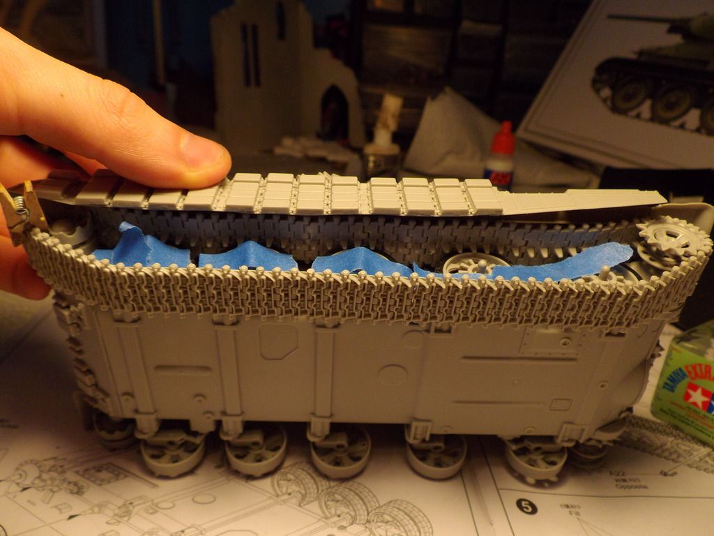

Next up, the tracks! Seven sprues in total, and I've already done five so it shouldn't be that long until I finish this build off; it's been a good one! I've also been requested to do a video on putting the tracks together on my YouTube channel so I'll put that video in my next update :D

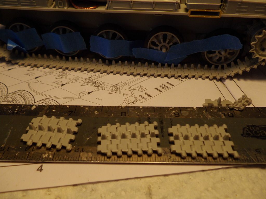

Thanks Norm! :cheers2: Would you happen to know how many tracks go on each side? The instructions don't specify but I counted each and every one on the diagram and they show 97 per side. :crazy:
Unleash the DShK!
WIPs
HobbyBoss T-40
Meng T-90
Orochi M3A3 Bradley
schweinhund227
Posts: 2627
Location: Ontario,Canada
Post by schweinhund227 »
There is a good picture or drawing in the instructions which gives you a good
Idea of how much track shoe you need.... Sounds about right

~PART SIX~
I put on the tow cable. I looks great and the wire is copper and is easy to cut and bend.
Some turret boxes and an extra fuel tank from Tamiya's T-55A kit add some more detail and interest to the rear deck. I did this because the tank is quite long with the turret at the front, and with the ERA on this kit that causes an imbalance of visual weight towards the front of the tank.

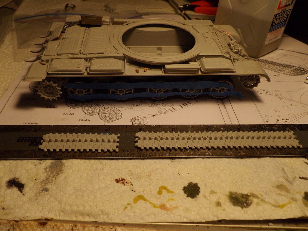

STEPS THREE & FOUR
Ah tracks....seven sprues of them and each track has three sprue gates on it. Well, I did one sprue a day, an hour of cleanup for each sprue, and it wasn't much trouble. You need about 97 per side; I counted them on the diagram which you can see in the top-right of the photo below :crazy: Why couldn't they label a number on the diagram for the number of tracks? Well, I used 91 per side minus about 3 around the idler (we'll get to that later), so I think 94 is the right number.
The actual assembly of the tracks is a breeze. As you can see, I've already done most of one side and the bottom length of the other. The tires were taped on so I can paint them separate.
On a metal ruler, I lay out some of the tracks. The ruler helps me keep the tracks straight and provides a hard and flat surface so that they're attached flat and properly.
After I have about four or five tracks together I glue them with Extra-Thin. Any more tracks and you'll have trouble popping them together without having the length fold/crumple in on itself. Also, I use a metal ruler because a plastic one can get glued to the tracks here :tongue:
Then I glue all the little groups together.
I let the bottom length dry solid and then I did a shorter length for the drive sprocket.
If you let the tracks sit for about 10 minutes then the glue will hold them together but still let them curl around the wheels. Don't glue it too the wheels by accident!
Needed some help keeping in line :shifty:
The front was done the same way.
Top length for the other side.
Draped on and given a hint of sag by just pushing it down with a finger or knife.
I did cheat a little bit here around the idler, but this section is completely invisible (below) and would make removing the tracks much more difficult.
See?
And the other top.
So that's everything done! A great kit to build...but now I've got to paint it; I'm the kind of guy who puts the whole kit - tracks and wheels and tools - on and paints it as a whole, so this is something new for me! :mrgreen:

Take a minute and drill your Tow cables Heads... and insert your Copper cables in them.. it will looks a whole lot better...
The rest of the work is Amazing !!!

schweinhund227 wrote:constructive criticism !
Looking forward to your paint job... The track assembly is very reminiscent of How Storm22tpt used to do it....
Keep up the good work buddy !
They actually are drilled out in the kit...but it doesn't look all that great because the holes aren't centered on the back :wtf:
