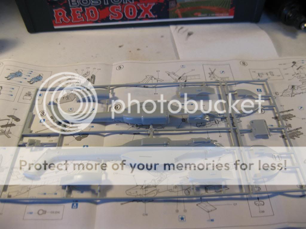

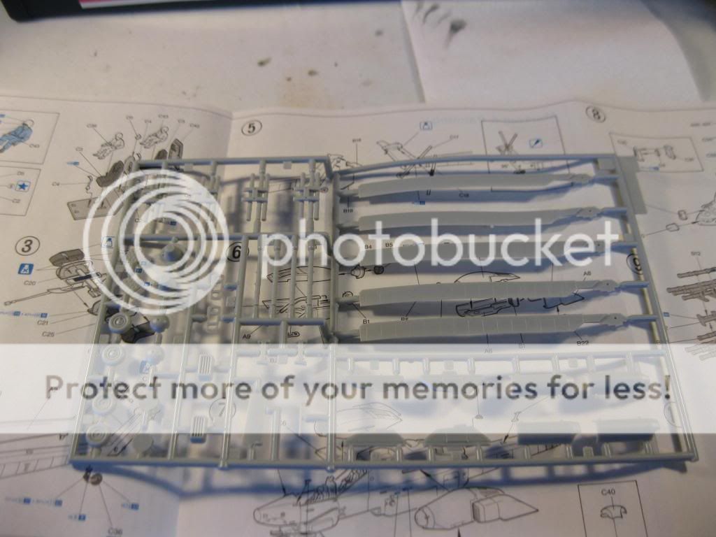

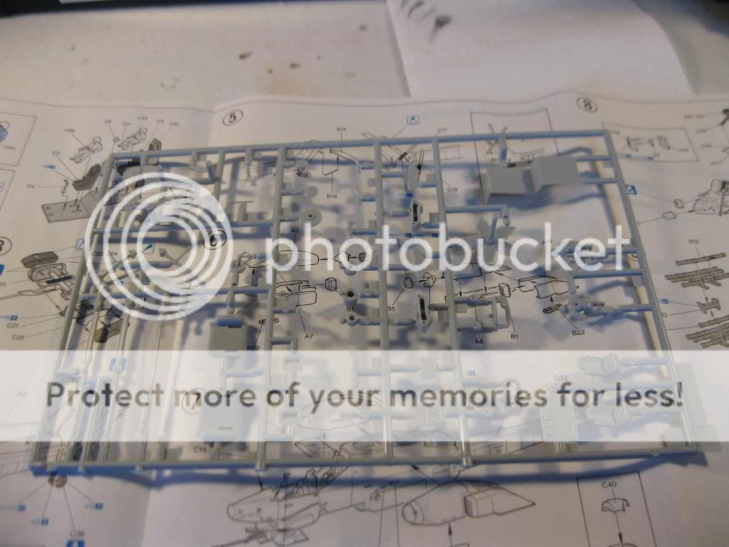

Well. . . Dragon never fails to deliver a complex model kit, even at 1:72 scale

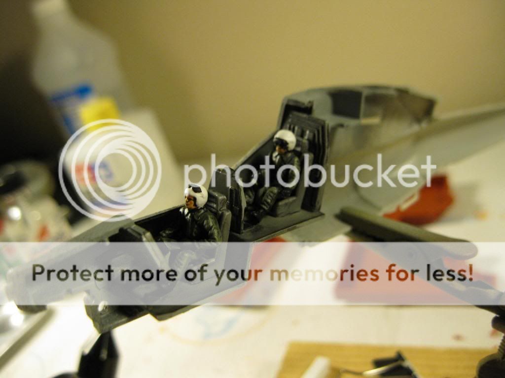

I'm not complaining, I'm glad to be on a styrene quest (of sorts). I tossed and turned last night in bed while debating whether or not to crew my Mi-28. In the end, I decided that I would not only put the crew in the cockpit, but I would also depict my whirley bird in flight. I never seem to lack ambition when model building

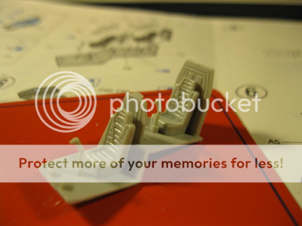

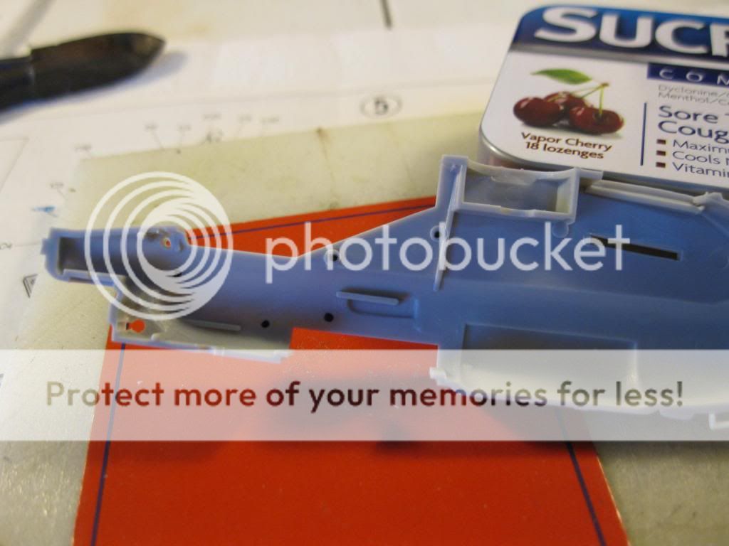

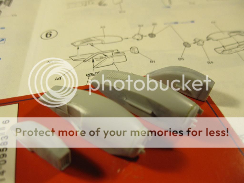

The cockpit at present. I shaved off the raised detail of the instrument panels, as I will be using the decals. I figured that if I shaved the stuff off, I wouldn't have to arm wrestle with setting solution. And, hey, once that canopy comes on, there won't be much to see.

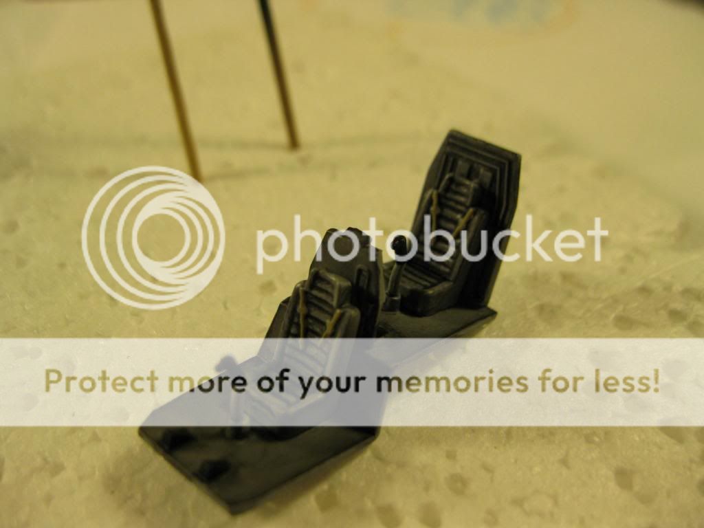

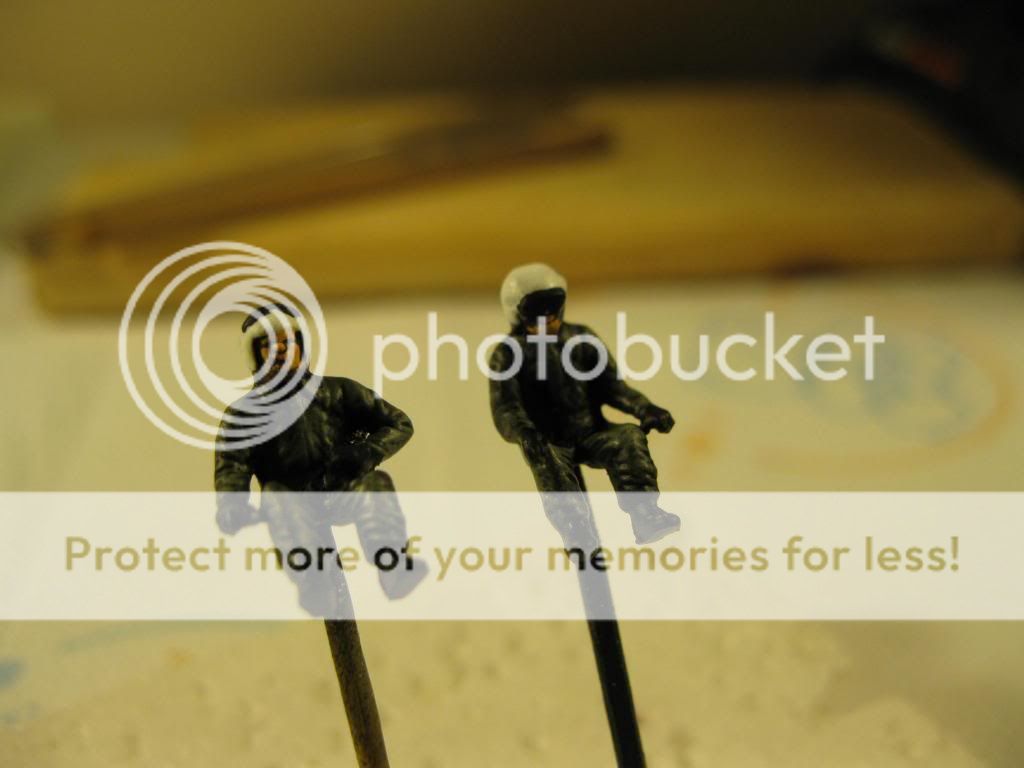

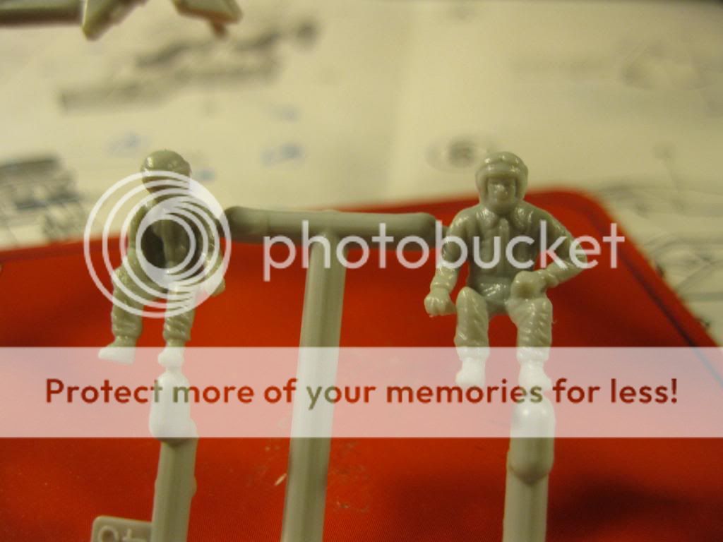

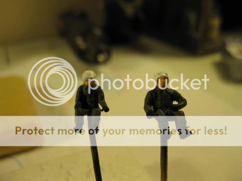

The crew look a little crude. Nothing that a little paint and a wash won't fix. I would really appreciate it if anyone has any pics of a Russian flight suit looks like. Yes, this is a plead for help

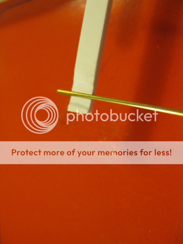

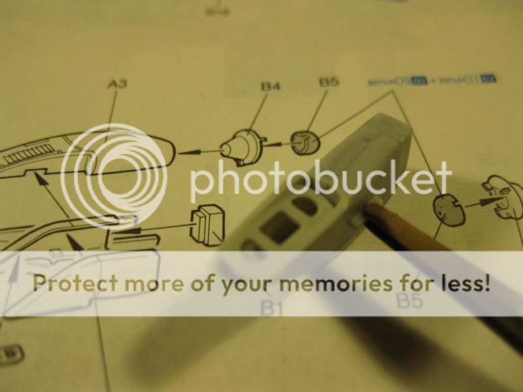

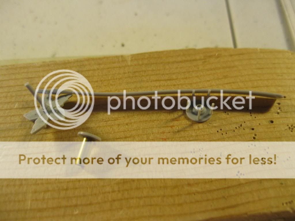

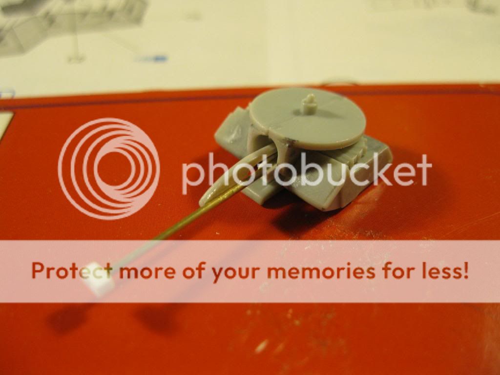

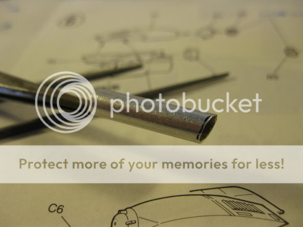

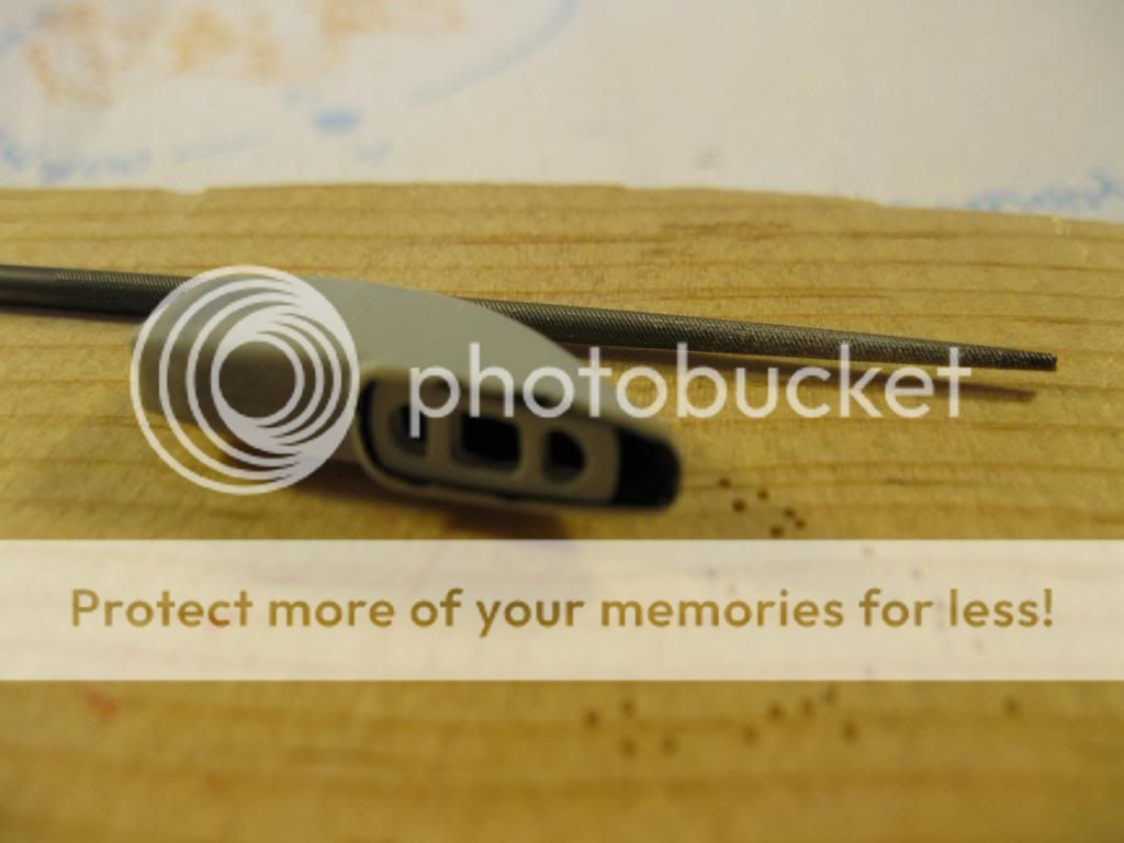

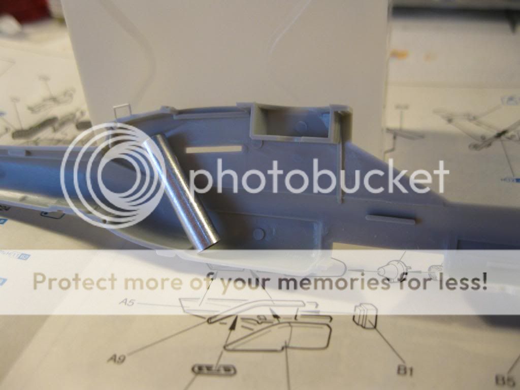

This is the stock barrel for the chin gun. It is really flimsy and bent. I highly doubt it will survive for any length of time after construction and visits to the shows. So. . . let us begin improving the little guy. Below it is brass tubing that will replace it.

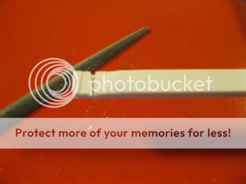

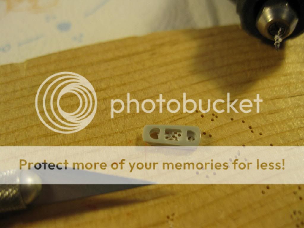

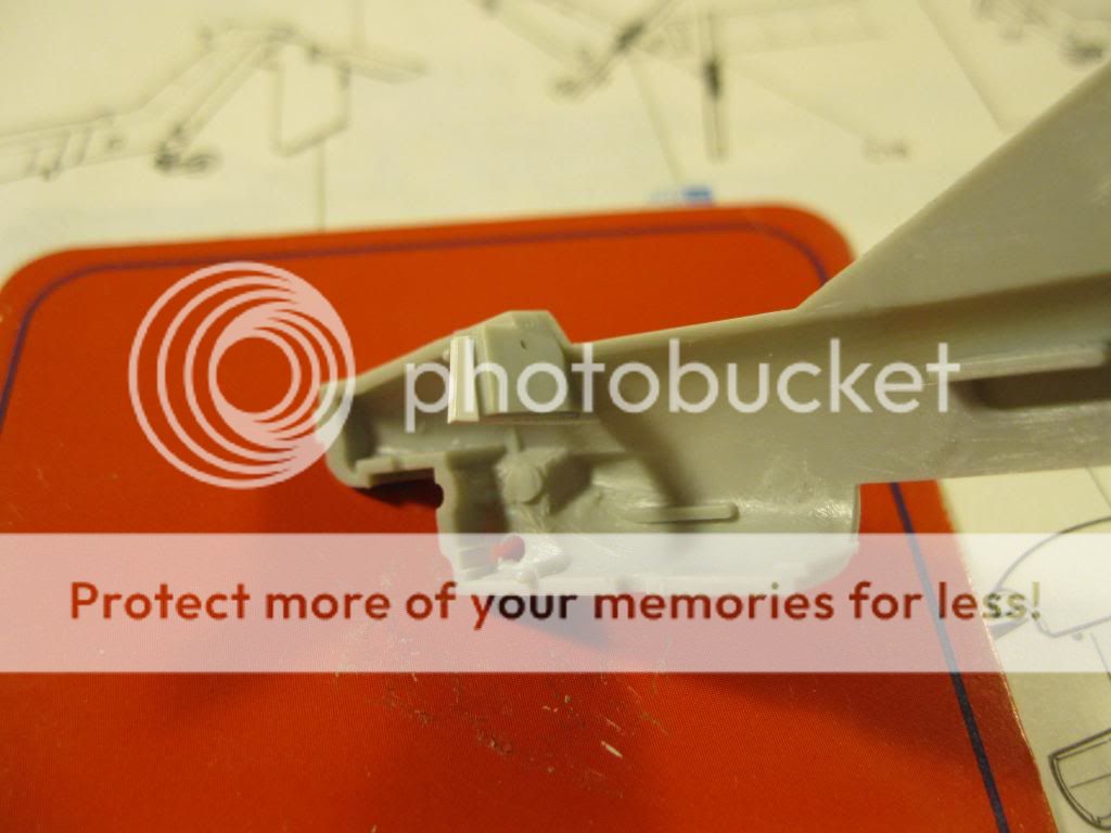

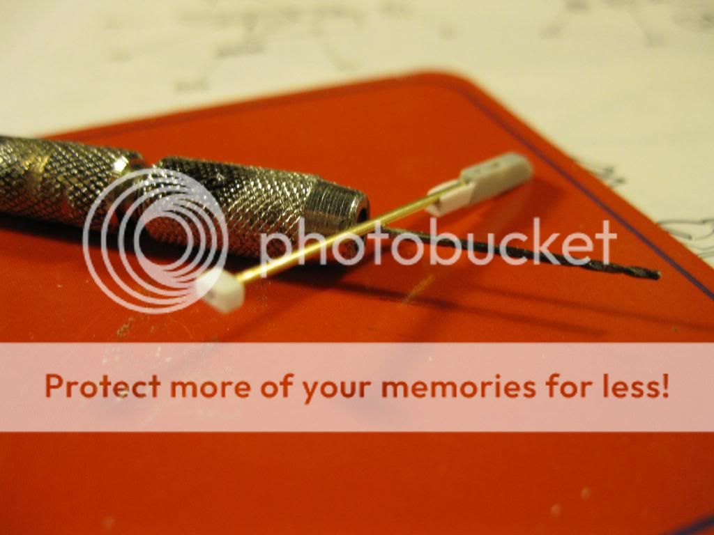

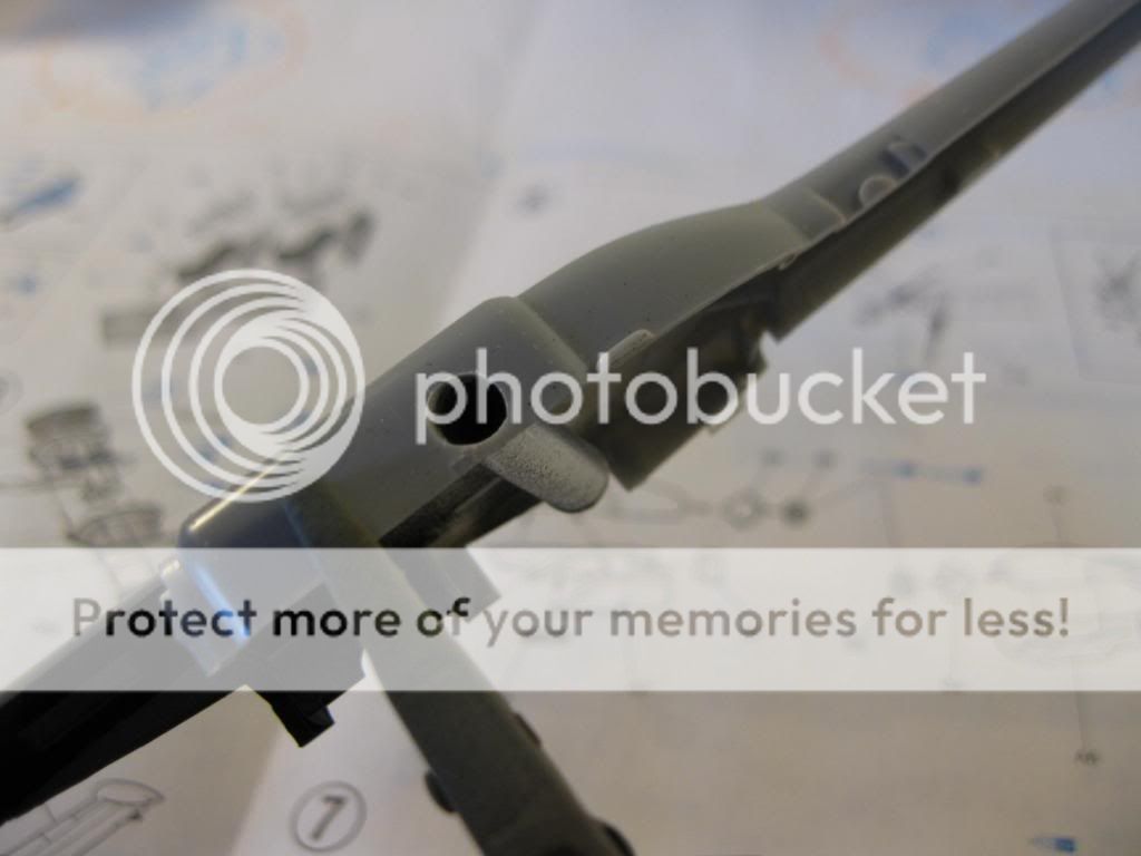

I really wasn't too sure how to go about it. It's not a straight drill hole and insert operation. I wanted to incorporate the saddle below the barrel. To do this I took out some styrene (.080 X.125 I think), drilled a whole, and then filed away almost half the circle.
A nice clean fit.

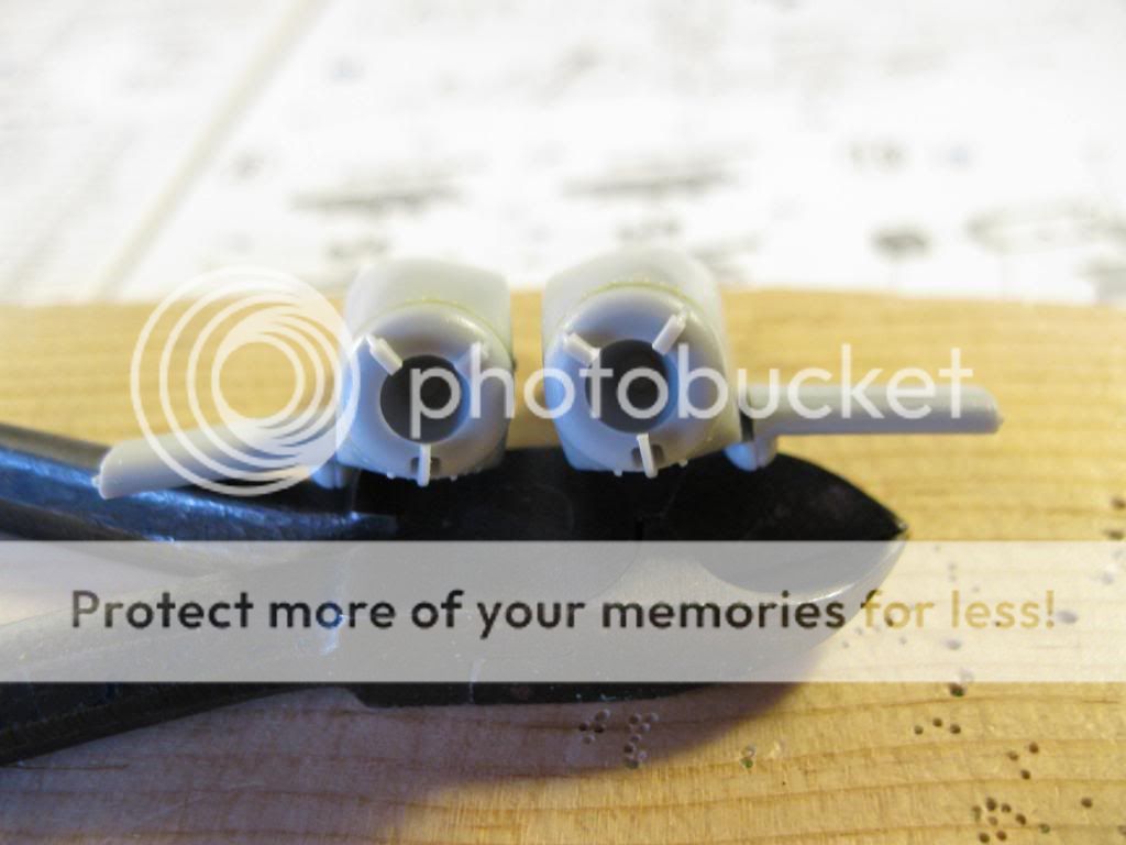

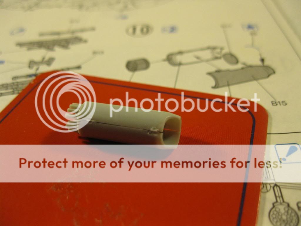

The muzzle break thing was constructed using a similar method as above.

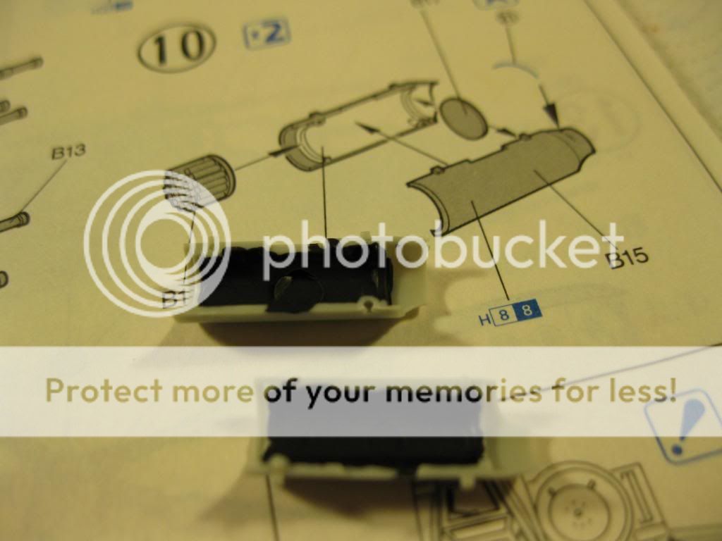

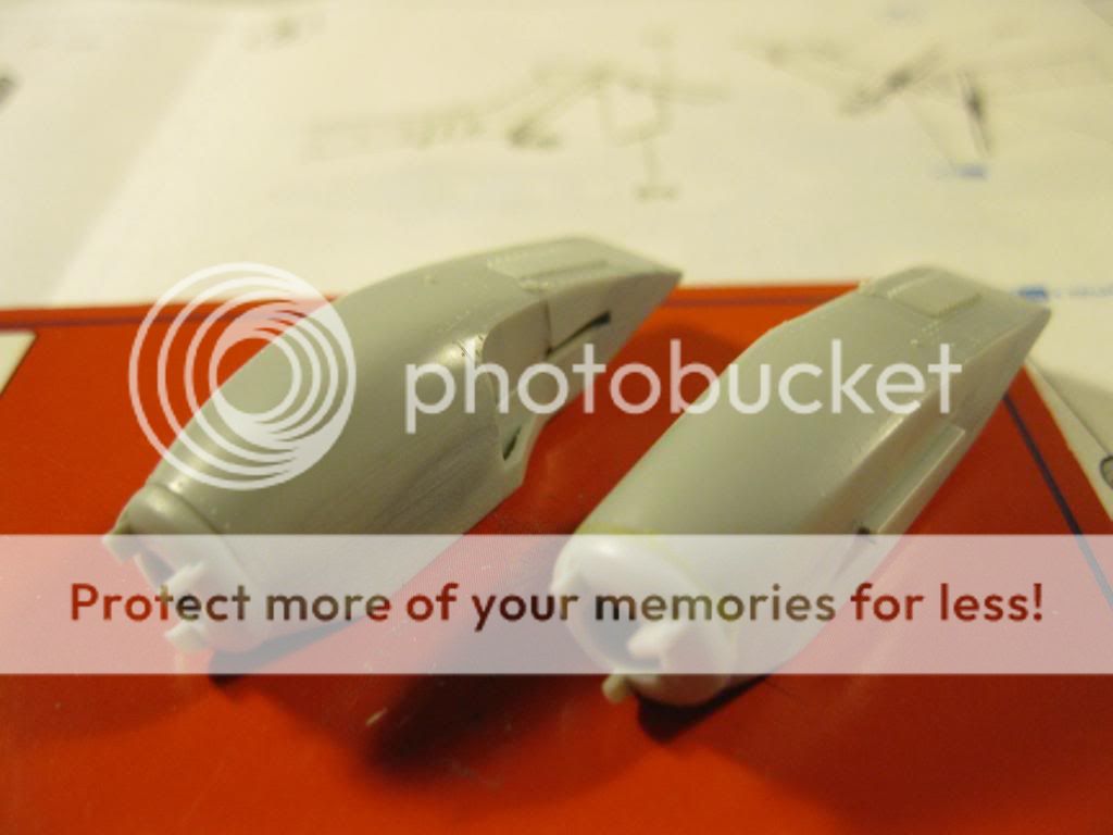

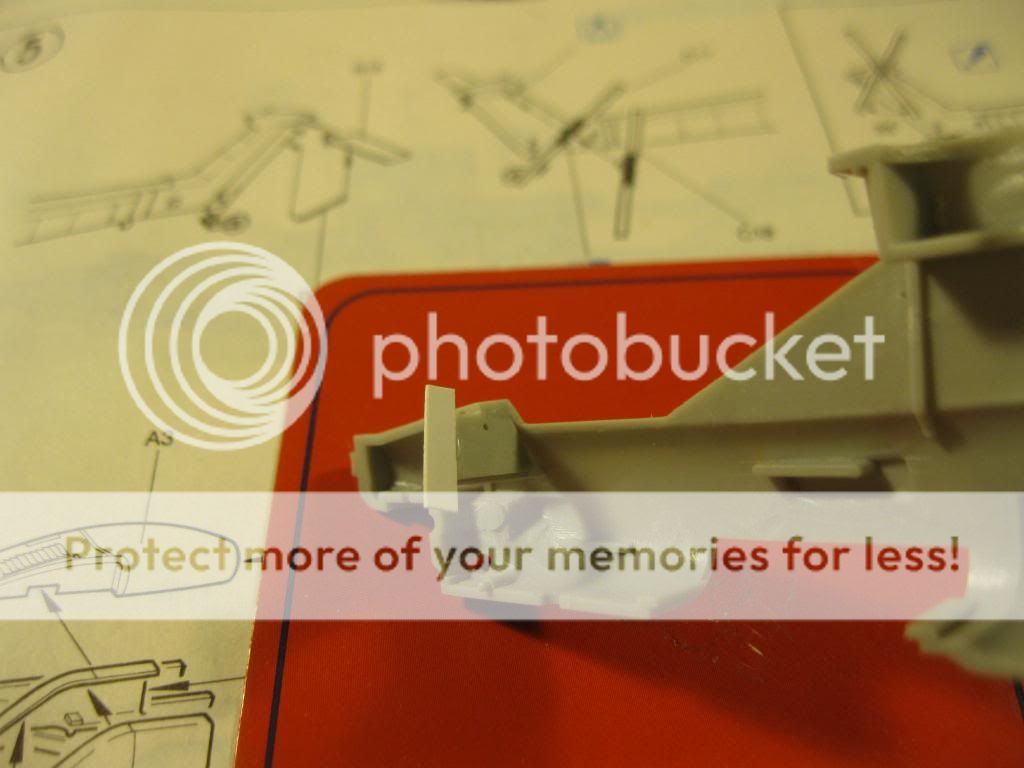

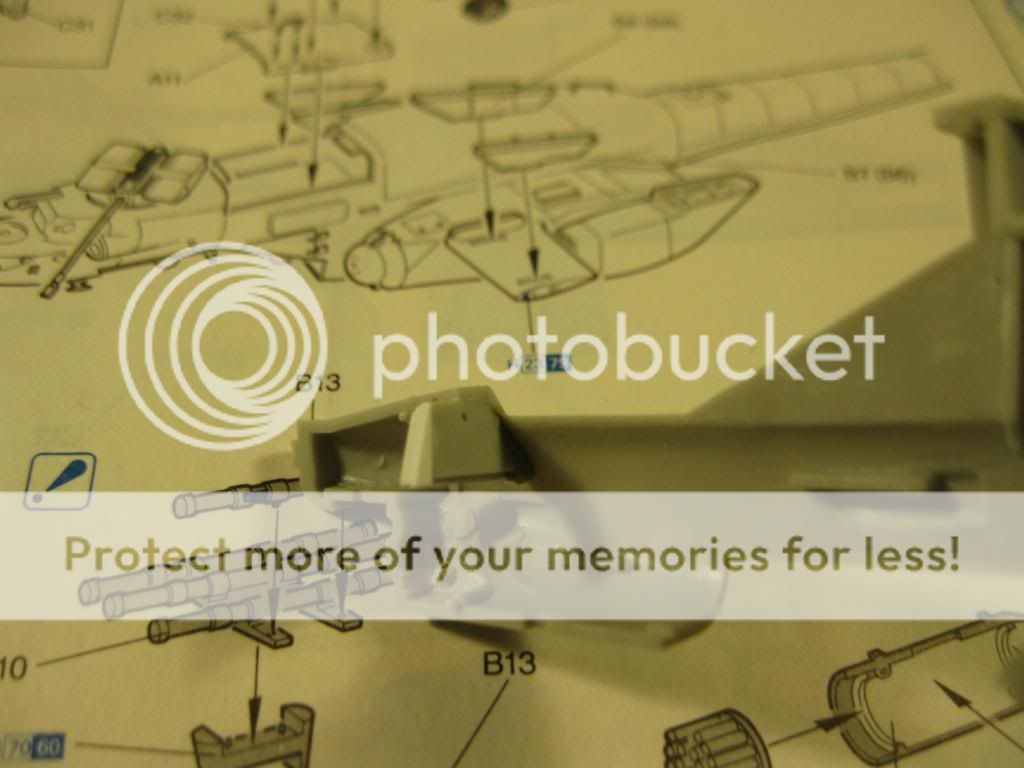

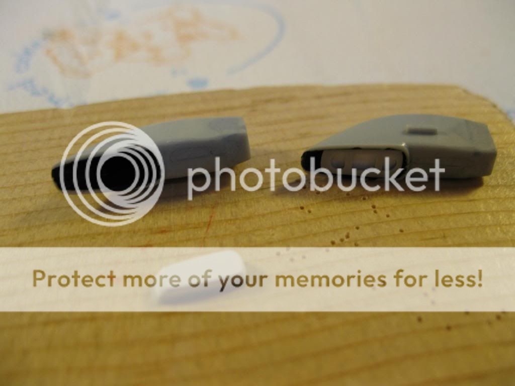

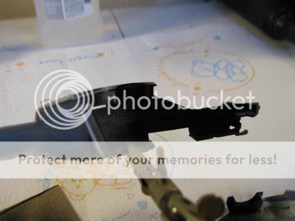

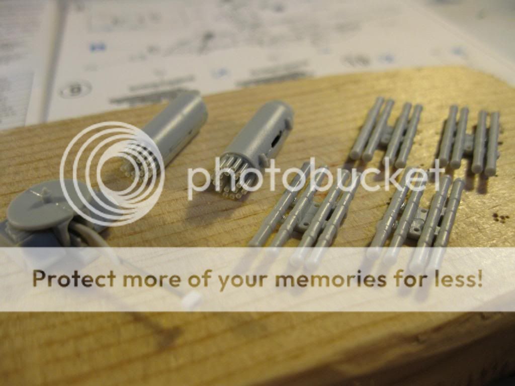

Assembling the chin gun was a bit fiddly
Lots of little parts (that only Dragon can do) that need a lot of dry fitting and patience. Oh, and don't forget all the filling. The ammo cases on both sides of the gun were awful. So a filling I went. Here is the finished result. Just a few touch ups to go.

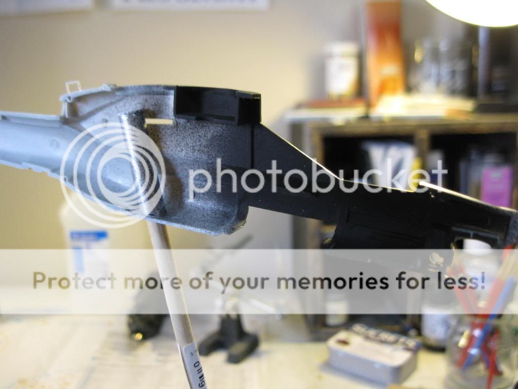

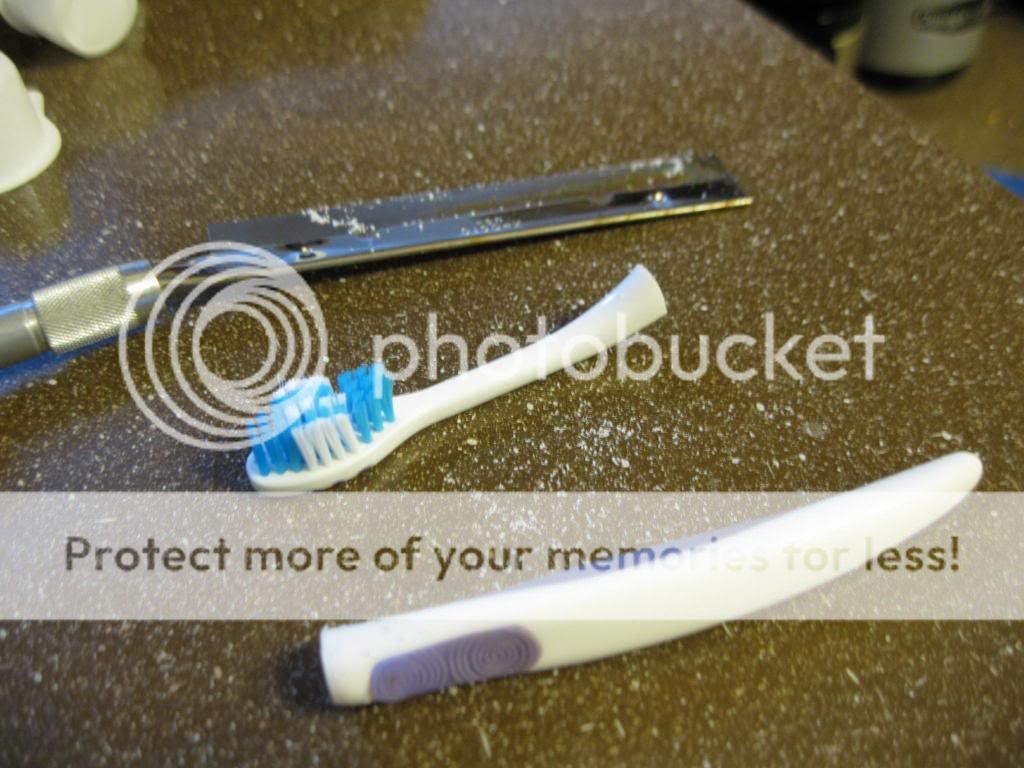

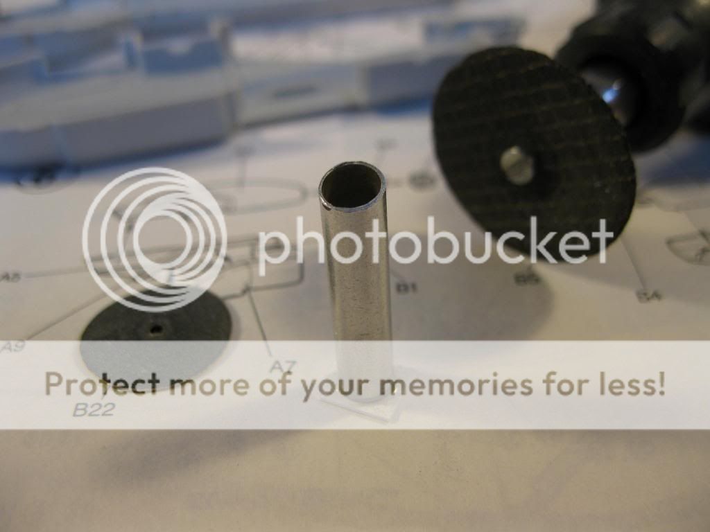

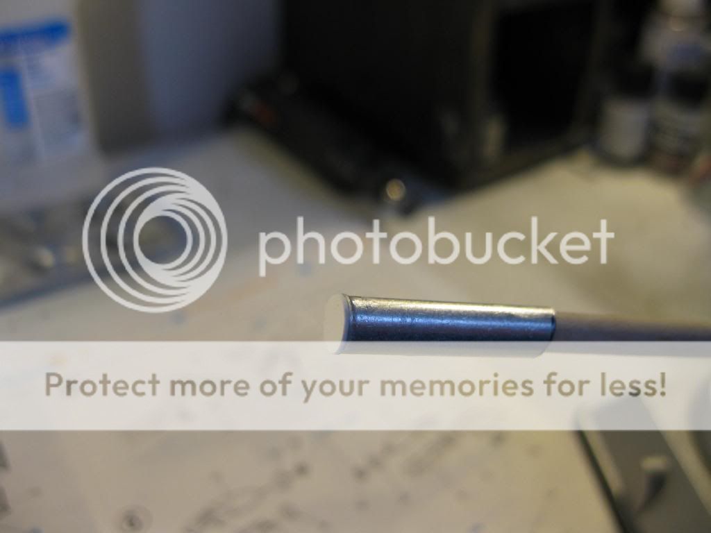

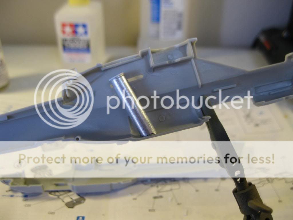

Tomorrow I am off to find a piece of dowel that will fit one of these cuties. I hope to use the aluminum over the brass, as I don't need any more weight in my bird. Still haven't quite figured out how I will install the tubing. I have plenty of time to think about it before I close the fuselage. This is going to be a whirleybird on a stick.
