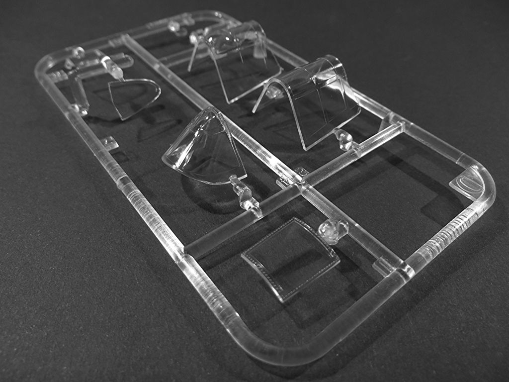

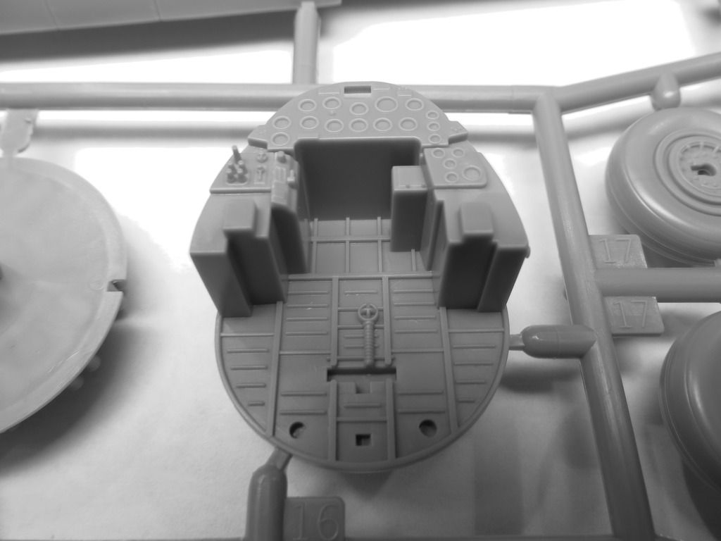

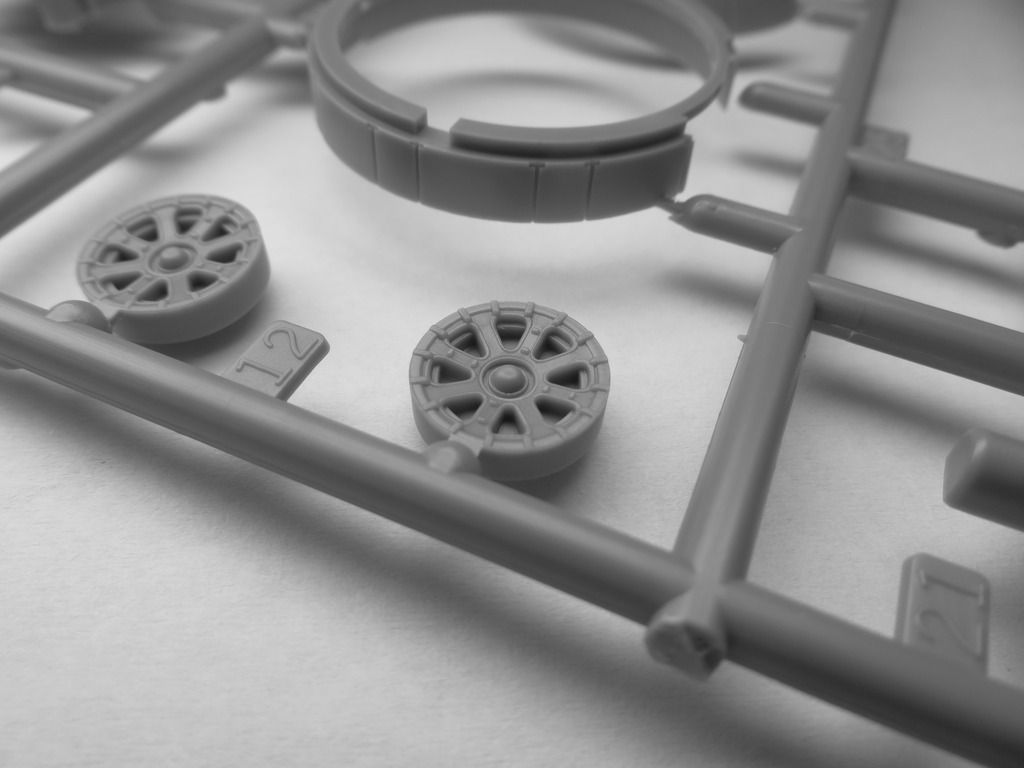

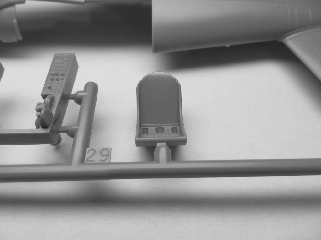

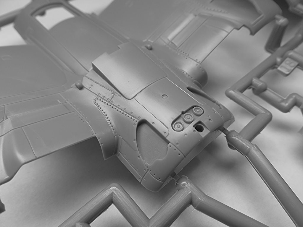

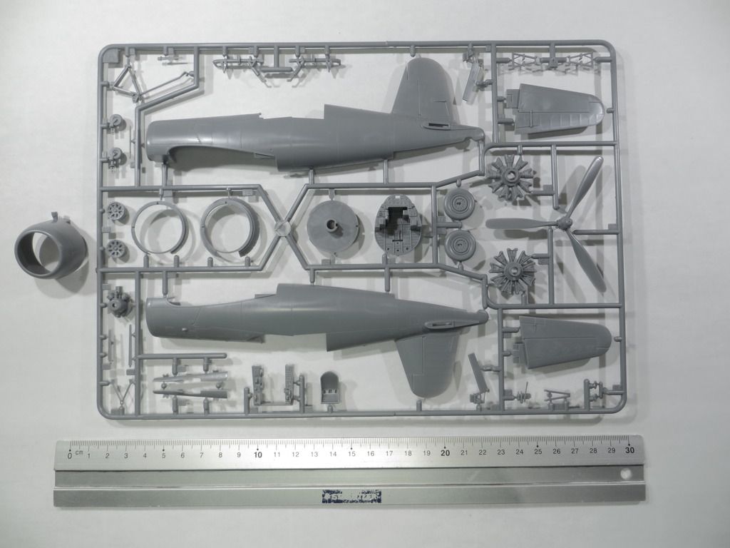

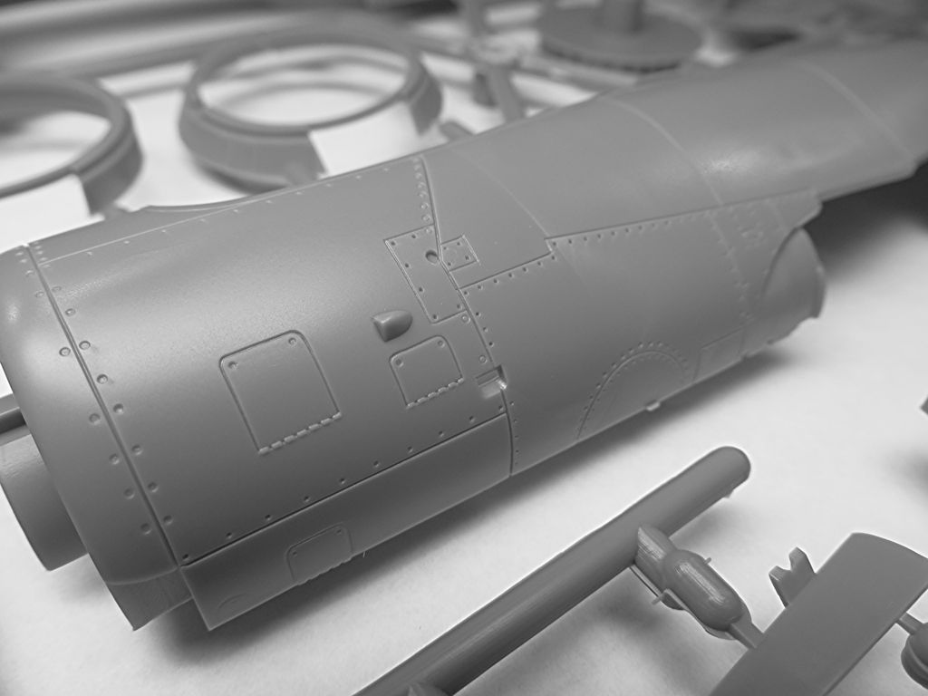

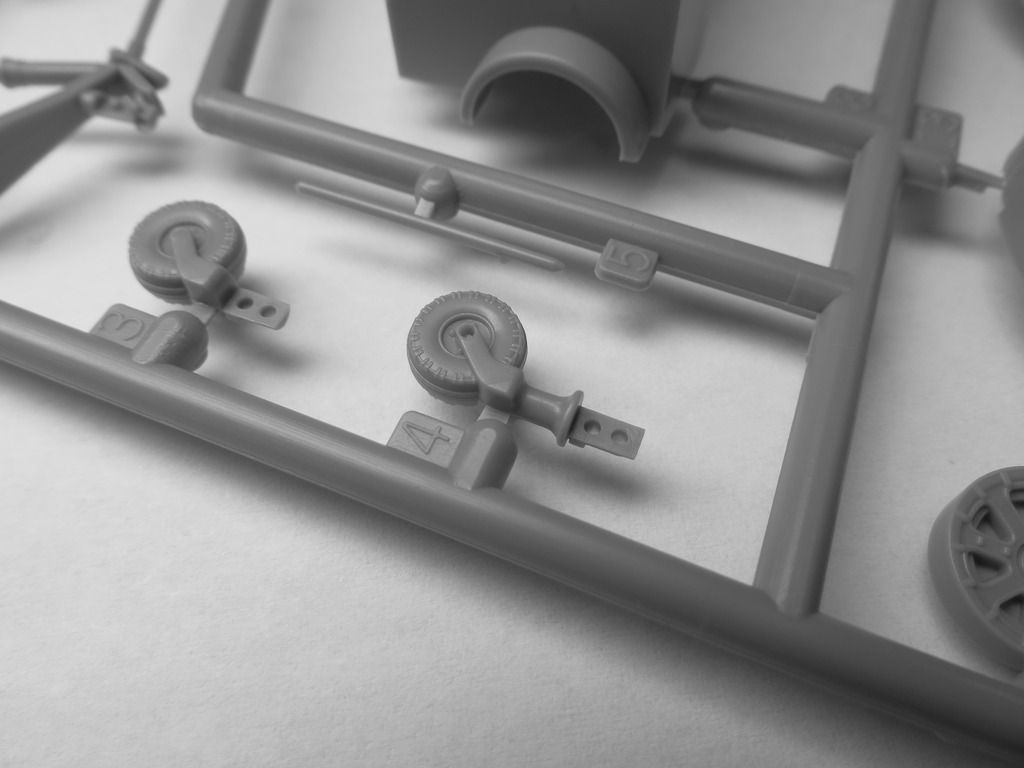

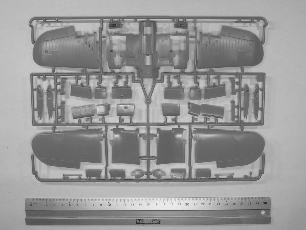

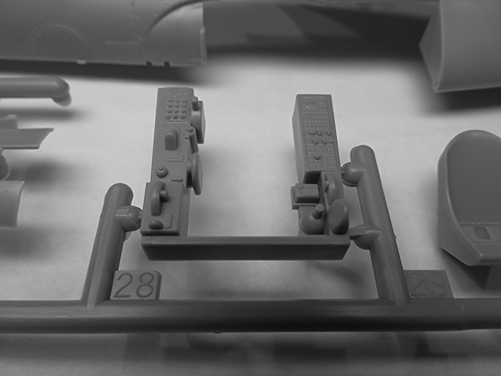

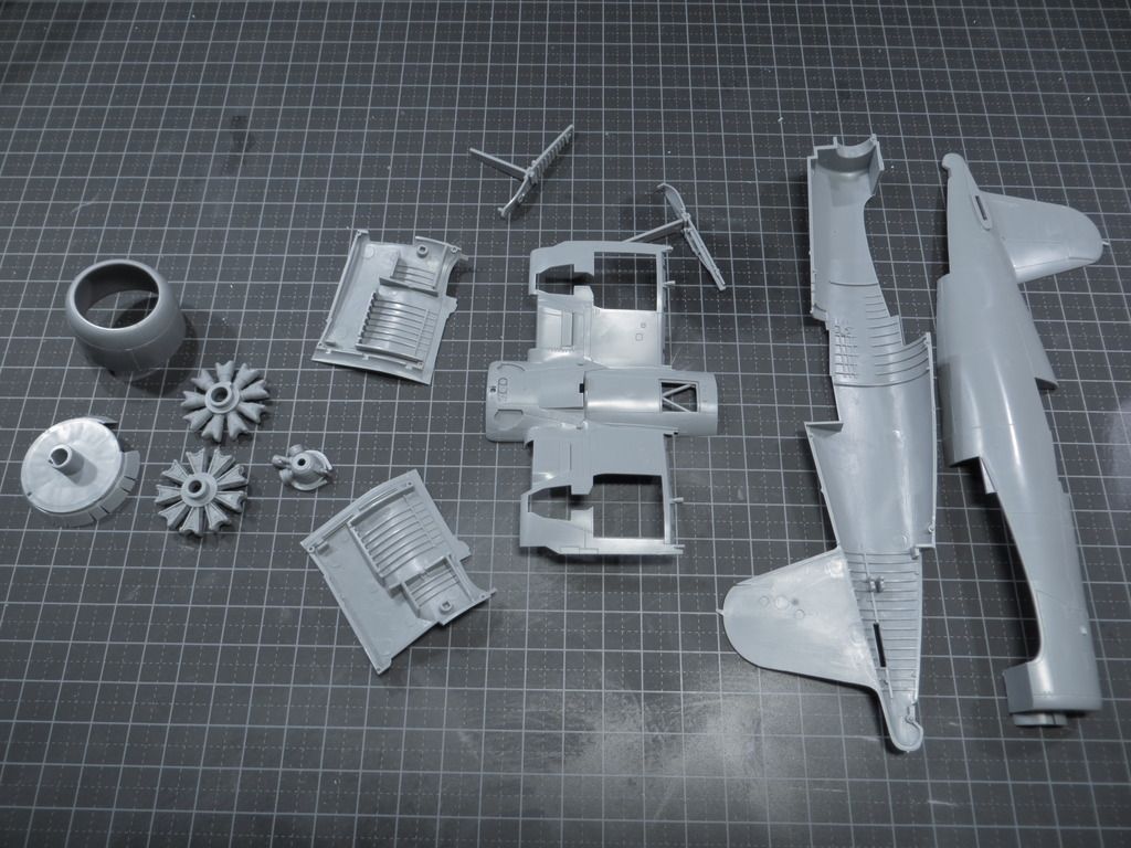

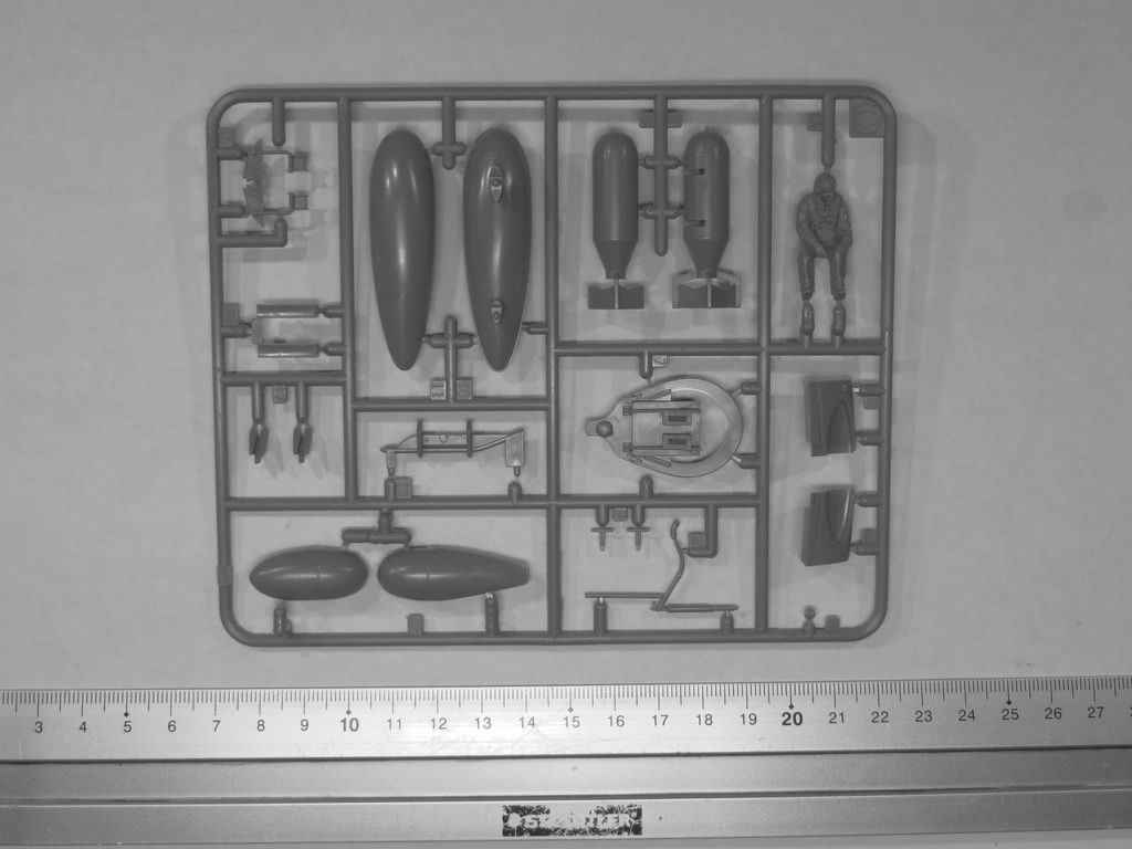

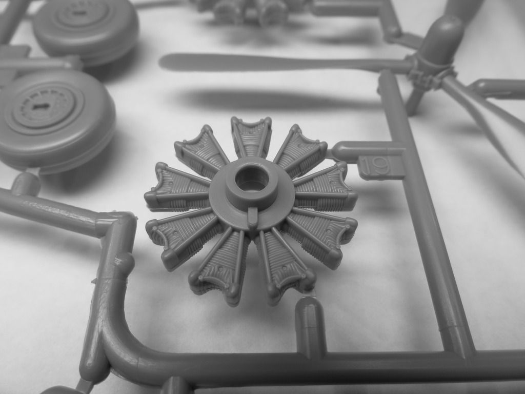

The Kit

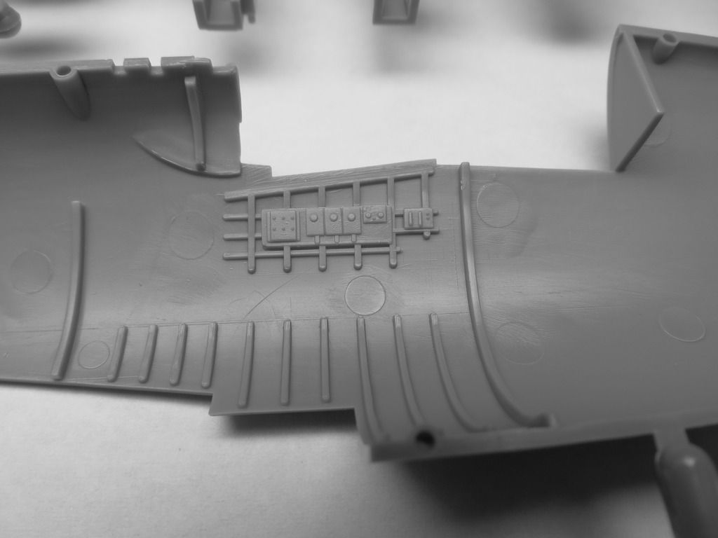

I my opinion this is a good kit. It's got some nice detail here and there and the moulds are very crisp.

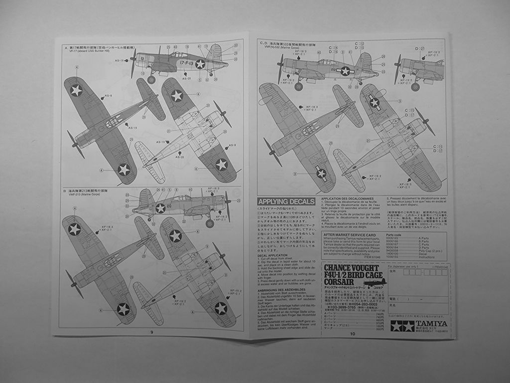

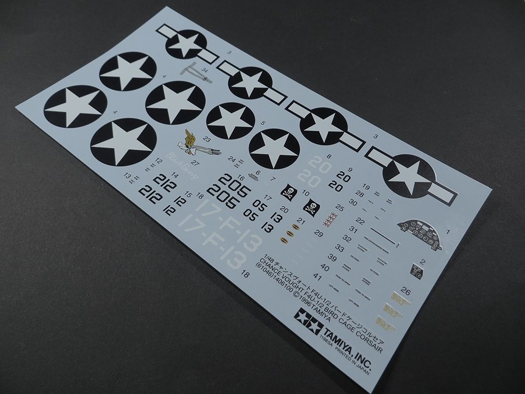

I'll be doing the first marking option, the VF-17 one aboard USS Bunker Hill.
Here is a quick look:

looks a good kit, I'll keep an eye on your build to see what, if any, the issues are as I fancy building one myself :pop:

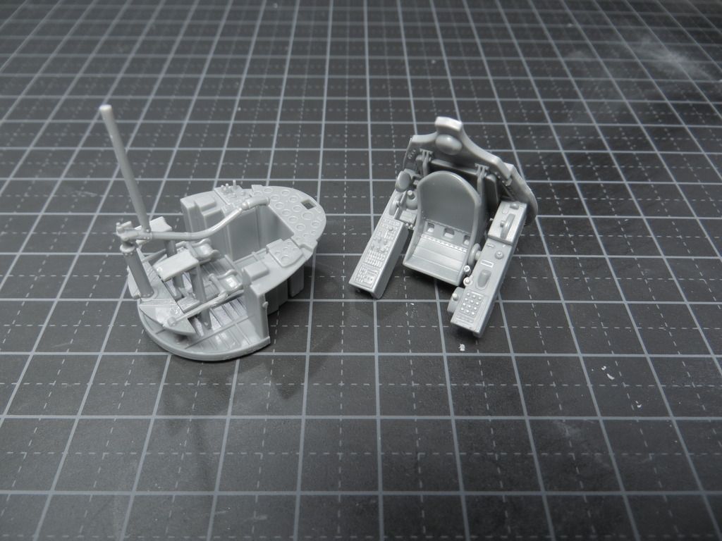

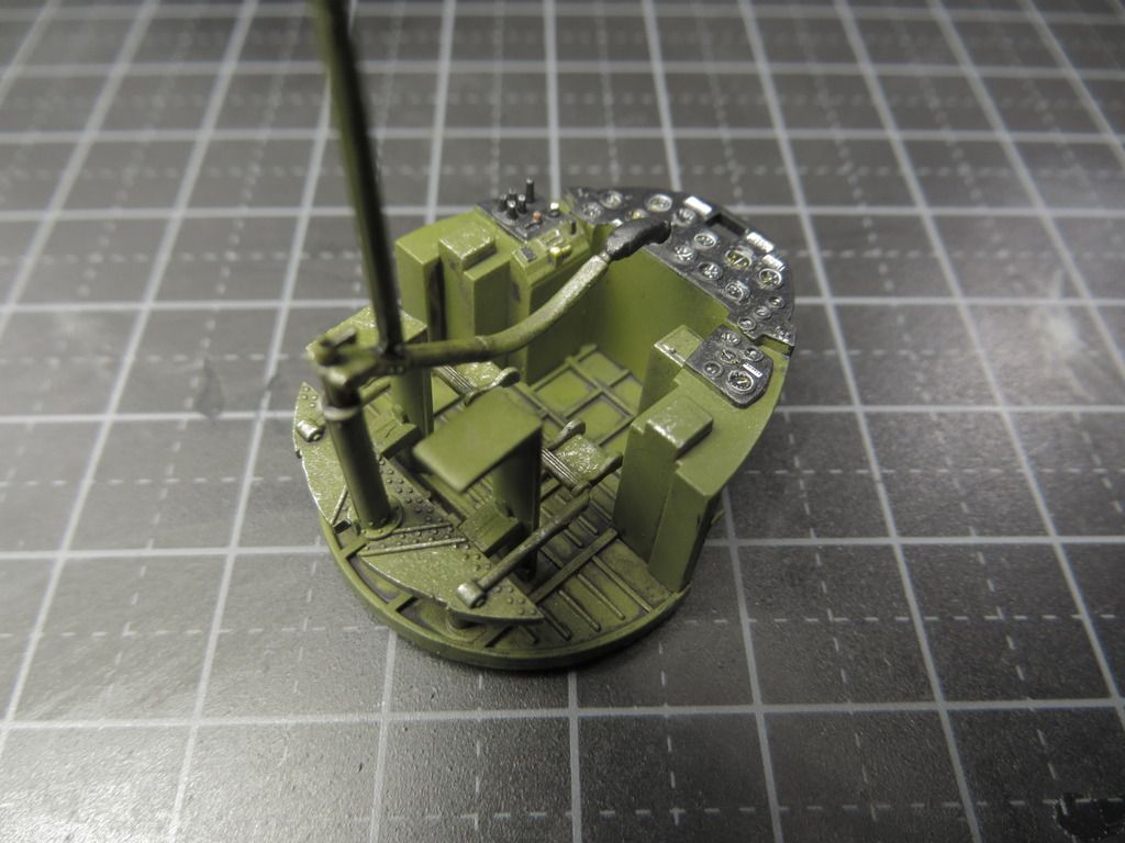

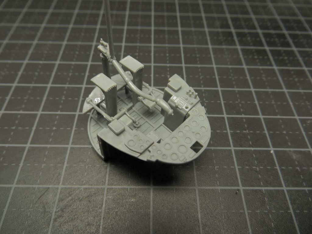

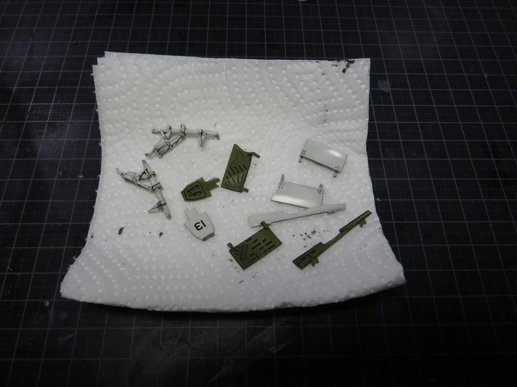

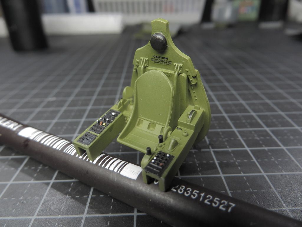

Update #1

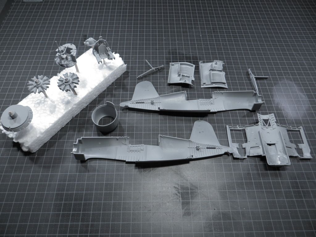

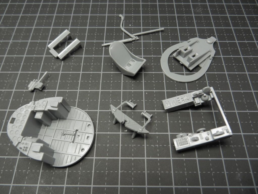

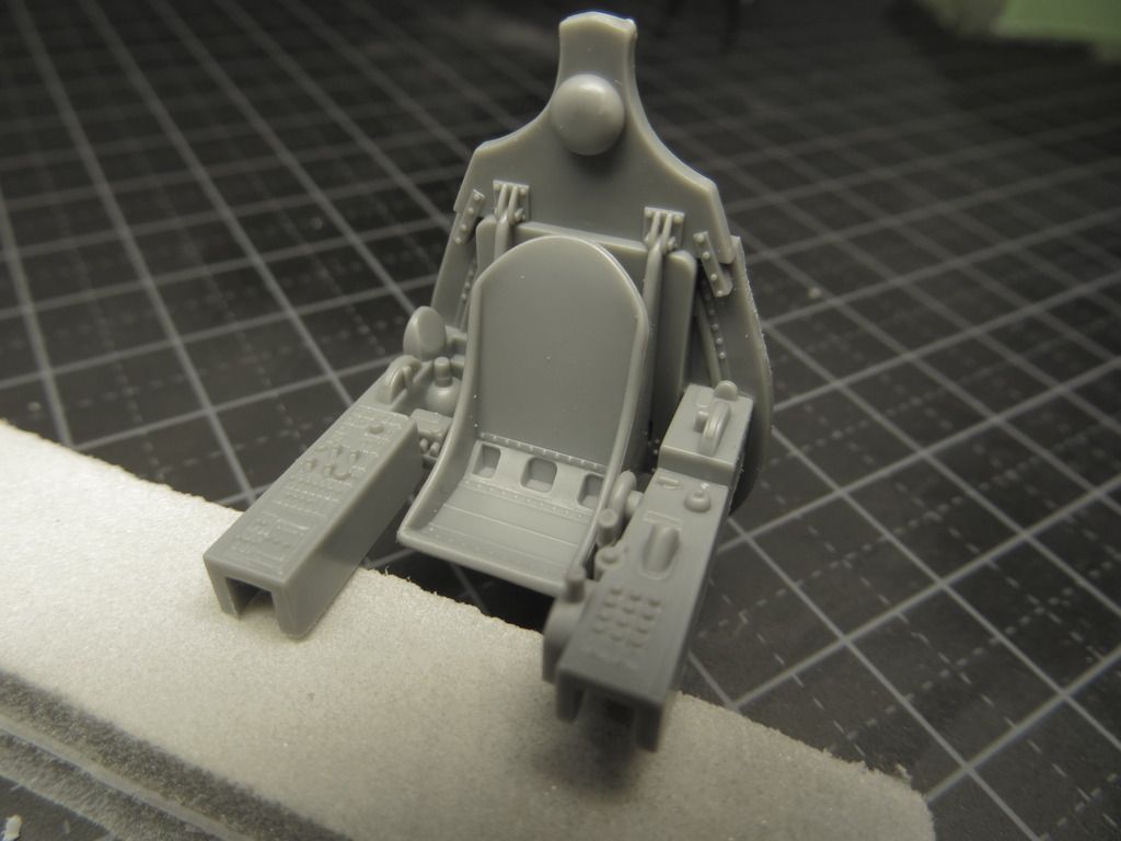

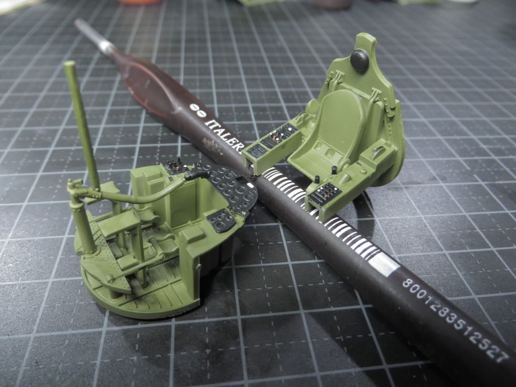

Some cockpit parts to be assembled...

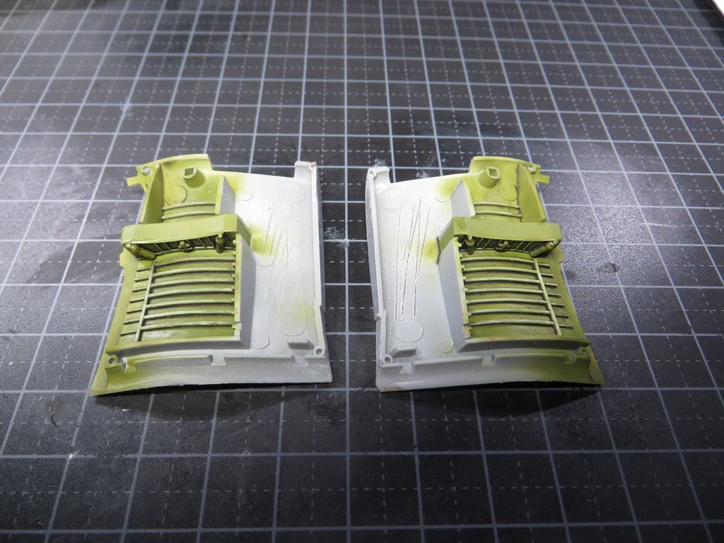

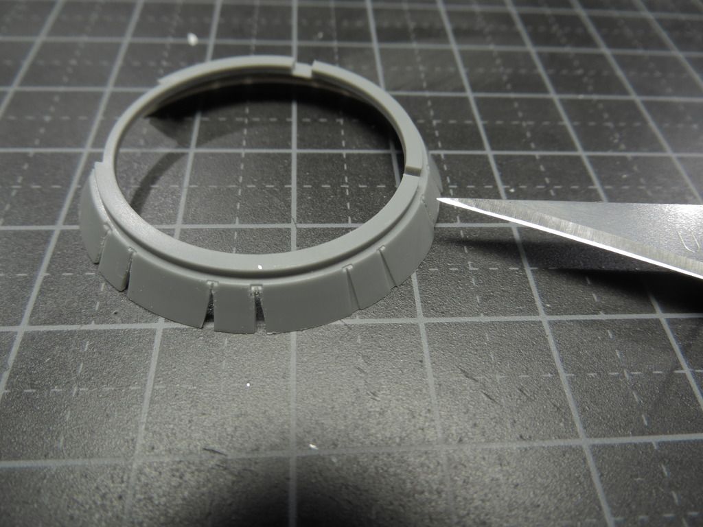

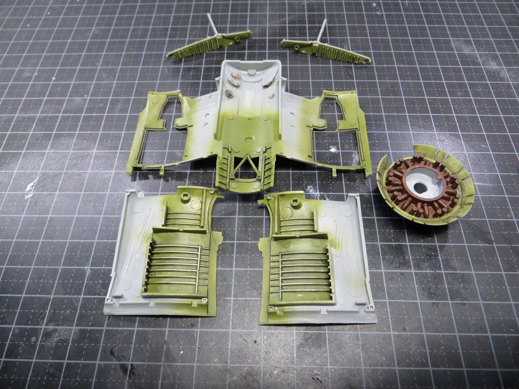

Radiator flaps cut open as Nige201980 did on his Corsair build.

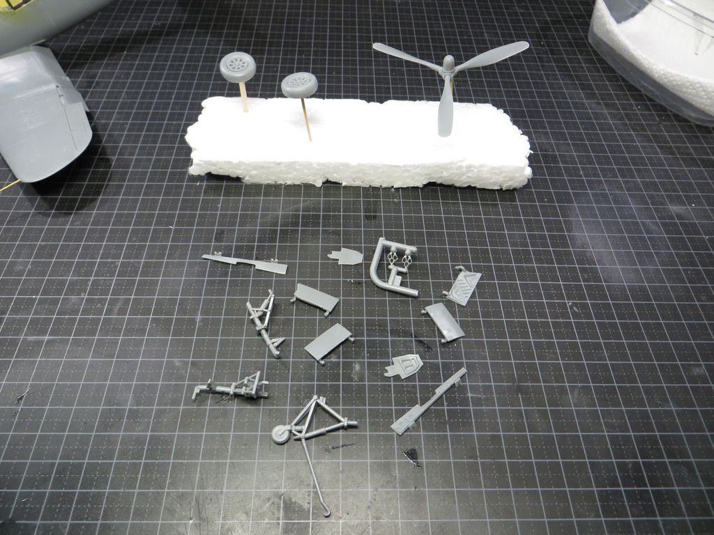

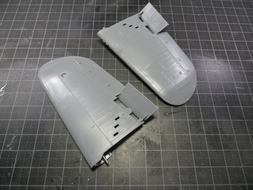

More parts redy for primer...

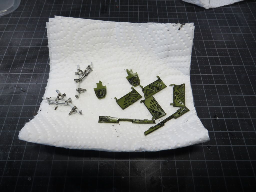

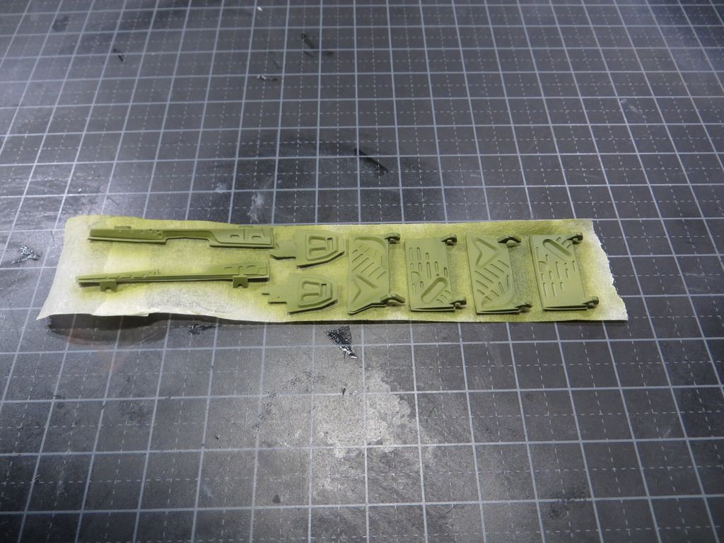

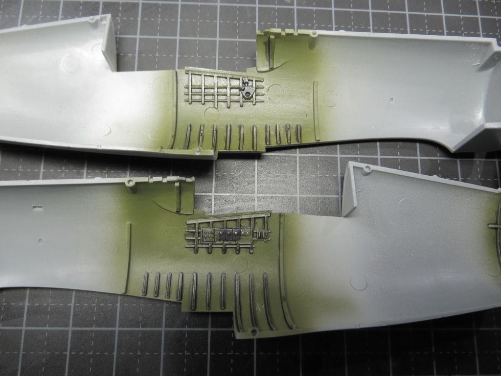

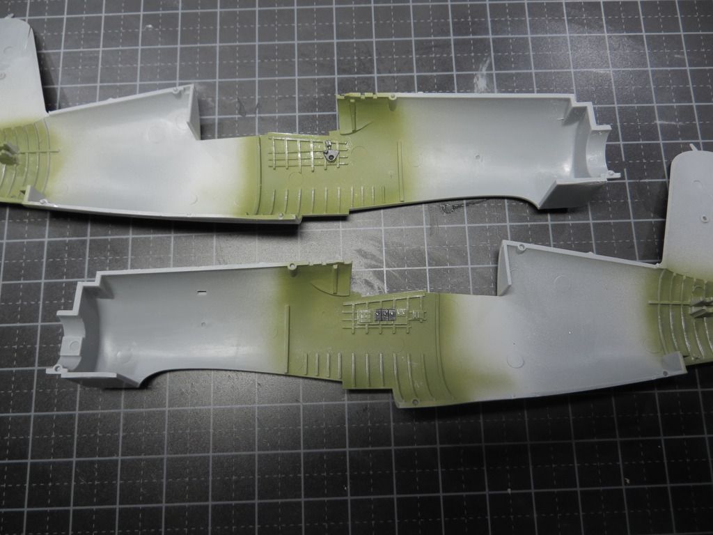

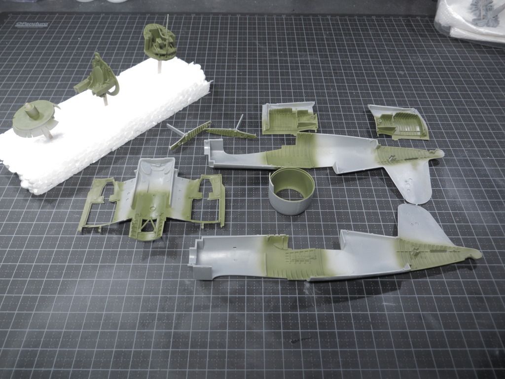

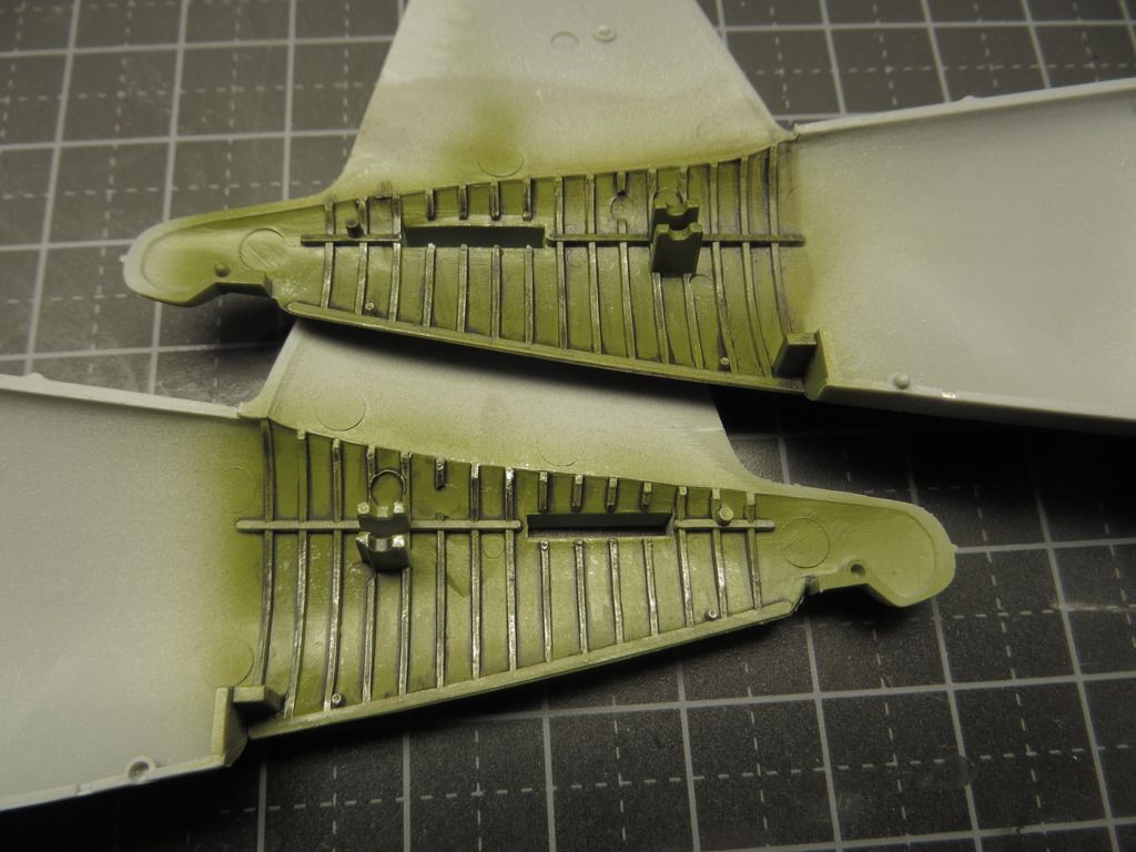

Parts of the interior and cockpit primed.

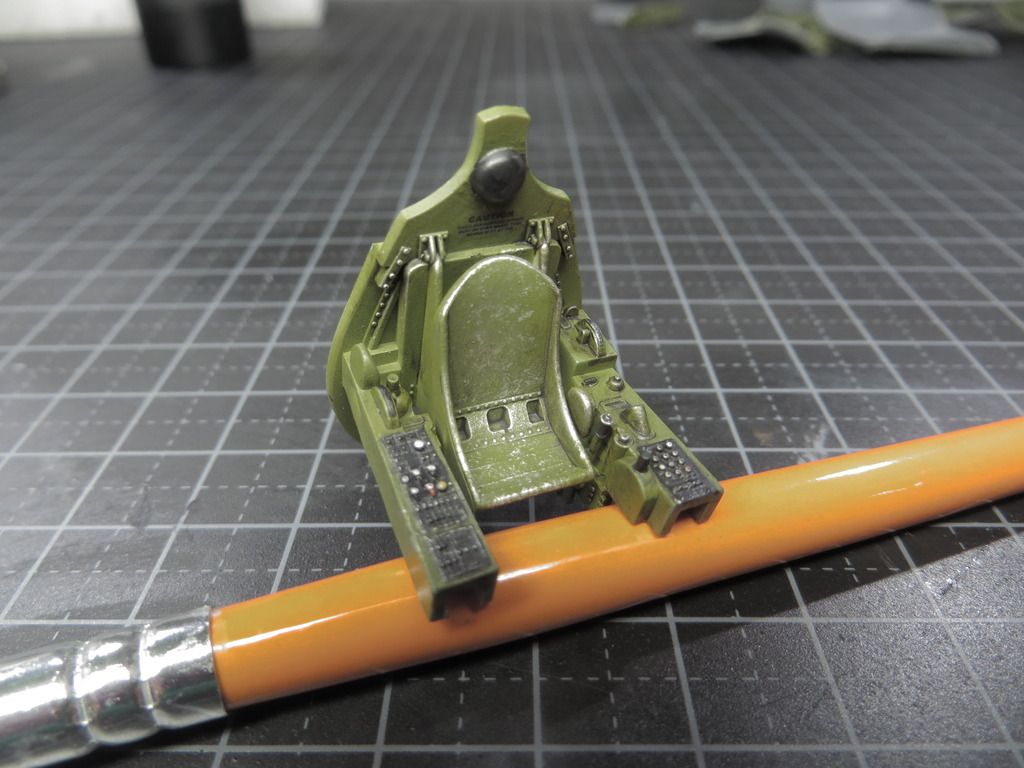

And then sprayed in Vallejo Model Air Interior green.

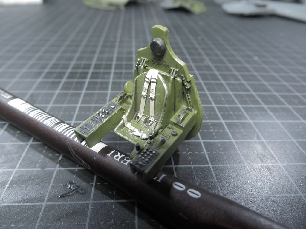

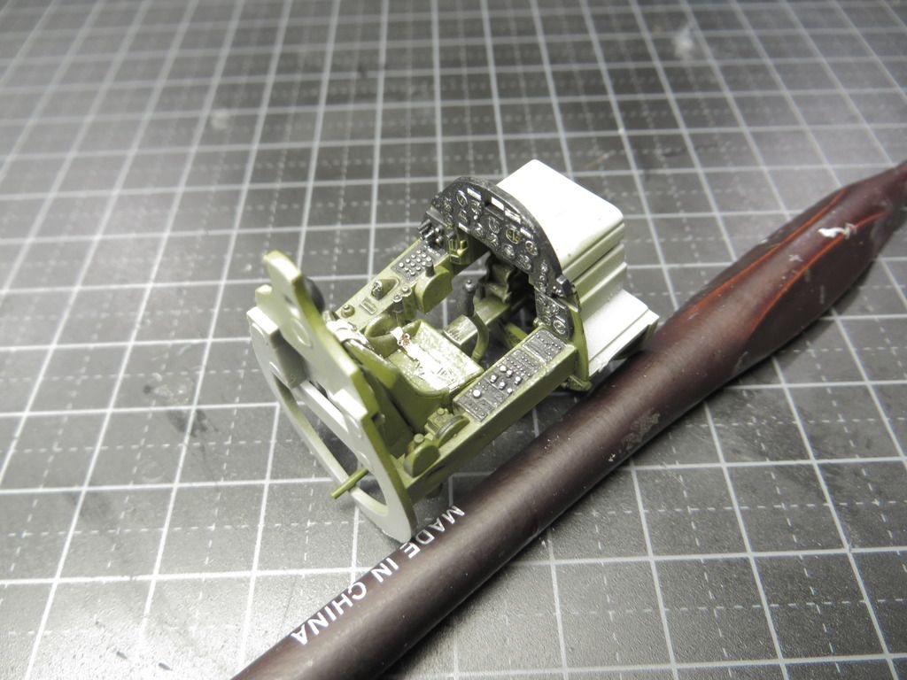

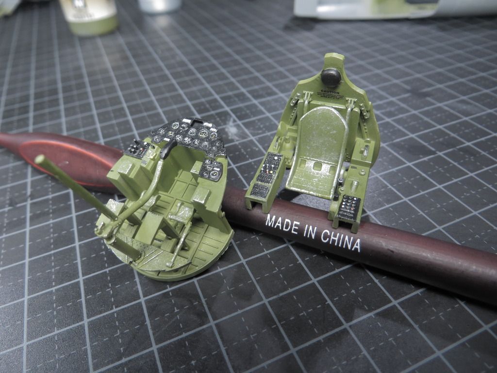

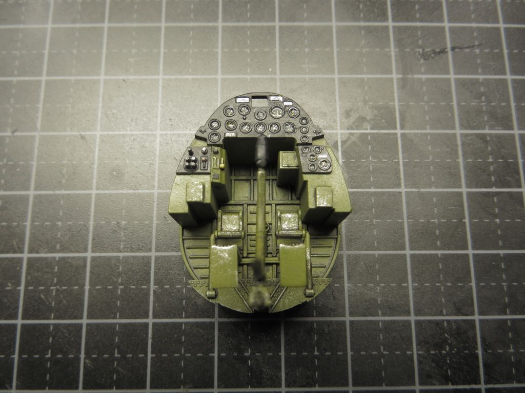

Some detail painting in the cockpit.

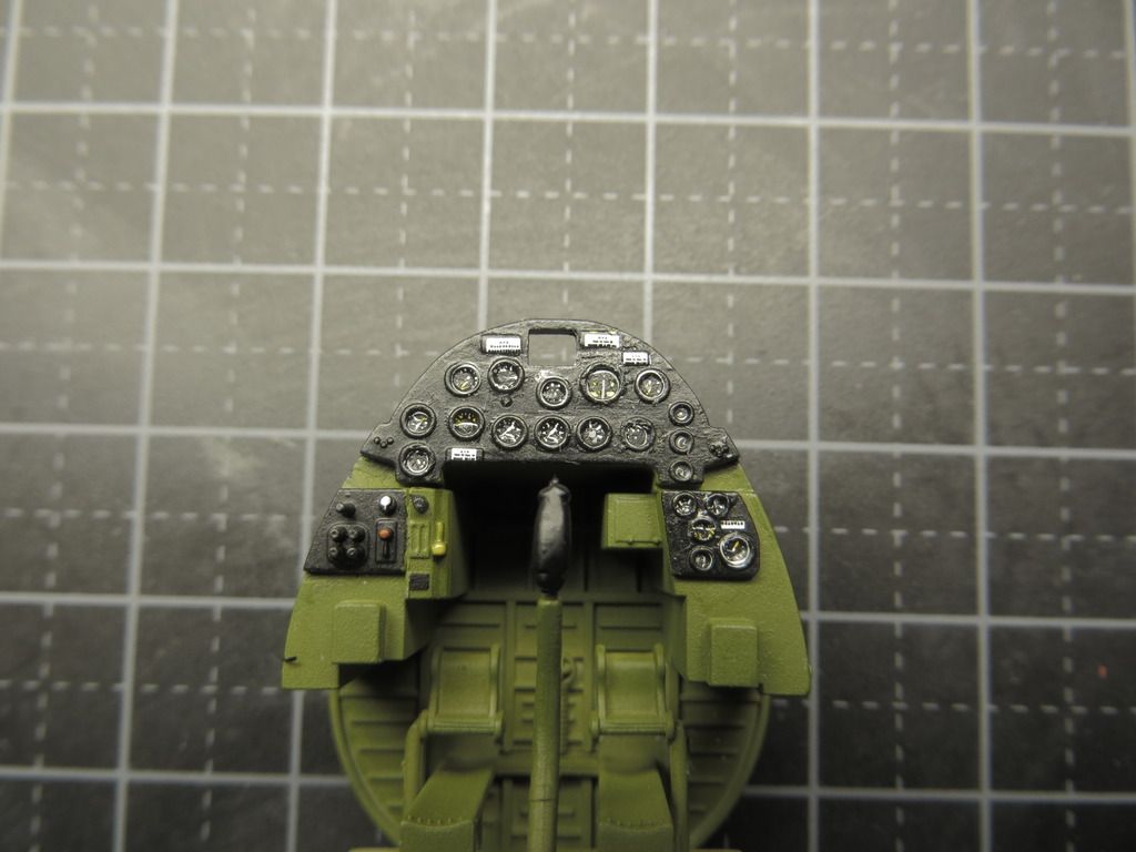

I took some old decal sheets and cut out some left over instrument decals to make the IP look better.
The result was quite good. :)
Some decals here too, but these are supplied in the kit.

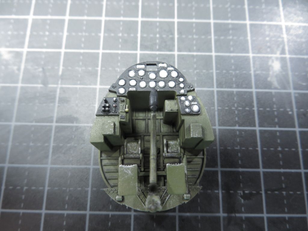

Chipping effects...
And lastly an oil wash after a clear cote. Gotta love the Mig oils!
And then some Kristal Klear on the dials to get a lens effect.
To be continued...

it looks to me that you've got the wear'n'tear on the seat perfect :bow::
great job

looks superb the weathering on the cockpit is quality and they are some great pics at the start of your thread

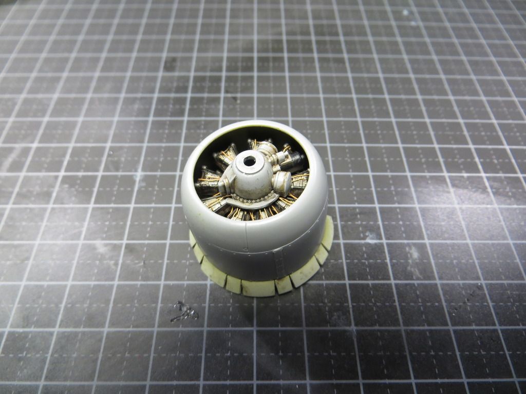

Love the cockpit mate really well done and love the engine cowl flaps :thumb1:

That's true craftsmanship on the cockpit. Great finish and crisp but beaten up at the same time.

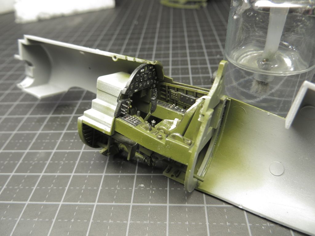

Update #2
Thanks Heel!
Haven't really got time to post here in the past month, everyday life in the way as usual. But now when school's out in the summertime I've got more time for modelling, so will crack on now! :banana:

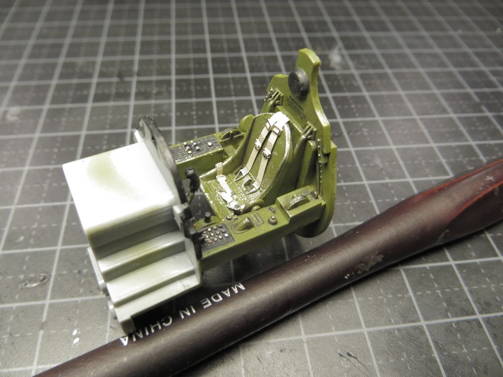

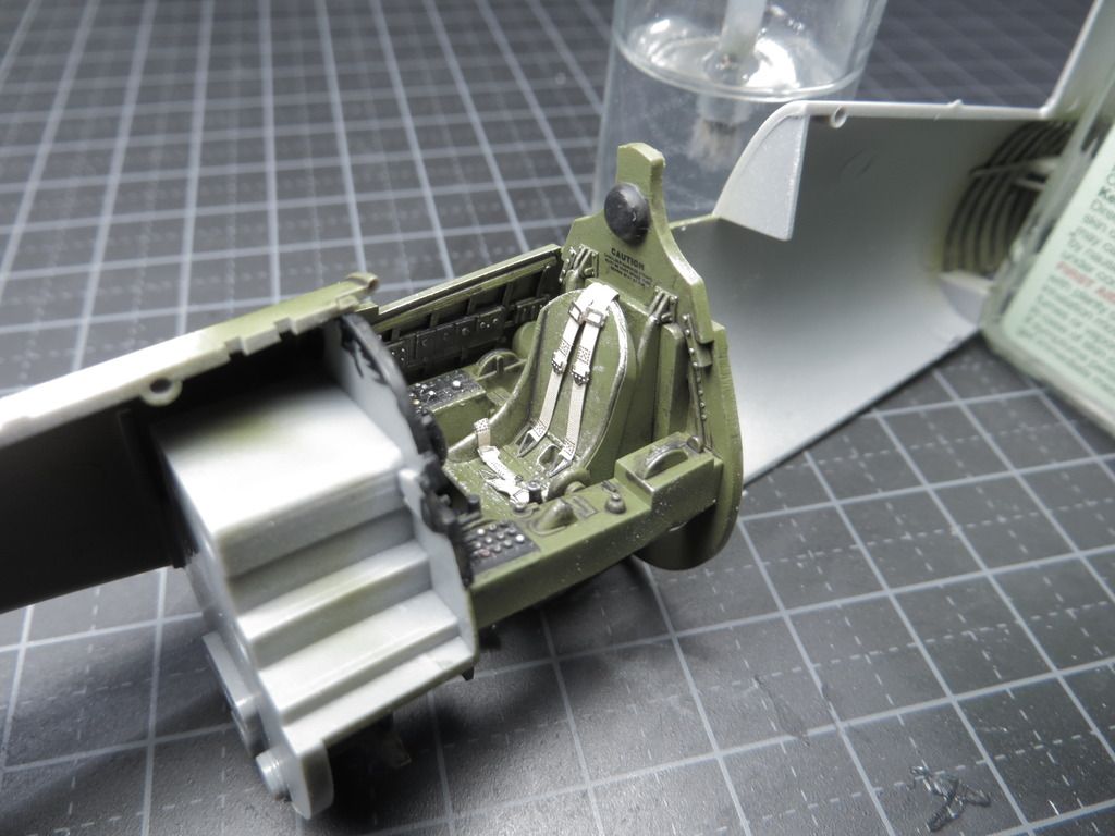

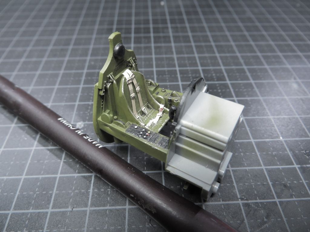

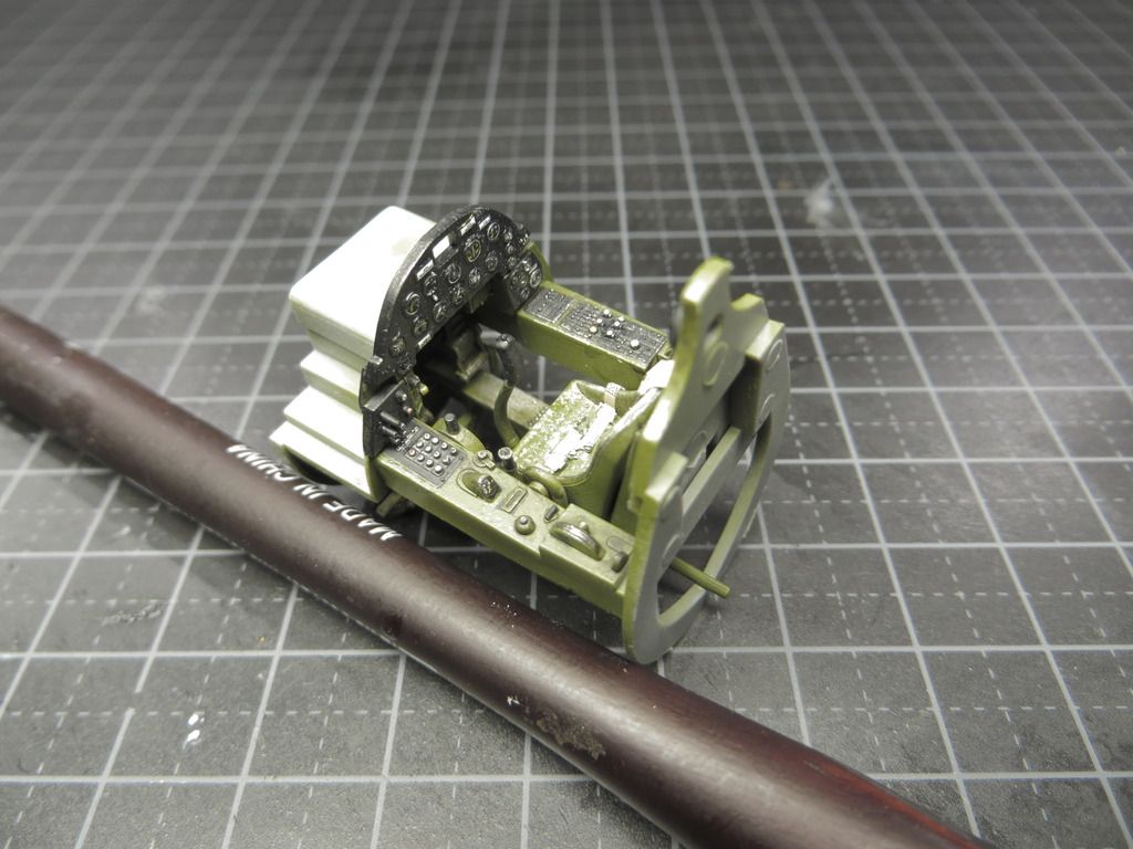

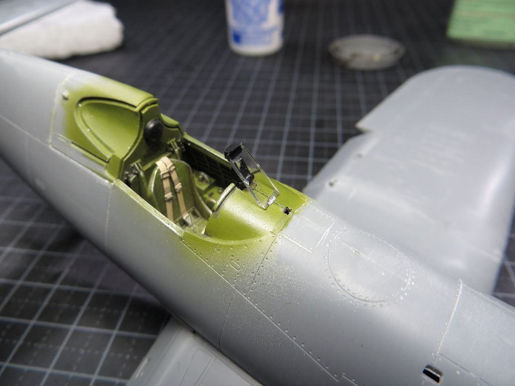

I added some leftover PE seatbelts from a Bf-109 and modified them a bit to look more like USN seatbelts.

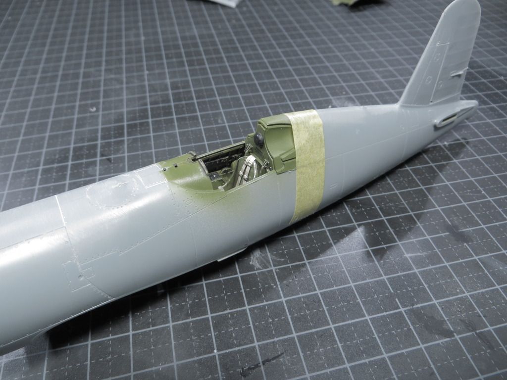

Then I assembled the two halves of the cockpit.
Fuselage halves glued together.

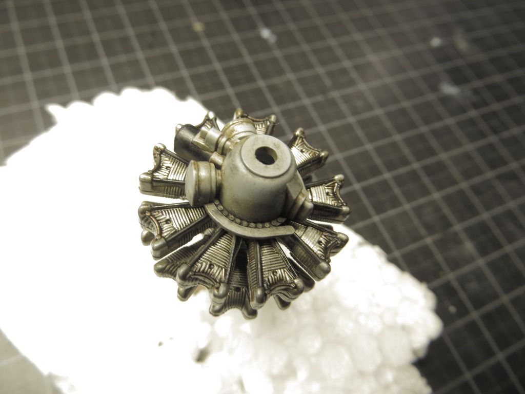

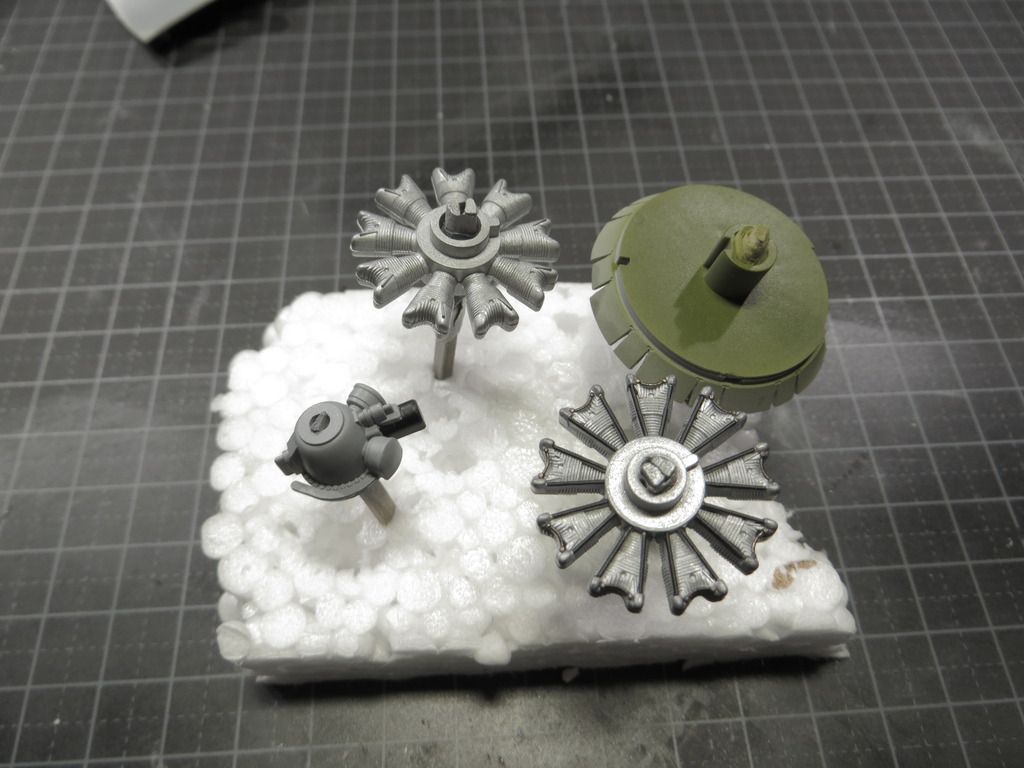

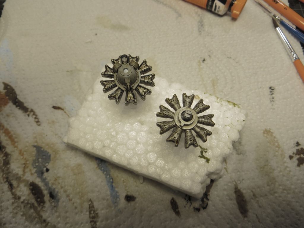

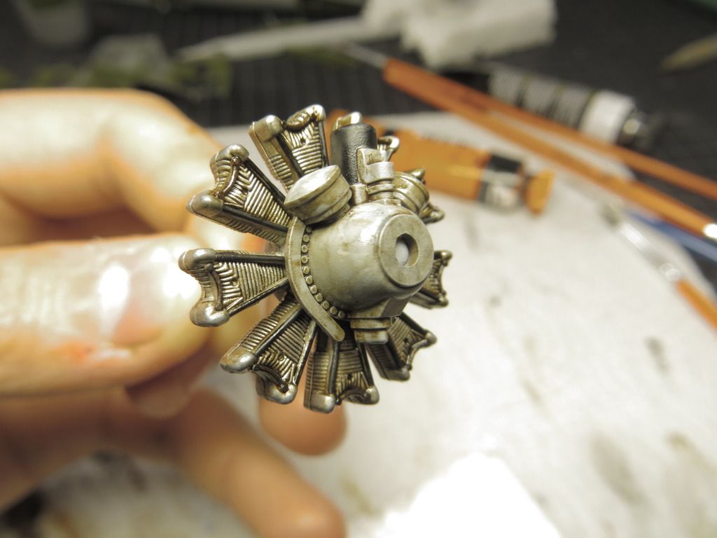

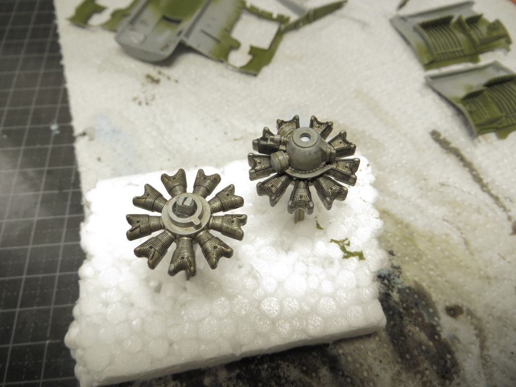

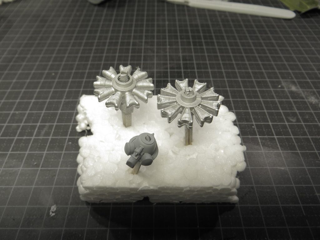

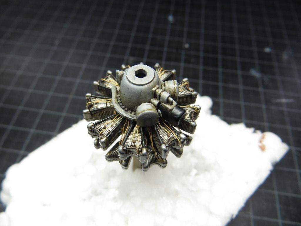

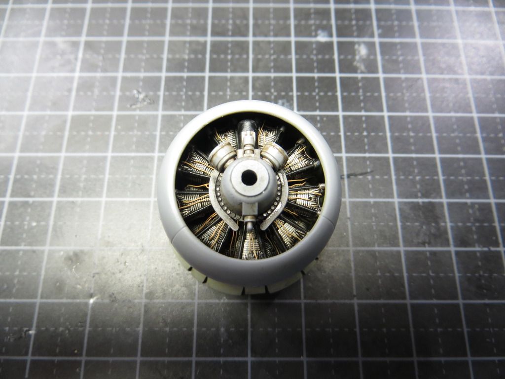

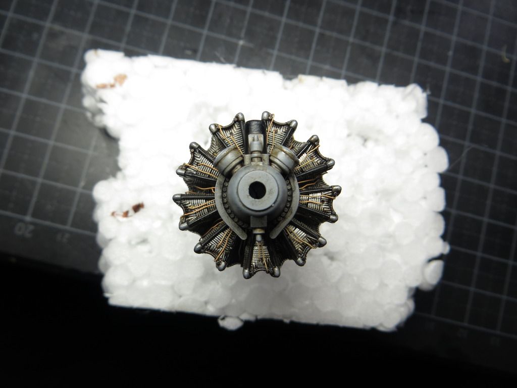

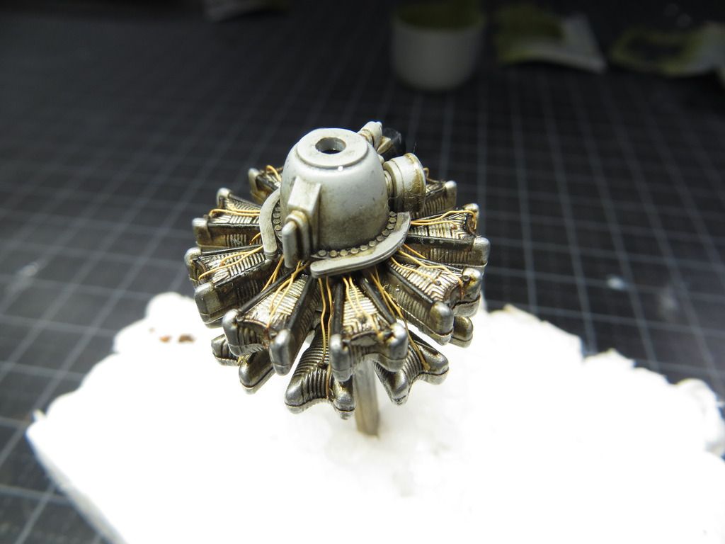

Started some work on the engine.

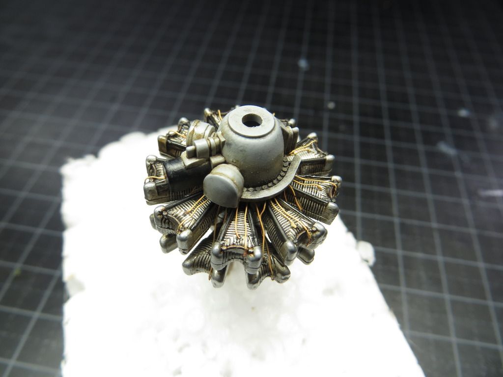

After a glosscoat I started the weathering on the engine, first off a dark brown oilwash.
And then continued with more oils and pigments.
Engine assembled.
I made an oilwash in the landing-gear bays and some other parts.
To last I made wireing in engine with some copperwire and painted it.
Here are the finished landing-gear bays.

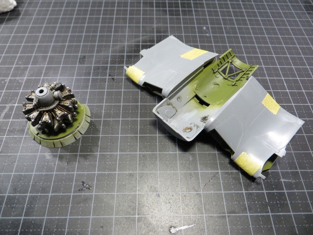

Engine and wing parts assembled.
Engine mounted to the cowling.
More parts of the wing assembled.
Engine and wings attatched to the fuselage.

The engine definitely looking the business!

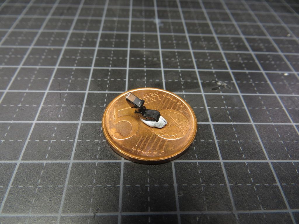

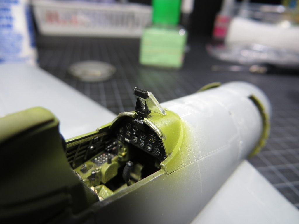

I scratchbuilt the clear part of the gunsight using the supplied kit part and clear plastic sheet.

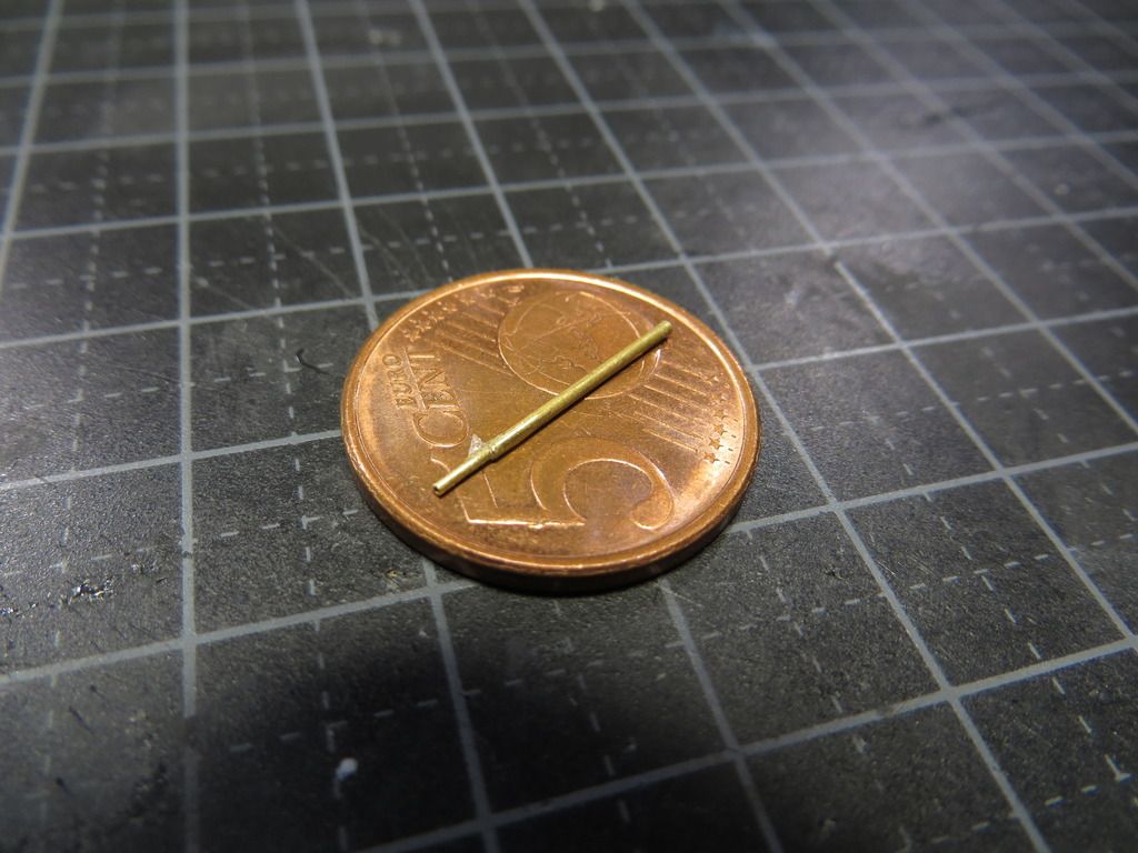

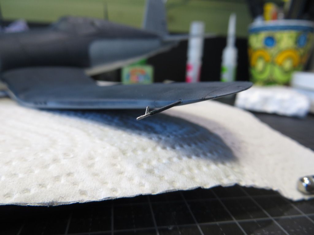

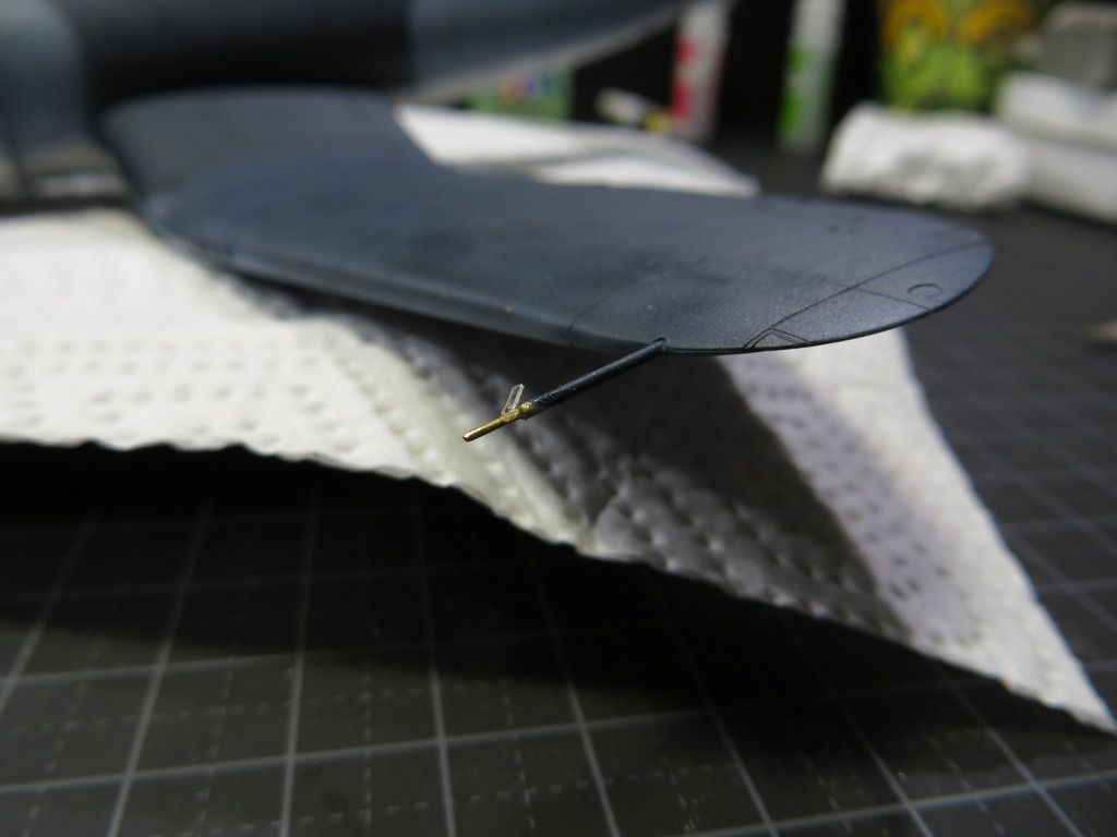

I scratchbuilt the pitot-tube using super small brass pipes manufactured by Trumpeter.
Gunsight attatched.
Pitot-tube attatched.

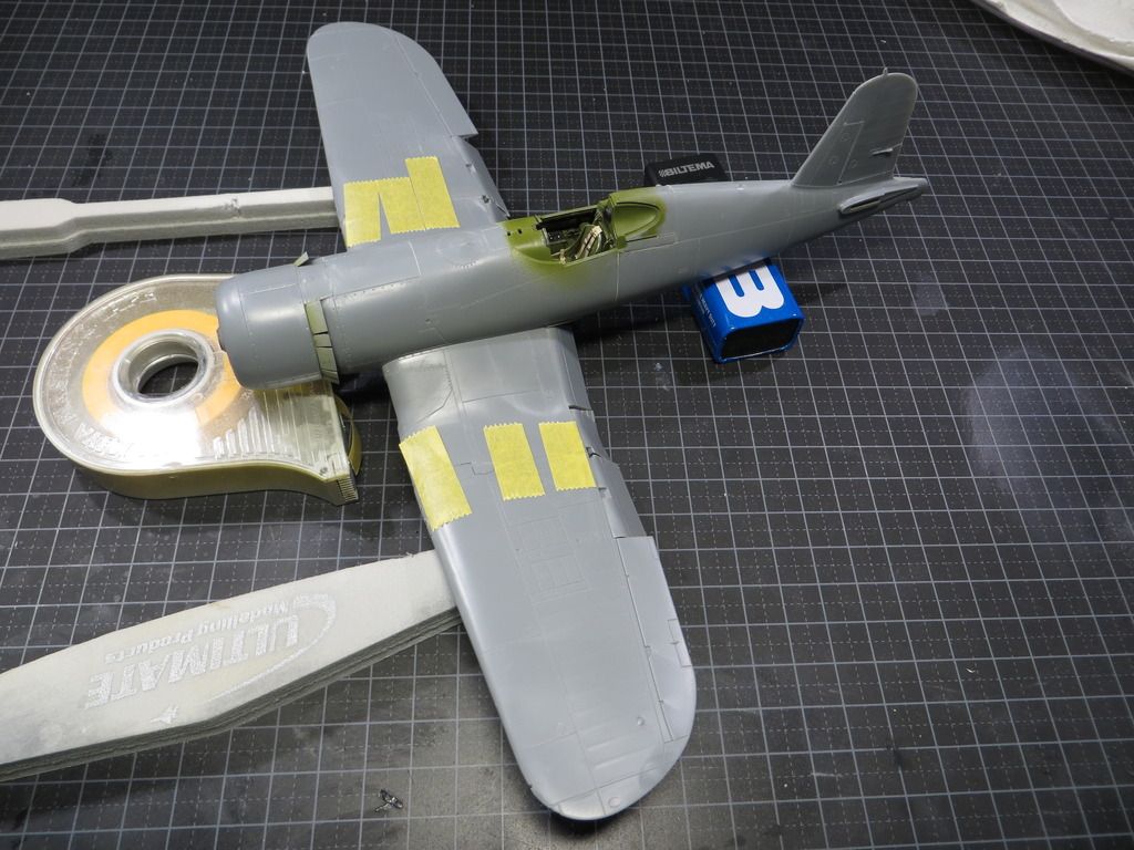

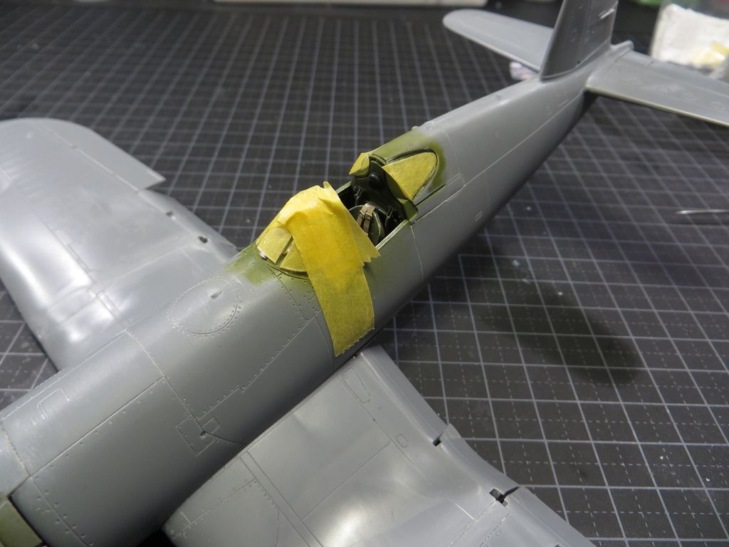

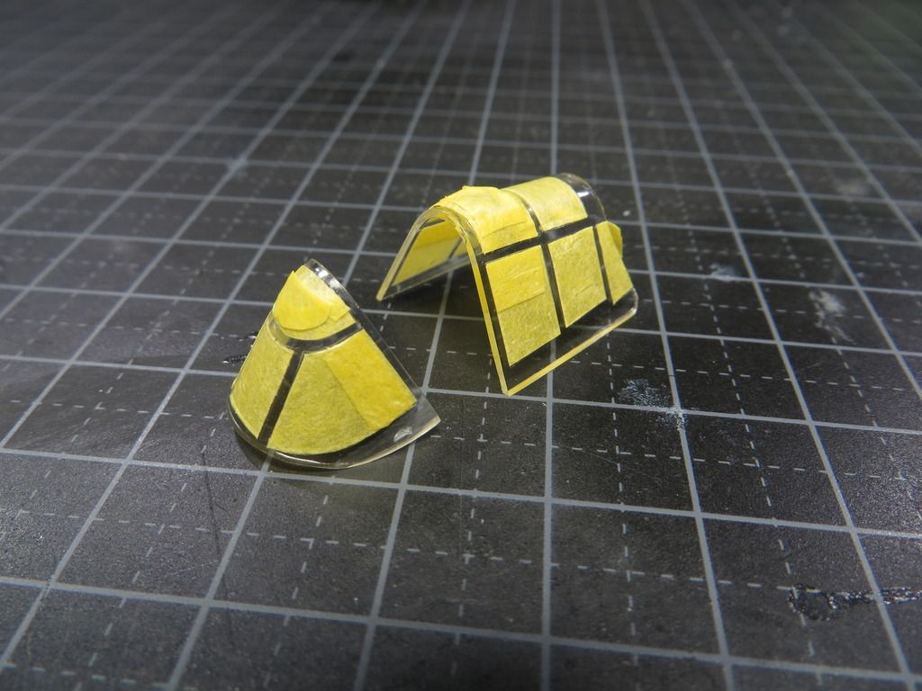

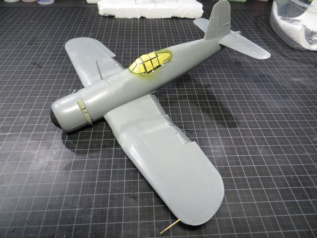

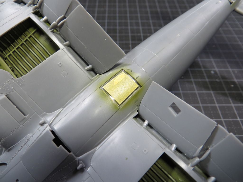

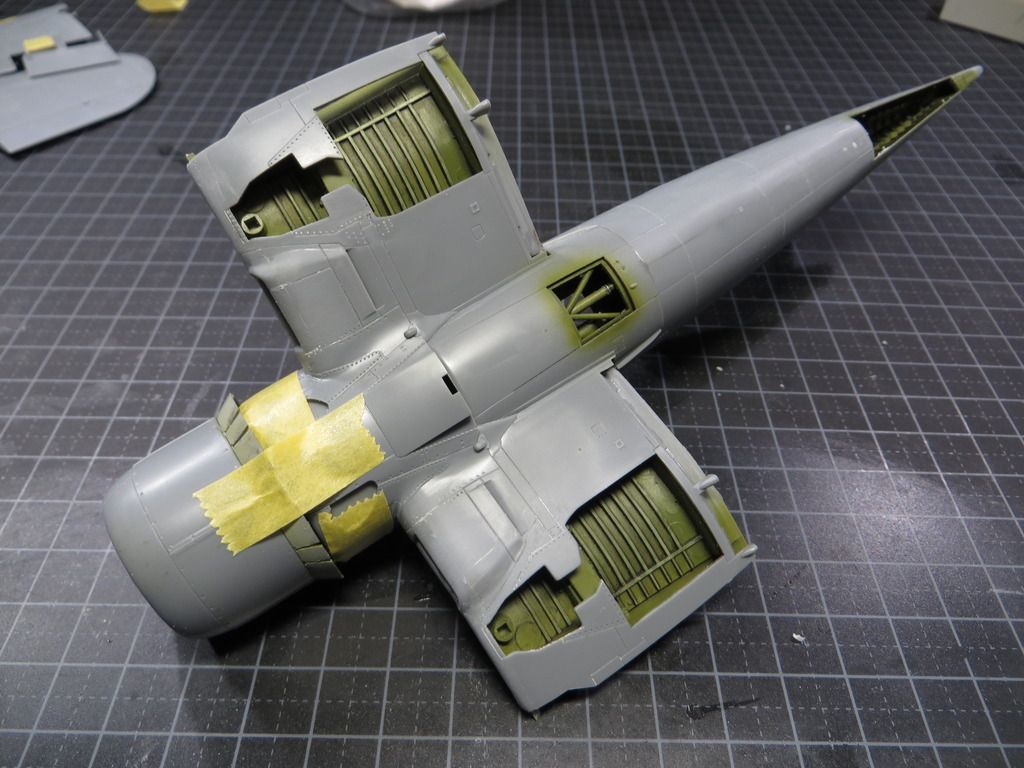

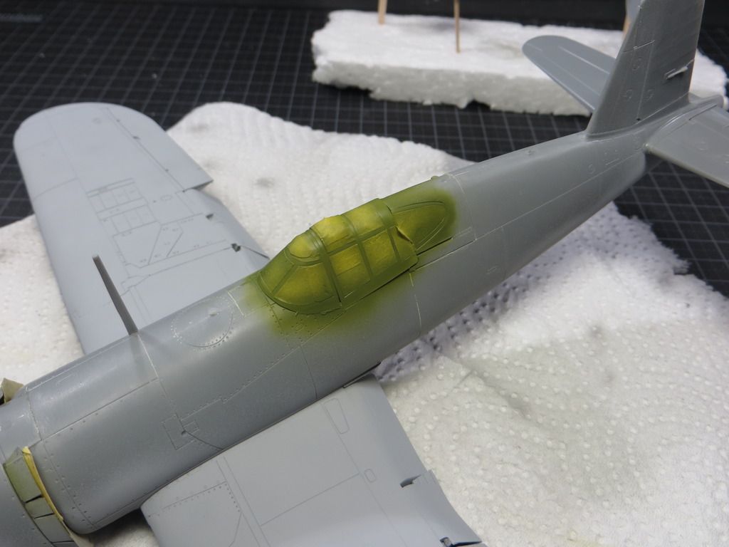

Canopy masked...
...and attatched.

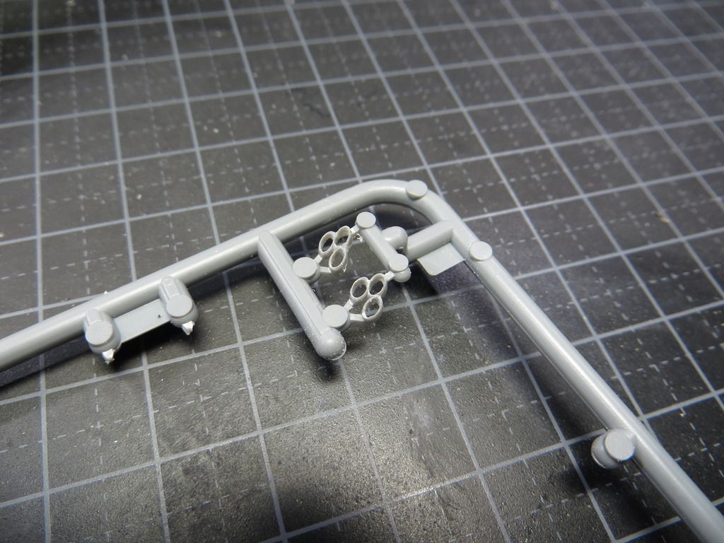

Exhausts drilled out.

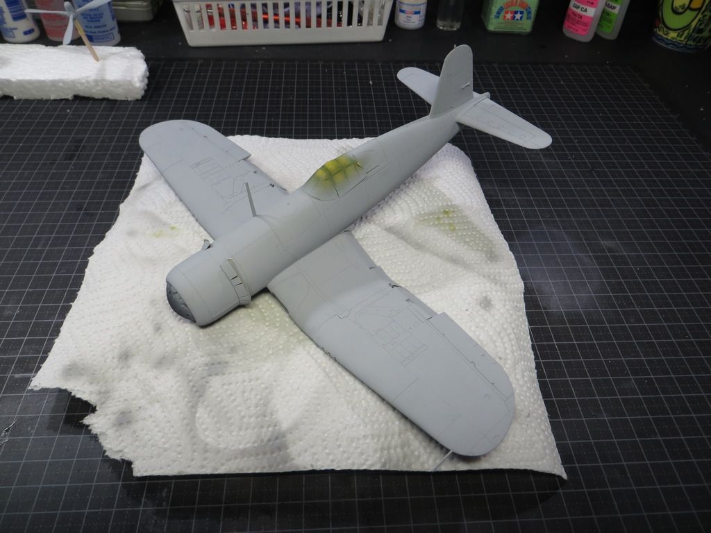

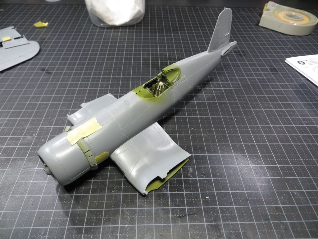

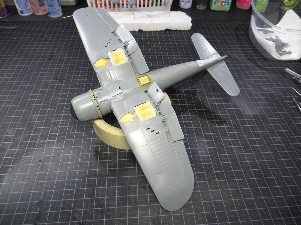

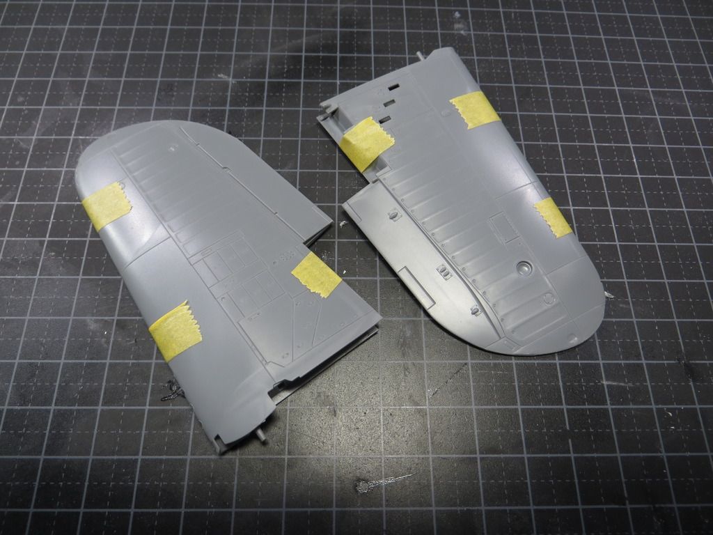

Masked up and ready for primer.

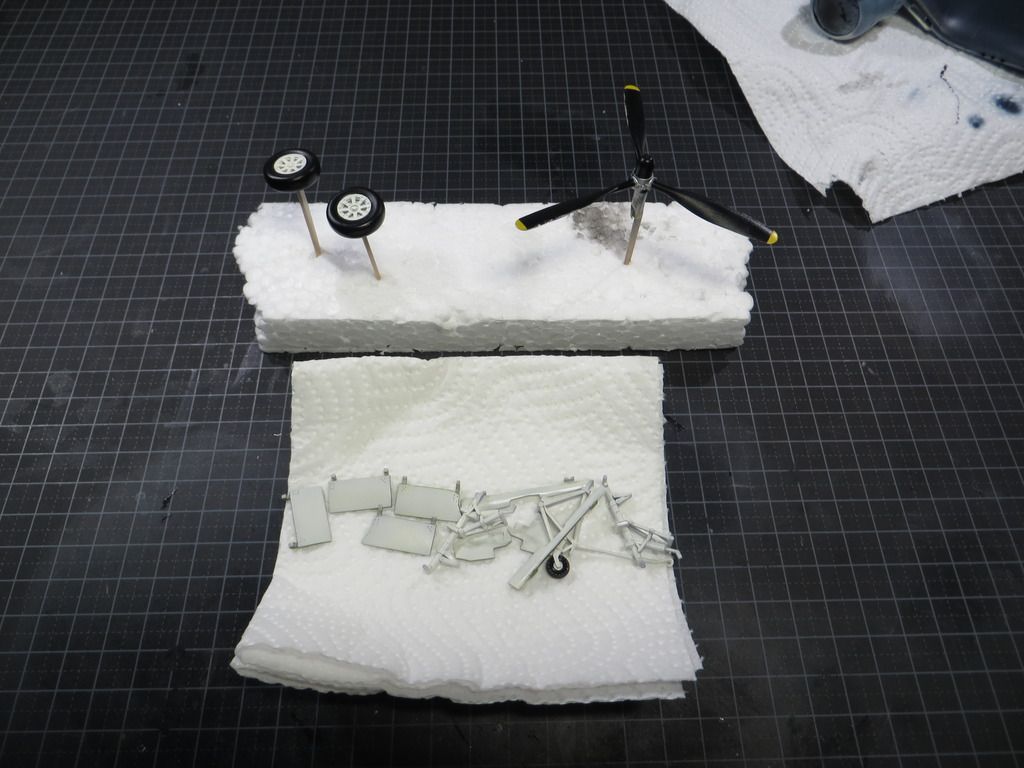

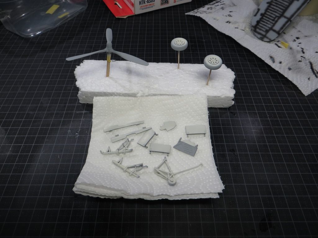

Some parts to be primed.
Inside colour of the canopy sprayed on.
Primed with AK Grey Primer.
To be continued...

Great stuff. The engine work is spectacular.

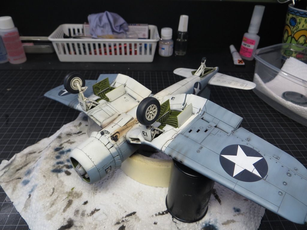

Update #4

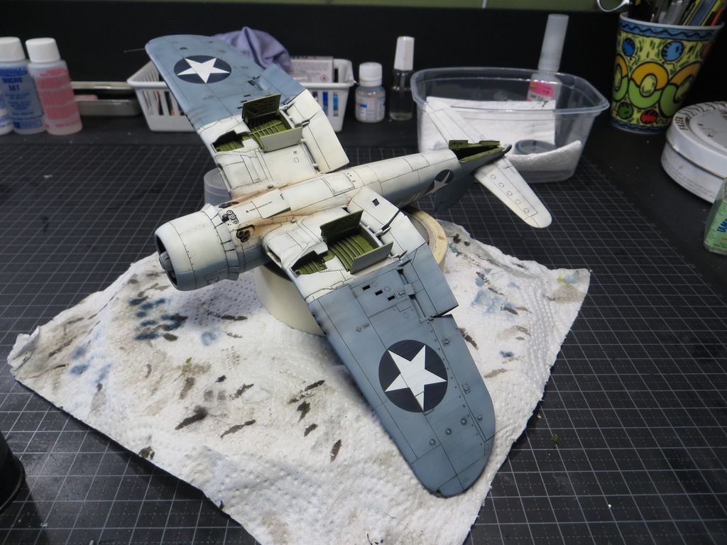

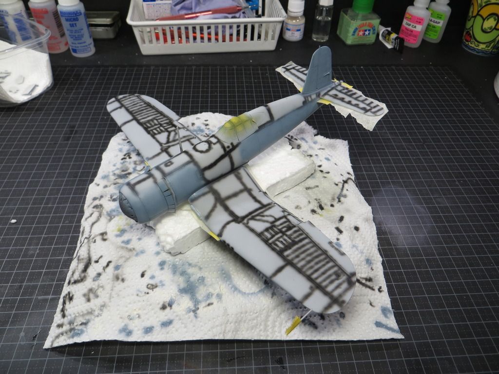

The painting stage has been a bit slow but my Corsair build is picking up speed at the moment. Only ten days left of the SiG, but I only got some weathering and a matt coat to do and this will be finished. :D

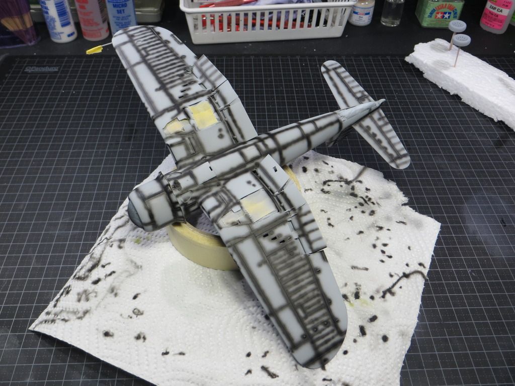

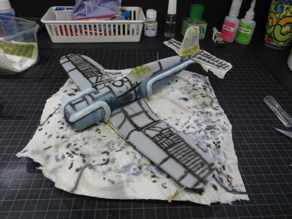

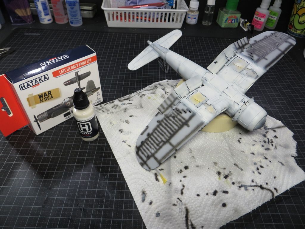

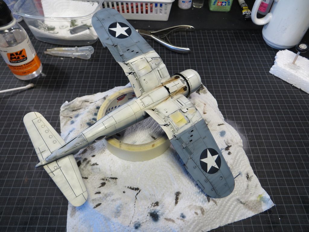

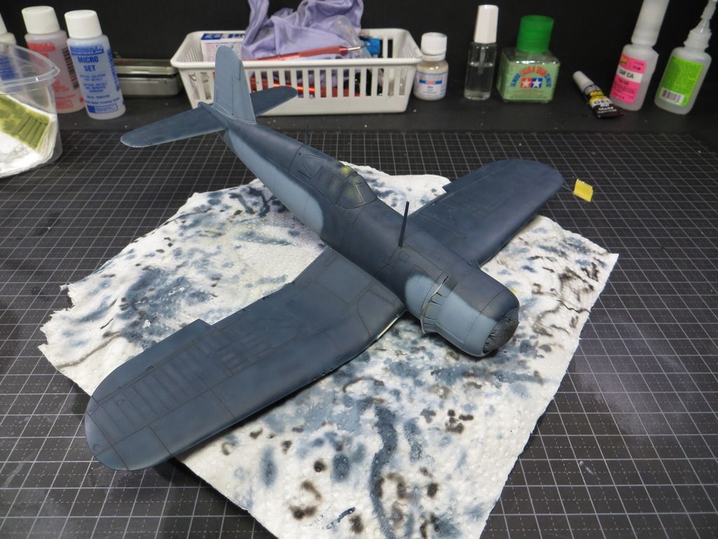

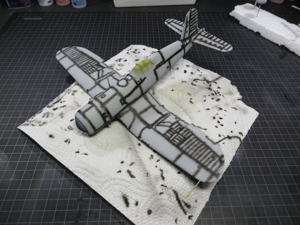

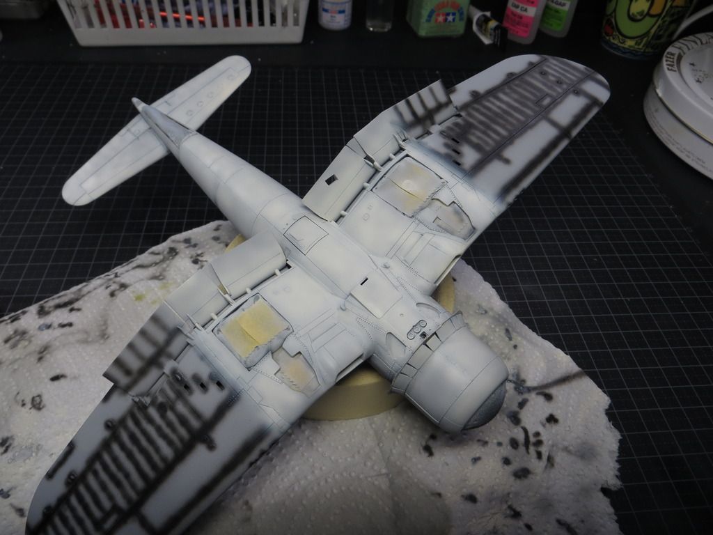

Pre-shaded using AKAN Black.-Great stuff!

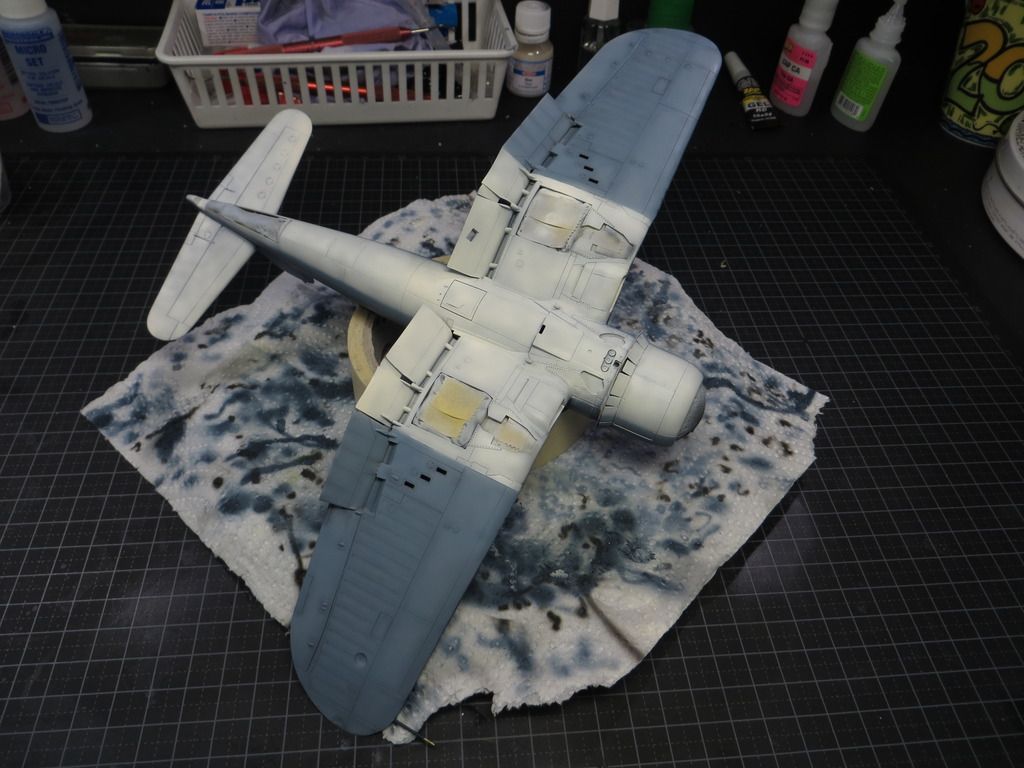

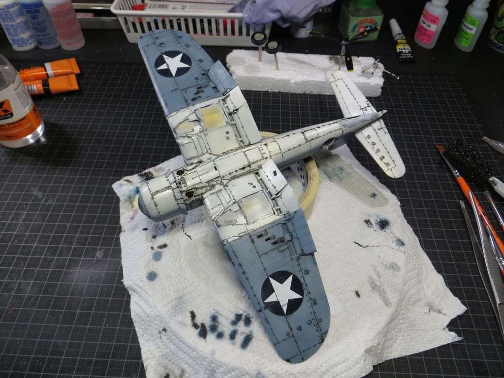

Underside painted using Hakata Insignia White. -From the US Navy Late paint set.
Hakata Intermediate Blue, slightly lightend mix.

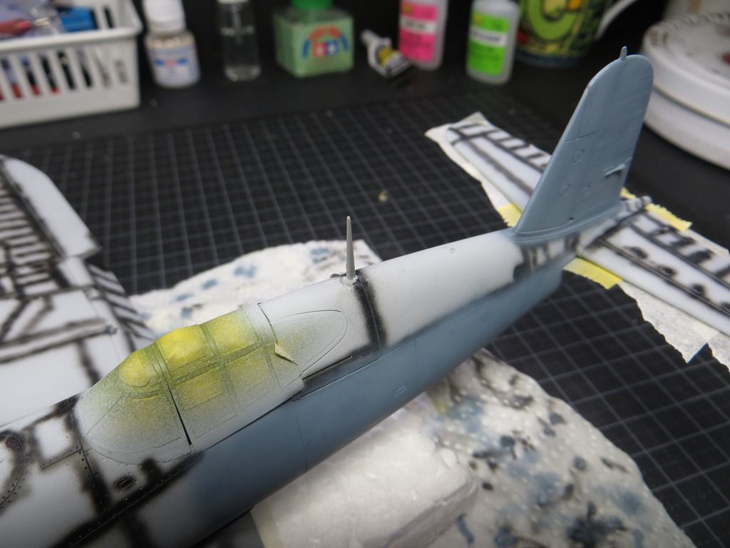

Then I suddenly stumbled across this pic:
You can see that this is the particular Corsair I am building. You can also see that it has got another mast behind the cockpit,
luckily, this mast was supplied in the kit but the instructions never told to add it, so I added it anyway.

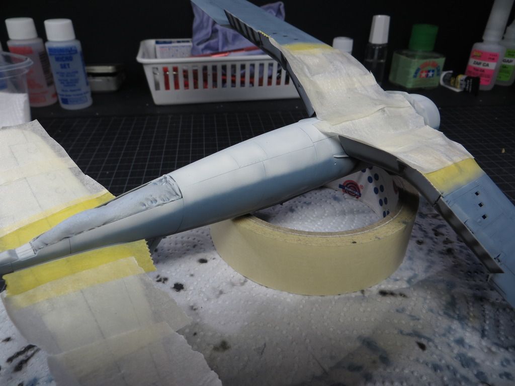

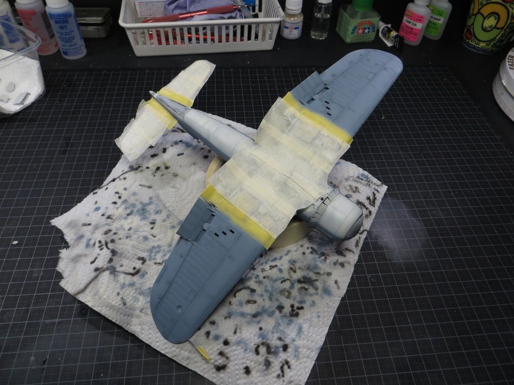

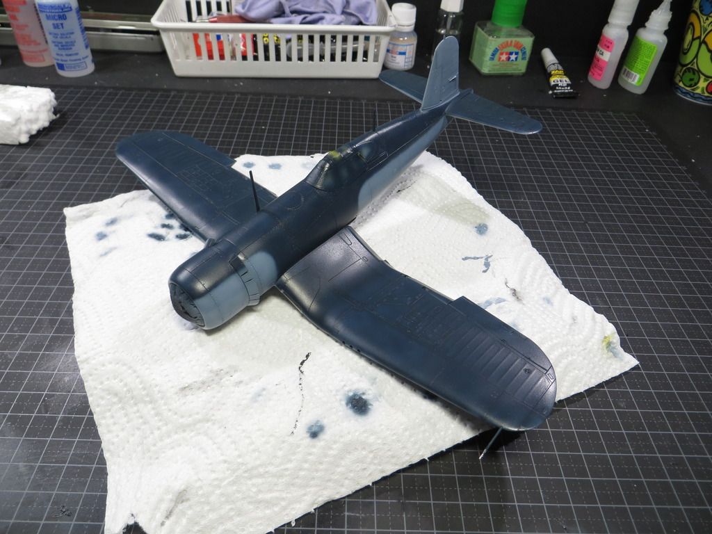

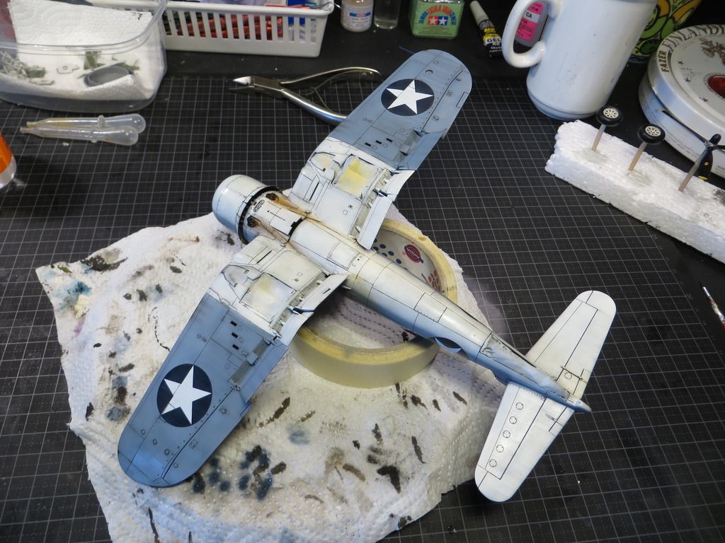

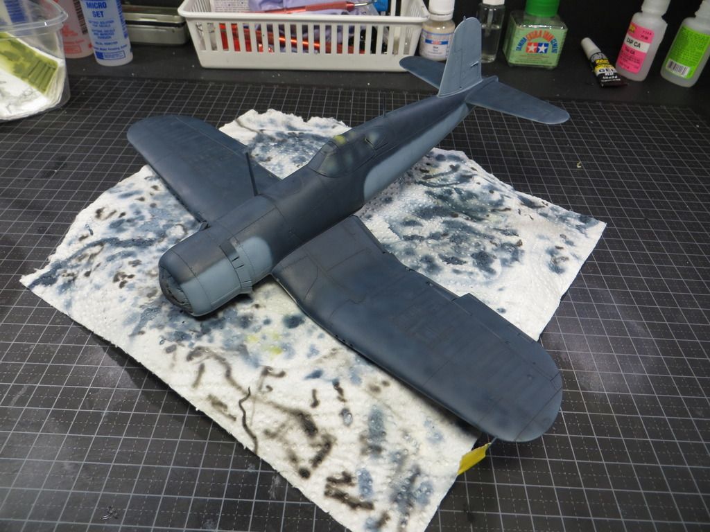

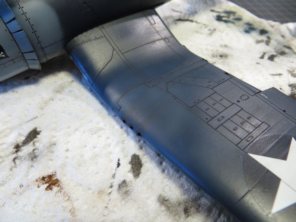

I first masked up the outline of the upper colourwith blue-tac to make it easier to get a better coverage on the paint.
After I sprayed the Hakata Semi Gloss Sea Blue on I then free-handed the edge between the semi gloss sea blue and the intermediate blue
to make a soft edge. This took many tries but now I am happy with it. :)

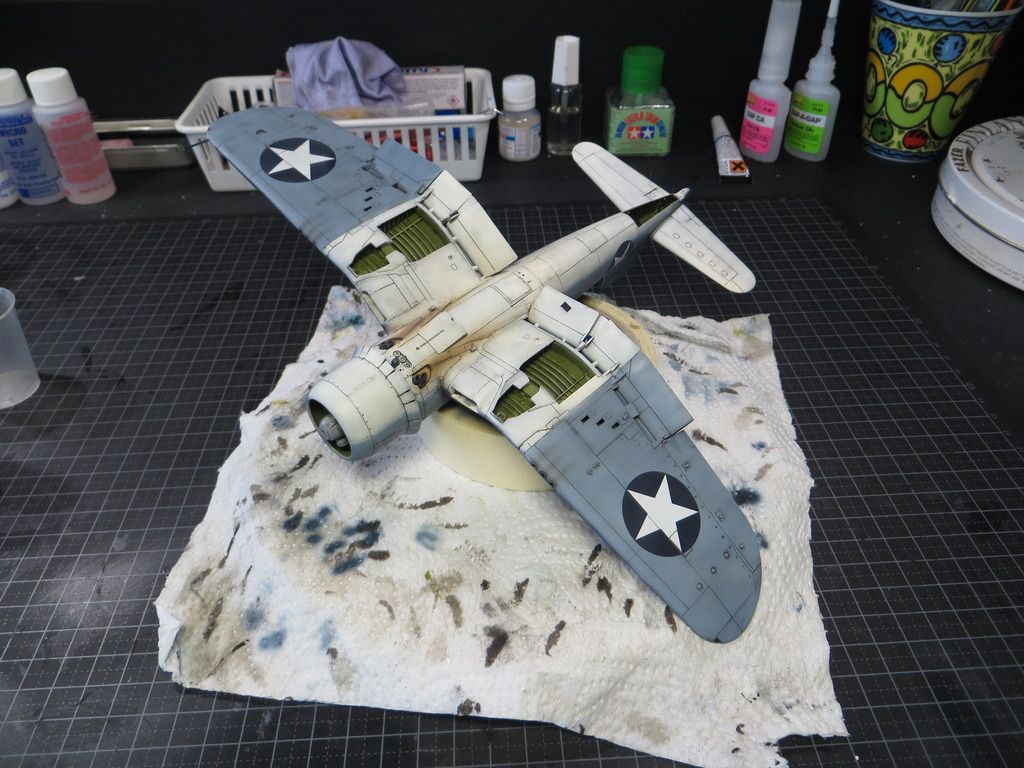

Underside unmasked.

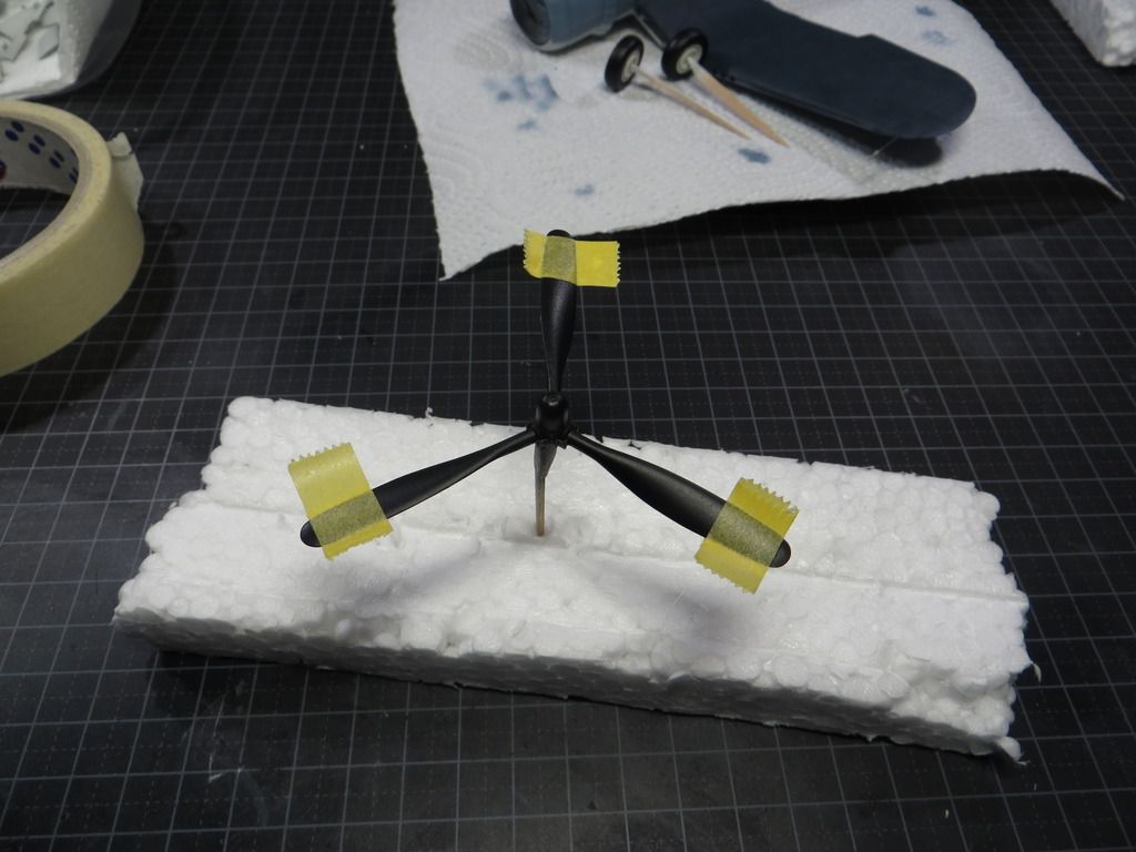

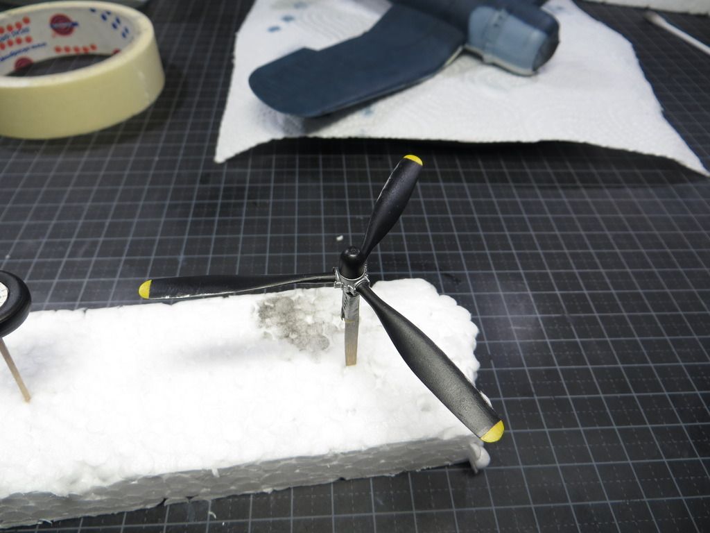

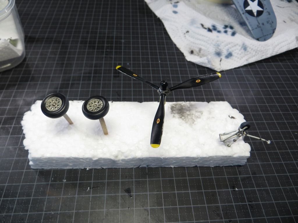

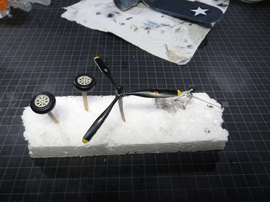

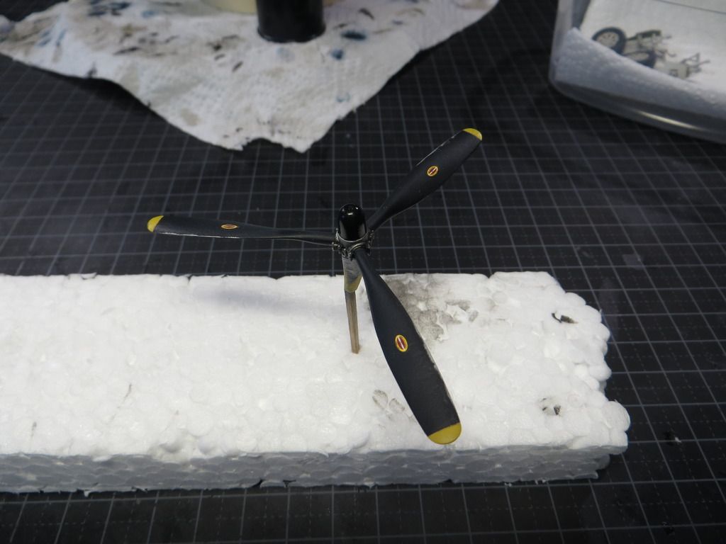

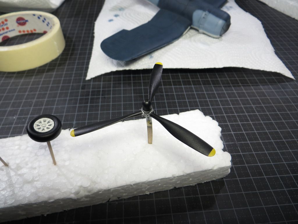

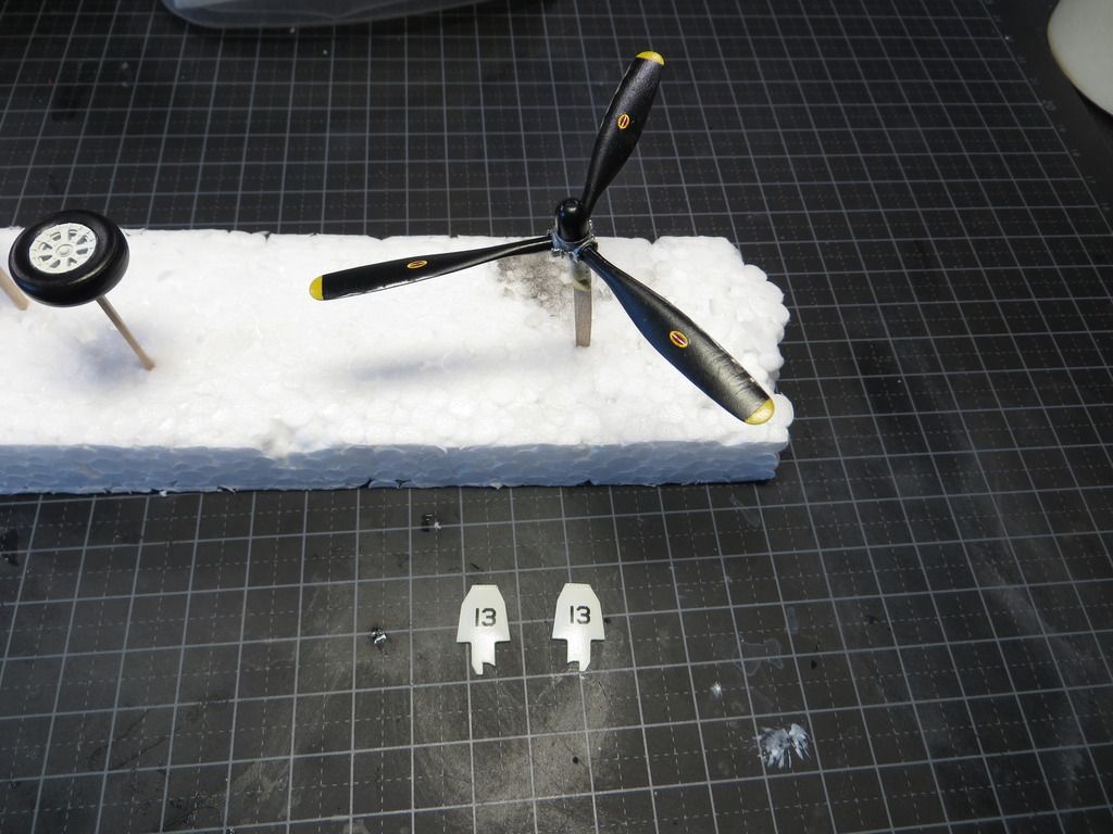

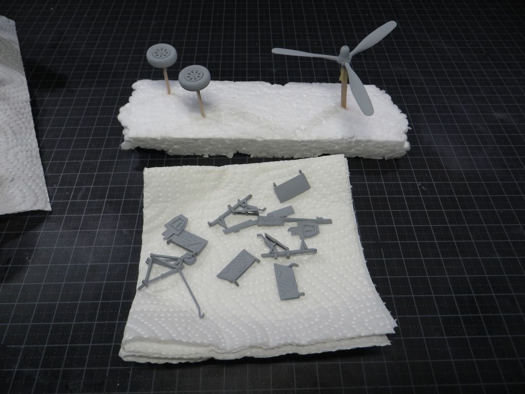

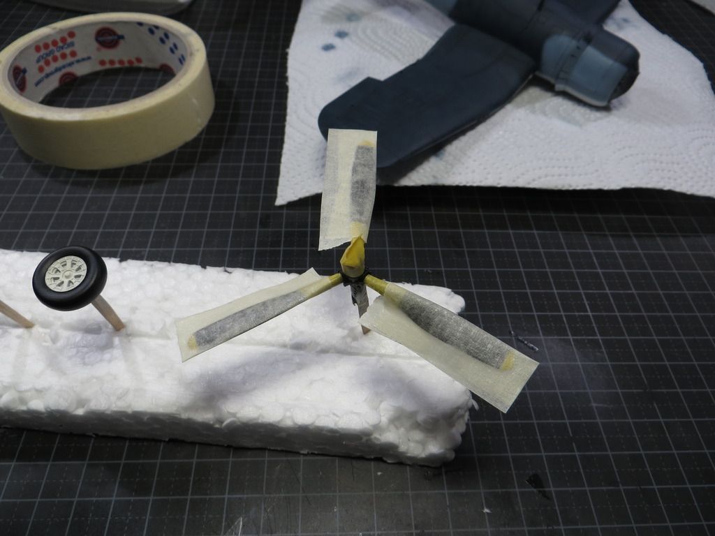

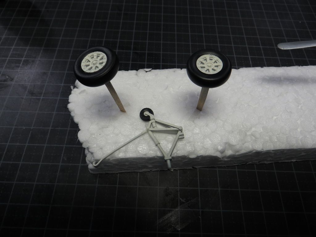

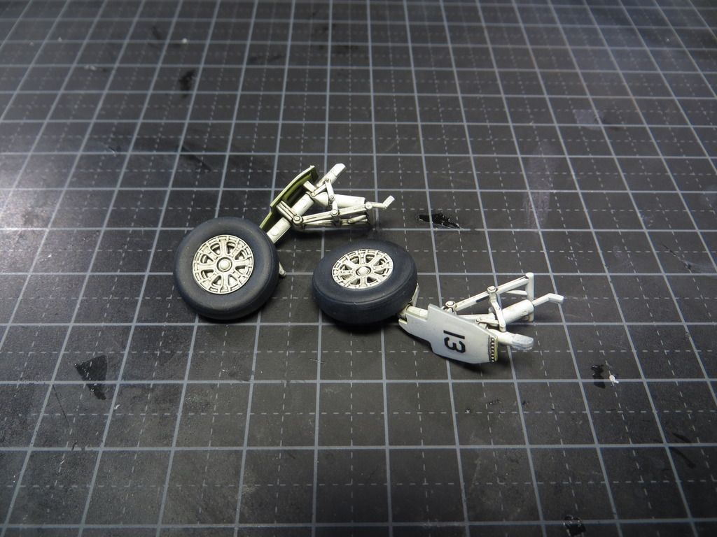

Some other bits'n bobs painted.

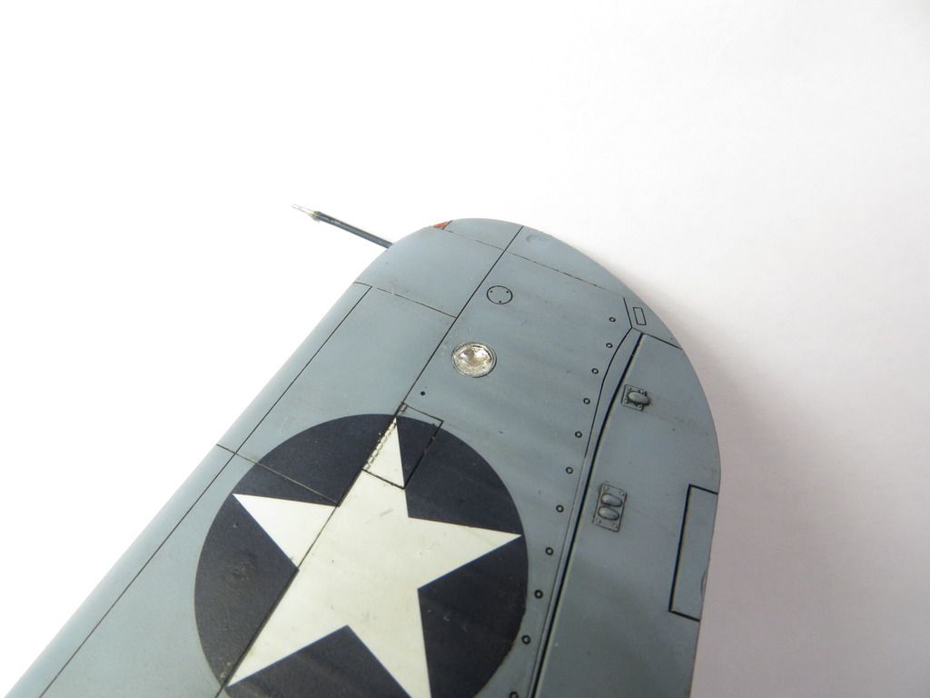

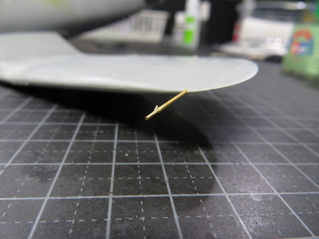

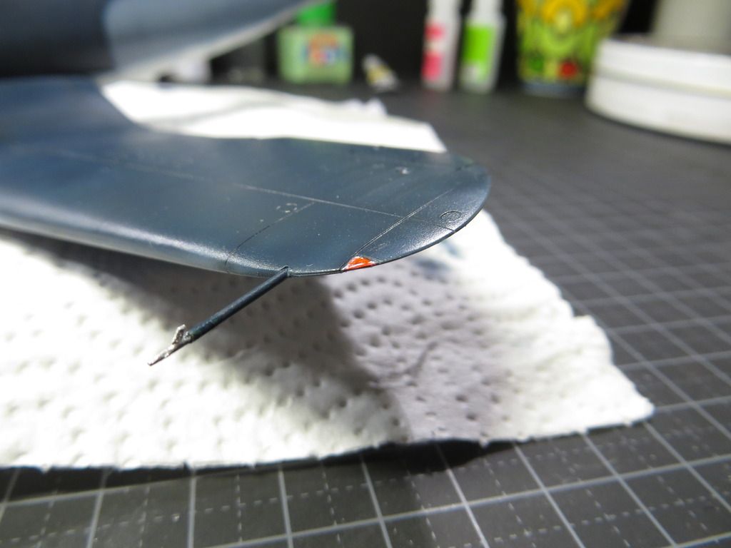

I decided to improve the pitot-tube a bit based on pictures I've seen.

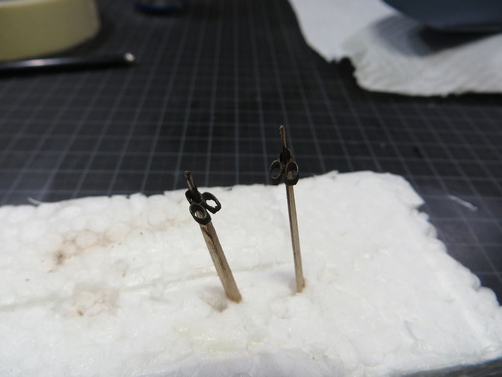

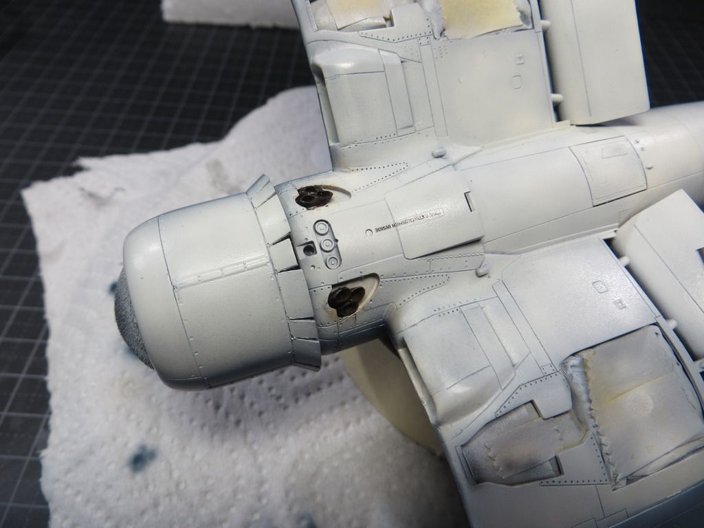

Exhaust painted.

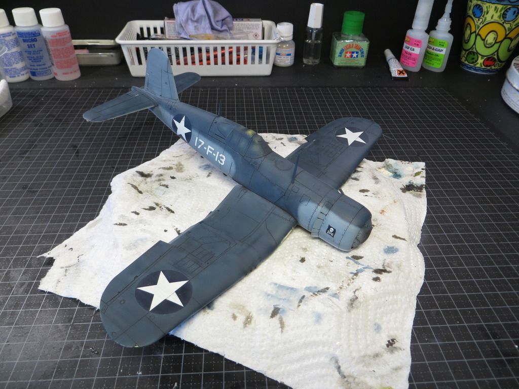

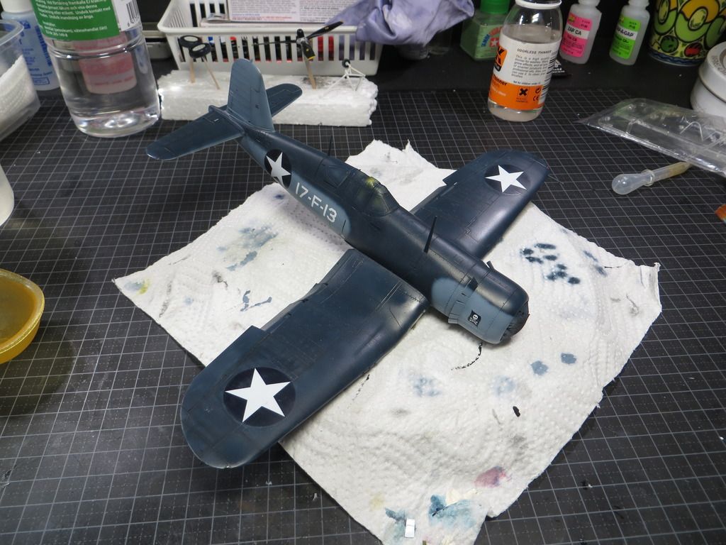

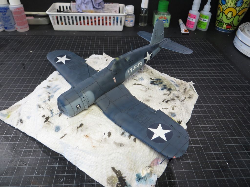

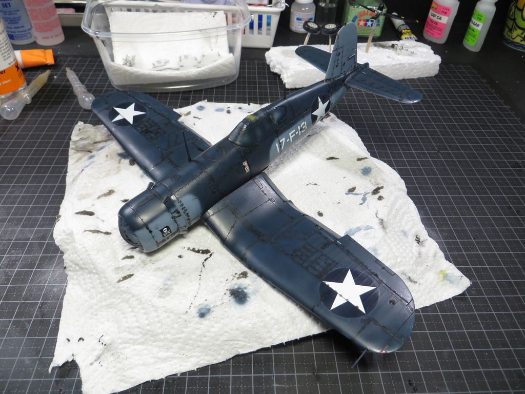

Gloss-coated using Alclad Aqua Gloss.

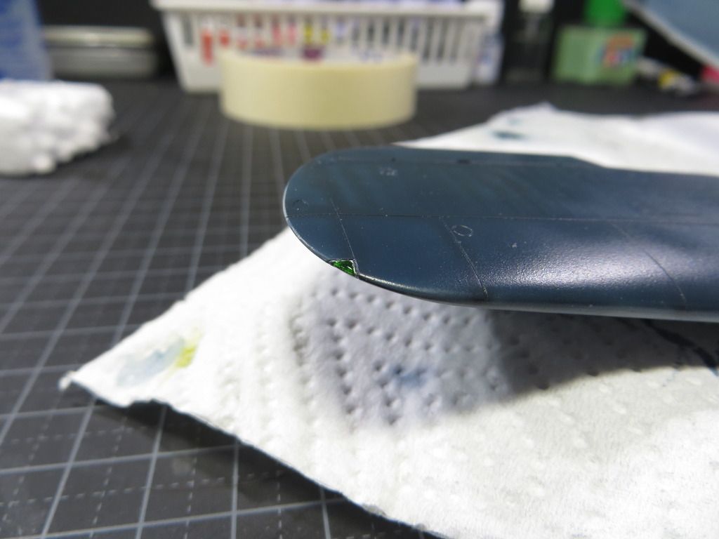

Wing position lights painted.

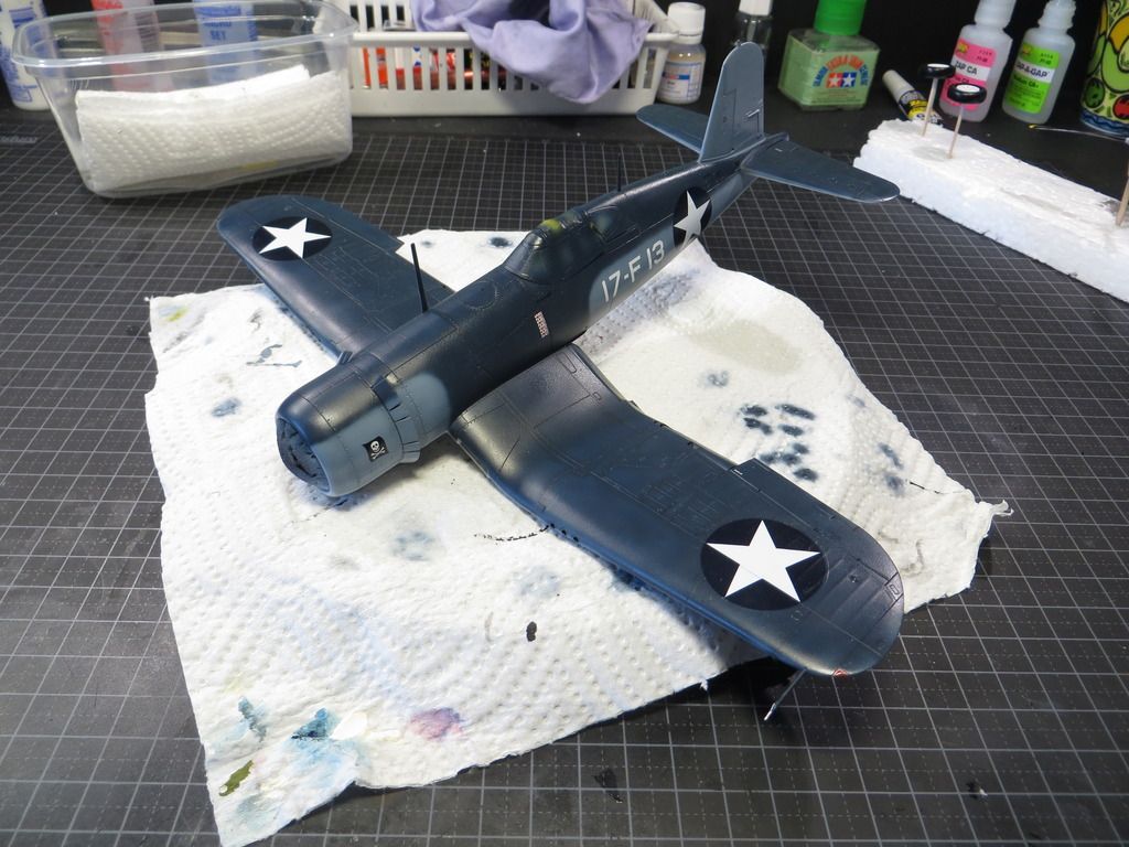

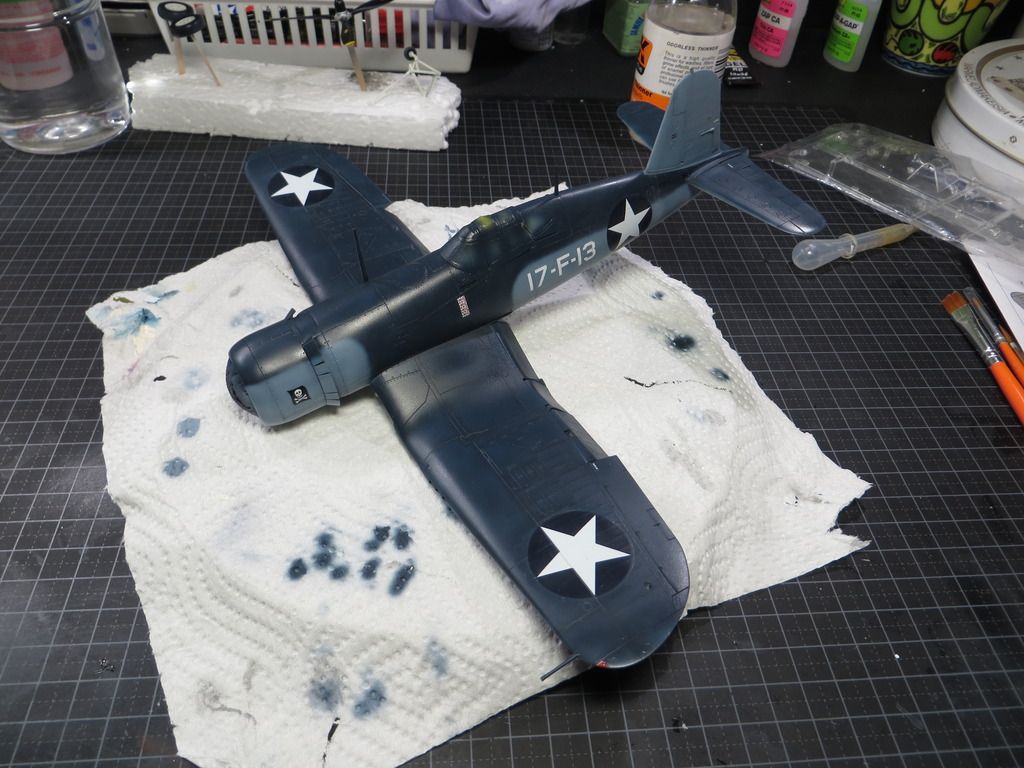

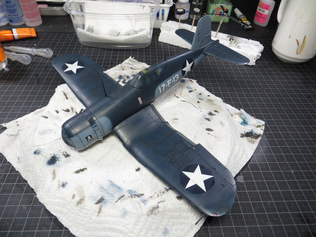

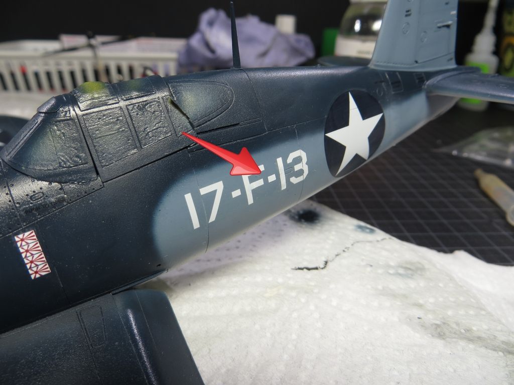

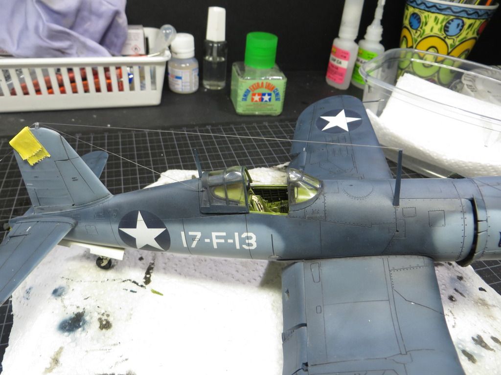

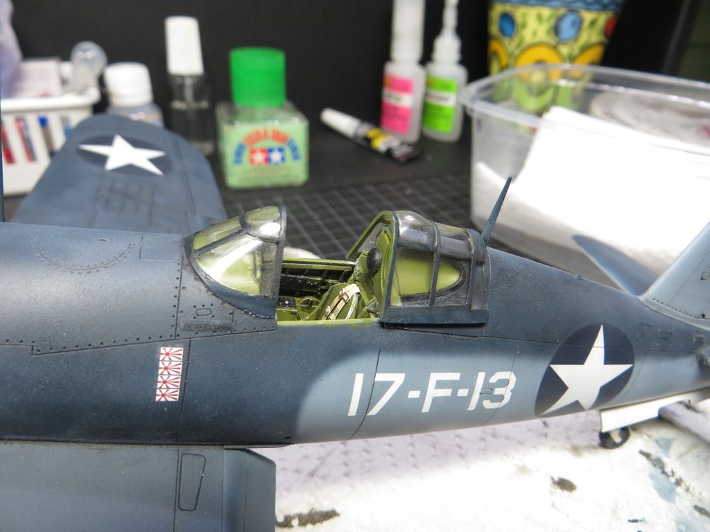

Decaled. I had to fix some broken decals on two places, so I'll blame it all on the quality of the Tamiya decals. :bash: :shifty:
Exhaust attatched.
Last update and final reveal next week. Stay tuned!

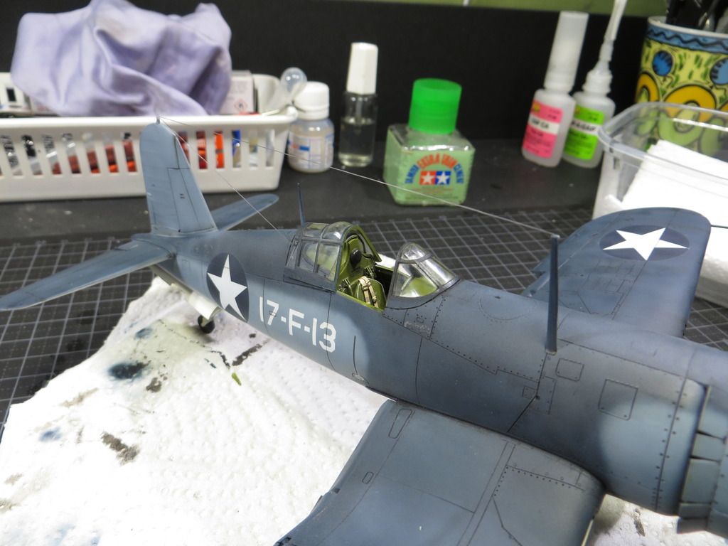

Lol! I forgot to add this little stripe between the F and 13. :lol: After the decal broke I had to fix it but forgot to fix this stripe. :wall:
Totally my fault. No worries, it's a easy fix.

Looking great mate. How did you find those paint? I used them on my Cosair and I found them not the easiest to get on with.
planemaker
Posts: 375
Location: Finland
Re: Planemaker's Birdcage!
Post by planemaker »
Nige201980 wrote:Looking great mate. How did you find those paint? I used them on my Cosair and I found them not the easiest to get on with.
Thanks Nige!
I found the Hakata paints quite OK. I though had some problems getting the semi gloss sea blue to spray well enough to free-hand the soft edge
between the sea blue and intermediate blue. But I finally got it right using my H&S Infinity equipped with a 0.4 needle, one drop of Ultimate thinner
Thanks Nige!
to about five drops of paint and the pressure at 25-30 psi.
Hope that helps!
Cheers! :cheers2:

Update #5
Final update today! I will post the pics in the final reveal section, be sure to check them out. :D
Final Reveal: http://www.intscalemodeller.com/viewtop ... 66&t=13393
I did a little filter on the decals using Mig oils to tune them down in brightness a bit.
Then I did a pin-wash using Mig oils again.
And then cleaned up.
I made exhaust and gun stains using pigments.
Matt-coated with Vallejo matt varnish.
Landing gear bays unmasked.
Landing gear bay doors attatched.

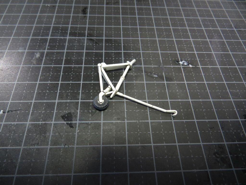

Landing gears assembled.
The rear landing gear was moulded as one piece.

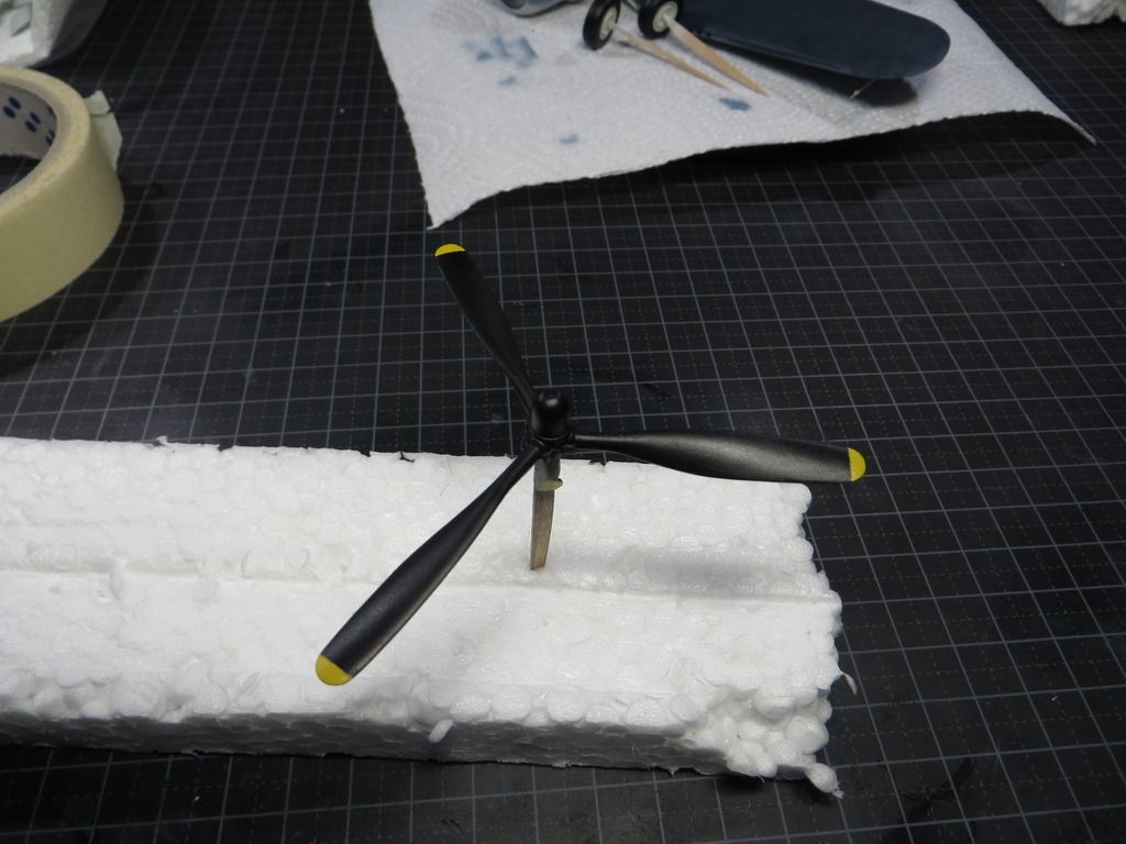

Finished propeller.
Landing gears attatched.
Canopy unmasked and glued in place.
I made the antenna wires using coloured fishing rod. I used masking tape to get the tension and CA to glue them to the antennas.
After the glue dried I cut off the excess and removed the tape.
I made the light or whatever it is under the wing using a piece of aluminium foil. The clear part was supplied in the kit.
