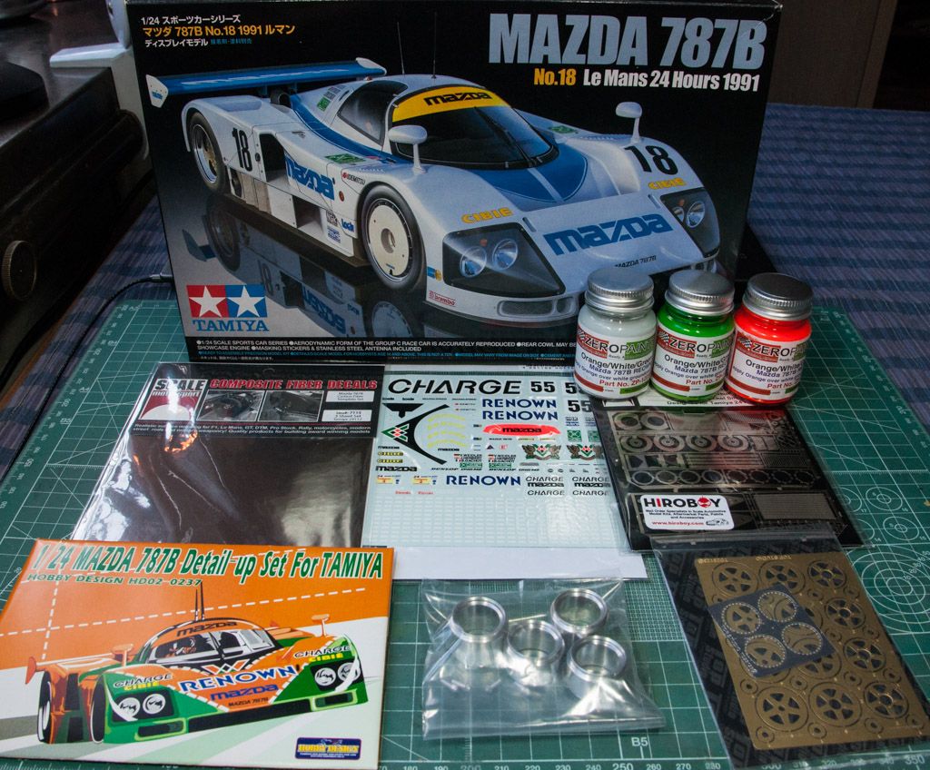

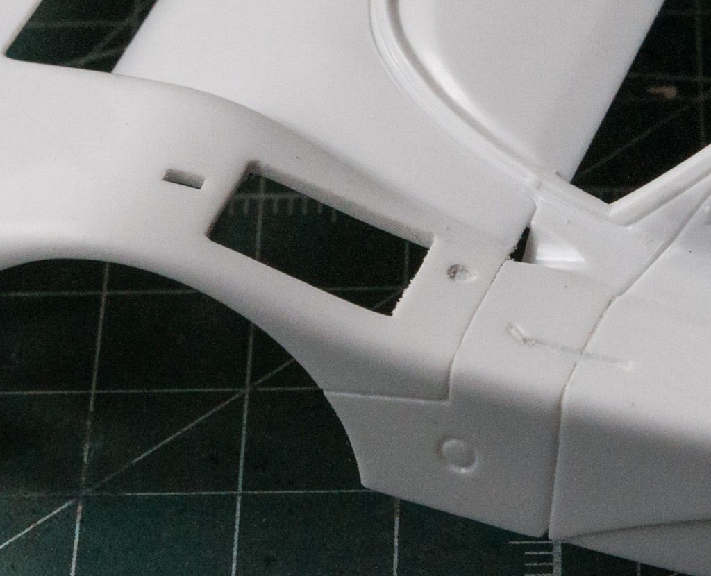

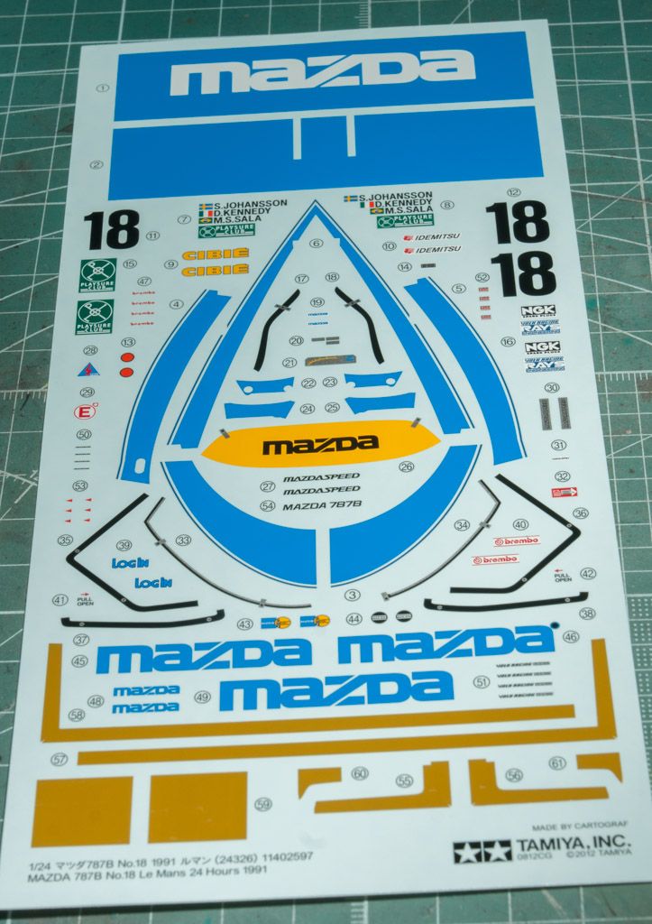

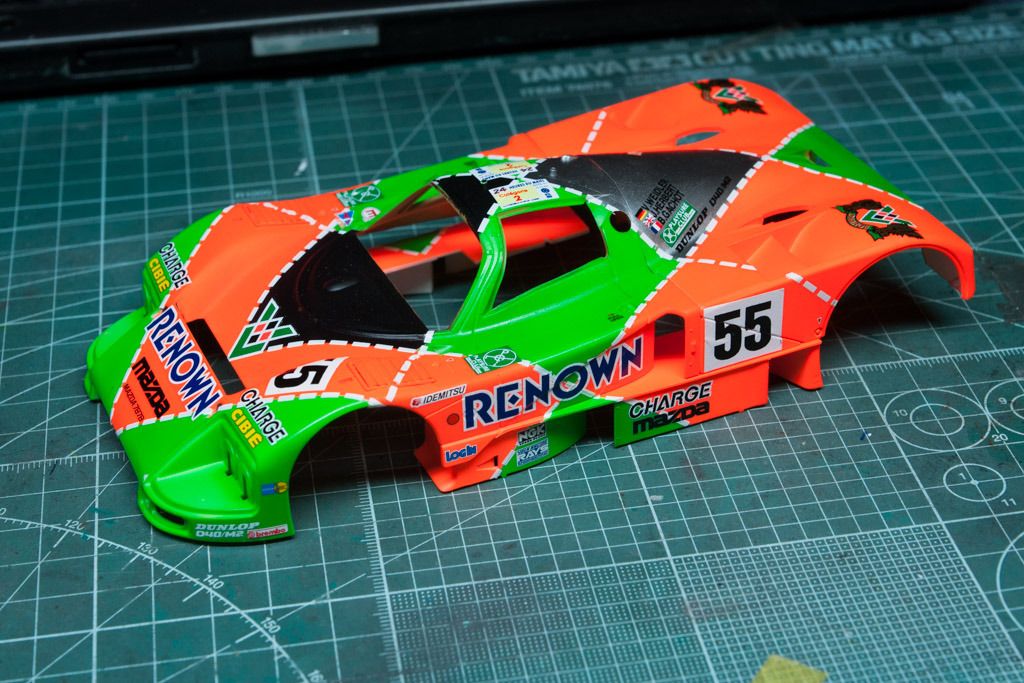

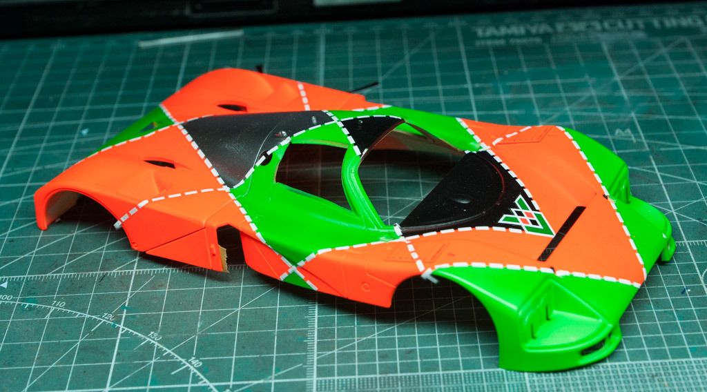

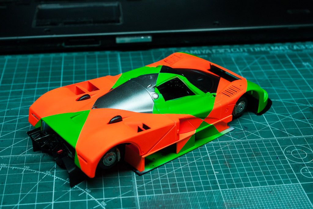

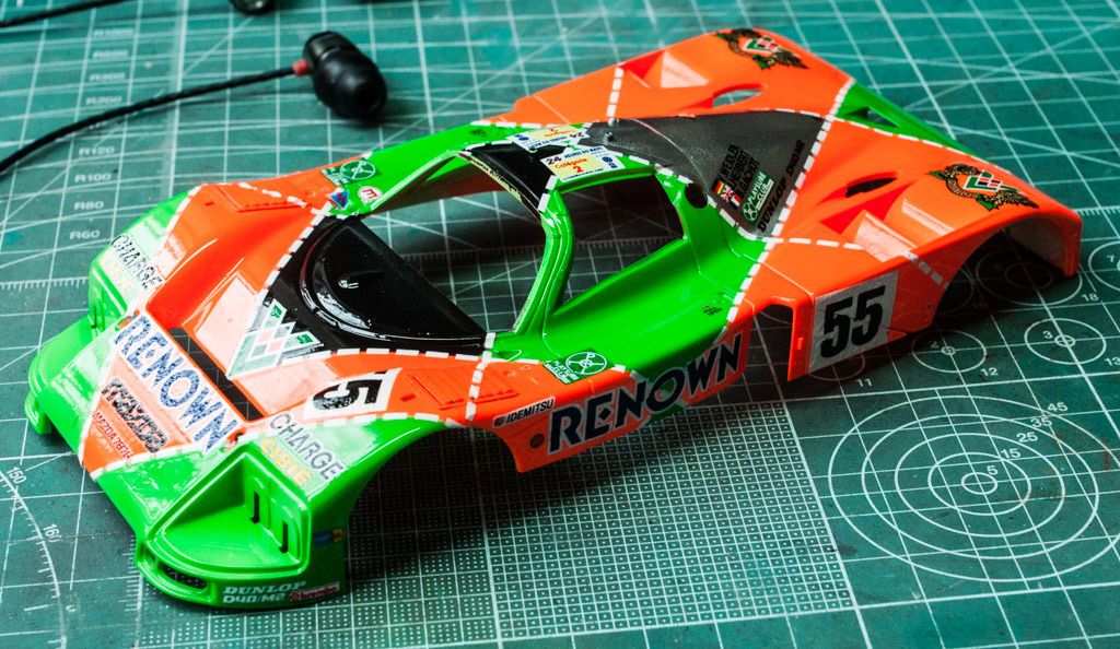

The plan is to do a pretty detailed Mazda 787B, as I have already done the white/blue #18 car this time I will go for the LeMans winning #55 (the only Japanese car winning LeMans). Also got the Top Studio turned alu and etch wheel set, Scale motorsport PE and carbon decals, Hobby design detail set and MSM declas.

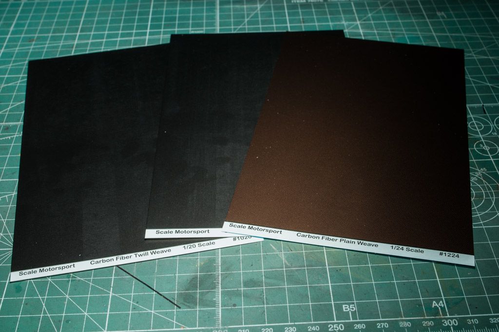

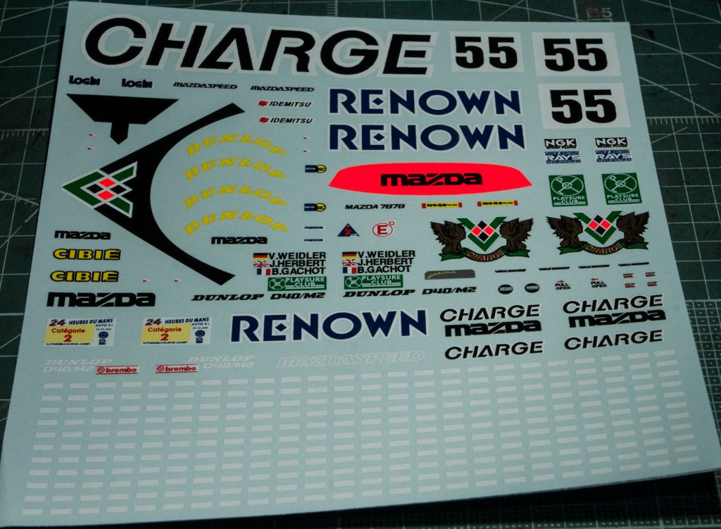

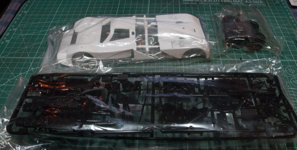

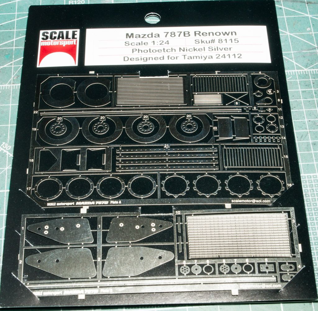

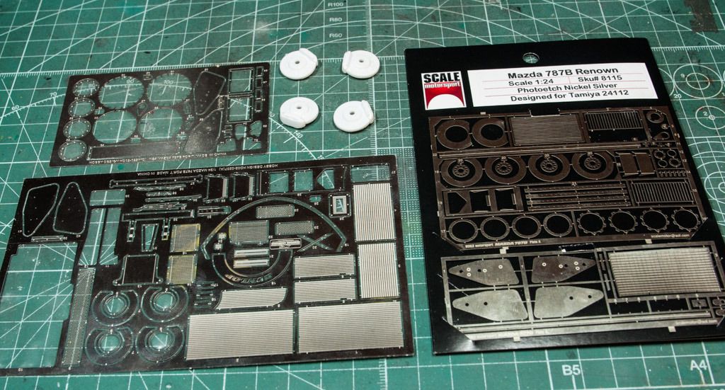

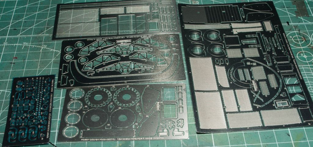

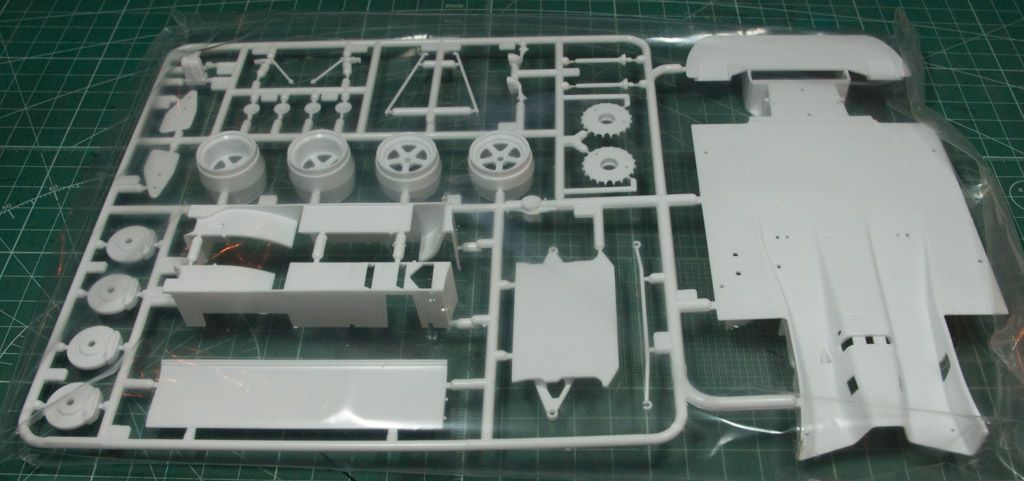

Wile waiting to start I did a short review of the kit and the aftermarket parts here http://intscalemodeller.com/viewtopic.php?f=98&t=10531

for cutting strips that are uniform width i've seen some guys rig up a two-blade scalpel setup. they put a spacer between the blades to set the width of the strip.

Wholy cow what a a build
That is a ton of aftermarket stuff

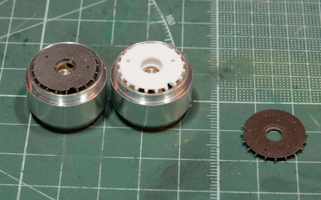

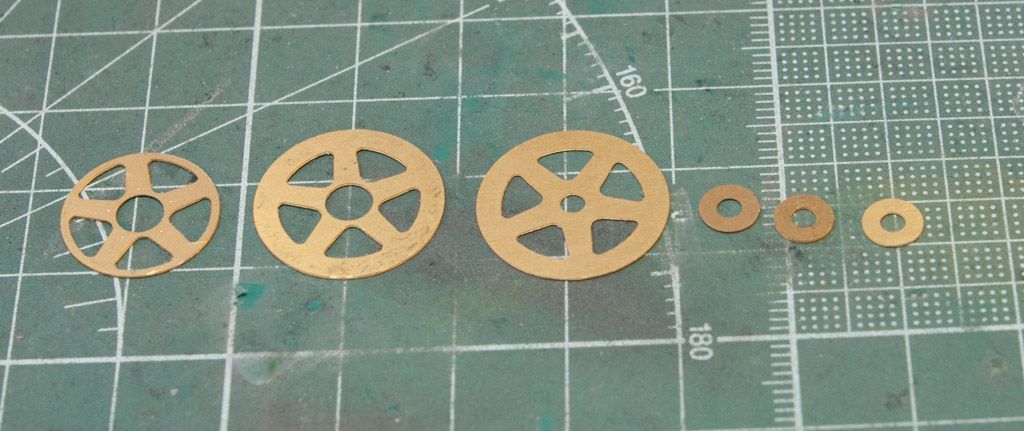

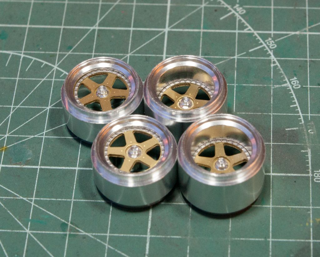

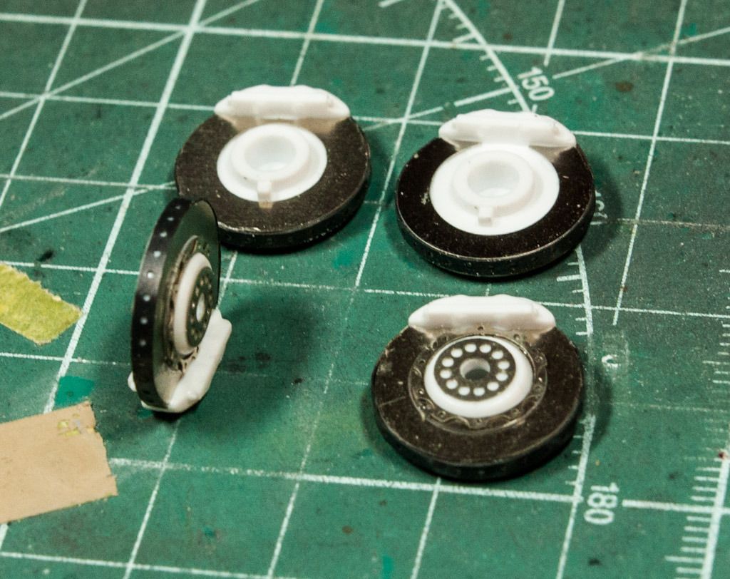

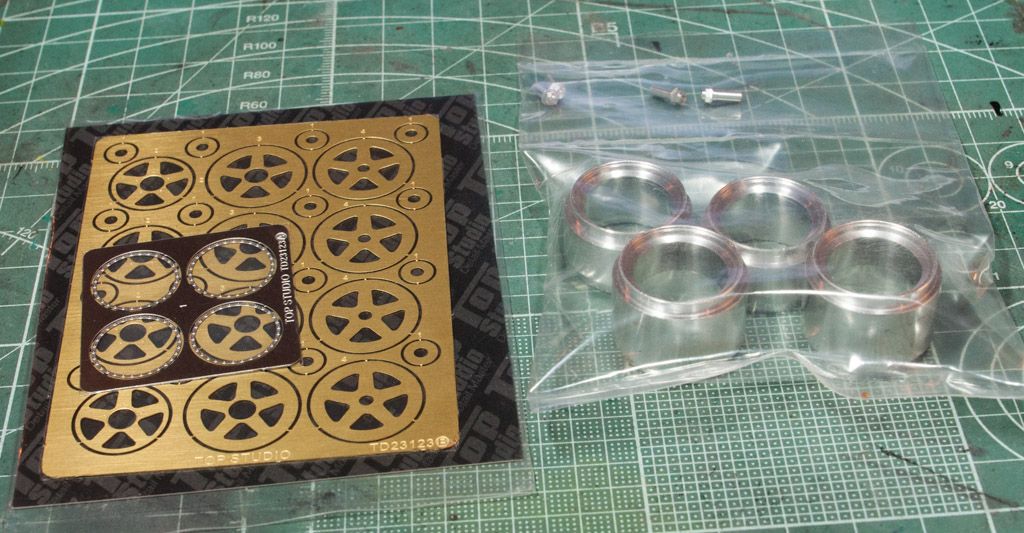

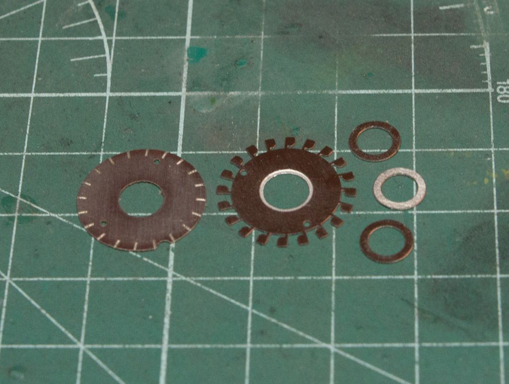

Started building the wheels yesterday, went together without any problem and looks better then the kit ones. Still need to add some details like a pin wash and air valves.

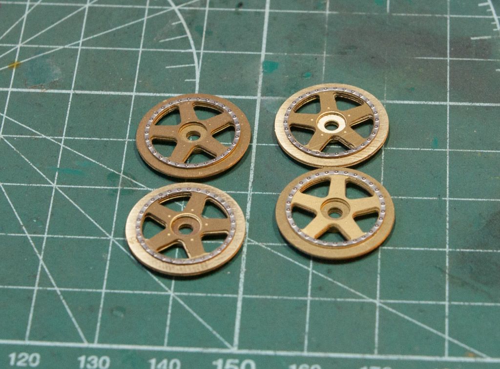

Started with six gold colored PE parts that needs to be stacked.
Glued them together with CA glue. I used rod in the center hole to line up all the parts. Also added the PE part with the bolt heads.
Centers in the turned aluminium rims and the wheel nut. The nut still needs a bit of paint.

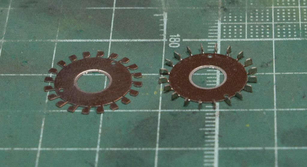

The front wheels have a aerodynamic cover that is a bit thick in the kit. So I'm using a PE one from the Hobby Design kit.
Started folding (or twisting) the fins 90 degrees using tweezers.
All assembled, I might change the three small PE rings to a tube as I think it's a bit too short and the layers of PE will be a bit too easy to see.
Test fitted on the rims, the fit is really good, almost don't need any glue to hold them in place.

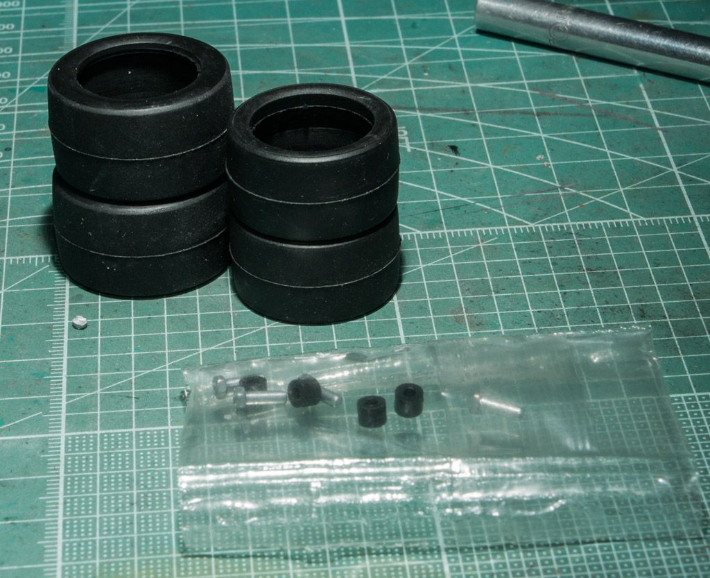

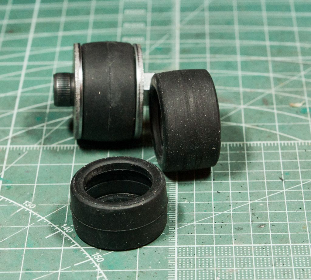

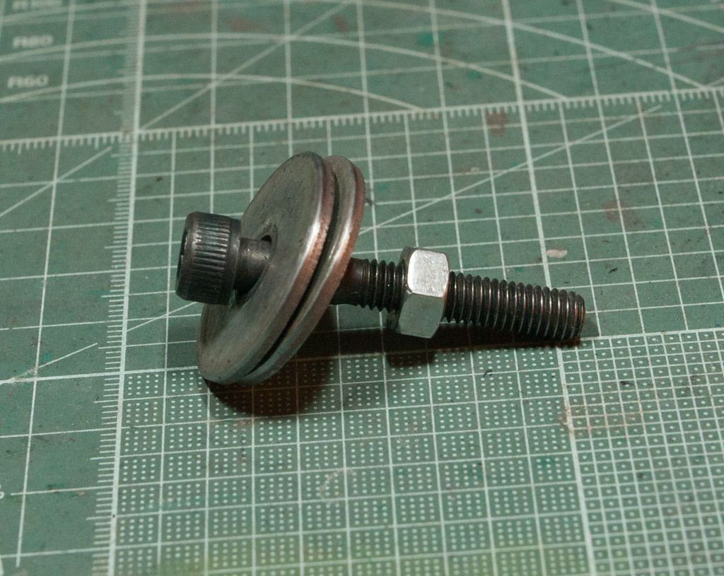

For the tires I used my normal method of using a M6 bolt, nut and two large washers to hold the tire in a cordless drill.
And then sanding the mold seam using a white thinny stick.
The tires on the rims, still need to paint the Dunlop logos on the tires and maybe some other markings as well. The fit on the rims is a lot tighter then on the Tamiya ones and pretty much perfect.

Thanks, yea the SMS carbon templates sets can be a bit bad ill fitting from time to time. Not sure ow much of it I will use or if I just make my own templates, saw that the carbon pattern for the interior is wrong.

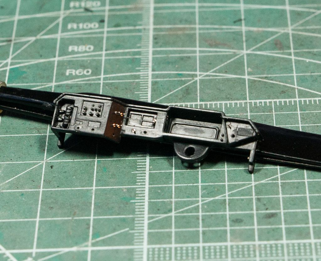

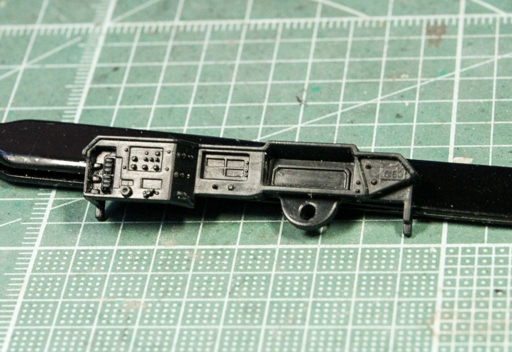

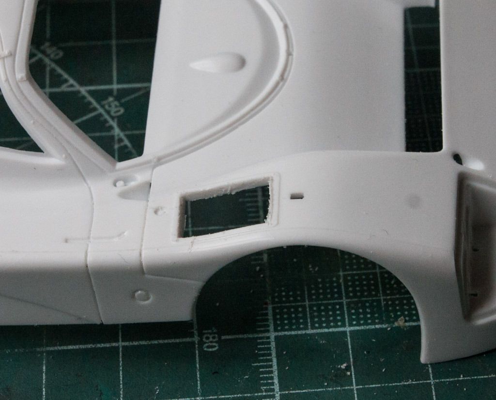

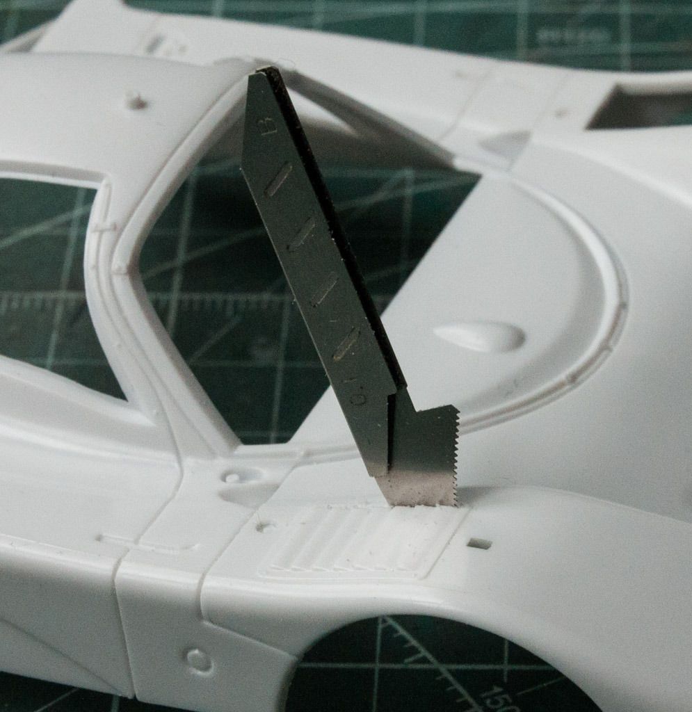

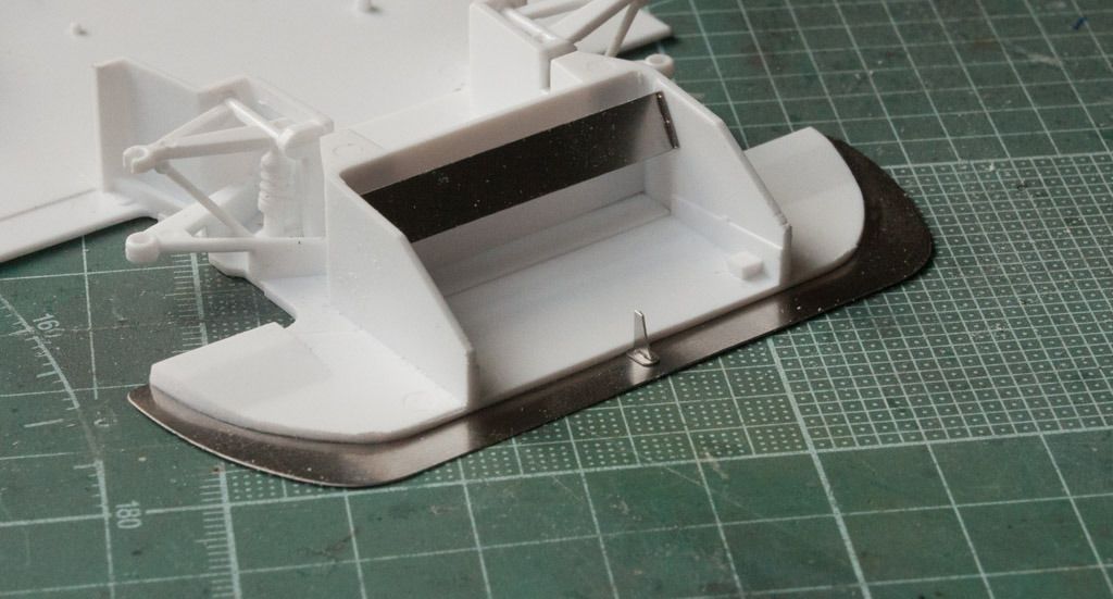

Have started removing the molded in details so I can replace them.
Started with the dashboard, a lot of switches to remove.
Some of the switches removed and turned aluminium ones from Top Studio test fitted. Will need to order some more different ones as well.

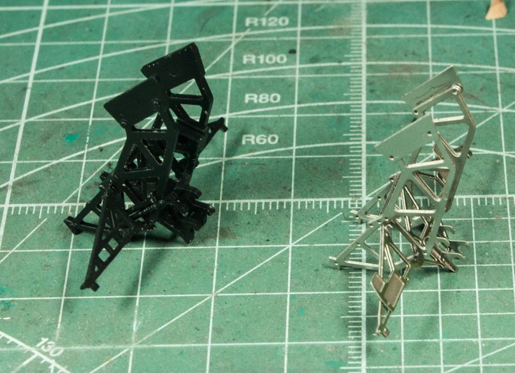

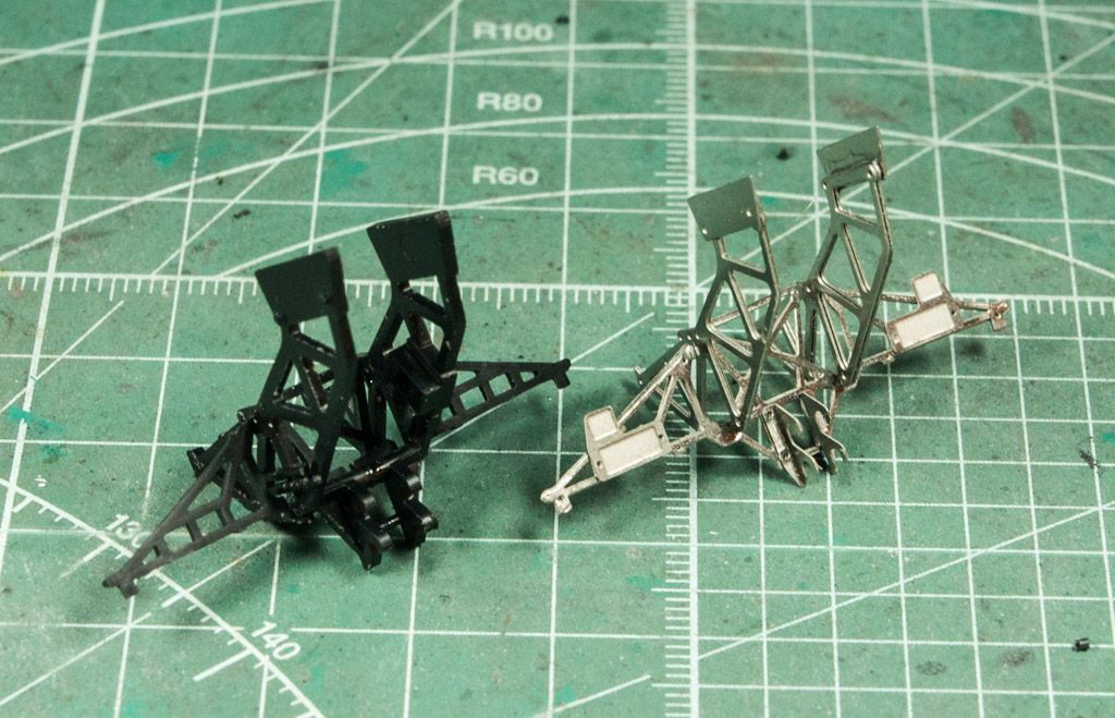

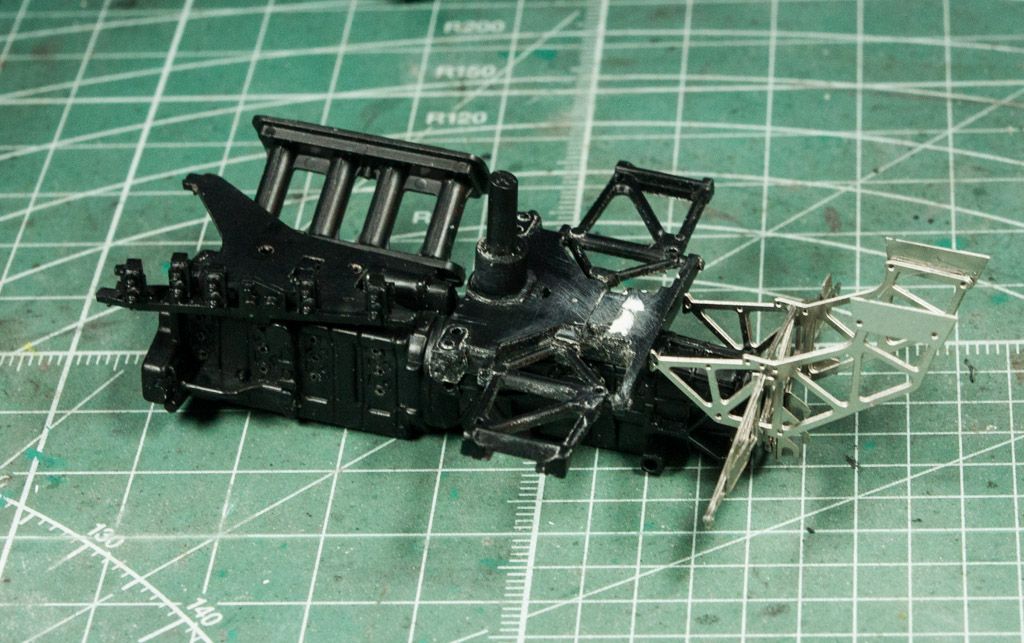

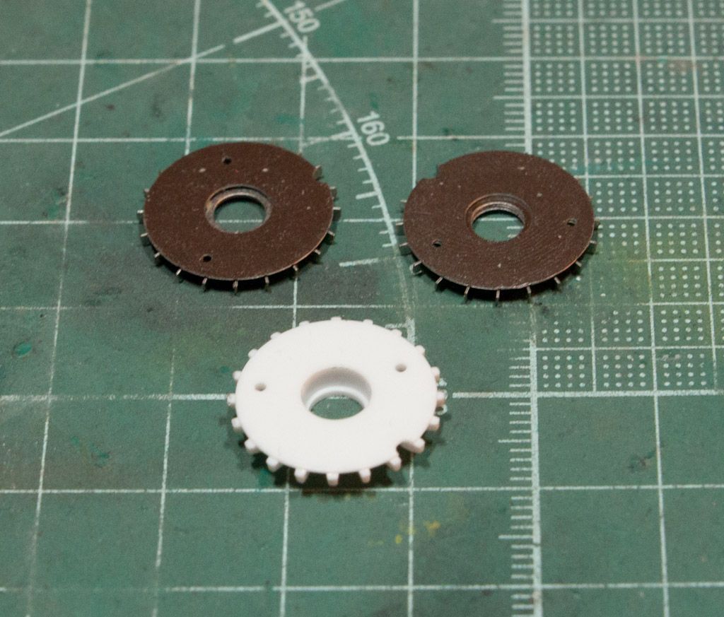

The rear jack point and rear wing mount from the kit and the new PE one, the PE one is still missing some details like bolt heads.
Test fit on the engine, have also removed the rear anit-roll bar. I'm thinking of cutting off the ignition coils as well to make it easier to carbon decal the plate over the engine.

Amazing looking project - I love the wheels and a very nice start. good luck with all that p.e.

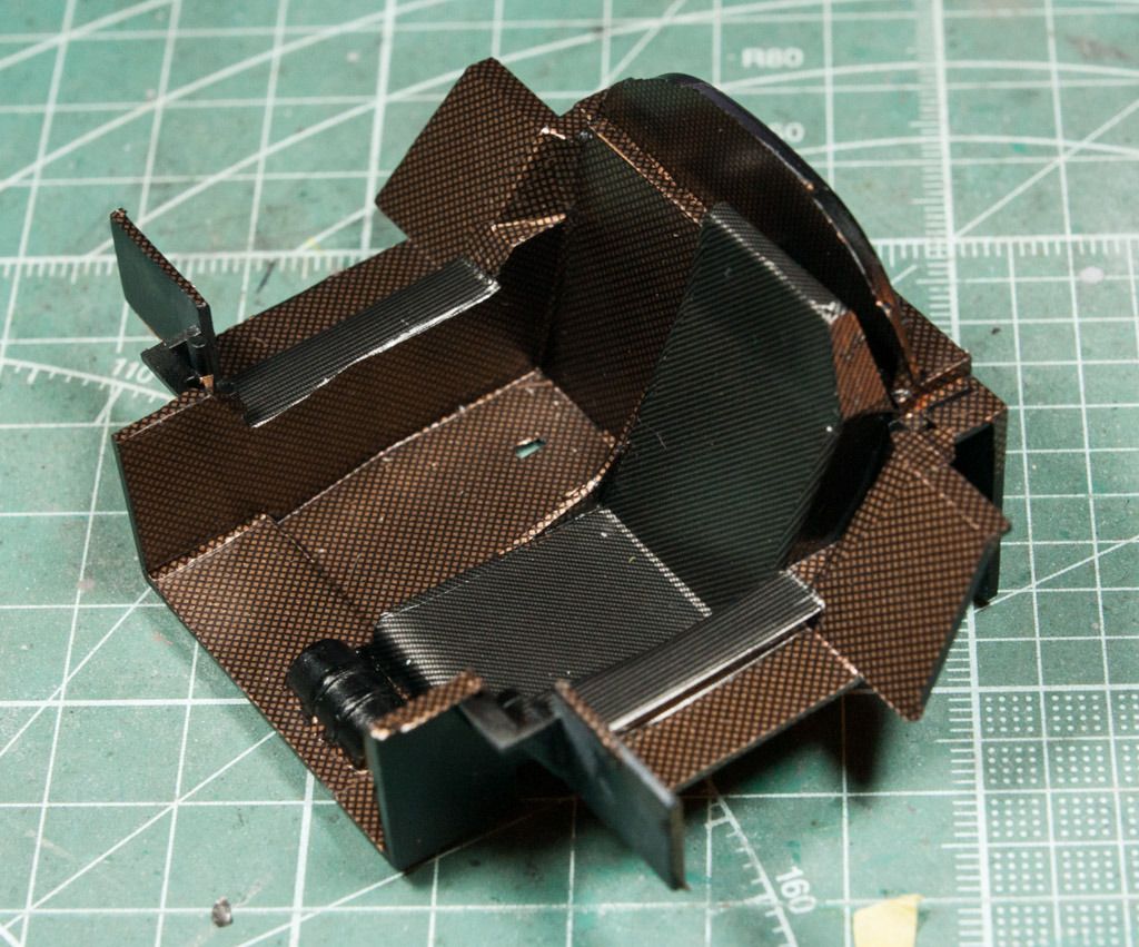

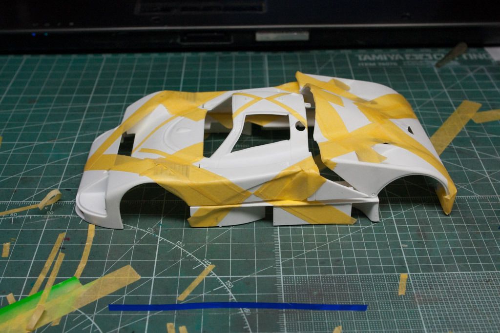

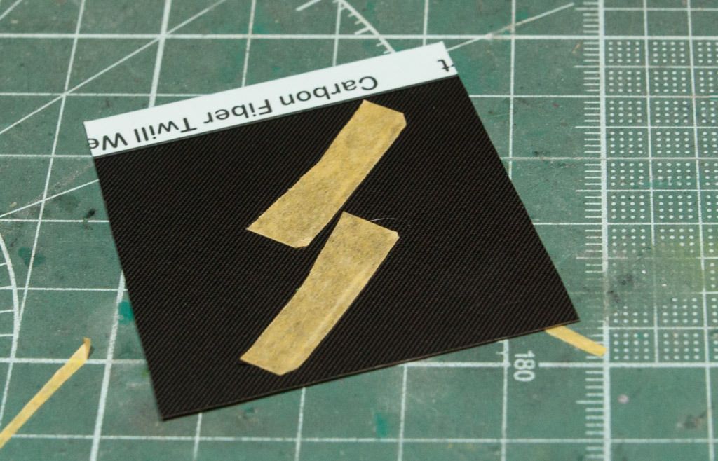

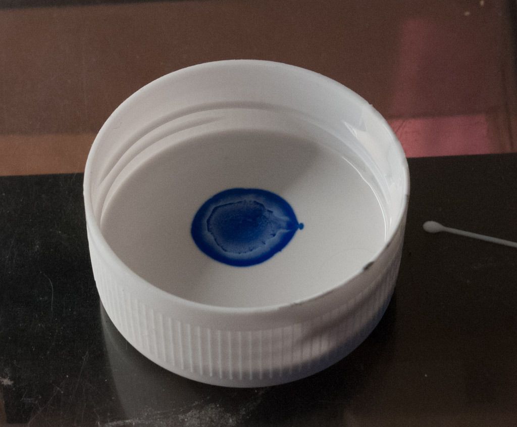

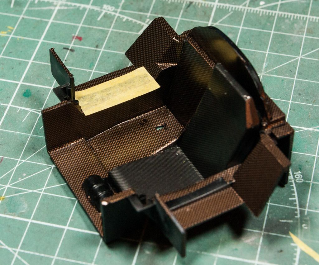

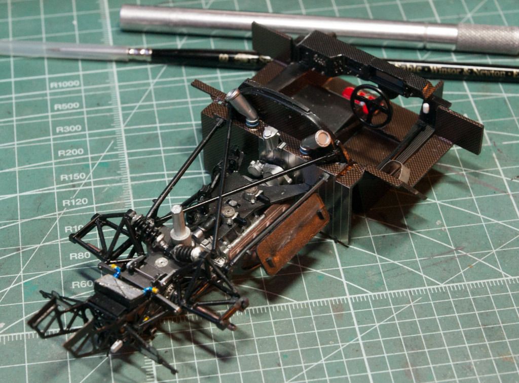

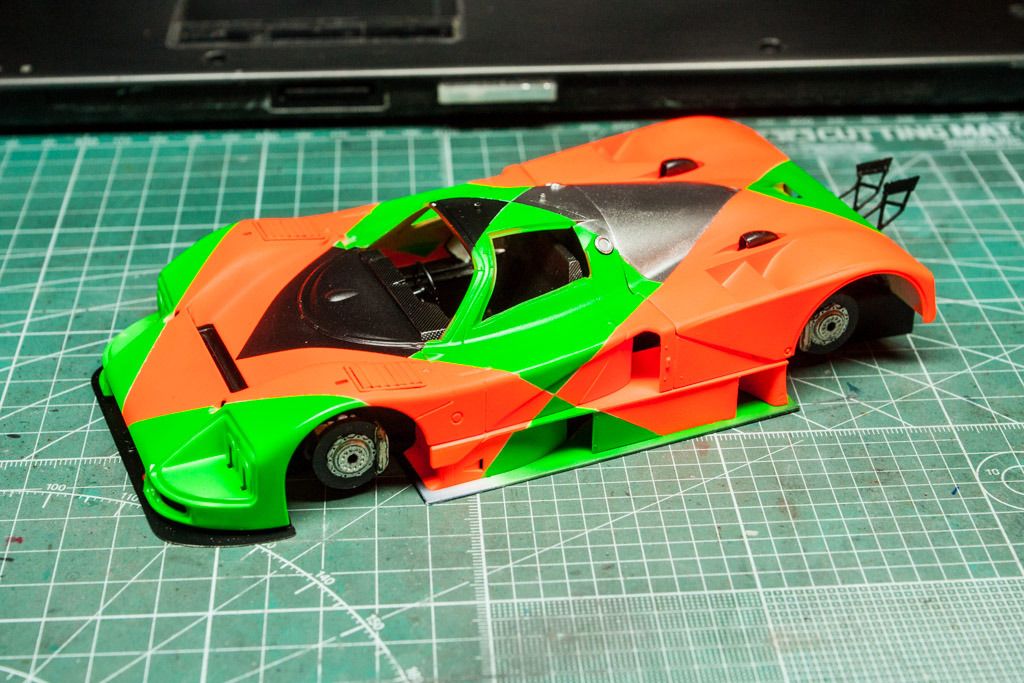

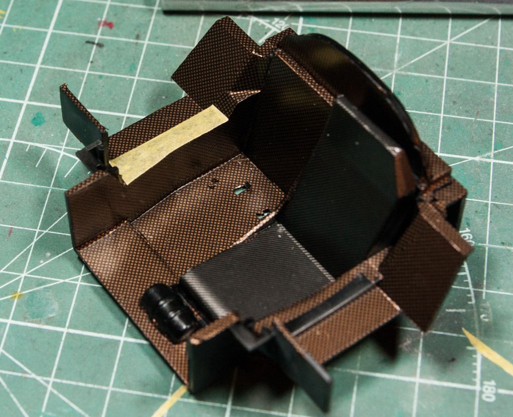

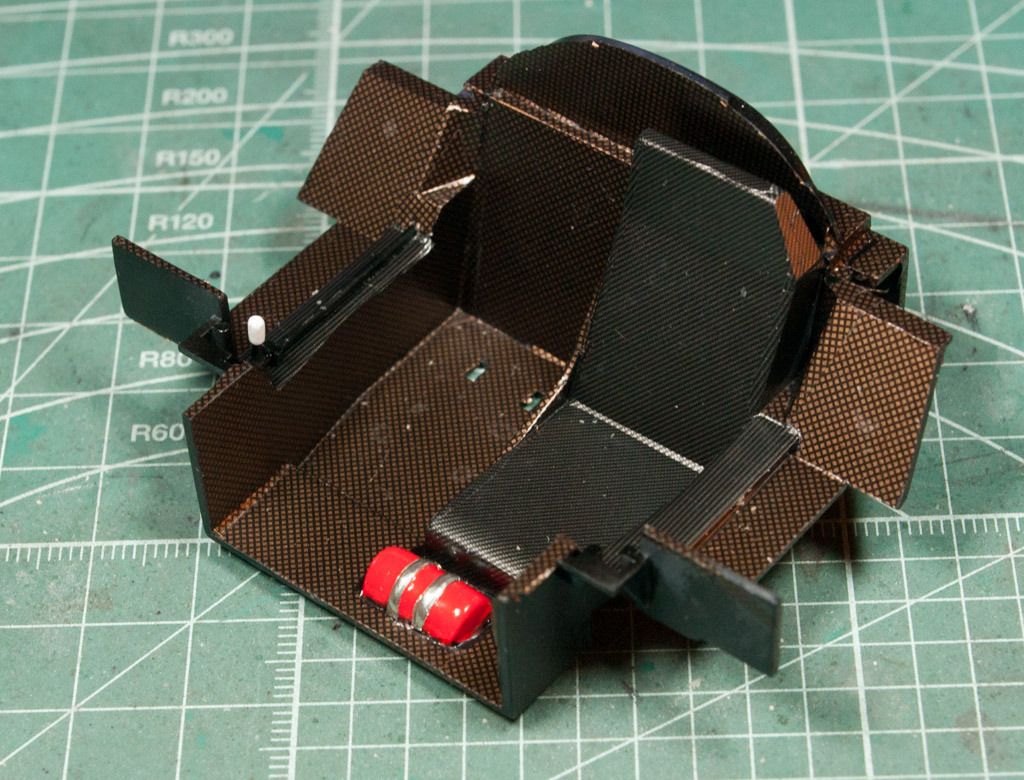

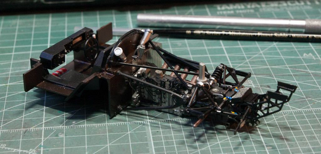

No updates in a long time but there has been some work done. I've gotten all the carbon decals done on the interior, most where from the Scale Motorsport template set, but I needed to make some extra one as well. Did this using some Tamiya masking tape that where cut to shape on the panel that needed covering and then transferring it to the decal sheet.

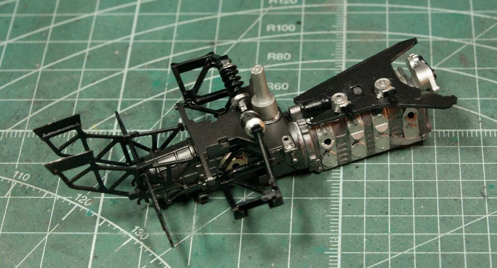

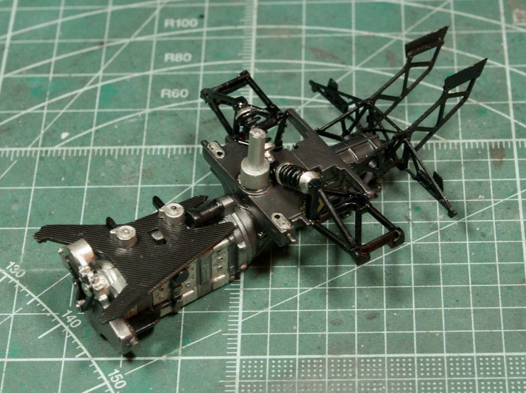

Have also got most of the engine painted and ready for some details. Gearbox was painted Alclad magnesium and the engine in AK True Metal aluminium and gun metal. Next will be to add some plug wires and oil lines.
Re: Tamiya 1/24 Mazda 787B
Looking good Jon, great work on the carbon fibre what are you using to soften them,
Engine also looks good keep the updates coming.

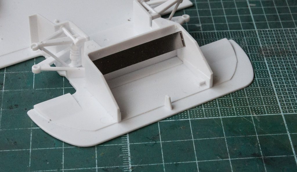

Ok so it's finally time for an update on this one. I haven't really done too much on this up till a few days ago due to the modern armour build. I have started adding some PE parts to the car.

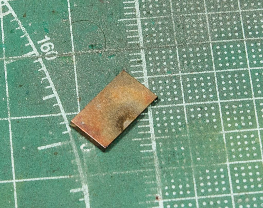

First up was the drink bottle holder, this comes from the Hobby Design PE kit. The PE is made from steel and is a bit hard to roll so I started with annealing the part using a normal lighter.

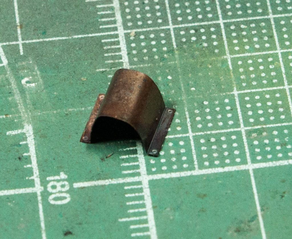

Rolled it to shape.

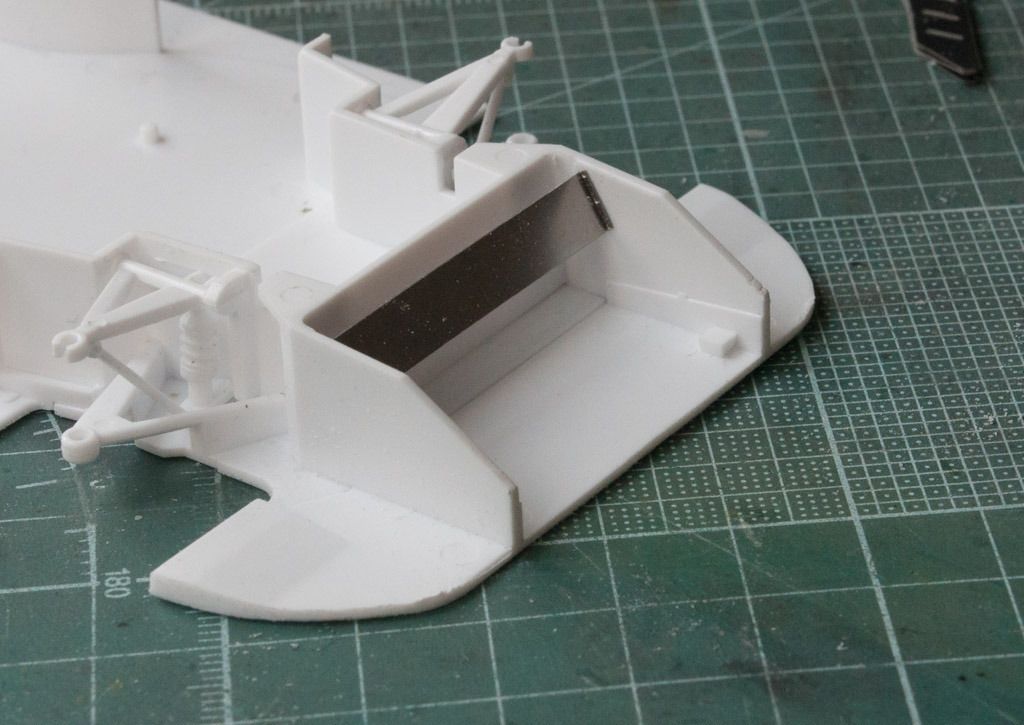

And attached it to the interior and painted it using AK True Metal aluminium.

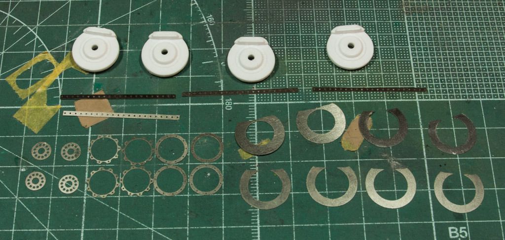

Next up is the brakes.
All the PE is from Scale Motorsport except for two of the rotor faces from Hobby Design.
All put together, the outer part with the vent holes where also annealed.

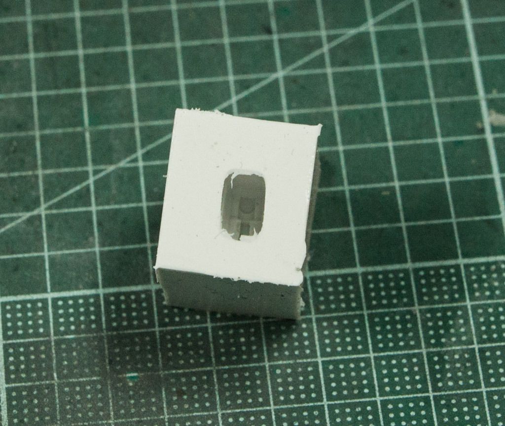

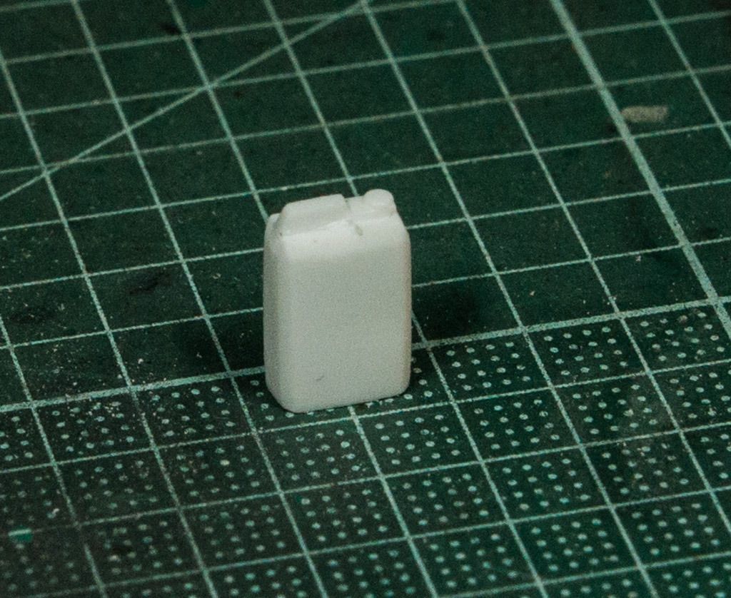

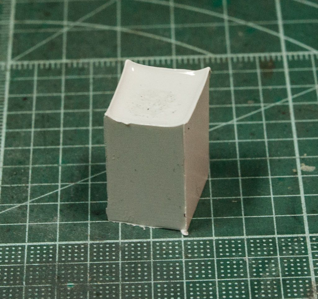

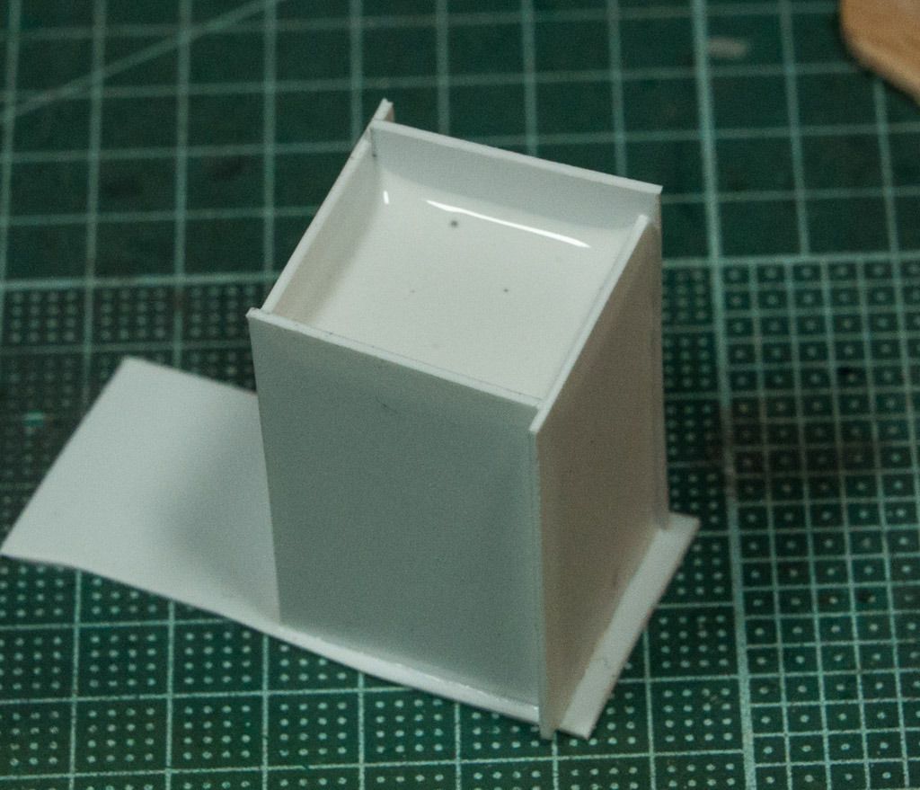

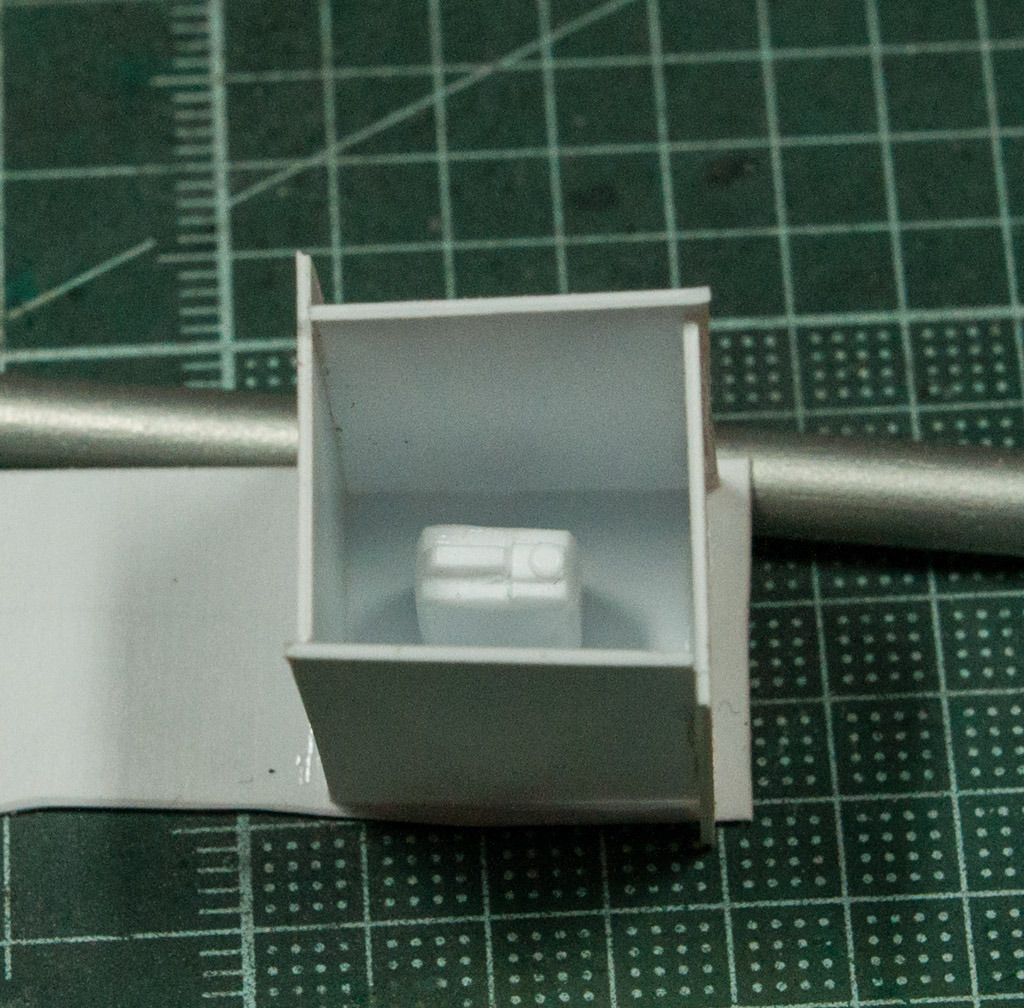

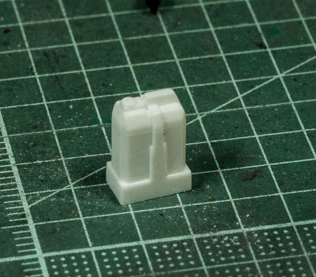

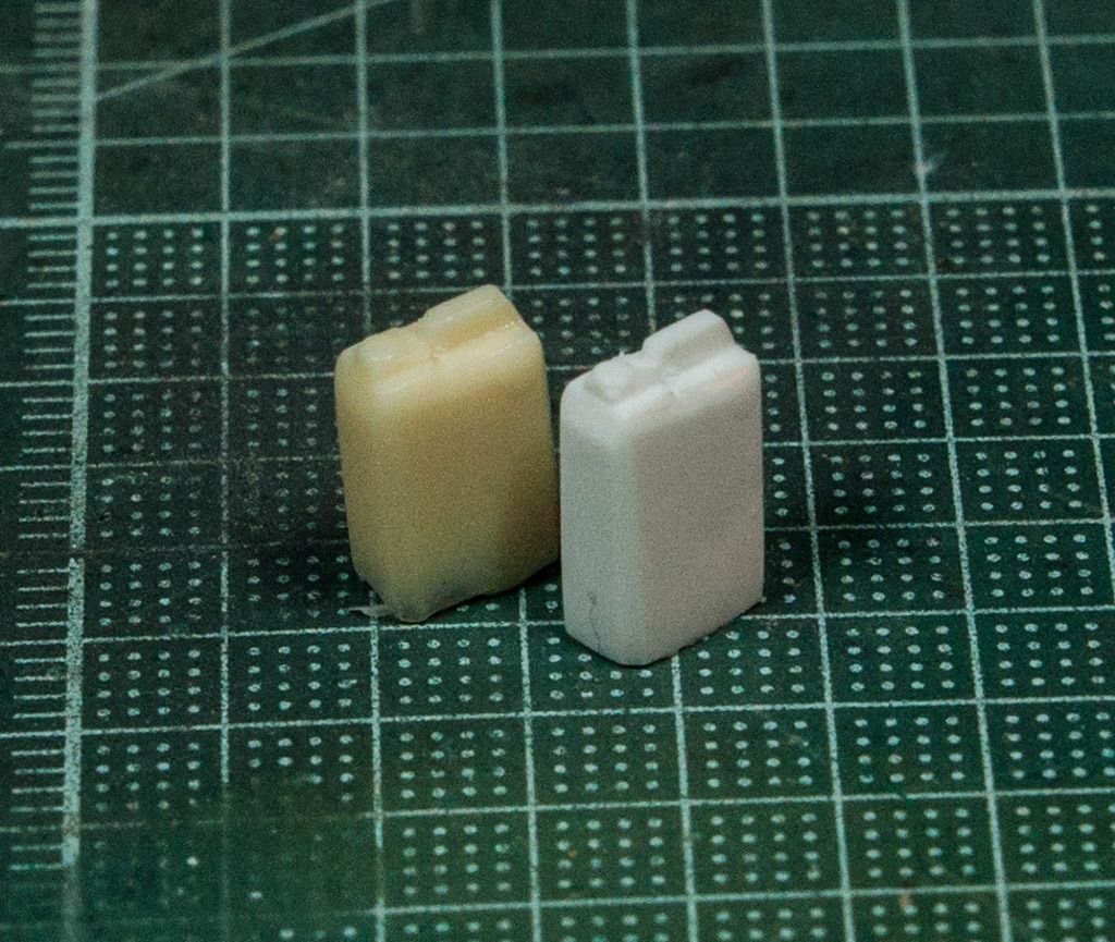

This is the catch can mounted to the back of the car and used to collect oil, fuel and water spills so they don't go on the track. Cause if they do you get a "meatball" flag (a black flag with a orange dot for mechanical problem) and you need to pit and fix it.
As there is a PE strap for it I sanded off the molded in one.

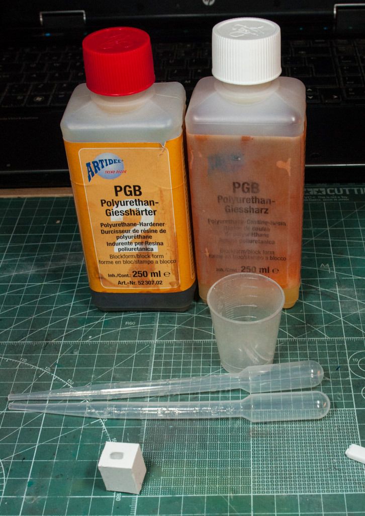

Since it's a 5 liter jug I figured it could be useful for other projects ass well as junk in the bed of a pick up or some thing similar. So I glued it to a sheet of styrene and made a small box around it.

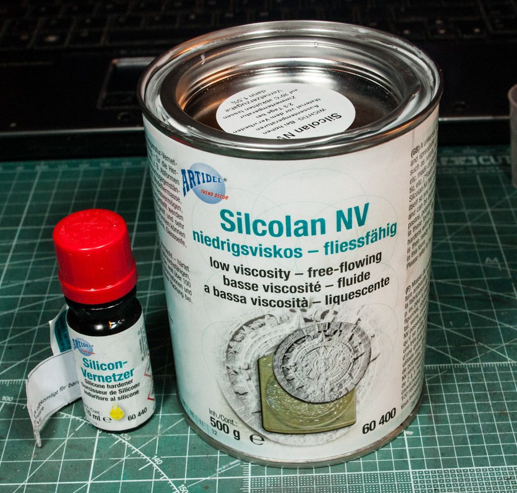

Mixed about 10 grams of silicone with 2% hardener.
This is the silicone that I use it's a really slow curing one which is good as all the air bubbles have time to rise out of the mold.
Rolled it to shape.
Poured it in and let it sit for about three hours.
Then you have a small block of silicone.
With a negative impression of the part.
Some resin mixed equal amounts of both parts.
And 15 minutes later there are two jugs. Next up will be drilling out the handle and adding the PE. Then I can start painting all chassis parts.

And more PE to add, the front splitter is a bit thick in plastic so that was cut off and replaced with parts from the Hobby Design kit.

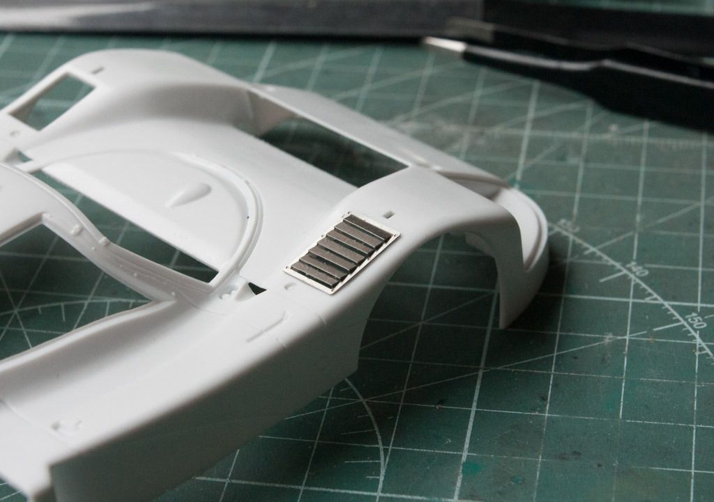

Also the vents in the front fenders where cut out using Tamiyas PE saws and sanded smooth.
A bunch of PE parts where cut off the frets, bend to shape and glued together, these where also from the Hobby Design kit.
This is the first stage of masking for the green paint. The problem is that both the green and the orange are very translucent and getting the colors to match on all four of the body parts can be a bit of a pain.

AWESOME!!!
You just made my 1/16 Ferrari F 40 vents...sweet
That is exactly what I am going to use
Thanks!
Your Mazda kit is coming along very well, don't stress the time...such a masterpiece is ready when it is ready
Thanks!

Thanks, the thing is I really don't like not meeting a deadline so I'll keep pushing this as long as I can to make the deadline.

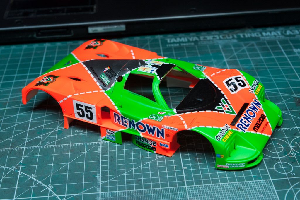

And I have gotten a bit closer to that, managed to get all the colors on the body and only had one small spot where the paint lifted. But that should be easy to fix. So next up is a coat of clear and then start the decals.
The orange is very florescent, so much that it is irritating to the eyes if you look at it for too long.
- Twokidsnosleep
- General
- Posts: 18027
- Location: BC,Canada
Looking good, that paint is something else
Lots of decals to go onto her as well
You will need a drink or 10 when you are finished
Got started on the decals tonight. All the "stitching" is done, just need to make some cuts around the front wheel vents to get them to conform better. I was a bit worried about the decals as I have never used decals from this company and some aftermarket decals can be a bit problematic some times. But these work great, comes off the paper easy, don't tear and lays down nice, so this might be easier then I first feared.

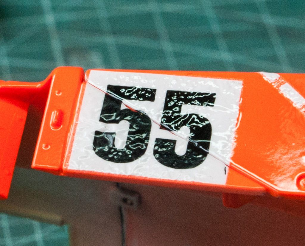

Thanks! But I'll have to redo most of it at a later date.
Went to put the final coats of clear on the body today, using Zero Paints 2k clear. The reason I use that clear is that it gives a really nice shine and don't harm the decals. Or at least usually don't harm the decals. I've used this clear for some years and never had any problems, even tried to put some spare decals and flooding them with clear without any problem. For this I started out with around five really thin coats and then a final heavier coat, and the decals just started to wrinkle and everything went to hell. So I'll have to order some new decals, strip the paint and start over again. And no way I'll be able to do that in the coming five days so I'm out of this GB, this will at least for now go into the stash of started and not finished kits to hopefully be finished at a later date.

Damn, that sucks
Sorry to see this happen on such a promising build
The clear is getting under those decals somehow

Any idea what the clear/wrinkly decal reaction was ???

I think the clear coat got under the decals because they may have not fully dried or bonded to the body yet.
