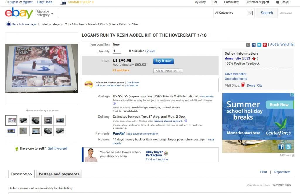

...And lastly an Ebay link to the resin kit... I have found no other kits or builds so far but I am always looking out for them. :thumb1:
Just as a piece of info the original car was built by Dean Jeferies Auto Styling in Hollywood along with the Sandman Groundcar.
Unfortunately it got sold on and turned into a white Blobby car for another production.. :cry:

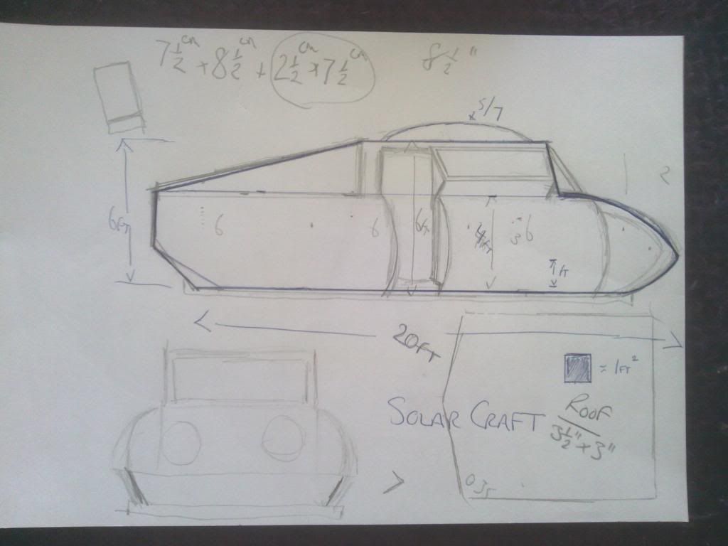

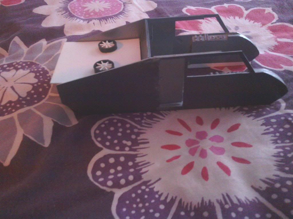

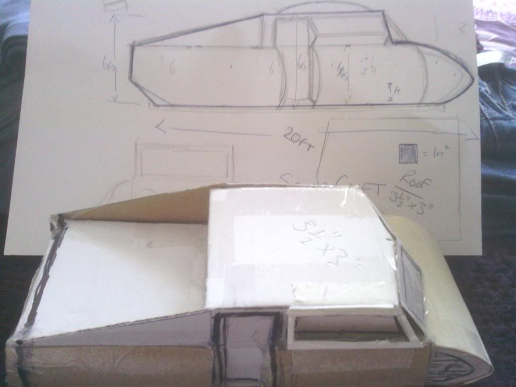

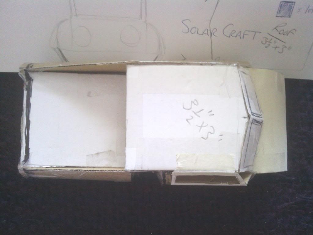

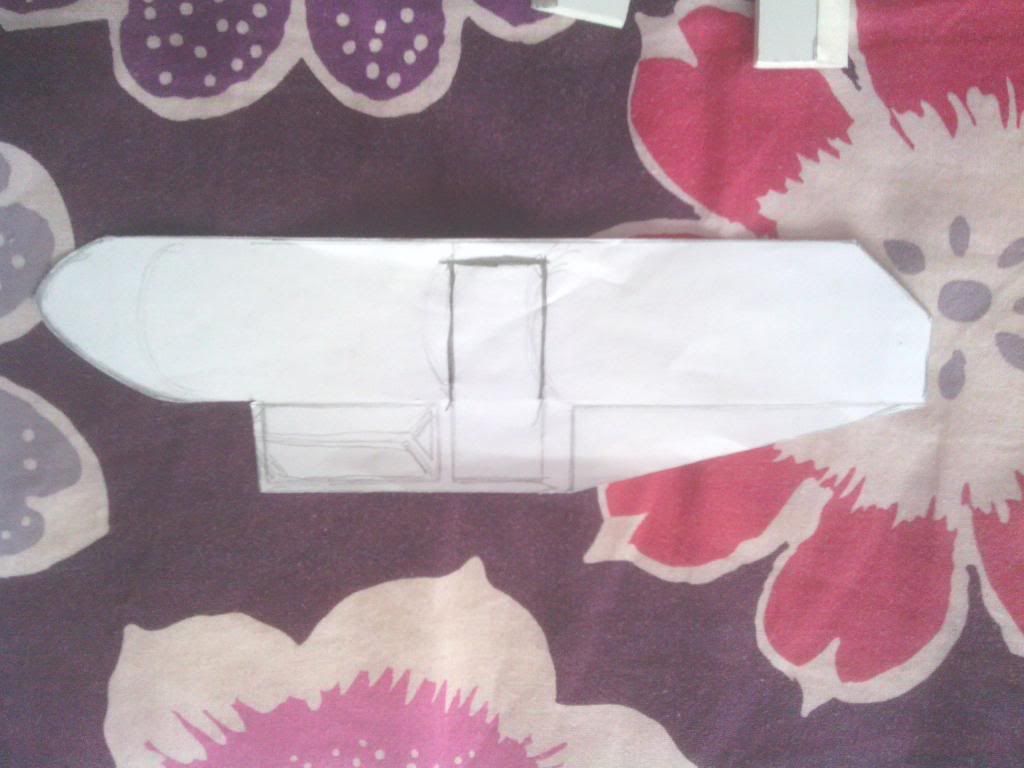

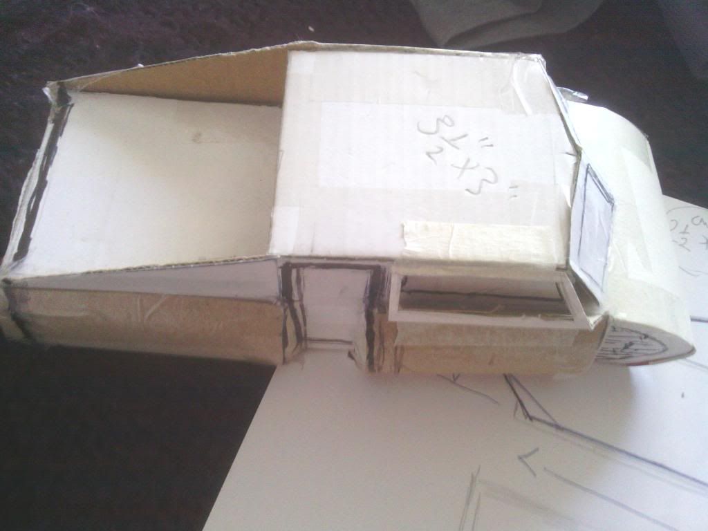

A couple of rough sketches where produced along with a cardboard Prototype...
Pics now... :dance:
as you can see... the prototype is rough, made with cardboard and loo roll tubes and lots of stickytape.
...but it gave an idea of scale and ease of build and the starting shapes for the plastic cutting.
Will get some more pictures up later..hope this has got your interest? :whistle:
Thanks everyone for having a look, wish me luck.. :crazy:

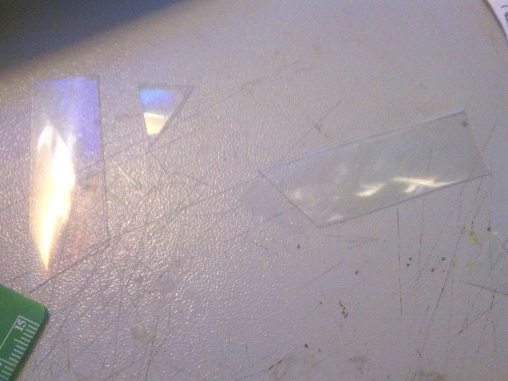

DC, the windows are gonna be clear plastic sandwiched between an inner and outer skin.. ( you'll see ) :thumb2:

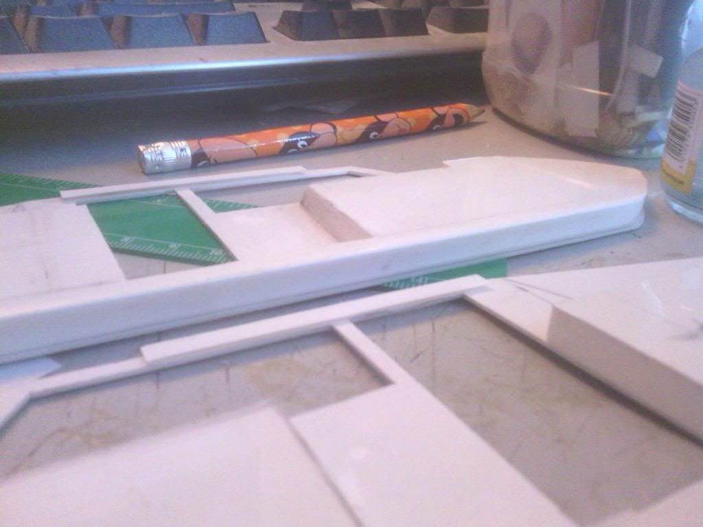

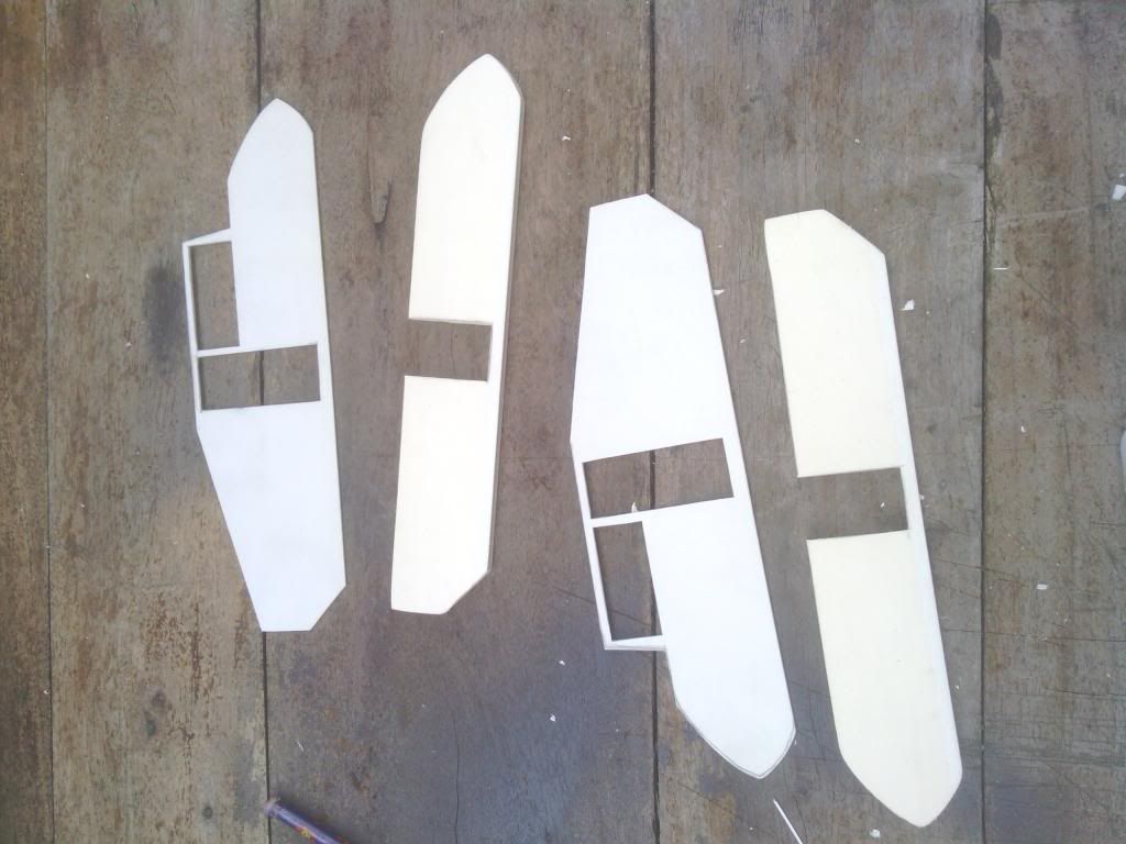

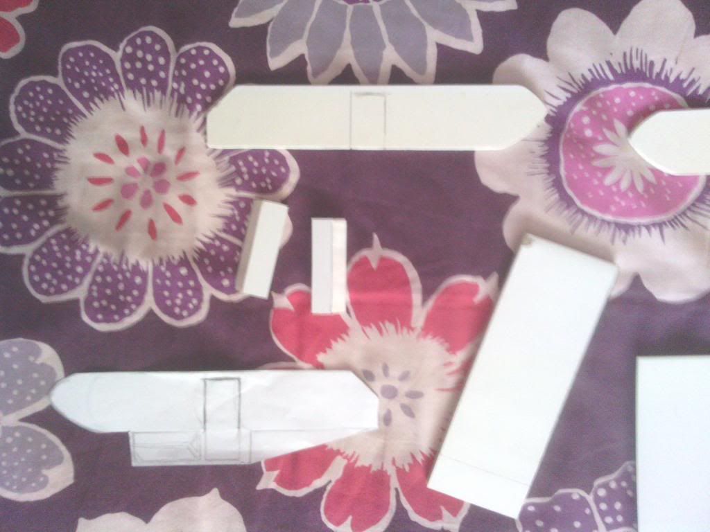

a quick paper template to mark up the flat upvc board and the plasticard..
Then I cut some bits and bobs for the tail and support wall and the floorpan..
While I was marking up I used the template and the cut upvc board to mark out the plasticard ready for cutting..
....Ta-Da... main walls and inner upvc together and main doors cut out. ( the main walls do get adjusted later as I have worked on them today )
Can you guess what i'm using for the curved wall pieces? :whistle:
Glued and clamped for an hour or so until they set solid...

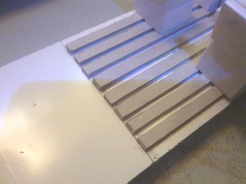

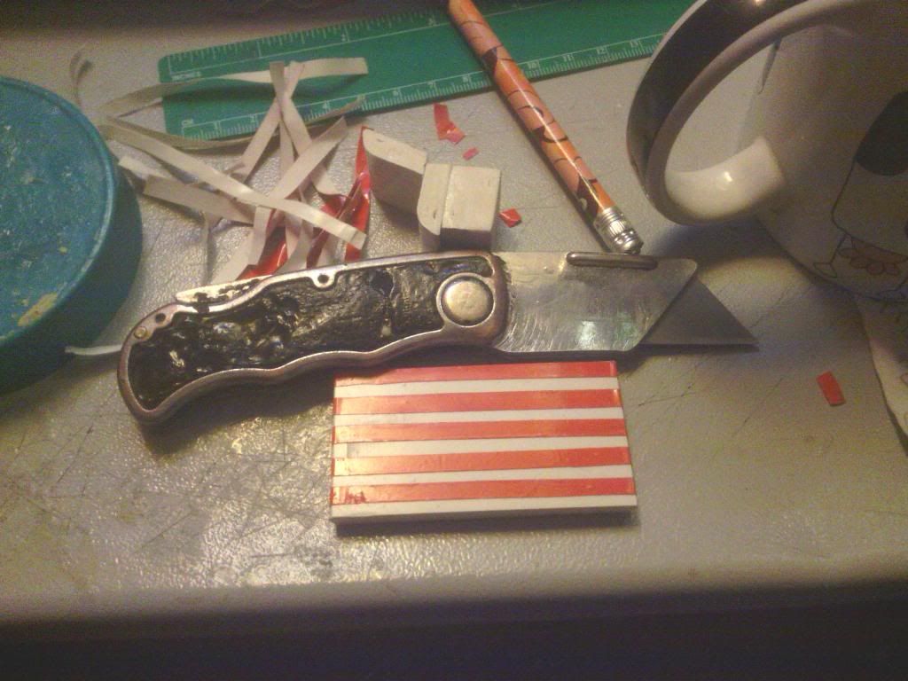

..and to finish off some Modellers card from the artshop cut into strips to give the floor some boarding effect..
Right that's it until tomorrow...Don't want to bore you with pictures of plastic bits.... :lol: :nena:

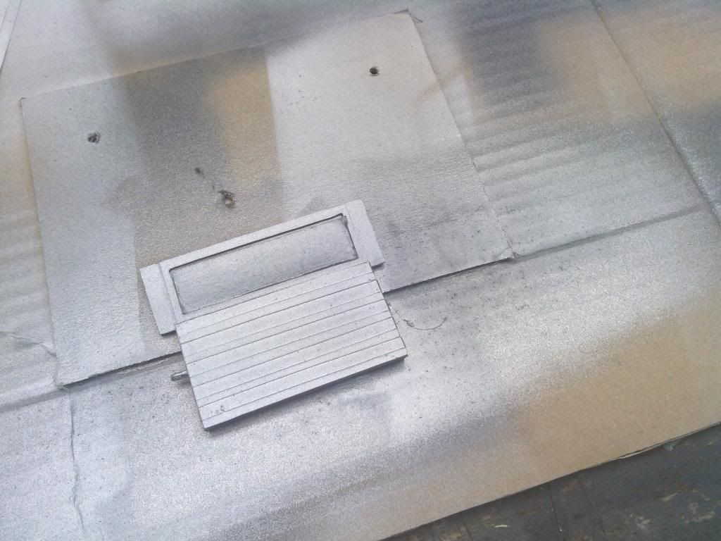

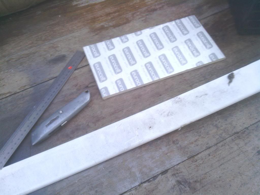

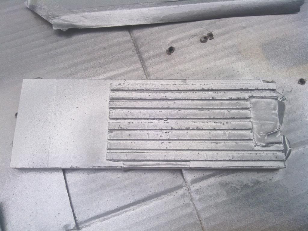

So as I posted yesterday I am gonna lat the floor to give it a steel nonslip texture so lets see if I got a picture to show what I mean, but before I do lets see about building an Interior... :eeek: ..... Yes an inside too !
So I take some old window reveal cladding and some flat fasciaboard and off we go..... ;)

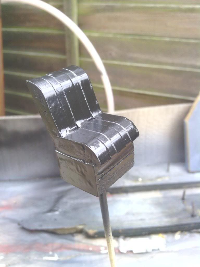

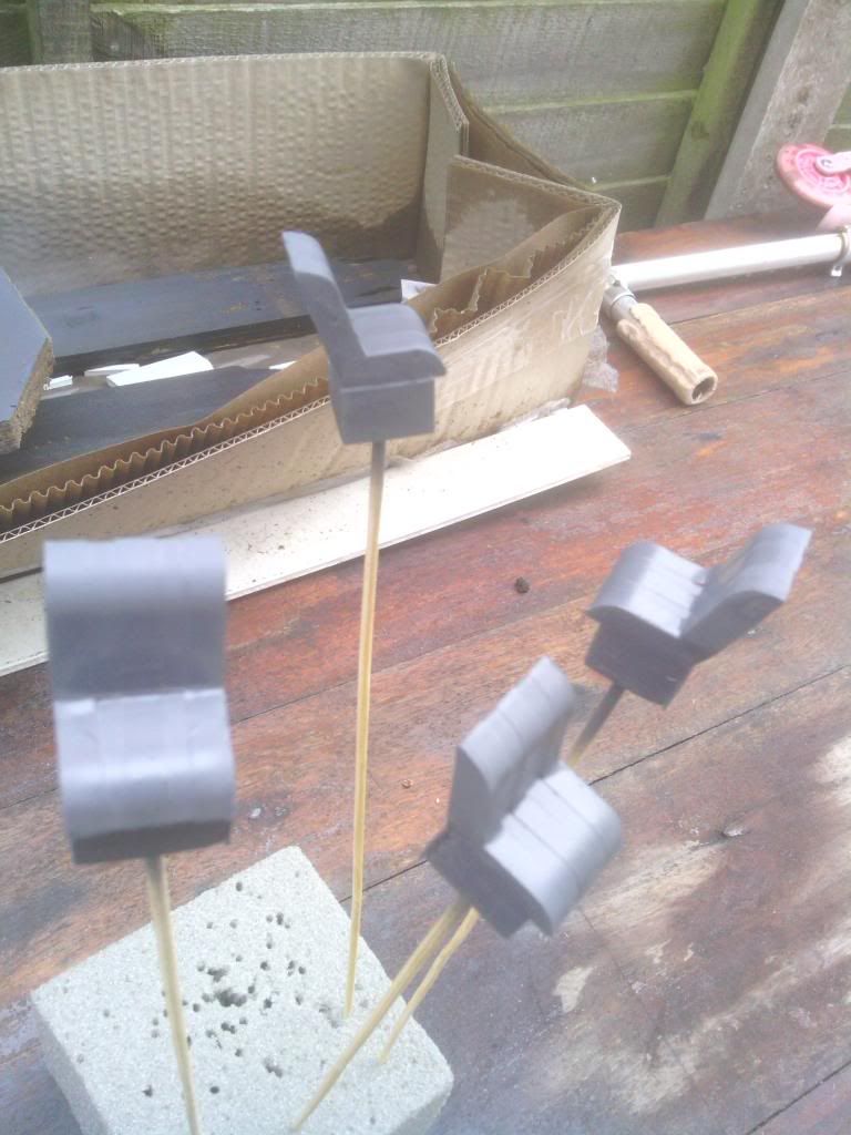

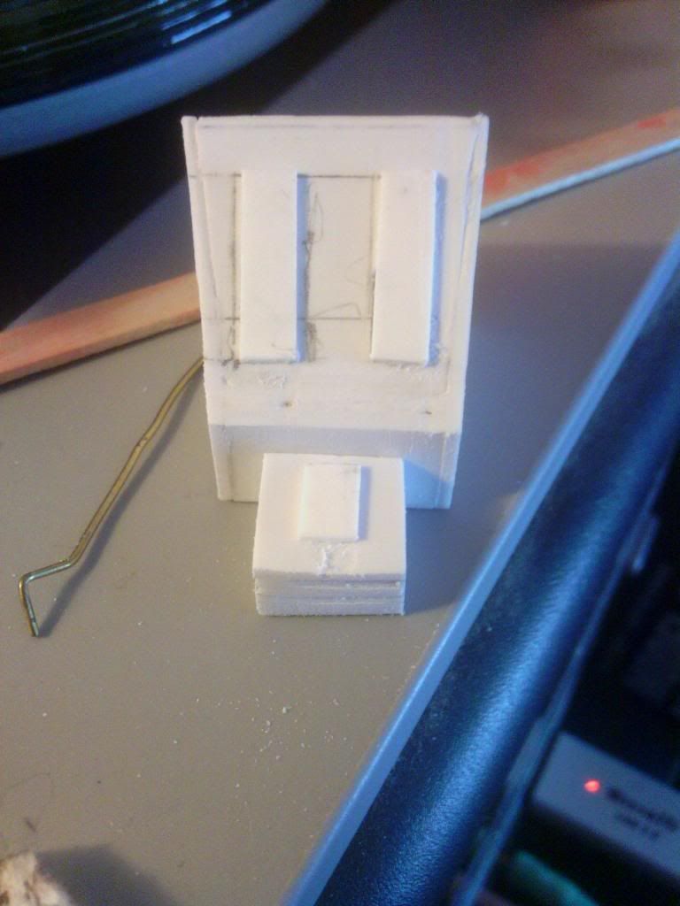

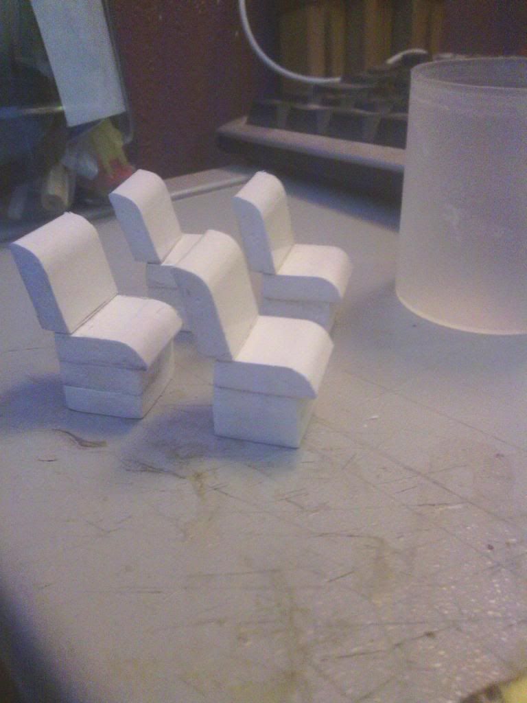

The beginnings of seats made from the curved edged piece of cladding..
Dashboard edge.. :wtf:
Ta-Da... dash.. :shock:
Seats ... :banana:
Okay lots of filling and details etc.. to add but you get the idea...

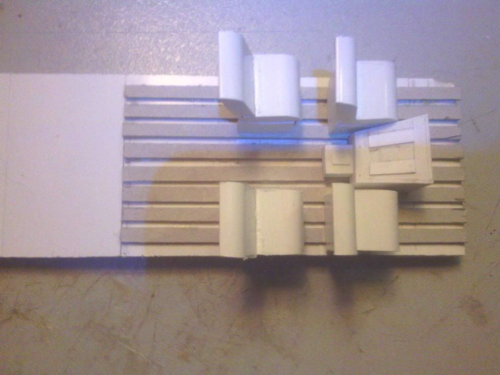

How about a rear wall under the back window? I'm using some old Pinstripe to give it a texture, I will use the same on the seats too..

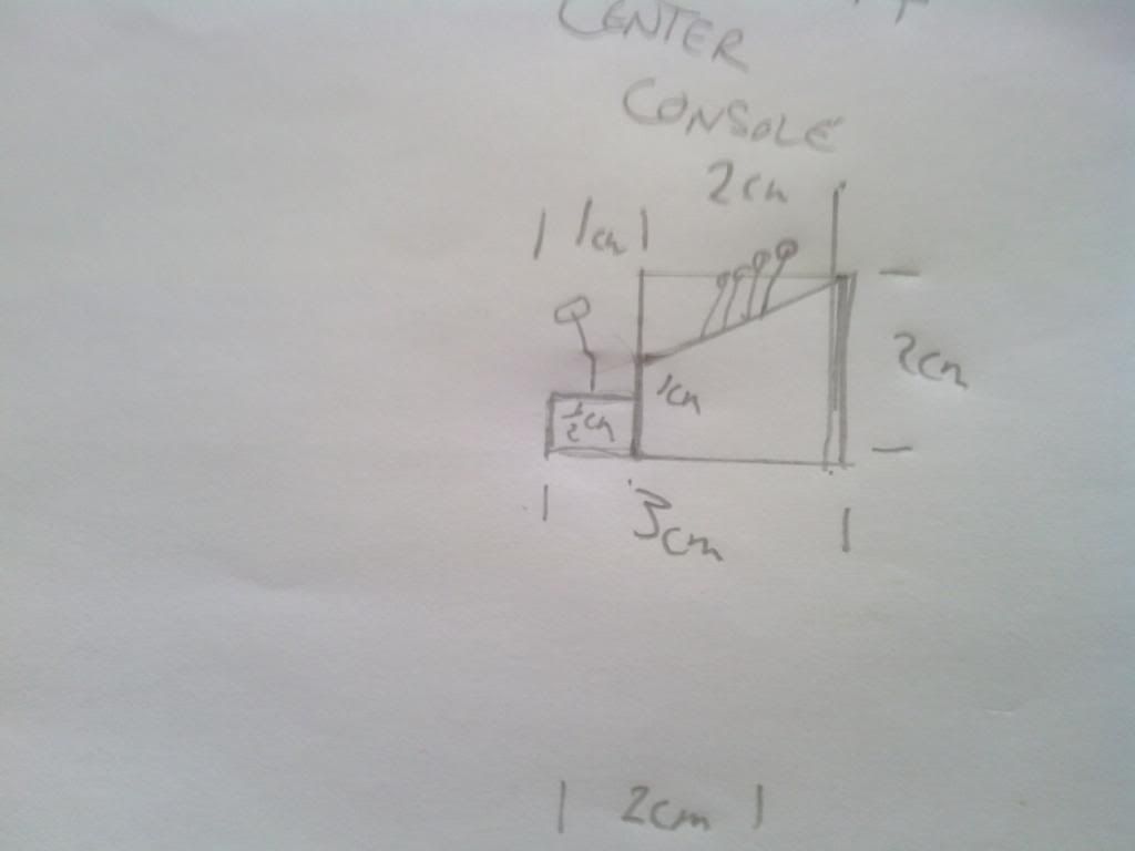

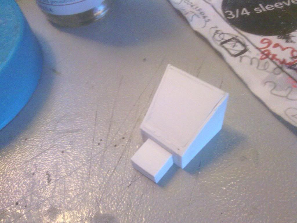

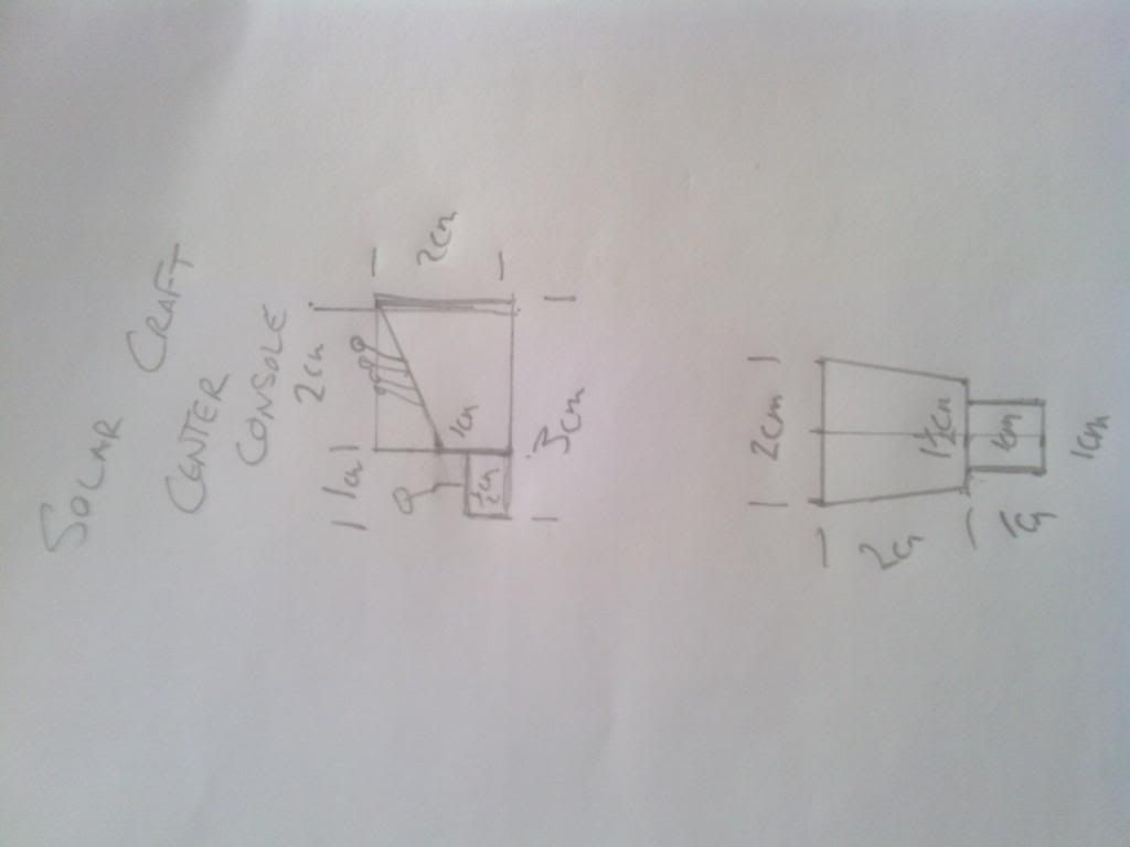

Center console next I think ! Well the plans first... :crazy:
Now the build.. :whistle:
Now detailing.... :th:
Oh..... and here is that floor shot I promised at the beginning... :dance:

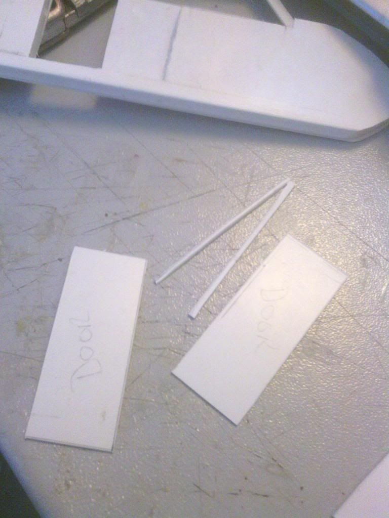

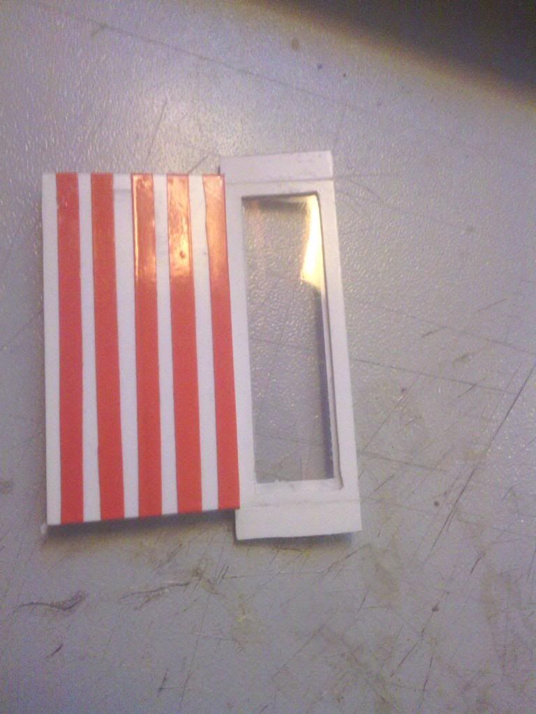

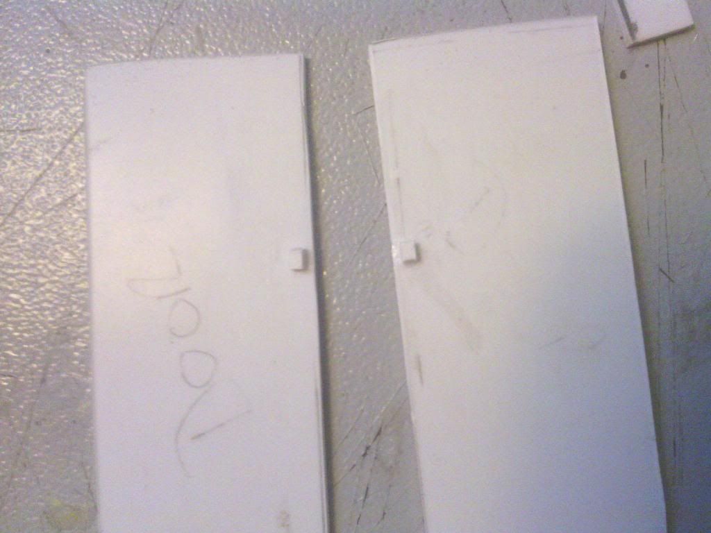

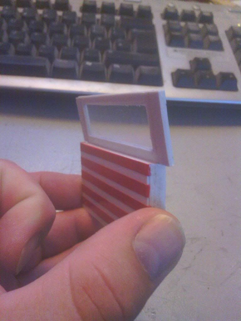

As a quick tease I have just finished the sliding doors... :eeek:

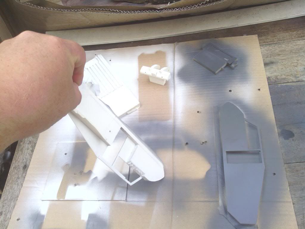

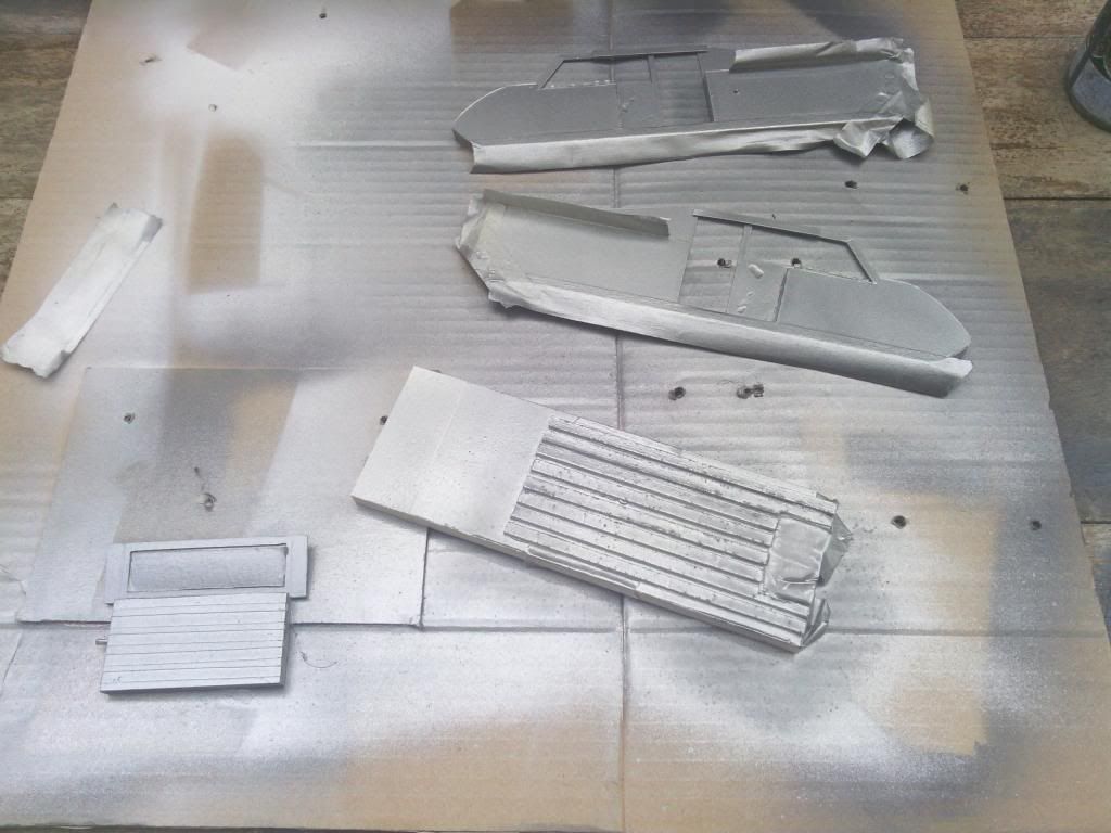

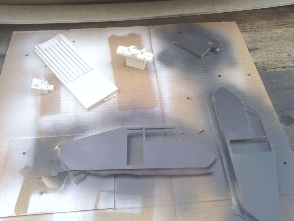

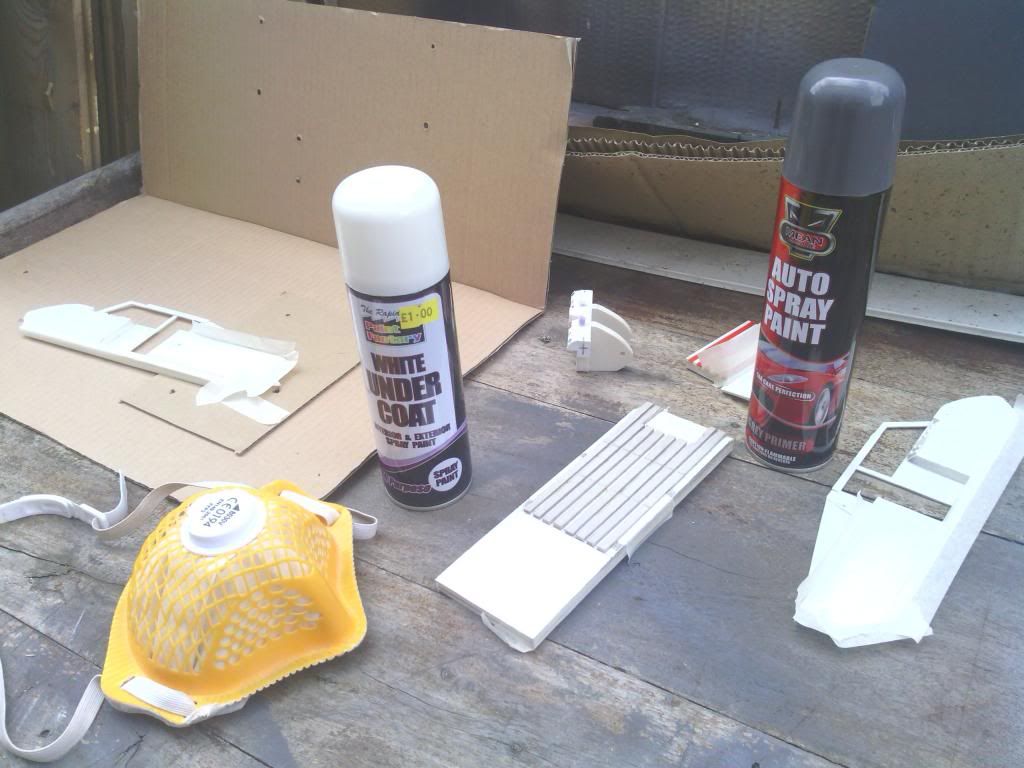

...and will hopefully get some primer on the inside as I cannot build up until the interior is finished so I may need to adjust for fitting.. :shock:

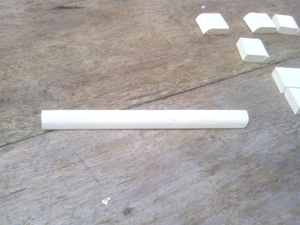

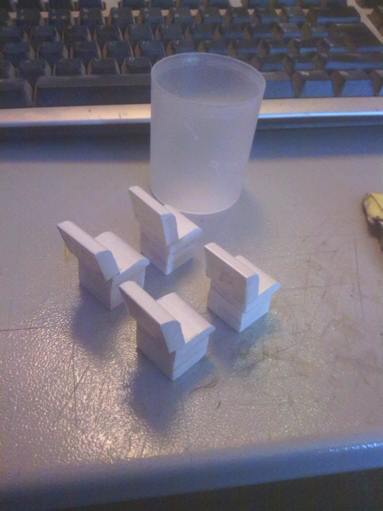

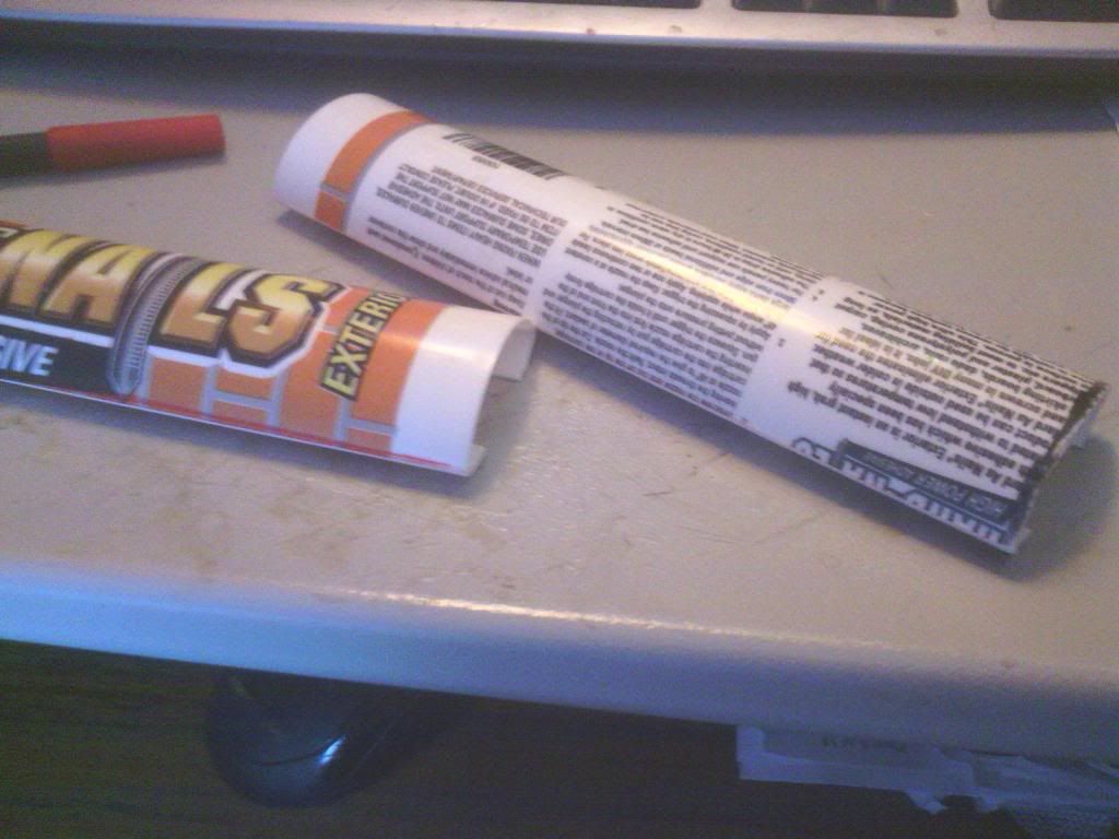

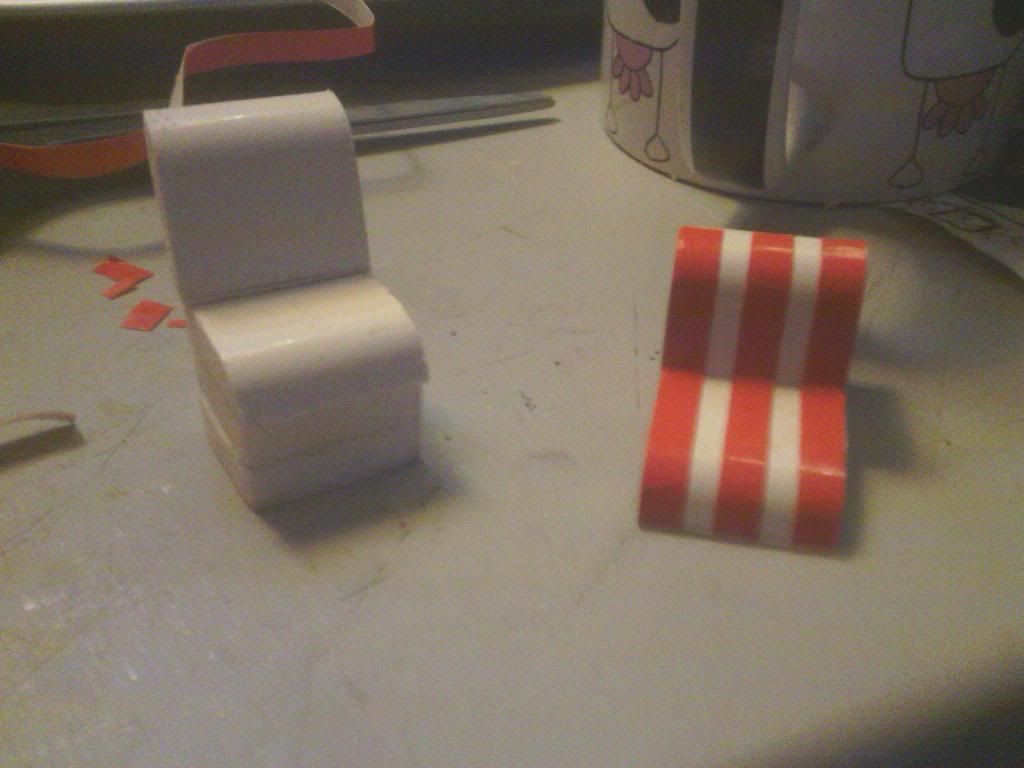

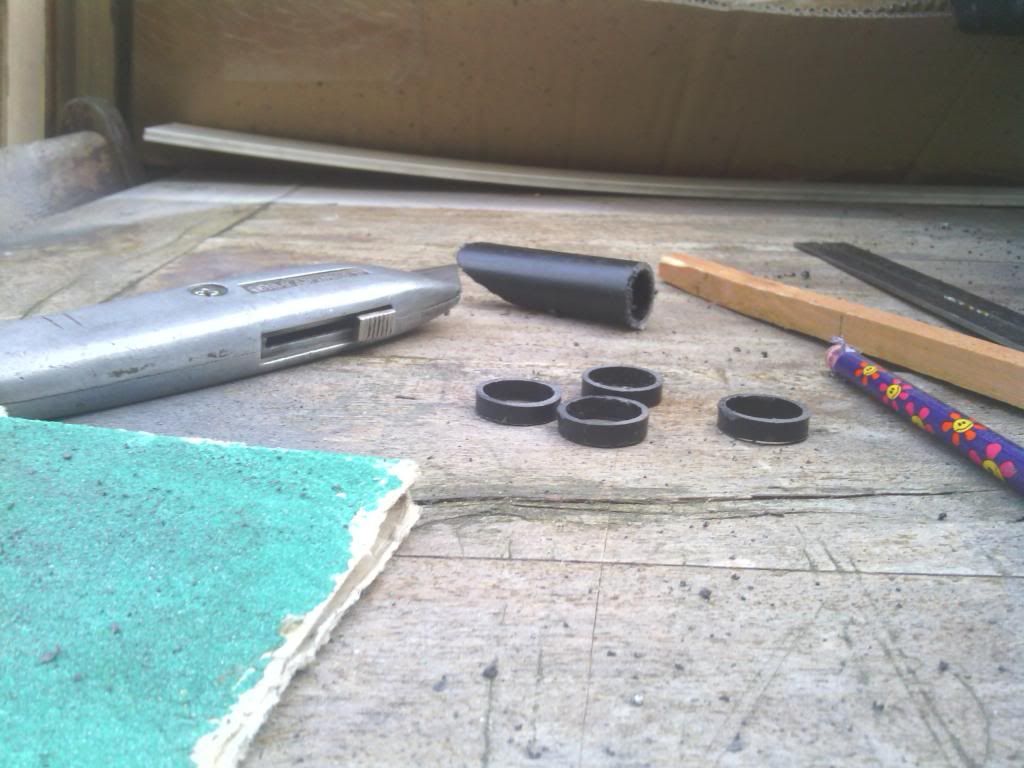

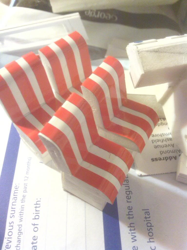

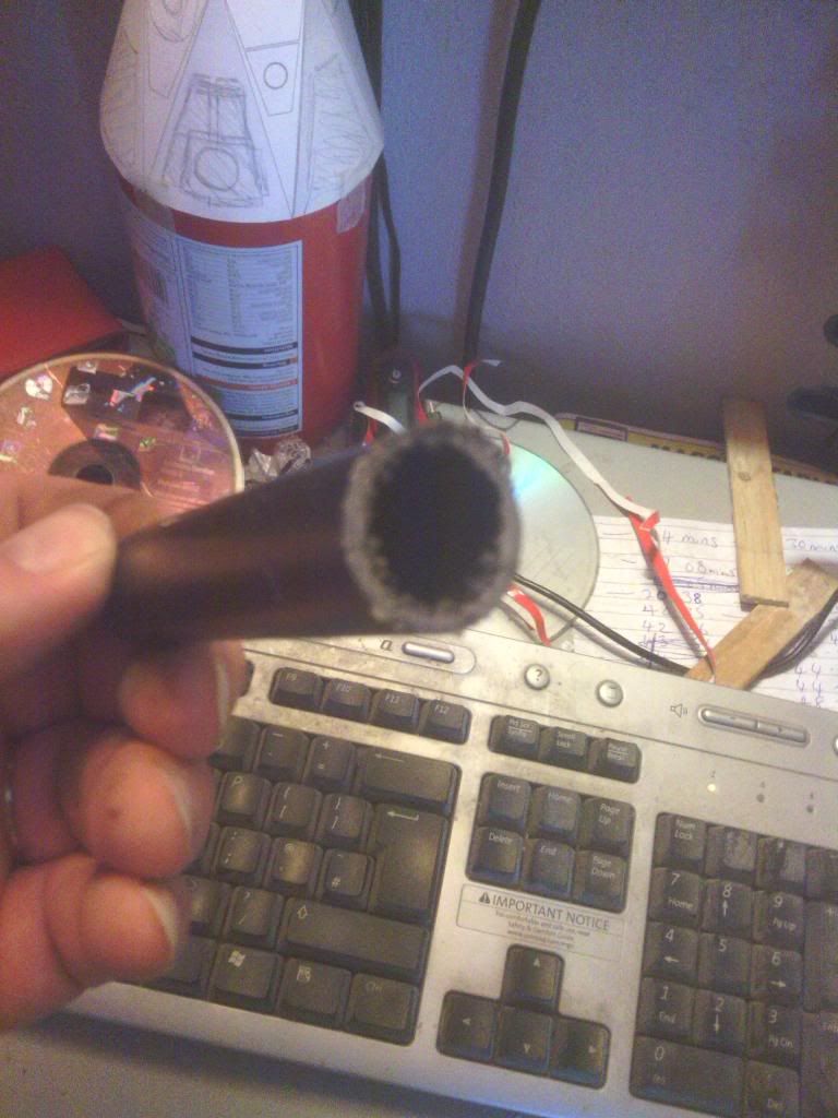

Okay so as I mentioned a couple of posts back I am going to use an old gluetube cut in half to make the side curved edges..
I skinned the edges visible on the seats and decided to fill the sides against the inner walls.

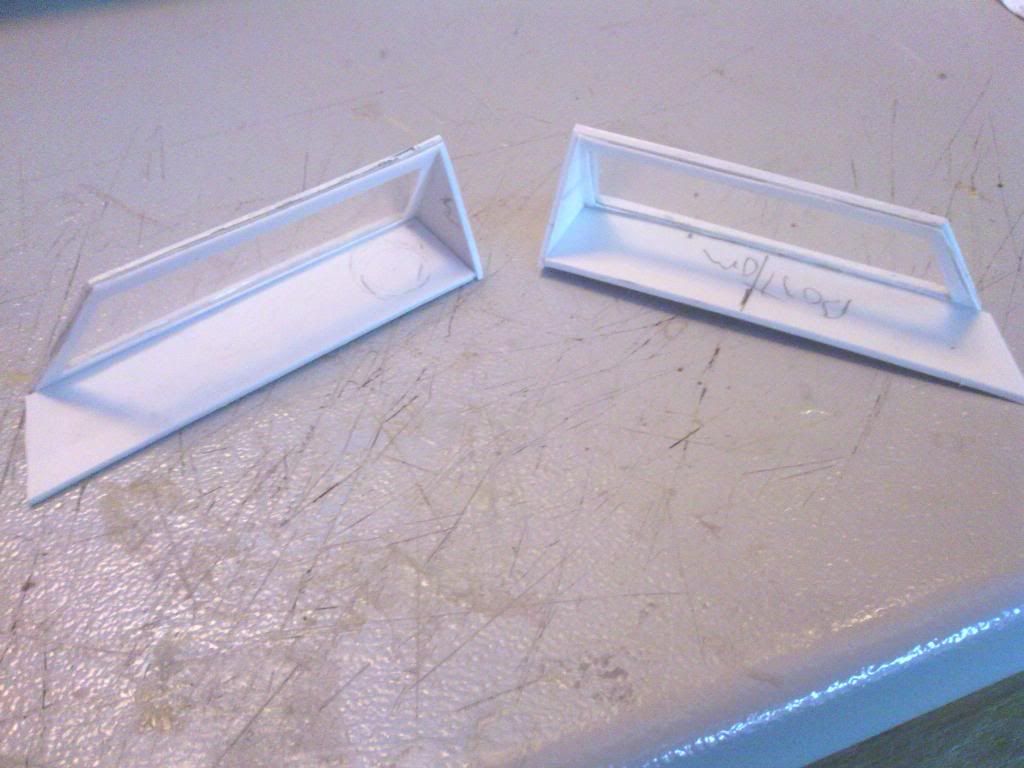

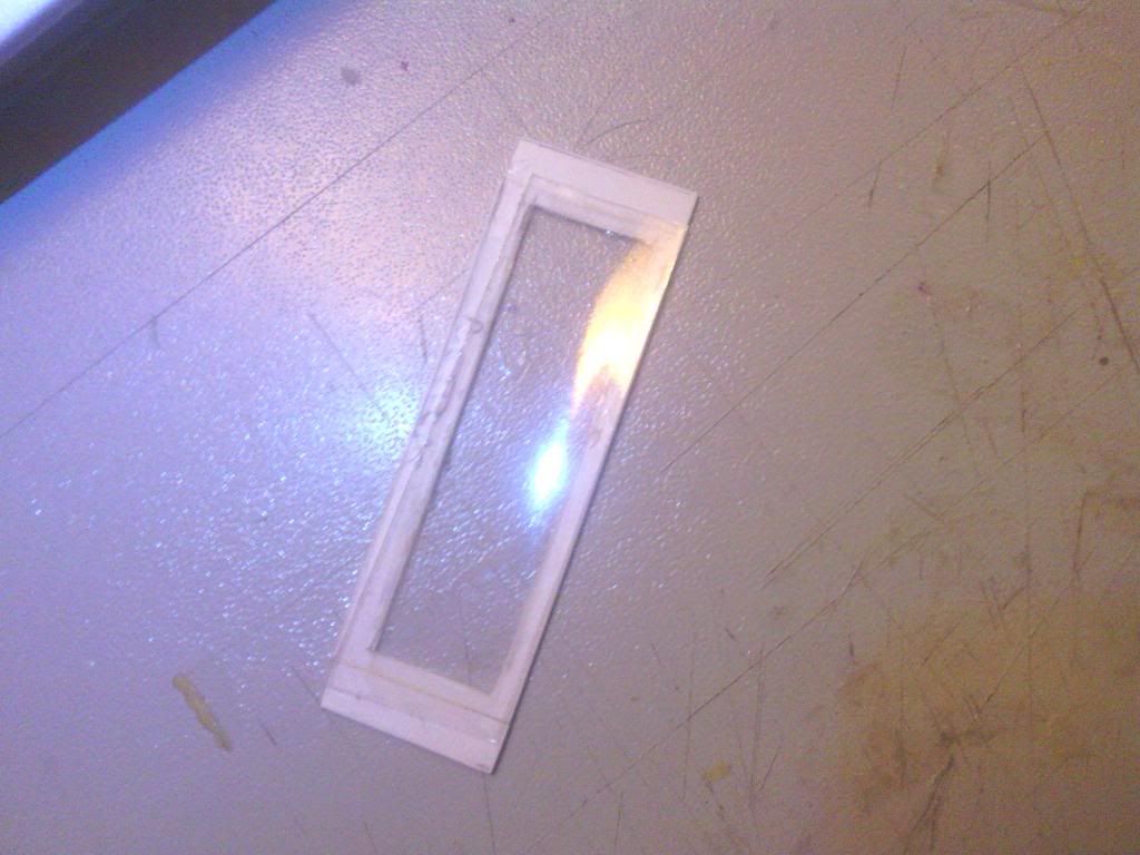

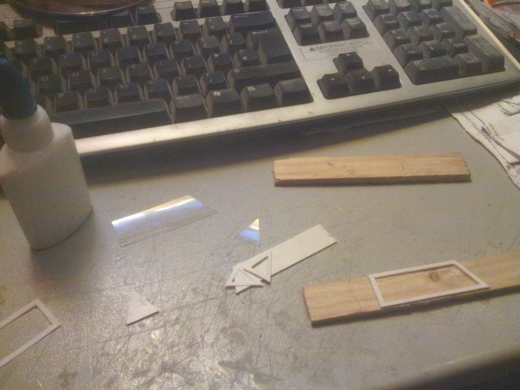

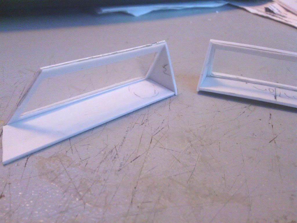

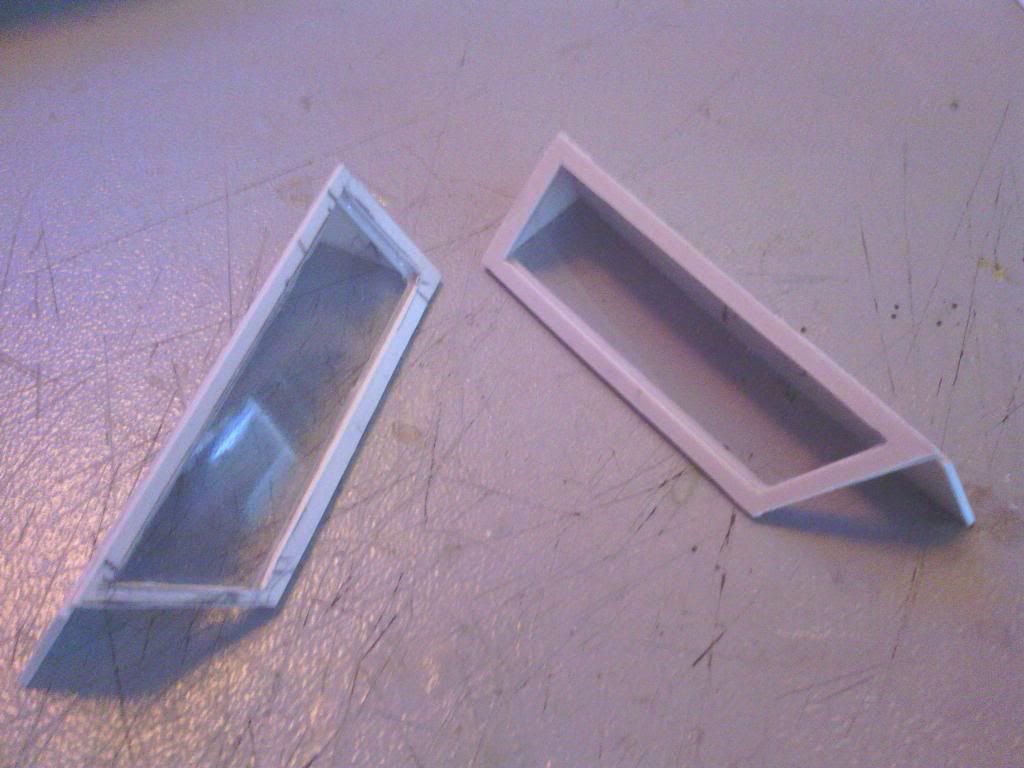

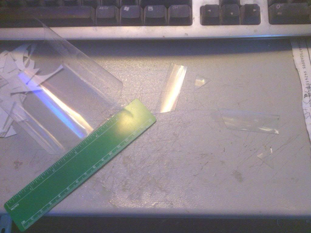

Rear window being glazed as I mention earlier by sandwiching a piece of plastic cut from an old flavoured water bottle..

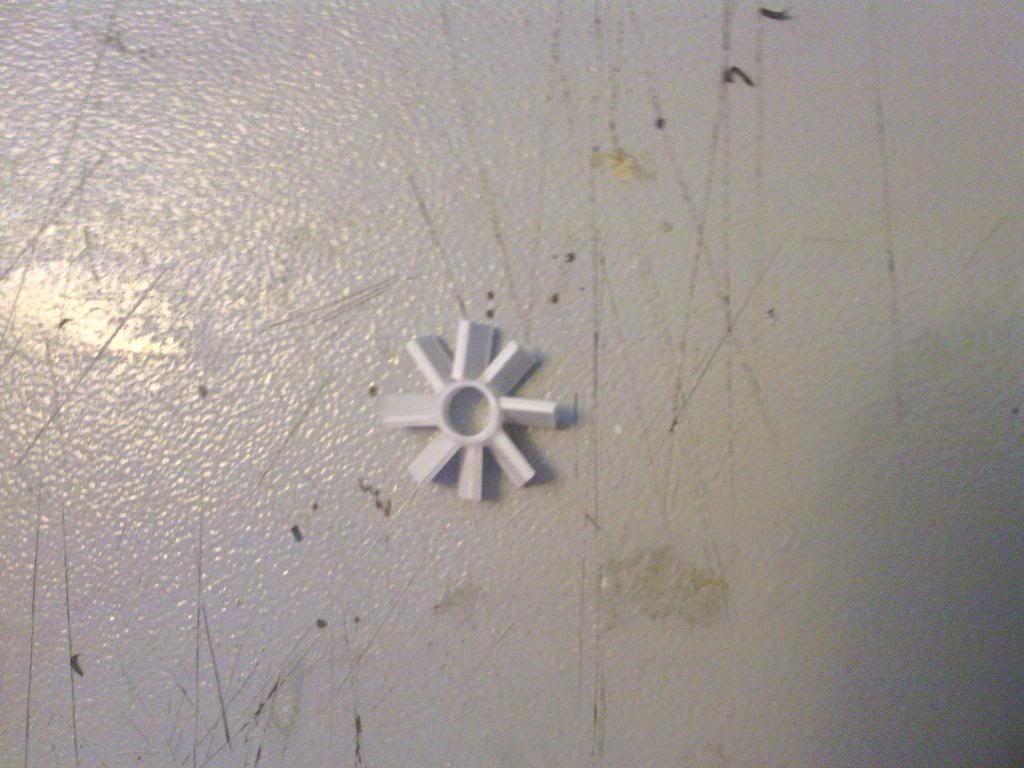

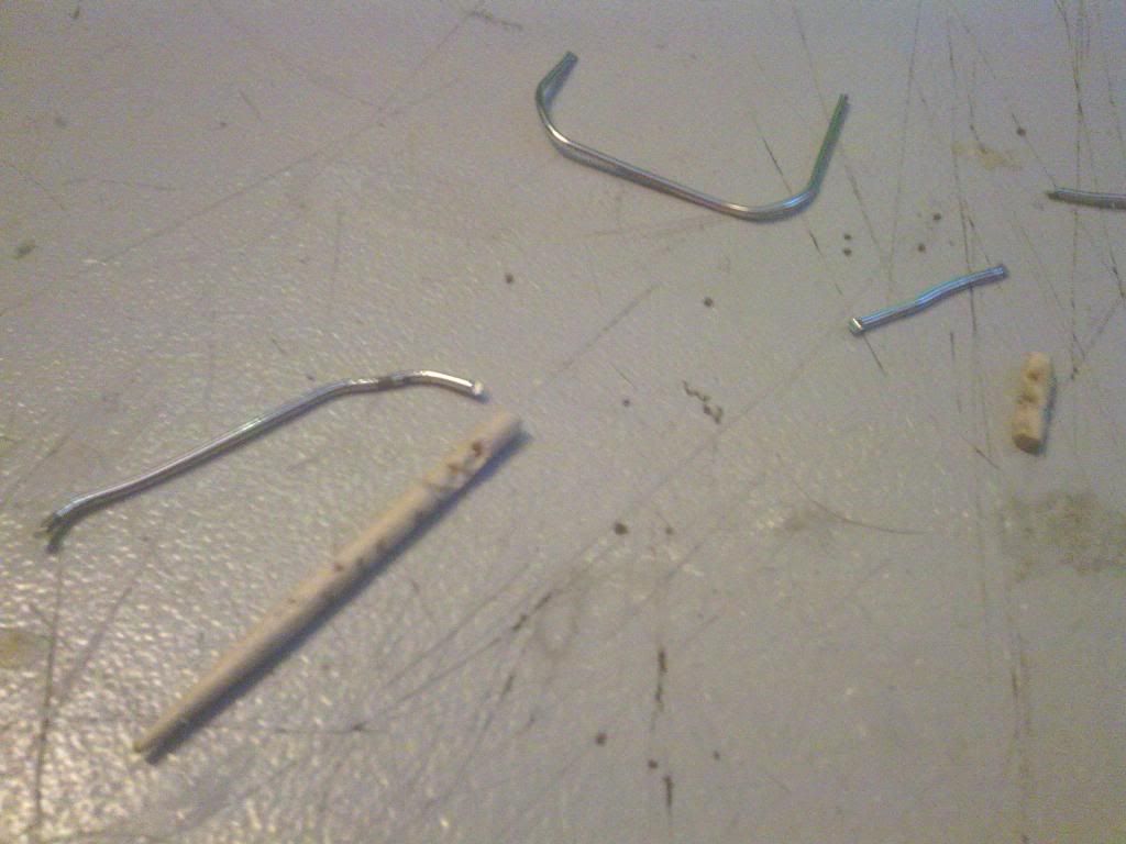

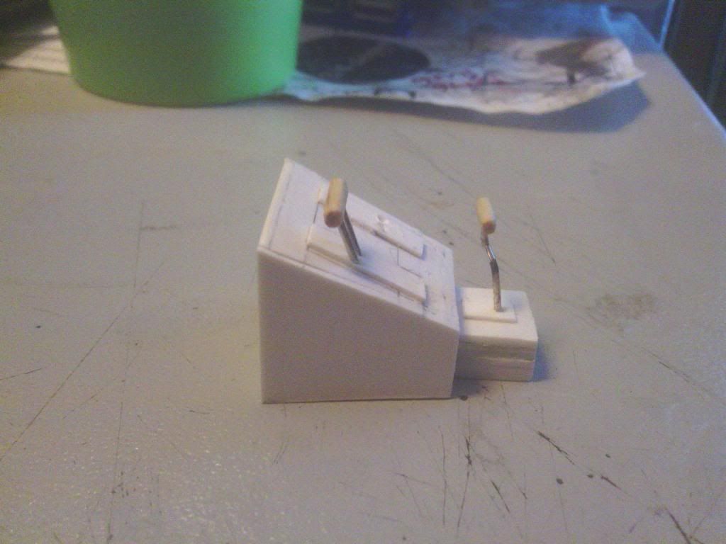

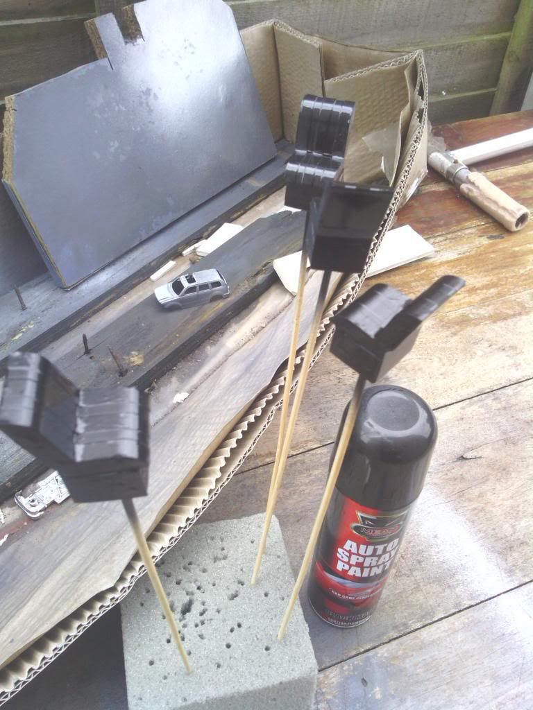

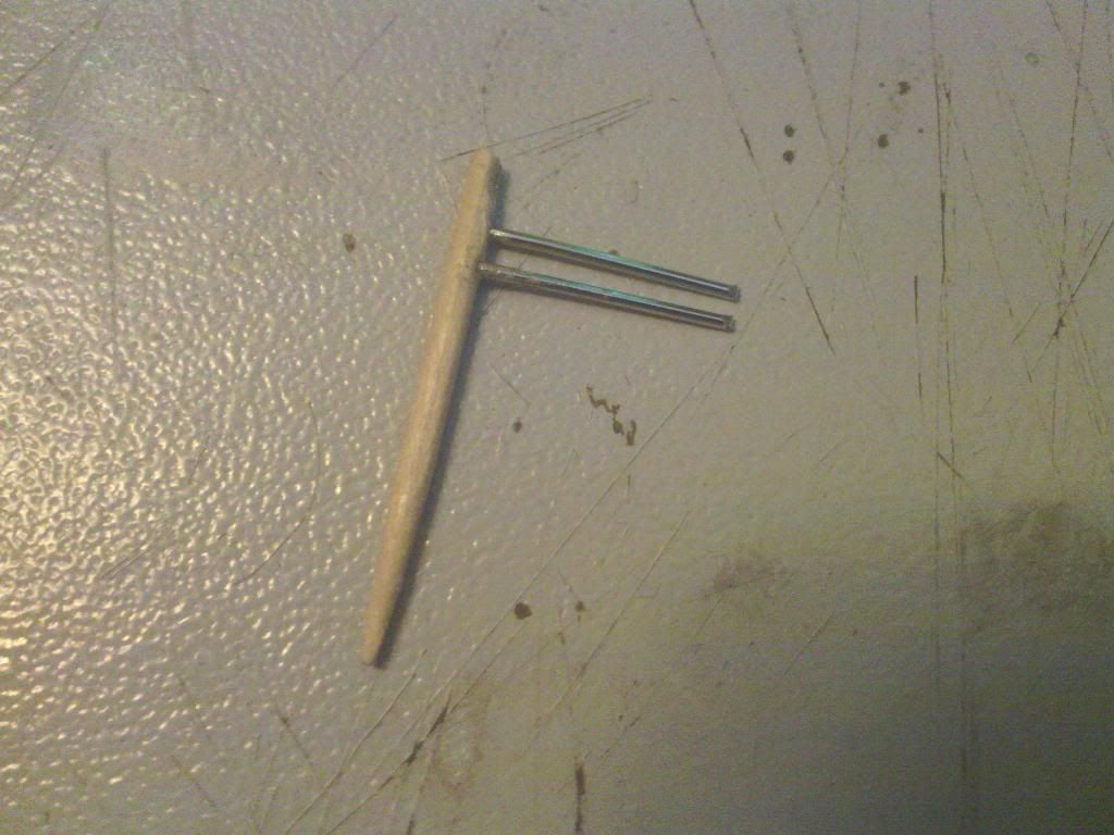

Can you guess what this pile of wire and cocktail stick will become?
Ta-Da.......

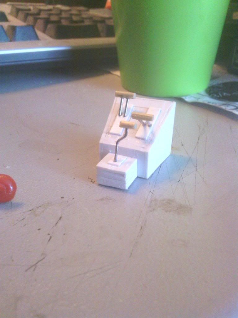

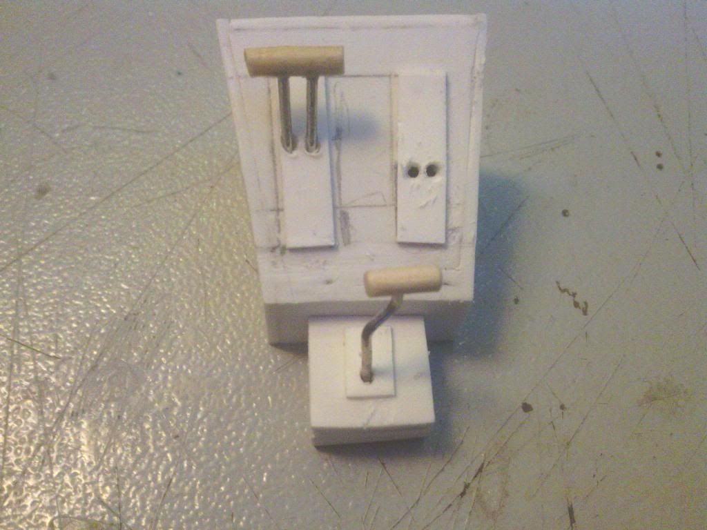

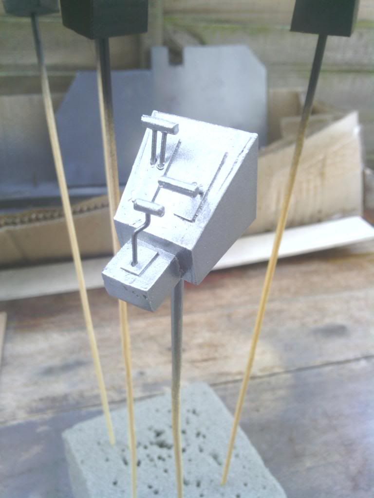

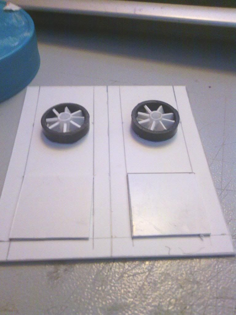

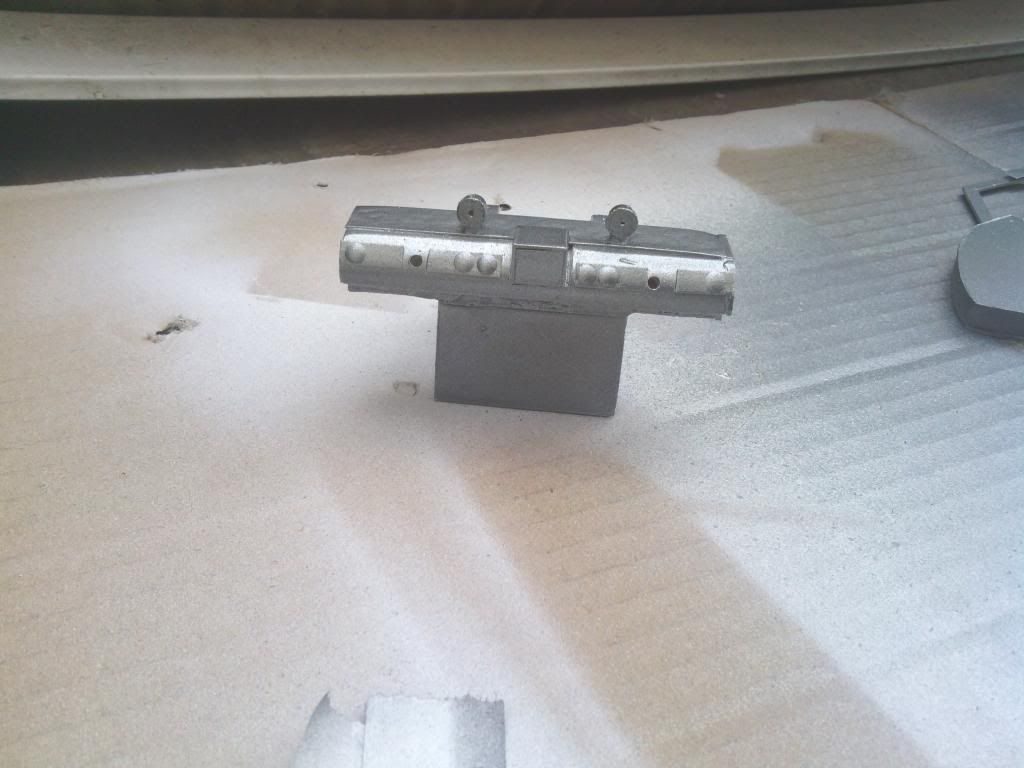

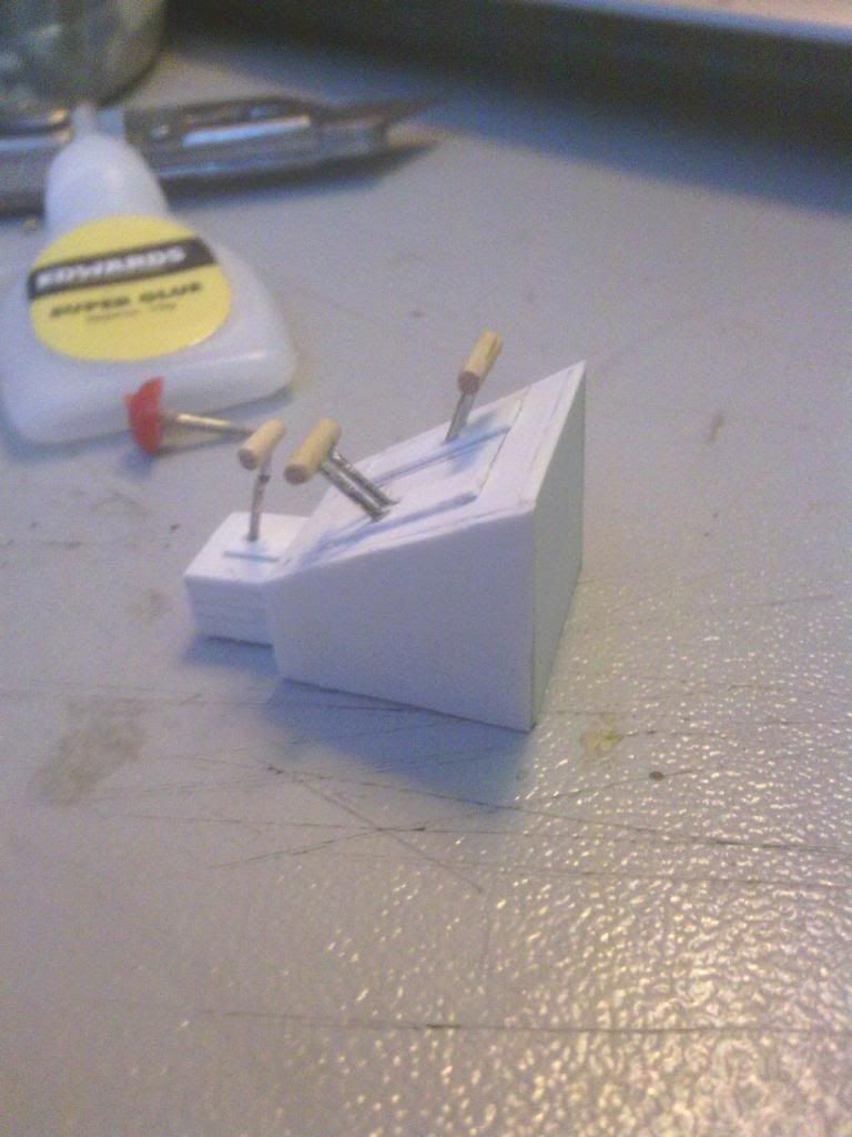

Dashboard detailing now and I have a screengrab showing a central monitor type screen so...... :wtf:
Lego piece and styrene later..

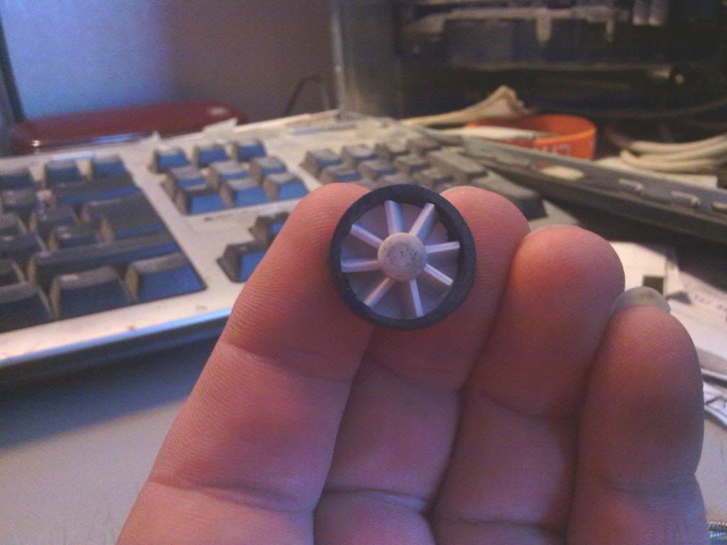

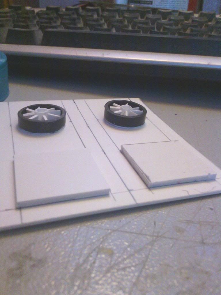

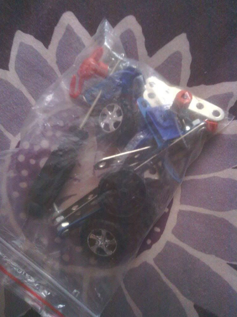

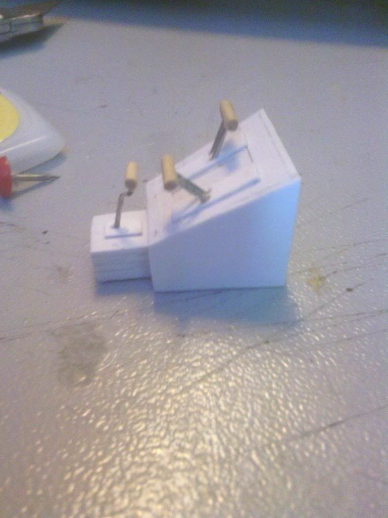

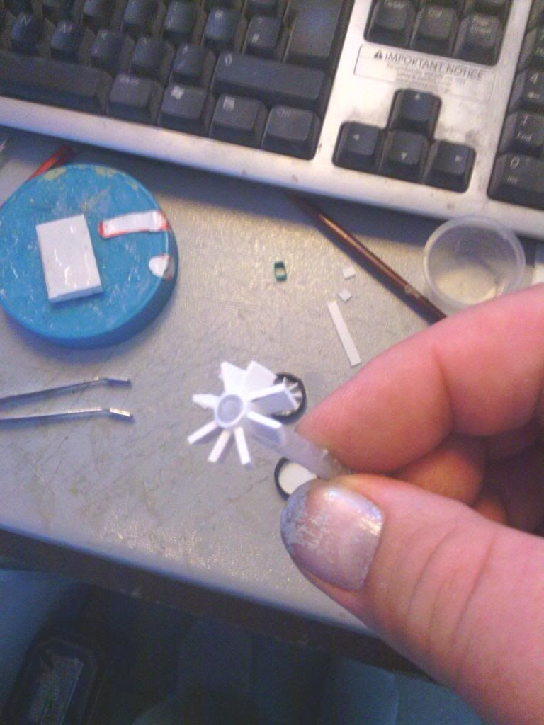

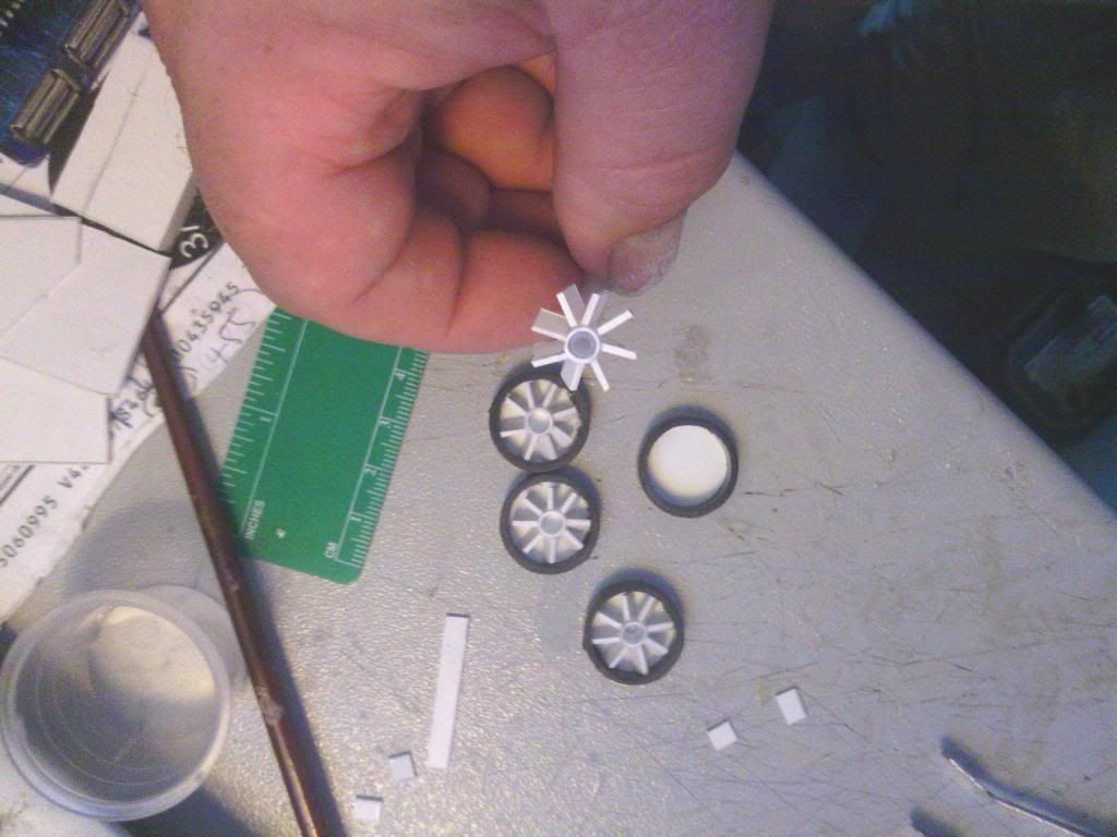

...and we gonna need some steering wheels and in the program the main cabin is equipped to be driven left or right handed
So 2 steering wheels to match the 2 joystick lift and forward/reverse controls on the center console...

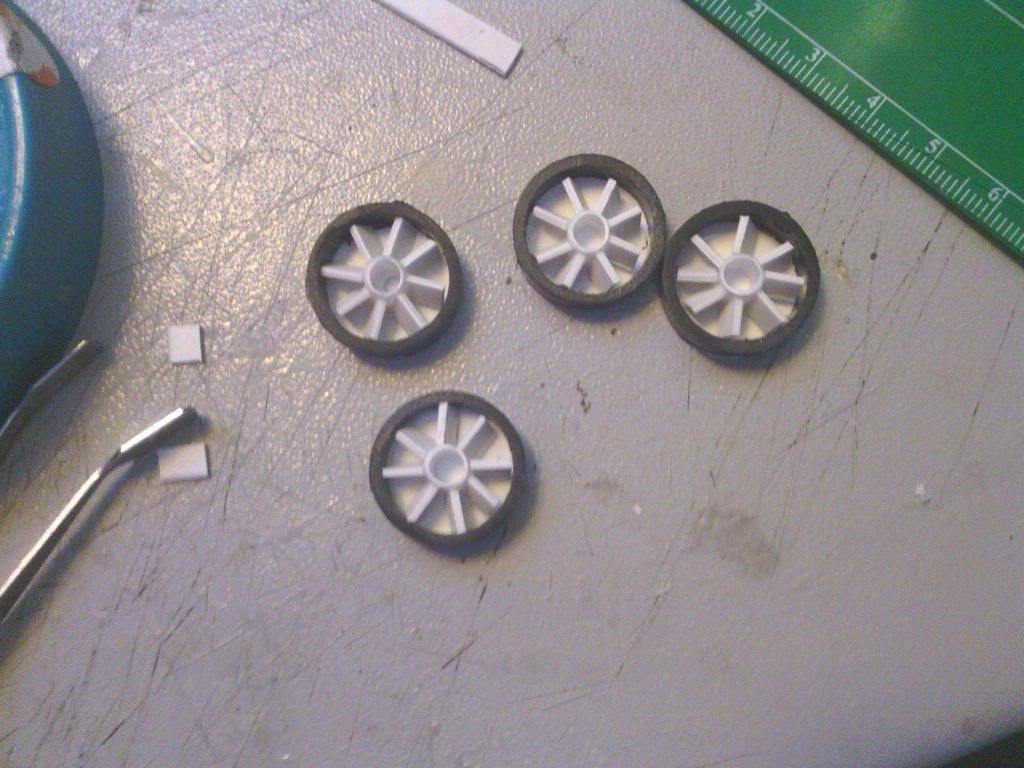

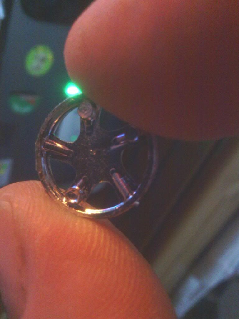

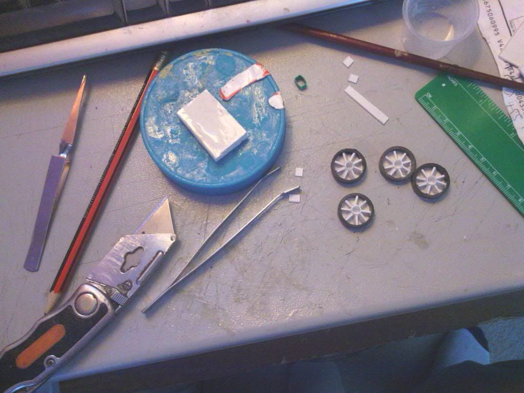

An old £1.00 shop meccano set and im liking those wheels... :think:
Minus the tyres..
Remove the IPM..
and some styrene circles later..

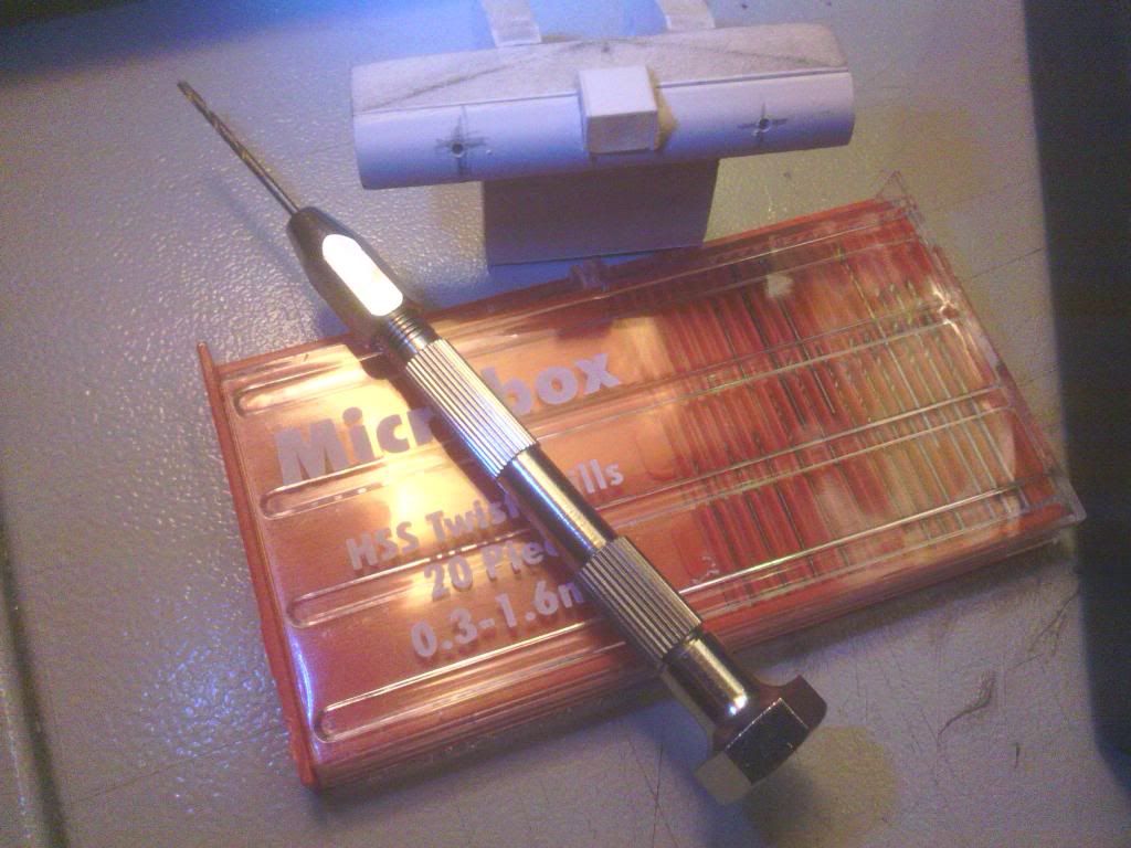

Mark and drill for the steering wheels...

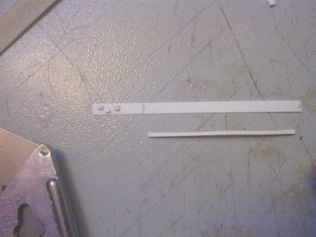

...and add some thin styrene strips to add dash greeblies to....
And that will do for tonight me thinks... :th:

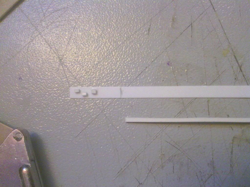

....but back at this little build and I can tell you I have impressed myself over the last day or so with all the bits and bobs going on... you'll see over the next couple of days I promise...

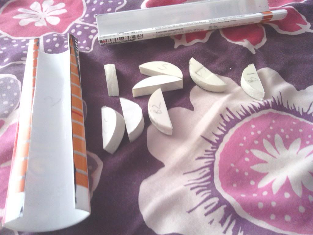

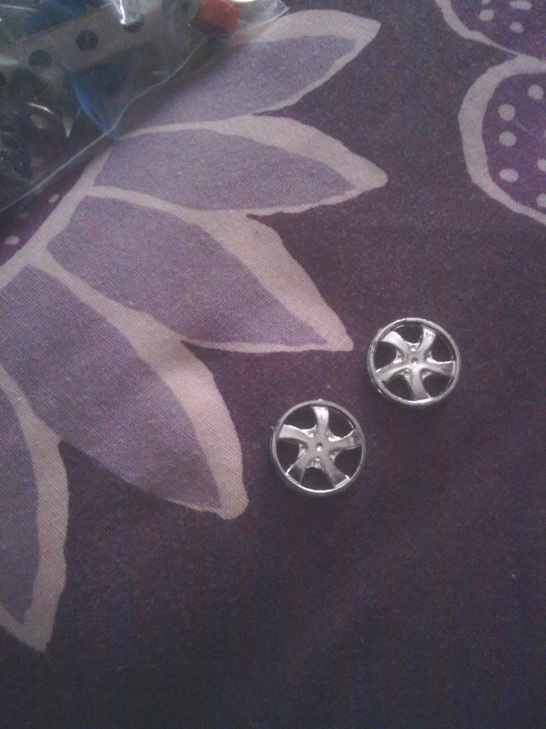

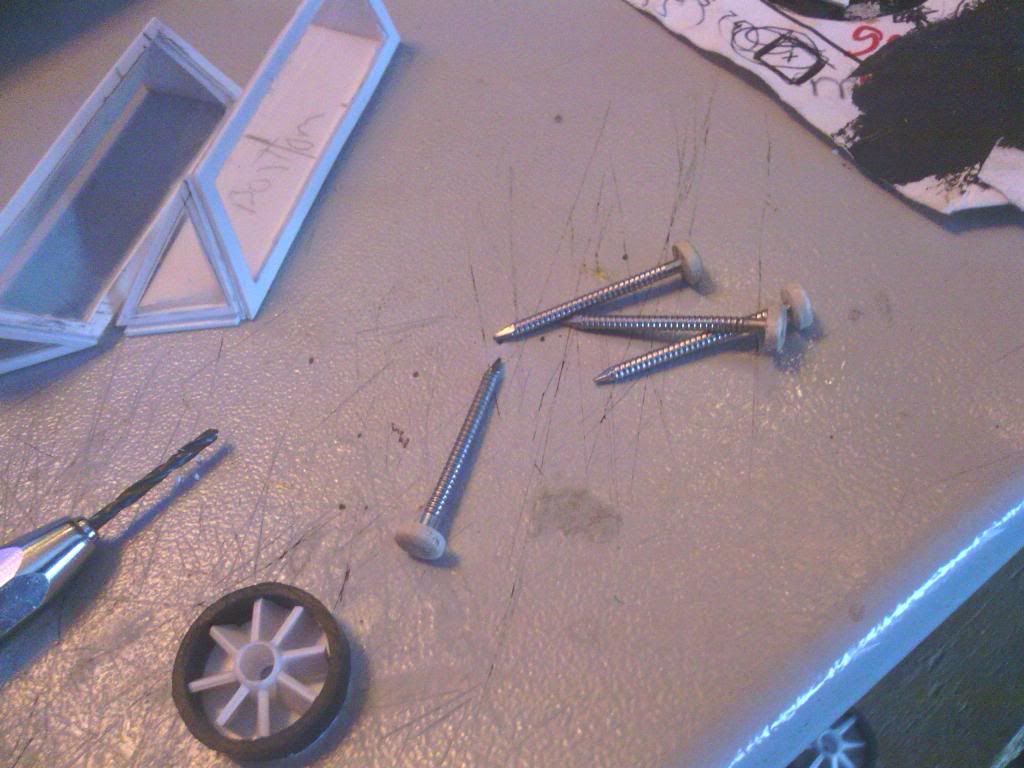

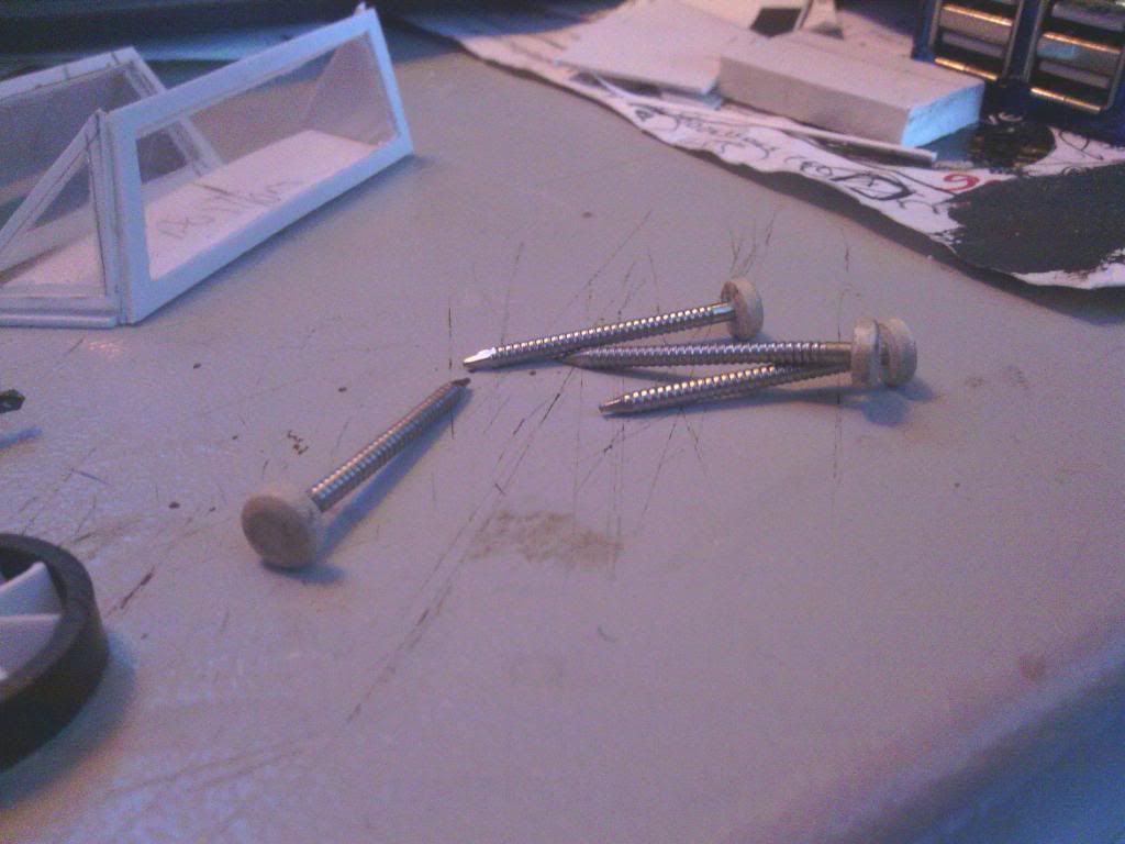

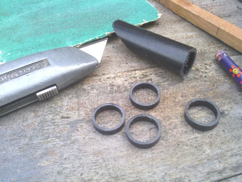

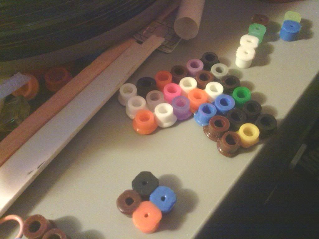

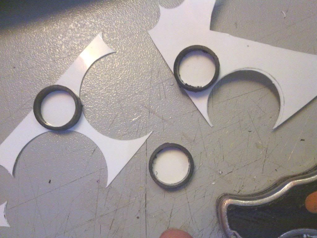

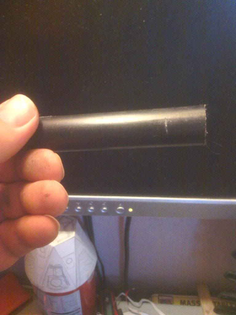

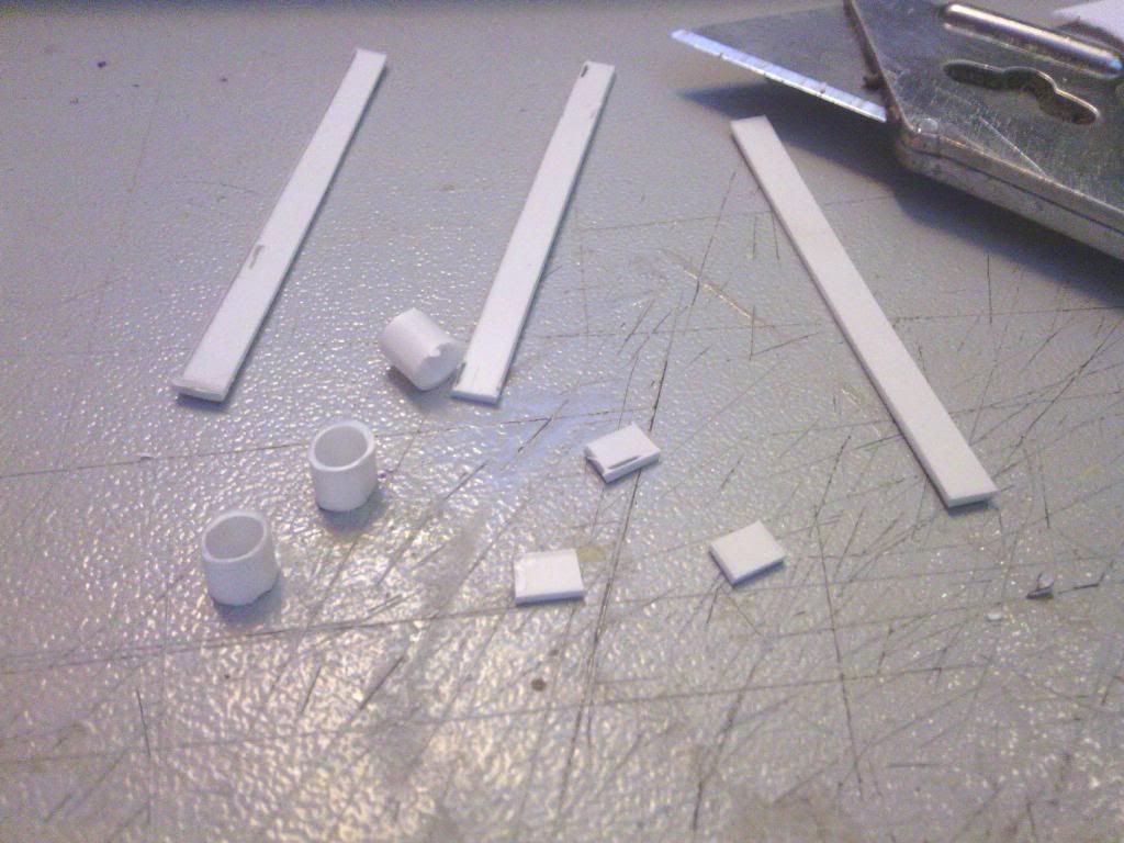

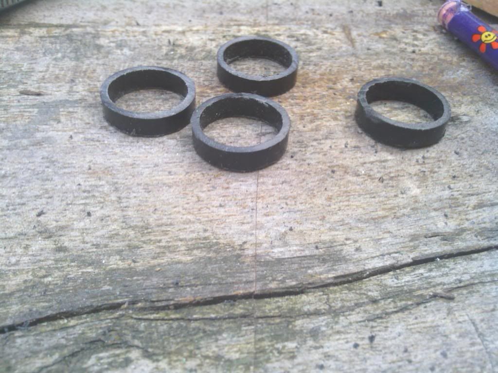

Anyways for those of you with primary school age kids, like me they are always bringing things home they have built at school. Mine use a product called Hama beads.. little plastic bits shaped like the old gun caps from when you was a kid..

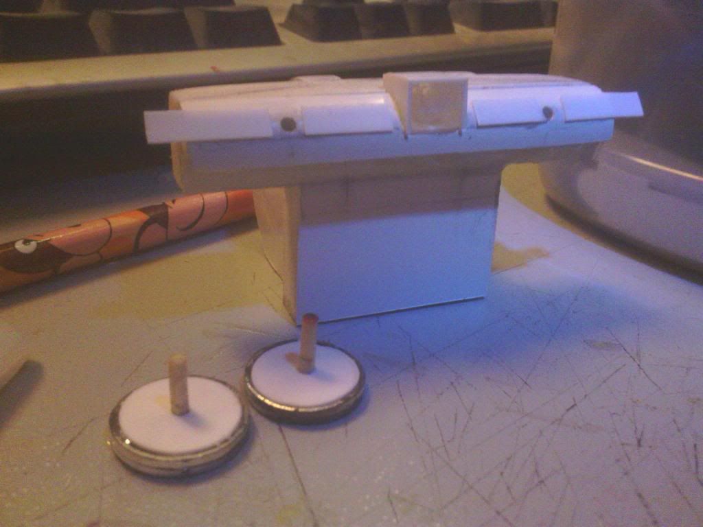

These..

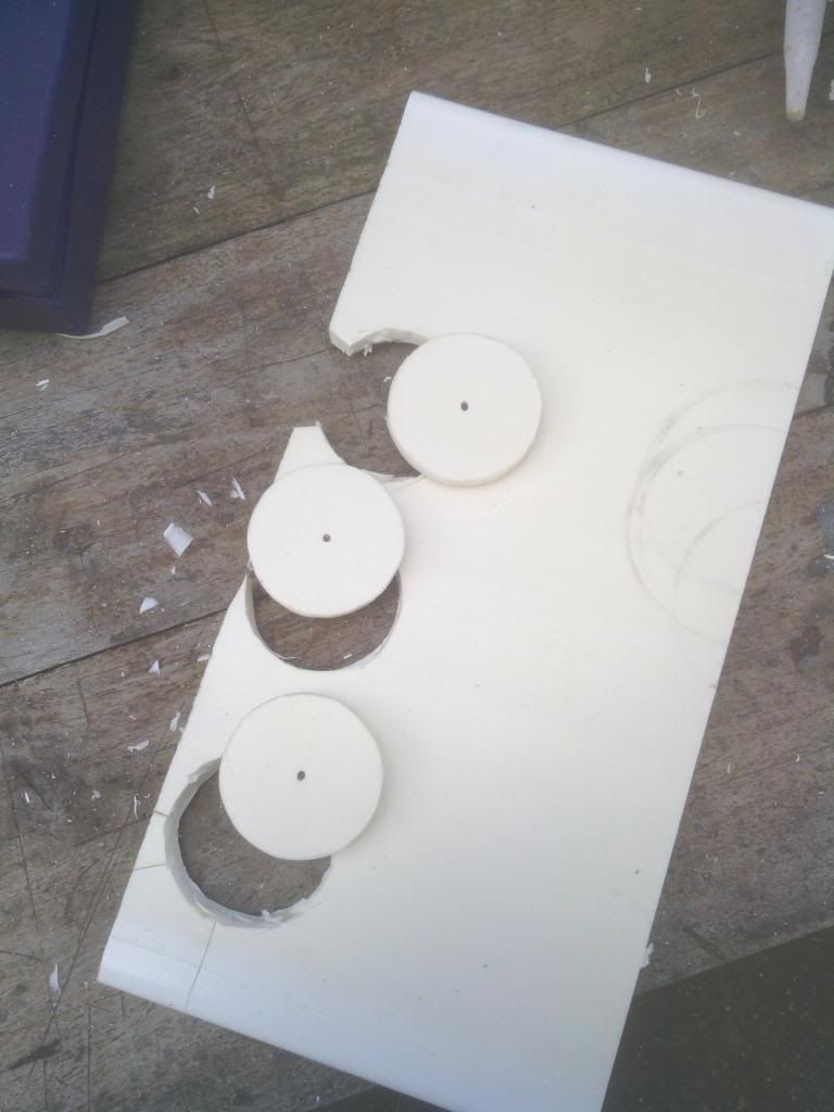

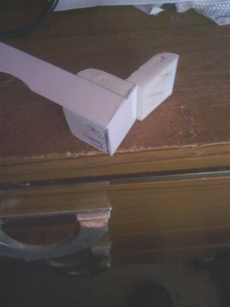

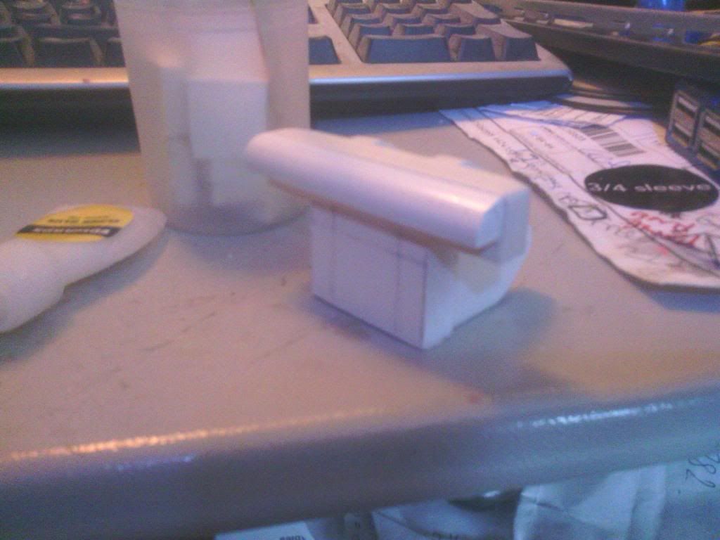

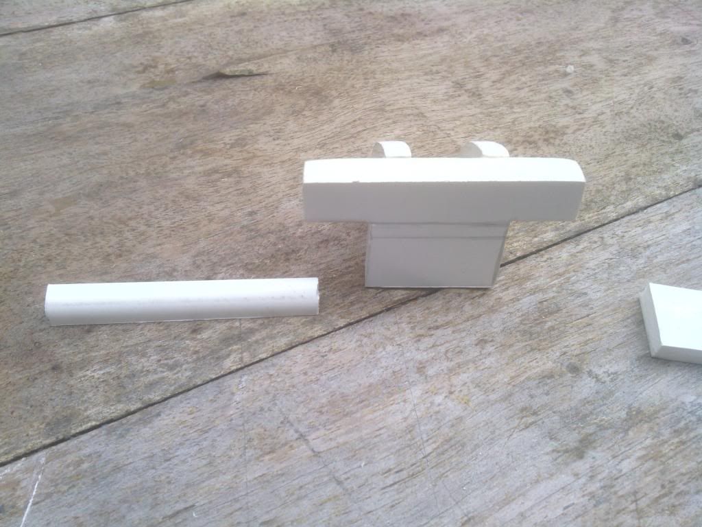

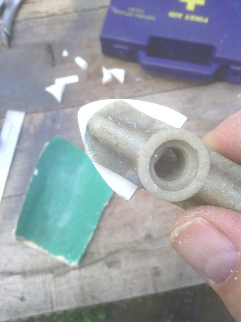

Well I got a use for a couple of those later but for now I will carry on cutting up fasciaboard for some bits for the side..

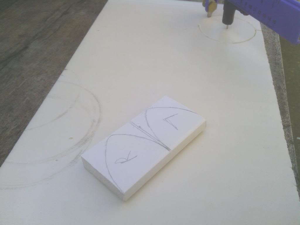

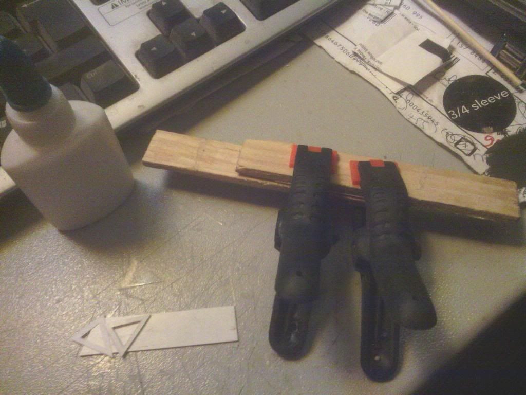

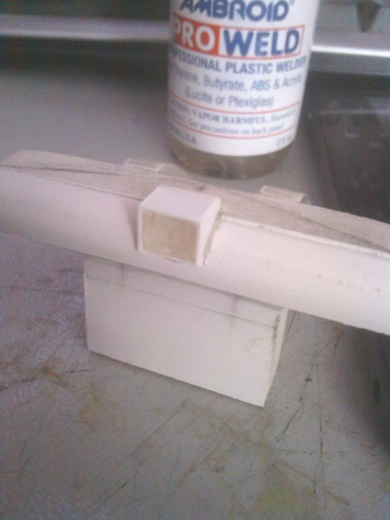

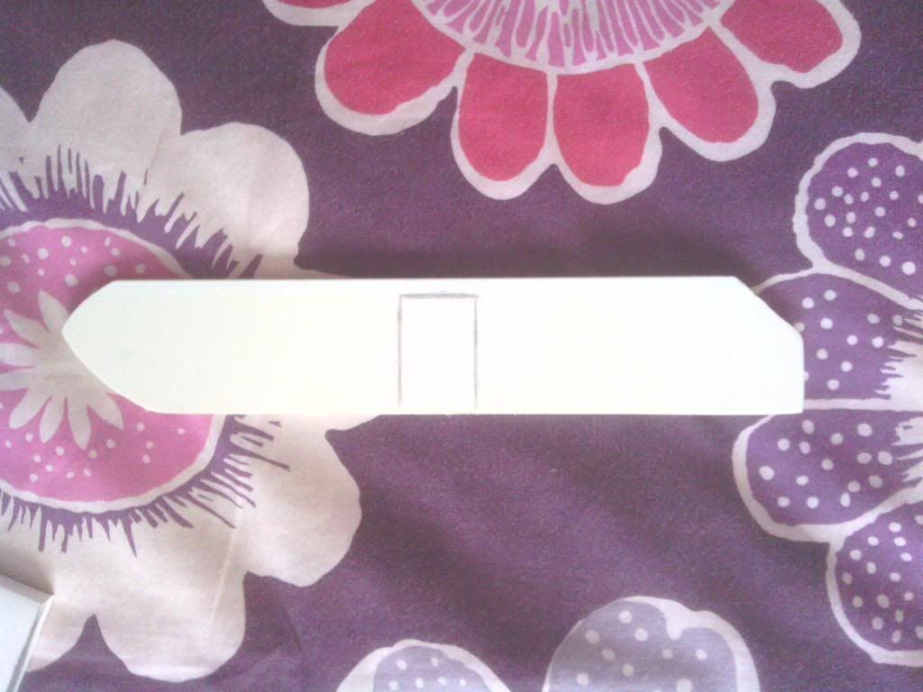

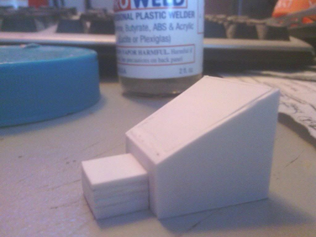

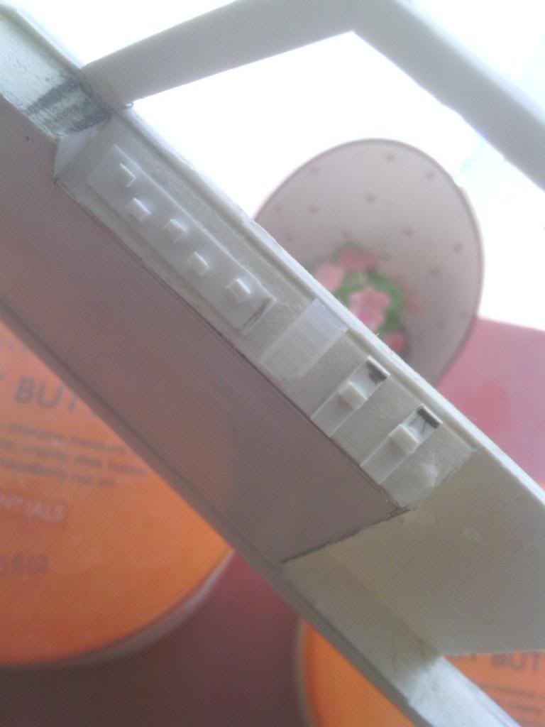

Clamped and sanded to a nose shape for some detailing later..

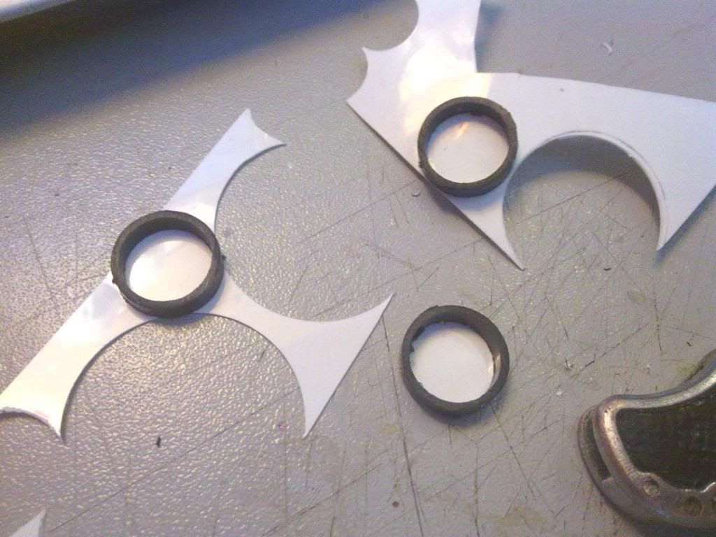

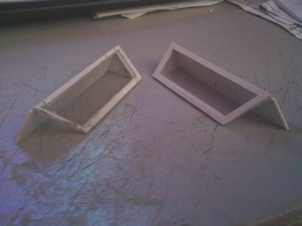

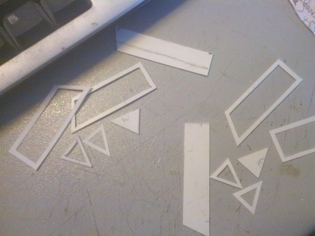

Circles for the side curved pieces to blank them off front, middle and rear..

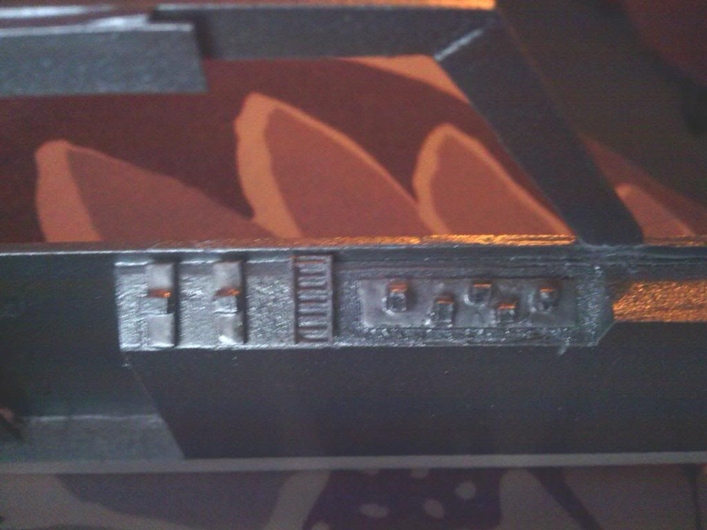

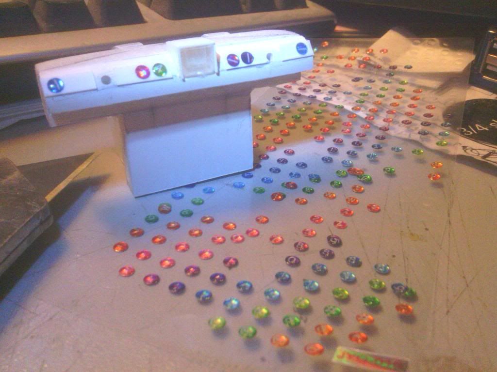

Back inside and some more detailing on the dash..
and a couple of my daughters ( she's 11 ) nail art sticky gem things....
as you can see... I borrowed spares... :shhh:

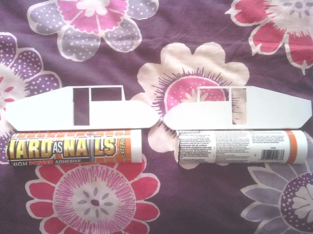

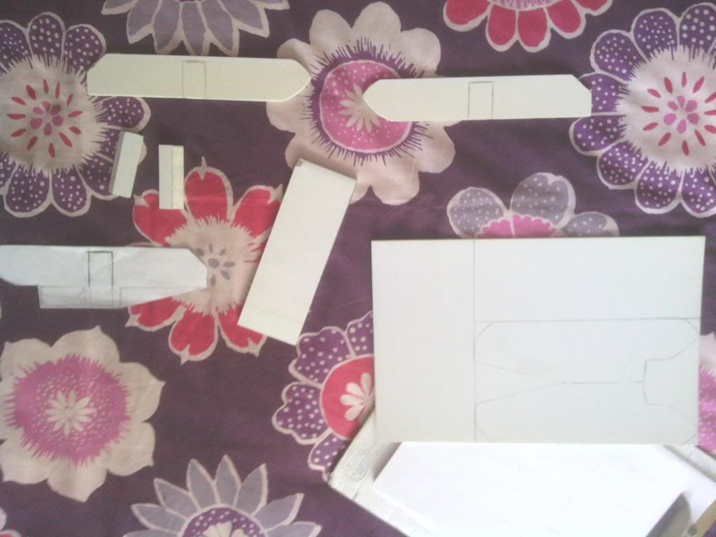

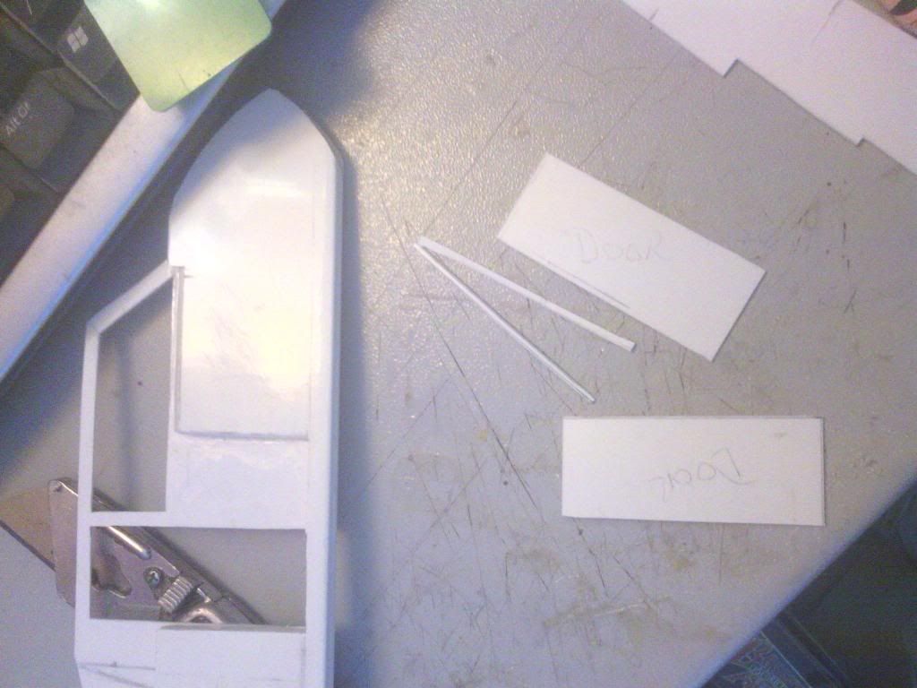

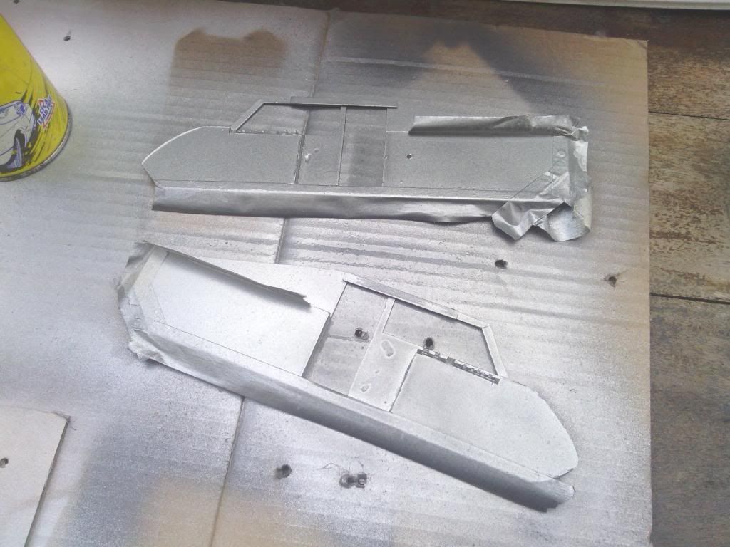

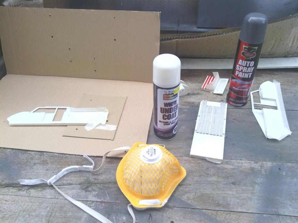

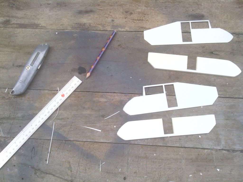

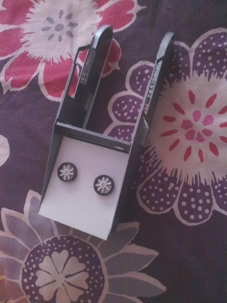

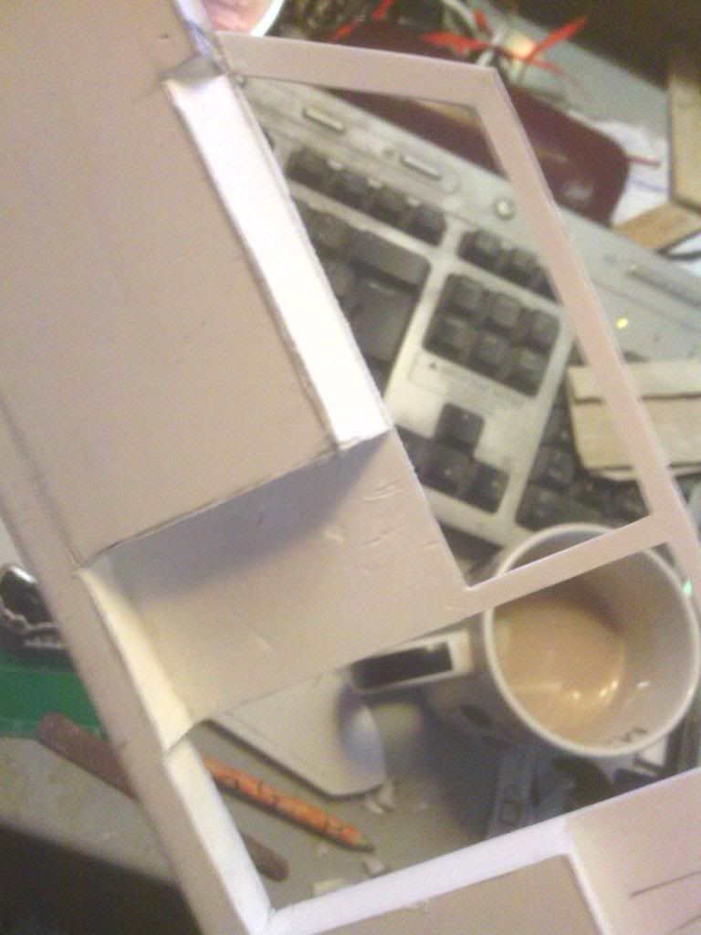

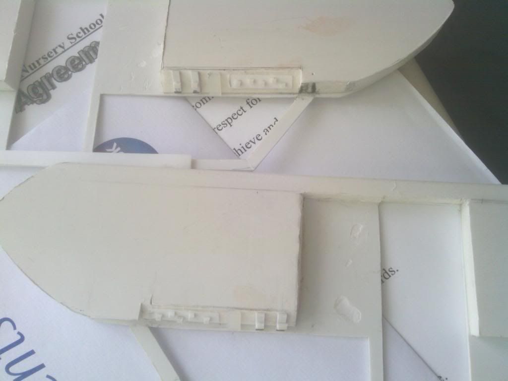

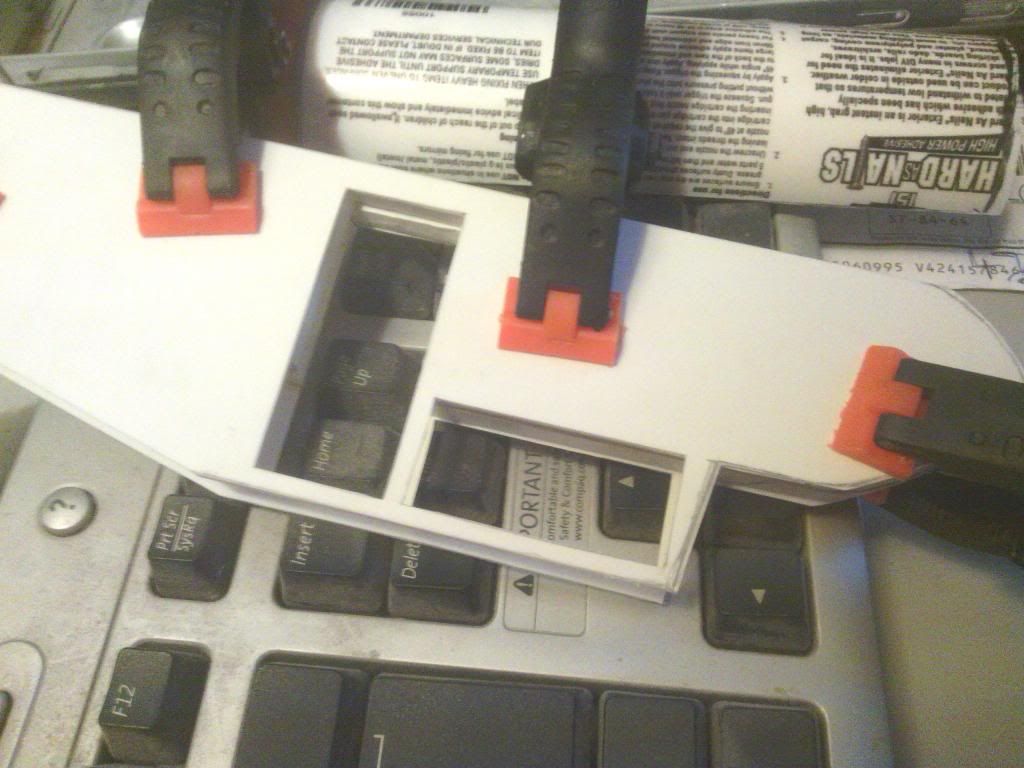

I decided to recut and work the inner and outer walls as I felt I had miss-cut them and after studying some screen shots noticed the inner walls under the triangle side windows had various buttons and things on a panel area. I also decided on having some doors and to maybe cut-out for them to work... :eeek:
You can see I have adjusted the angle of the front window and cut the panel and door recess on both walls...

Now back to those beads and my use for them....
The dashboard in the series has revo's and speedo's and things mounted on it so lets make a couple....
Seat striping next... I mentioned I was gonna do this when I was using the pinstripe on the rear wall... well here goes..
...and finished all 4 seats...

What is that tool/knife in the 2nd pic for cutting circles as I have been using scissors and a sanding stick so it would make my life easier?

Here ya go Dc..... I found you one on fleabay like mine..
http://www.ebay.co.uk/itm/like/26116862 ... 80&ff14=83
My only word of warning would be the thing is prone to start and adjust on its own as you go round and round so with styrene try and make the cut /score on the first pass then bend and break the circle out or if needed make a couple more passes slowly to avoid the spiral cut effect I always end up with mate.. :thumb1:

I have started the spraying and painting stage of some parts so I can think about closing it up..
Okay...... Ford Nimbus Grey Metalic is my chosen colour.... I had a can in my paint stash. :banana:
Lovely colour but you have to remember the undercoat/primer effects the top colour.. :th:
The cabin/cockpit is white primer and a couple of light coats floor, walls, ceiling, doors, dash.
Seats are matt black..
so buttons and raised detail on dash and wall control panels all nimbus grey... raised panels are picked out in chrome which is a shade lighter than already on. Now I can paint all the button effects with acrylic red, blue, yellow and white fine....

Still hard at it.... :crazy:
Busy pegging in walls and adjusting as I put it together....
Sanding, trimming etc.... :eeek:

Okay just a quick post tonight before bedtime.... :shhh:
I mentioned earlier that I was going to attempt sliding doors as the real thing and detail the buttons on the wall panels so I will post just that..
Firstly the doors... and I decided to create a runner above the door and a runner/ floor piece on the step to hold the door in place.
...and the runners.. :th:
I will make a start on them buttons using 1mm plasticard on a 0.5mm panel backing like so....
Door handles while I wait for buttons to dry... :whistle:
...and repeat for the other side now... :dance:
...tis done... :wtf:

side windows...
Now the glazing bottle ... :lol:

Well I am still hacking away at bits of plastic..... You should see it now.. :whistle:
I have come so far it'll take me a week or so to catch up.
Right windows on the side..... stupid angled things.... all triangles... :crazy:
Lets have a go..
Bits of lat to use as a press while the white glue sets..
All clamped so wait a bit then.....
...Ta-Da..
Plastic glazing as well....
Inside view....
Think I best start priming these bits up...
Yeah cheap and nasty £1 shop rattle cans...Geez I'm tight.
Coated..... well its a start..
Inside white, outside grey to give a tonal difference for the top coat.
Dry now so a quick flash with the silver inside. The walls and dash will get the same..
This is the paint but as I posted earlier it stopped working after the insides were complete... :(
Floor next..
All together minus the dash...
While its nice and I am outside I will coat up the chairs with a matt black finish..
More £1 cheap stuff// :thumb1:
Dash and console too then....
That will do for today................ :dance:

So a couple of posts back I teased you all with some 3/4 conduit well its build time.
These slices are gonna make me the 4 fans at the rear. 2 on the boot/hood and 2 where the rear lights would be.. :whistle:
I re-worked the side windows slightly and made up the front glazed part..
They may get some more adjusting to fit yet... ;)
Back to those fans and in order to build them I had better back them first..
...and I am going to have to scratchbuild the fan part as well ( this is a scratchbuild after all )....
So the centres are made from styrene tube ( an old Mcdonalds balloon stick ) and 8 blades from 4mm square styrene stock..
Glue up the 8 blades at an angle ( like this / ) to the balloon stick and....... :eeek:
Stick them in the now dry conduit slices and.....
Build some more...
And then there was 4..... :th:
I need to work on the side curved pieces so rack my brain for build ideas...
Gonna go with the 4 half round 8mm thick fascia board circles from the post ages back...........................
But while I work on those lets have a quick "bits" shot..... ;)
and buttons on the inner walls after the raised panels are painted in a different silver..
A start on the boot/hood where the fans and a couple of raised panels detail...
and the panels at their correct height...
The fans need some centre caps and a way to pin them in place so I recycled the polytop pins that held the window capping in place ....
Drilled a hole like so... ( windows sat waiting in the background )....
then did this with them...
