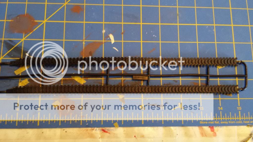

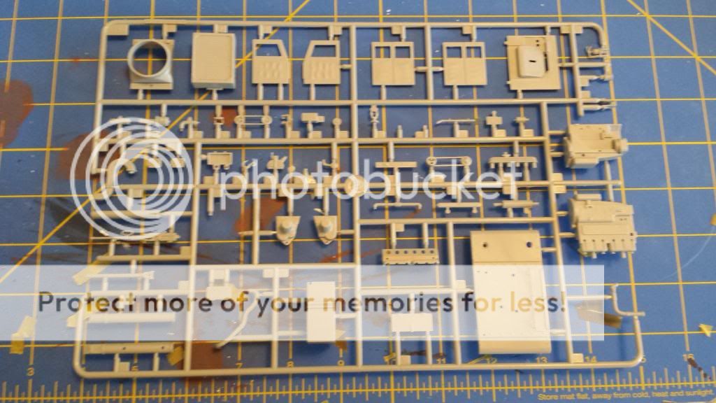

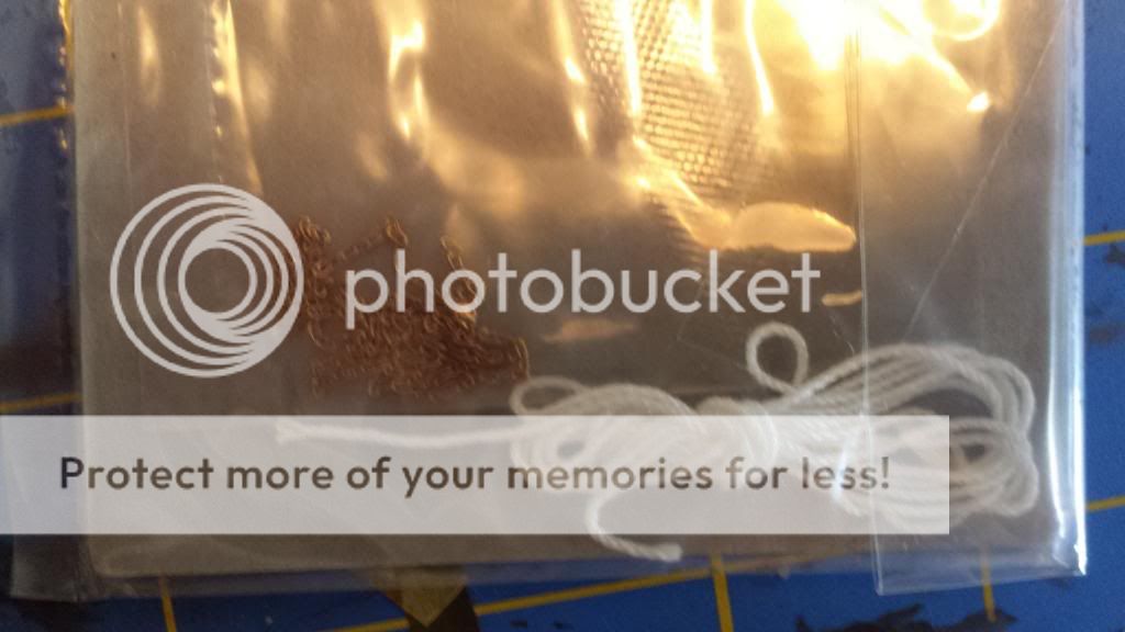

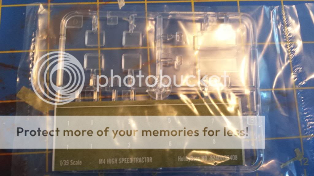

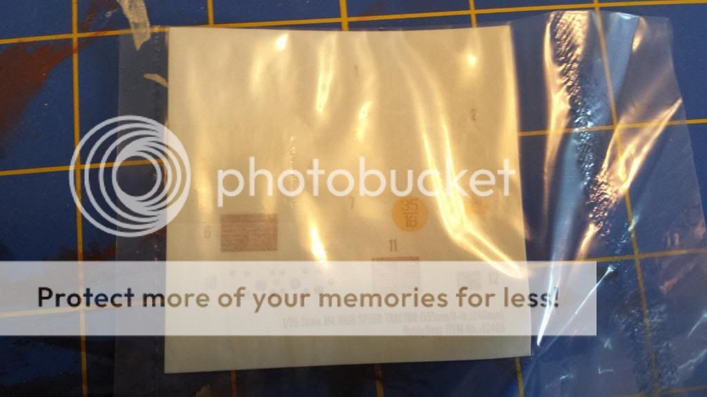

The tractor arrived over the weekend. So I'll go ahead and do my sprue shots. Note that there are some pictures missing as photobucket can be dumb. Also, the pictures are always crystal clear on my phone but once I put them on here. Not so much.
I kept the decals in the plastic bag because there's not much point in opening it right now. But aren't they glorious. 12, only 12 decals. I love it! haha
A mask set which is very nice of them to include.

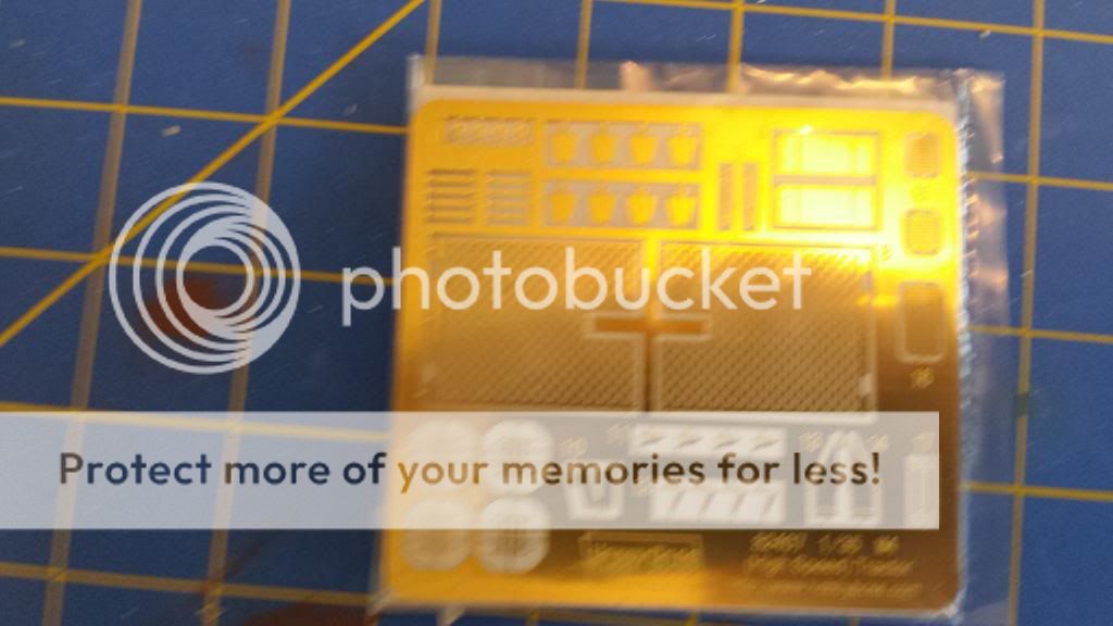

Some rather heavy brass photo etch.

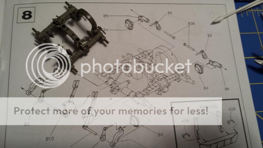

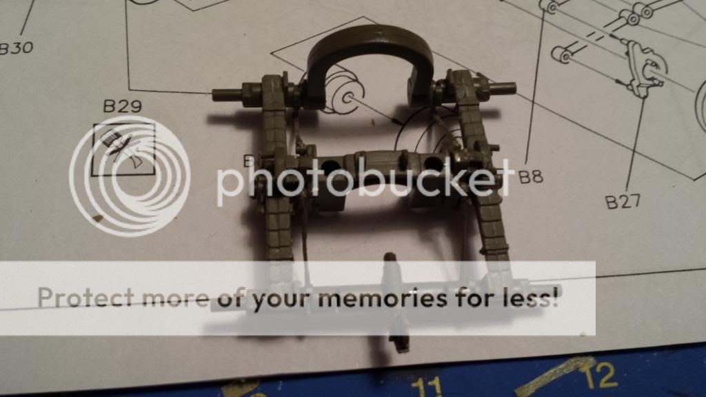

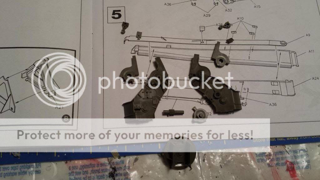

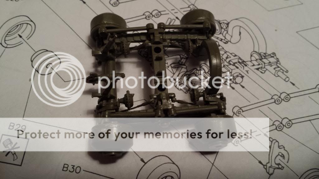

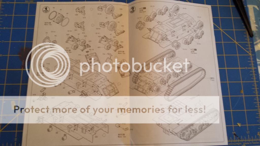

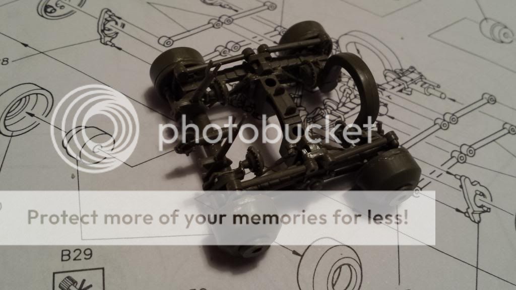

Right then so I got to work on this bad boy over the weekend. Aaannd I have only 1 picture to show. Note to self, take more pictures.
Steps 1 and 2 are complete and I must say that so far this kit has been a dream. It's going so smooth at the moment it's almost scary. Oh and I worked with my first 2 pieces of brass photo etch and my god. Why is the silver photo etch a thing? It was so much easier to work with the brass.
I also received the Long Tom today. Ignore the Big Ed set. It's for a Blackhawk.

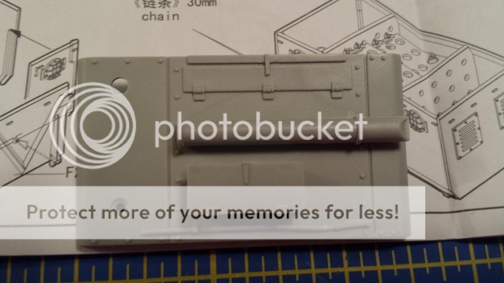

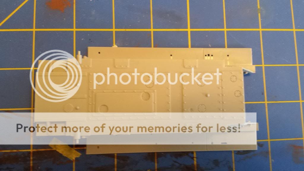

The never ending EPM on this kit is.... what killed the Fun for me !
I wish you good luck with it...
Those are visible even after adding other parts to the kit...
Hobby Boss has fallen down in grace... in my book !

Yeah, I'm about to put some filler on them...

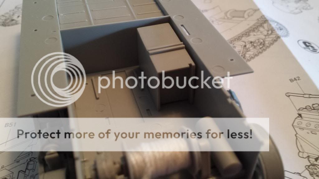

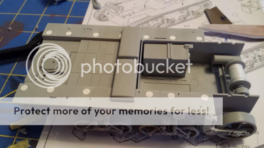

Update 2: Progress
I remembered to take more than one picture. Yay me! :dance:

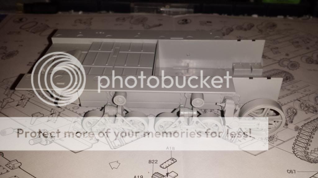

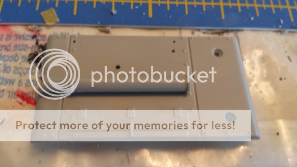

Nasty EPM taken care of. This took longer than it should have because my sanding sticks need replaced.

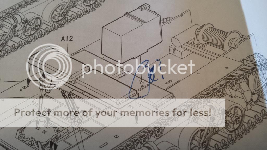

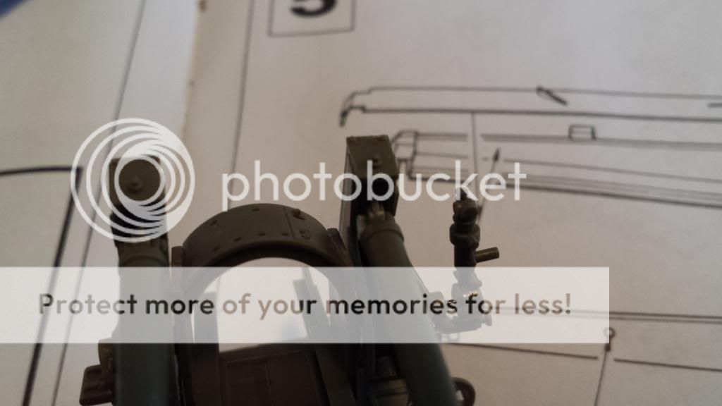

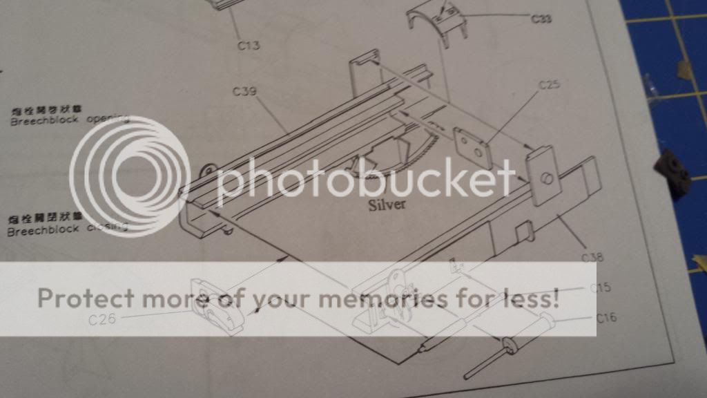

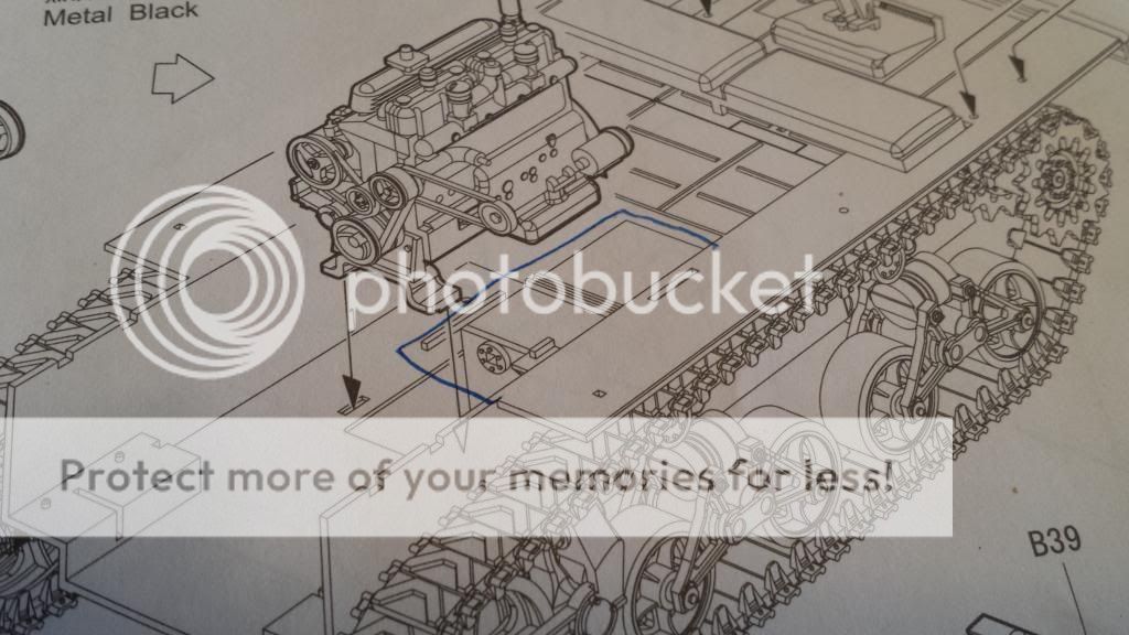

So I continued with the guts of the vehicle when I noticed a fooboo in the directions or I'm an idiot. It looks like they want you to cut inside of the bench but that doesn't make any sense.
There was however a page with said piece shown in place. That makes more sense.
Perfect fit

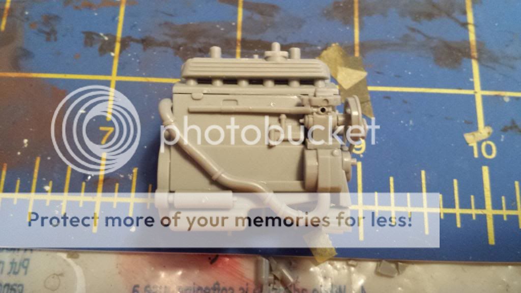

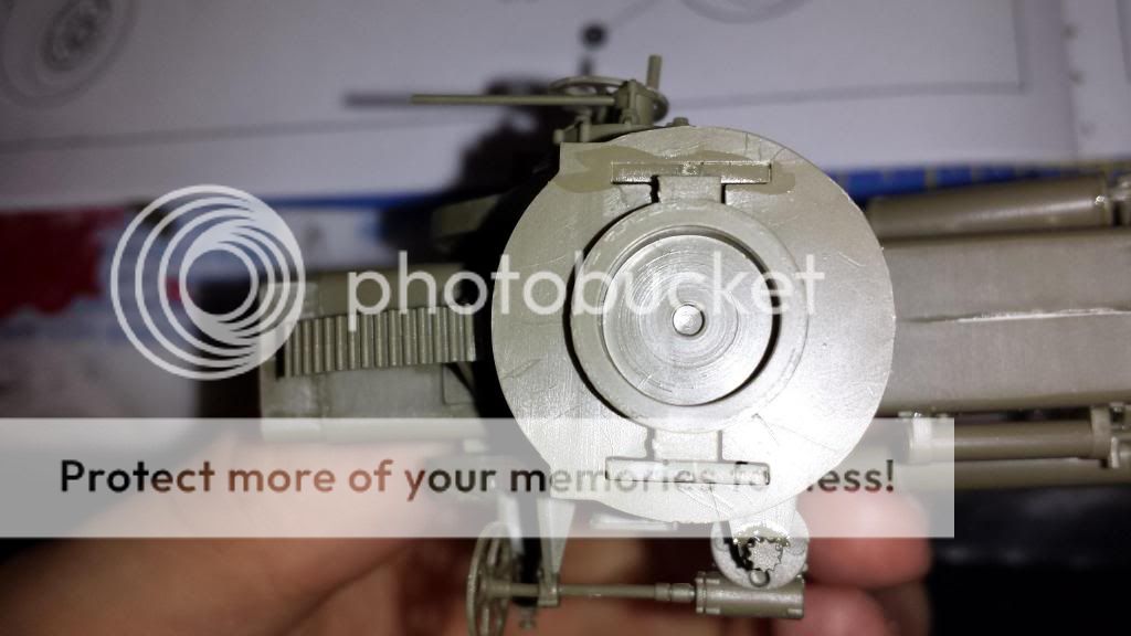

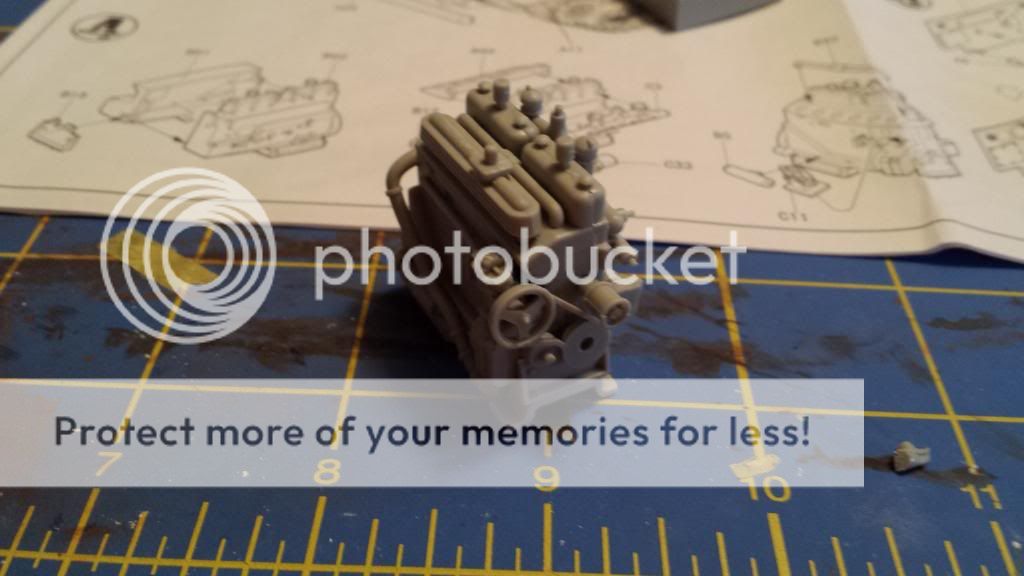

I then started on the engine. There are quite a few gaps and seems but I may just leave them as some of them would be a pain to clean up.

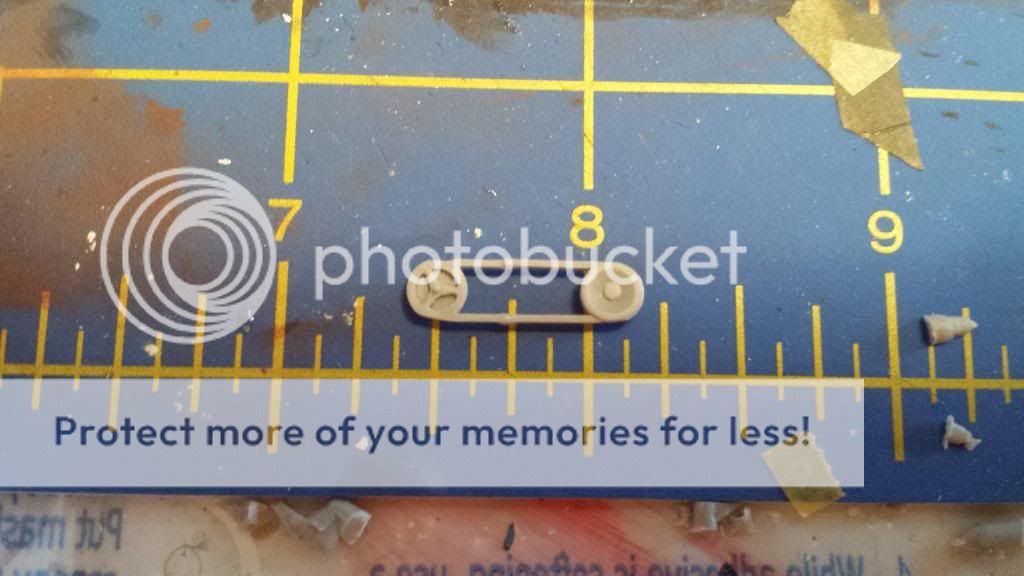

I went to sand one of the last belts that goes on the engine when an uh-oh happened. :ooops:
Not perfect but better than being in two.

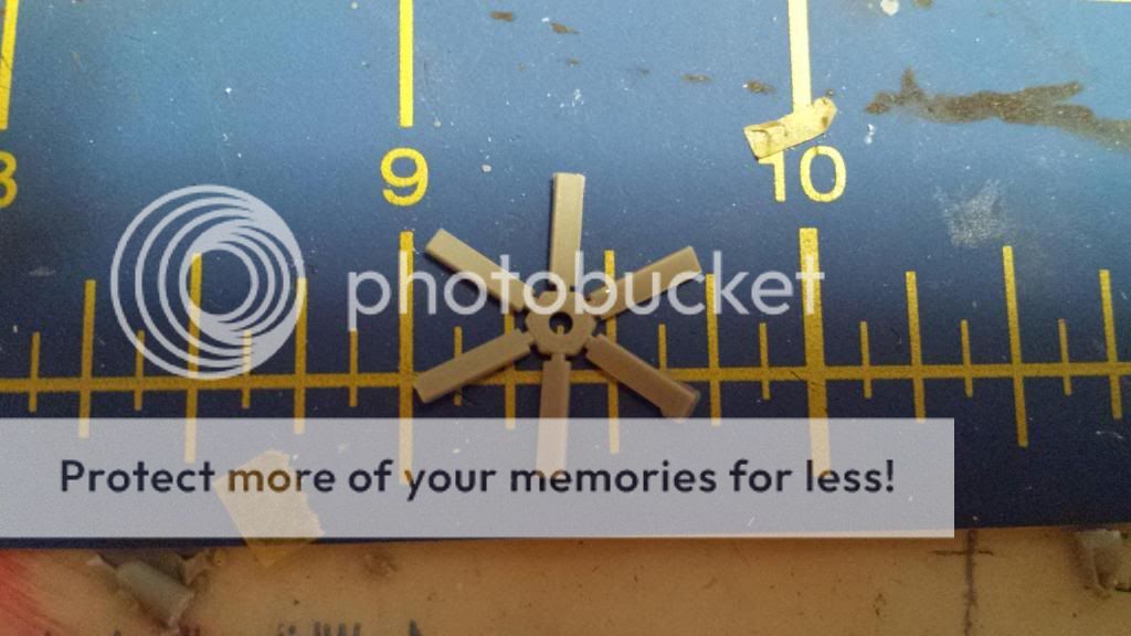

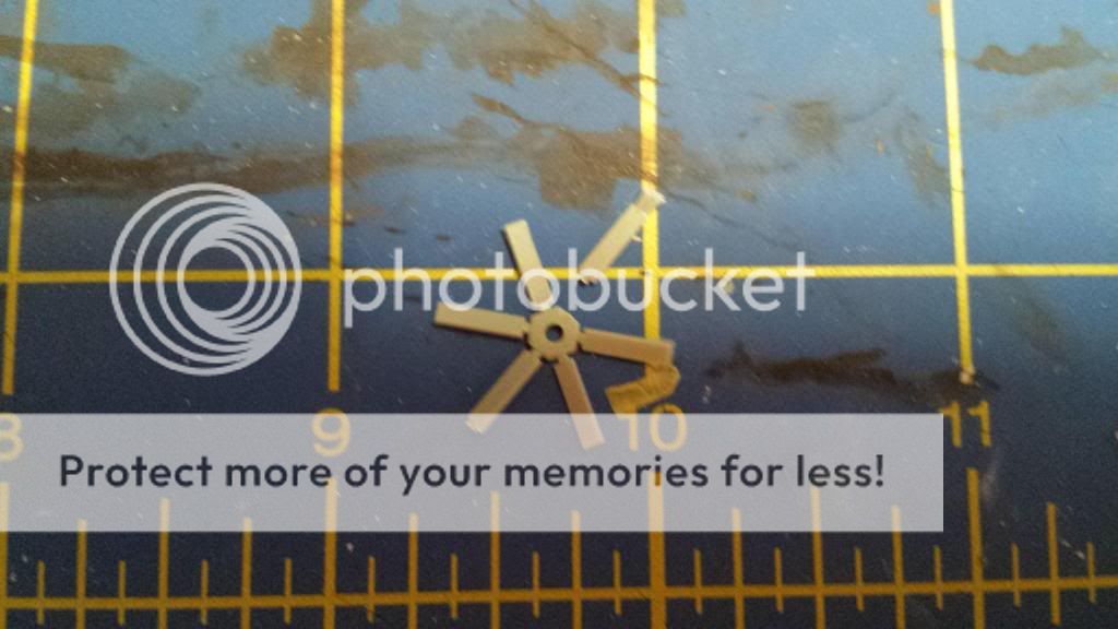

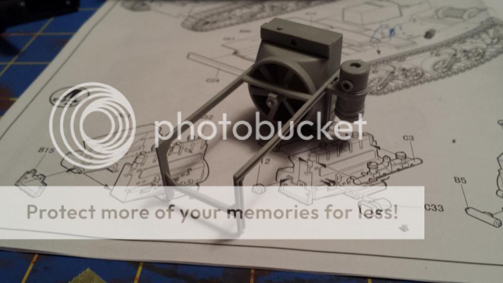

Next was the engine fan stuff. Another uh-oh but this time it wasn't my fault. It was like that on the sprue. It's a very delicate piece with very delicate joints.
Good as new
Engine coolant system? Fully assembled. Engine coolant system sounds better than engine fan stuff ;)

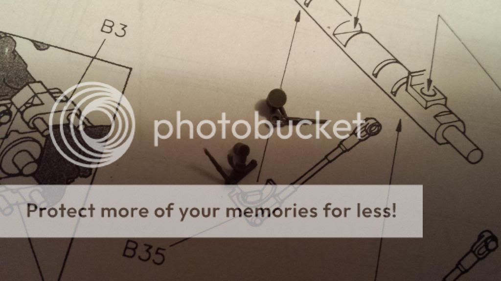

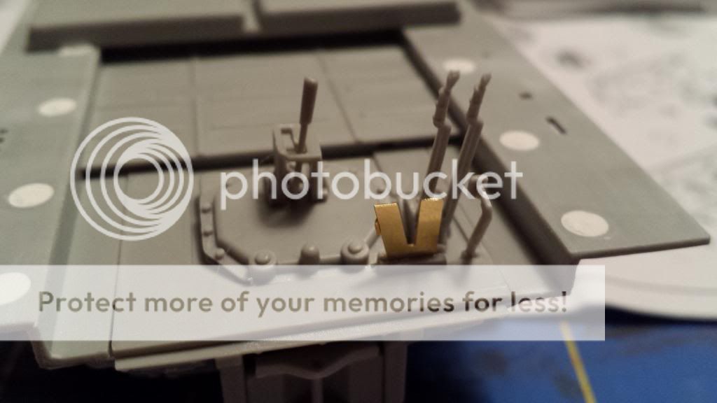

Went back to put the pedals and such things in.

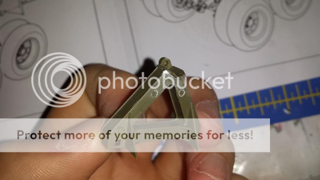

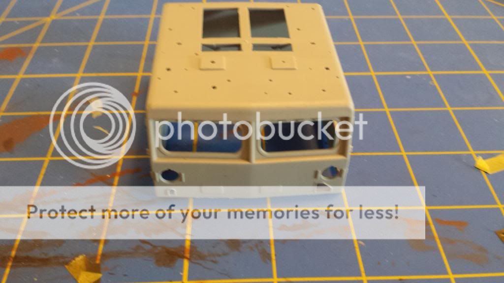

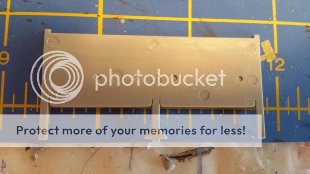

Update 3: EPMs...

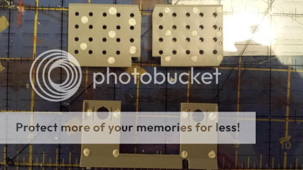

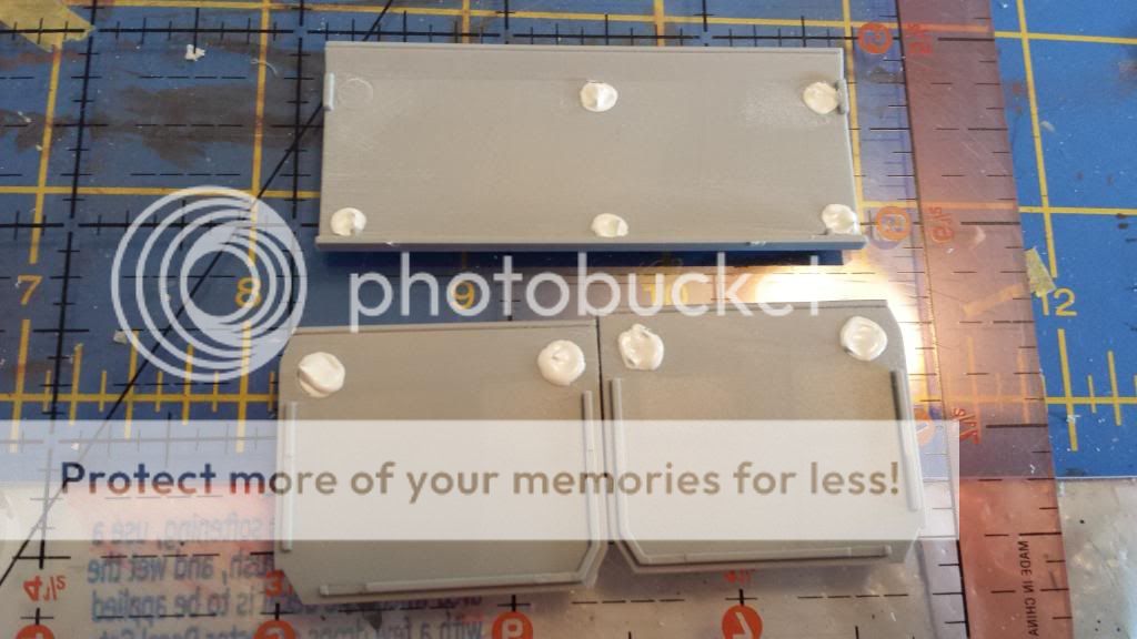

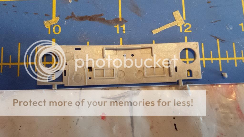

Right then, I had been warned about the EPM on this kit. They weren't wrong.
This part isn't too bad.
But this one is just a wee bit excessive ain't it?

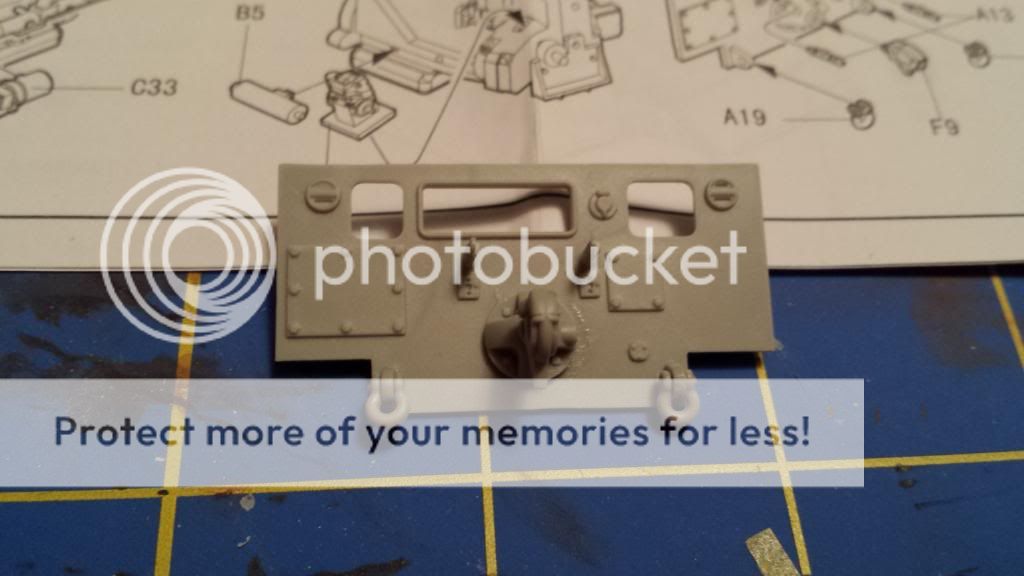

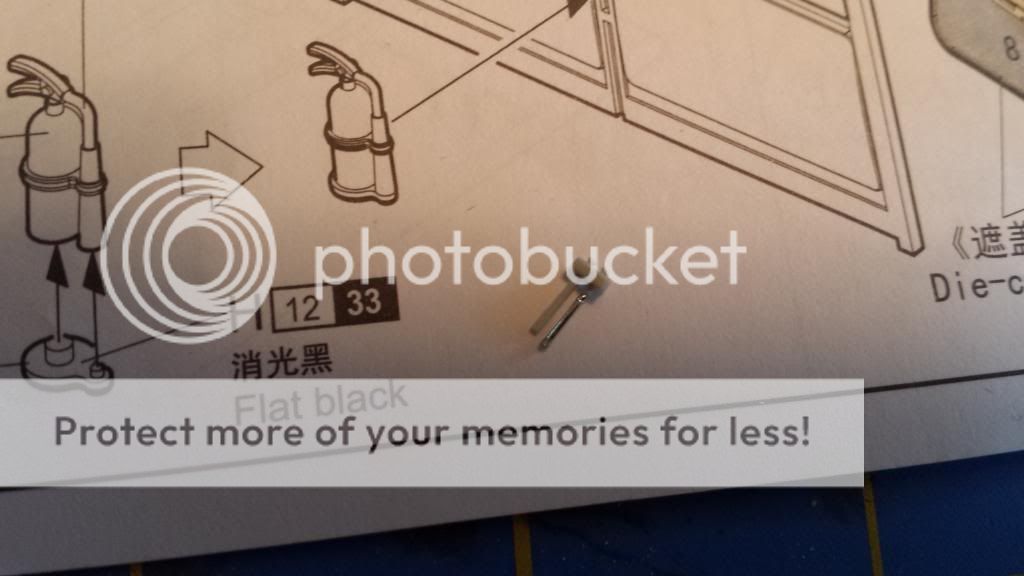

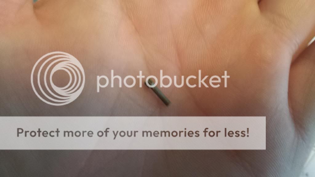

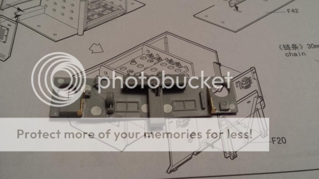

I moved onto the the details of the dash and hit a fooboo. That's not supposed to be metal on the right... One thing about this kit is some pieces are so effing delicate that they just snap when you cut them off the sprue. So I took a pearlized needle used for fabric, cut it down to approx. size and glued it on (note that these are pretty tough so you'll need a pair of wire cutters). It goes inside the dash so no big deal.
Here is the dash finished

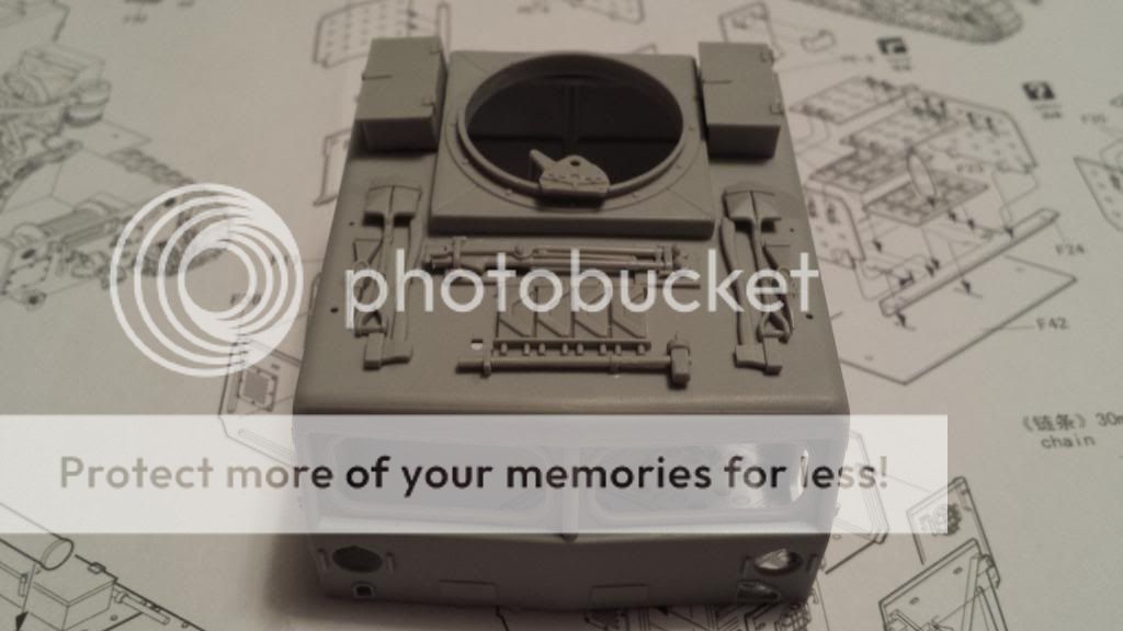

I then put most of the bits and bobs on the exterior of the cab.

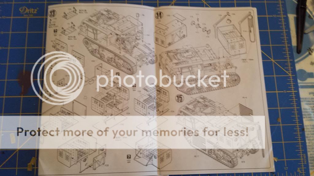

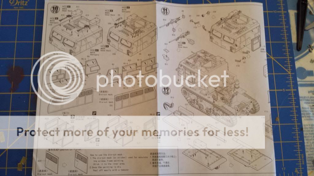

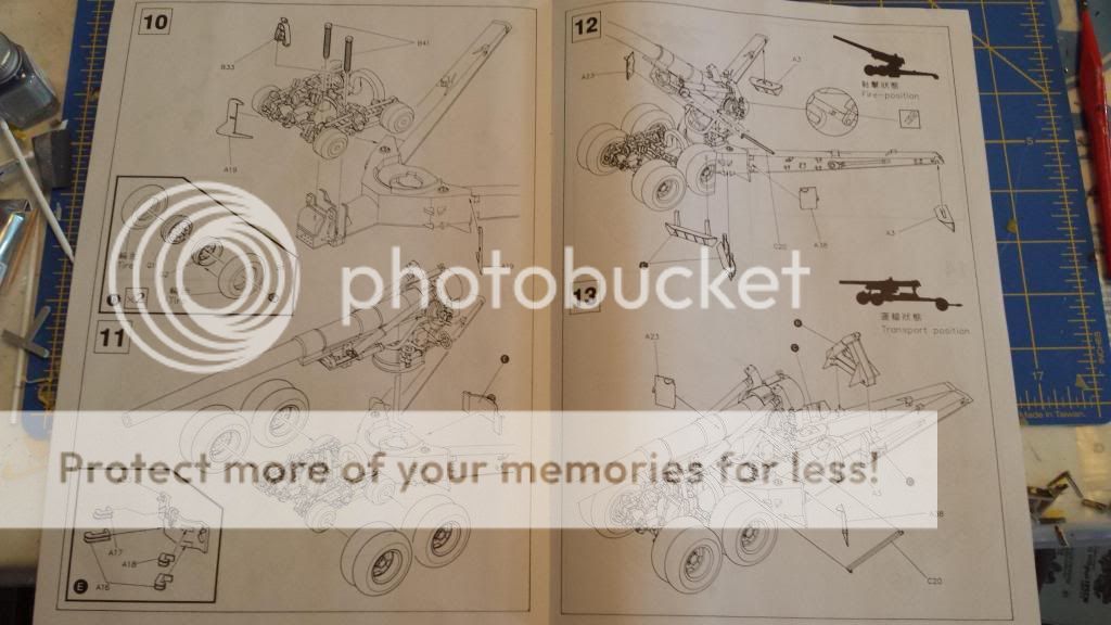

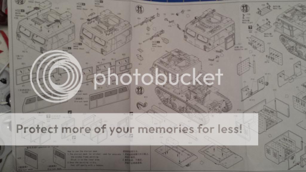

Another small criticism of this kit. Sooo much going on on this page with little break up. Gimme some lines and boxes! Actually the problem is that half of these steps have "options" which should be presented differently as it can be quite confusing.

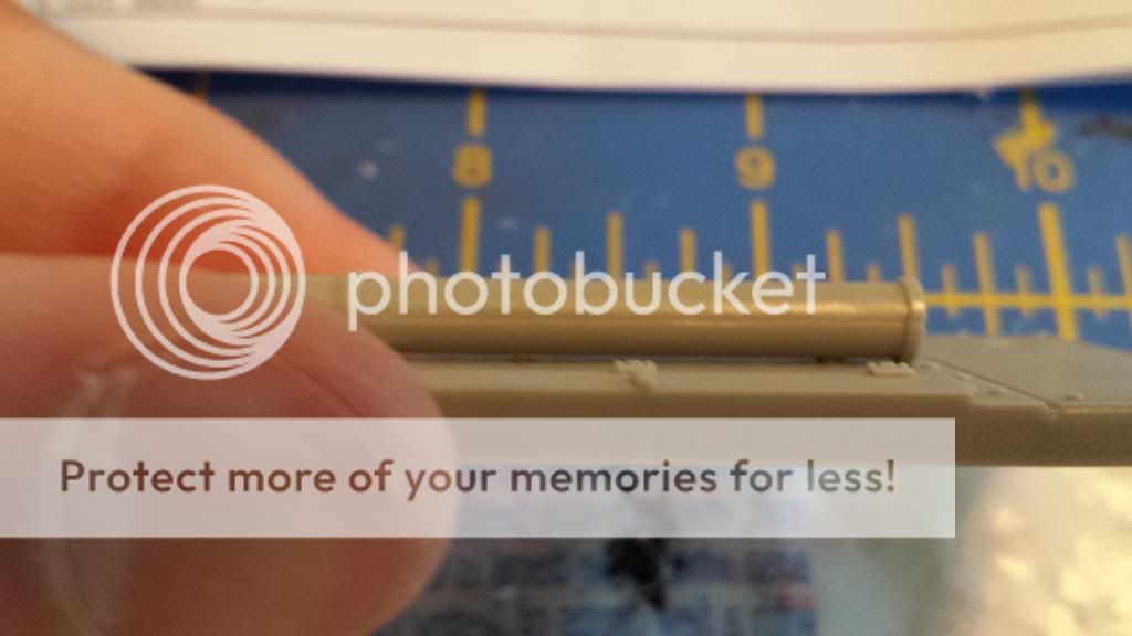

Errr there's supposed to be another locator pin. I don't recall clipping it off...
No matter, it was just to line up with the exhaust to make sure it isn't crooked. I don't know if you can see it or not but I used a needle again, those are becoming a great tool for screw ups :lol:
And it's pretty straight.

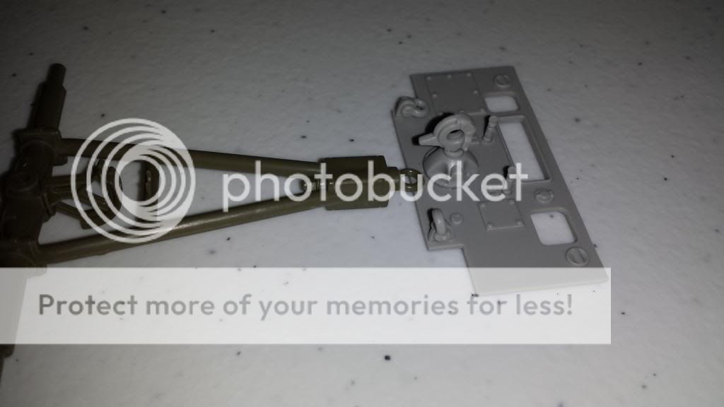

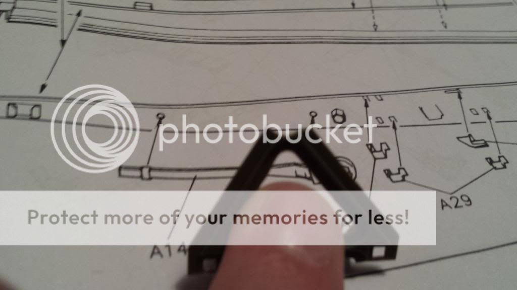

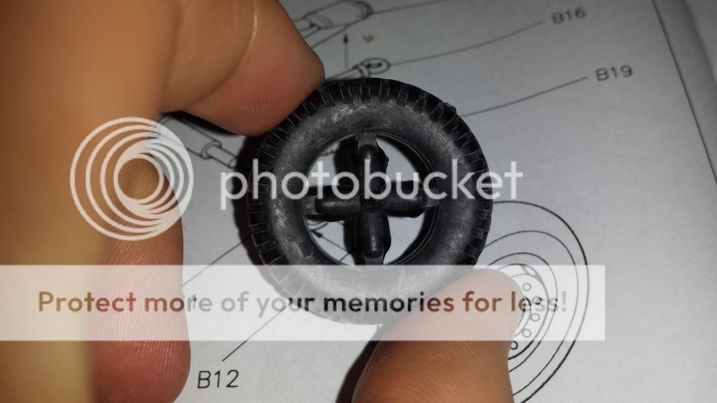

I'm not sure what that thing at the bottom is but it was quite warped on the sprue. I tried my best straightening it out but didn't want to break it. I'll just say it's supposed to look like that :whistle:

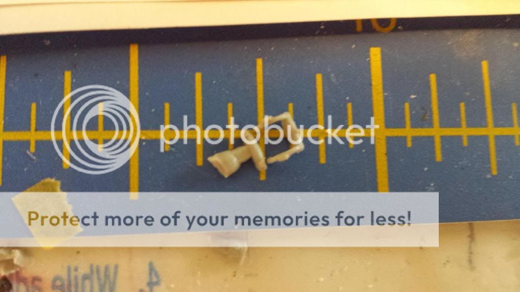

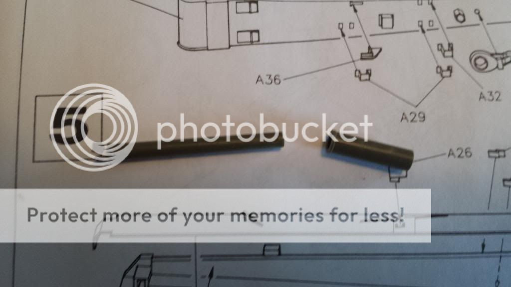

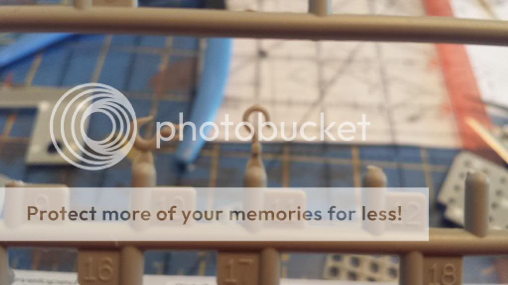

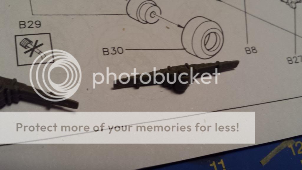

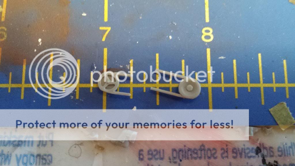

Another mishap :doh: Tried to make as easy a cut as possible but it just snapped. I forgot to take a picture but I glued it back on just fine.

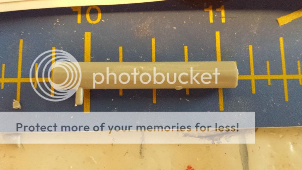

More lovely EPMs...

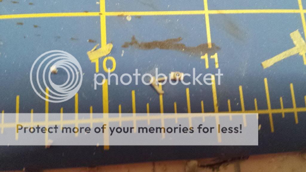

Tiny little fiddly bits that you use on the ammo crate.

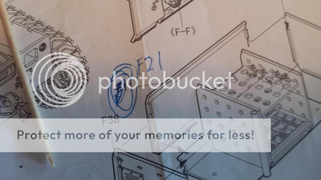

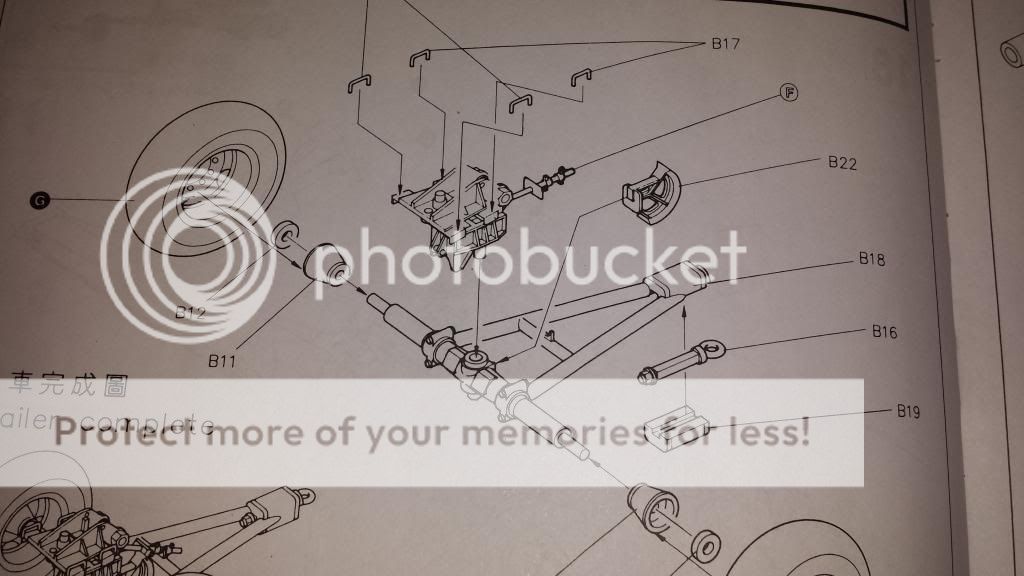

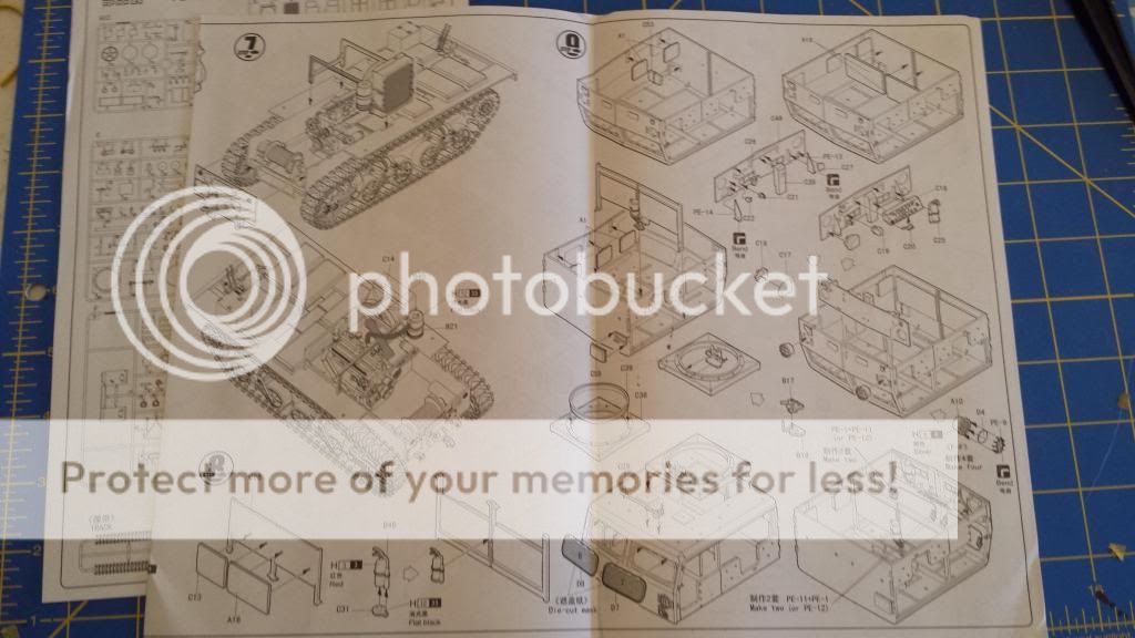

Direction fooboo. Directions call for part F11... Here is part F11
I needed part F21. Easy enough to figure out but if it were a smaller or similar part that could have been a problem.

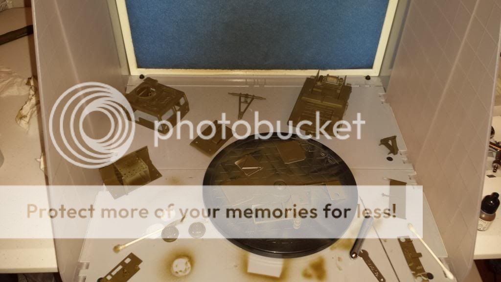

So I'm now to the point where I've broken the M4 HST down into multiple sub assemblies ready for paint. I've decided to put it in a project bin and start on the Long Tom that way I can do the painting all at once. Despite the annoying EPMs this kit is still a blast to build so far.

Great to see your still going with this one, dispite all the nice round holes. Don't know what I would have done... :bash:
And about the breaking of parts. I had the same problem with a ICM kit, tiny pieces and hard plastic don't go together well.

I noticed those ejector pin marks, too...well who could miss them deeply recessed buggers! If the mold designer of this particular mold had any gumption and was aware that EPM's can be a nightmare in the modeling world, he/she could have eliminated all of those marks simply by putting in two overhanging Ejector bars that extended beyond the two ends of those flaps and also the two sides. There'd just be a witness line at the intersection of where the transition takes place from the horizontal flaps to the vertical walls (sides of the armor). Those horizontal ejector bars are simply actuated by two push rods connected to the ejector assembly. Well, that's how I would have designed it! The advantage of those ejector bars is; you're covering the total surface area of the flaps and thus you're getting maximum evenly distributed loading on those two surfaces, which will prevent ejector pin stress marks, due to small surface areas at the end of the pins pushing off large surfaces area of the mold, and also, remove the risk of distorting those two overhanging flaps ie...no warping.
Must have been designed in China for cheaper mold costs?!
Re: 155mm M-59 "Long Tom" Howitzer w/M4 High Speed Tractor E
Damn... :eeek:
I hope you've got enough filler for this build!
Looks great after you filled and sanded it though :thumb2:

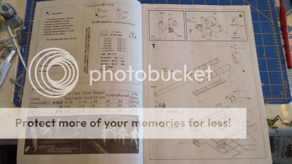

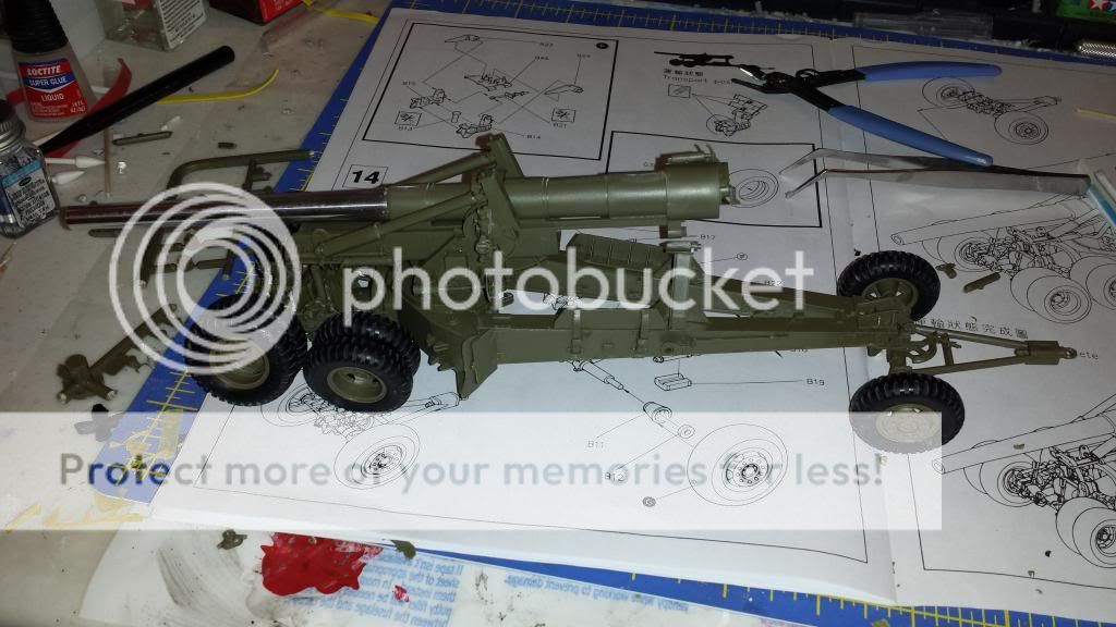

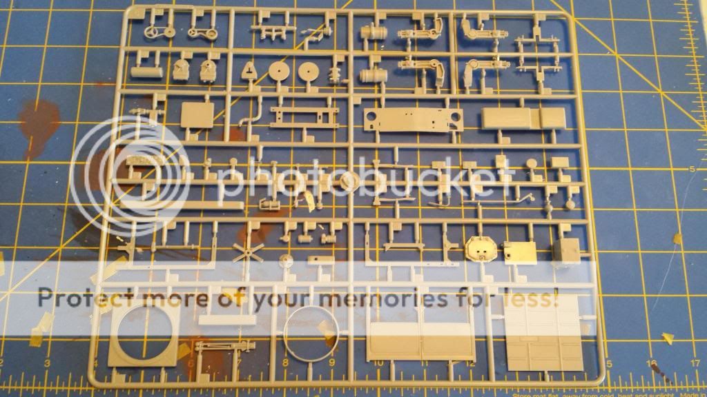

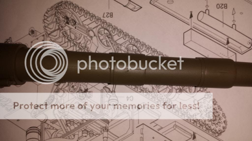

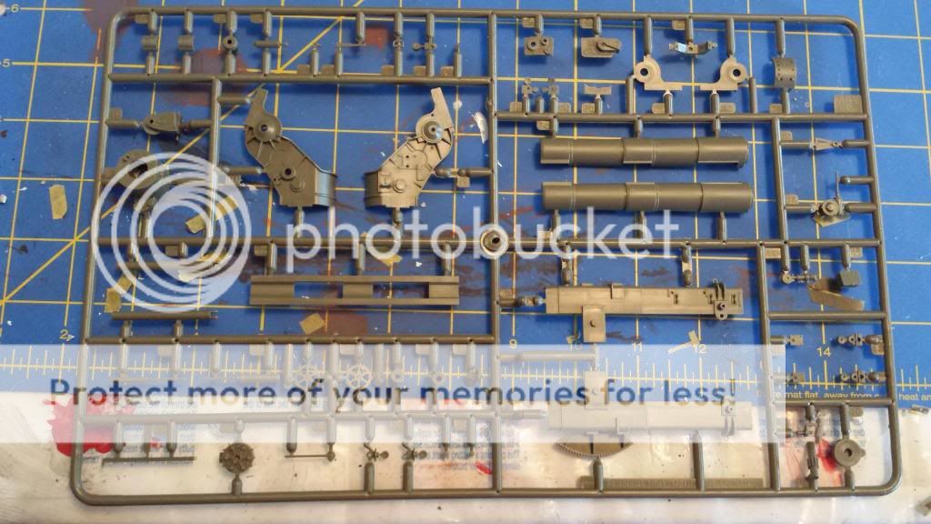

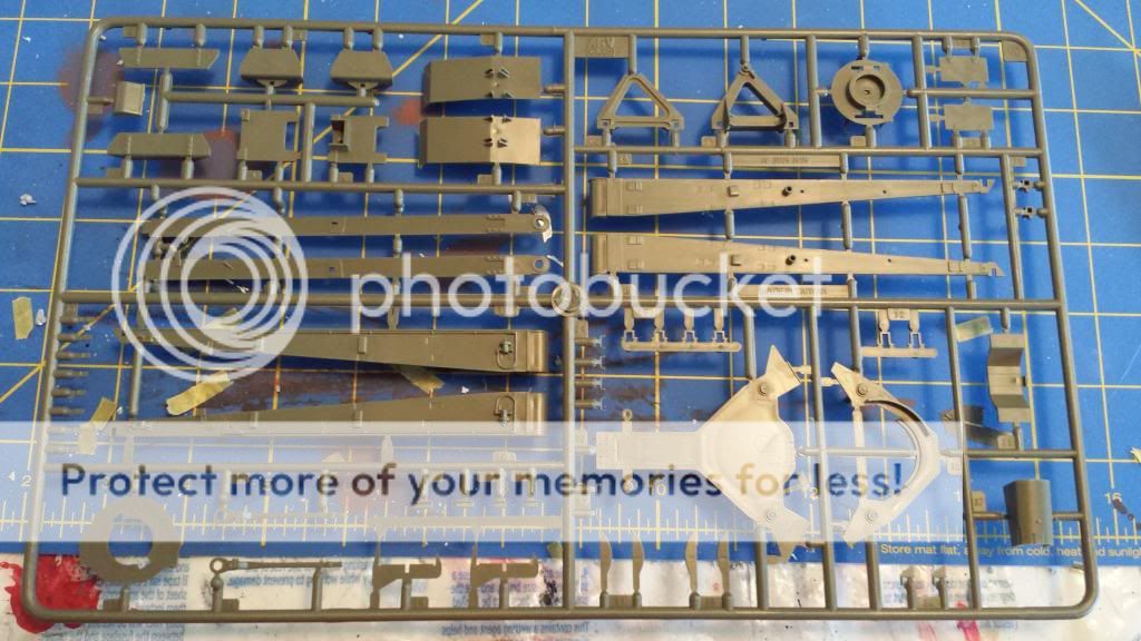

Update 4: Long Tom sprue shots

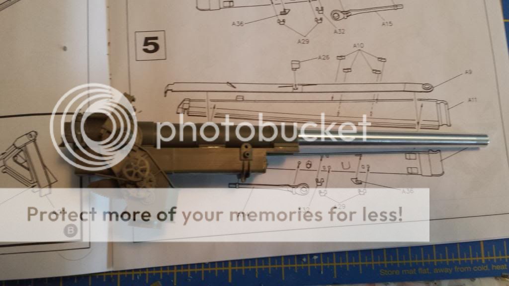

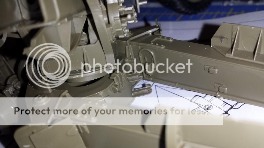

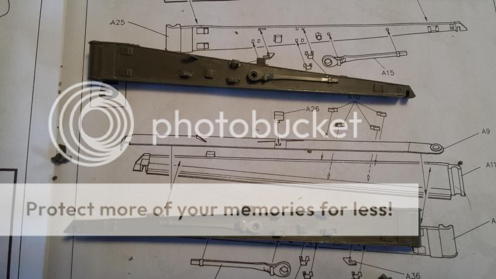

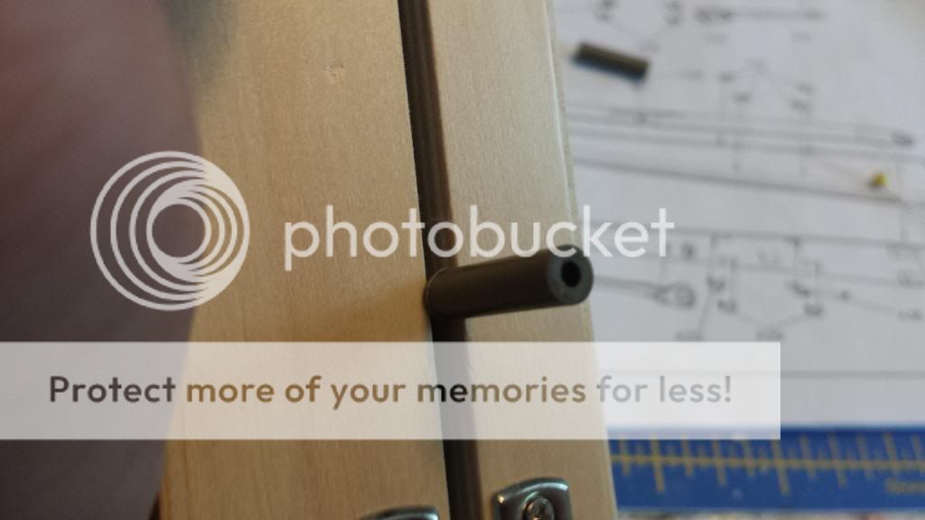

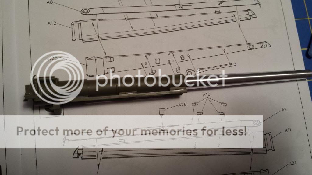

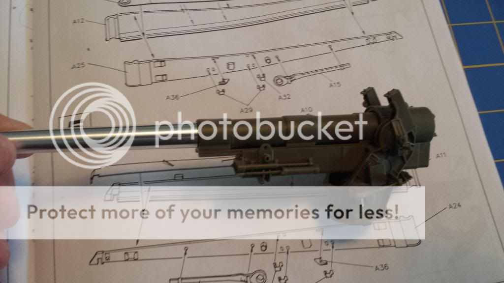

Since I've finished most of the assembly on the M4 HST. I've moved onto the Long Tom. Once again photobucket was dumb and wouldn't let my upload some pictures.

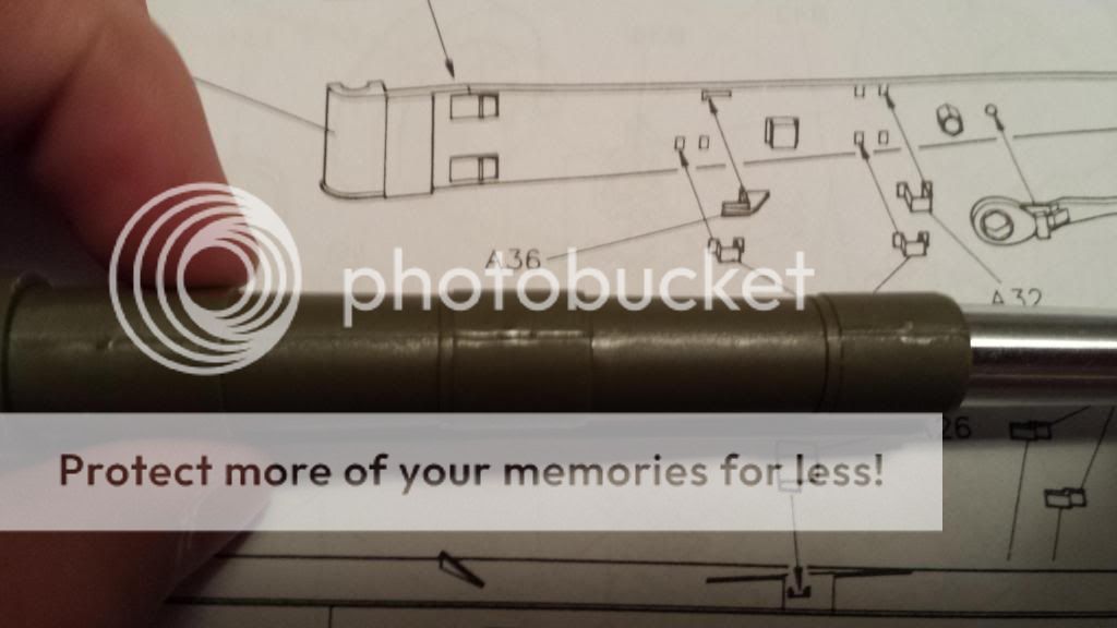

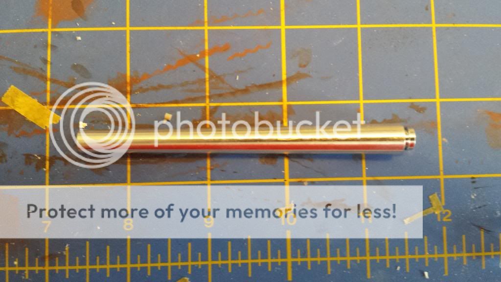

Nice barrel

Yeah they are quite annoying to as the piece that broke in the picture was just the handle to the M2 Browning. Kind of pointless that it was molded separate other than part count fluff.

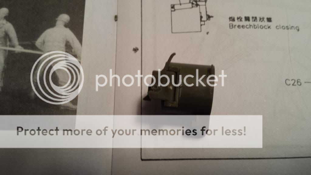

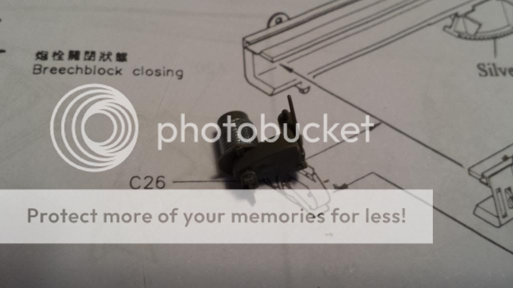

Let's start with a screw up

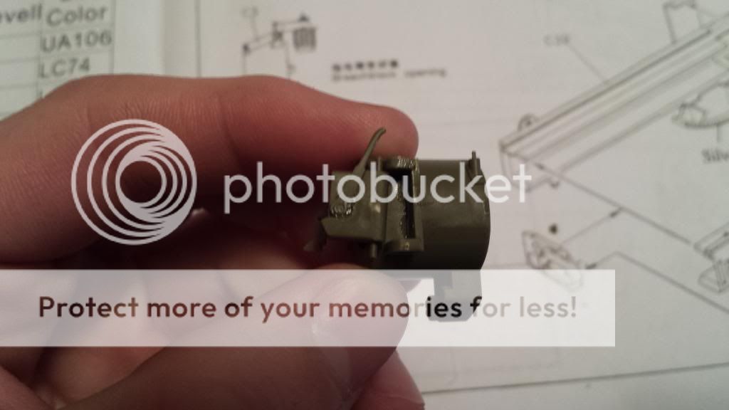

Started on the breech, well so far so good right?
Sh*t! :doh: Don't I feel dumb...
No matter I just cut those pins off and all is well.

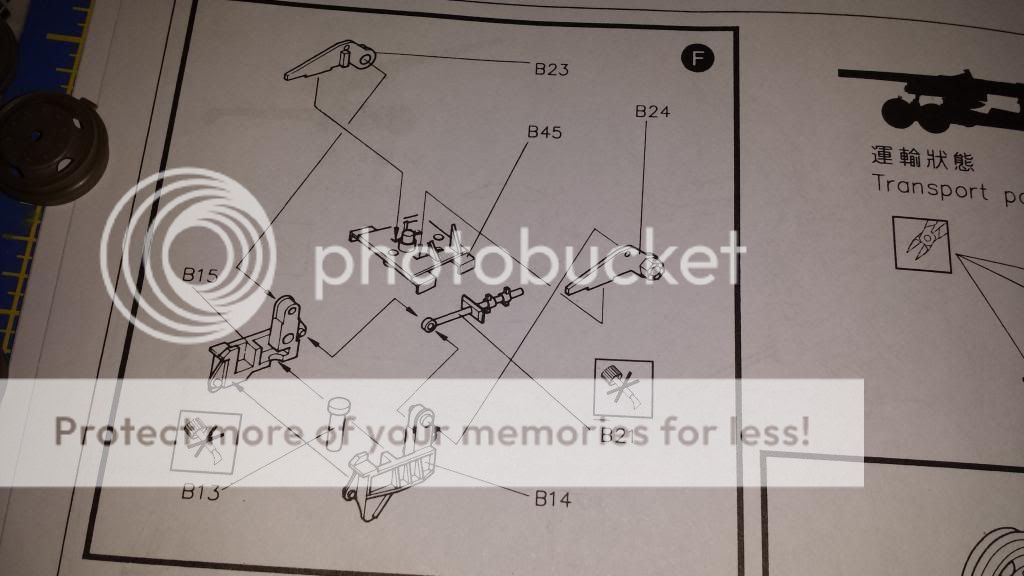

I guess I was tired when I done this step because I found it really, really confusing.
But I figured it out.
Next was barrel assembly. No seam lines here!
But there are some here.

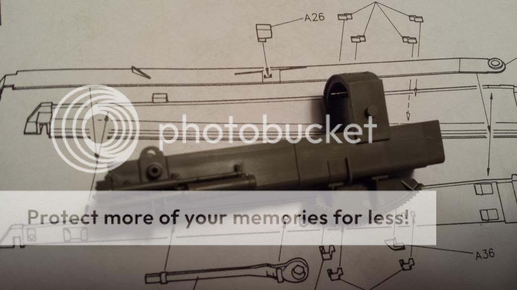

I have no good idea the name these parts make. Carriage, cradle, the thing that the big gun sits in...?
Bad picture but that is a really stupid place to put a sprue gate.

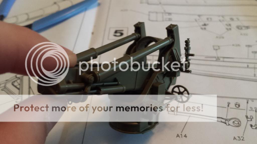

It's starting to come together.
So was fitting the hydraulics together and kinda got one stuck. Also kinda broke the bracket part.
I had to put the piece in my xacto knife box and then push on it with needle nose tweezers to get the darn thing to come out.
Here they are in place
Tried to fix the bracket as I lost the piece that broke. Why do I always lose what I need but every single useless piece of plastic I can always find. It lasted for a while but failed later on.
Arm things
Oops... that's supposed to be one piece :doh:

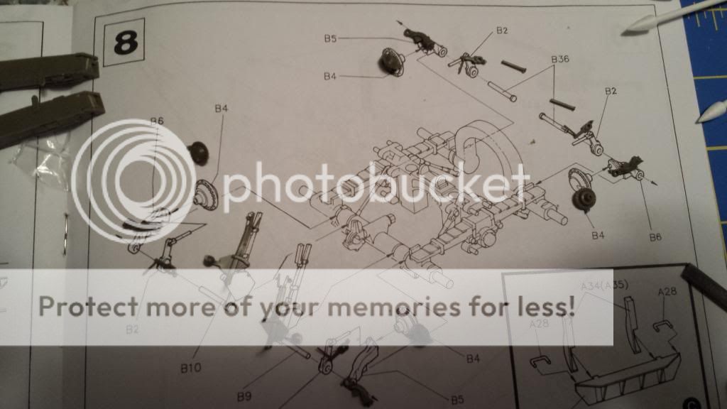

Went to sand the leaf springs and then I noticed something. I cut the locator pins off of them. :doh: :wall: :wall:
Twas a pain but I managed to get everything fitted together.
More fiddly ass pieces
That step was relatively easy actually. I really need to work on lighting.

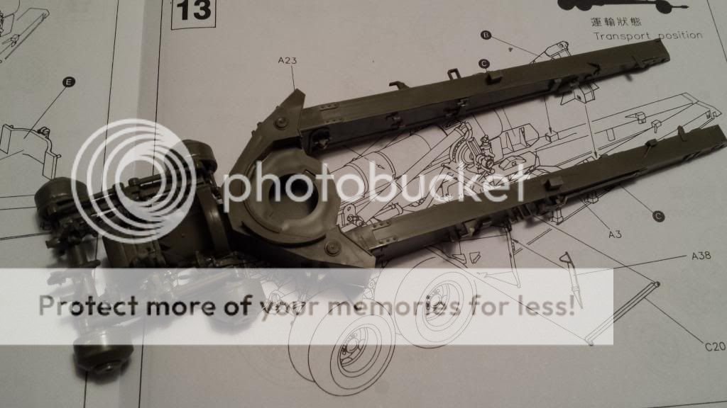

Chassis is complete. There is over 50 pieces there. More pieces in this things chassis than the Tamiya m41 Walker Bulldog kit altogether. Even puts some car chassis's to shame.
Fitted to the arms.

On to make the transport thing
Complete. Relatively simple

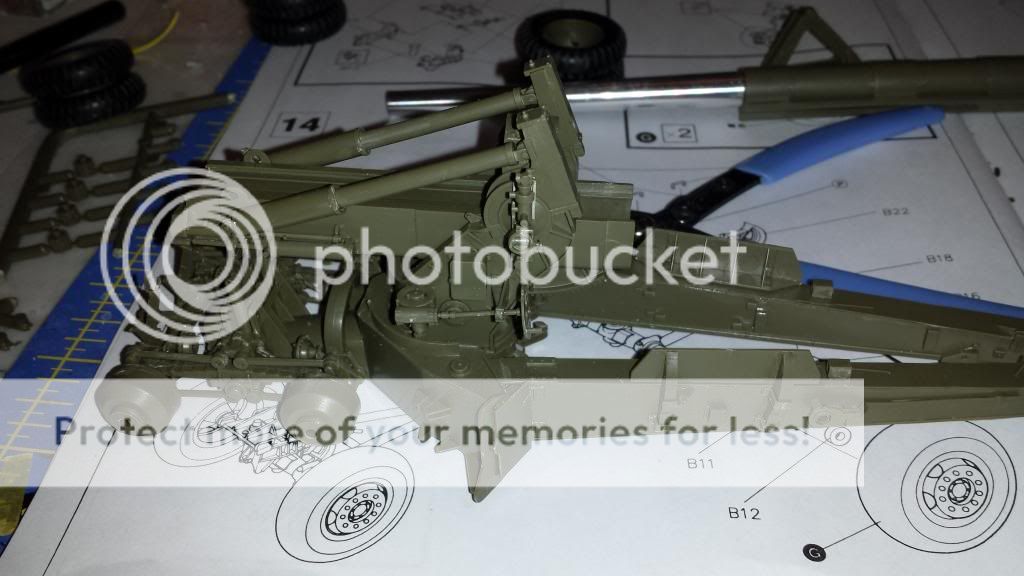

So at this point the build is pretty close to done. So I went to start work on the tires.
All 10 tires had this annoying tee in the middle of them. Just a pain to clean up

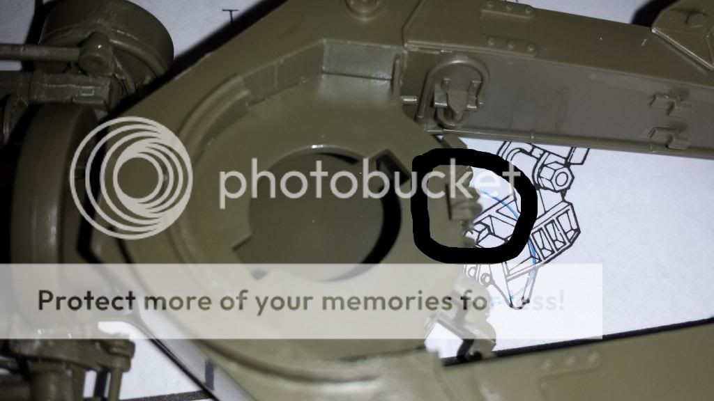

See that little nub sticking up that I circled? Well if you don't put the gun on first this will screw crap up!
That little piece will not let the gun sit down
I tried to soften the part up with some Tamiya extra thin but it did nothing. So I had to start Frankensteining it. The slide things on the bottom, you're going bye bye.
With a lot of encouragement it decided to fit down in there.
Dry fit of everything together and man that thing looks awesome.
Started priming and hello seam! Anybody use the Vallejo olive drab primer as paint? I don't see the point in spraying olive drab primer and then olive drab paint when they both look the same. Seems like wasting paint.
One final note. To connect the Long Tom to the M4 HST I'm gonna have to cut something. Neither the trailer part for the Long Tom nor the hitch on the M4 HST are designed to open in any way. Anybody got any idea on how to connect them aside from just cutting something and hoping for the best.
Man, that took forever lol Next time hopefully I'll have one of them finished! Take care

Update 5.5: Painting
Not much to update today. Got my new paint booth so it was mostly painting, filling, sanding, repeat. These EPMs are being a pain to get rid of. As well as the seam on the bottom half of the Long Tom.
It's a very brown looking olive drab from the pictures but it's not nearly as brown in person. For those curious, I'm using Vallejo rlm81.
