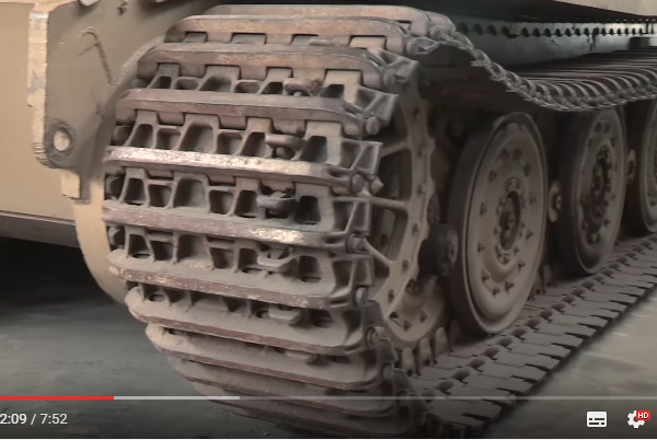

the other side (does anybody know if the guide horns are correct? :scratch:: I never know whether they shall be hollowed or not)

And to answer your question about tracks, yes they should have lightning holes in guide horns.

Thank you for the answer. In the mean time I found a great video on youtube:
[youtube]1ZNZCTNGtlI[/youtube]
There is a nice shot about the tracks used:

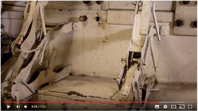

Thank you. In the movie mentioned above there is a nice view about the gun. I used this as a guide. Mine is not 100% accurate, but the goal is to catch the feeling:

Full stock would be 12 rounds. I plan to put 3 in, and leave one outside (maybe hanging on the crane). I still have to figure out how to place the rounds to have a nice visual experience. For sure there will be some empty credos, so some modifications have to be done to force them to a hanging position:

There is a nice shot about the tracks used: guidehorns.PNG
Interesting tracks. No ice cleats or indents, I thought Tiger tracks had one or the other, not neither.

You made me think, and I have checked several vintage photos. This one is a pretty nice picture, and the tracks are clearly visible: Image I think the tracks in the museum are correct. :) But it will be a huuuuuge work to drill/carve all those missing holes. :cry:

As mentioned, I changed a bit the ammo holders for the empty spaces, cut the upper right arms, sanded, and glued back in an angel. I plan to have the two armed shells on the left side close to the center to hide the empty space behind them. With this I hope the one who looks into the tank will assume that more shells are behind, thus the number of ammo will look to be higher then the reality. On the right I will place one, and one goes outside.

So, last time I was looking for a solution to make holes into the guide horns. I ended up using my rotary tool with 0.7 drillbit, and drilled 2 holes next to each other, then gently moving the drill between the holes I removed the plastic between them. I did it only for the horns on the outer side, the inner ones won't be visible.

I managed to accomplish both tasks for this weekend: finish the tracks and level up in The Division. :)
First I mixed up regular dirt from the garden and two kind of pigments. The pigments are great to add color to the dirt, and to maki it finer. With a small brush I applied some of my home made scenic glue to the tracks, concentrating on the deeper sections, and covered with the dirt mixture. The ends are kept clear for future gluing. I let it dry fore a minute or so, and then with a kitchen paper wiped off the surface to reveal the shiny metal edge of the tracks. Where I added more glue, the mud will be darker. If I'd like to add some more dark areas, I only need to add some more glue. Again, to save some material I added the mud only to the visible areas.
When all the track segments have been dried, I added to the lower hull. Tigers had 3 rows of wheels in combat mode. I glued only the internal ones first. Then using then as a support I could add the return roller and the upper section of the tracks, and secure it with Tamiya Extra Thin. Then I added the middle wheels, and glued them on adding more strength to the tracks. And here I also added the drive sprocket. With its teeth it provides a great area to join the upper and the lower section of the tracks. Here I used superglue first, and reinforced it with Extra Thin. When the two halves were glued together, the lower section was aligned to the wheels and secured with Extra thin, and with superglue to the other end of the upper section. Ummm... might sound a bit complicated, but it is only me, who cannot explain it... :D
At the end the outer wheels were also added. Finally I added some dirt to the joints.
And when that all have been done, I started over on the other side... :)
Here are some closeups:
Now I have to weather the remaining of the hull, paint the figures, and figure out how to make a nice snow with the materials I have. I probably try to add flour and baking soda to wood glue with different dilution. Any idea how to make nice snow effect in a DIY way?
