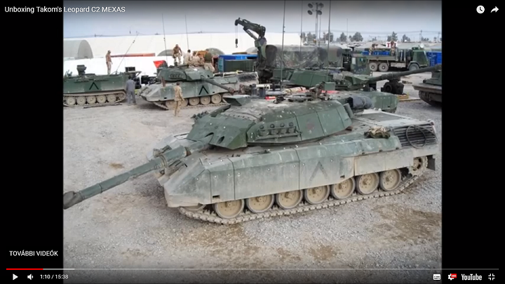

I also fount a nice picture for inspiration on Youtube:
R U Ready? :D
